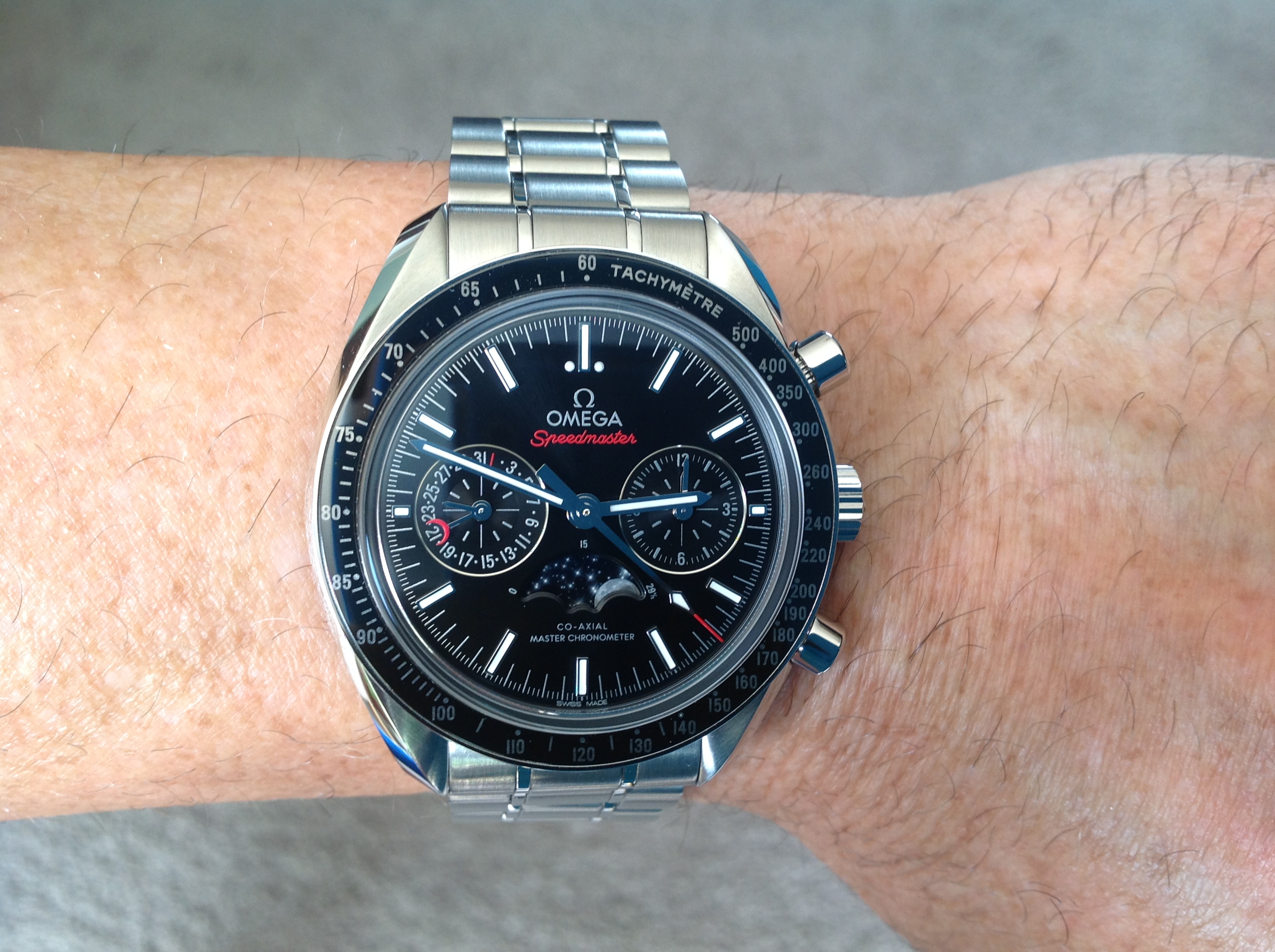

Looks like the black Moonphase are common. Time keeping not an issue for me, a few seconds a day is good enough for me.

Thats a lovely picture
Cheers! It has been a daily-wearer ever since I got it! Always wanted a Seamaster since watching Bond as a kid in the 90s 馃榿
