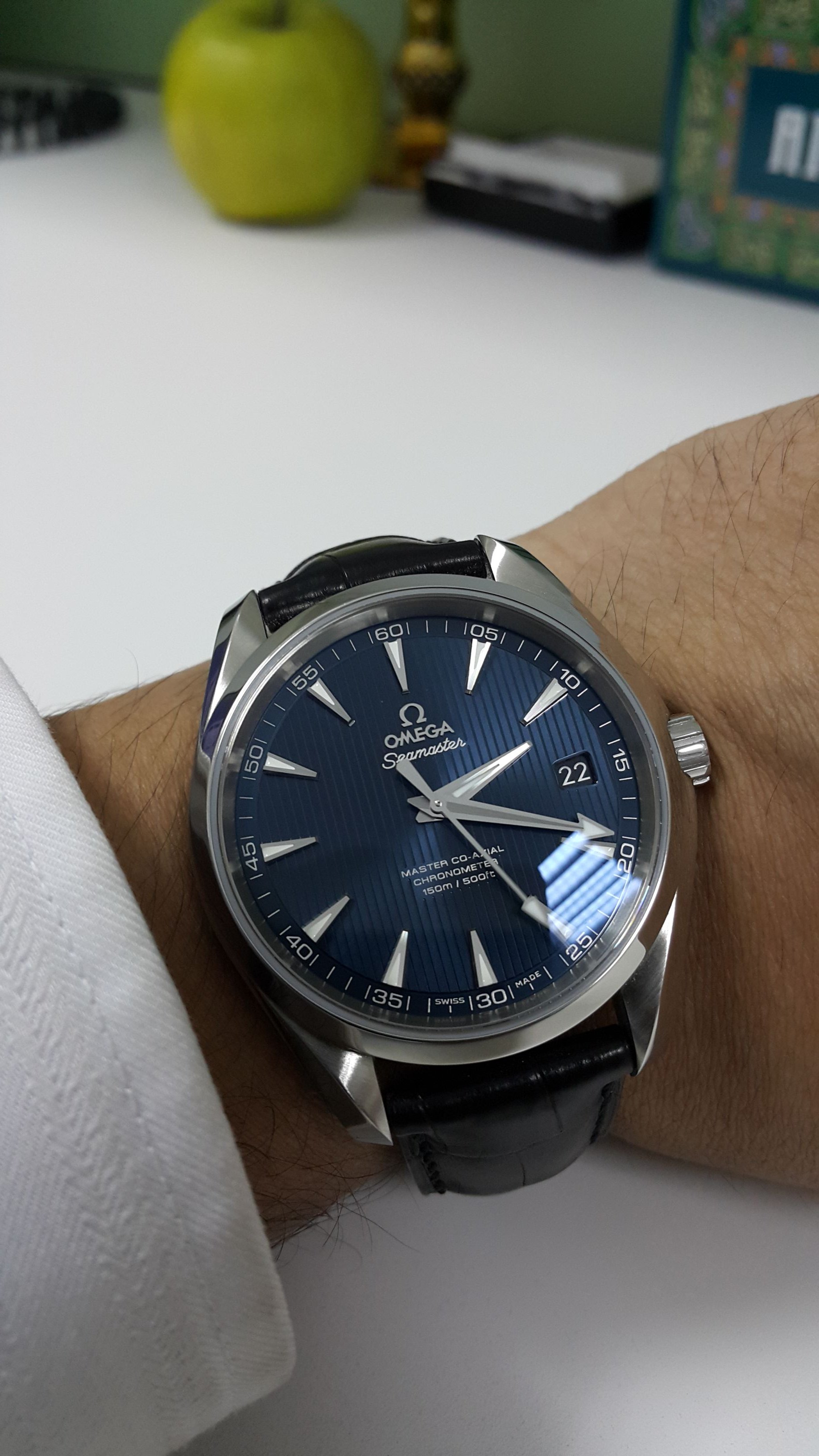

Mine is pretty much dead on balls accurate.
It's an industry term.

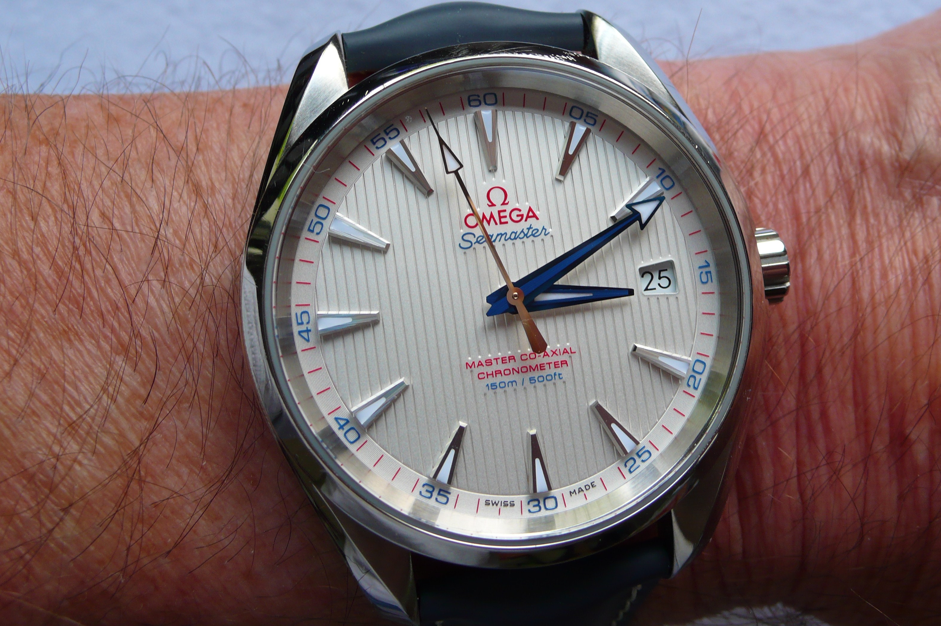

These Omega co-axials are incredible!! Mine is 12 months old and keeps time within 1 to 2 seconds per day.
