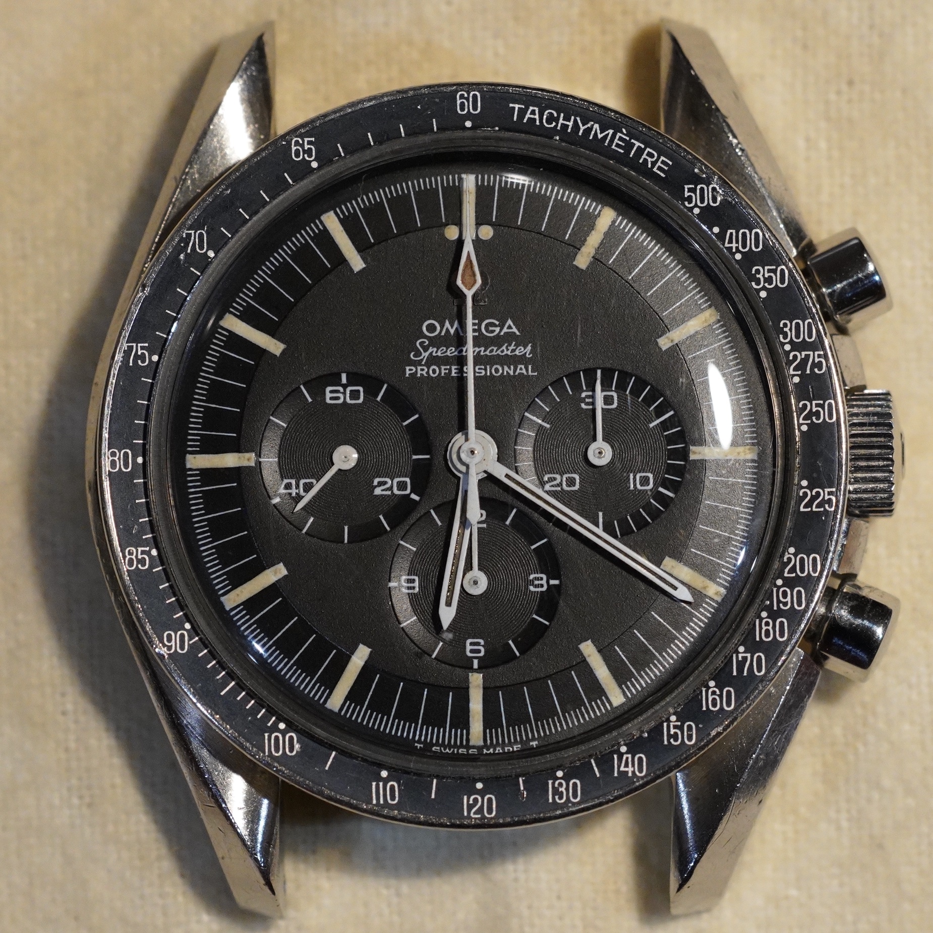

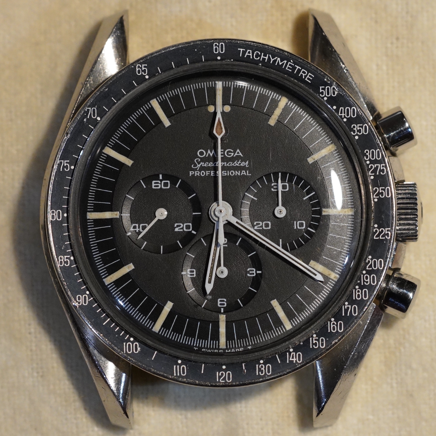

In what conditions would you recommend this be done? For example, would you recommend stabilizing the dial (or hands) of my 145.012? (I hope it's OK to post a photo of my watch in this thread, but please let me know if I should instead create a new thread).
In the attached image, you can see that the edges of the hour hand are slightly degraded (exaggerated by the reflection of light), as well as some minor age spots on multiple dial plots. (Edited: easier to see by opening in a new tab and zooming in). Perhaps more significantly, the plot at 1 o'clock is degrading at the edges as well, and the plot at 12 o'clock has whitened/lost a bit of the lume at the top. What do folks think?

I check hands under a microscope to see if there are cracks or thin spots - if there are, I stabilize them. For dials, only if the lume is flaking.
My watchmaker always stabilized the hands of my older watches when in service. It is done even if no cracks are seen in the microscope. It is just as a prevention in case the watch is exposed to a shock strong enough to crack the lume on the hands. If done by a proper watchmaker , you can’t even tell….

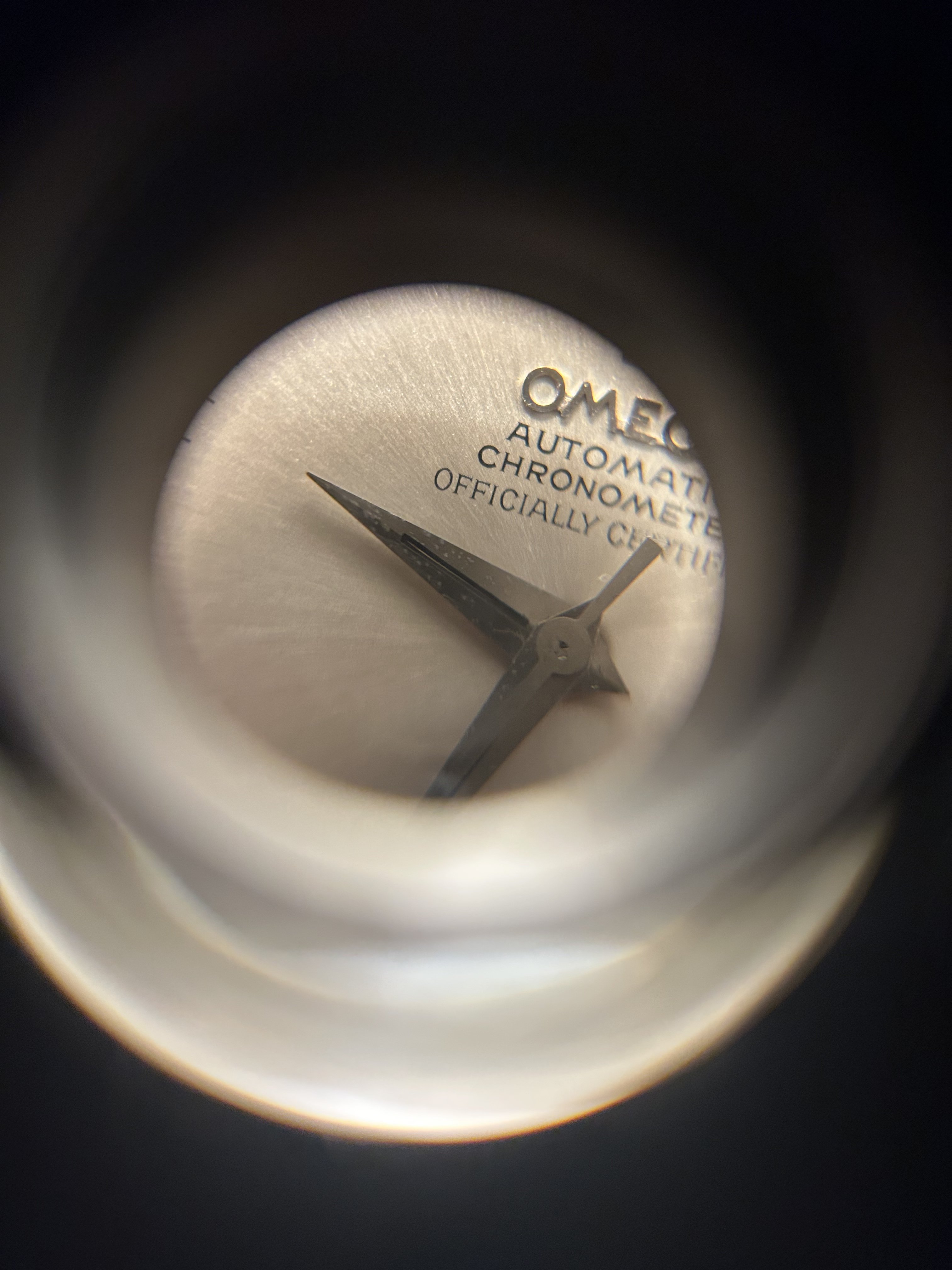

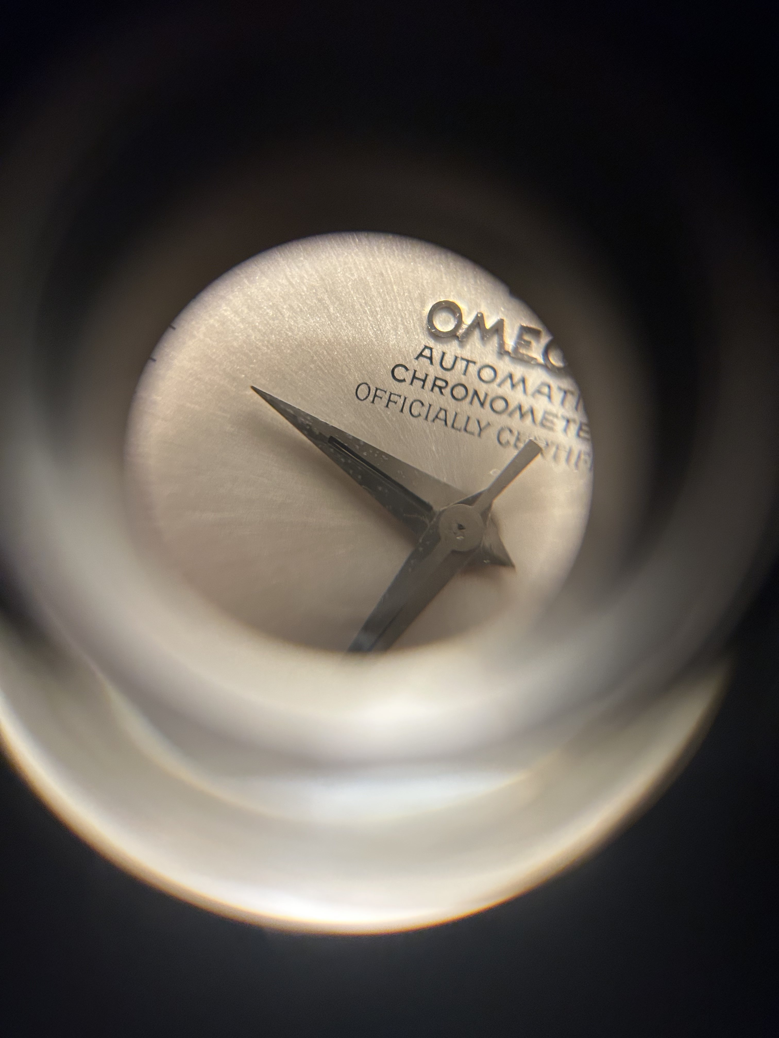

Sorry to resurrect this thread - however I wanted to ask if people ever do this for some of the 60s Omegas that have black painted or onyx indices, and as a result have black paint/material in the hands? Pic for context. I have a very clean watch and I wouldn’t like the material to come out and damage it, if this is a risk.

Yes, some have onyx or painted hands.
And some lume turns black with age.

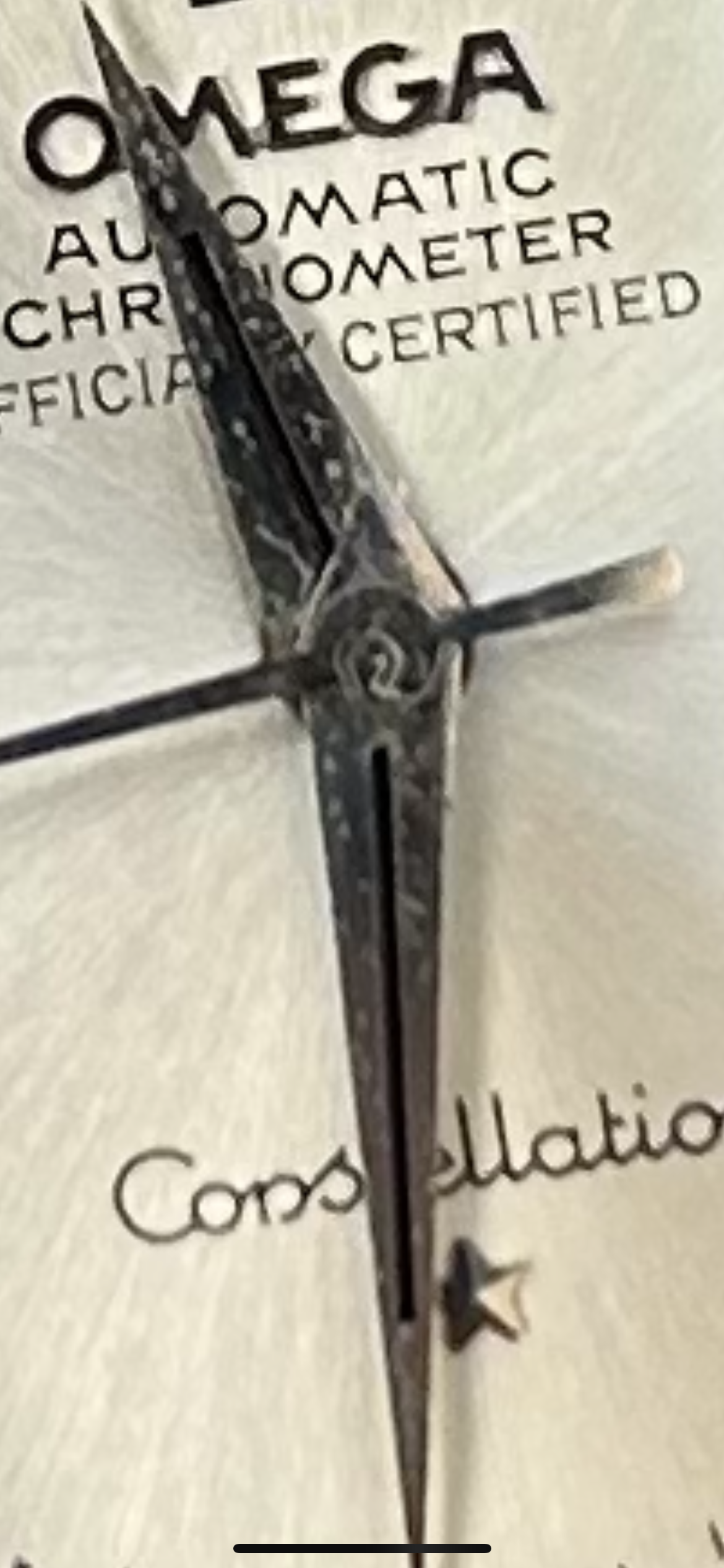

I’m not clear on what you’re asking. Are you asking whether binder can be used to stabilize the black paint on the hands on your watch?
If so, it’s not something I’ve done, or see the need to do...
Agreed.
Yes, that was what I was asking. Sorry it wasn’t clear - and thanks for your responses.

As an addition to my latest comment - I was looking at my constellation under a loupe, and I noticed what appears to be a crack in the black paint of the hour hand - would you recommend stabilising this?

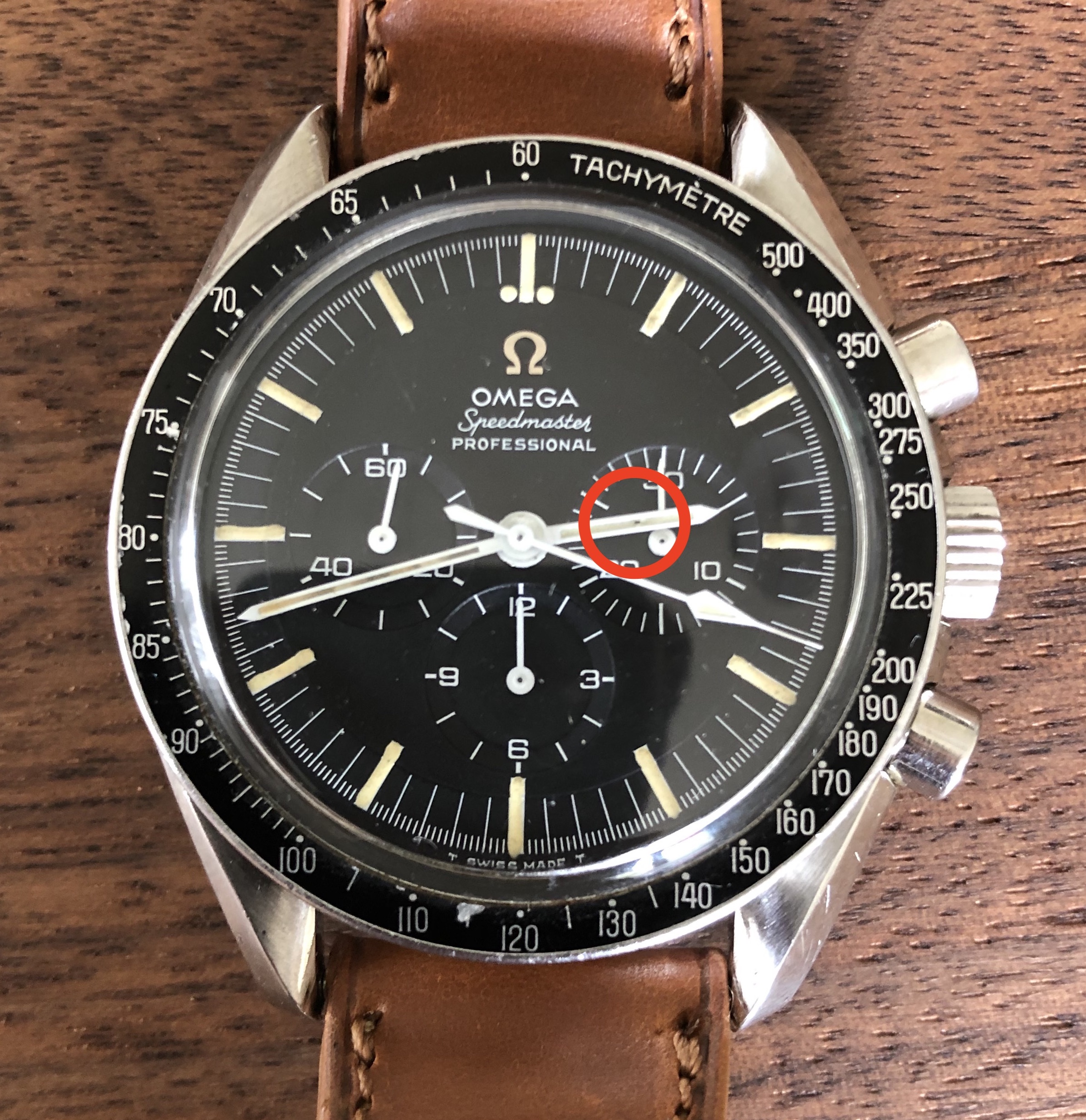

Sorry for reverting back to stabilizing lume on hands. I get the binder method from underneath part, but for that, the hands need to be removed in the first place. When my (careful) watchmaker removed the hands of my 145.012-67 for service, some lume broke off the hour hand (I still cry a little). He subsequently stabilized the lume from underneath to prevent any further lume loss.
Is there a way to secure the lume before removing the hands?

The binder could be applied to the top of the lume, but it would be difficult to do so without getting any on the painted surfaces of the hand. I also don't believe this would be as effective as applying it to the back of the hand - when you apply it to the back, you are stabilizing all of the lume on the hand, not just the visible portion, as you would be if you did it from the top.
The lume must have been in very bad shape for it to fall out when removing the hand...this is very unusual in my experience.

Thanks for your reply, Al. That bit came off. Bad shape?
