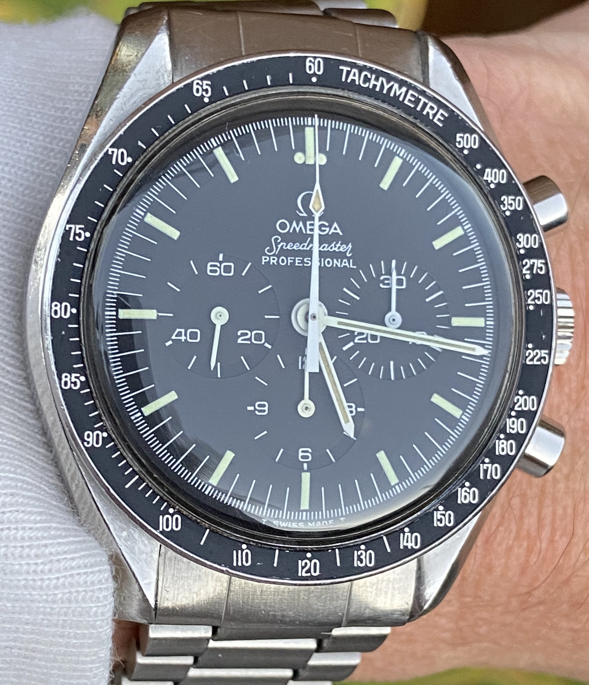

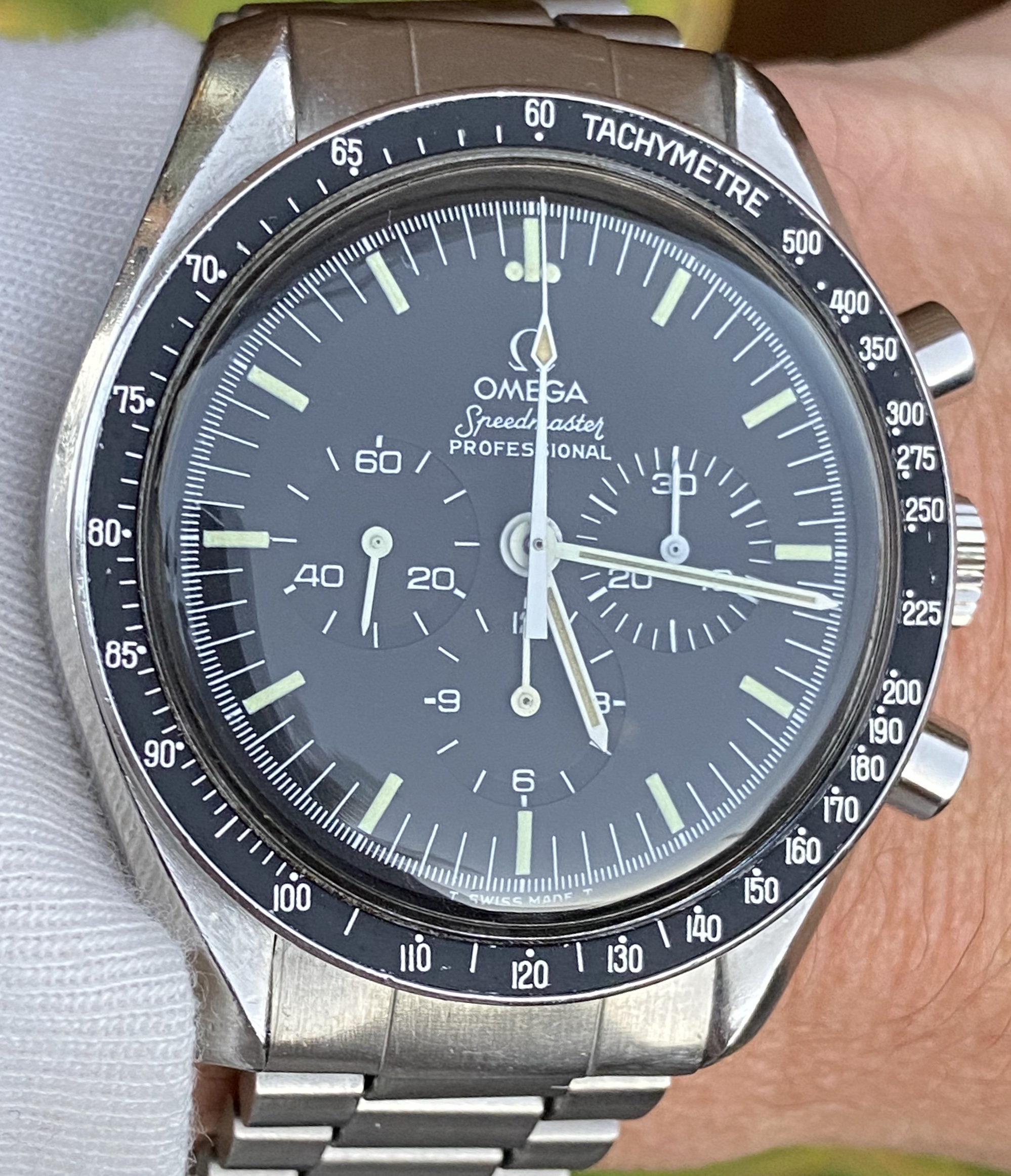

Hi all. Have a 145.022-76 in for a bit of service and the shop is suggesting to stabilize the lume on the hands, they say it is beginning to crack a bit. It is not obvious at this point at all, no flaking or any holes in the lume but it’s 40+ years old so am sure they are right.
So, was looking for your thoughts on this in general. When buying a vintage Speedy, is having the lume in the hands stabilized a positive or a negative in your mind? Not talking relume, just stabilization. And does anyone do this as preventative maintenance before flaking or just wait until you can actually see an issue? Thoughts and opinions are appreciated.
The ‘76 in question, no point in a thread with no pictures. 😁

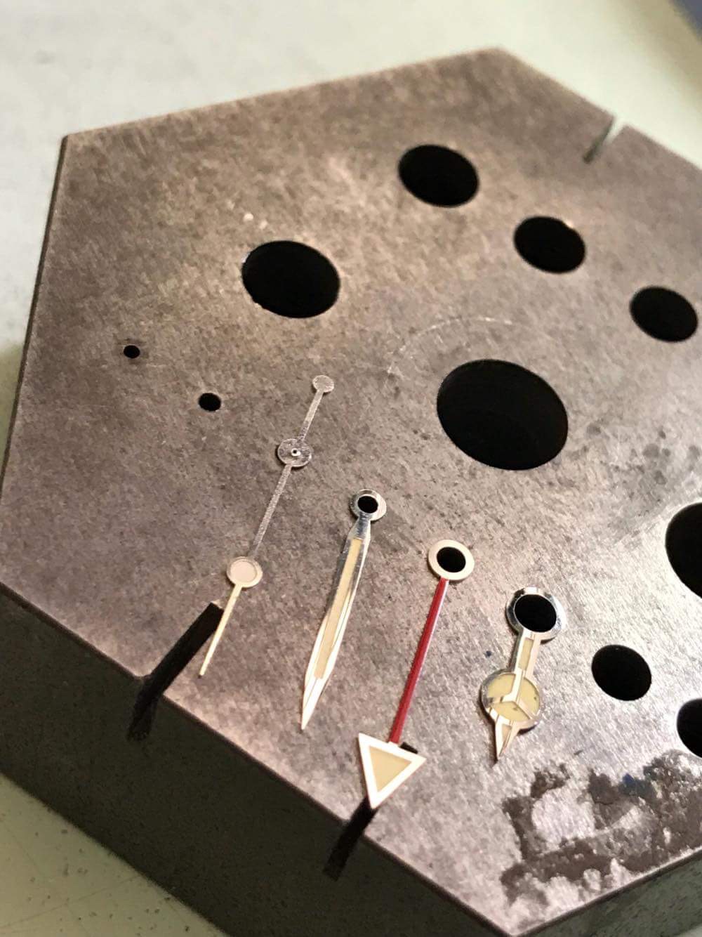

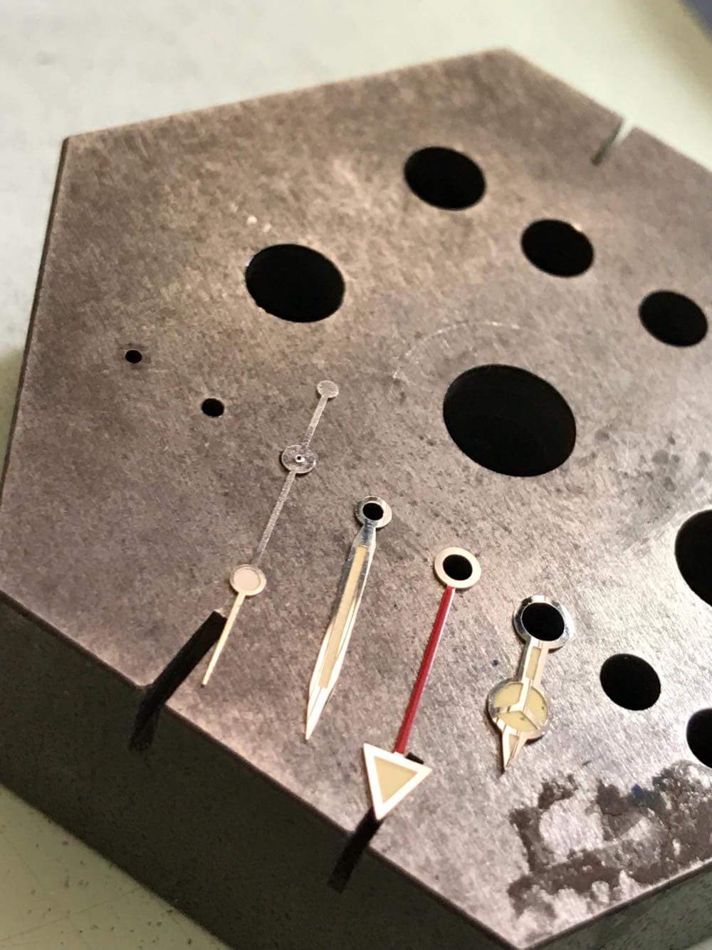

You often cannot see cracks with the naked eye. I put each hand on the microscope, and backlight the hand to do the inspection...
As noted, the binder is placed on the back side of the hand:
Done properly, you will never see it.
Cheers, Al

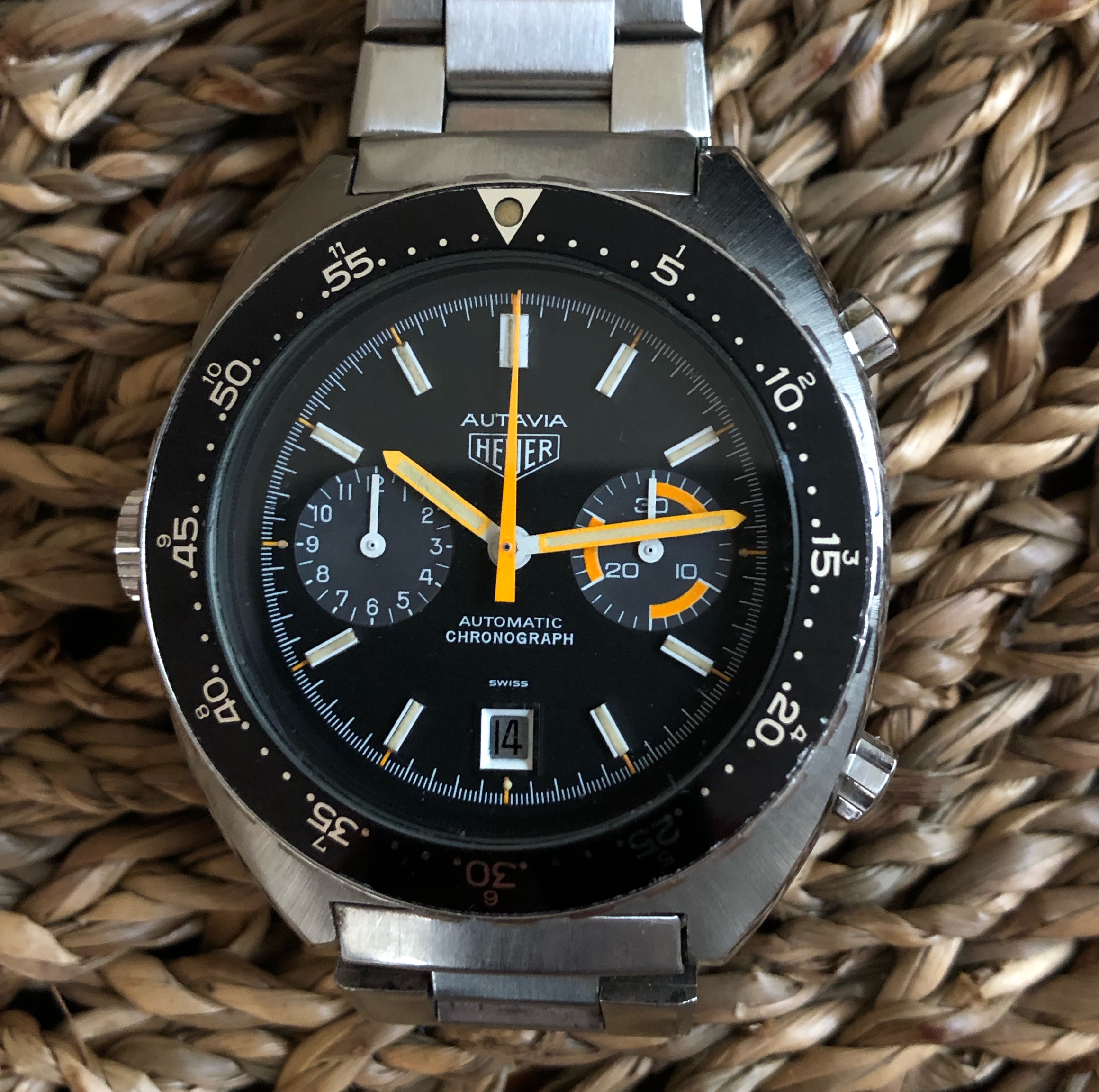

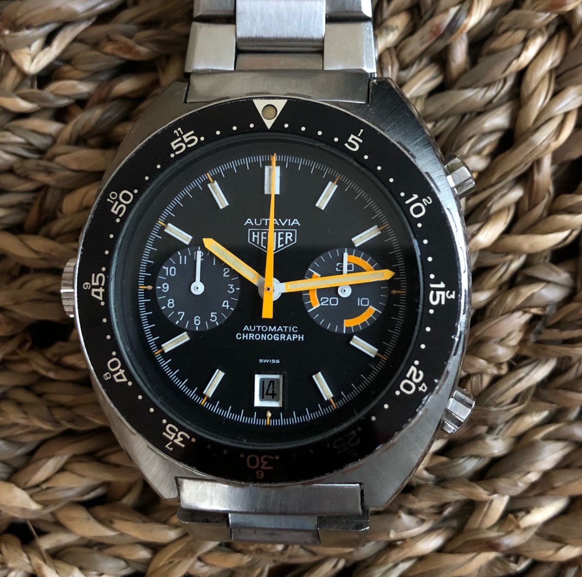

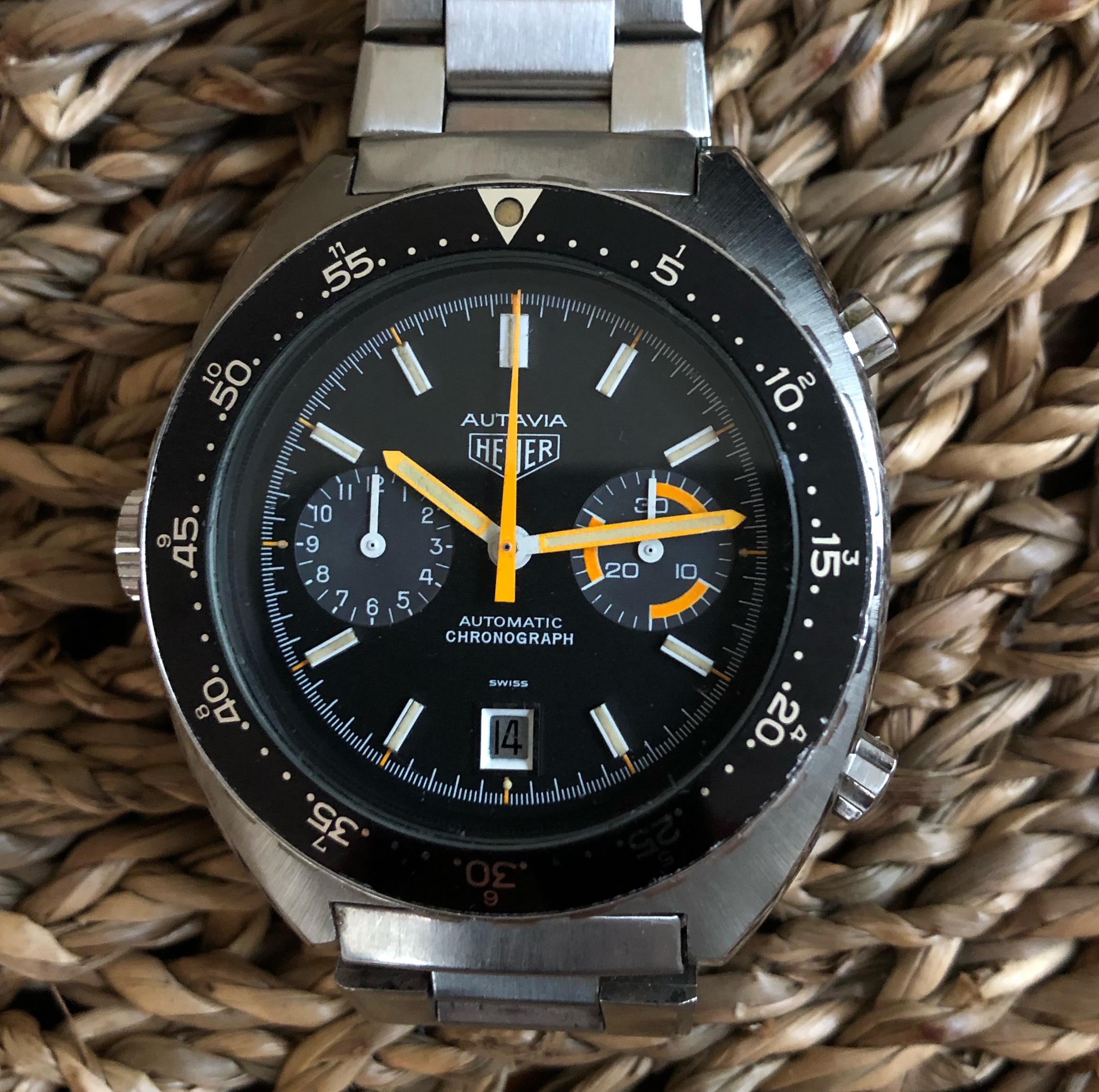

I had the hands on this Autavia stabilised by my watchmaker about five years ago. I was reluctant at first, actually purchased a NOS hand set, very hard to find. In the end his stabilised hands matched the fade on the dial better than the brighter NOS and have had, touch wood, no issues since. BTW, the hands were orange to begin with🙄

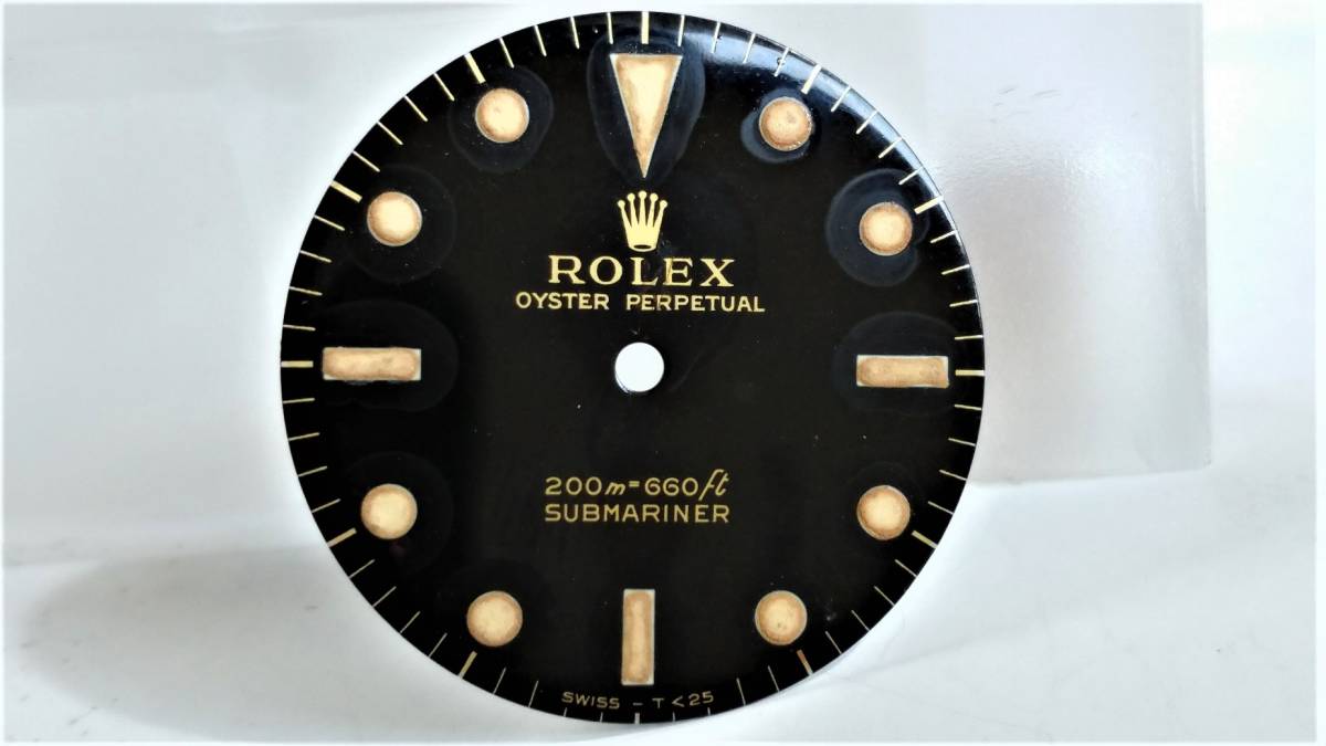

The bigger question imo is stabilizing lume plots, which you can not obviously do from the backside.
1,185
6,046
I was wondering that to about lume plots on the dial. Has any one had luck stabilizing lume on the dial?
10,093
57,625
It's a much better option than having flaking lume get onto the dial or, worse, into the movement.
1,990
9,506
All I know is LAWW said "NO" to that; they do not stabilize lume on dials, just hands. That is only one shop but they specialize in those kind of services so if it could be done well I think they would do it.
30,230
78,056
It can be done, but has to be done carefully so extra stabilizer doesn't spread to the dial. It will often change the colour of the lume, making it slightly darker, and if the lume is very matte finished, it will probably look more shiny after.
