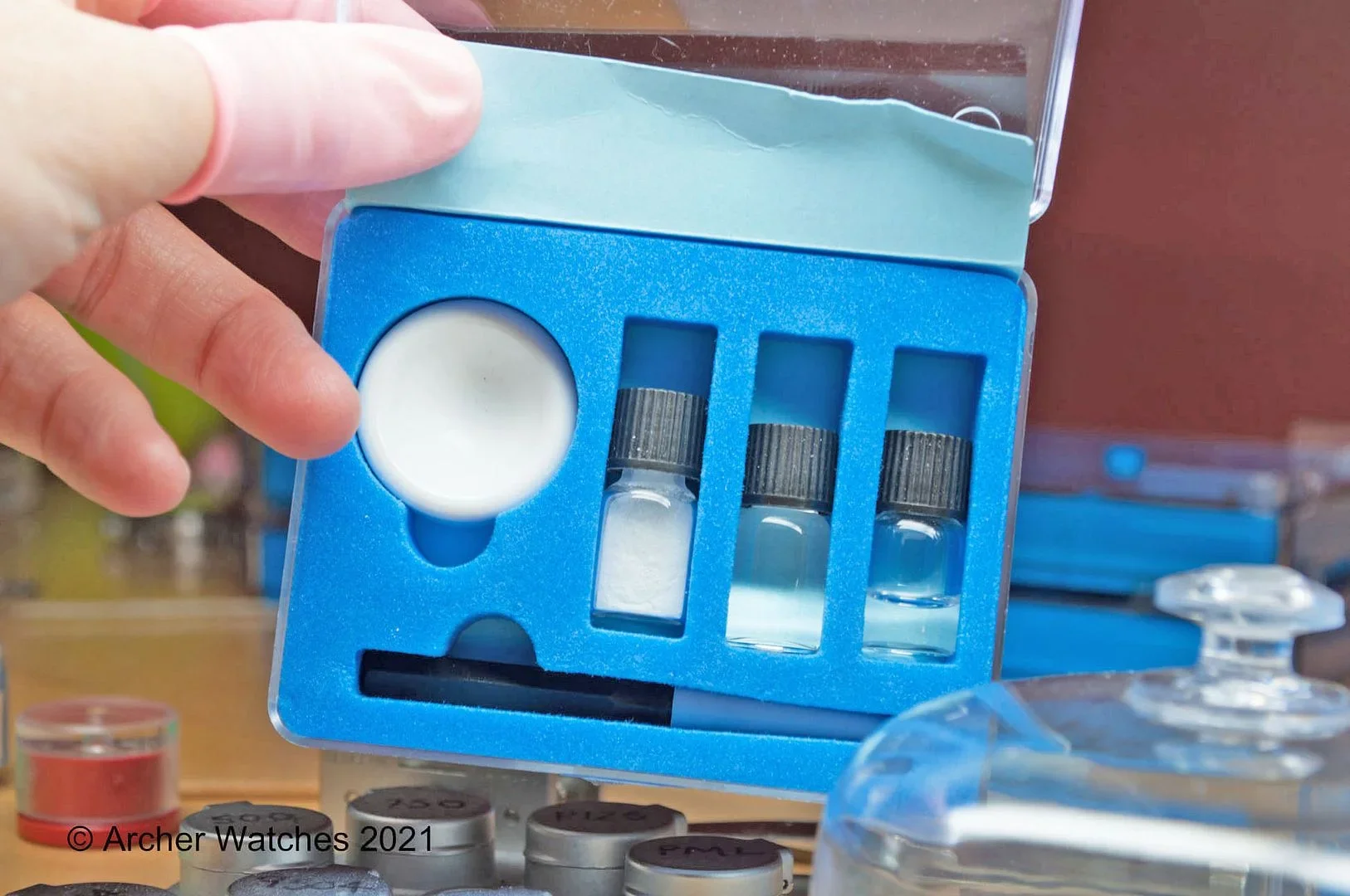

320
998
@Archer, may i ask what make the binder is you use to stabilise the lume on hands, please? Many Thanks,
30,230
78,056
It's just the stuff you find in a reluming kit, like this...
320
998
Brill thank you; I was torn between the two big names Tritec and Bergeon, although some suggest Bergeon use Tritec anyway, even though there's no hard evidence to support. Assuming can't go too wrong with either
