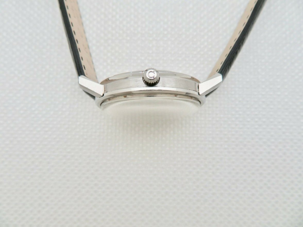

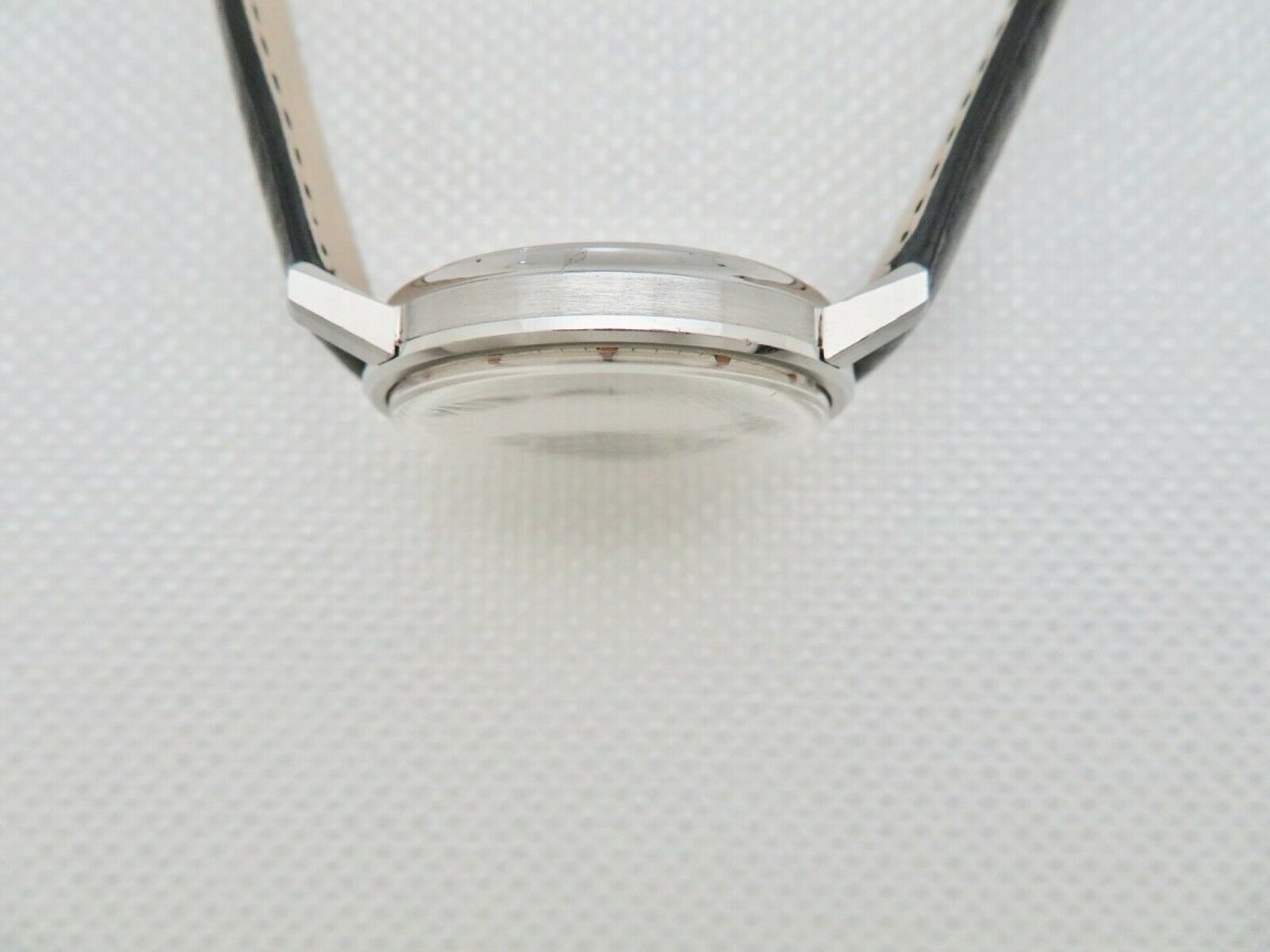

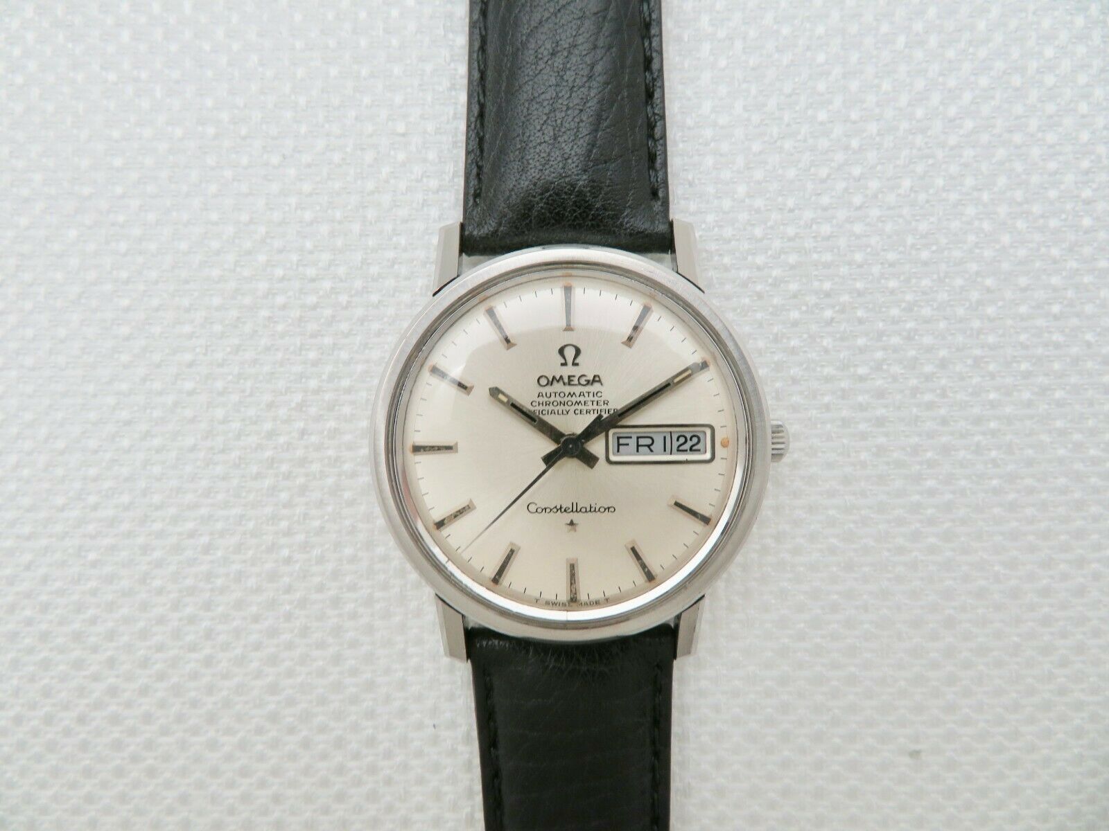

Geneve's dial looks good. the case may be polished. More photos are needed of the movement and the lugs to determine and judge better . Also the crown?
Connie looks a little better.. 35 is without the crown yes.

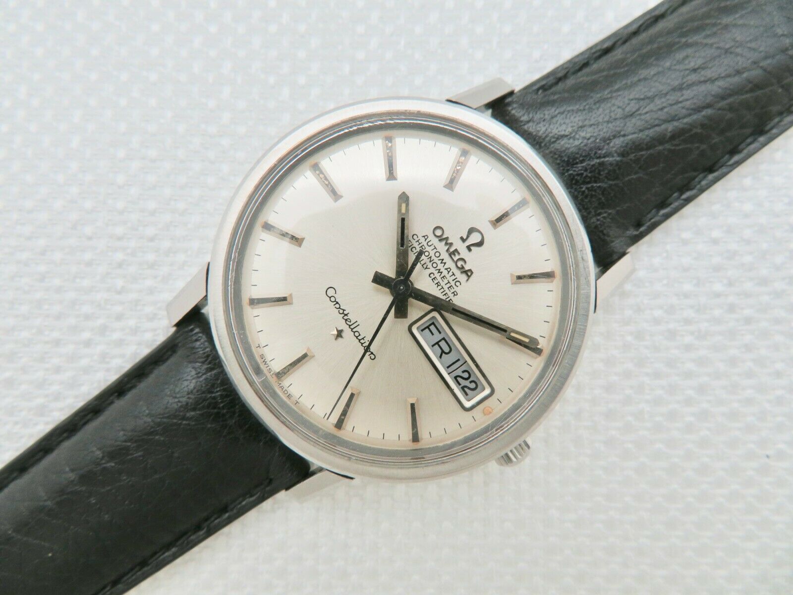

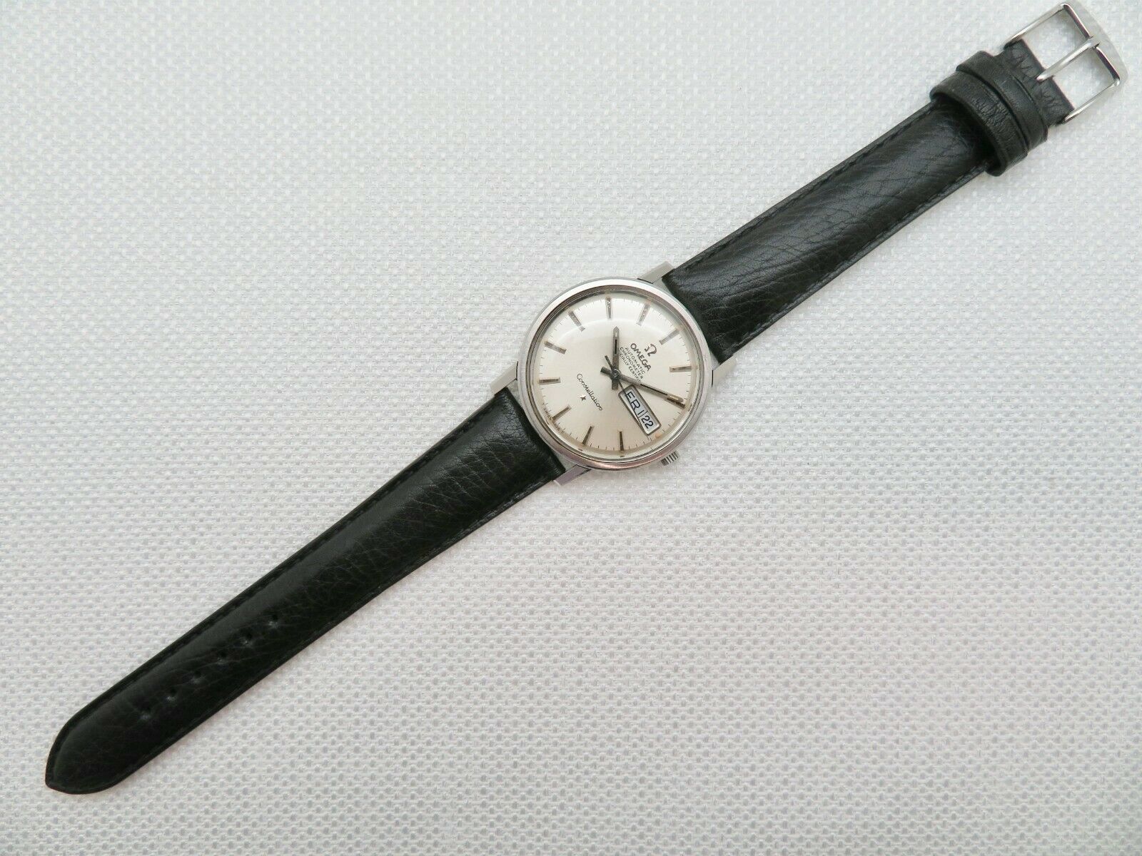

Hi guys'
Looking to soon make my first vintage Omega purchase. Just want to know what you guys thing about these two watches?
https://www.ebay.com/itm/1971-Omega-Geneve-Vintage-gents-automatic-watch/163985705594
https://www.ebay.com/itm/MENS-VINTA...TER-DUAL-DATE-WRISTWATCH-168-016/283744047723
Also, The Connie, I assume the 35mm is without crown? Thanks in advance for your input.

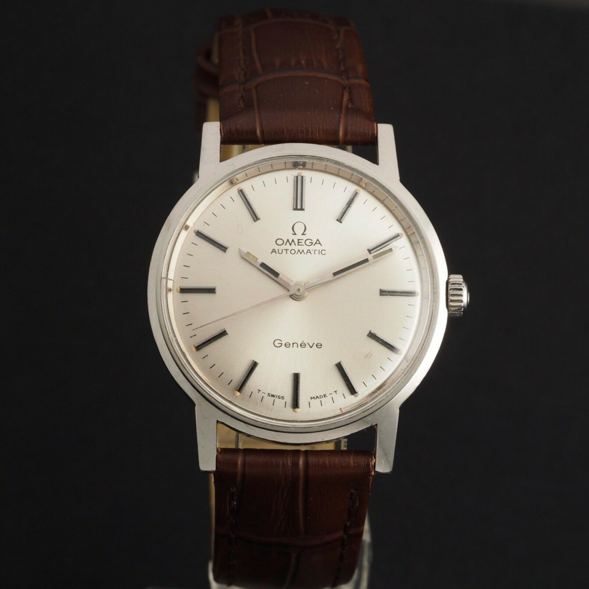

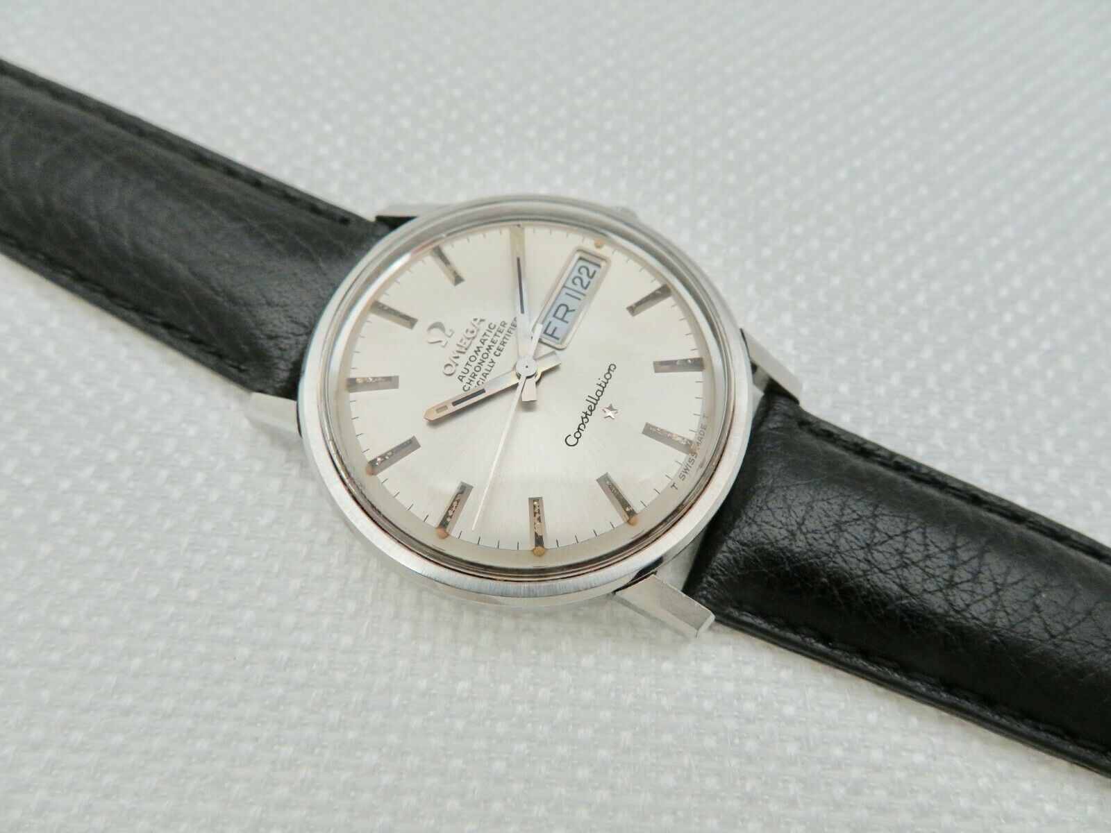

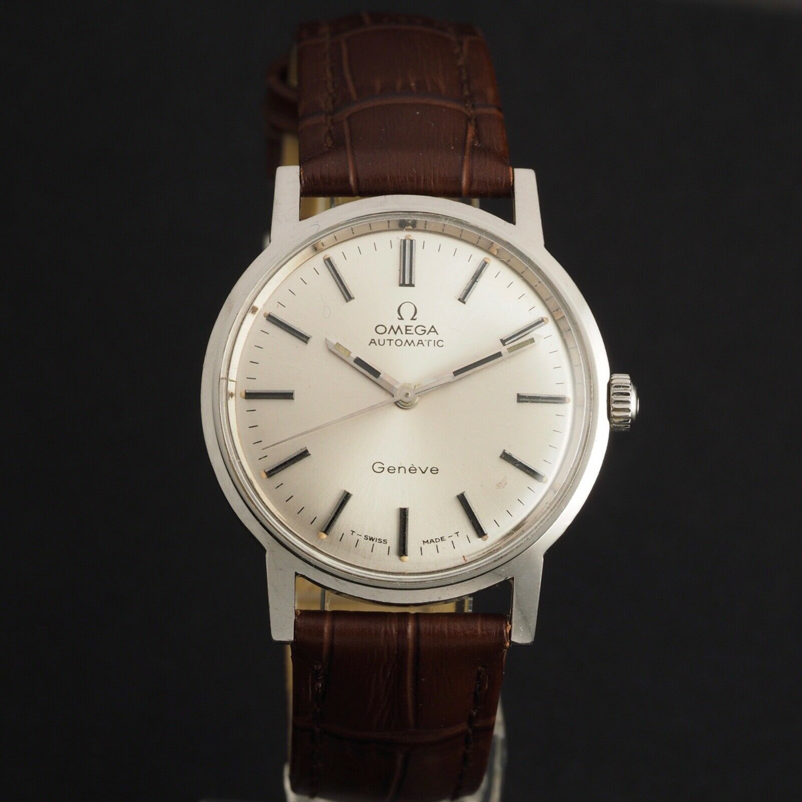

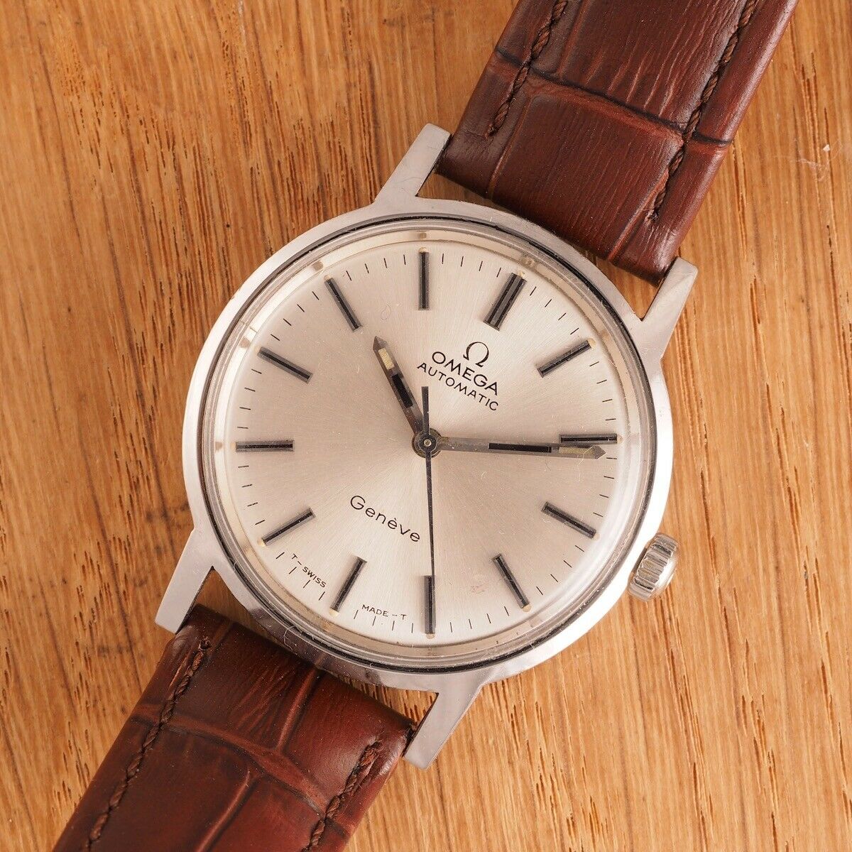

Dial on the Geneve looks too good for a 49 year old watch. Is the seller representing it as original?
16,305
45,025
I think fhey’re both original- my SM 600 is the same age and looks about the same for dial and lume color.
10,123
57,923
I agree that the Connie dial is original. There is noticeable wear on the indices and a little discoloration. Still not convinced that the Geneve isn’t a redial though.

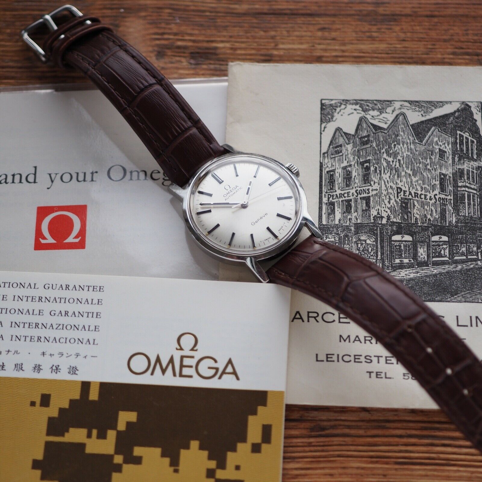

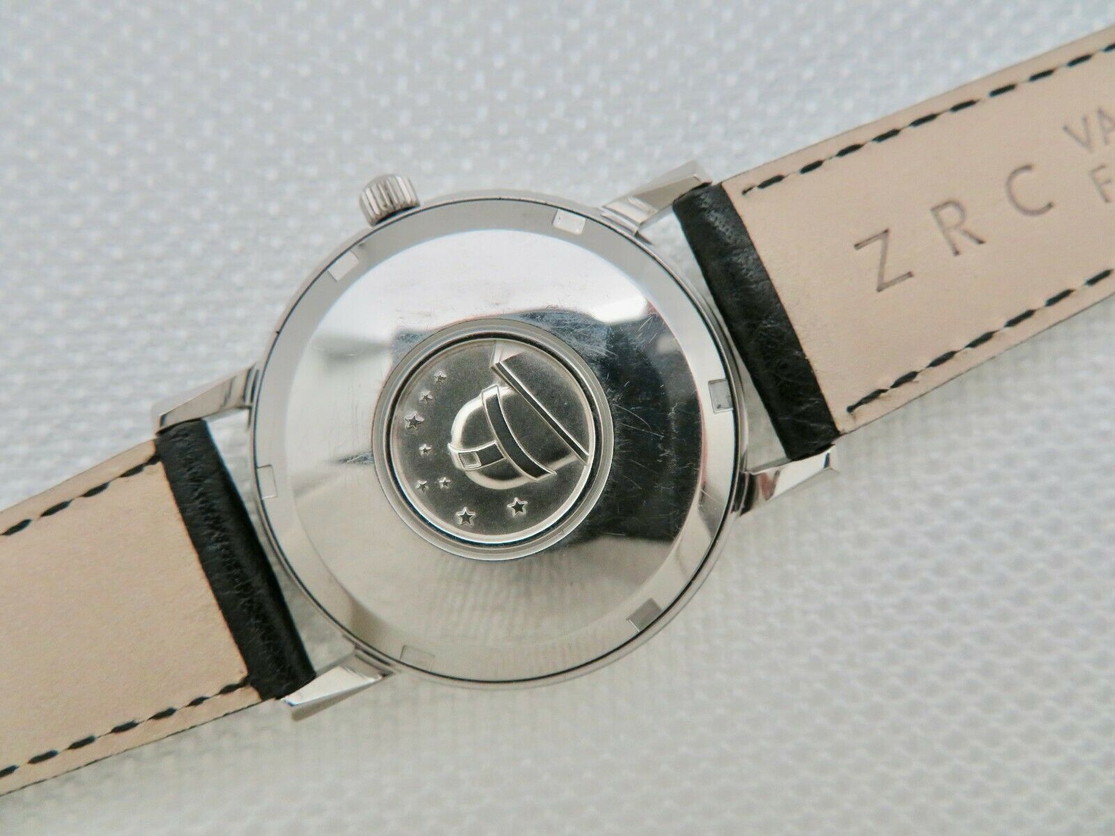

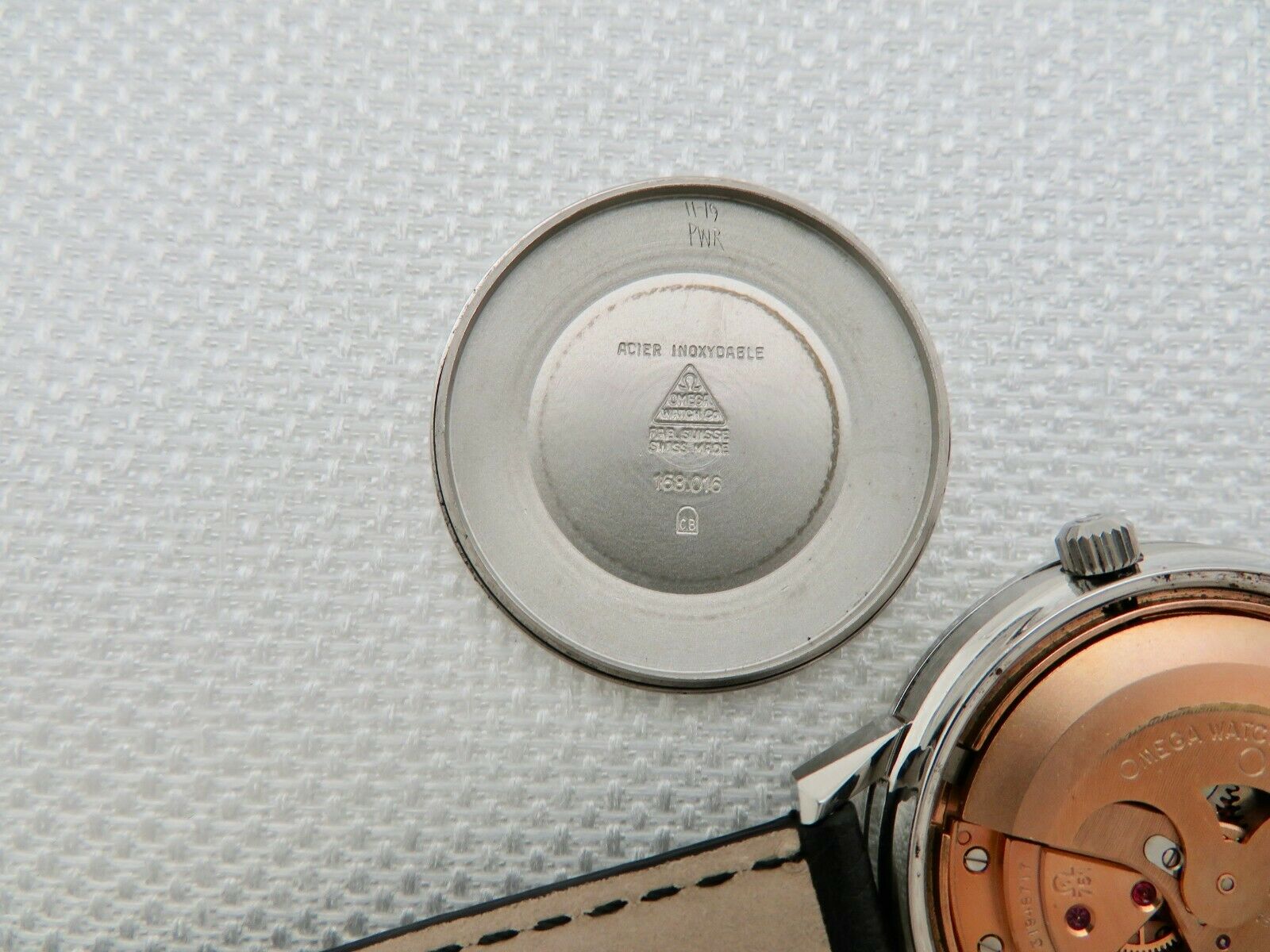

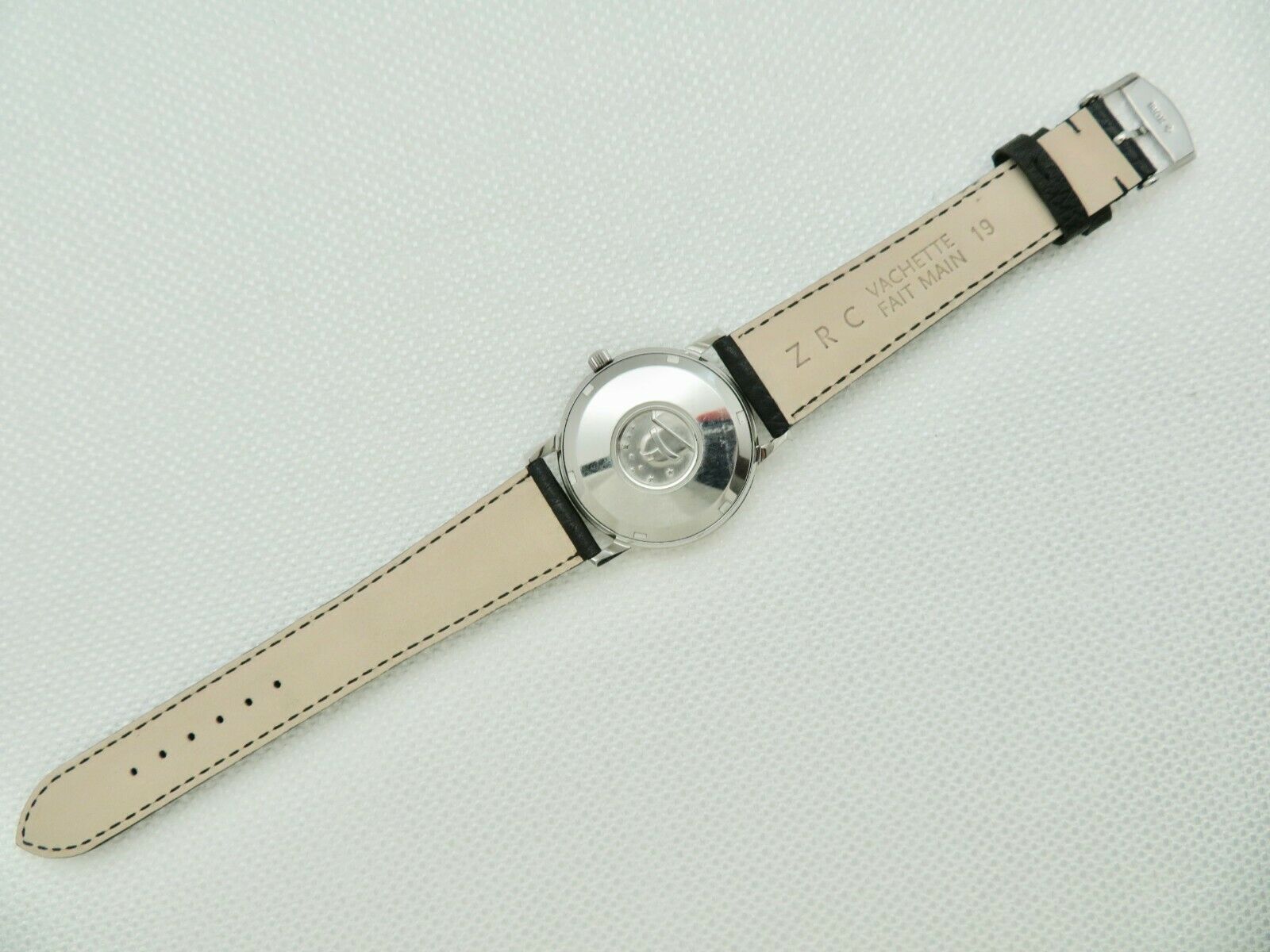

Well, I think that both dials are original and both watches look legit and quite nice, though I don't like the patina on the markers of the Connie.

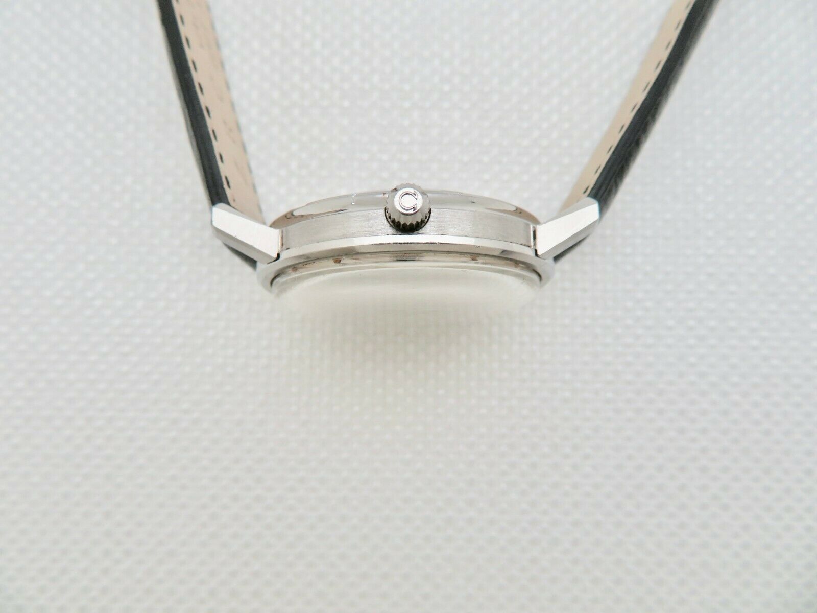

The crystal of the Geneve is genuine. The seller describes that of the Connie as original and "Omega signed", but I can't see the symbol in the center in any of the pictures, so I assume that's not correct.

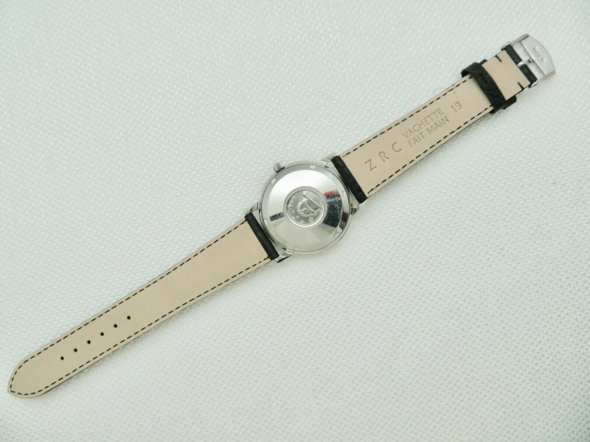

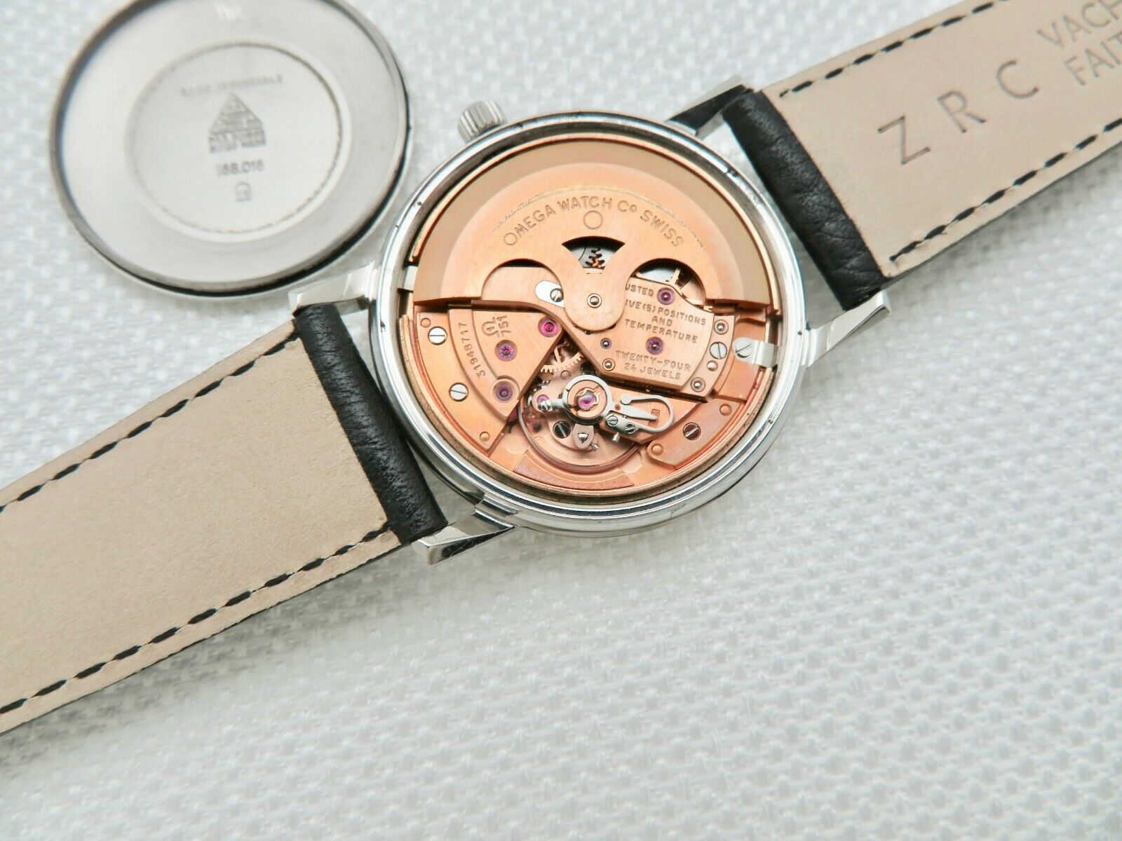

While the Connie is proclaimed to have been freshly serviced, I can see some rotor scrub? I'd check this out.

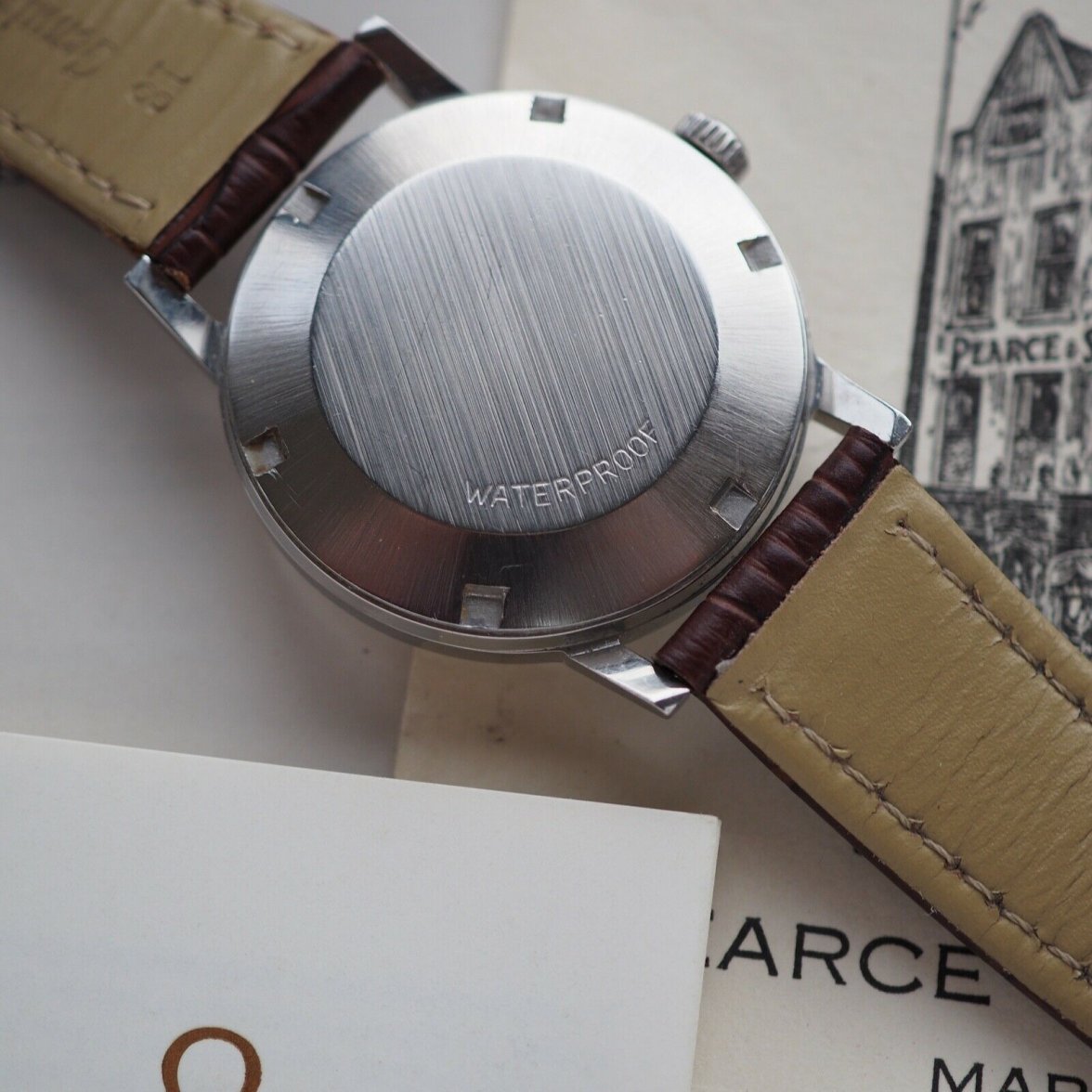

There are no movement pics of the Geneve and no service information either. You should ask for both.
If all was fine inside, I'd personally go for the Geneve, since it is in slightly better condition and comes with papers.

Entirely a matter of taste (in this case mine) but I like the slimmer case profile and clean simplicity of the Geneve dial as opposed to the (IMHO) the thicker case profile of, and clutter of the day/date window on the Constellation.

Given that both dials are original in my opinion, I do prefer the Genève, definitely don't like daydate complication on dress watches.

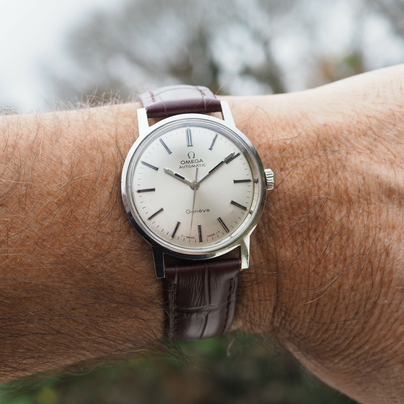

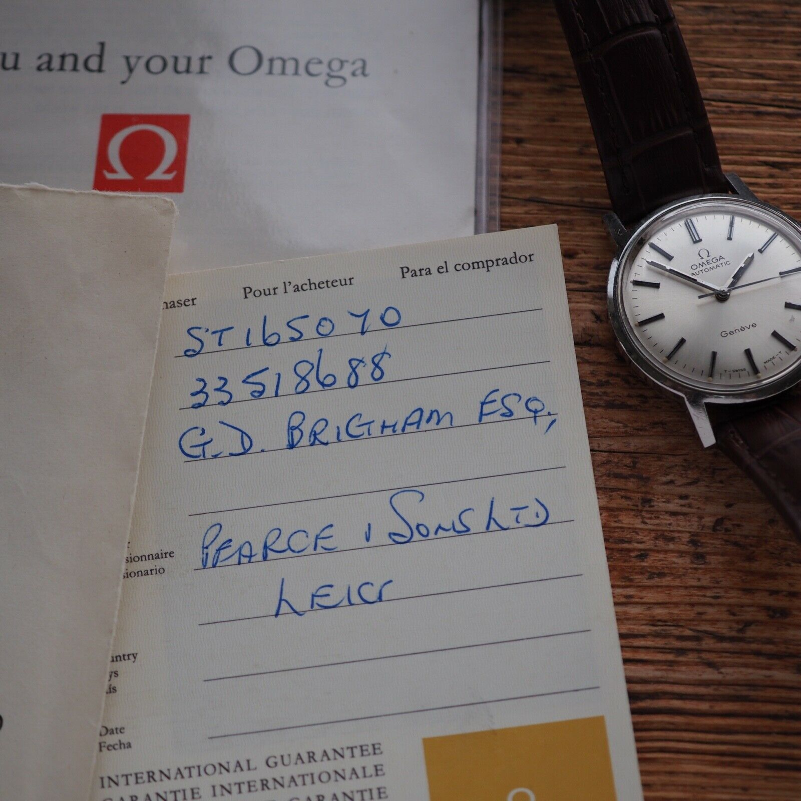

With the Geneve, is it common to have the 'Swiss Made' above the plots like this? I'm assuming it's an original dial as there are some notable contributors on the thread. Looking on other web images there are some other examples out there but not enough to suggest these aren't original either...

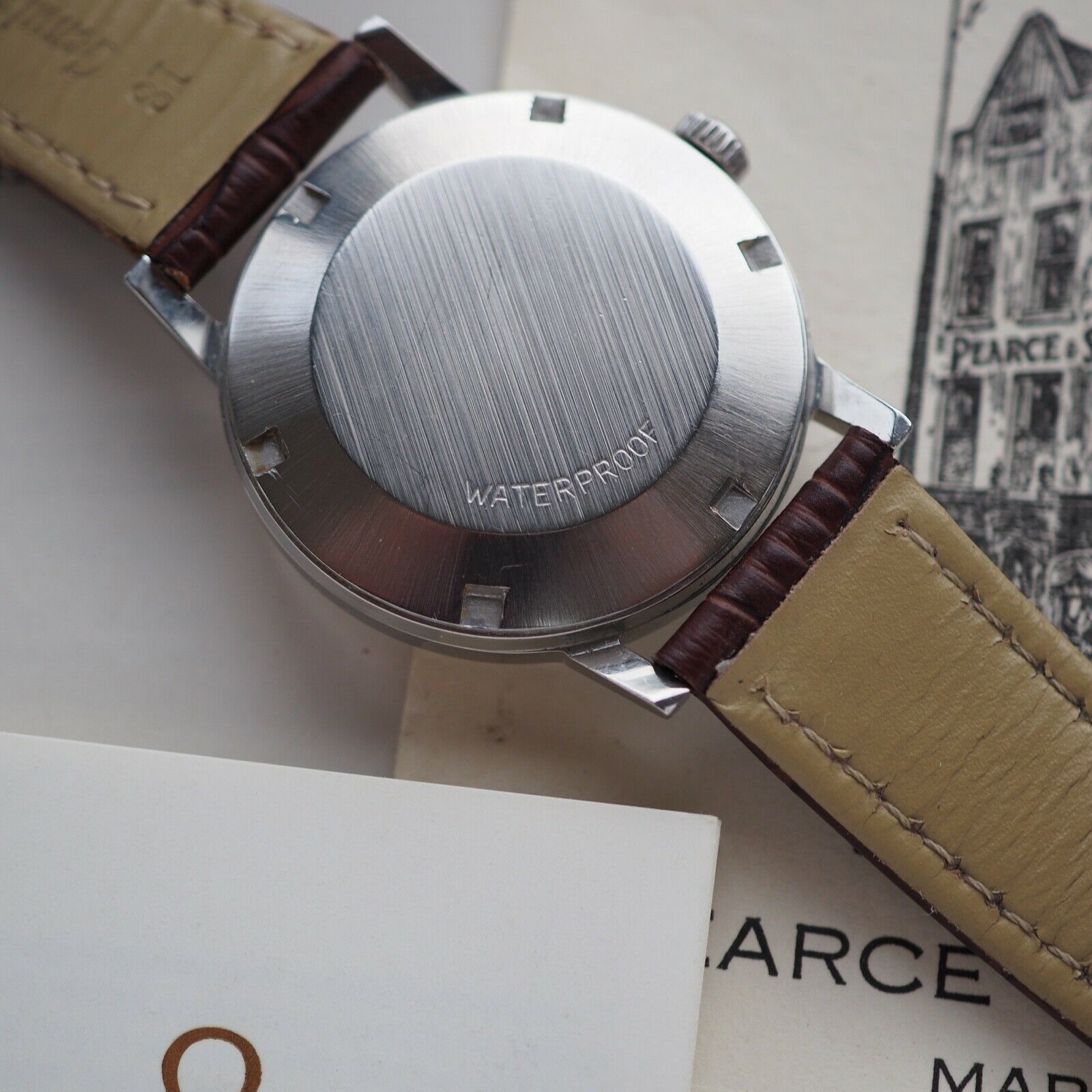

The Constellation has some condition issues on the markers, and I'm personally not a huge fan of day-date windows, but it's a more desirable reference by far, and the no-reserve auction format is appealing.
With respect to the Geneve, these later references were produced in huge numbers, and the utilitarian case design makes them less appealing to many (https://omegaforums.net/threads/omega-geneve-and-their-collectibility.105399/). In any case, there's no way I'd pay anything close to $900 USD for that watch, regardless of box and papers.
