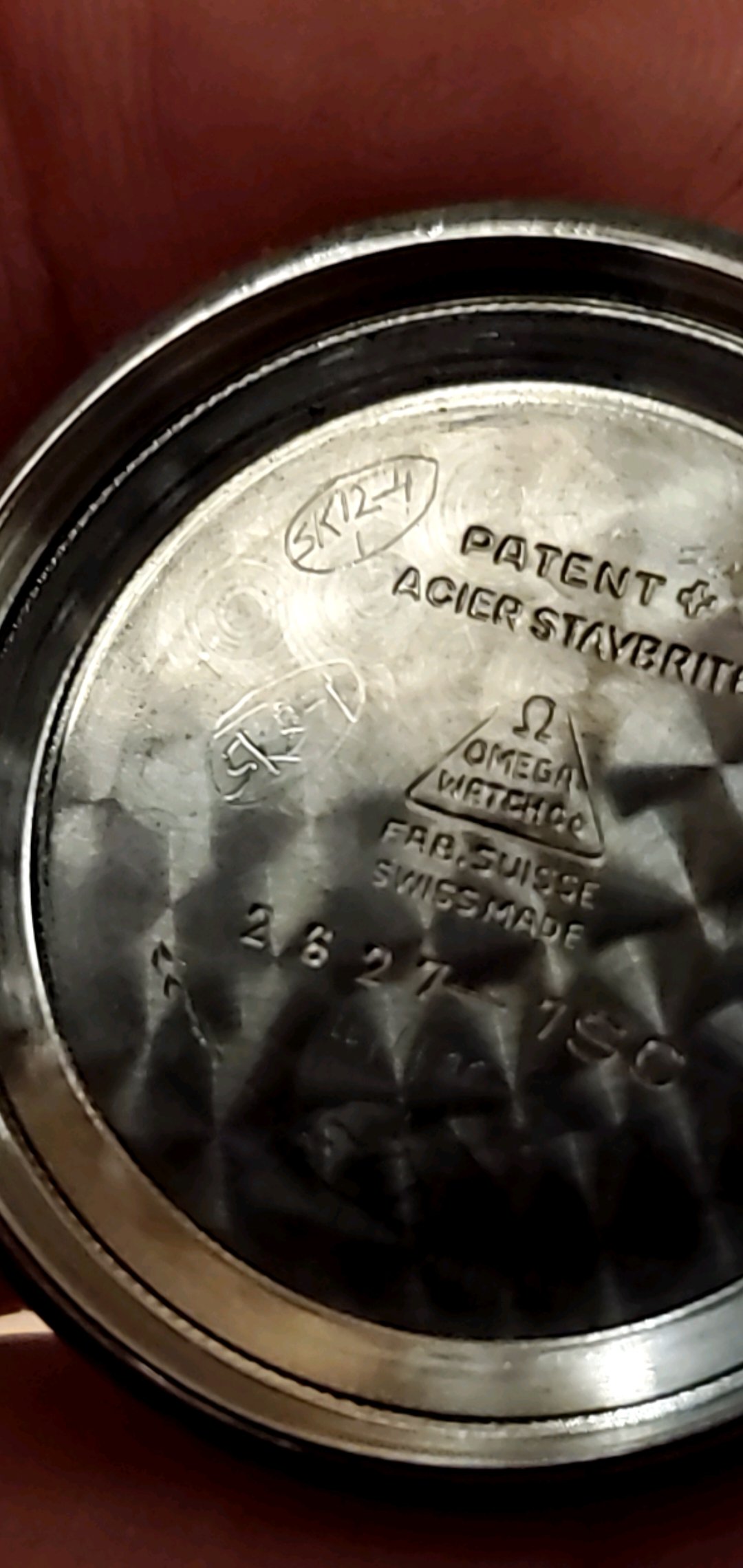

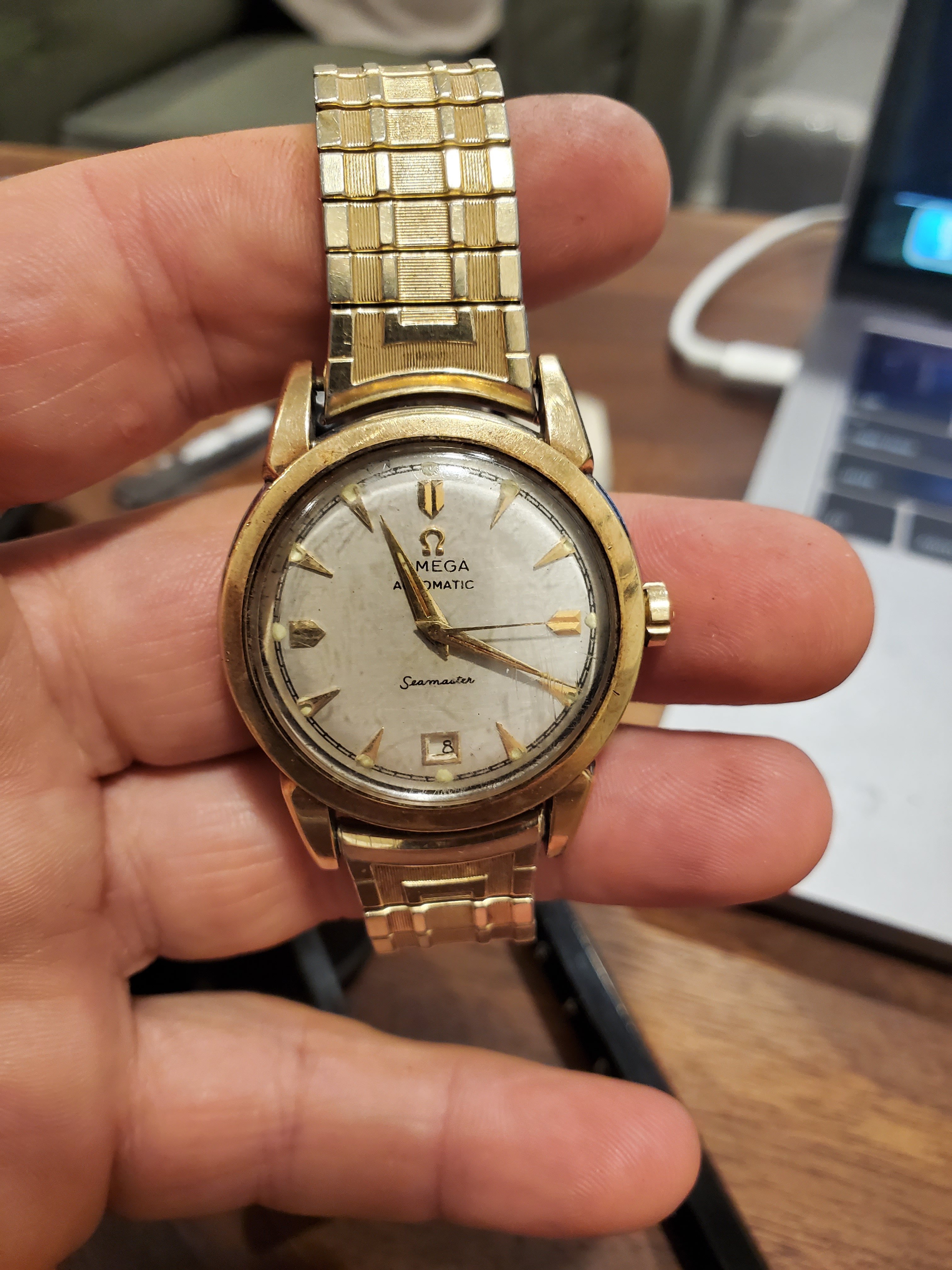

I was recently gifted my father's watch which he was given, by his father, when he graduated high school. It's a 353 bumper movement which, from what I've researched so far, was used in the early '50s (every article specifically says 1952). It's originally gold plated but heavily worn over the years so a lot of the plating around the case is gone, the bezel and tops of the lugs are still plated. It's been serviced many times early on as indicated by the markings on the underside of the case back (the last service marking year I can discern is 1977). It has an aftermarket 10k gold bracelet.
I spoke with Omega and got some advice on cleaning and getting it running well again (think it's just really gunked up as it will start and stop).
What I am looking for here are details or educated guesses on how this watch would have been OEM, band, crystal, etc. It has poorly replaced loom (which doesn't work anymore so must have been done a long time ago), and a plastic dome. I would like to get a version of the original band that could have come with it, a metal bracelet too maybe.

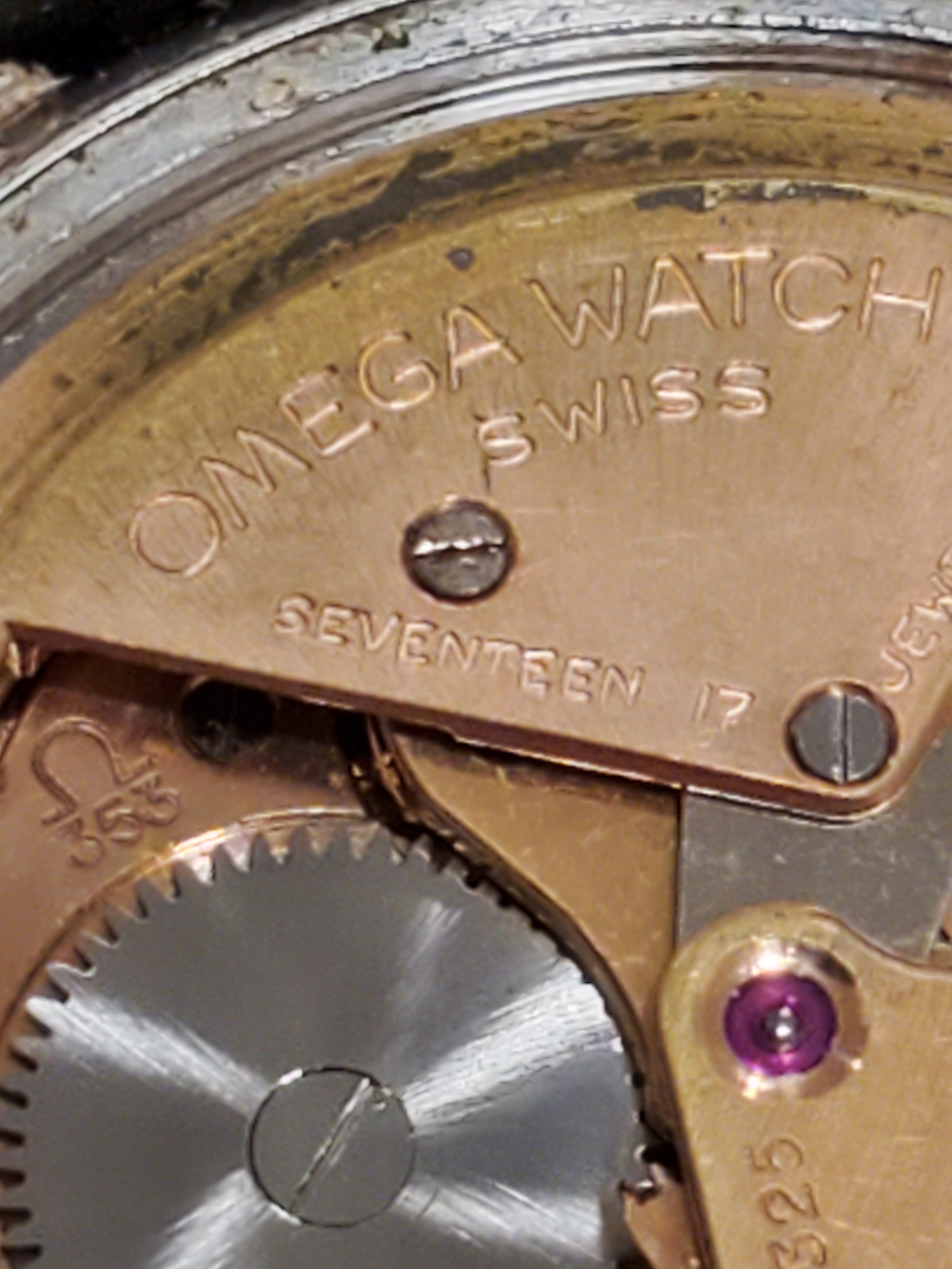

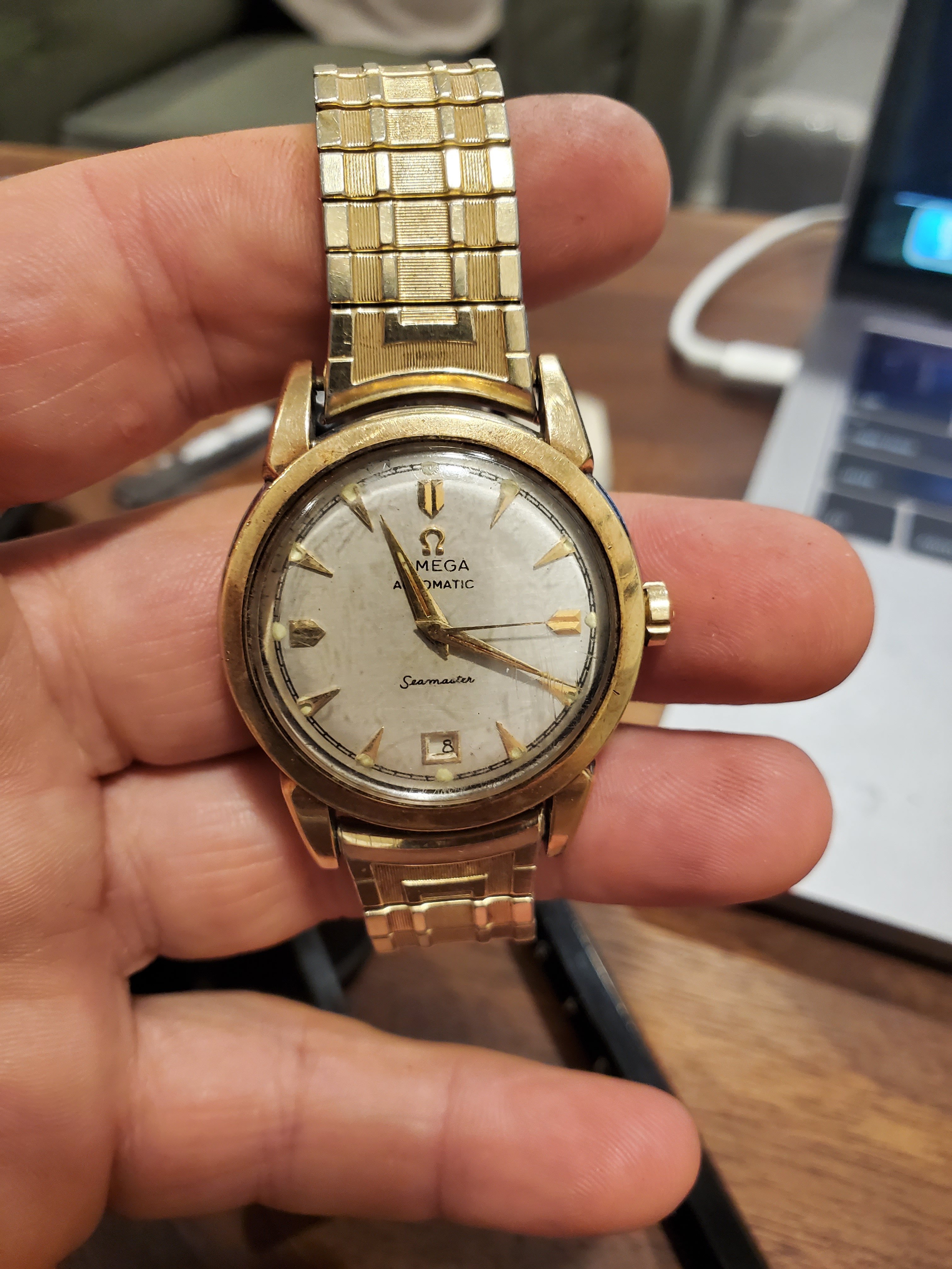

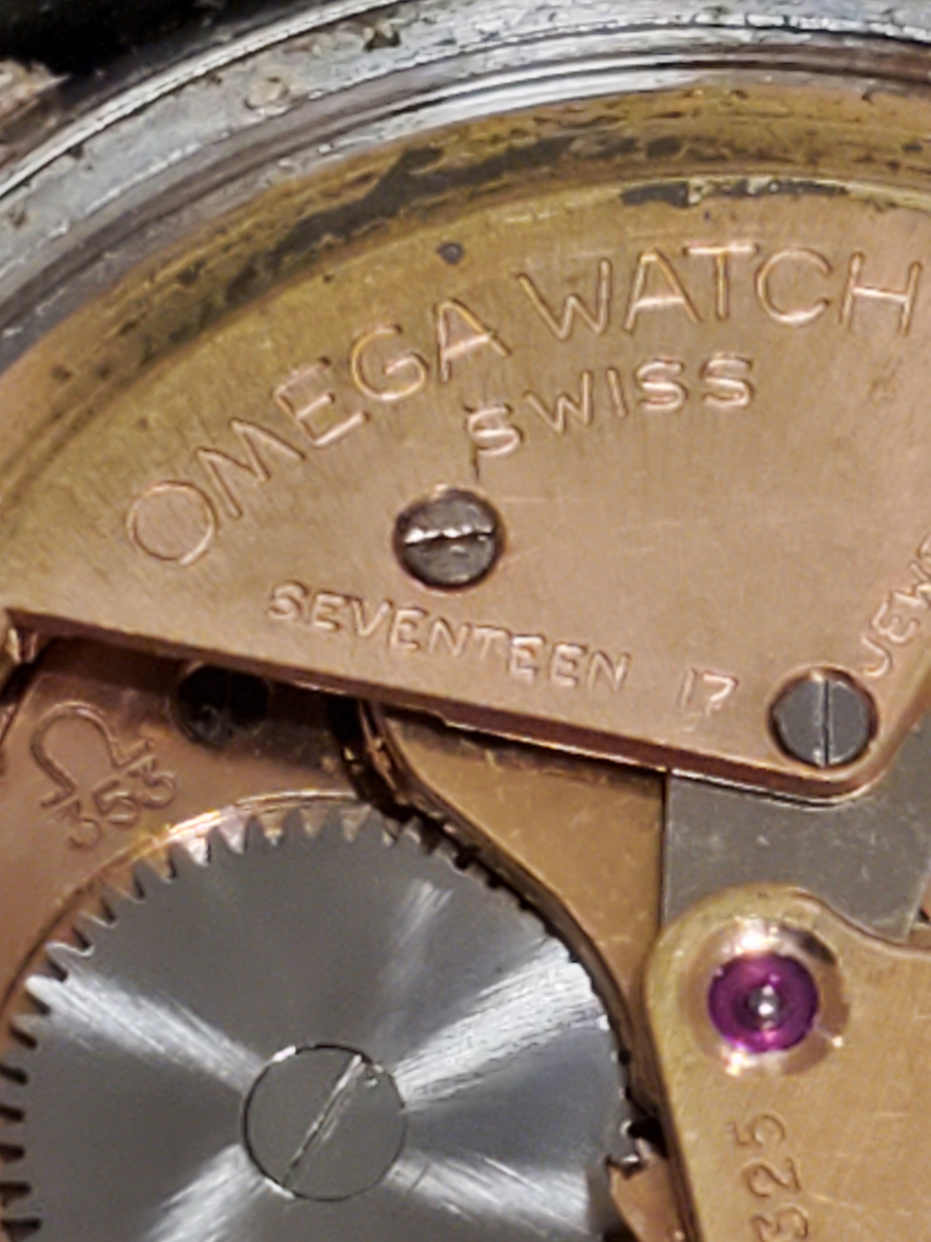

The watch face intrigues me as well. The serial number and movement all lead me to a 1952 Omega Seamaster "Calendar", but as you can see in the picture, it doesn't say "calendar" under the Seamaster text, and I haven't been able to locate images or examples of this face with this movement elsewhere.

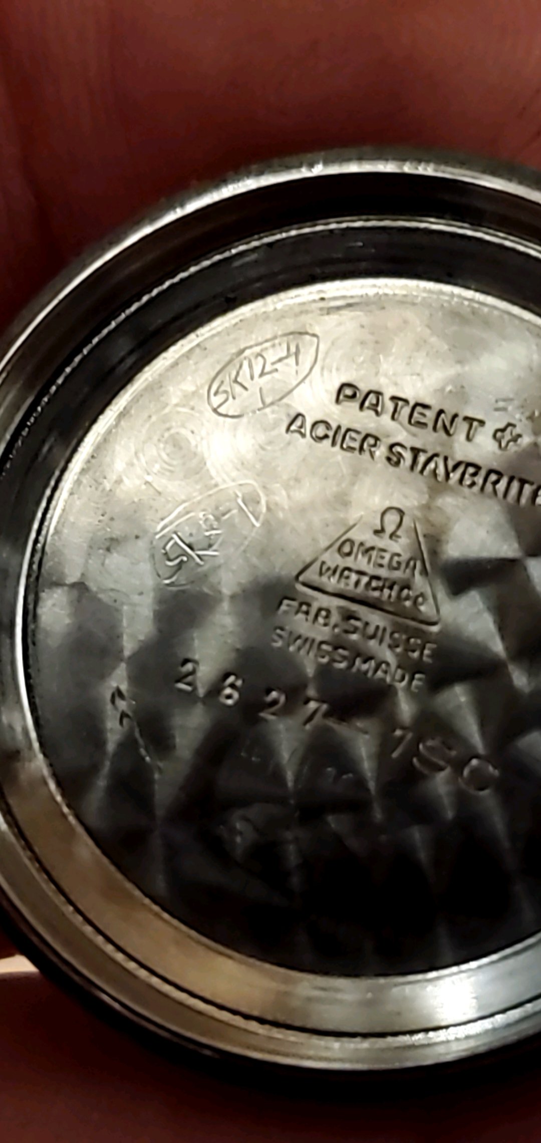

Do you have a photo from the side? There are versions of this watch on which the case is stainless steel, the bezel is solid gold, and the lugs and crown are gold capped (thicker layer of gold than plating). So the gold may not be as worn as you think. The reference number is 2627. You can research that for more information and ideas of how it looked originally. I wouldn't personally worry about the dial not being original since that's the way your dad had it for a long time. It's never going to be original again, so might as well enjoy it as he did. I think it would look best on a strap, but a gold plated 5-row beads of rice bracelet would be appropriate, too. e.g. https://omegaforums.net/threads/omega-gold-plated-beads-of-rice-bor-bracelet-great-condition-250€.155625/

Not all versions of this watch had “Seamaster Calendar” on the dial:
This was common, particularly in the U.S., until the mid-1950’s.
Also, your watch is gold-capped, not plated. It never had gold underneath the lugs or on the back. The gold on the front is very thick. Around 1/4 mm, or 250 microns. The process to make these is very similar to how the planchets for US dimes are made.

Without meaning to be rude, what makes it unique is that the dial has been repainted, it may well have had Calendar on there originally, or may not, but there is no way to tell. This is how it looked for most of its useful life however which is what really matters with an heirloom. As already noted, the 353 movement was in fact in fitted for several years, if you want a second opinion on the age, post the start of the serial number, 3 digits should be enough, though there is in fact no downside to posting or showing the whole number.

All the info I looked up for the 353 movement, connects it only to the year 1952. https://www.omegawatches.com/vintage-watches?v_watches_calibre=3017
Then I looked up how to read the serial number, it starts with 1301, and each site I see shows that the serial number is only associated (assuming by manufacturing date) to 1952. Assuming they used the movement in watches for maybe another year, but the year it is registered to seems to be 1952. Most of the information I have been seeing for the 353 (before all of the help I'm getting here) is just a spec line for a vintage watch description. There seems to be much more for the 355 than the 353.
The number 13013325.

I can tell the lume has been (poorly) reapplied at some point (and needs to be replaced again). Super interested, how can you tell the dial has been repainted?

Sloppy printing and incorrect fonts. No question about it, the dial was poorly repainted a long time ago. We see this all the time.

Have you compared it to other photos of this reference, it's very clearly way off as in completely wrong.
