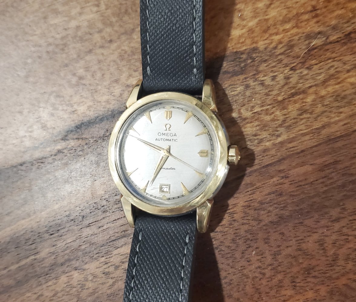

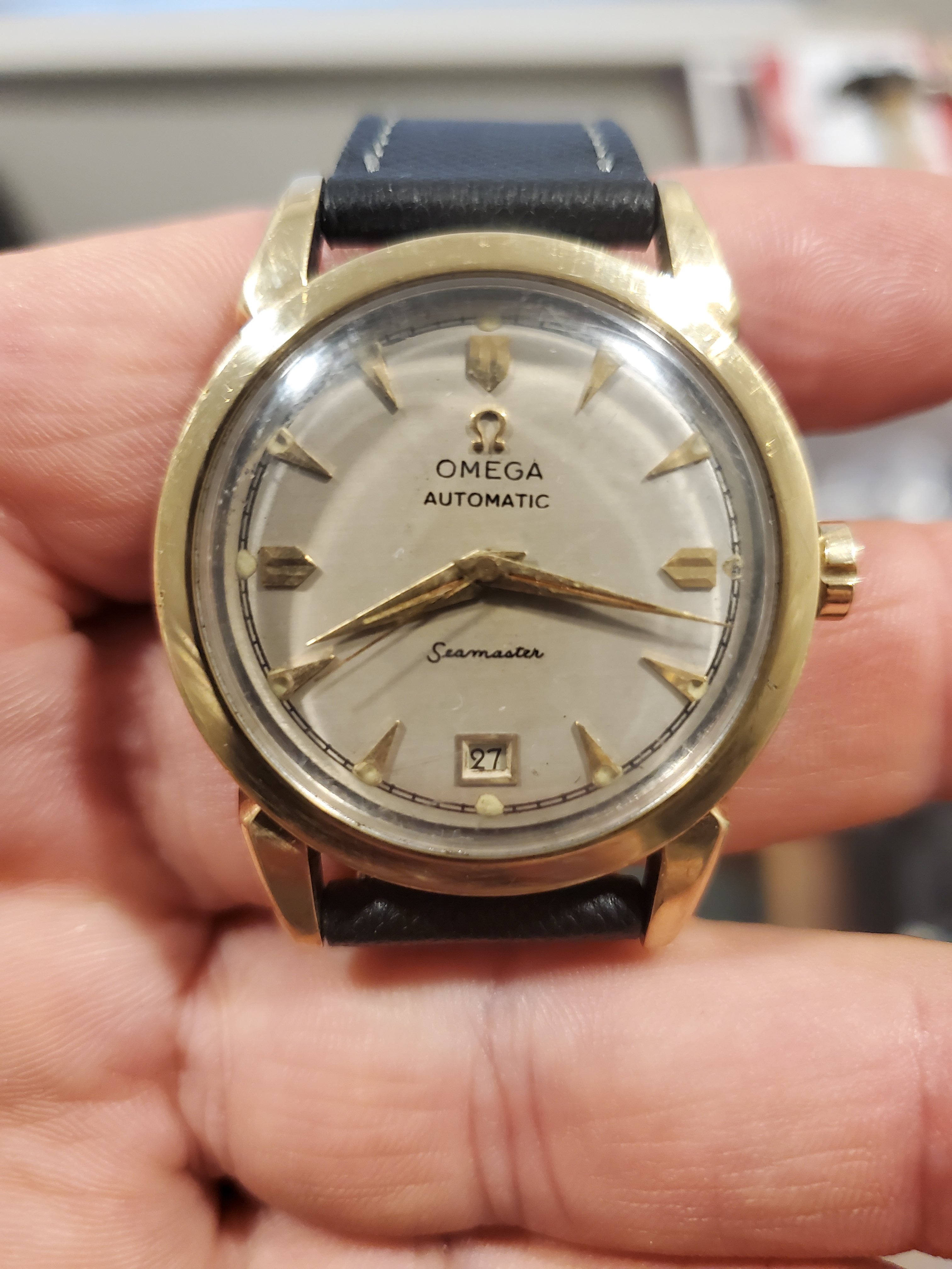

Looking for details on a vintage omega seamaster watch
14
4

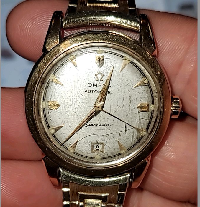

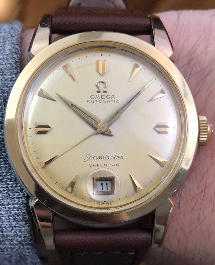

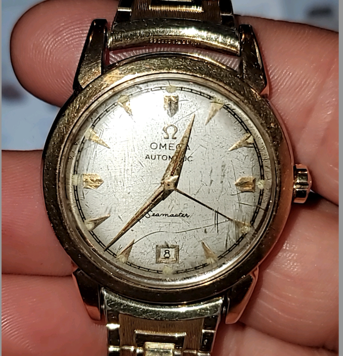

Have you compared it to other photos of this reference, it's very clearly way off as in completely wrong.
I did notice the numbers for the date wheel are an "interesting" font lol.
24,838
55,263

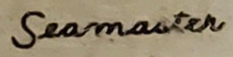

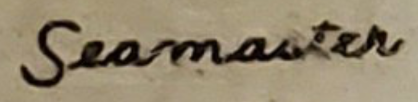

We are referring to the printing on the dial, e.g. OMEGA and Seamaster. They are poor representations of the original. I know that it may not seem that way to you, but when you have looked at thousands of these dials, it immediately jumps out at you.
13,495
31,815
If they'd looked at even a dozen it should do it, this one is so bad.

@Dan S @X350 XJR

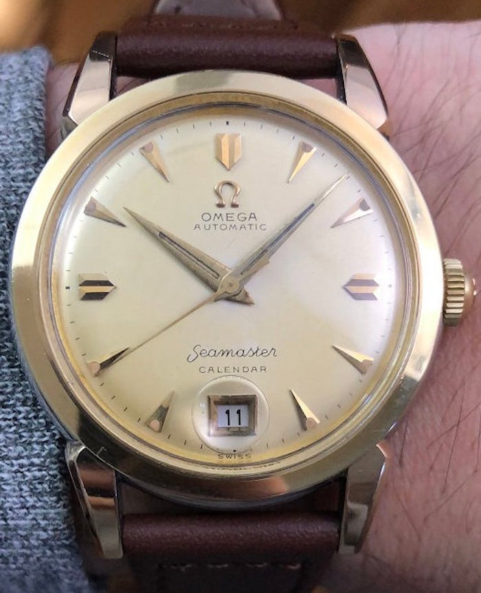

Can you share a good/original example for me to compare? See what you are seeing? (I could look at examples but not know what it good and what is bad).

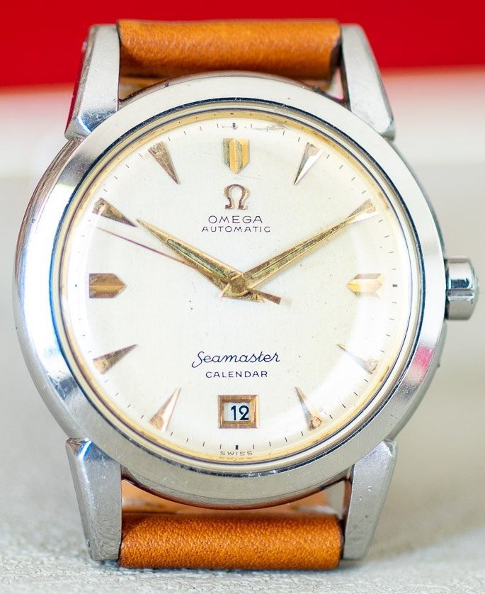

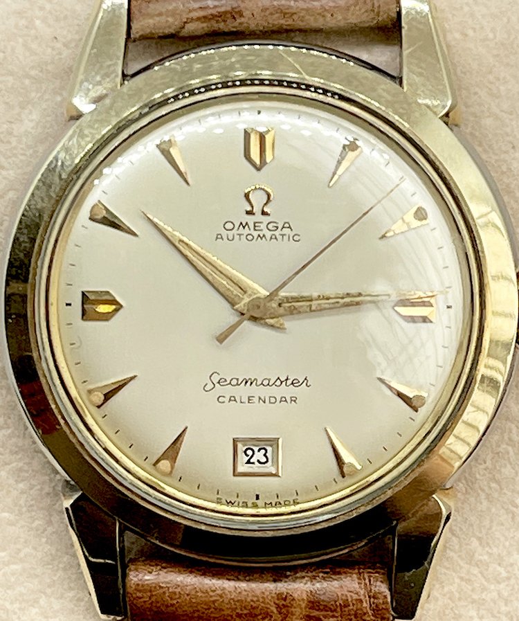

631
788

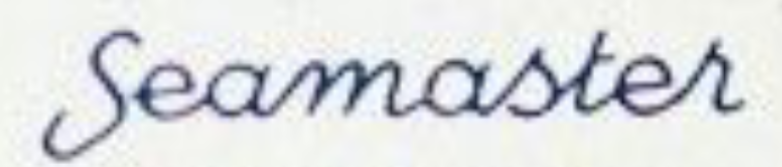

You'll see slight variations (even in the three nice ones pictured above), but not too much in these early Seamasters. The fonts do change more over the years, though.

I do like the current face of my father's watch, but am curious what a replacement would cost. I have been scouring the internet but not finding options for the same design. Would any of you be able to suggest a website or connection that might have a possible replacement?
13,495
31,815
Watch eBay for a loose dial or a movement with a dial or a complete watch with a bad case. New dials are pretty much nonexistent and have been for decades.
What elements of the design are you not finding?
3,681
8,015
The more you change it, the less it is your fathers watch. You cannot add value. I would just have it serviced so its wearable, and put on new strap (forget about finding original strap- have you ever seen/smelled 70 year old leather?). Polish or replace crystal finding original is not important. Thats what I would do. Enjoy it

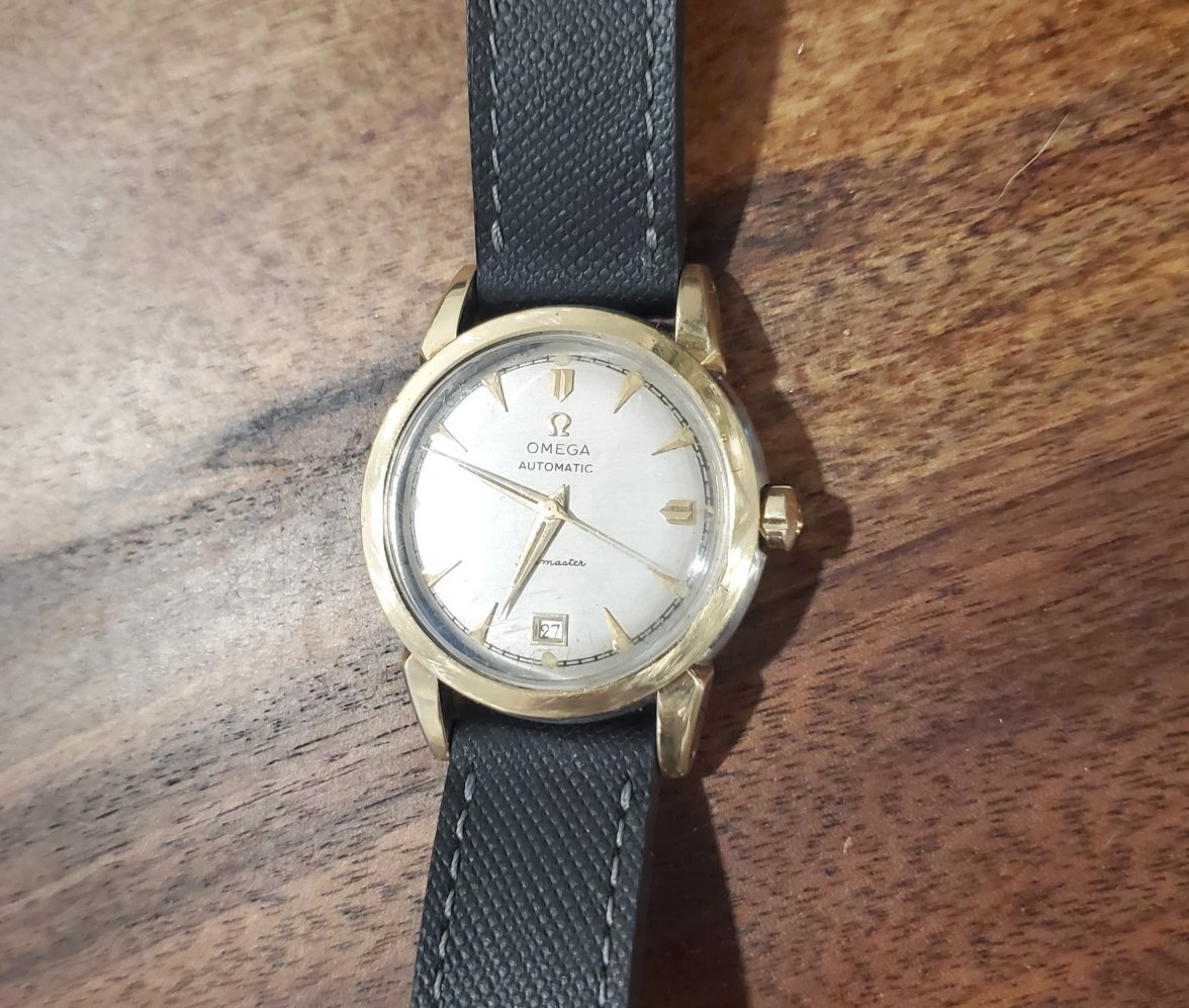

Thanks, good advice. Not looking to add value, never selling it, its an heirloom. Just researching the possibility of getting parts to revitalize the watch closer to how it was when he first got it back in the late 50's. Thinking it might be a good memory of when his father gave it to him. Not die-hard on this pursuit, just exploring the idea. Did get a cool new black leather band that goes great with it, and already polished the plastic and all the gold, lightly buffed, just enough to give some shine but not remove its character and wear.
3,681
8,015
Sounds good show us the cleaned up photos

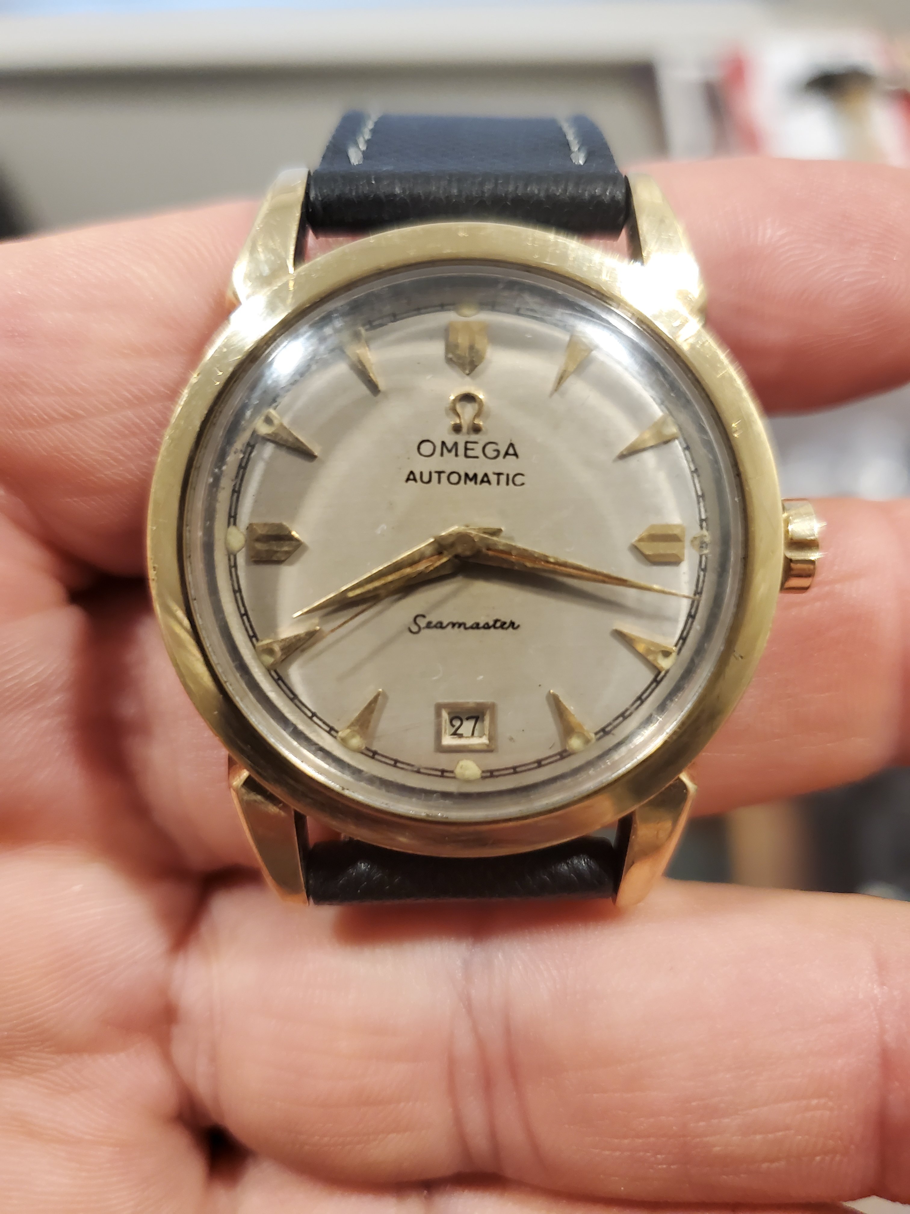

All the info I looked up for the 353 movement, connects it only to the year 1952. https://www.omegawatches.com/vintage-watches?v_watches_calibre=3017
Then I looked up how to read the serial number, it starts with 1301, and each site I see shows that the serial number is only associated (assuming by manufacturing date) to 1952. Assuming they used the movement in watches for maybe another year, but the year it is registered to seems to be 1952. Most of the information I have been seeing for the 353 (before all of the help I'm getting here) is just a spec line for a vintage watch description. There seems to be much more for the 355 than the 353.
353 is a specific watch caliber, or movement designation, not a vintage watch description. It was used in many different watch references.
The information I've found suggests that the cal 353 was used from approximately 1949-1953. However, the 13.01M serial number on the movement does correspond to 1952, most likely.
