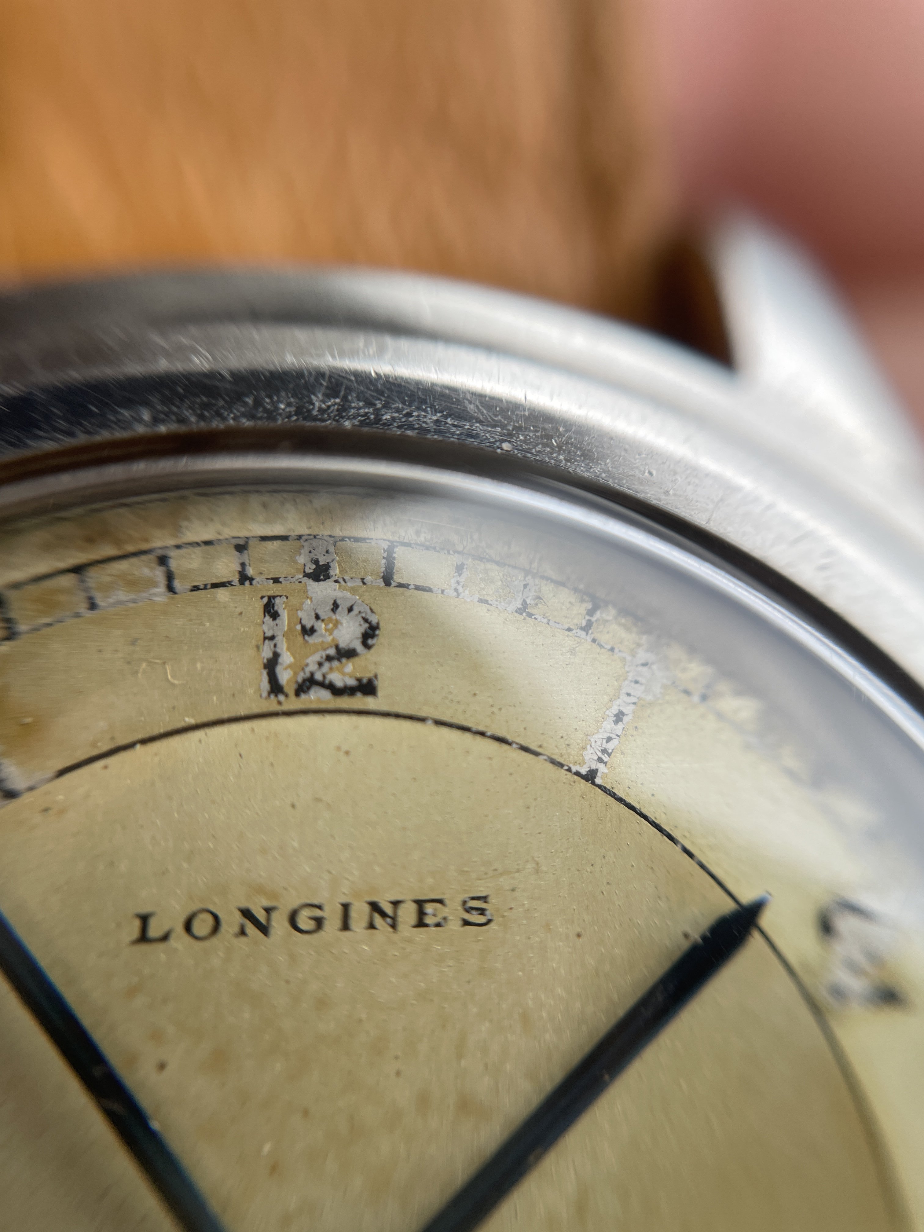

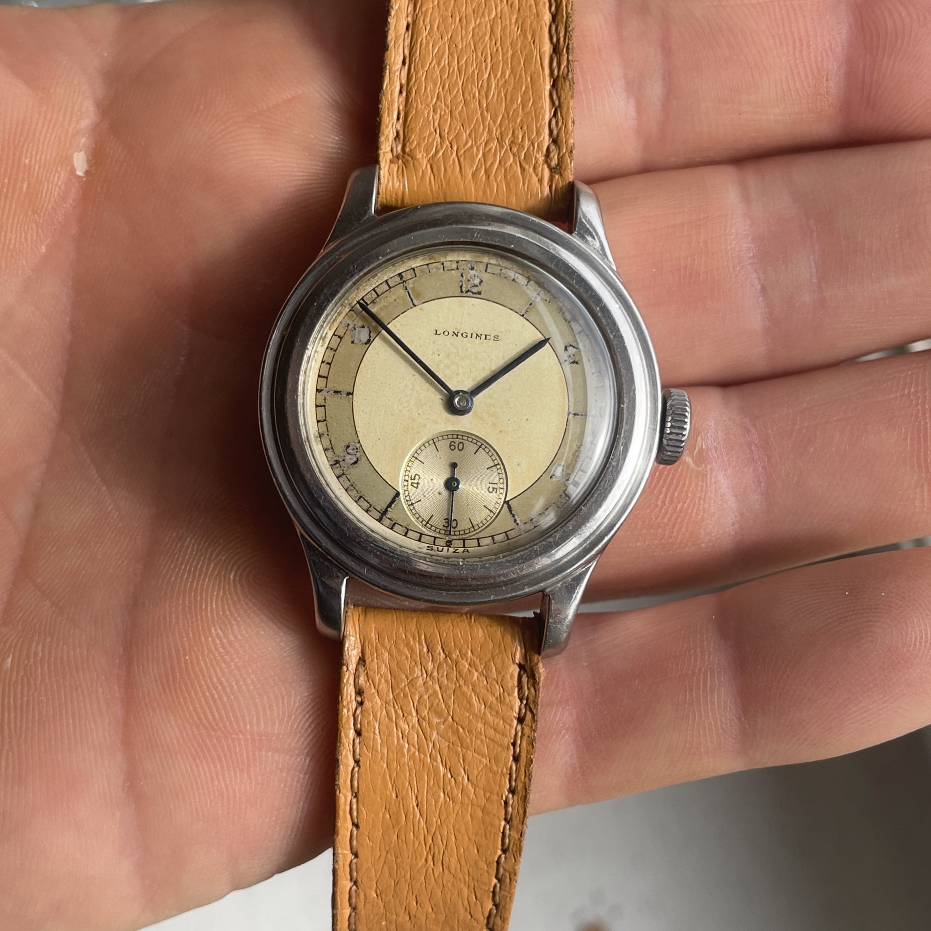

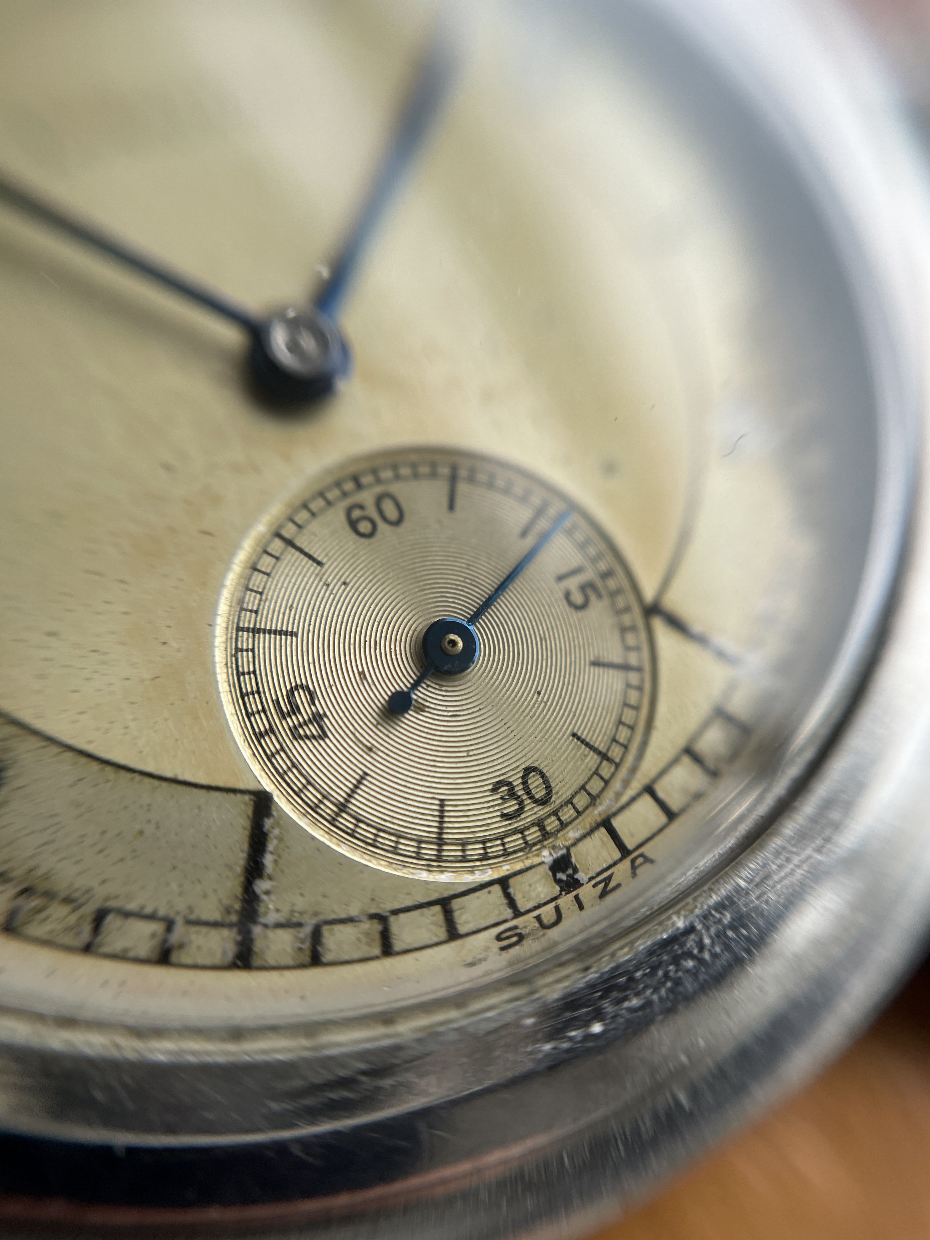

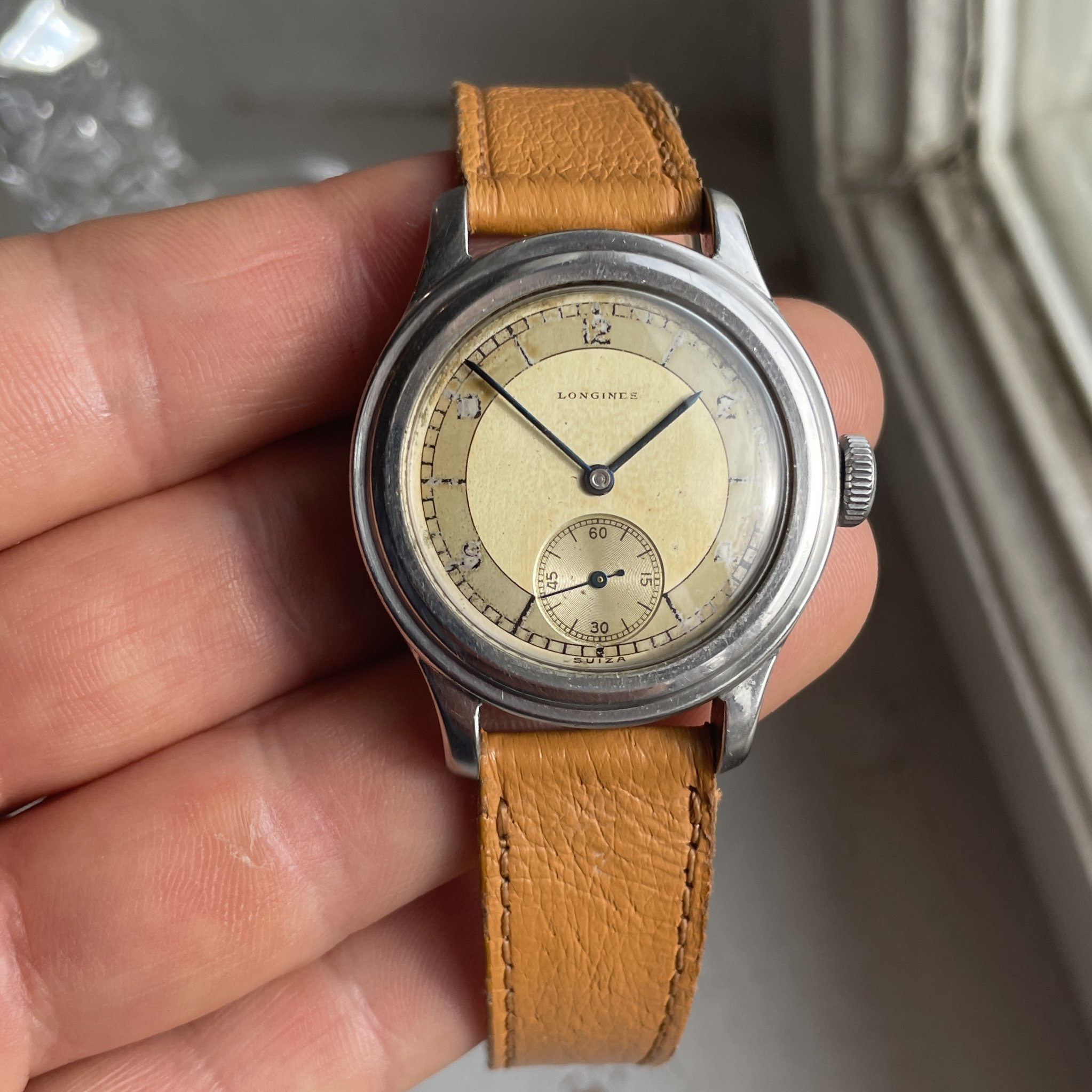

In terms of finding photos of examples, it depends on the thing I am looking for. In many cases, I will search the internet as certain websites serve as useful archives. For other things (e.g. unusual examples), I do have various folders with photos that I have saved.
Good observation, regarding the "s" in Longines! I would guess that it was a batch with flawed printing.
P.S. Have you measured the diameter of this dial? Also, did it come with a movement?
Yes, the diameter is around 27.5mm

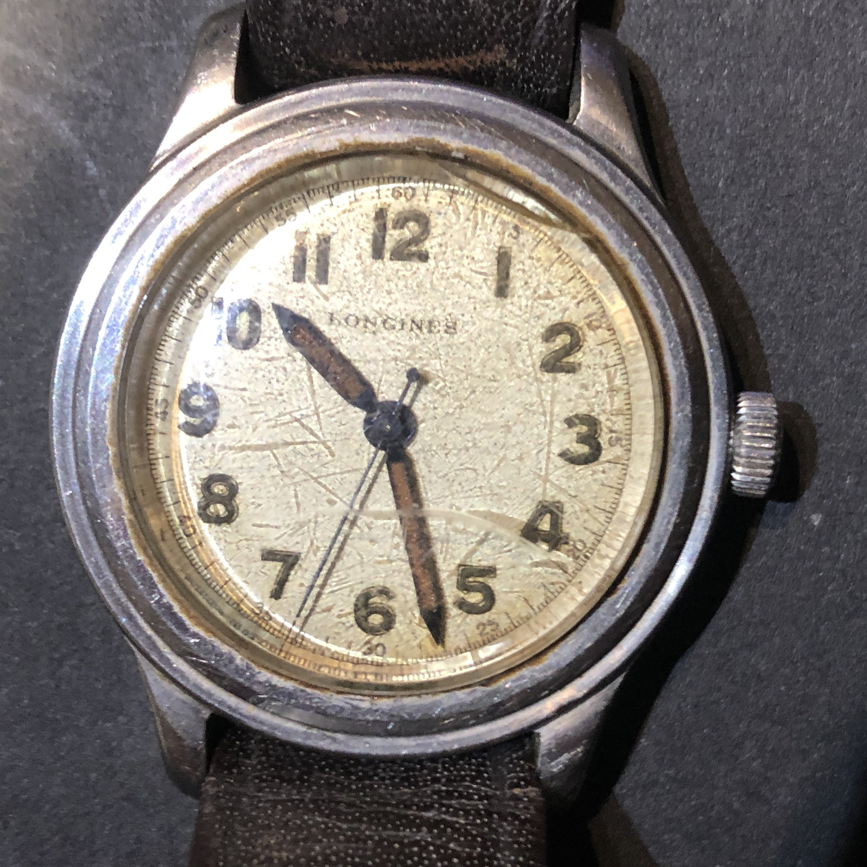

Yes you are right that it looks like the same dial in both of these, so probably the seller have swapped the dials since he is clearly stating it is different watches (with different ref numbers and origin country). Looks like the second one have different or relumed hands as well? Or is it just the different lighting?
I specifically asked Longines when asking for an extract of mine and got this answer:
"I'm sorry to inform you that we don't provide any information on the dial. Regarding your second request, we only provide historical information kept in our archives on the basis of the serial number that is engraved on the watch.
In our registers, the original serial number 6'461'428 identifies a wristwatch in stainless steel bearing the order number 22243 and the reference 4142. It is fitted with a Longines manually wound mechanical movement, caliber 12.68N."
So unfortunately Longines don't seem to provide any more information regarding the dial.

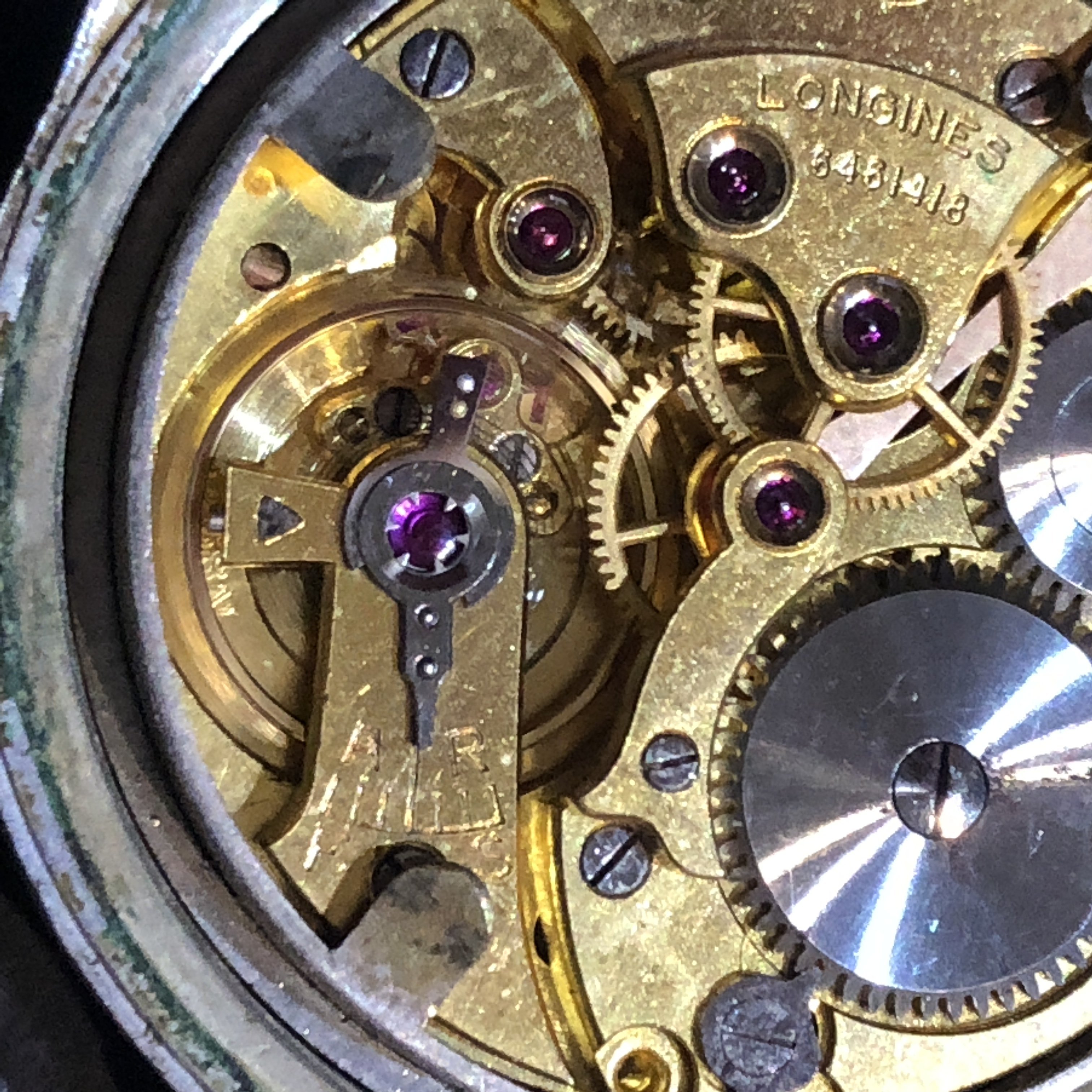

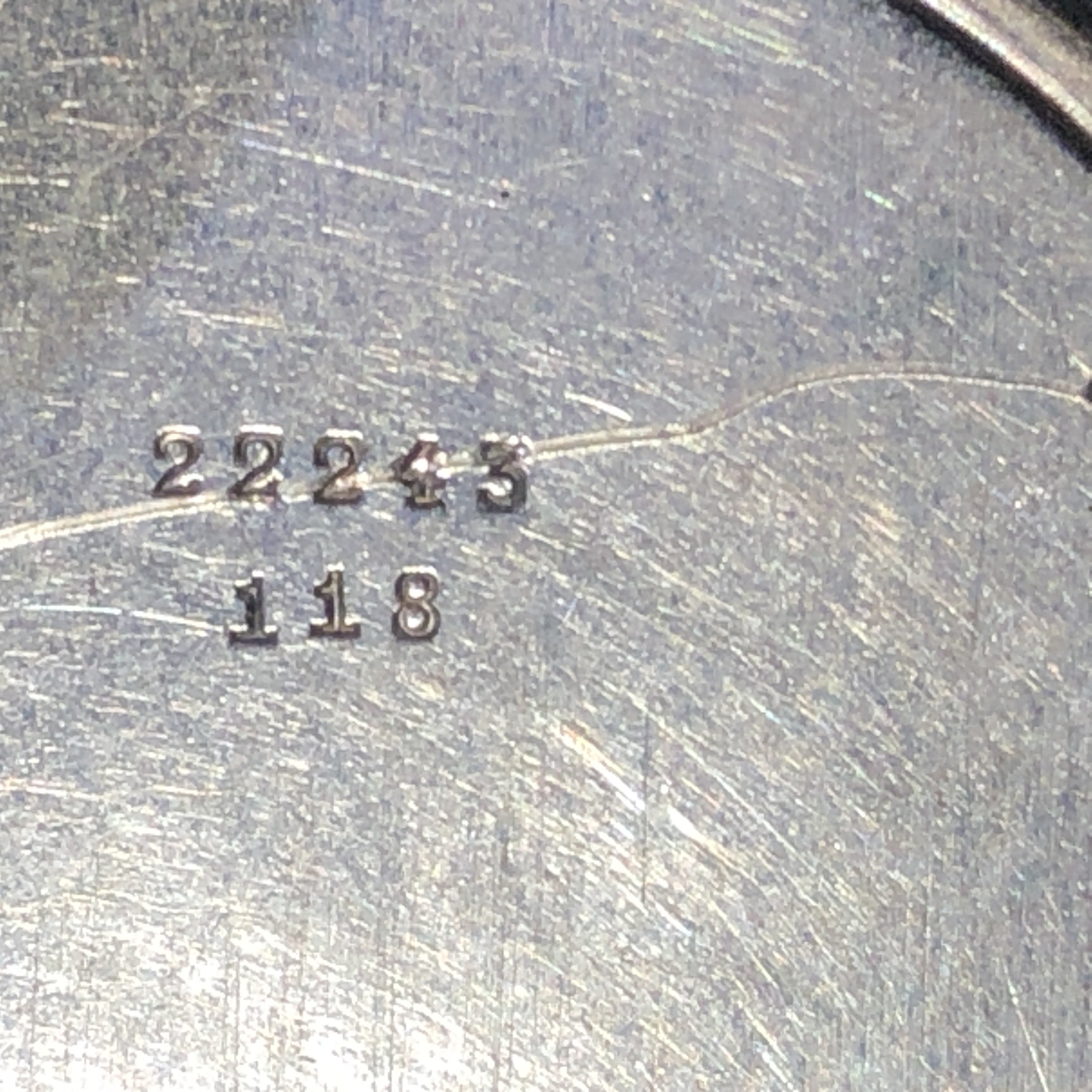

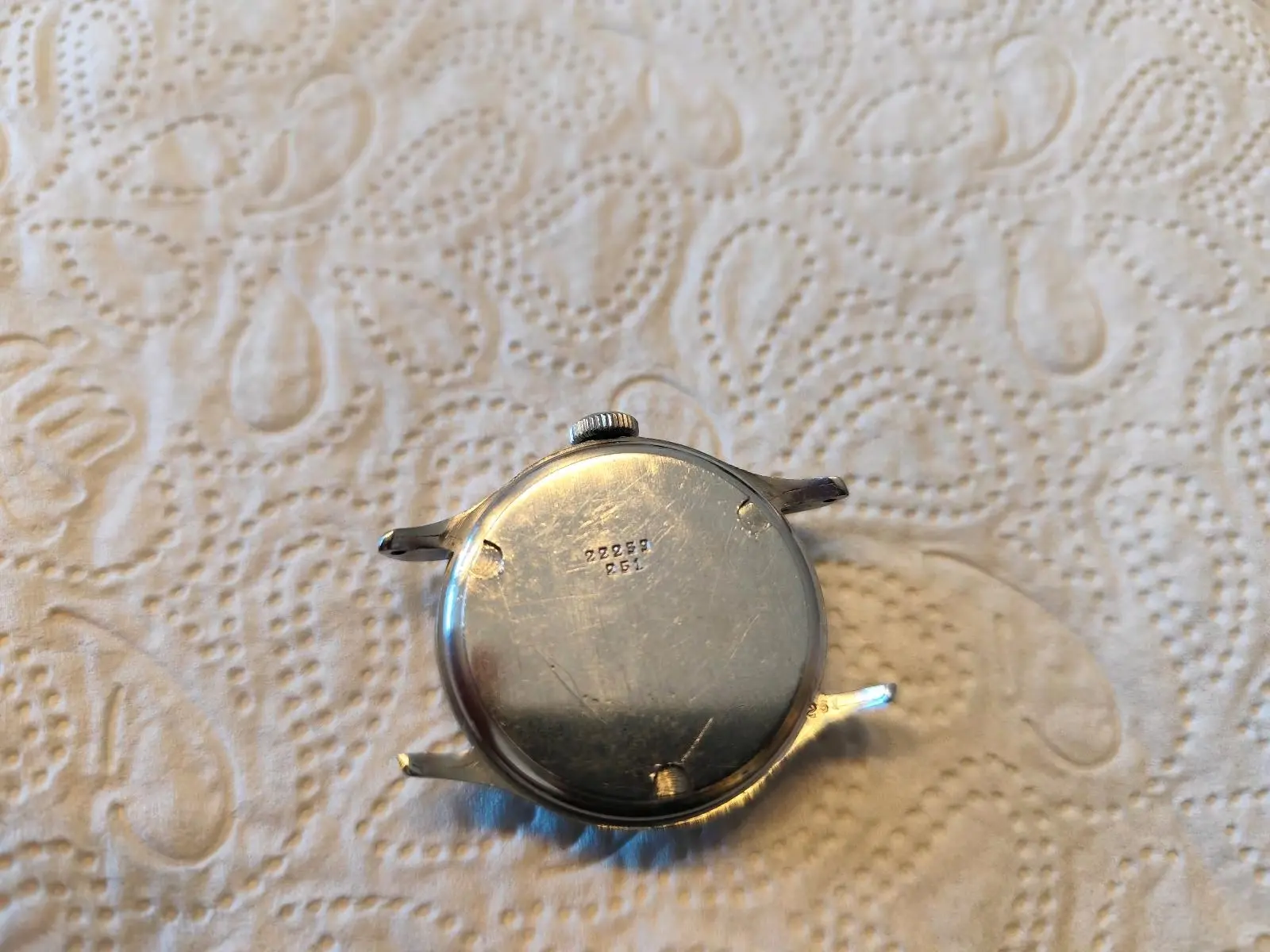

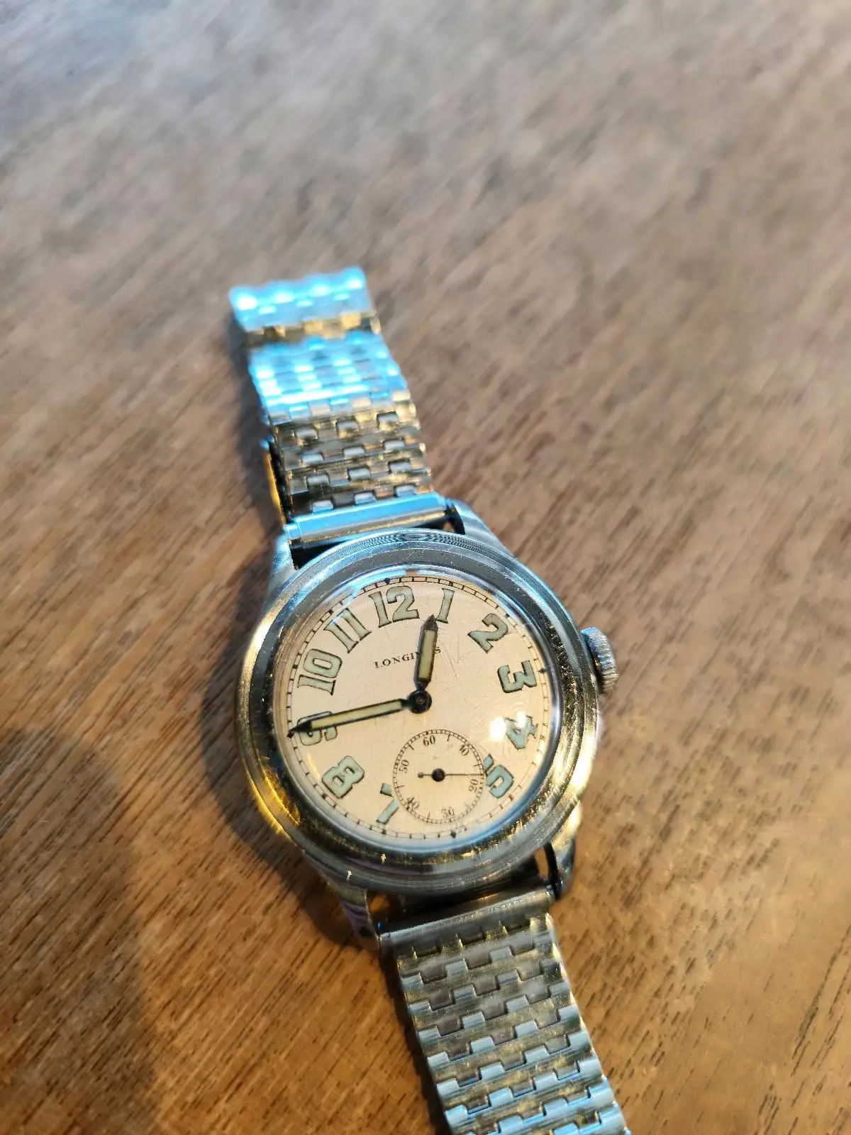

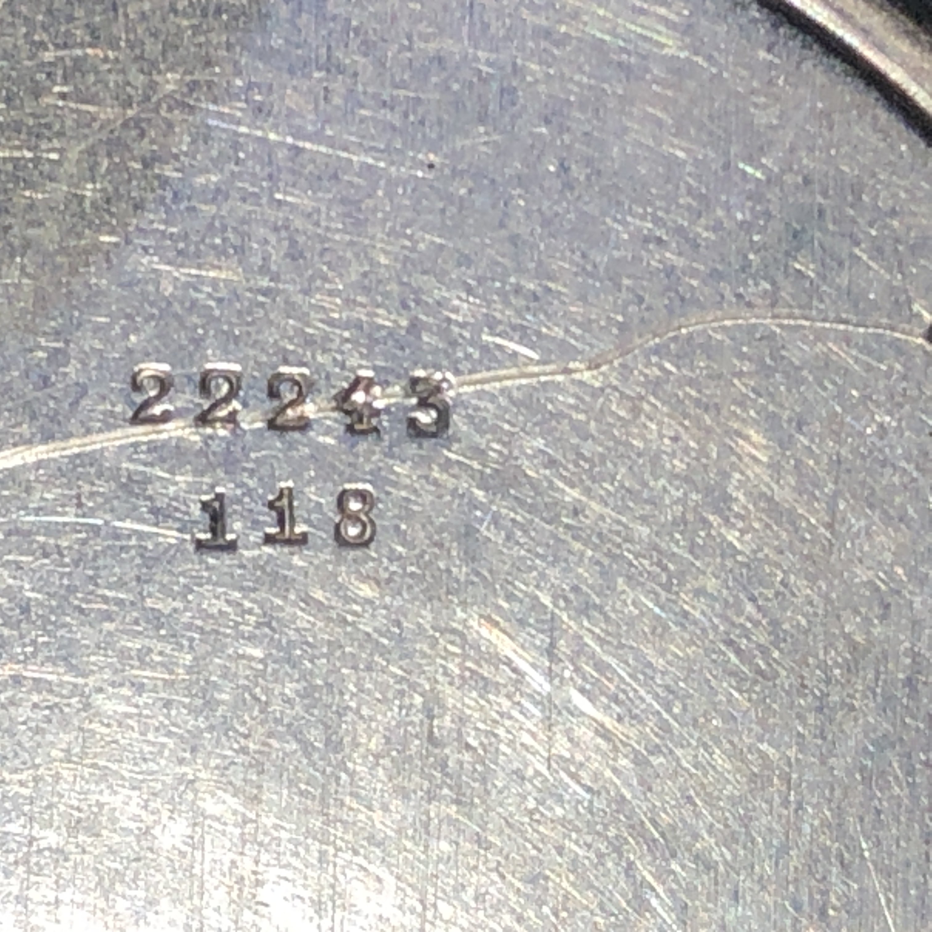

Howdy,
I have original serial number 6'461'418 which is a wristwatch in stainless steel bearing the order number 22243 and the reference 118.
2,829
4,948
Howdy,
Wow, such a close serial number! Thank you for sharing photos. Your watch looks very original, to me. I would guess that @hejsam's example looked quite similar when new.

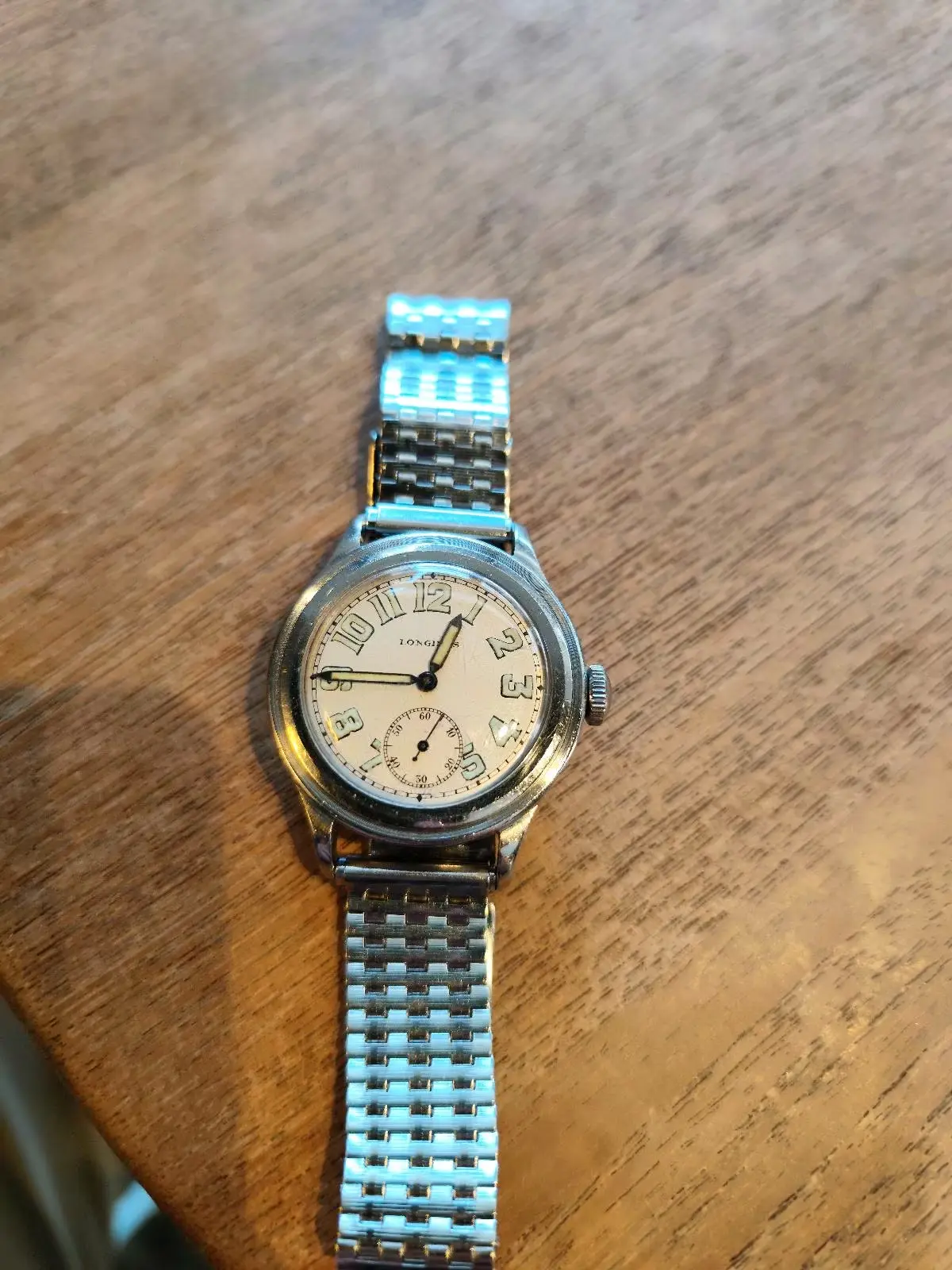

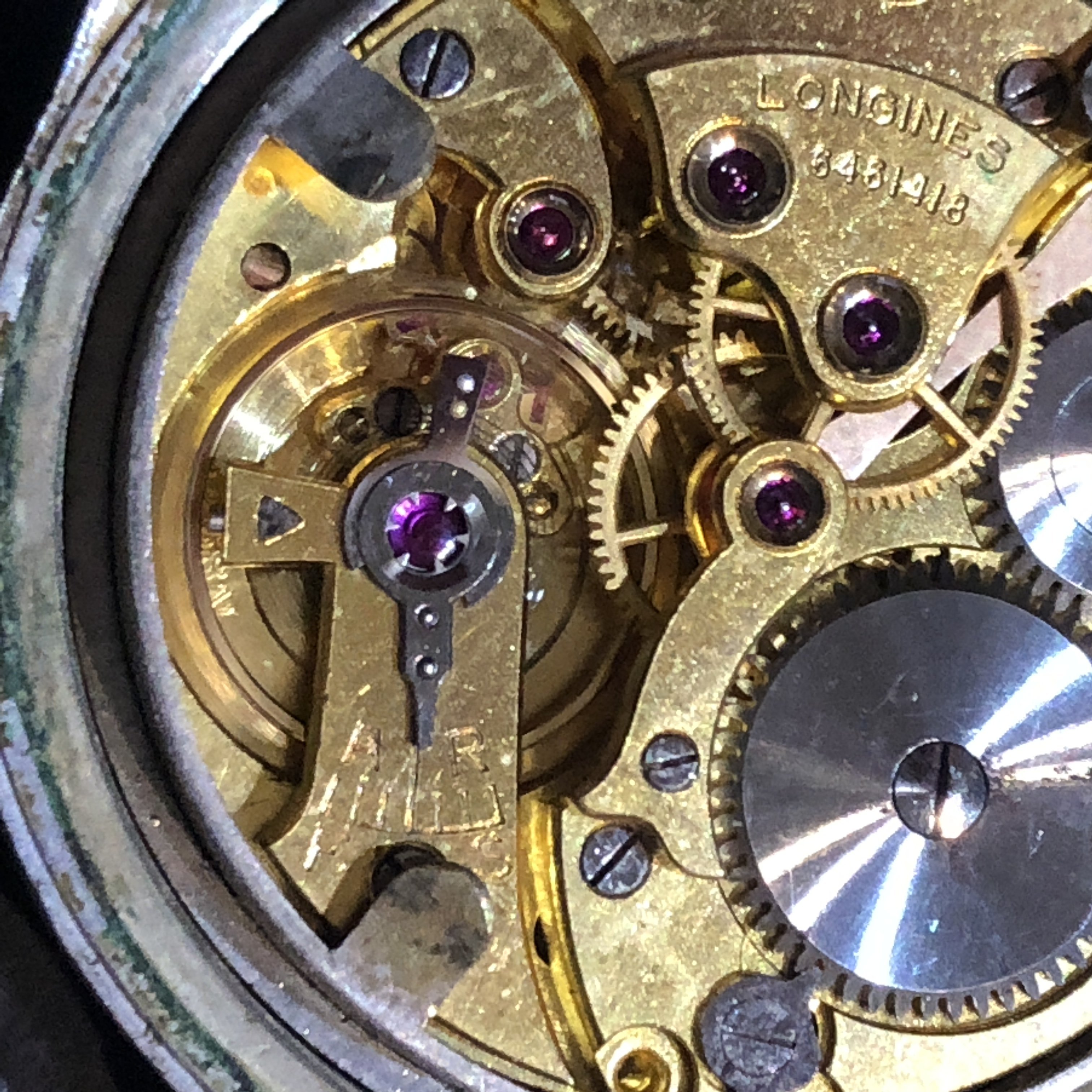

Howdy,
Very nice, thanks for sharing.
Do you have the ability to take some more photos with focus on the dial and preferably with a polished crystal or even better with the dial outside the case? Would like to study how the dial looks 😀

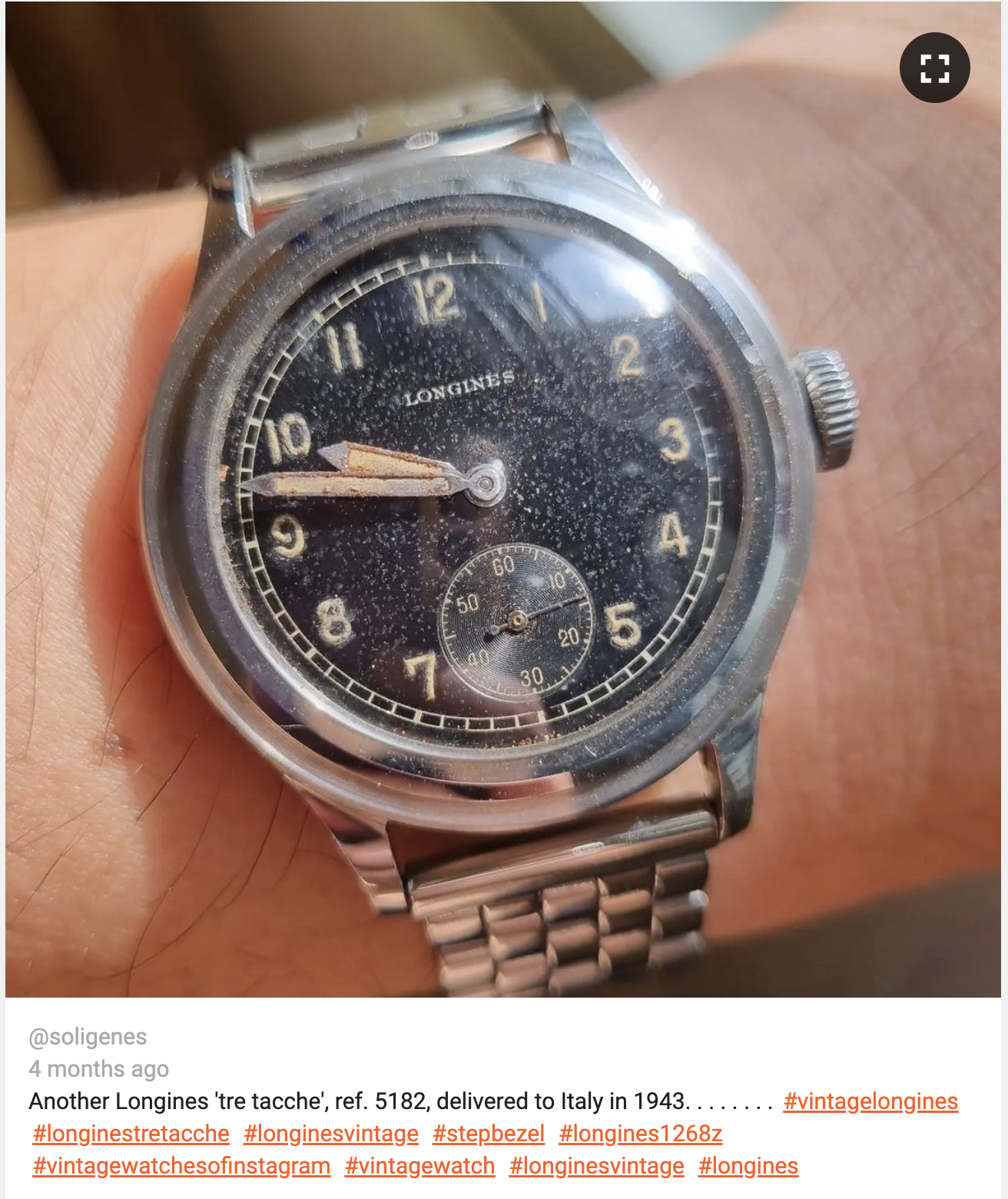

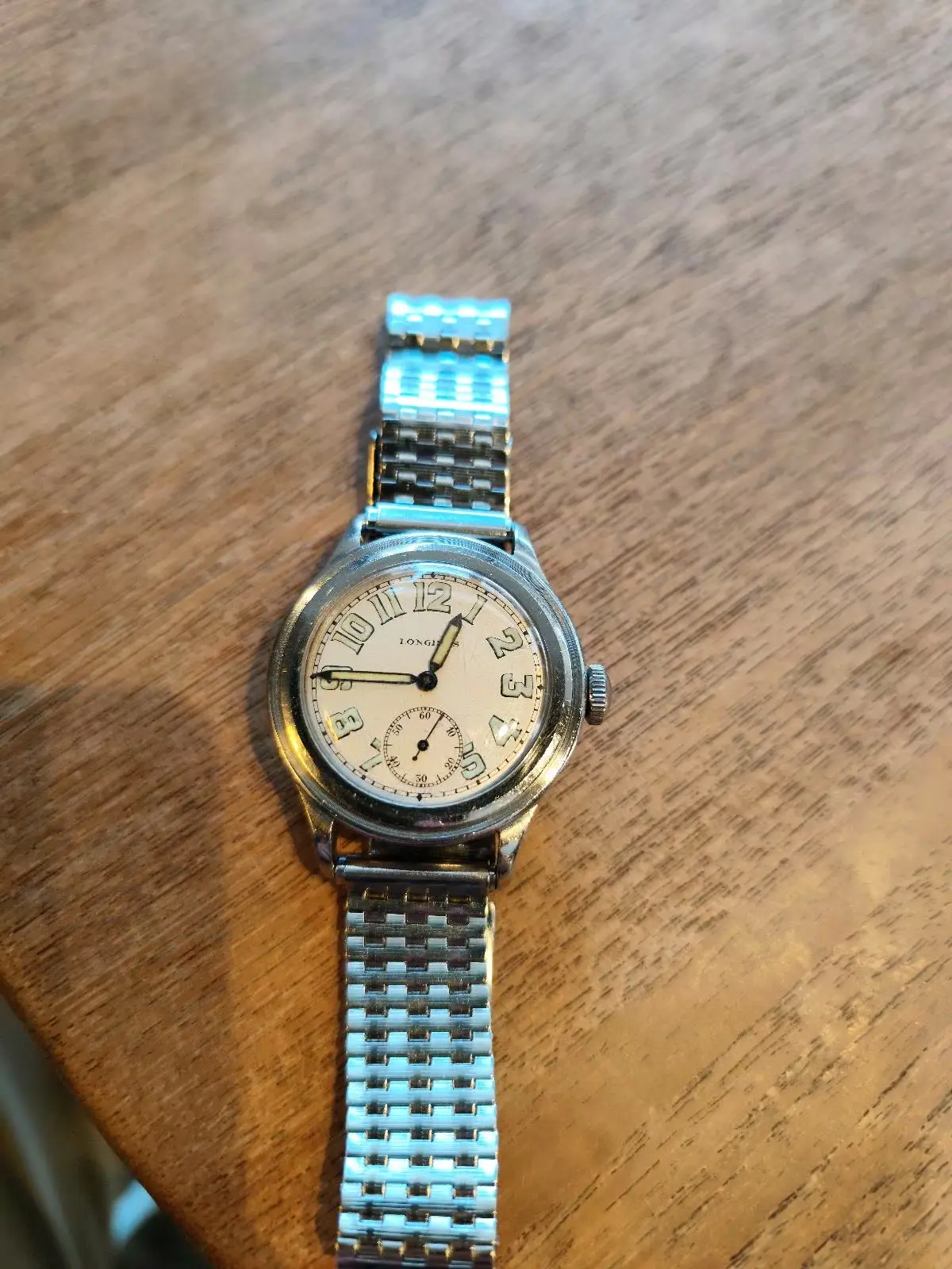

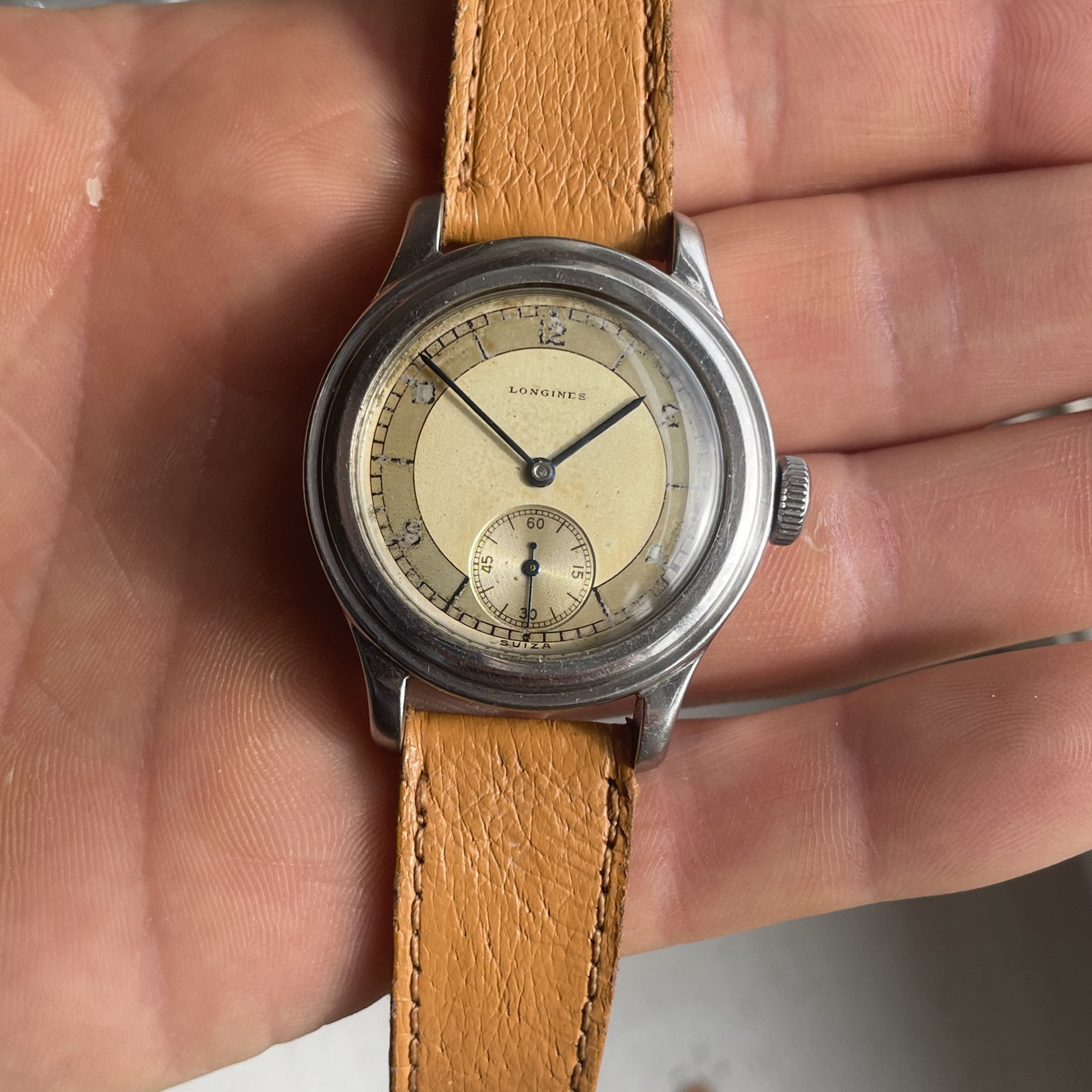

Another 35mm tre tacche with "sei tacche dial"
As always, it would be great to know what is written in Longines' archive.

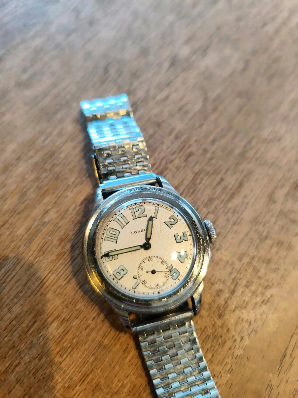

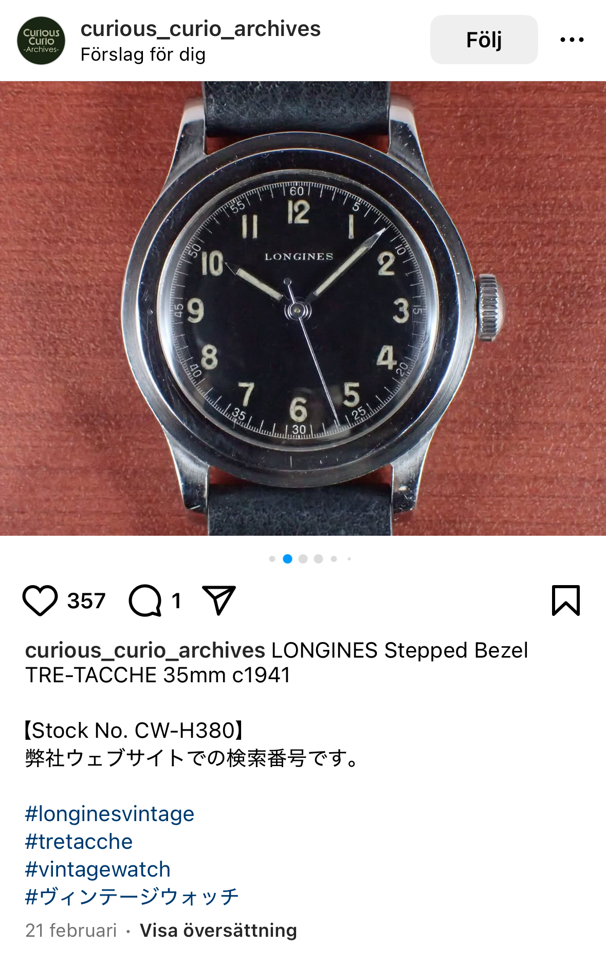

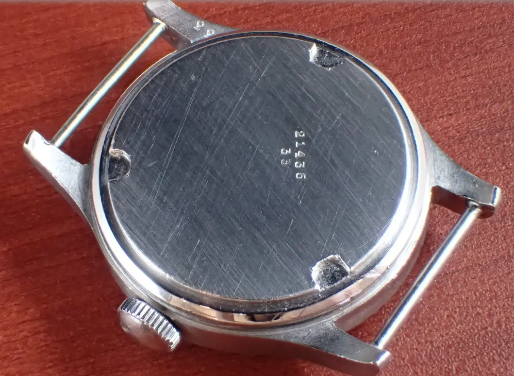

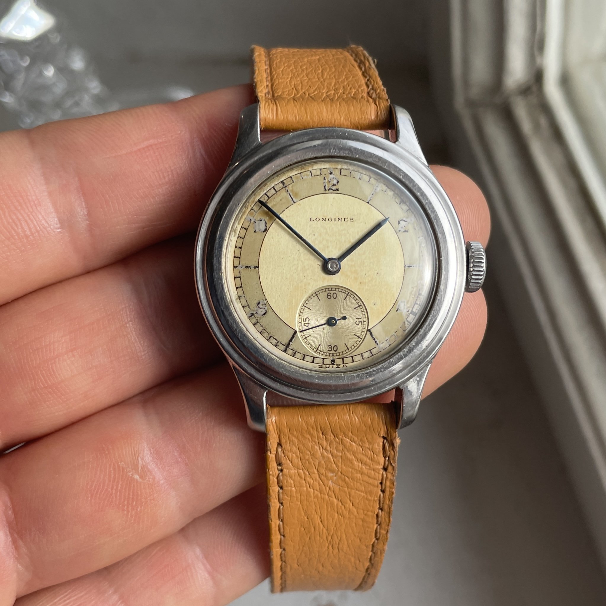

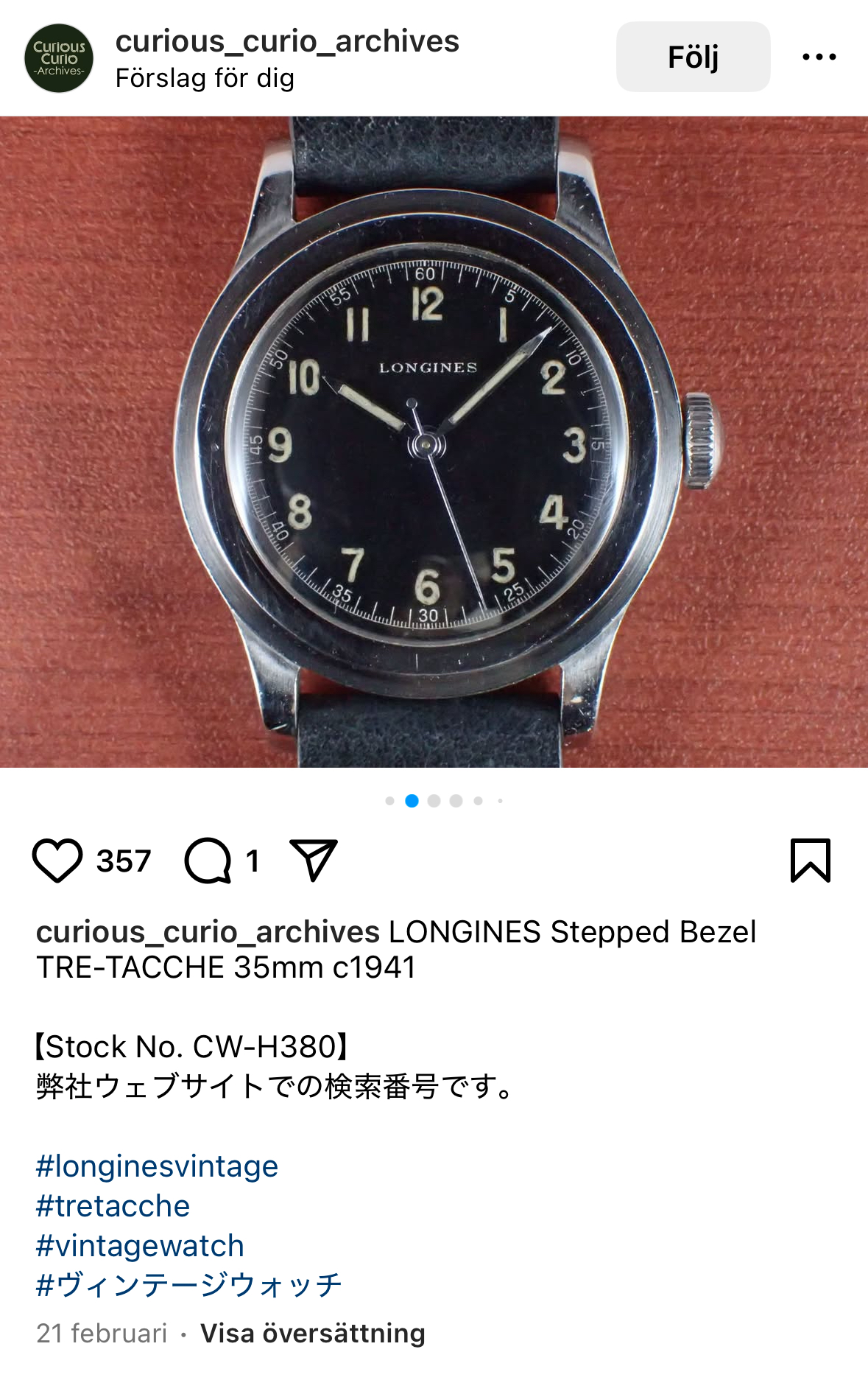

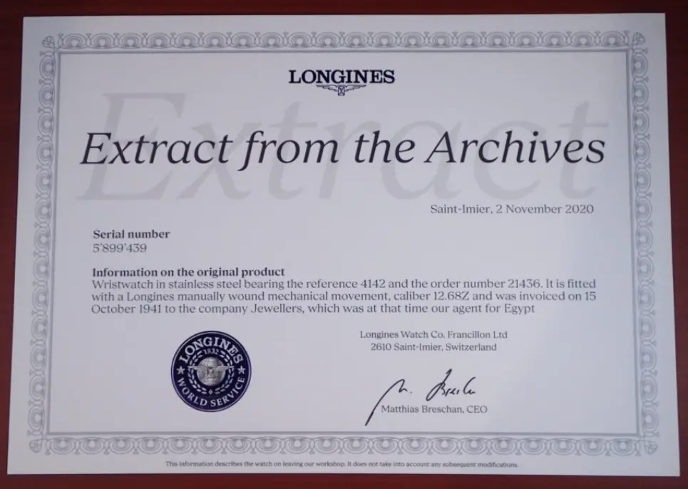

Stumble upon this 35mm tre tacche with centrum second, what do you think about it @DirtyDozen12?
Hard to say but dial does not look flat, hands and numerals does not look typical to the 35mm tre tacches I have seen (thinner).
2,829
4,948
As with almost all 35 mm tre tacches, I am not certain. I cannot tell whether the dial is flat or convex. The design of the outer track is consistent with the invoice year (1941), I believe. Here is a 30 mm/10.68N example for reference: https://omegaforums.net/threads/1941-longines-with-military-connection.150015/. I would have expected a signature that resembles the one on the example that I linked to. That signature was typical of Fluckiger dials from the mid-1930s to early 1940s. Like you, I wonder if these thinner hands are correct or not. I find it interesting that the watch was originally invoiced to Egypt, though I cannot conclude anything from that alone.
Source: https://curious-curio.jp/watch/39891

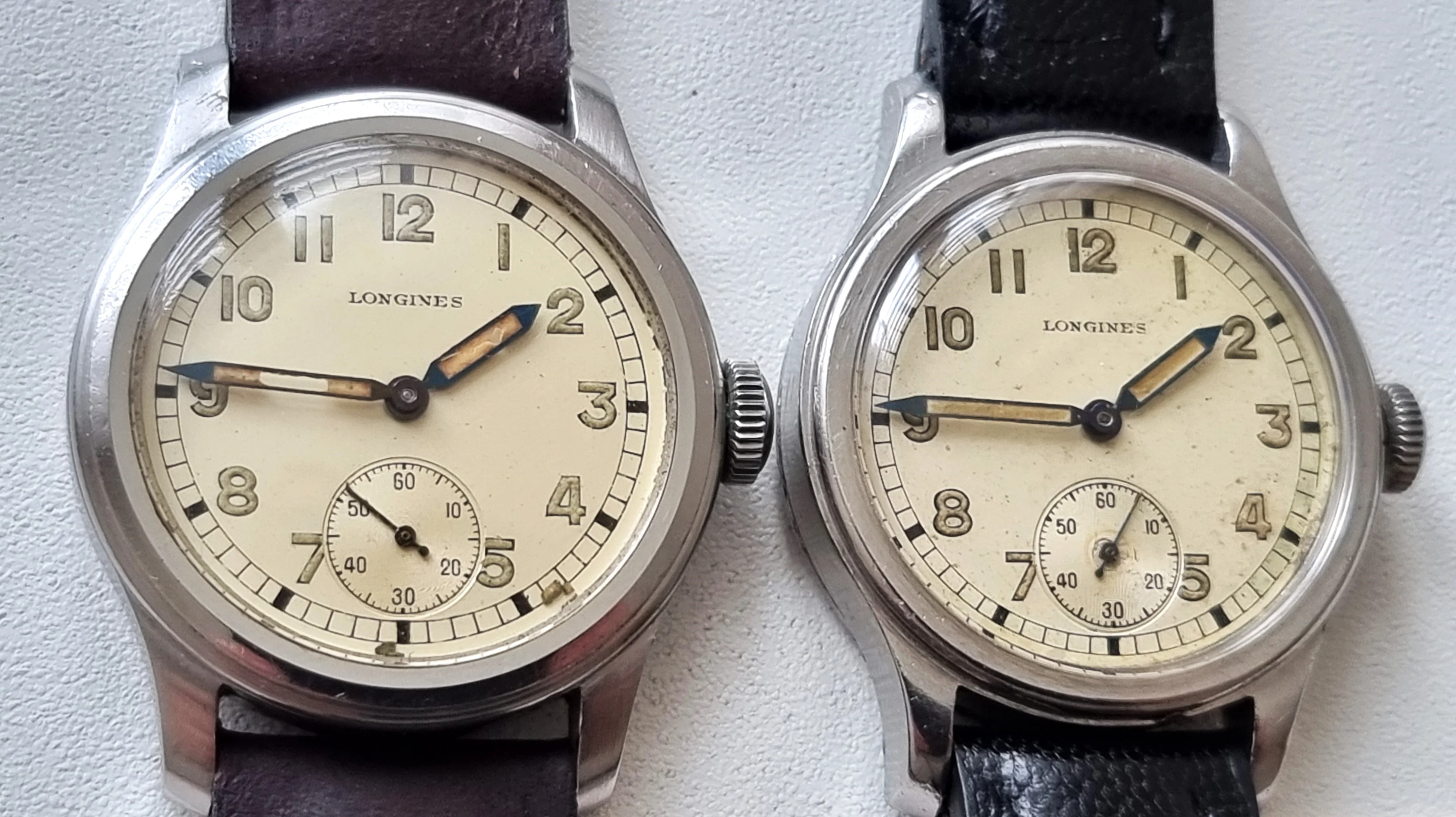

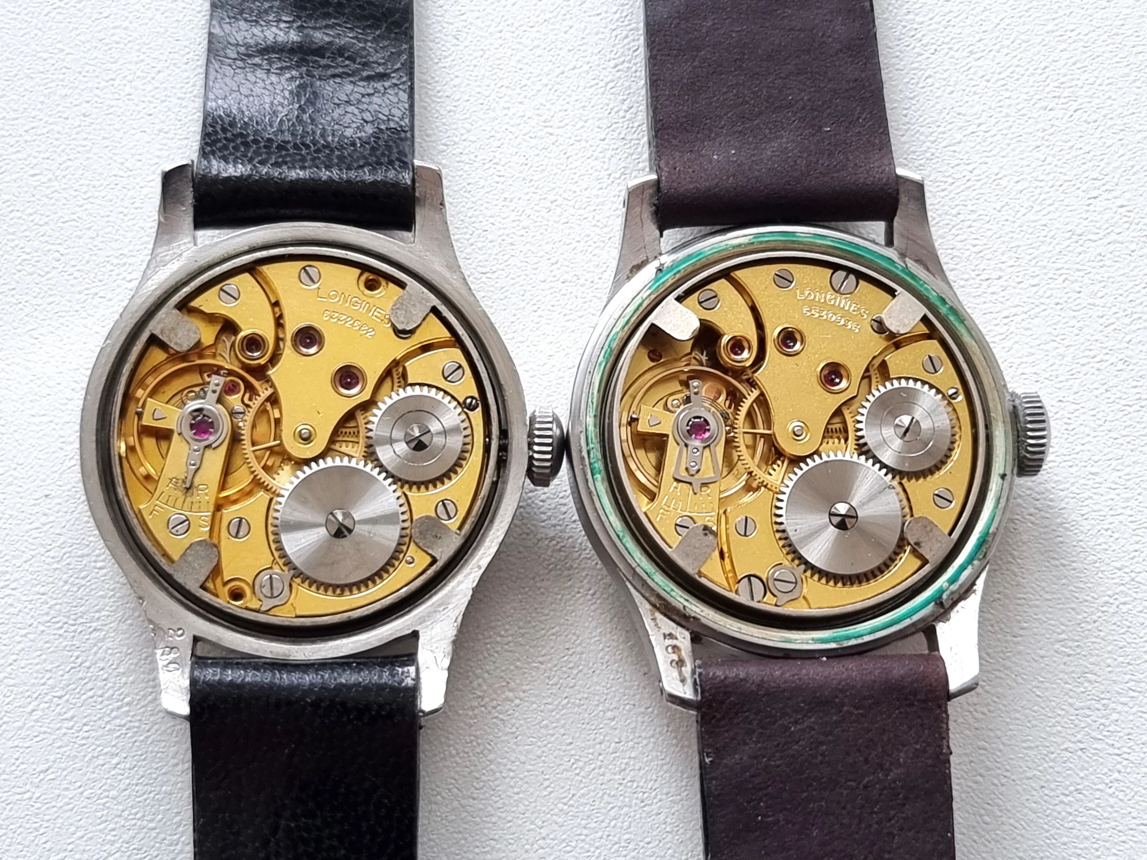

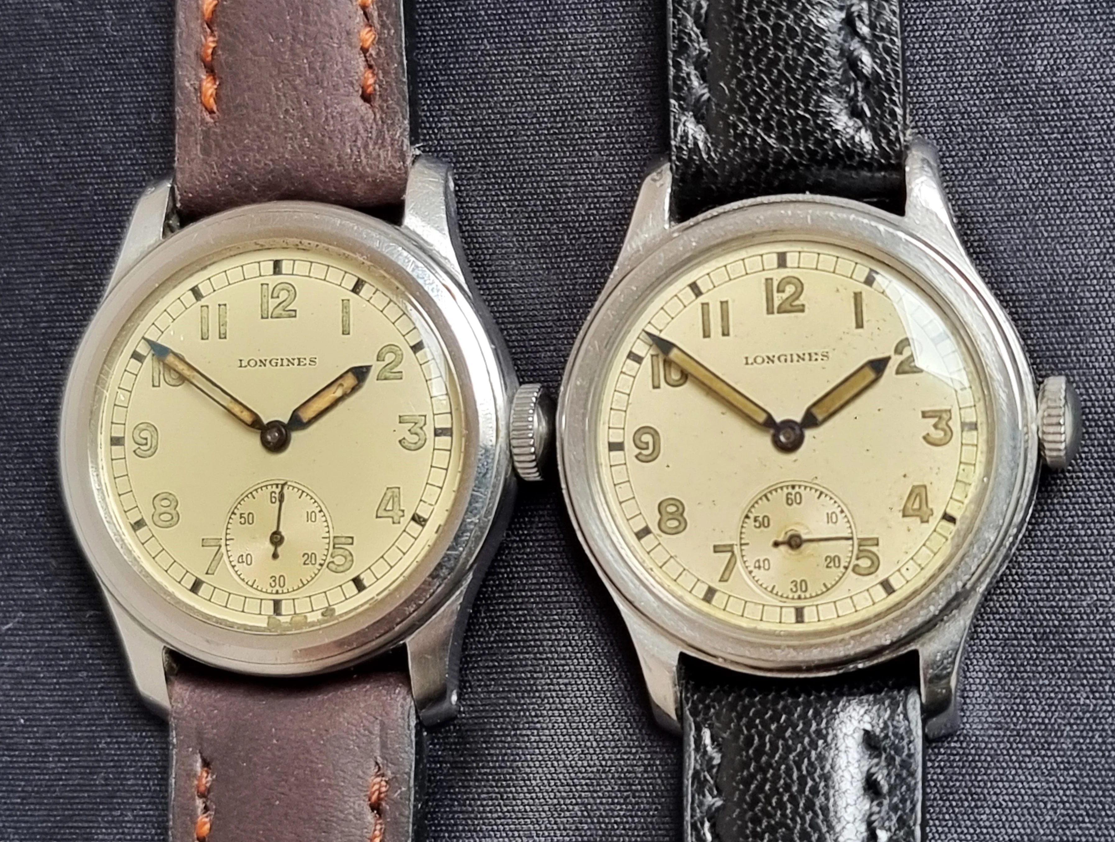

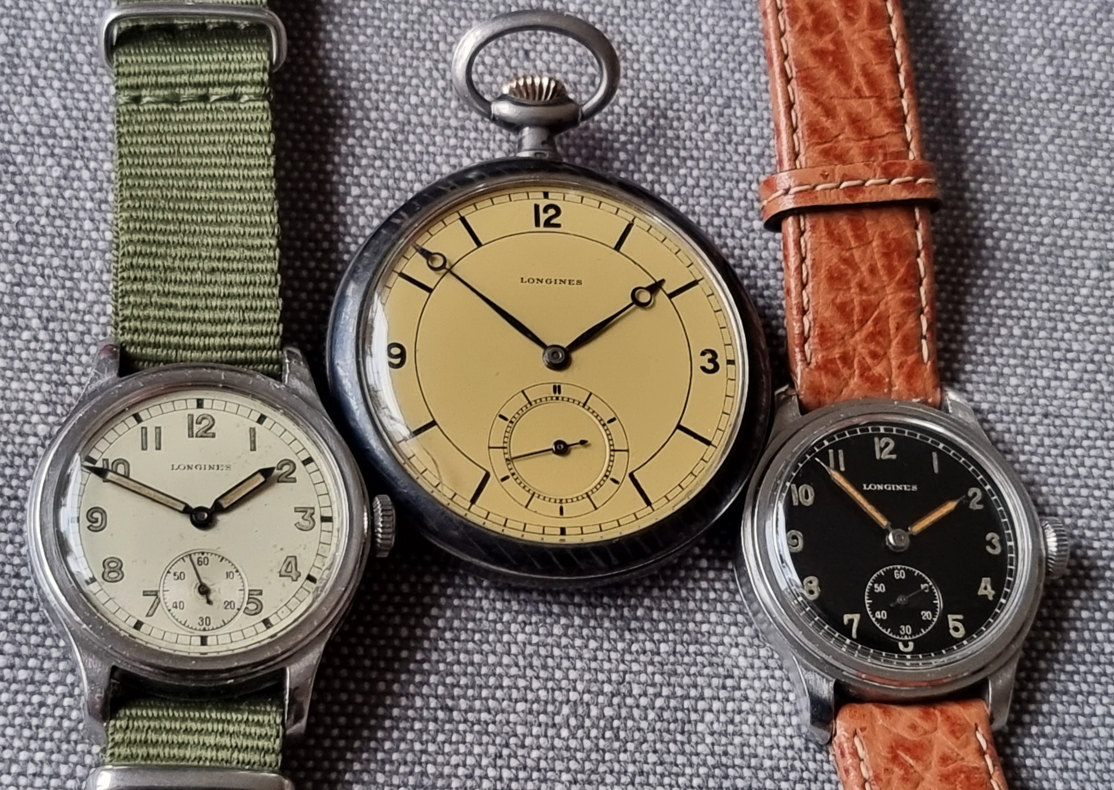

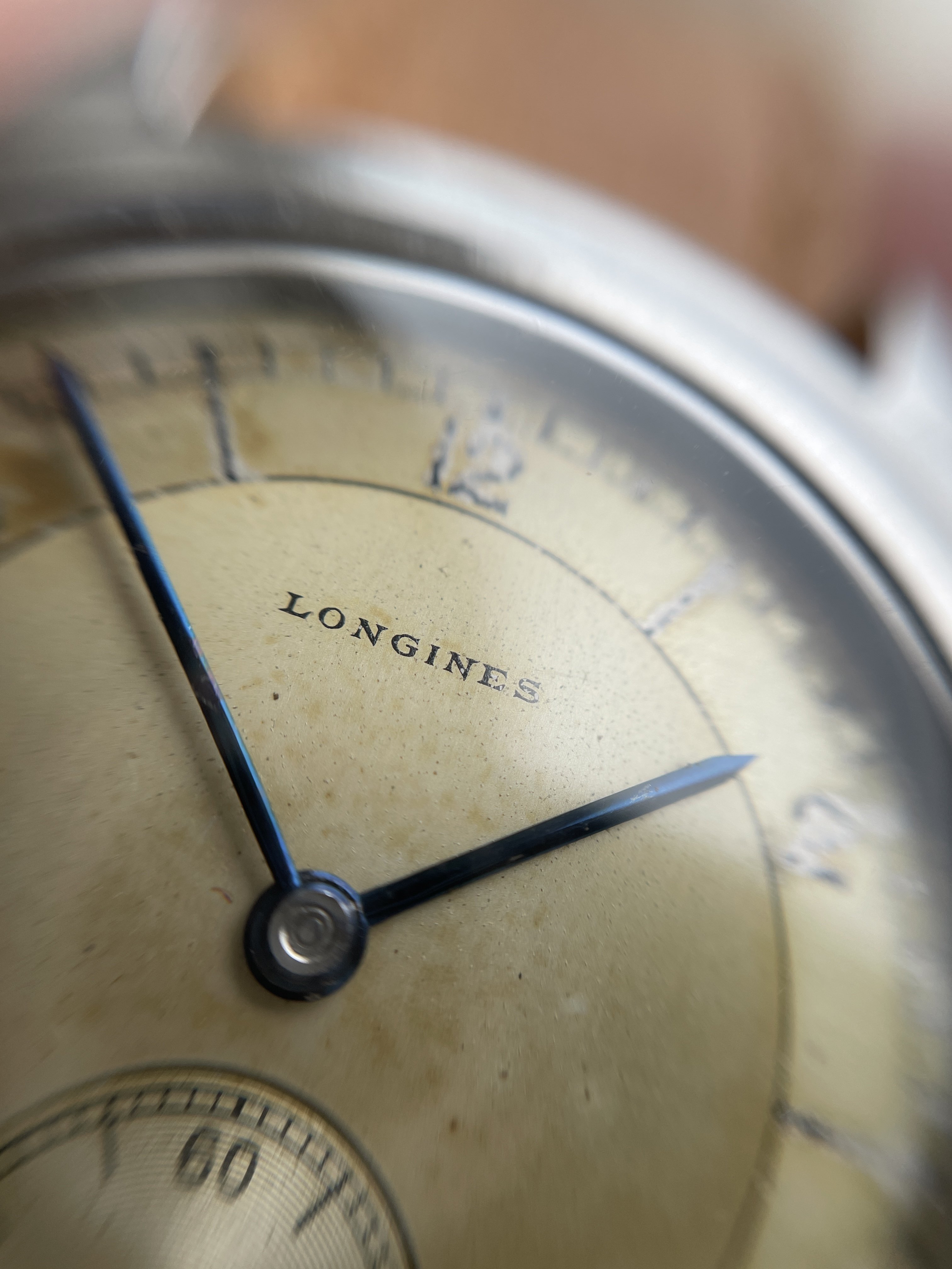

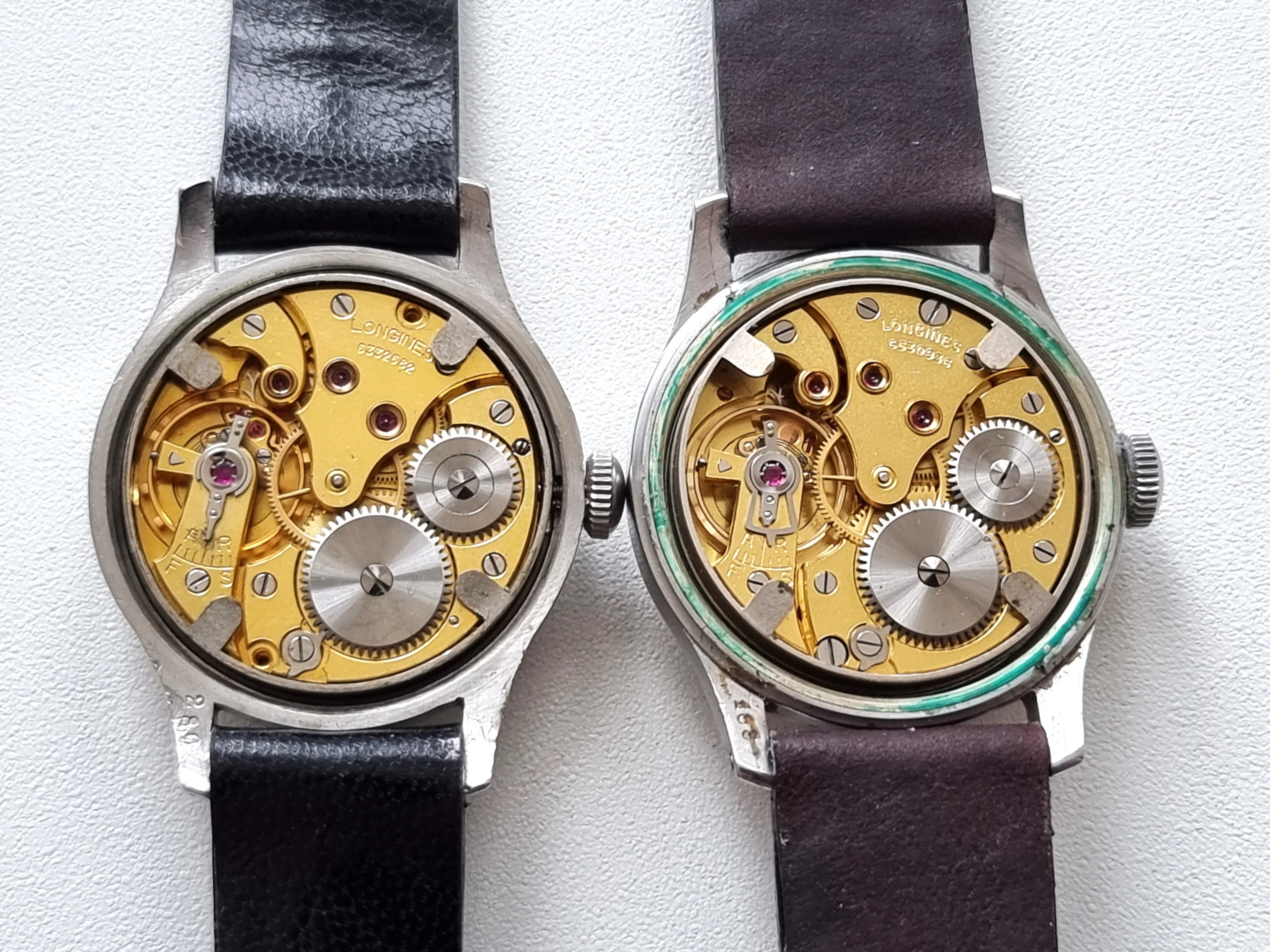

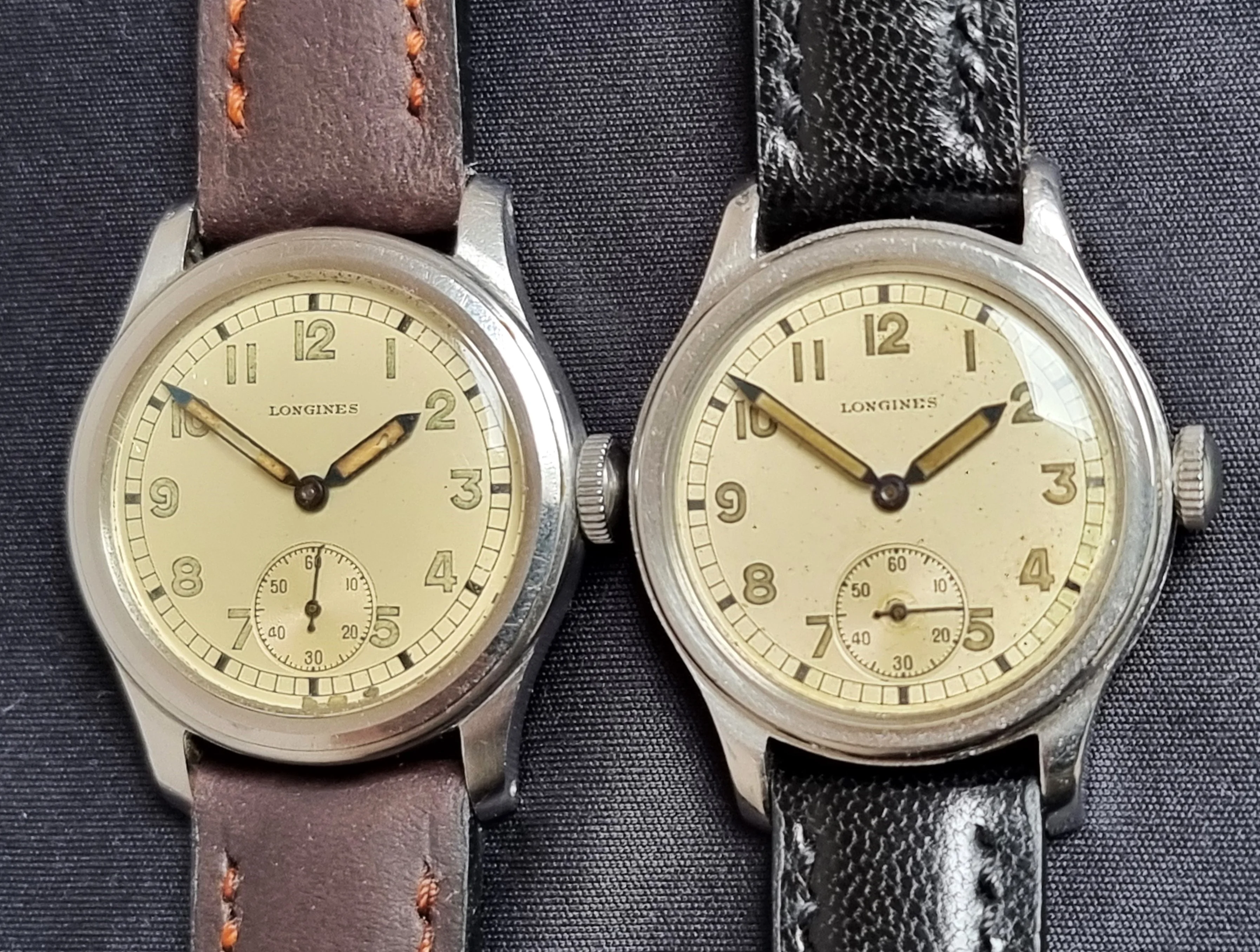

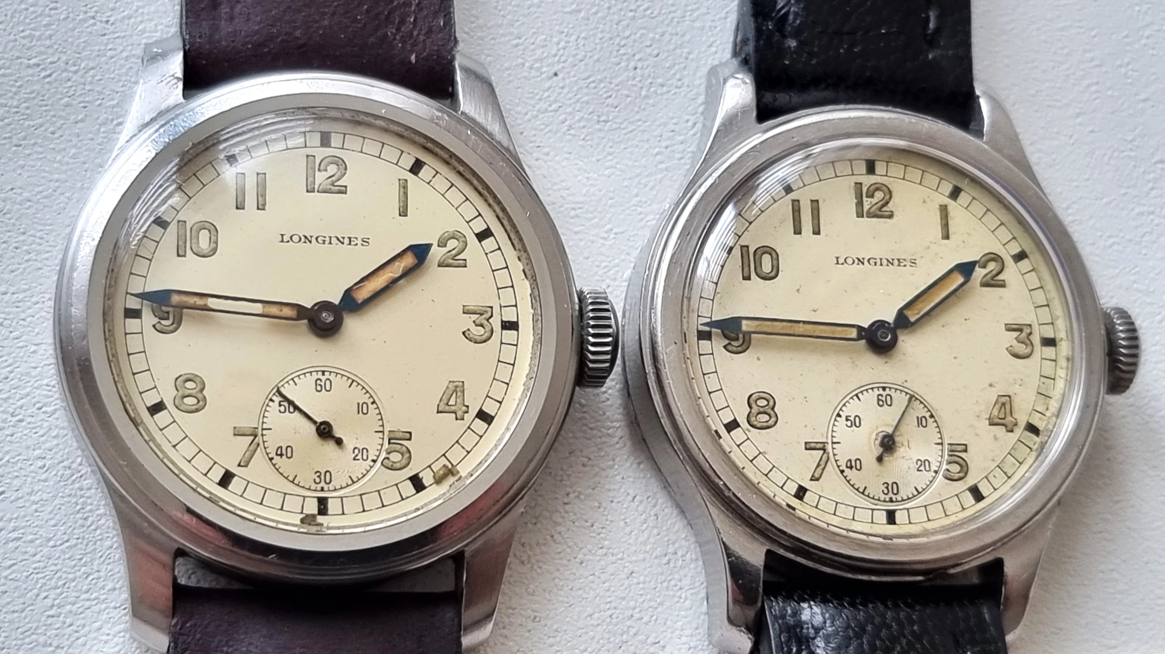

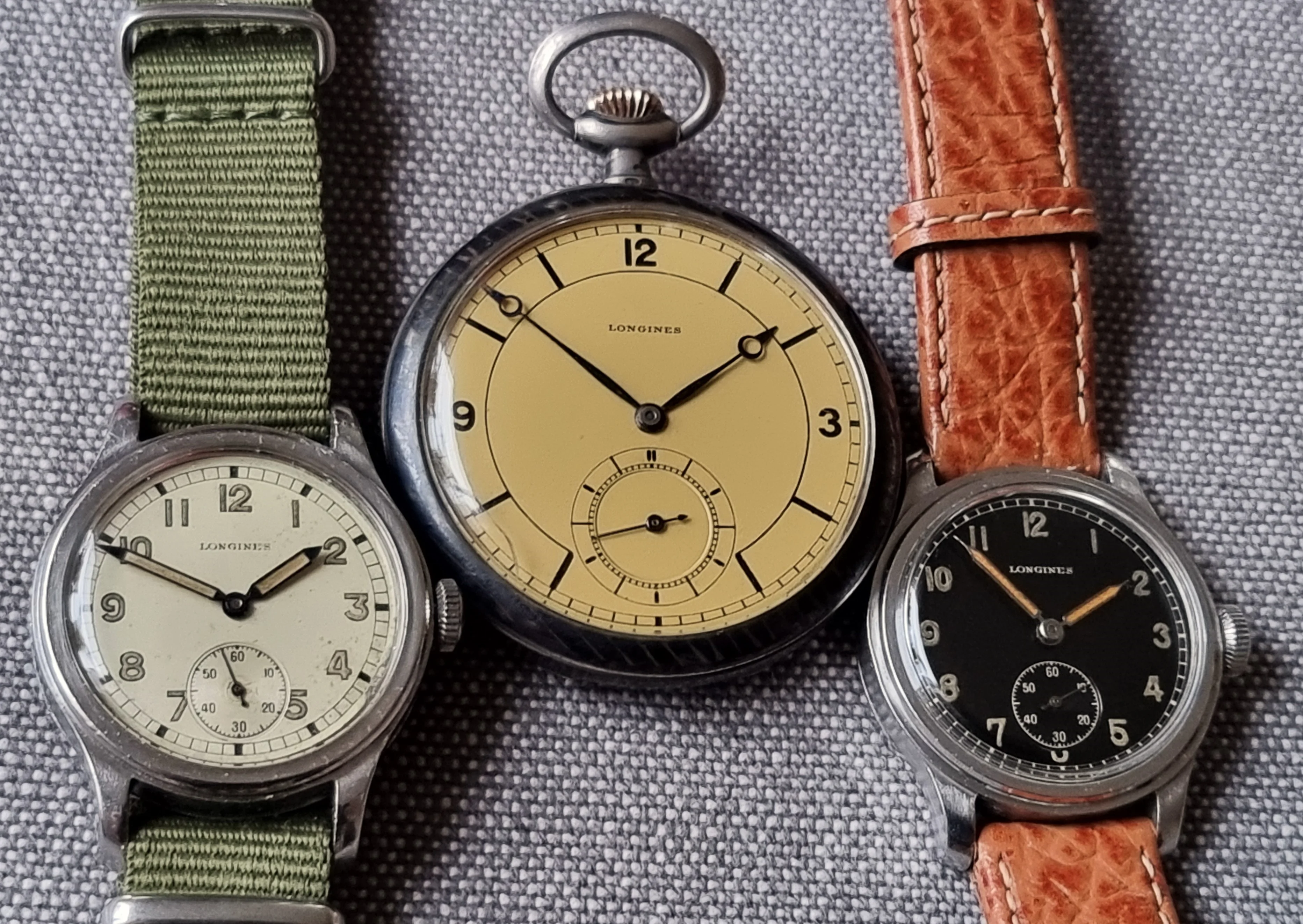

Hello.
Such a curiosity. Tre tacche and sei tacche with the same dial and movement but different case. And three years difference in movement numbers. Is it possible, is one of them a franken? Or maybe two frankens?
6,904
10,769
Dont know but I like them 😀

Hello.
33mm?
7,690
22,055

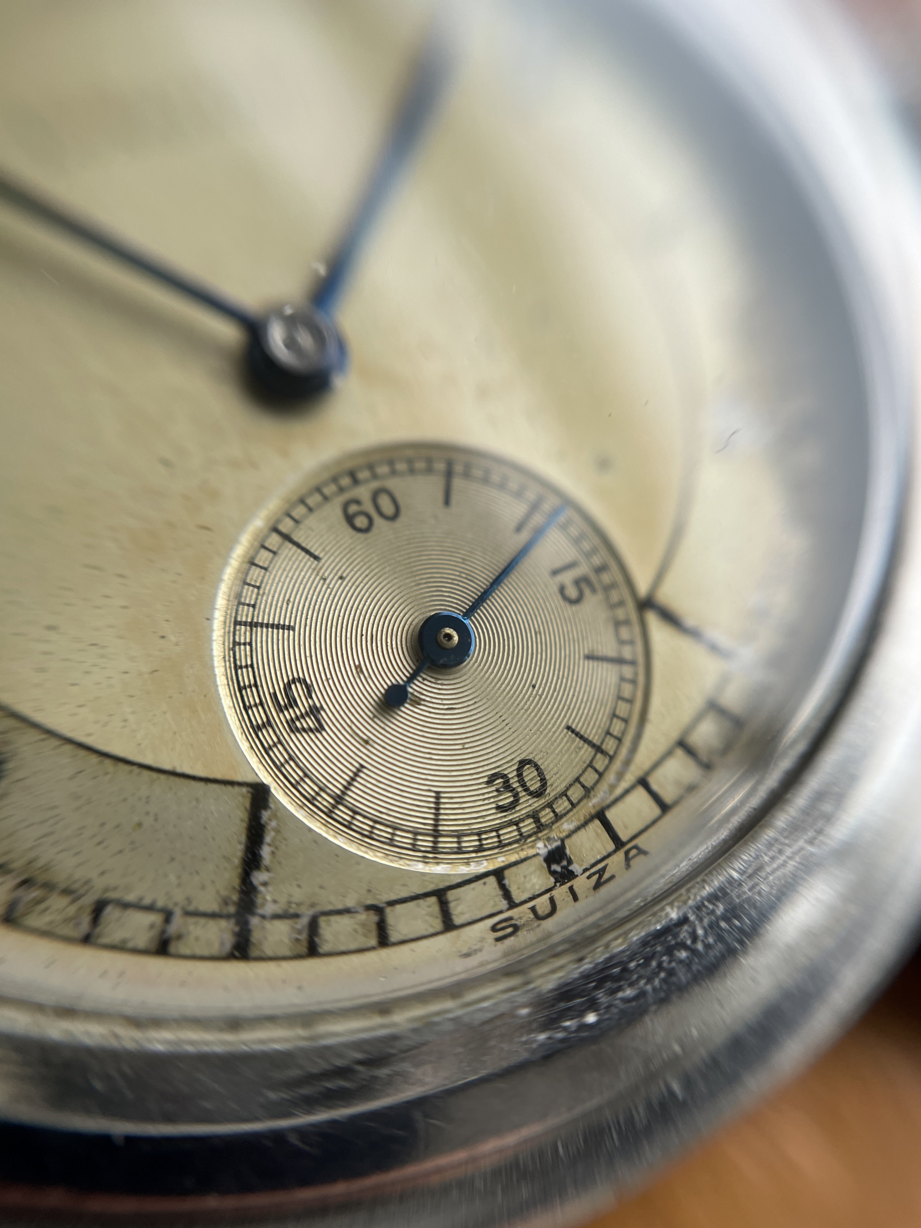

Hello.
Hi everyone.
The tre tacche to me looks like a correct example of 33mm tre tacches found mainly on the scandinavian market - at least I’ve seen a few examples come up on auction in scandinavia in past years.
The same dial in the sei tacche appears to have been transplanted from a 33mm tre tacche. Funny as the transplants usually go the other way around but someone in this case probably decided the larger case would make a more valuable watch.
You can even see there’s a big gap between the minute track and the bezel, with chipped varnish which would have been hidden under the bezel in the original watch.
809
9,410
Hi everyone.
Exactly, you're right. I saw the break before the auction ended, but I still decided I had to have this watch. It's a very valuable flat dial for me, in perfect condition. I don't know if the flat dials were only in the tre tacche version or the sei tacche as well. If I get confirmation from Longines that my sei tacche is a franken, I'll move the dial to the tre tacche (the dial in the sei tacche looks much nicer) and look for a 32.5 mm tre tacche case. I know that Longines currently has a much larger database and even the color of the dial may indicate that it will still be a franken, but it's worth the risk. And I'll have a project for the future.

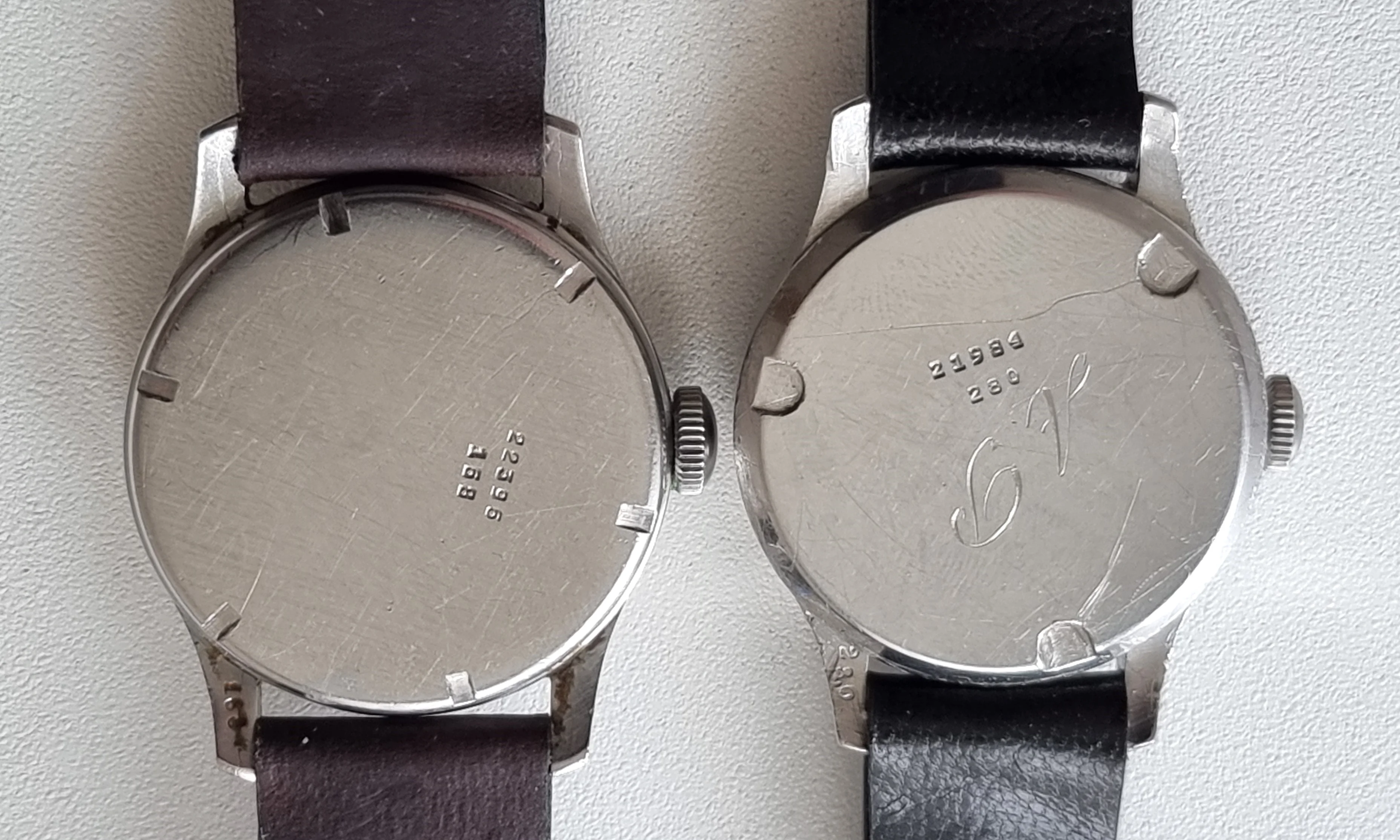

33mm tre tacches are relatively uncommon, I would say over ten years I only saw about 10 or so on the open market.
I’d say 6 of those had one of these cream colored radium dials. 2 were pink, 1 had another type of (very nice) non lume white dial, and maybe there was one or two radium black dials similar to this design.
809
9,410
I know someone in Sweden who has a 33mm tre tacche case with a sei tacche dial. I have already started talking about buying it. The 33mm tre tacche cases were different heights? So far I have managed to find two tre tacche watches for my collection, the light one is more than 1mm taller than the black one
