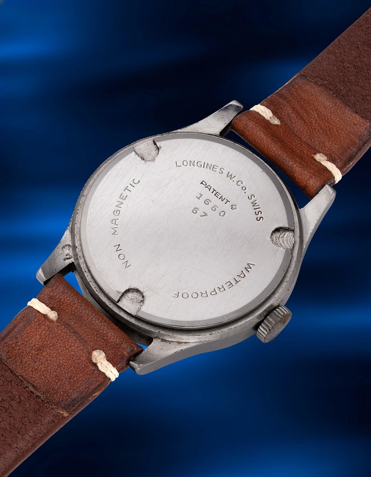

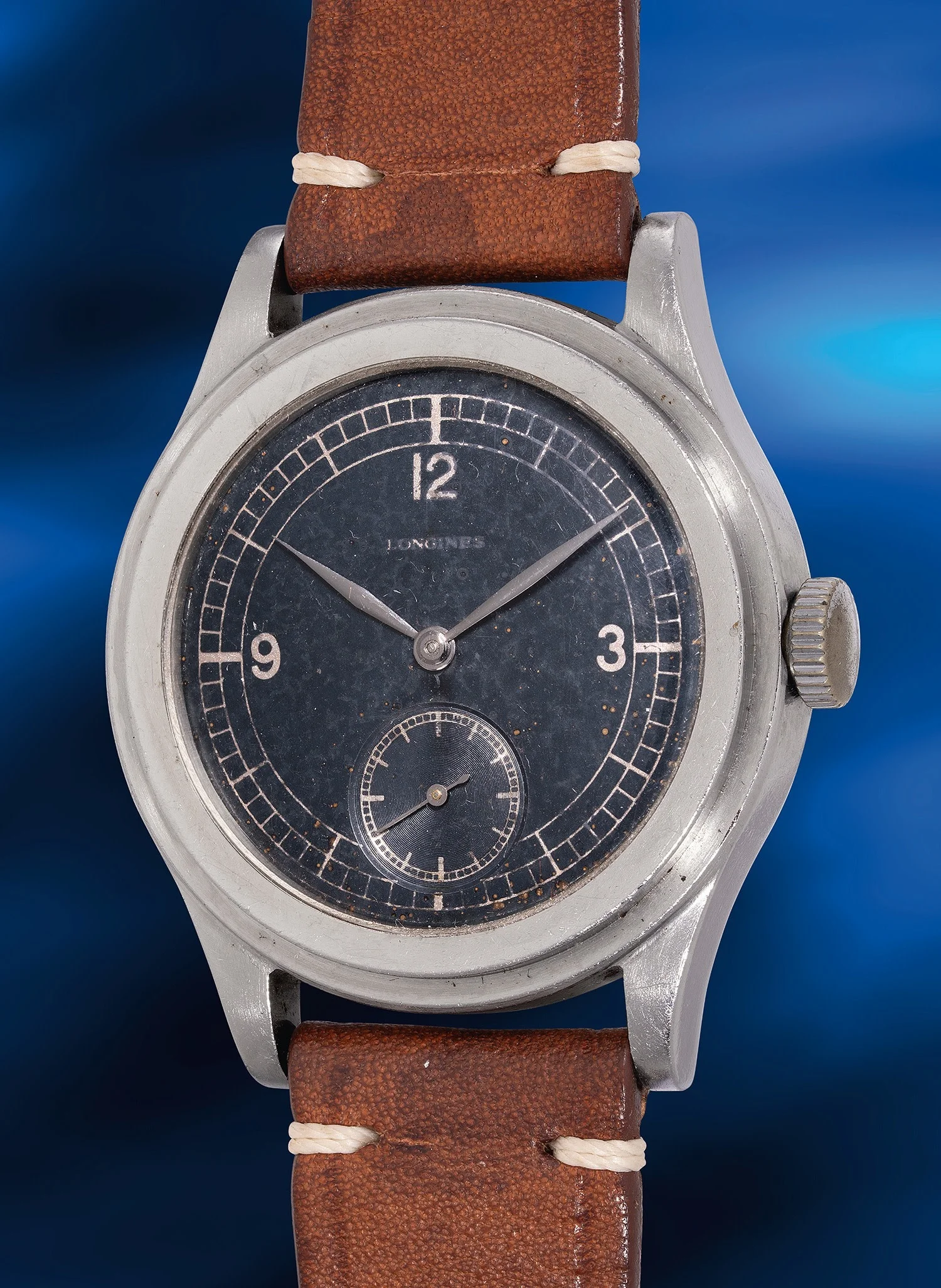

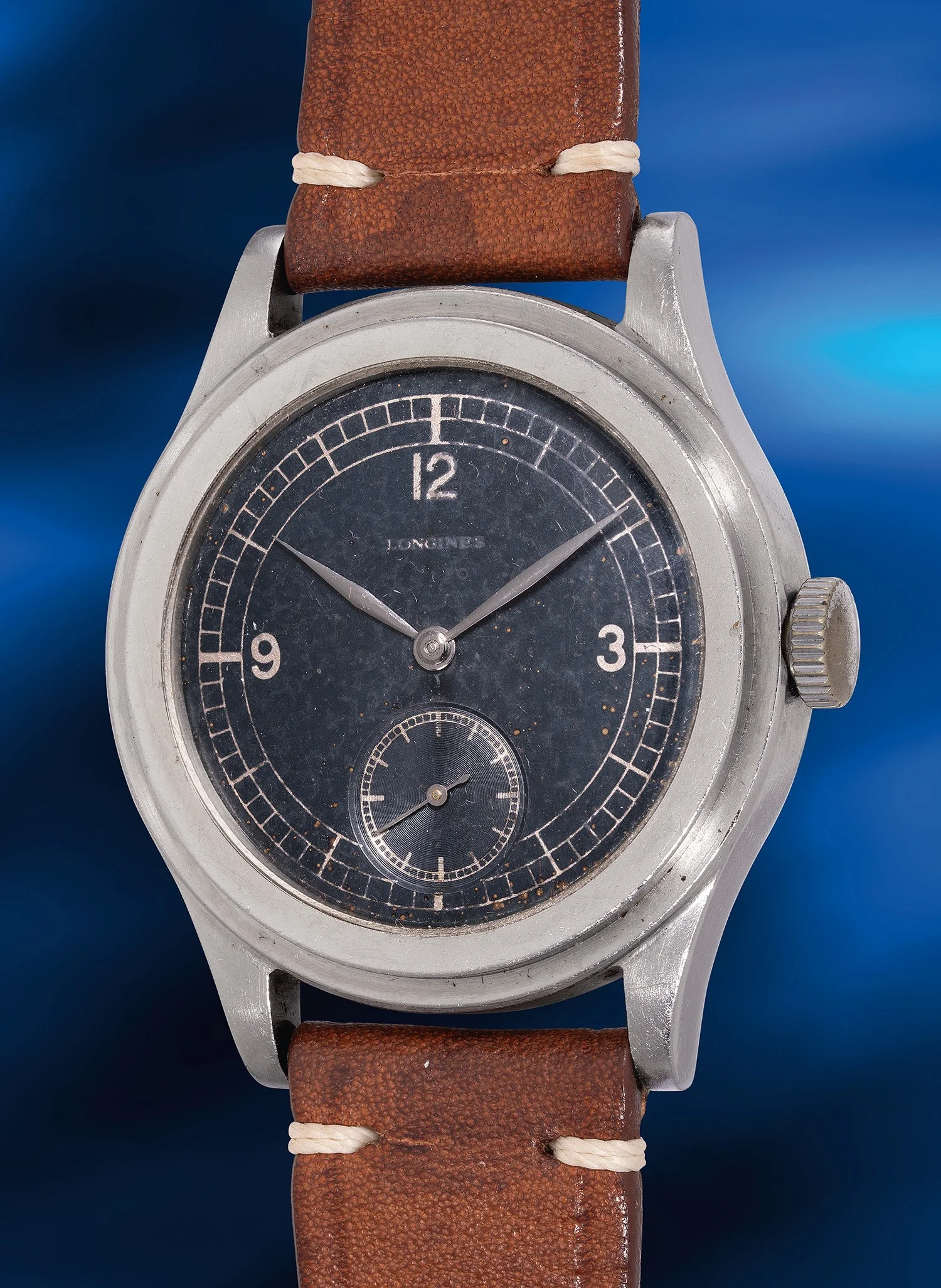

First, the photos.

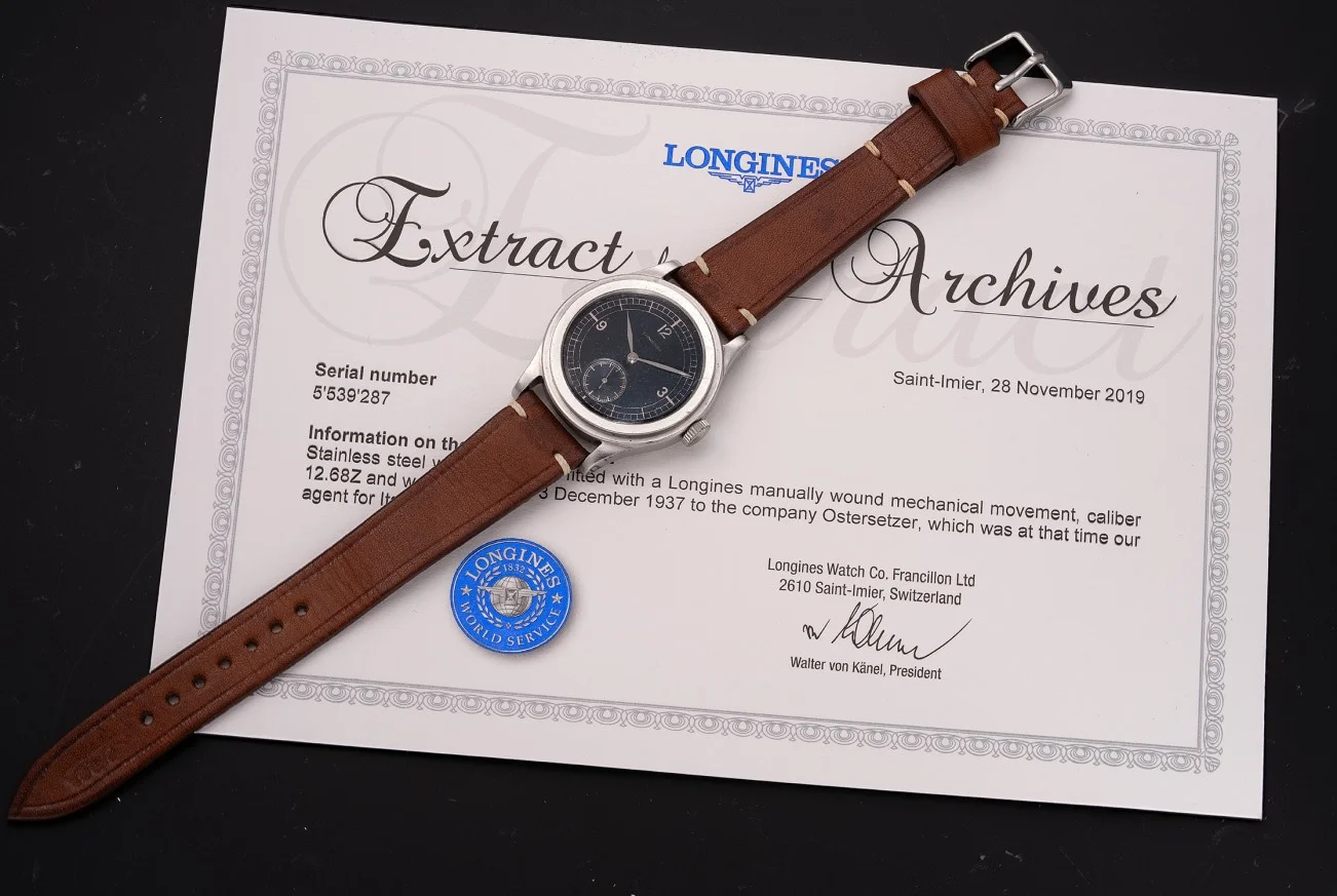

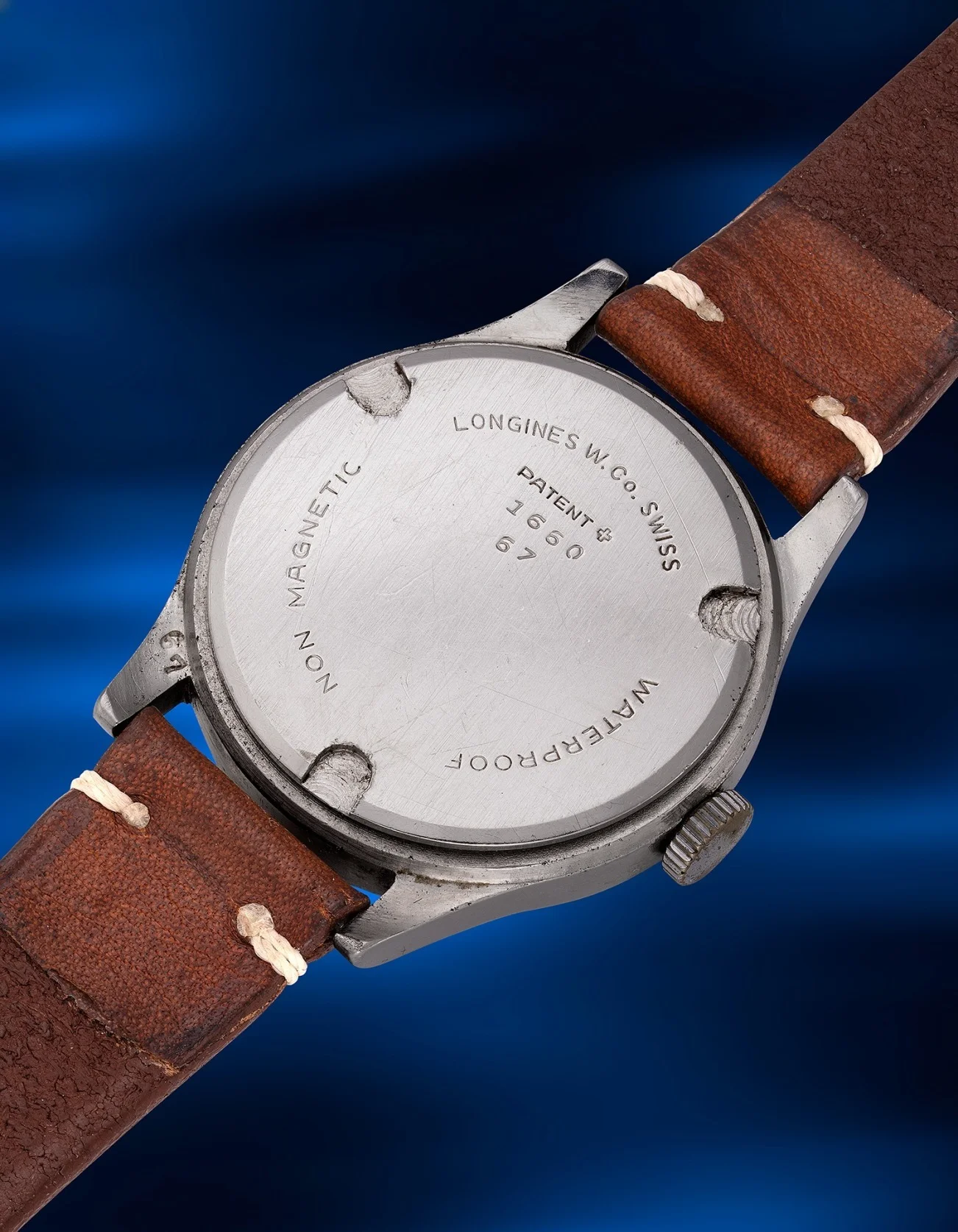

Movement No 5’539’287
Case No 1’660, further stamped 67

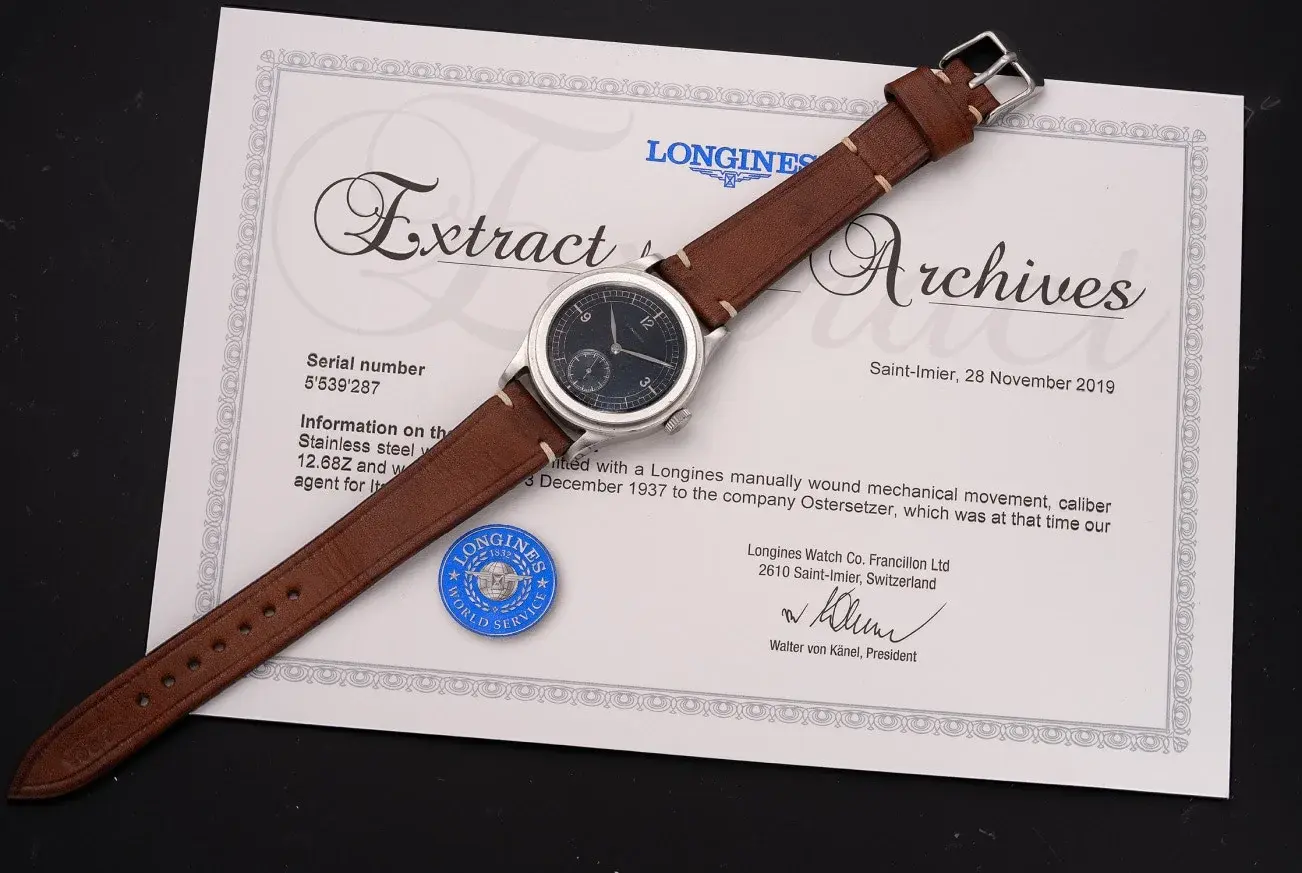

Delivered with Longines Extract from the Archives dated 28th November 2019,
confirming the present watch was sold on 3rd December 1937 to the company Ostersetzer, Longines’ agent for Italy.

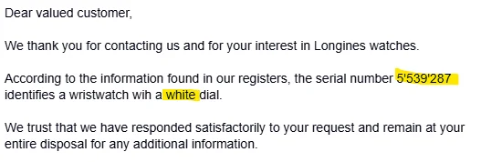

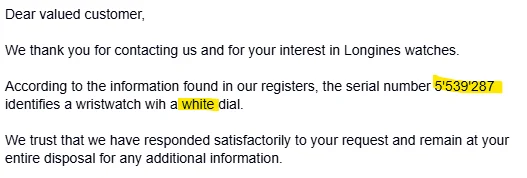

Unfortunately, Longines Archives confirmed this watch originally came with WHITE Dial.
Although I believe this dial is possibly a correct configuration for a 35mm 3T, this is another one of those frankens or whatever you may call it, very common in Longines 3T's.
Also, the dial condition is very poor as well, and damage marks around the edge of the dial suggest this dial originally came in a smaller watch, and was swapped later on.
Below is a capture of the email from Longines heritage department.

Why would they not include that info with the extract???
Longines' archive dept has continually unearthed new information as they find more records. The physical archive cert was probably issued before they had the dial color information.
The information likely existed in the records when the pictured extract was issued, but it is only in the last year or so that Longines has ceased issuing extracts for watches with current appearances that do not match the written descriptions in the archive. The pictured extract, being of the older style, was issued before this changeover and under the old rules. At any rate, neither old nor new-style extract typically includes detail on dial configuration unless there is some particularly noteworthy surviving dial characteristic noted in the archive that they deem worthy of mention.
They used to issue archives all the time, with just the information on the case number + movement number matching.
so an Extract from the Archives by Longines is just that, a proof of "CASE NUMBER" and "MVT NUMBER" matching.
nothing more.
Dial is a different story altogether : you need to check on your own. At least the old extracts don't guarantee anything on the watch.
PLUS, it could be possible that an extract could be obtained in its original form, AND THEN the dial swapped, as the extract DOES NOT mention the type of DIAL.

Aside from the dial color, everything else seems consistent. The dial is flat, comes from a 35mm case, and hasn't been repainted. Do you have any suspicions about the dial's origin? The first thing that comes to mind is a transplant from a Sei Tacche watch. Did Sei Tacche watches have dials like this?

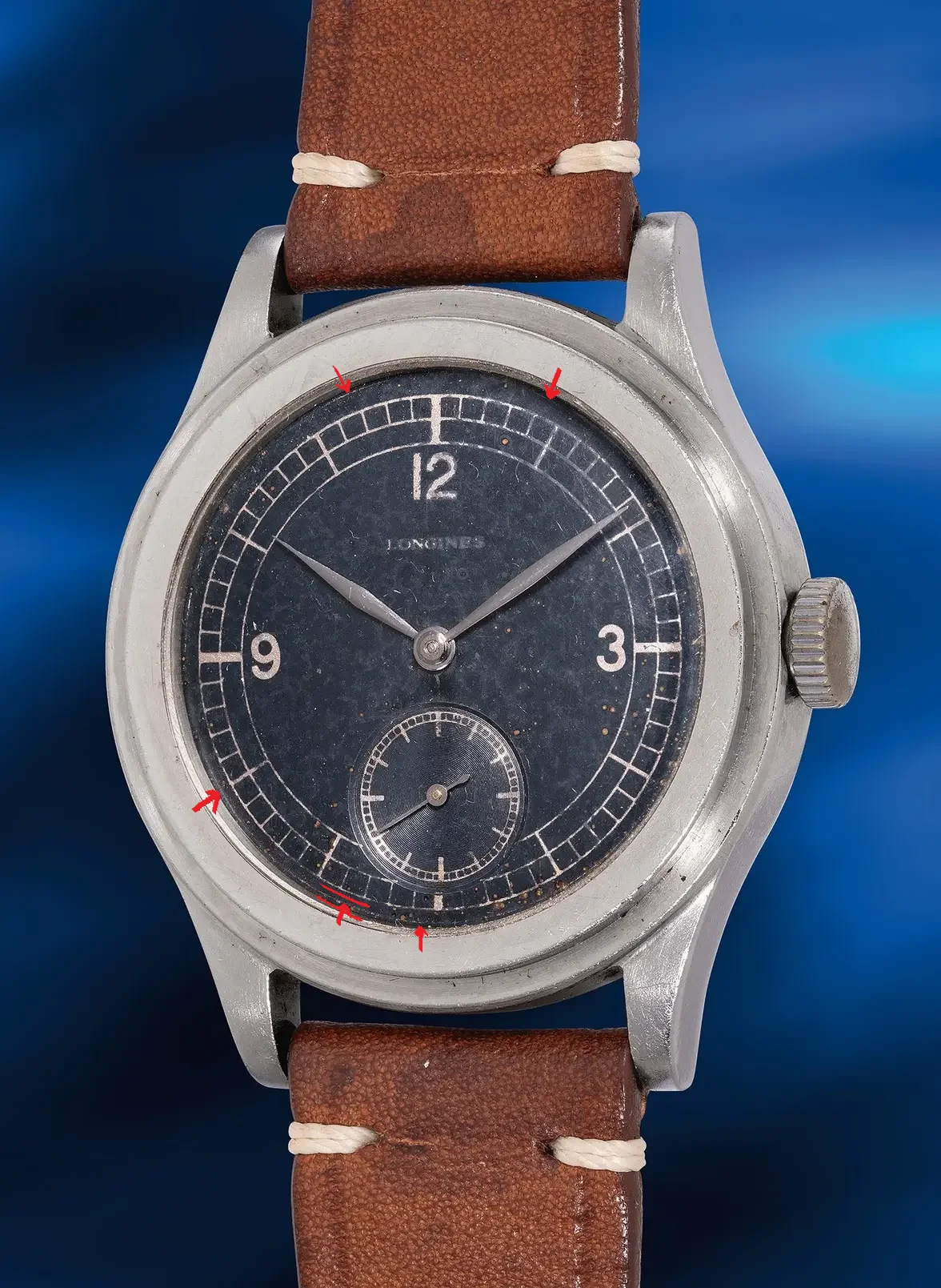

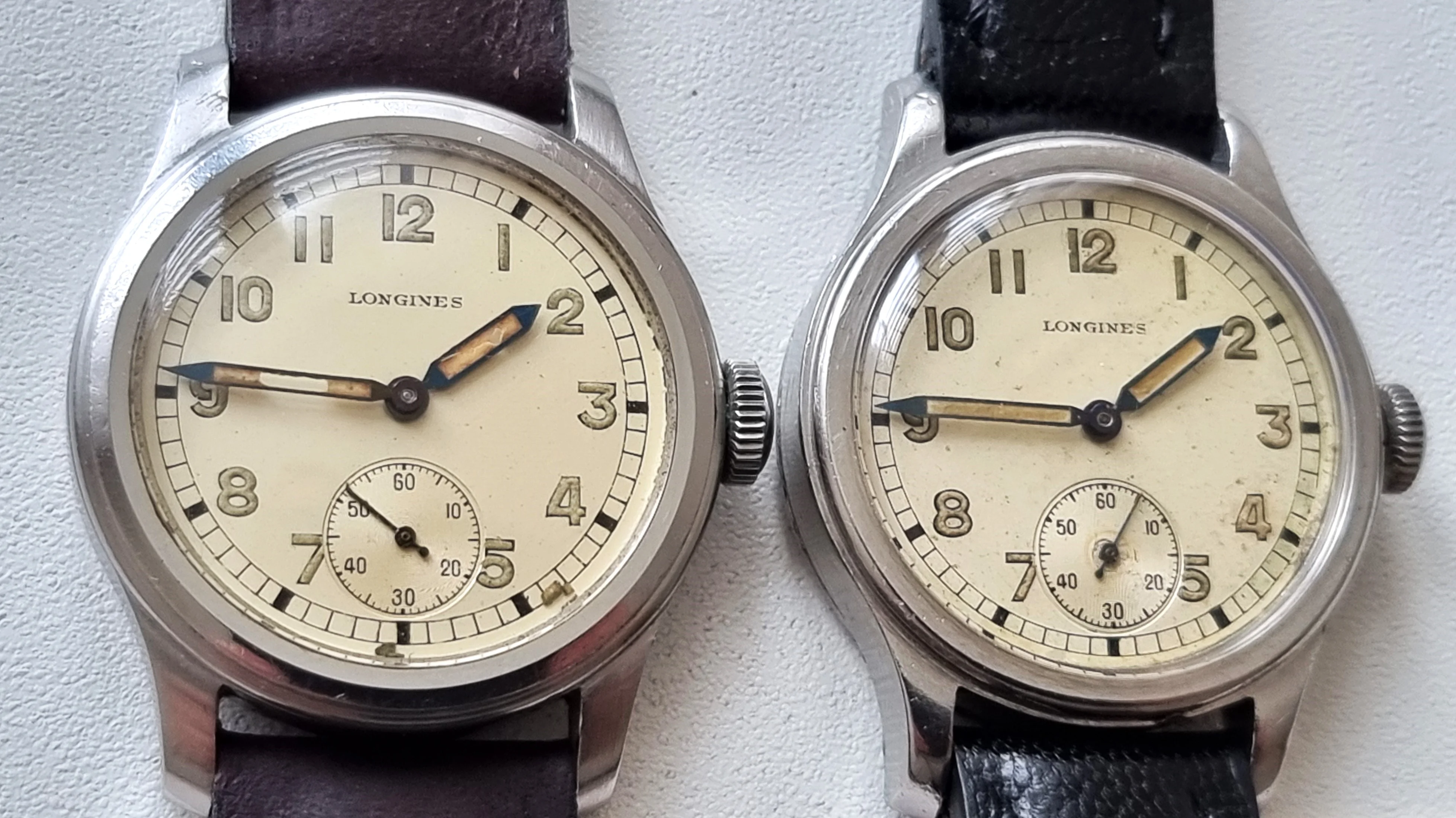

My suspicion is that this dial did not come from a 35mm 3T case.
possibility would be similar period non 3T cases, probably about 32-33mm in size.
These are the primo candidates for dial swapping, since the larger case size makes it much more valuable, obviously...
Sei Tacche is a little bit later period.
I would say dial period is contemporary with the case, just the size does not match.
Here is proof: you can slightly make out the outline of where the original watch case's rehaut would have touched the dial, and made a mark on the dial...
The original case definately had a slightly smaller dial opening.

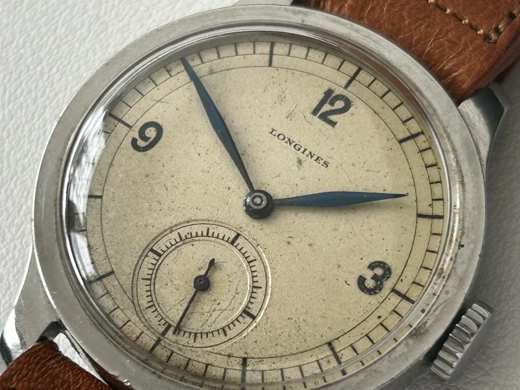

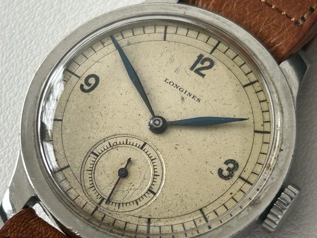

Very similar style dial in a 32mm similar period case:
Although this one is different that it has different style numbers, especially "open 9" is most distinguishable

Thanks for the pictures. It supports what the OP mentioned.

Yes, you're right, the larger the case, the more expensive the watch. I bought a Tre Tacche Dial in a Sei Tacche case because it was 1.5 mm larger. The photo shows the outline of the original case. Tre Tacche and Sei Tache are a very risky subject, but these watches are so tempting that people buy them, even knowing they're folding watches.
