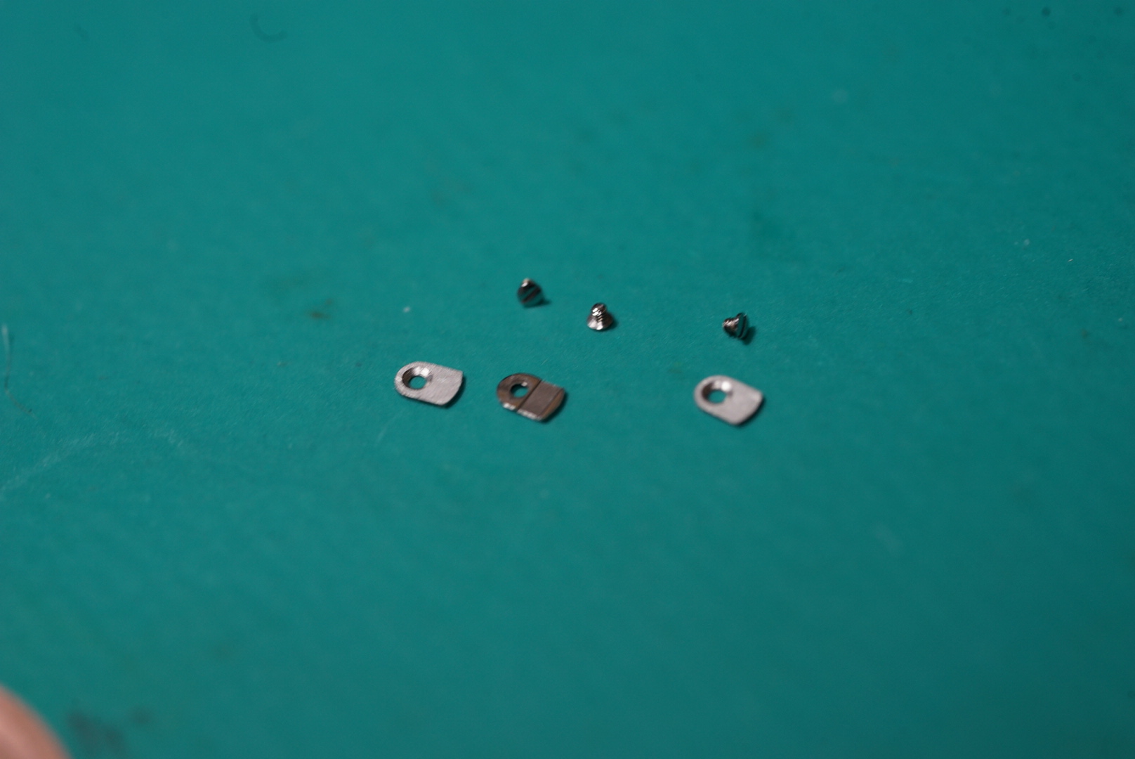

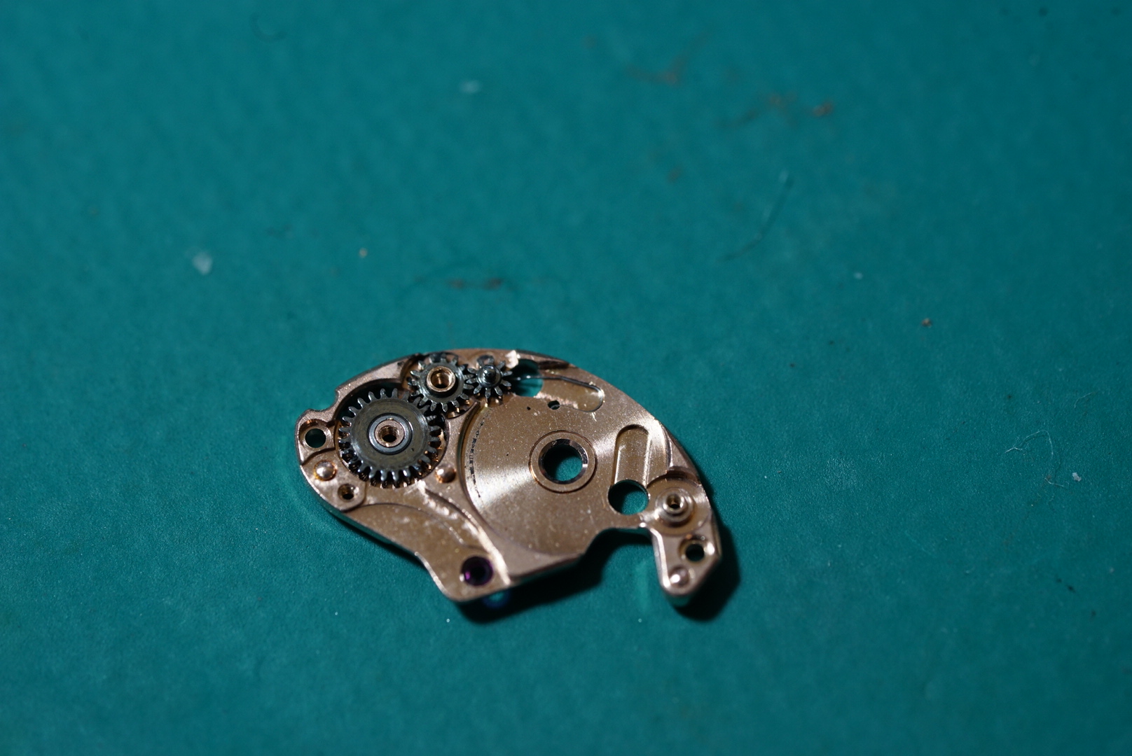

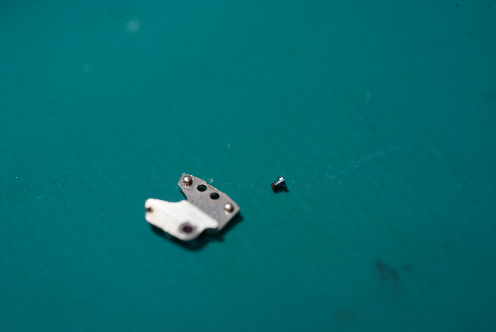

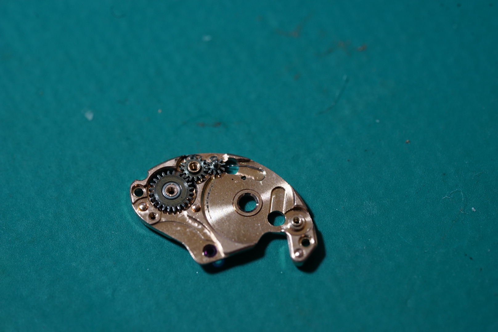

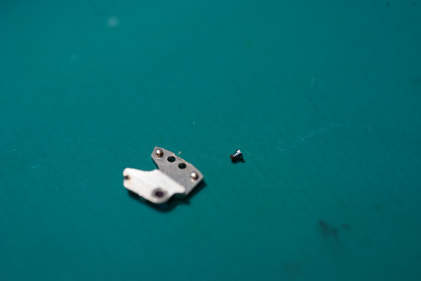

I am quite a bit worried about remembering which screws go where, but I'm hoping it will be more obvious than I expect once I get into it. And I'm going to try my best to keep the parts very well organized throughout the process.
I take photos of the bridge and parts along with the screws as I go, this allows me to keep track of what screws came from where.
Another handy thing to keep an eye out for is if the bottom of the screw has also been polished or not, as well as the shape of the screw head.
For example, most bridge screws have a flat head, and screws that go into the automatic winder modules from the bottom will often have polished bottoms as the bottom of the screw will show through on the other side.
Its also not a bad idea to take a photo of how everything went together just after you have taken a plate off, this way you can get an indication of whether a screw went in one way up or another.
If you forgot to take a photo, as I have done in the past you may find that watchguy.co.uk may have taken a photo of just what you need to know in the past, has certainly saved my bacon before.
Good luck!

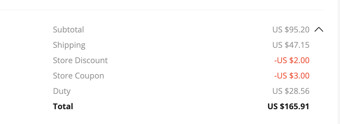

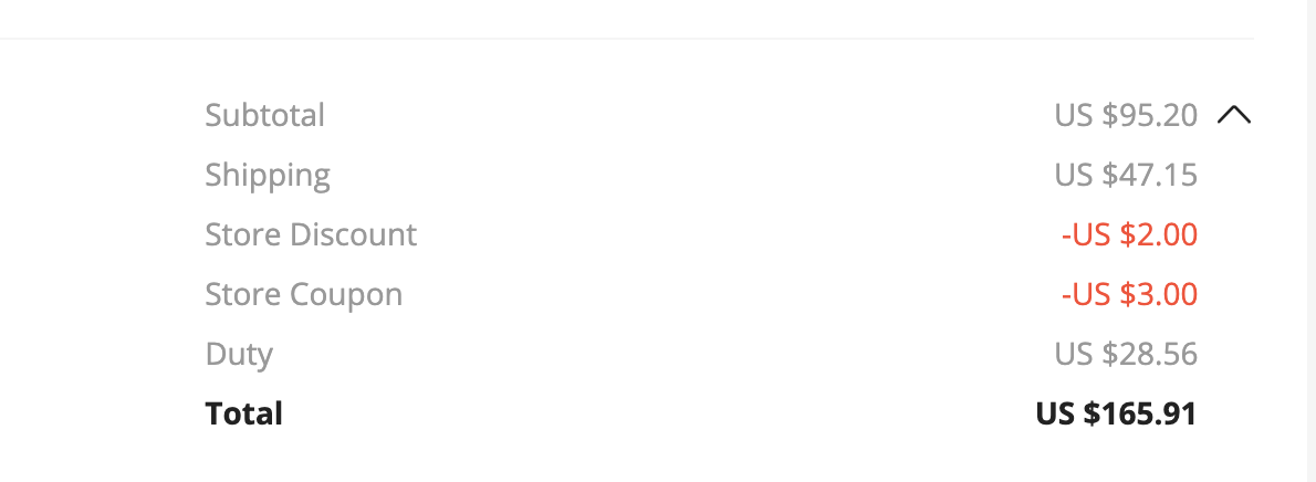

How much did you pay for them? A quick search on Amazon and the Caseback tools was minimum $150
https://www.aliexpress.com/item/32965681928.html
I pay 30% tax because I live in an extremely prosper country with an extreme amount of disposable income 😁

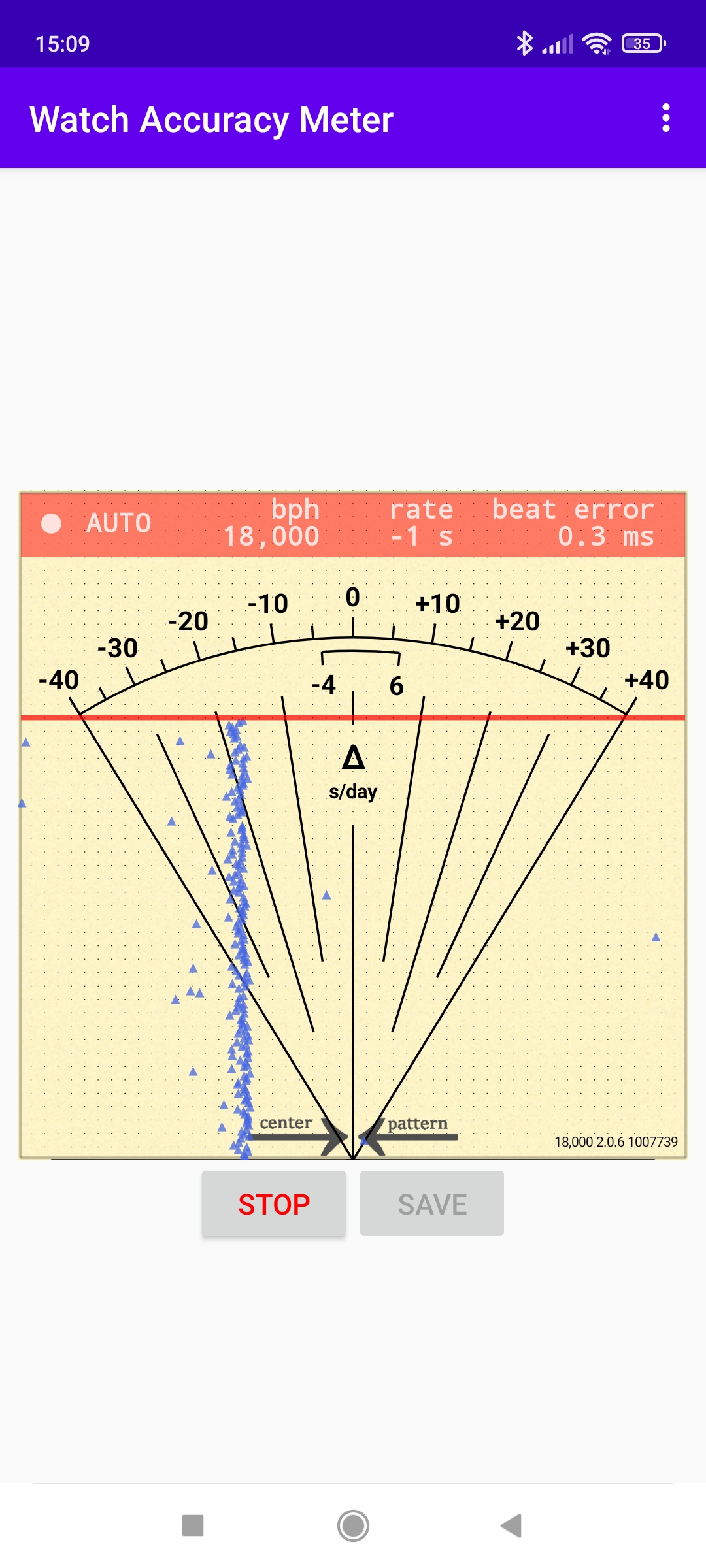

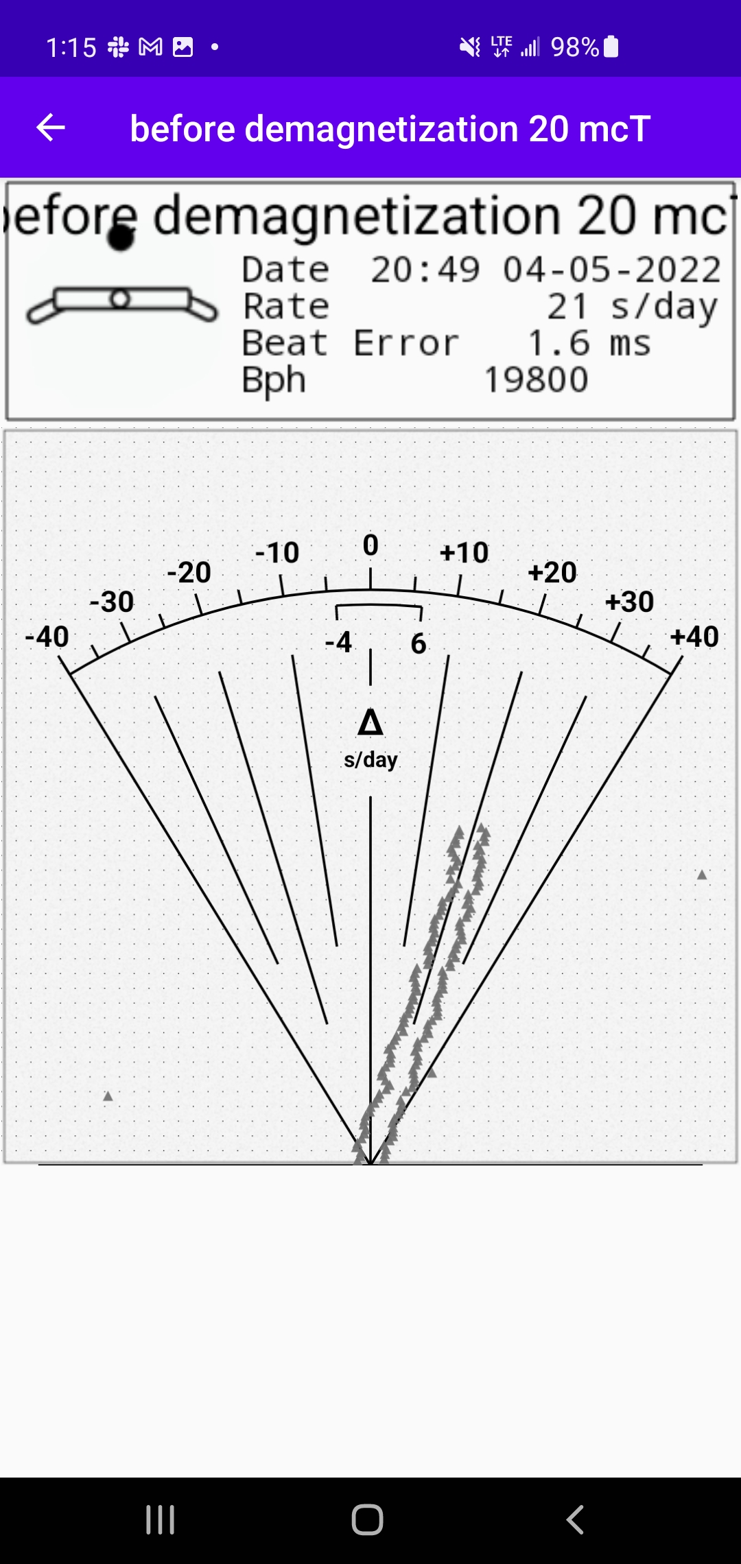

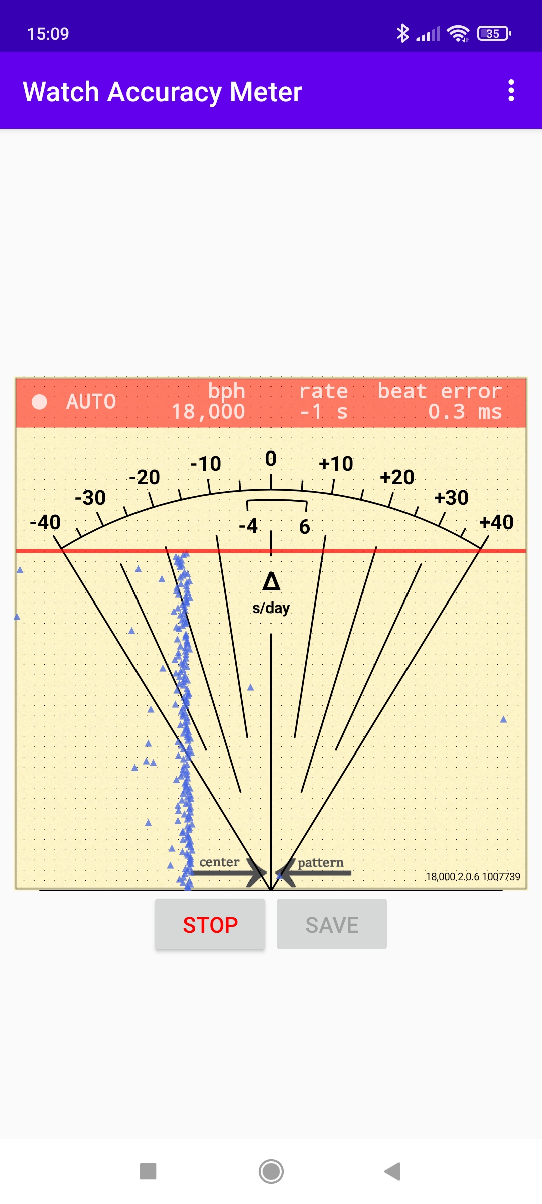

I recently came across this timing app for my phone. Now, while I do not expect it to take the place of a timegrapher it does seem to do a reasonable job to my untrained eye. Anyone have experience with this app, good, bad or indifferent?
I've been using that one, too. I sure wish my watch would give results like yours!

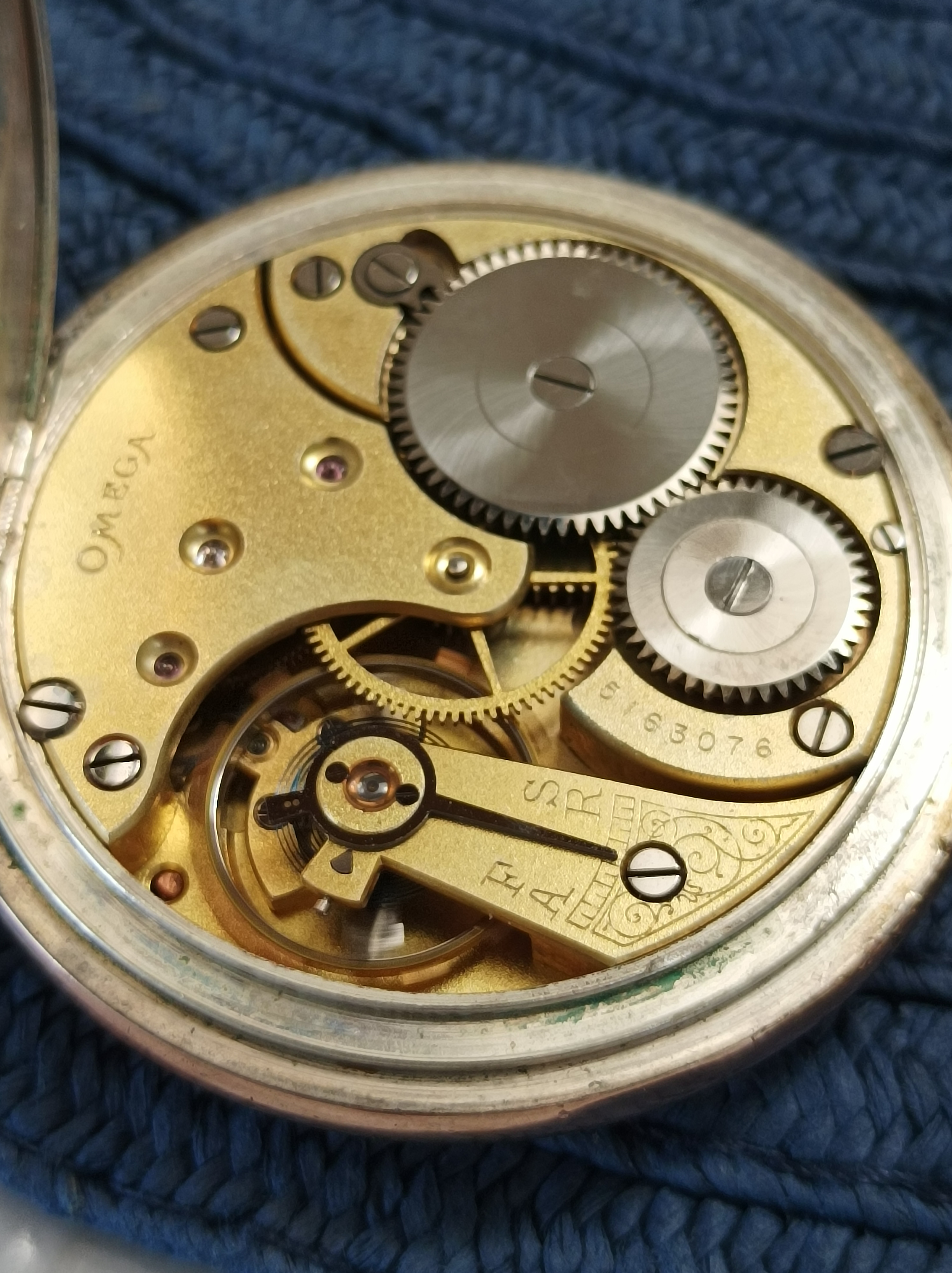

That was from a 105year old pocket watch too 😲, I guess which is why I was wondering, although the watch is very accurate worn 🙄over 24hrs it's not -1 sec, more like -8. Still not bad though and I think the app is good enough for non precision tuning

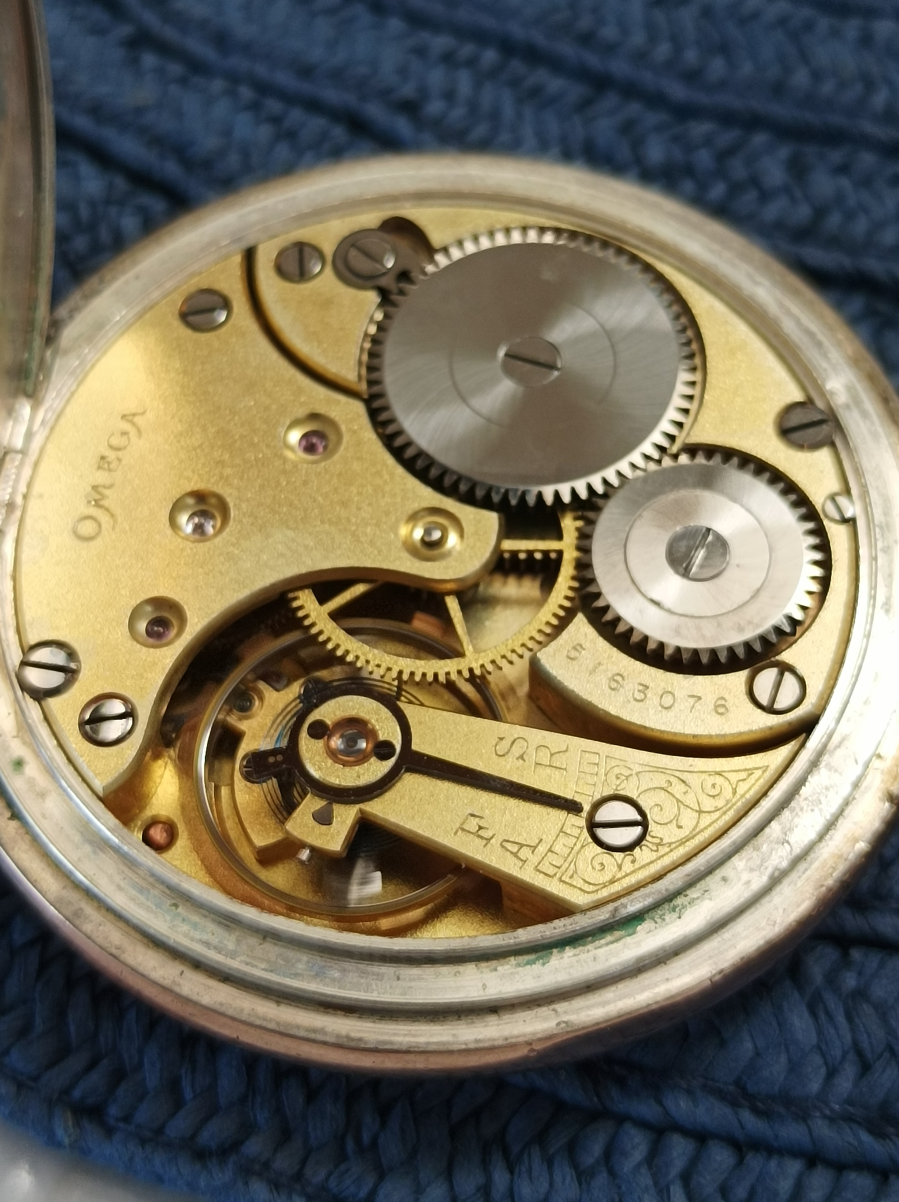

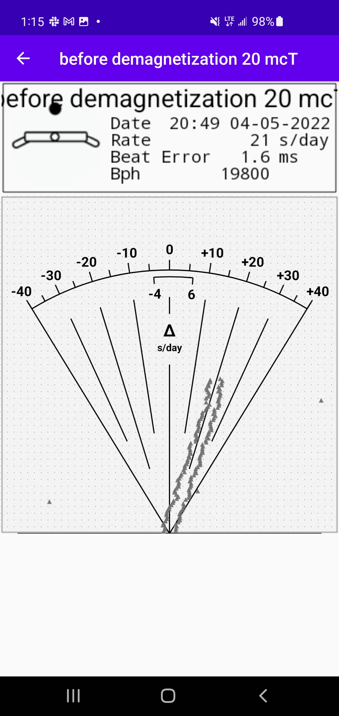

Here's a recent result from my cal 505 constellation. It needs a service. You can see the beat error.

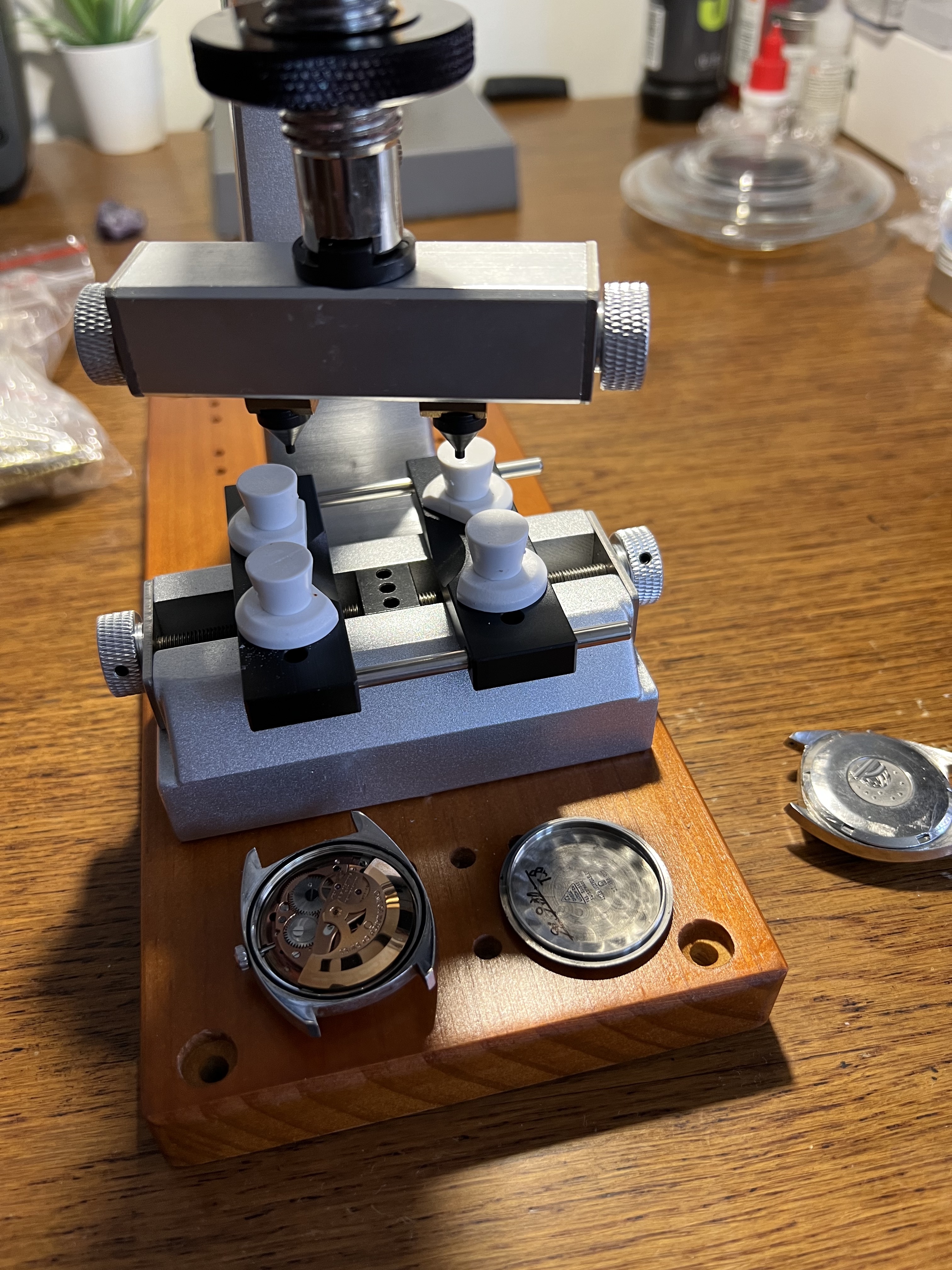

I think I'll ask my brother for help though, while I hold the movement vice still comfortably with 2 hands and position the dial, he can then gently pull the hands with the tool
For me, caseback opening was a 2-man job too (unless you have a big vice mounted somewhere, I had my brother push onto a drawer that we used as a vice, while I pushed down on the caseback opener so it doesn't slip) - so I really hope this new tool will allow me to open casebacks alone
Im planning on buying a small table vice instead. They go for around $20-40. I think i can clamp the case holder so it doesnt move and get two hands on the caseback tool. I haven't experienced a tough screwdown caseback yet though.

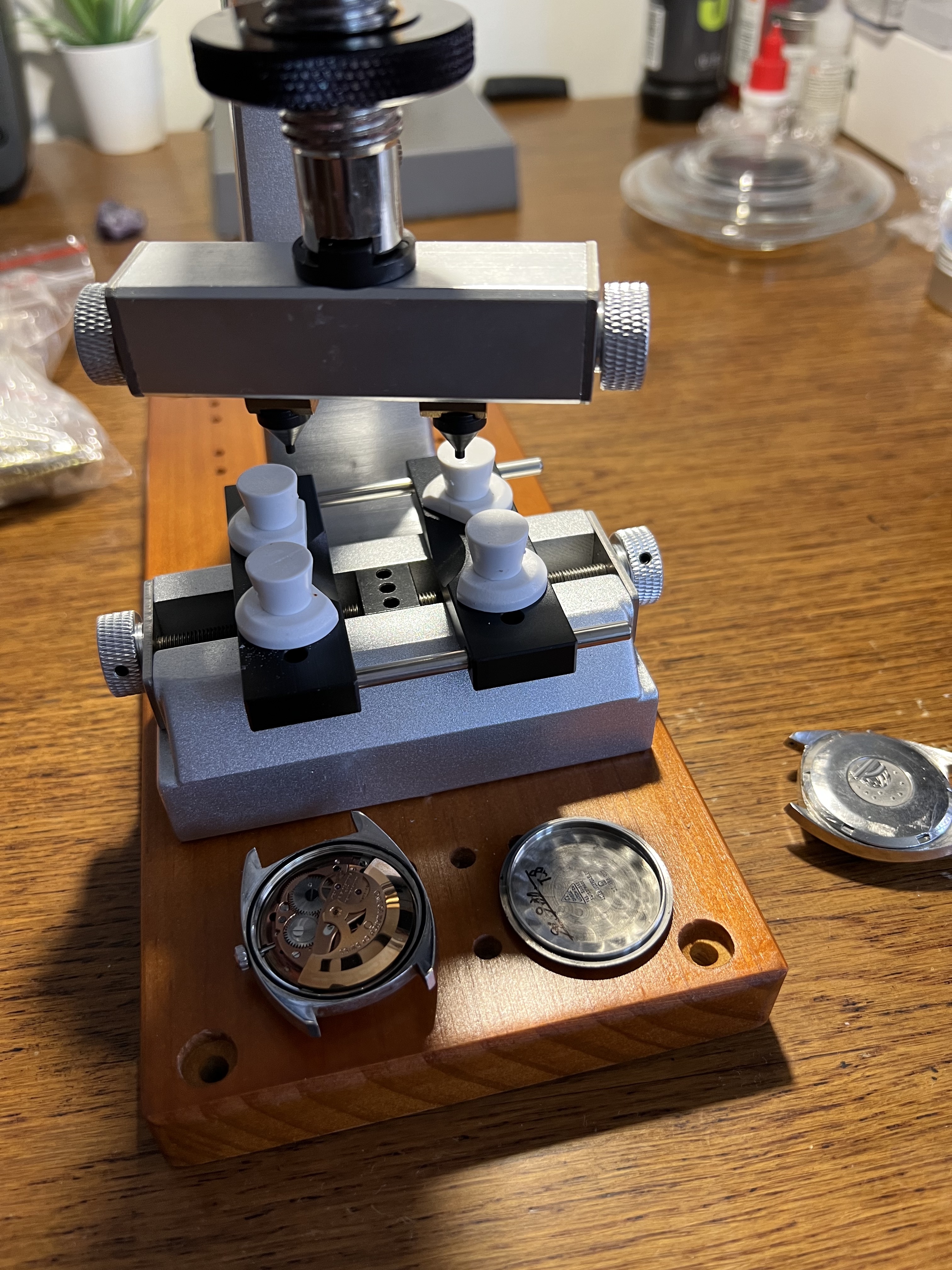

Also, i recently put in an order for one of these https://www.aliexpress.com/item/100...416525581205363513eaf80!12000028224824658!rec
The reviews on youtube seem pretty good. There are also aluminum dies that can be bought on aliexpress for an extra $30 or so when the nylon ones eventually fail.

That press is awesome, nylon ones indeed splinter, but I guess it's good because better they splinter rather than the watch splintering 😀
I'm in love with the caseback opener, arrived today 😁

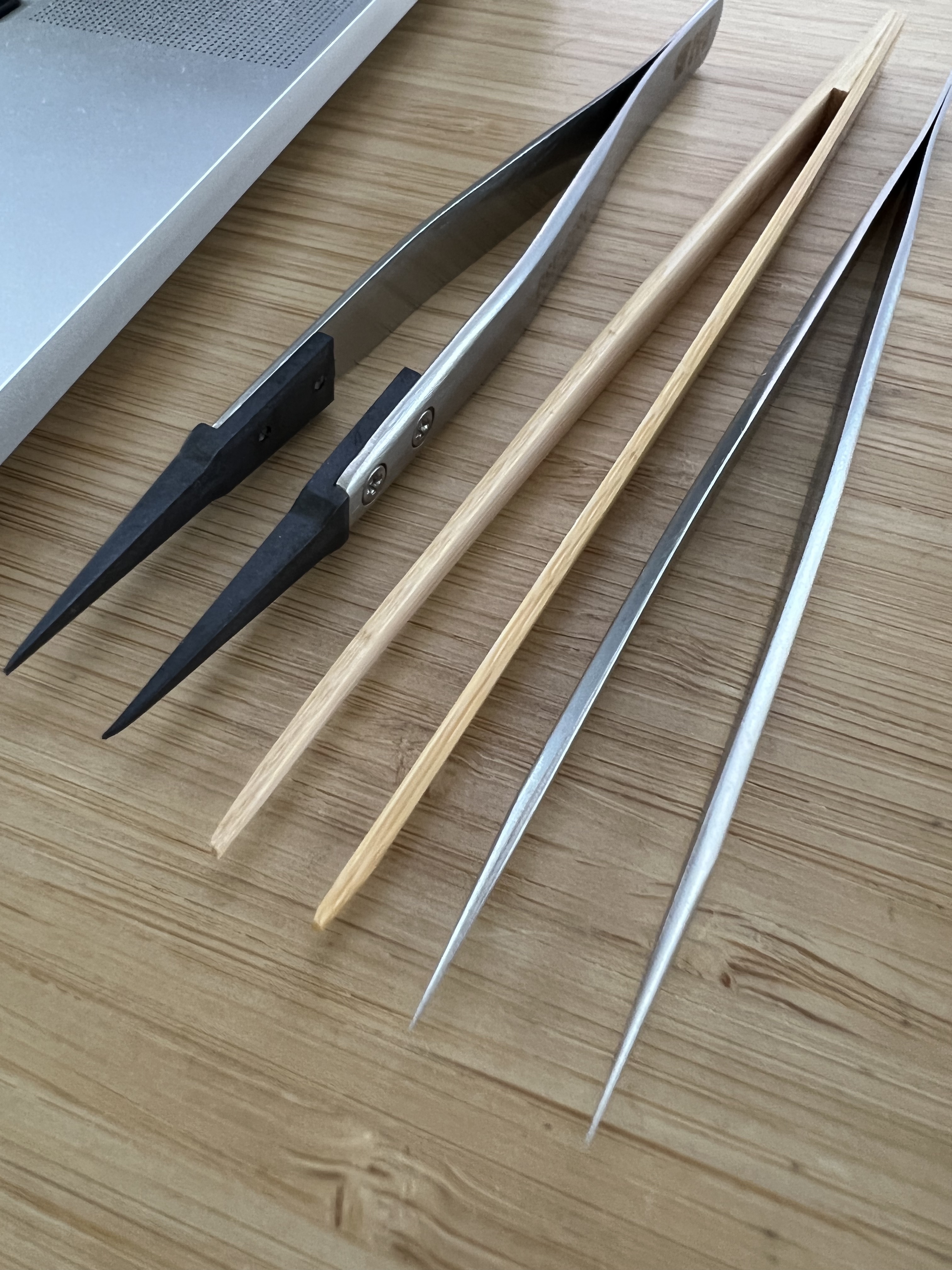

At this point my only regret is not buying an expensive screwdriver set when I first started, my beginner set is pretty good, I have a different spare beginner set, and at this point it just seems wasteful to buy yet another set

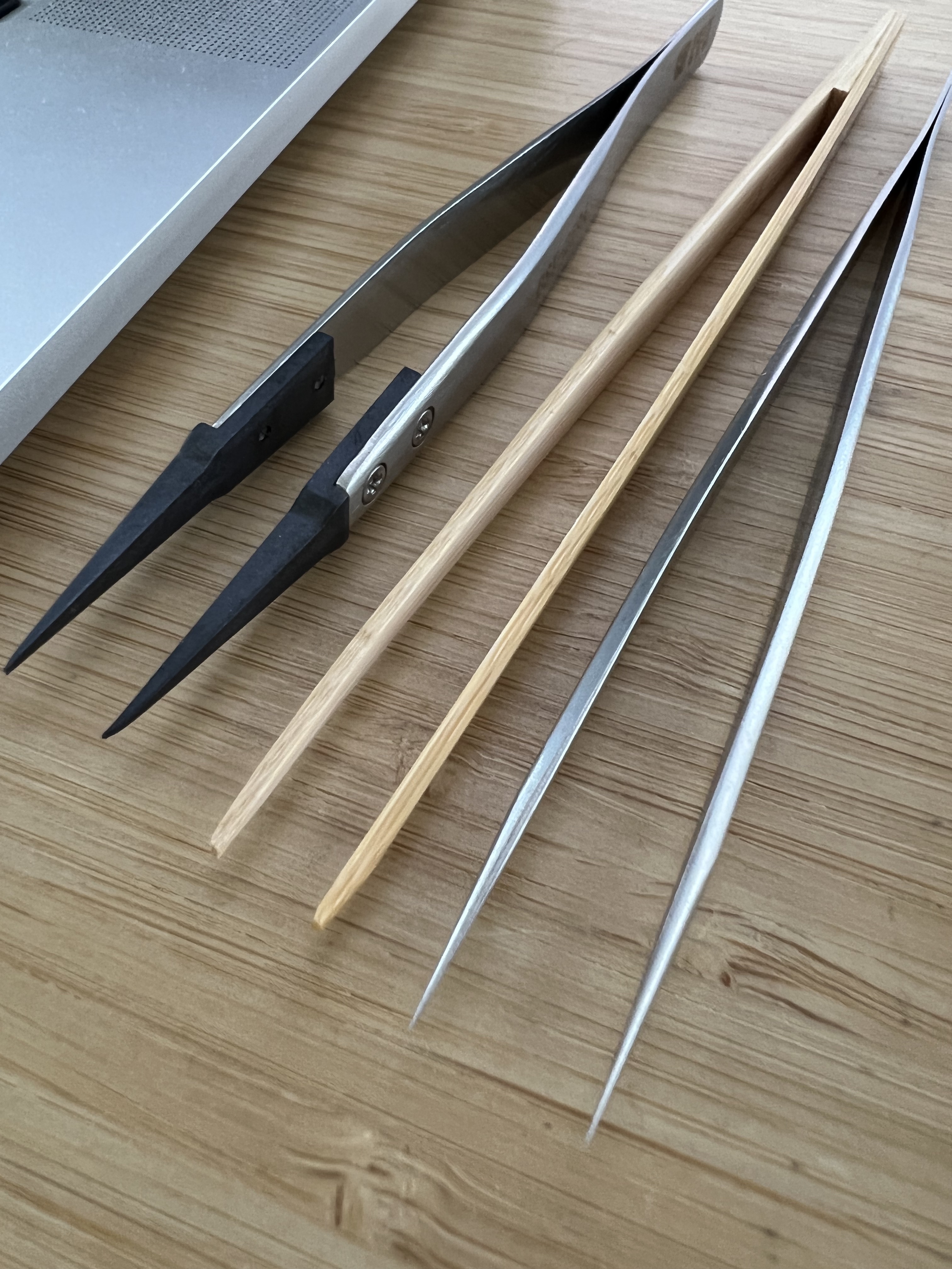

^ These are also like $5-ish on Aliexpress and the $7 set I bought compared to these is a child toy, never used them, I've been using a Pro's Kit tweezer I had, going to switch to the new plastic tipped one for most things (the brand is BST)
