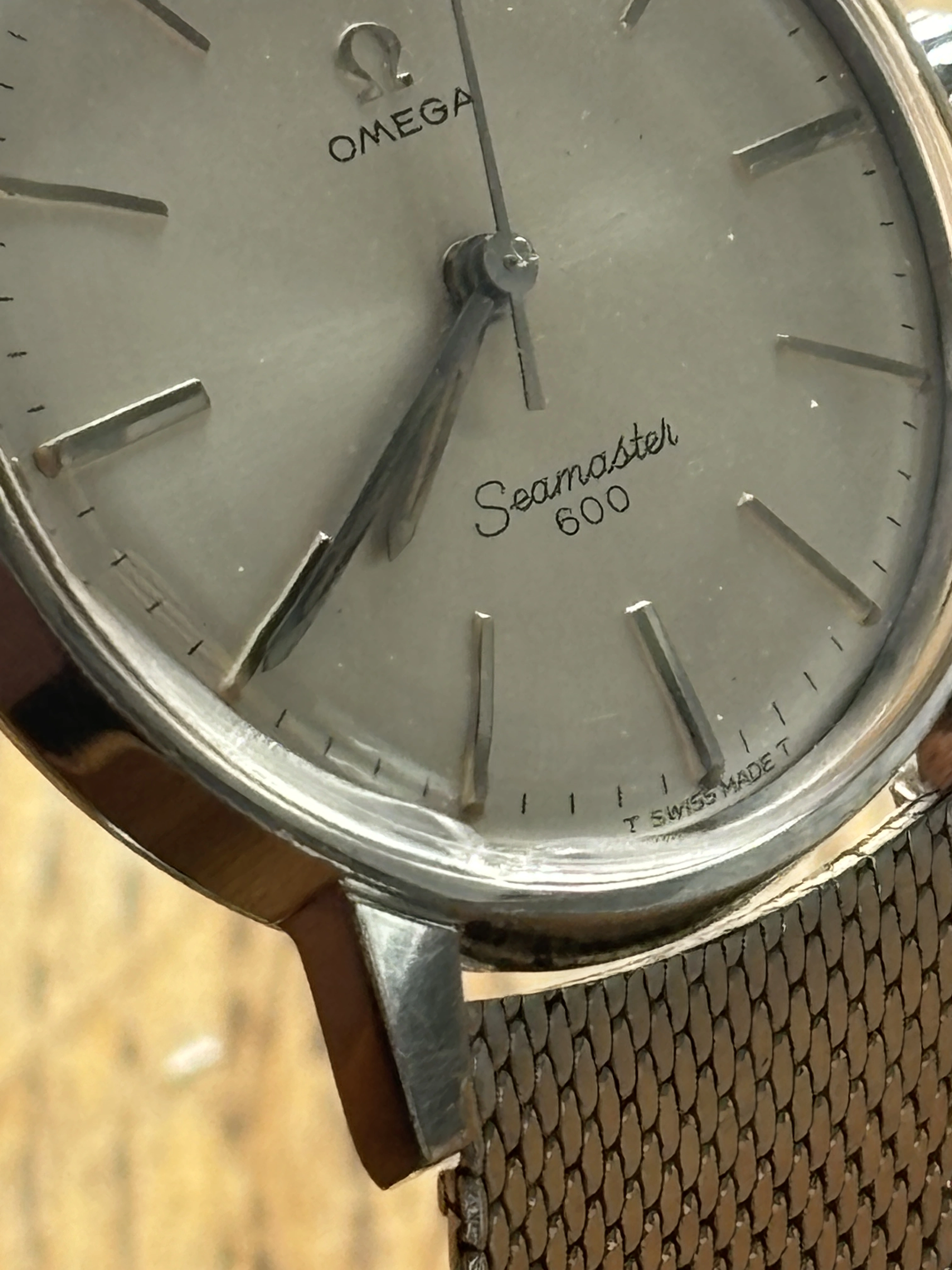

I recently had my Seamaster 600 and Constellation Pie Pan serviced by a local Omega-certified watchmaker here in New Zealand. Upon completion of the work, the watches were mailed to me last week as I do not live in Auckland, where the servicing was performed.

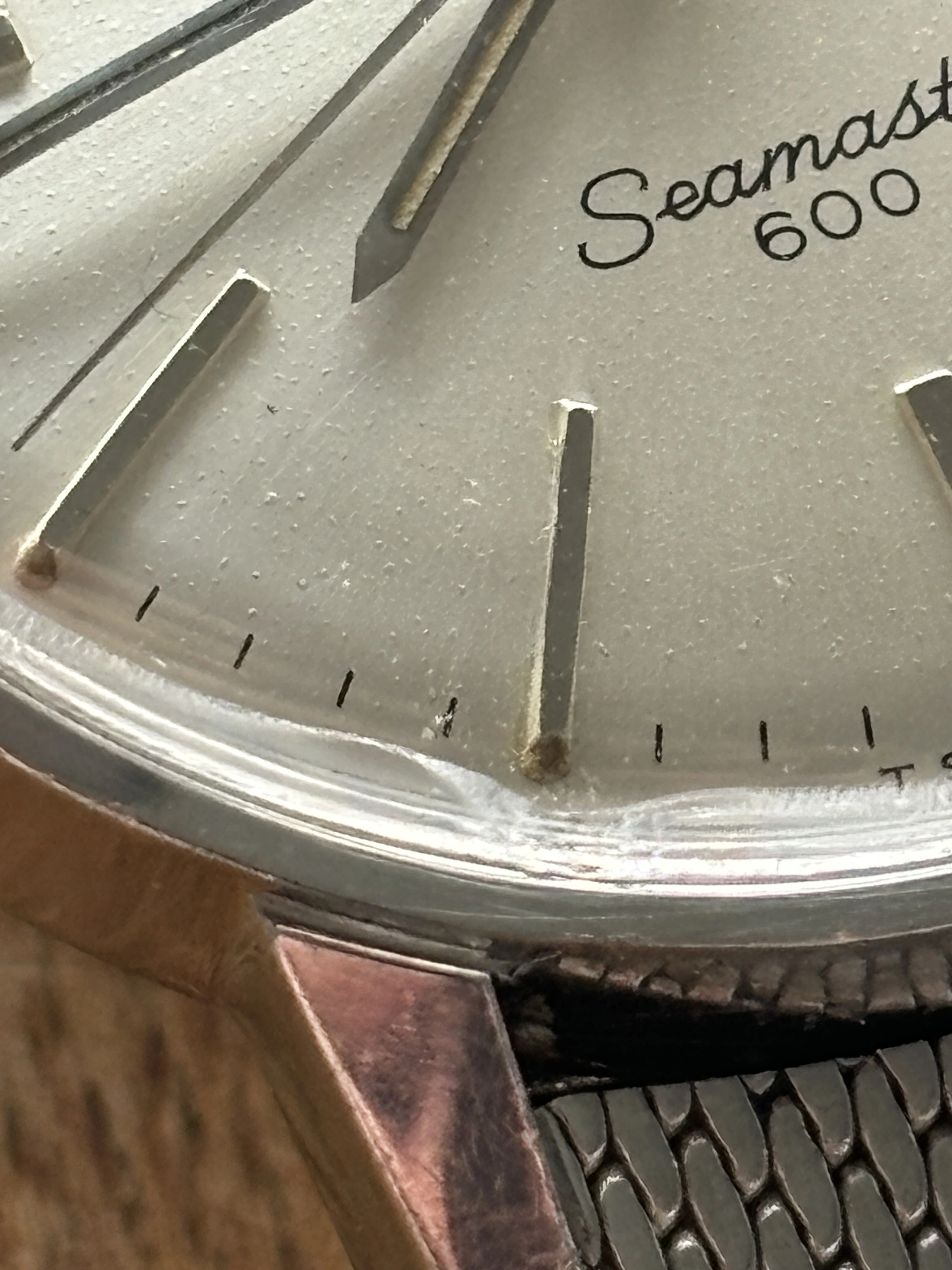

Upon opening the package, I noticed a small crack in the crystal of the Seamaster 600, which is peculiar considering the watch was well-packaged, and the delivery box showed no damage. Additionally, the Constellation was changing date at 2:30 am, which is annoying but manageable. However, the cracked crystal is a more significant issue which needed addressing.
I have had previous issues with this specific watchmaker but returned to them due to their satisfactory rectification of the last two mistakes. These included snapping the chronograph hand on my 145.022 76 (without informing me) and failing to tighten the chronograph hand sufficiently on my Flightmaster, causing it to reset to 58 seconds.
As a result of these four issues, I felt I had endured enough with this watchmaker and decided to end our working relationship and sent the 600 to another larger Omega-certified watchmaker in Auckland (as there are no such options locally).
I informed the second watchmaker that I only required a crystal replacement, as the watch had been serviced a week prior. Today, they provided a quote of NZD$580 (USD$332.42) as the watch needed a new crystal, crown, and gaskets. Considering I had just spent NZD$905 (USD$530) on a full service, I was quite shocked.
The second watchmaker explained that they replace gaskets every time a watch is opened, which seems excessive given the recent service and brand new gaskets. Additionally, they claim the watch needs a new crown, which further raises questions about the first watchmaker's workmanship and the larger watchmaker's practices of potentially charging for unnecessary gasket and crown replacements under the guise of waterproofing.

I will just say that it makes sense to replace the crystal gasket when replacing the crystal. The rest, I don't know.

My first reaction was -fυck that! But then thinking about it - factory crystals for all omega watches have shot up in the last few year- I don’t know the pricing but $100US wouldn’t be out of reality anymore. Crown is probably around $50-75US, gasket $10 (we are taking about Omega parts costs- not Cousins rubber band specials) and an hour of their time which for any specialty trade is probably around $100-150/hr these days, think about how much it costs to change the oil, replace a CV boot and do a standard inspection on a German car at a certified independent shop- about the same.
I say pay the shop, lick your wounds and find a new watchmaker. Several on this forum in NZ- perhaps not Omega certified, but competent and qualified and have access to parts.

Thanks for your responses. @JwRosenthal
Although I did mention costs entailed, I'm not questioning the expense, more the practice of dumping a caseback gasket that was inserted only a week prior, and the fact that the crown also needs replacing after a supposed 'full service'... I find the whole thing questionable, and just wanted to see if that feeling was justified.

Of course- I agree about the back gasket (crystal doesn’t have one- it’s a pressure fit acrylic) but I understand that (to use cars again) some companies consider fasteners a one-time use and will replace every fastener they remove from trim or covers etc. If they don’t know the age of that seal (considering your former watchmaker was a little questionable to begin with) and it leaks while under their warranty period- then they are on the hook. It’s cheap insurance for them that all the waterproofing parts are indeed waterproof.

If the gasket was just changed, there is no reason it needs to be changed again. Rubber gaskets are multi use items. There are certain case back gaskets on some Omega models that are a nylon style that are one use only, they need to be changed to ensure waterproofing.
Couple of things to tackle here - first, if you want to keep everything original and not make it water resistant, that is your right to do so. I do a lot of work for people who want everything original and we leave it as-is. They need to know that the watch won’t be water resistant, the invoice states that and we move on. I’m talking collectors here. Omega don’t give you that option, but an independent Omega watchmaker will.
The second thing - I get a lot of work come through my shop that has been to other watchmakers. Even after the watch has been ‘fully serviced’ I tell the customer it needs to be done again, and I’ll provide photographic evidence of why. Had it happen twice this month with 2 Omega’s.
I’m not giving a guarantee on someone else’s work. The age old story, “sure, I’ll do just that one part for you as it was recently serviced” I say. Customer comes back “my watch has stopped working, it was working great before I took it to you, and you touched it last!” The watch was never working well and I happened to touch it last, so now I’m fighting about a job I made $50 on. Perhaps the shop you have them with now are worried about this and are trying to avoid it.
Advice - cut your ties with the old watchmaker, and possibly the new. Find someone you can have a conversation with about what’s wrong, what needs to be done to fix it and how to move forward.

Do know that a service crown will be the modern cylindrical with fine splines style and not the petal style you have now. Since they already have your watch, if you don’t care about waterproofing and want to keep it original- just tell them to keep the original crown on there and sign whatever waiver releasing them of their liability.
Eat the few bucks on the rear gasket and have them do the crystal. Then send the bill to the former watchmaker and tell them you expect reimbursement and why yo chose not to send it back to them.
