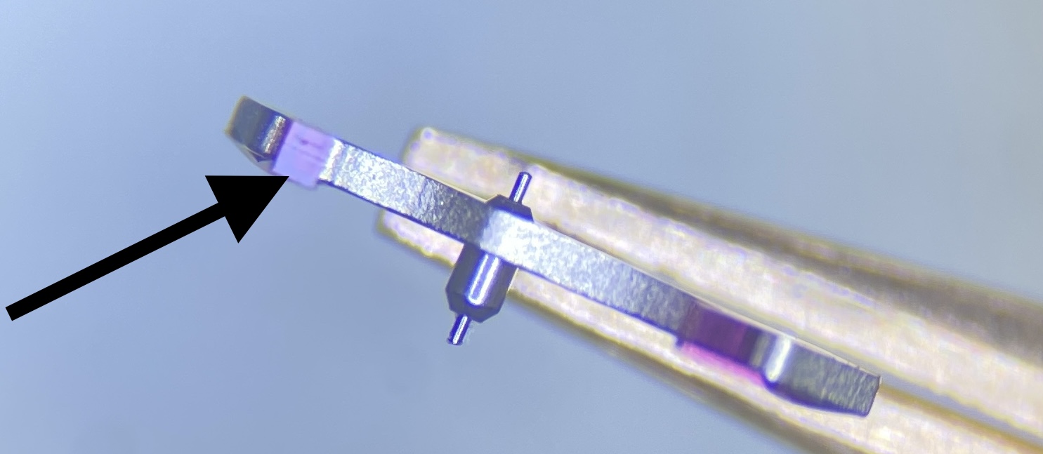

It’s always going to be a difficult dance, and a tough one to figure out. As an example, here is a pallet fork from an Omega 552.
You can see a groove has been cut into the jewel. I have chosen to change this parts, but others may not. Will the watch run without it changed? Absolutely. It won’t run as well and many people will never notice it or care about it. That’s not how I work though. I like every 100% correct, where possible.

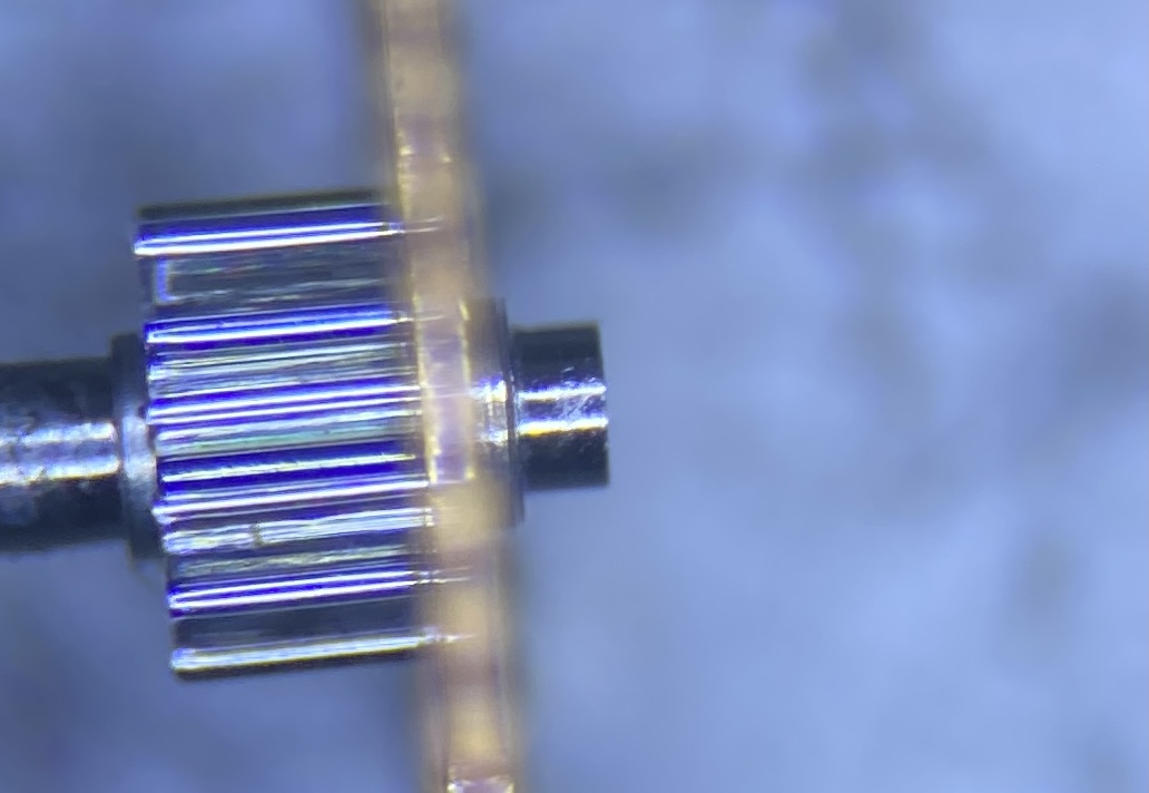

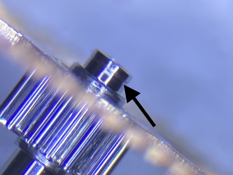

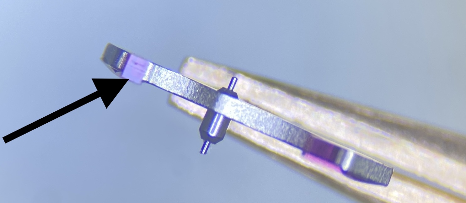

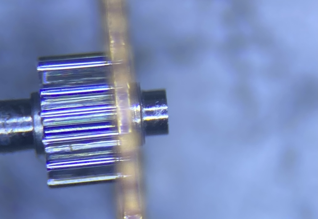

Same thing for this train wheel. You can see a groove has worn into the pivot.
Would the watch run with this wheel put back like this? Yes, but again it won’t run as well. The choice here was to polish the pivot, not replace.
