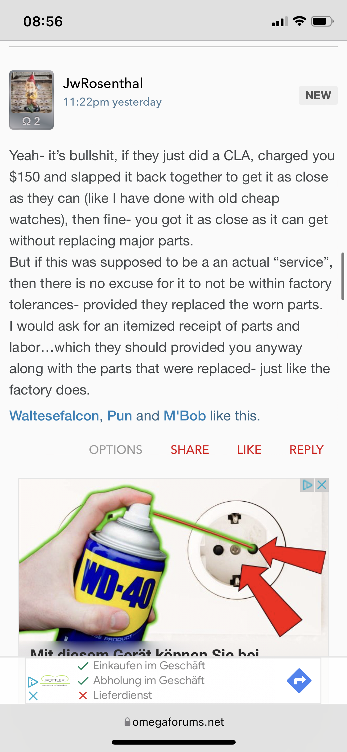

Yeah- it’s bullshit, if they just did a CLA, charged you $150 and slapped it back together to get it as close as they can (like I have done with old cheap watches), then fine- you got it as close as it can get without replacing major parts.
But if this was supposed to be a an actual “service”, then there is no excuse for it to not be within factory tolerances- provided they replaced the worn parts.
I would ask for an itemized receipt of parts and labor…which they should provided you anyway along with the parts that were replaced- just like the factory does.

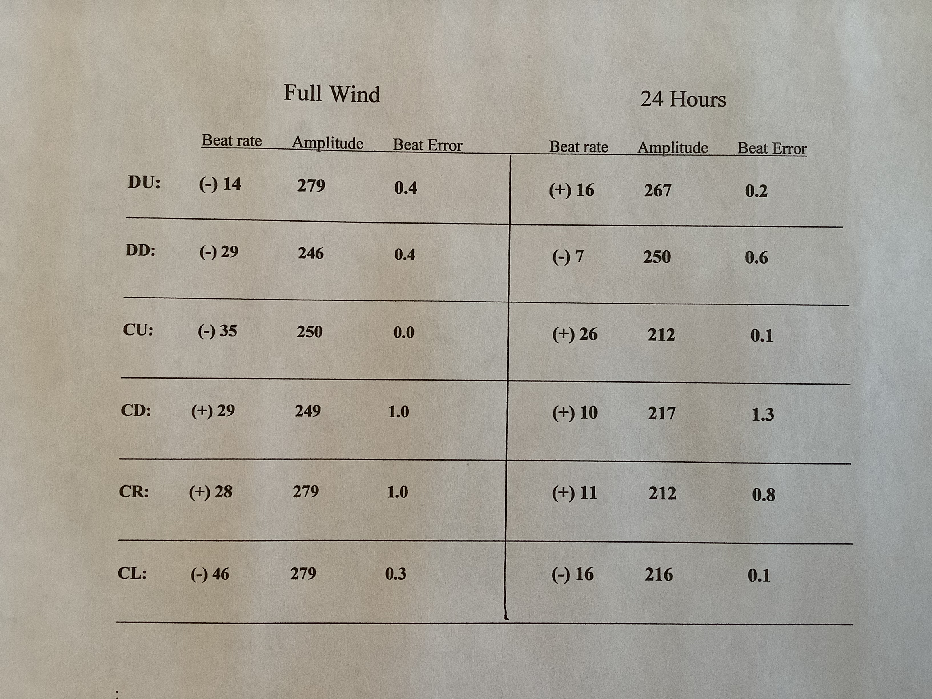

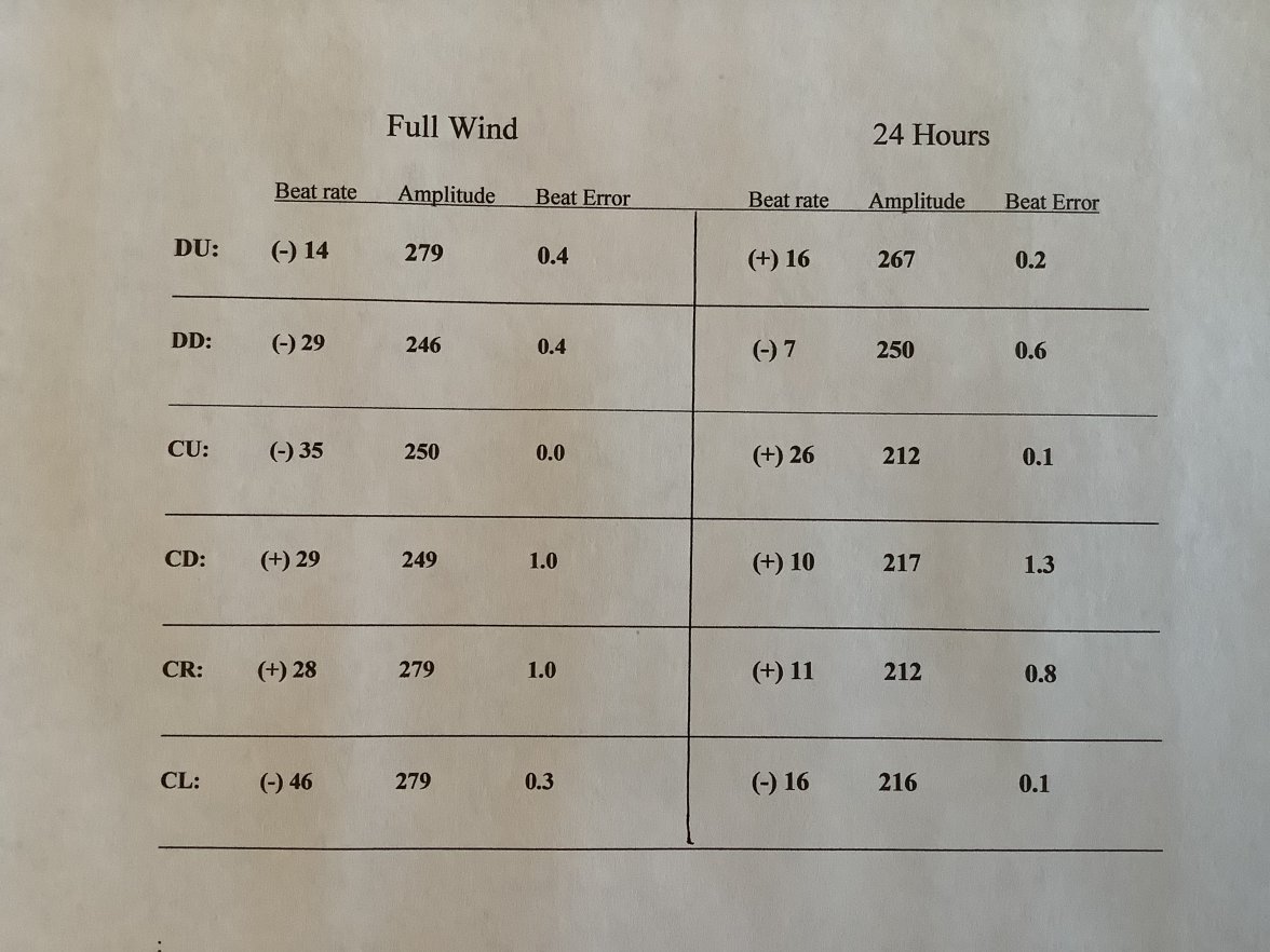

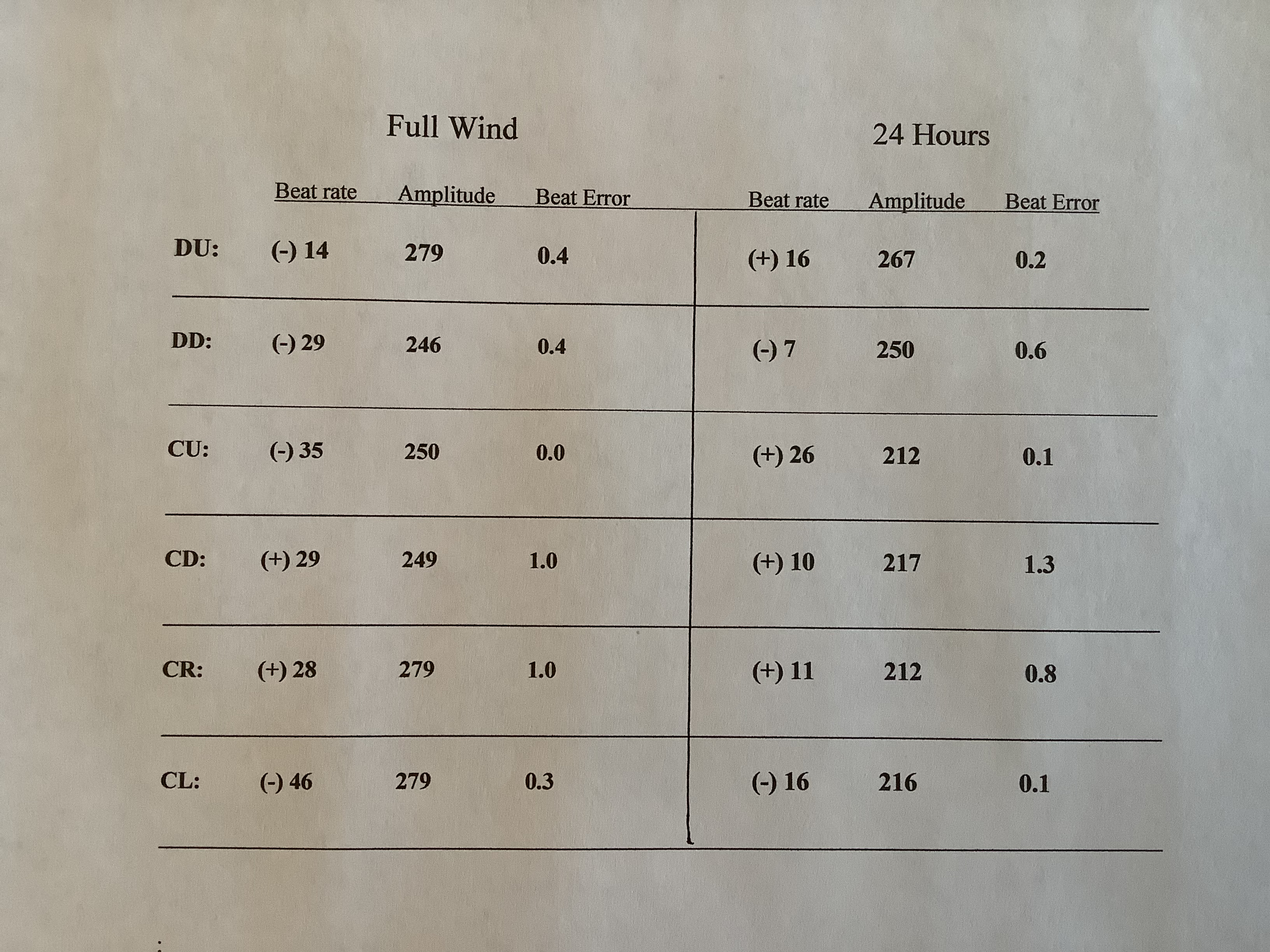

They sent me this, as if to show, “Hey, great rate, huh?” Really?

I am guessing they may not have attempted to address those issues.
Still trying to sort out if they think they can..

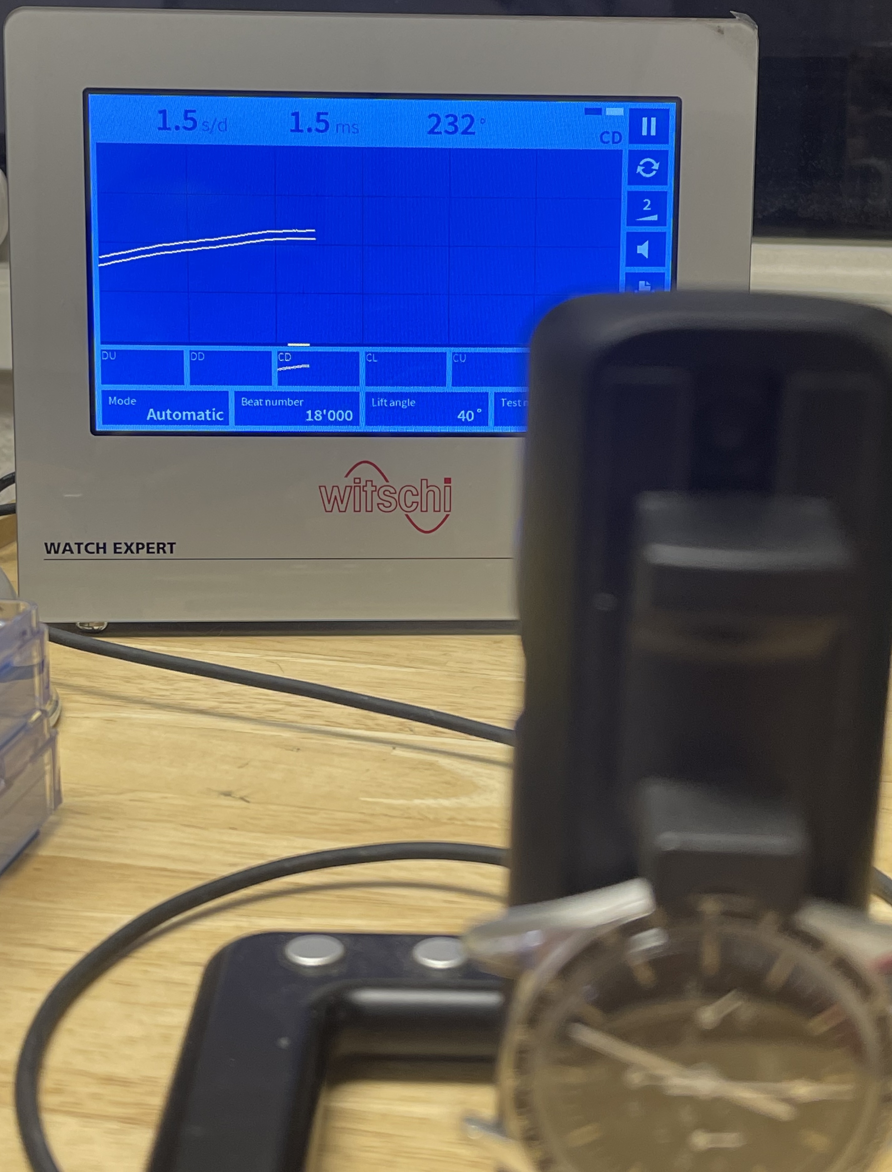

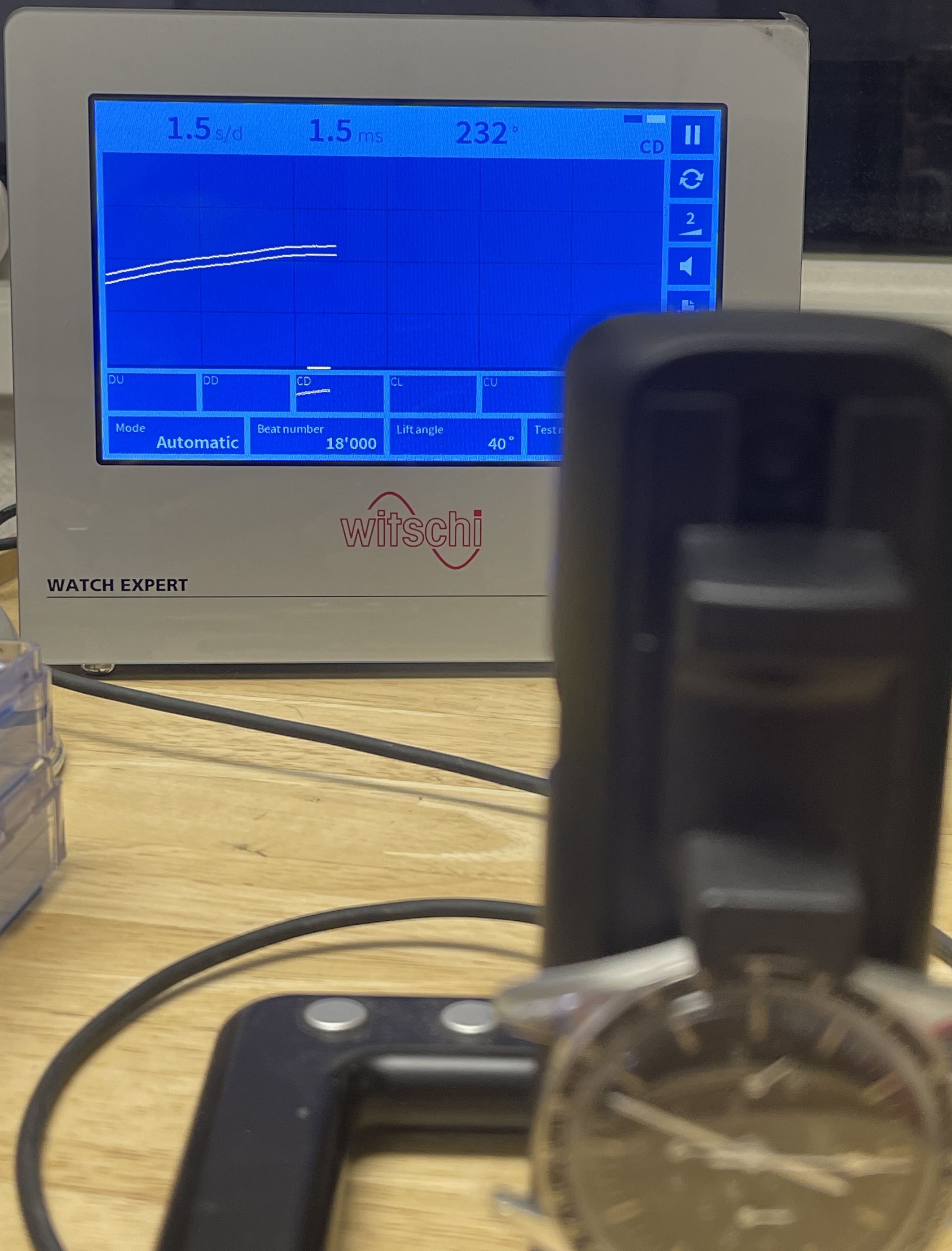

Take a look at the timing results after I immediately received the watch. When I showed it to them, they told me to “demagnetize it.” also of note: these were generated with the wrong lift angle of 52 degrees. You would think they would know better..
