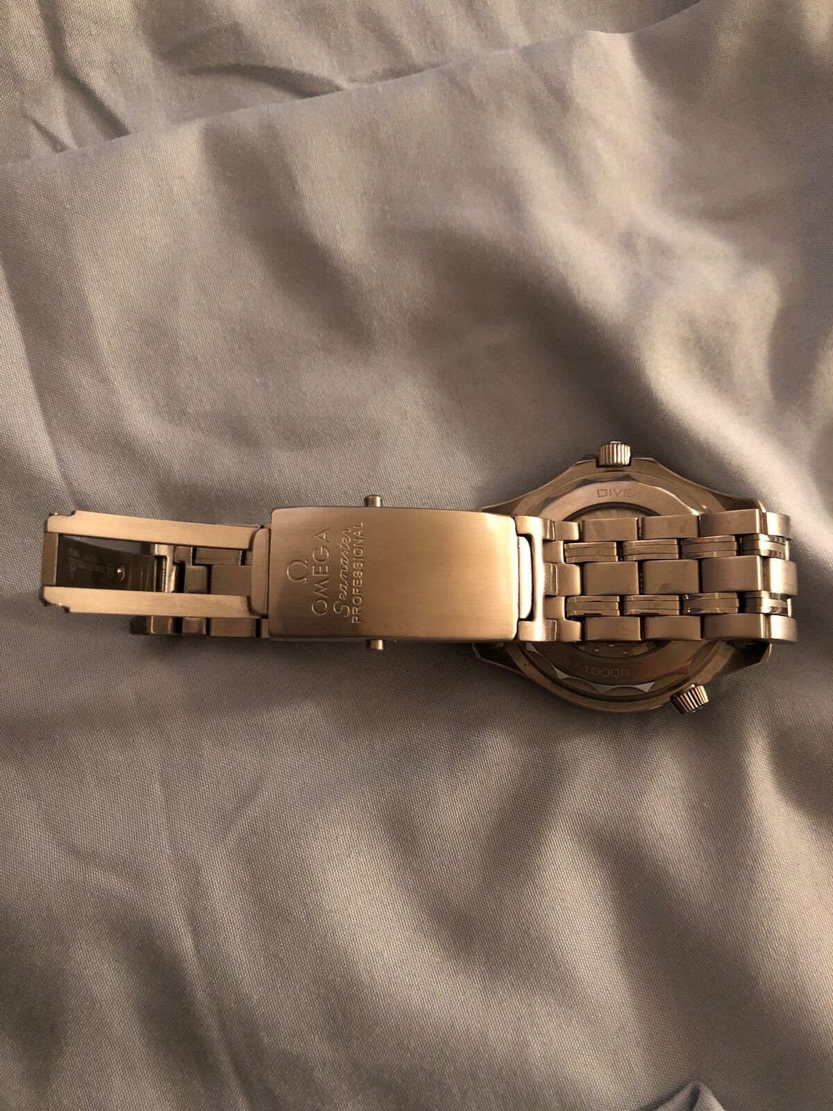

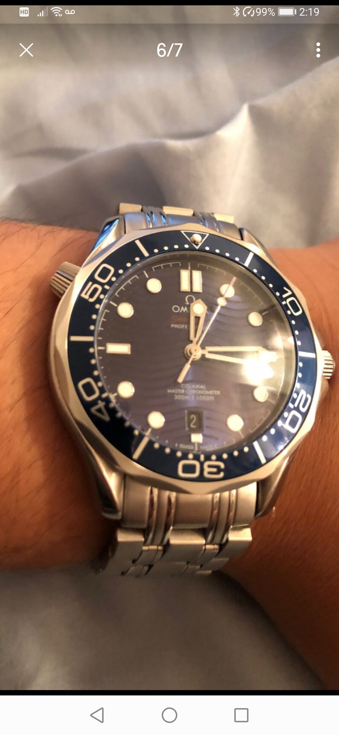

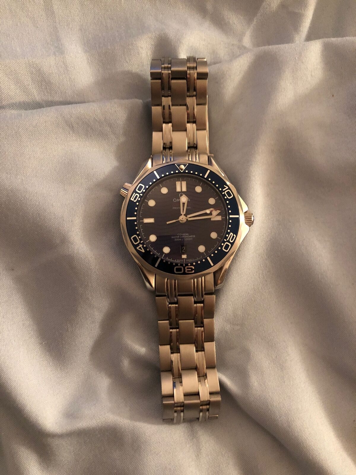

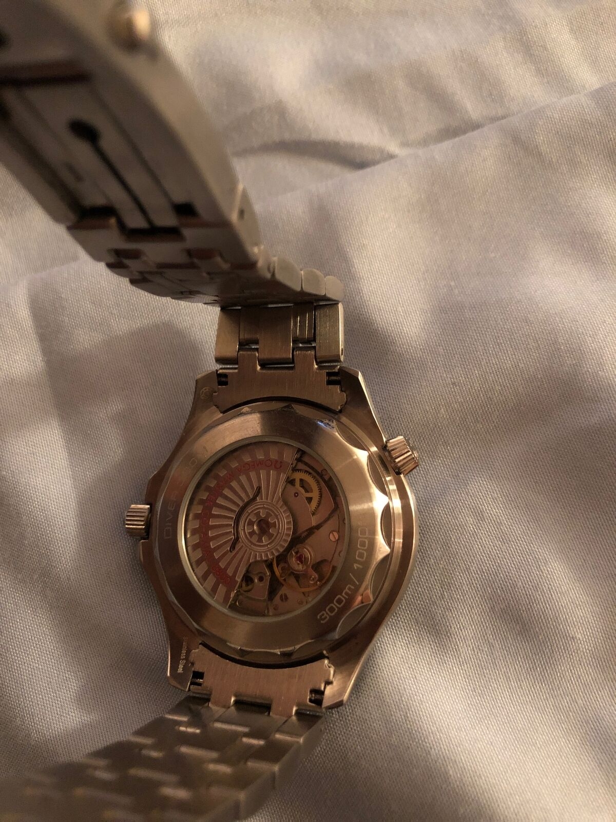

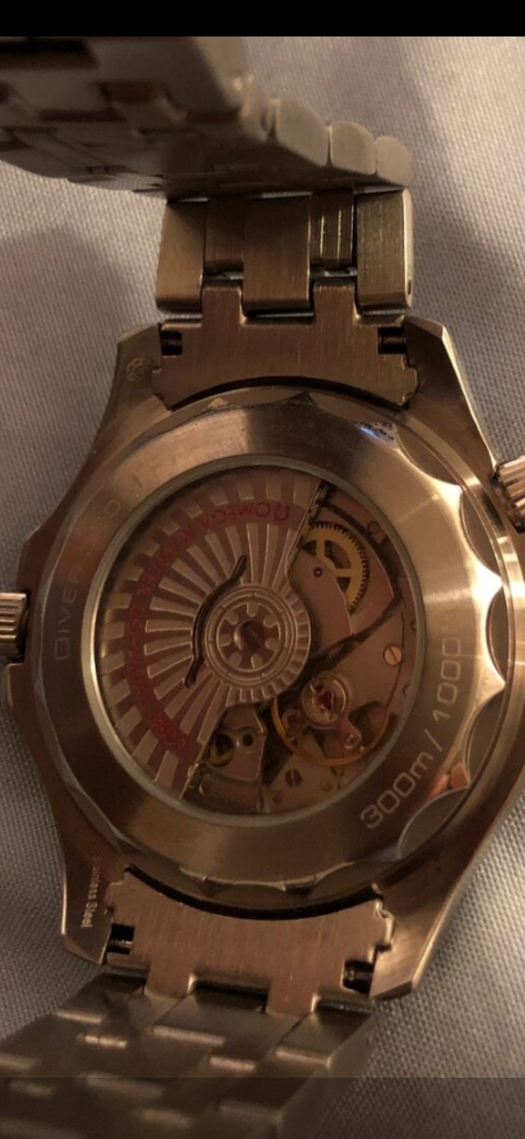

How's this seamaster? Legit?
Looks like a bad fake. For starters: the bezel looks like it has an aluminum insert (should be ceramic), the lume pip is hideous (very protuberant and extending beyond the triangle), wrong bracelet clasp, and HE valve is in the wrong position. And that’s just what can be seen with these poorly lit garbage photos.

Yeah. Second this. An easy way to pass off a fake is In garbage lighting... where any watch would look equally bad.

Among other things, the engraving on the clasp is poorly done. It looks more like “Seanaster” than Seamaster. That and the lines of text don’t align.

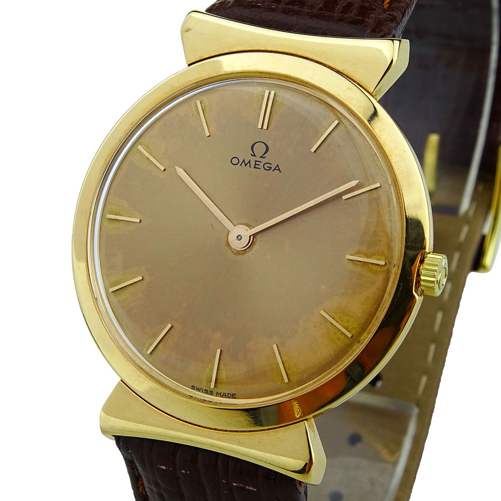

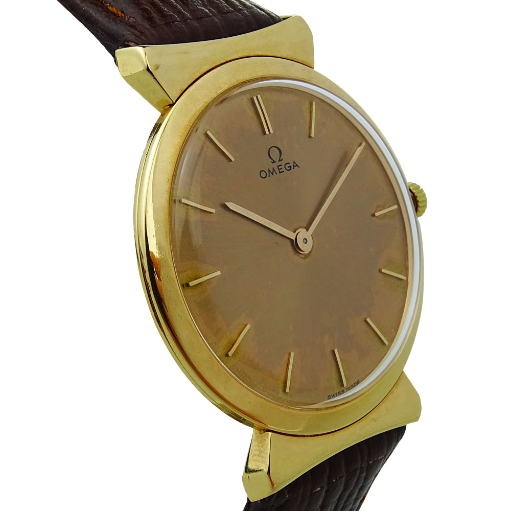

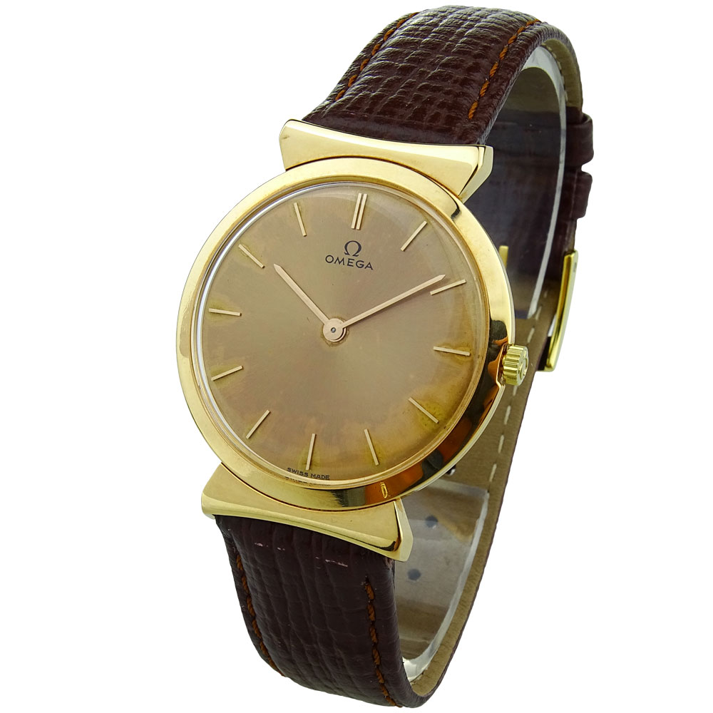

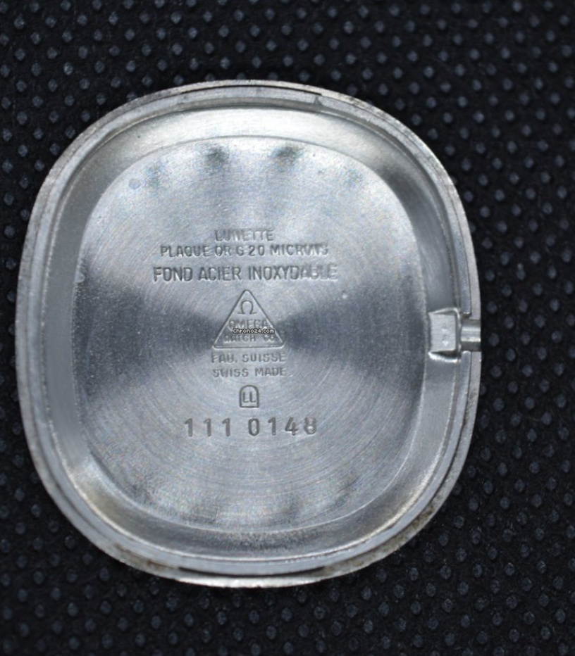

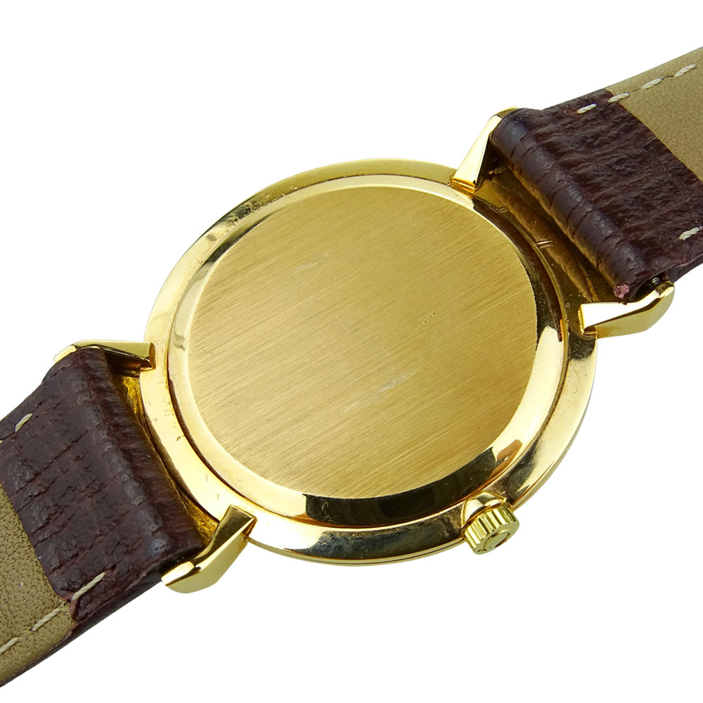

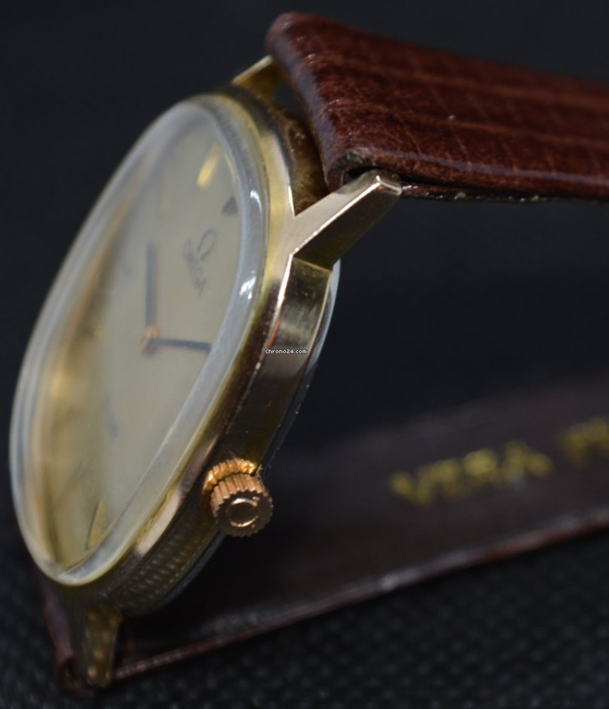

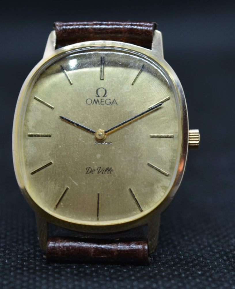

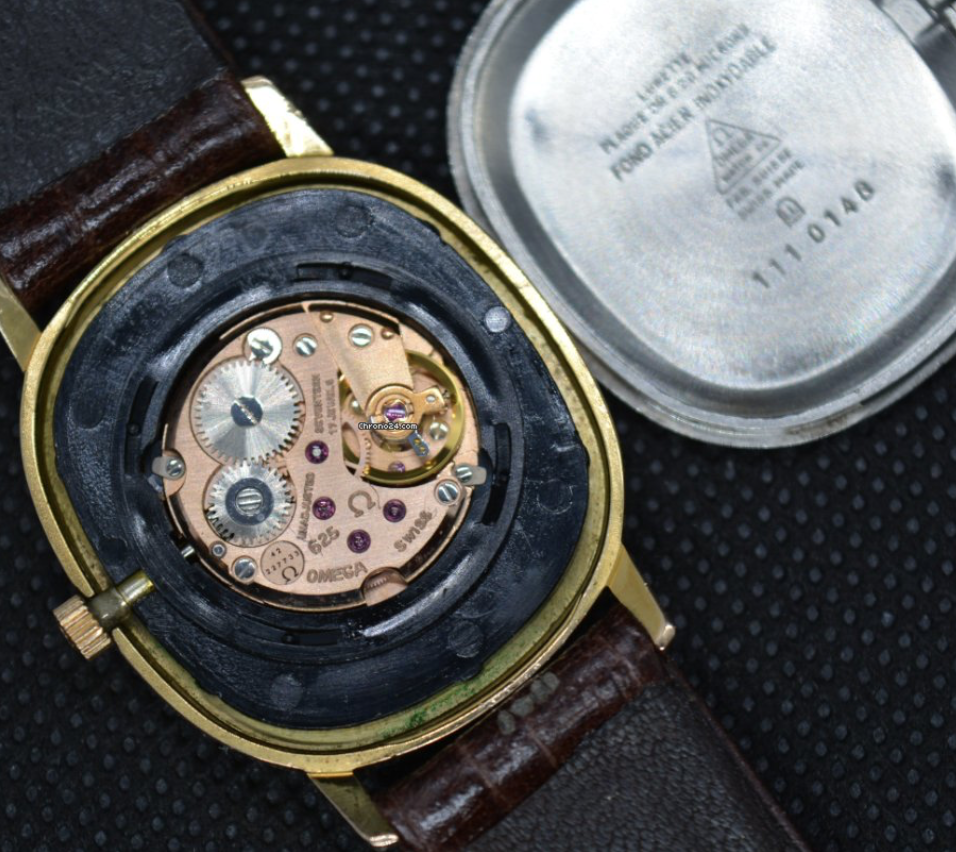

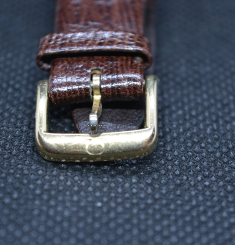

Hi friends,
I am planning to buy an Omega de ville to father for his birthday. I compare this pics with other referecens and it looks legit. Nevertheless, I am quite knew in vintage watches, and I would appreciate if someone can help me to check if this Omega is fake or not.
Also, it is possible to restore the dial?
Model: De Ville
Reference number: 111.0148
Movement: Manual winding
Case diameter: 32 x 35 mm
I would appreciate any help!
Thanks in advance!

First the answers.
Yes it is completely genuine.
No, it is not possible to restore the dial to an original finish/quality.
Now my thoughts.
This watch is gold plated (only 20 micron plate), has a ladies caliber, will probably require servicing, and was made at a time when Omega was in deep doodoo following the quartz crisis so they produced anything they thought would sell.
If you really want this model, there are better examples available, but I would look for something else.
