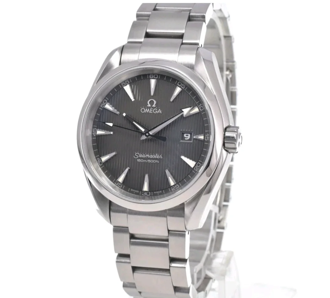

Hi. I'm looking to get my first Aqua Terra. Currently own a Peter Blake in electric blue and looking to get a more modern daily wear watch. I settled on the quartz Aqua Terra in grey teak due to budget and wanting to keep service costs down.
I found this 231.10.39.61.06.001 watch from Japanese seller on Chrono24/ebay with a lot of positive feedback. Price after tariffs ($2000) is about the mid range for a good condition watch having warranty cards but no box.
I've done some basic online research on spotting counterfeits but would appreciate some advice because I've never seen a grey teak in real life. Thanks

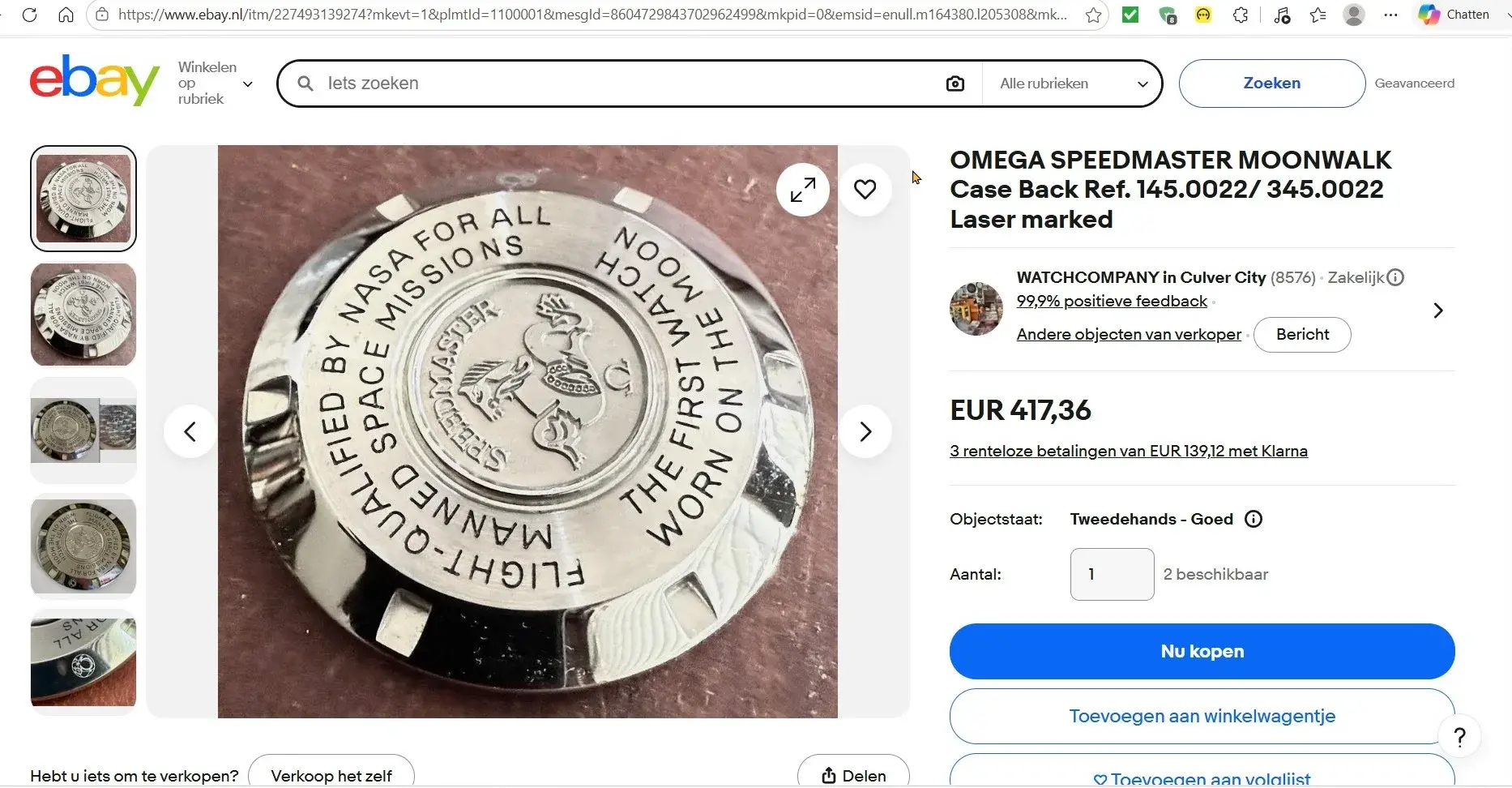

Fake Speedmaster casebacks are up again, look at the gap in the word Missions. Other cases and casebands are also fake from this seller

Modern laser engravers make this too easy. Scan something even a photo, spend a few mins with various software and click Burn, instant engraving.

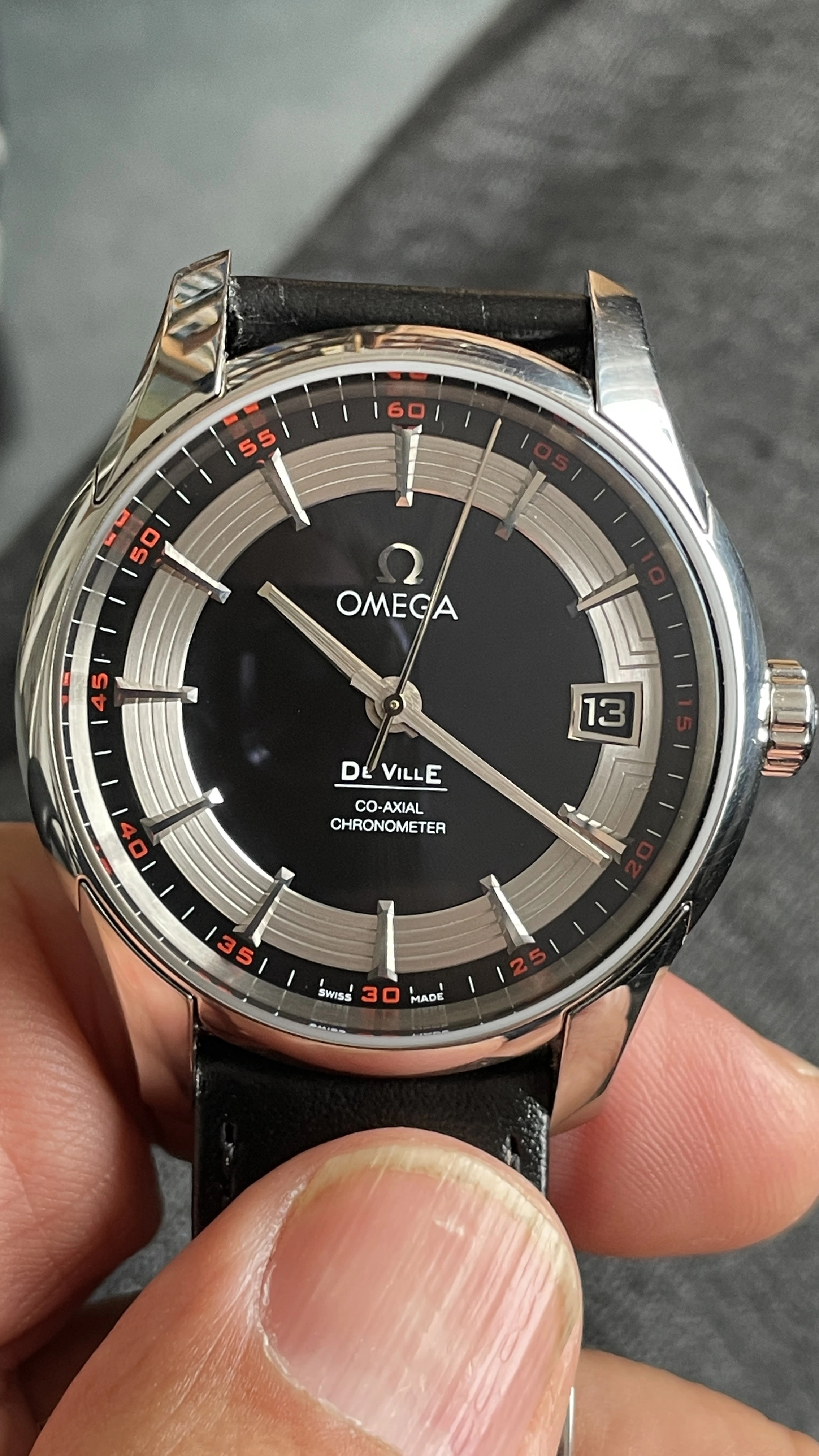

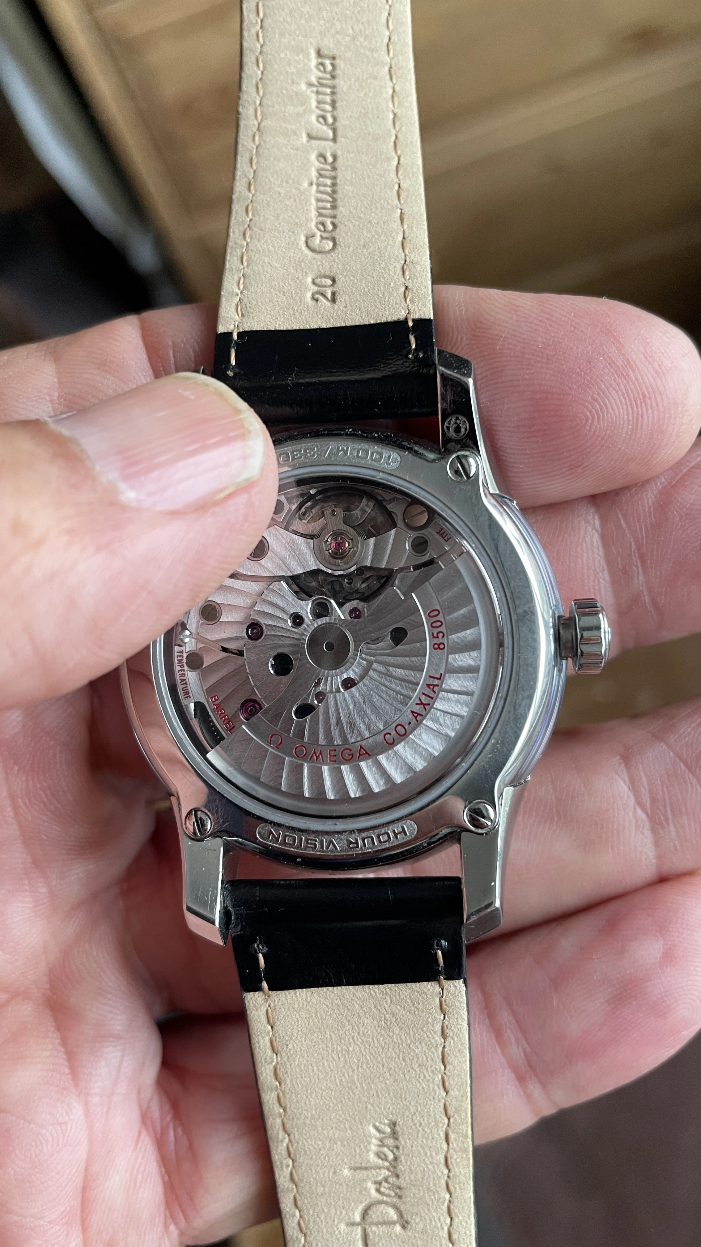

Recently acquired via Chrono24 gray market brand new old stock Omega De Ville Hour Vision from Ippo, Japan. Came on beautiful 9 link steel bracelet in immaculate Omega lacquered wood box and white cardboard outer box, red warranty card with hologram, manual. Then heard about VSFactory that does very good clones of the Hour Vision. So thought I’d just check the serial number, dealer (Ippo Japan) on Google Gemini who reckoned it was legit. Gemini then suggested sending photos of movement at which point it became convinced the watch is a VSF fake! Panic!
I then cross checked with Chatgpt which from photos reckoned it was legit. Matching serial number on lug and movement, doesn’t come up as commonly faked number, free sprung balance wheel etc. Clincher seems to be that the case thickness of mine is 12.2mm checked on two calipers which is Omega standard. VSF current spec for an 'Hour Vision' I saw on a website was 13.5 which appears to be common to the fakes
Attached dial and movement photos. I put on aftermarket leather strap. Would be most grateful for a real human to have a look.

DO NOT!!! I repeat-- DO NOT rely on AI to provide reliable on watch authentication (or anything, for that matter). Chatgpt is so comically incorrect while being so confident in its stupidity. Save yourself the trouble and do it the old fashioned way...with your own legwork and research.

Thank you for that. I would be grateful if you might give me an idea from the photos whether the watch is likely to be fake or legitimate.

sorry, but that model/era is not one of those I have studied. My comment was only meant to target the use of AI in this hobby. I've found it useful to search old listings/threads for particular parts and models; but dreadfully inaccurate when asking it to verify/compare/authenticate.
Its confidence in its ignorance will likely be its undoing in the coming skynet wars 😉.

I am really no expert. All I can say is that the authenticity of my Omega Deville 8500 checked out with Omega - model description checked out with serial number and reference number. This model ran from 2007 to 2017, don’t know the date when mine was made but as new old stock import probably quite late in the run. My Omega serial number starts with 82. Agree the bit sticking out looks odd. Mine hasn’t got that. Also check the case thickness. For my De Ville, fakes tend to be over 1mm thicker - may be similar for Aqua Terra fakes.

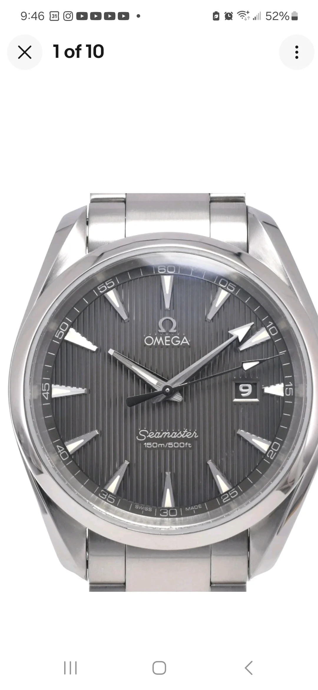

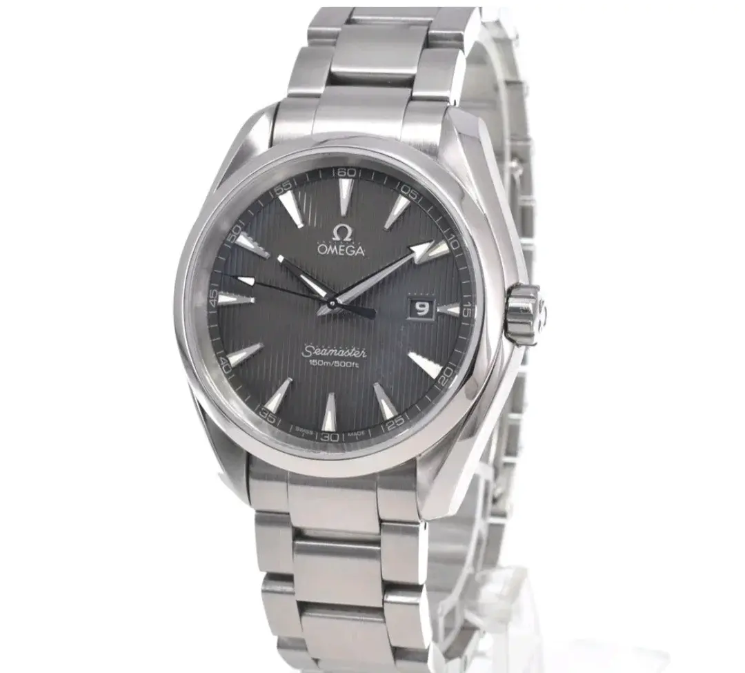

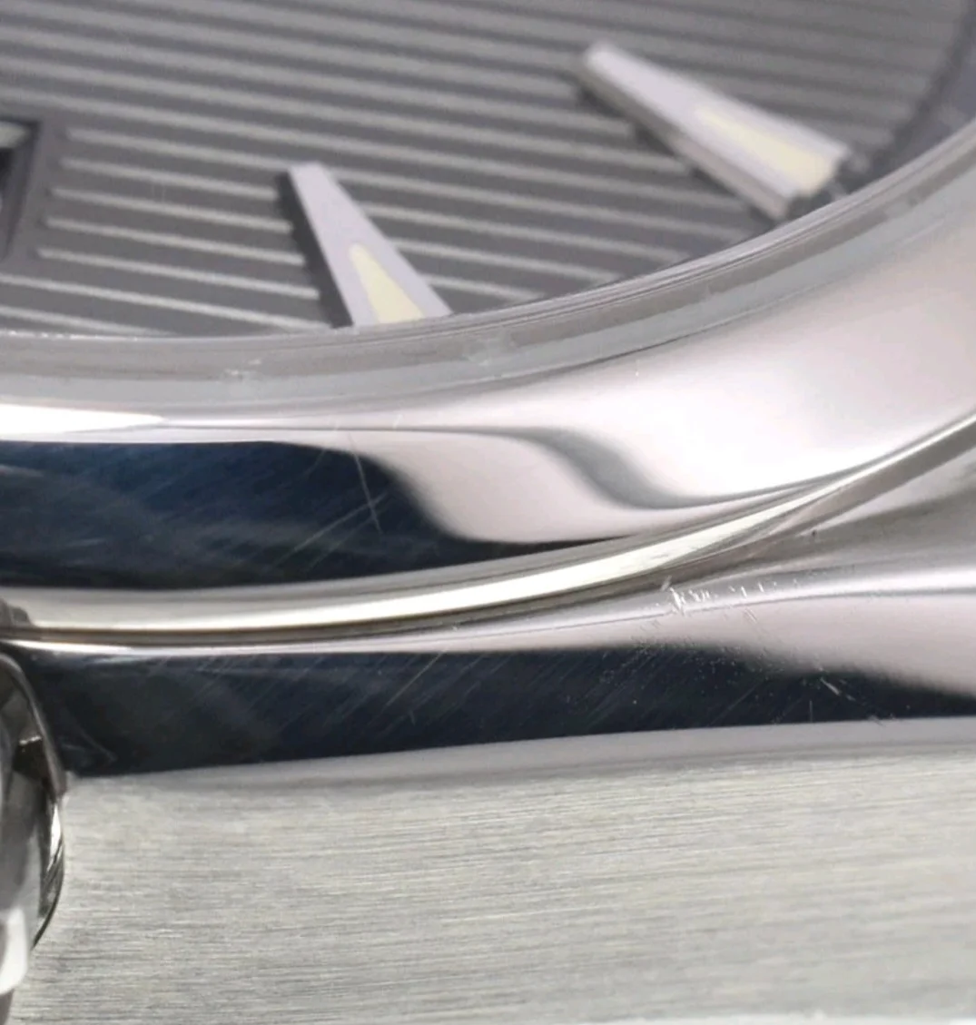

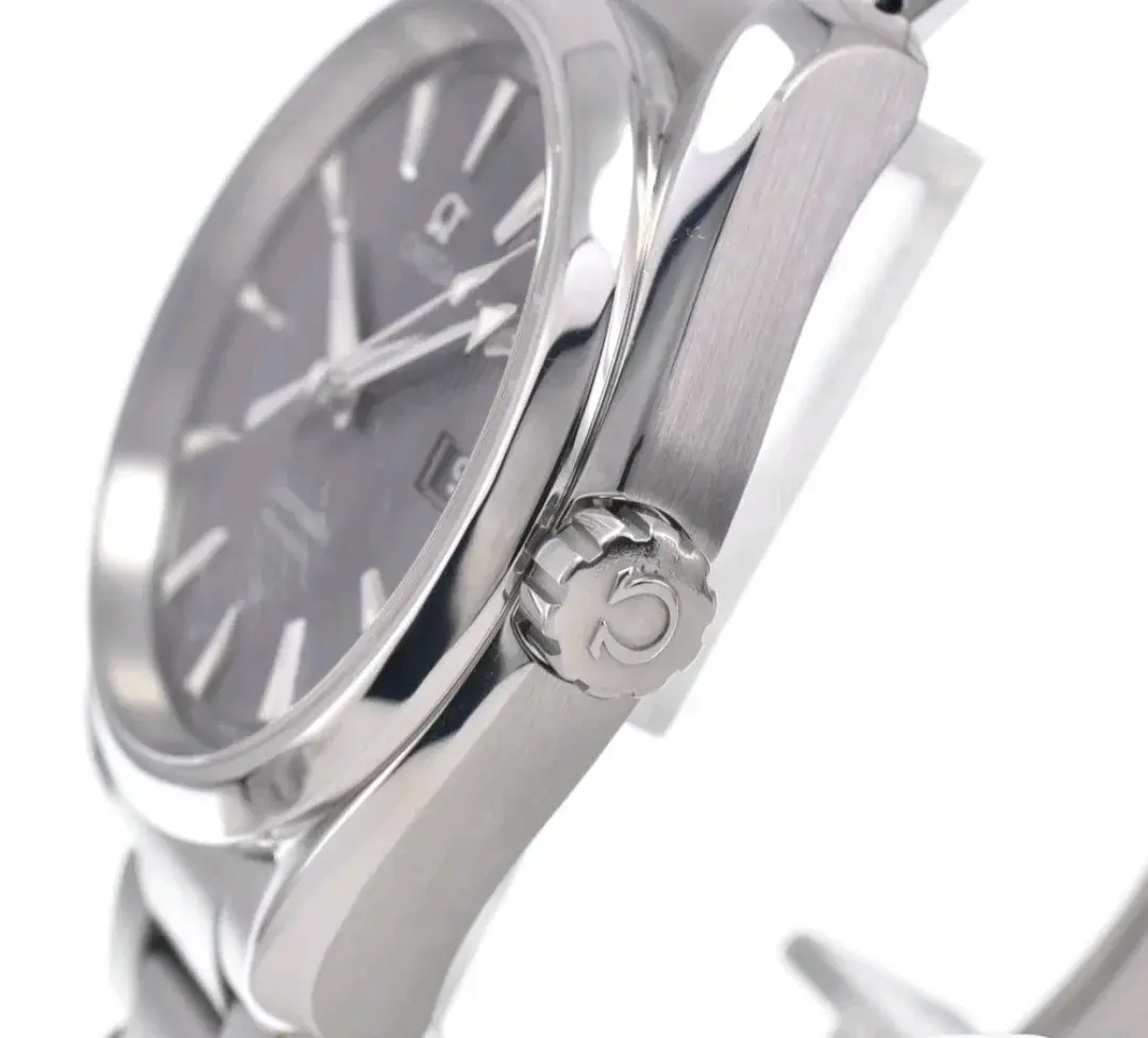

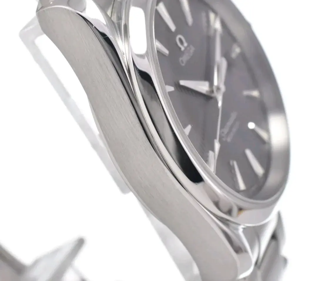

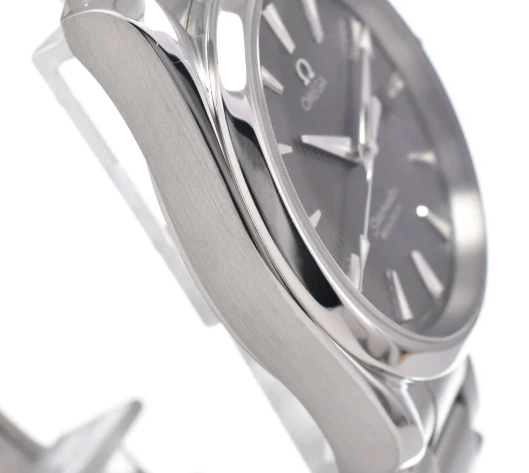

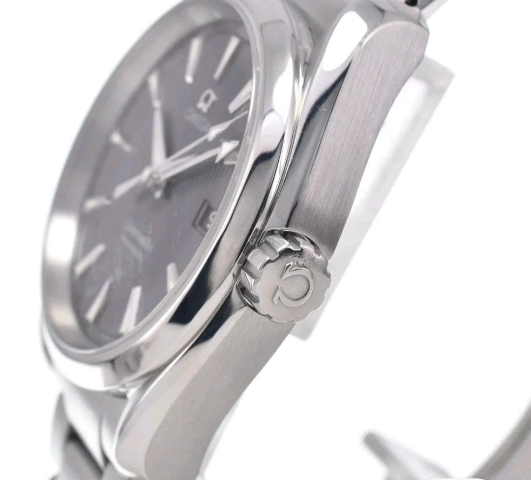

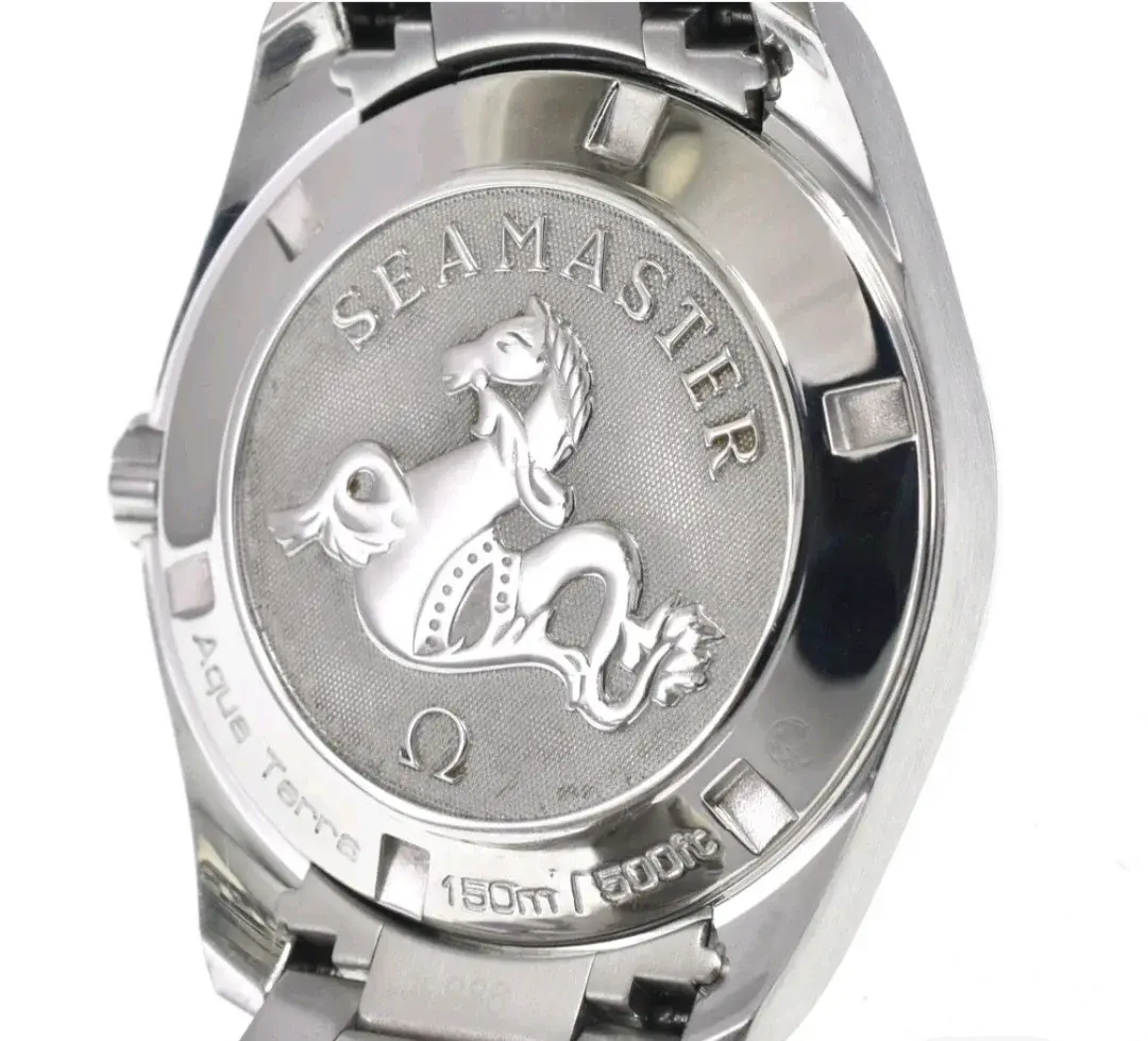

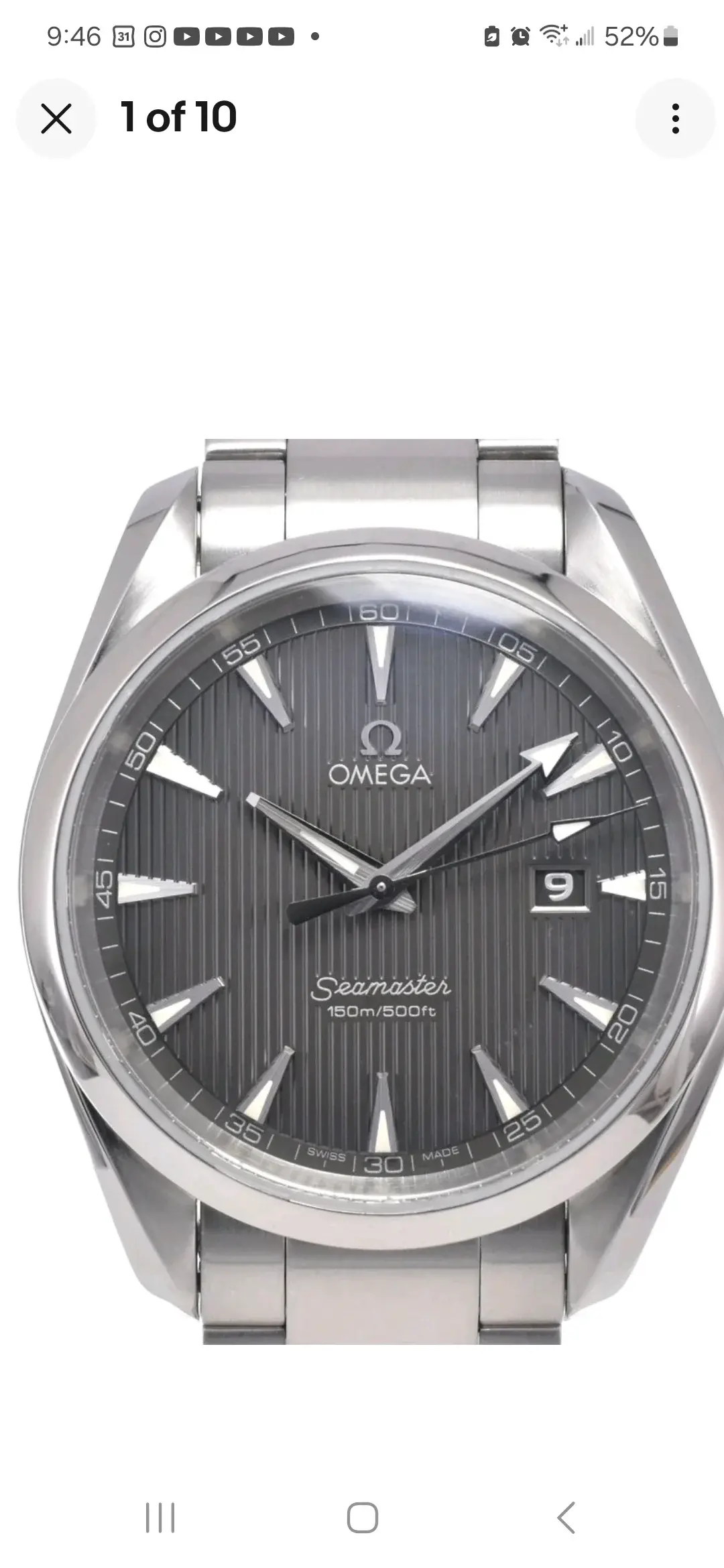

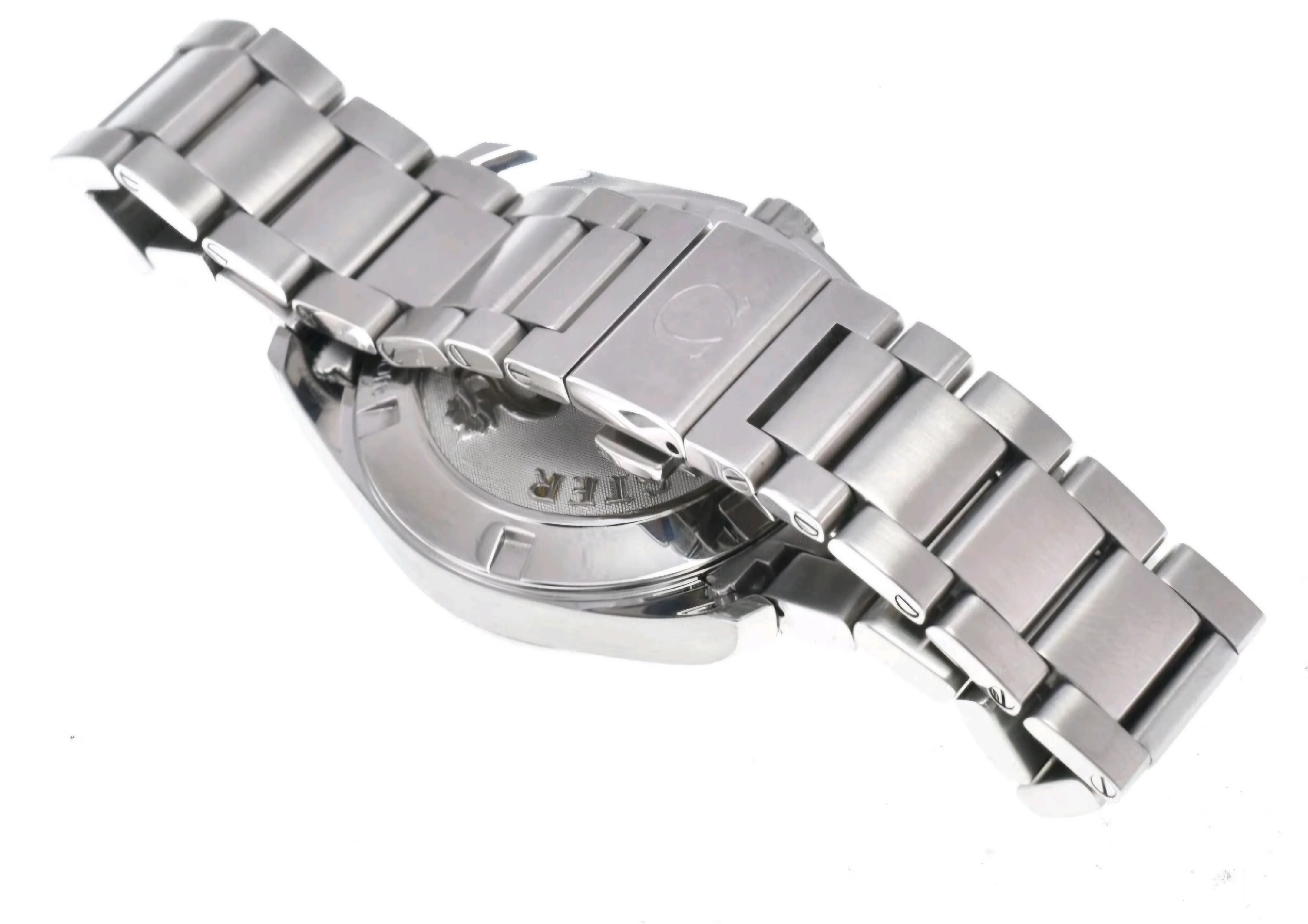

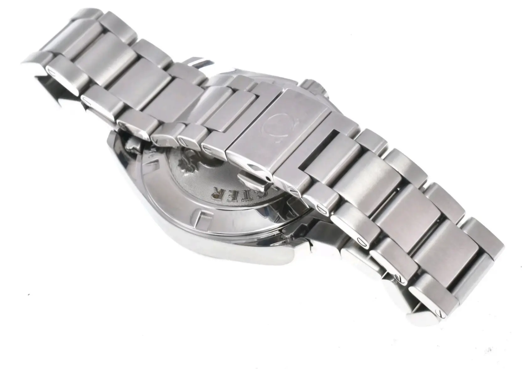

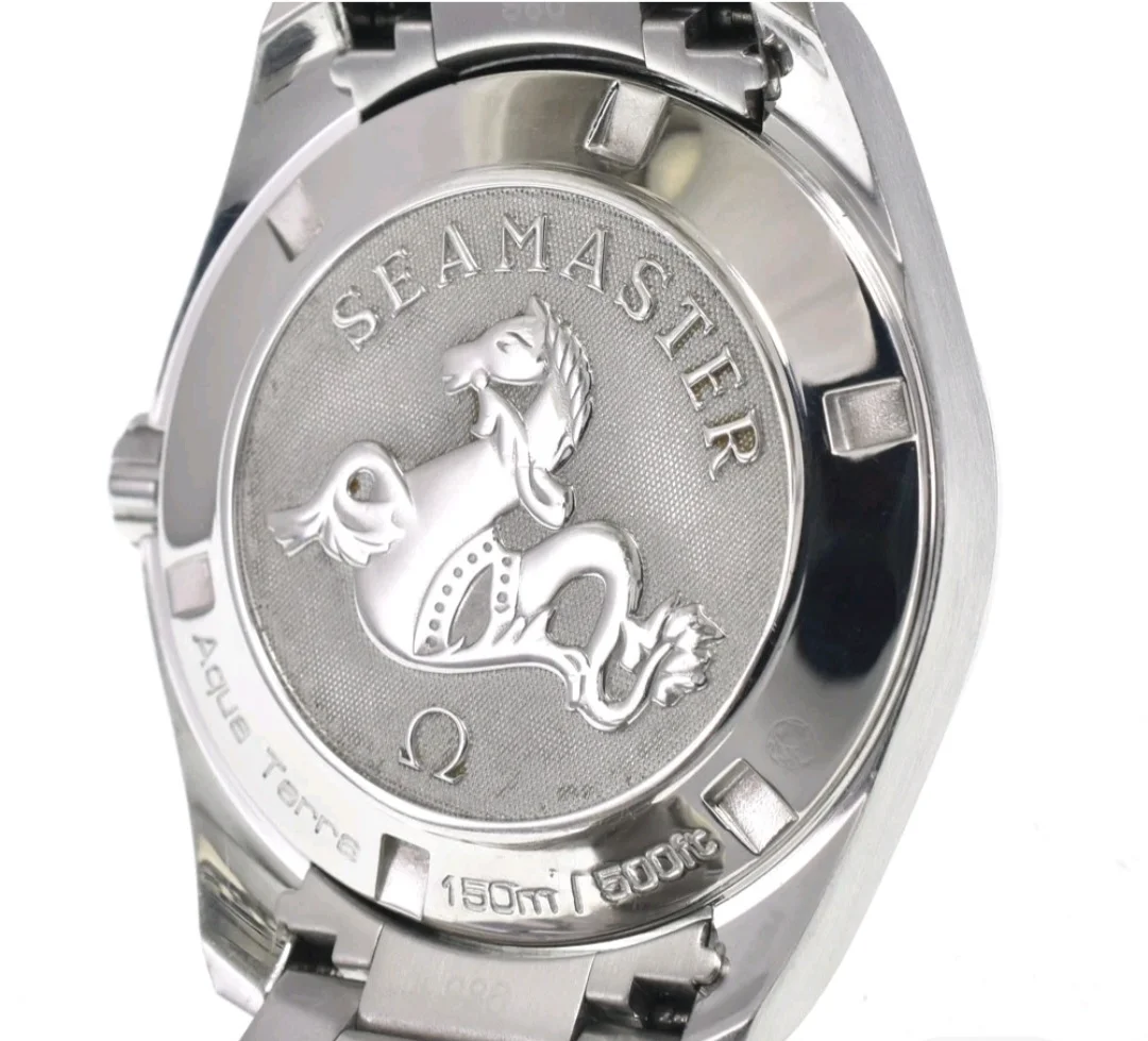

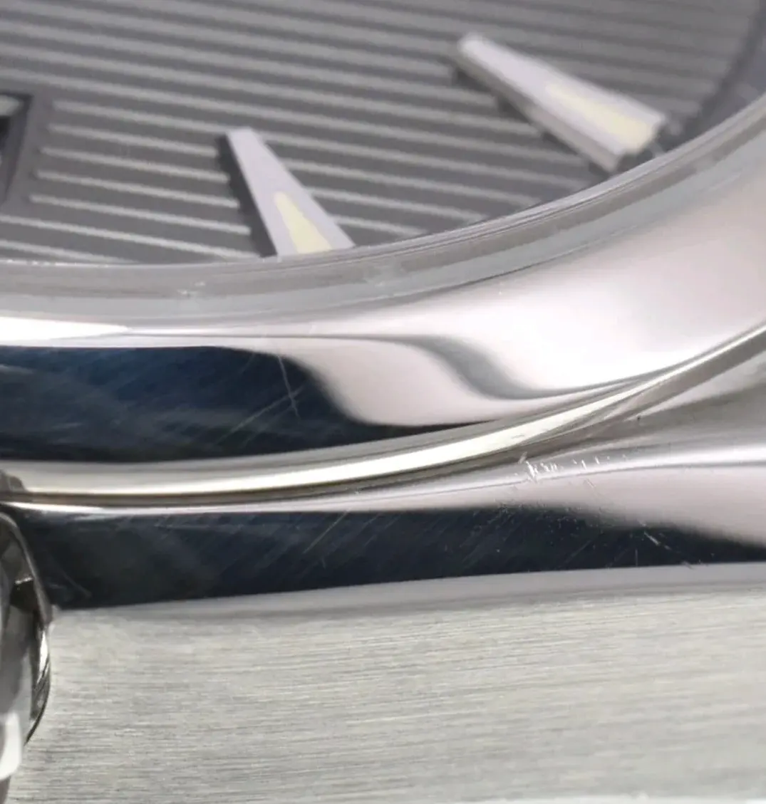

Good morning fellas! I'm looking at this Omega Aqua Terra, and this is my very first time buying watch so I don't have any knowledge about AT but find em very gorgeous and want to own one of them. I'm attaching the photos below from his post. I would very much appreciate any thoughts and advices on authenticating the piece. Thanks in advance!
