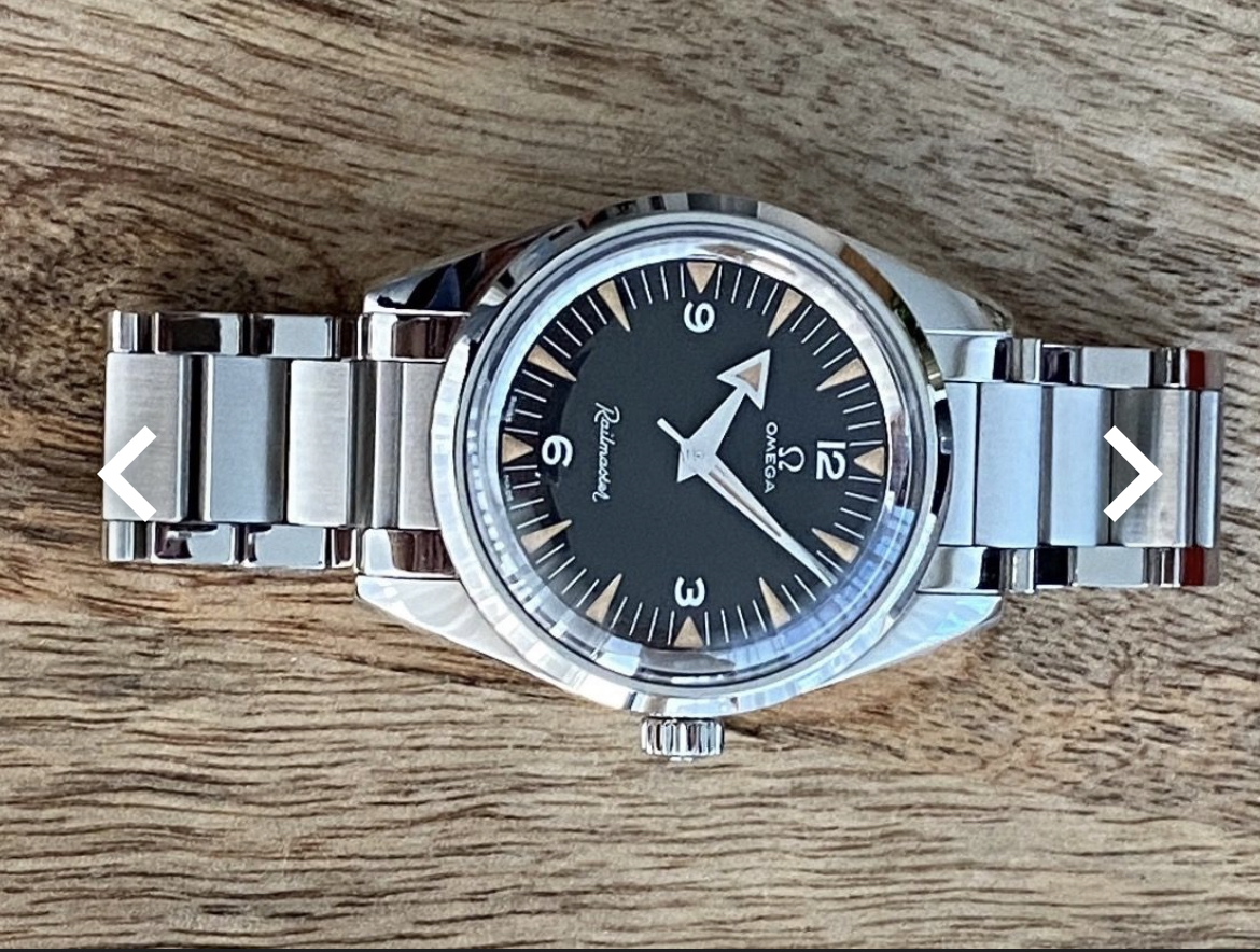

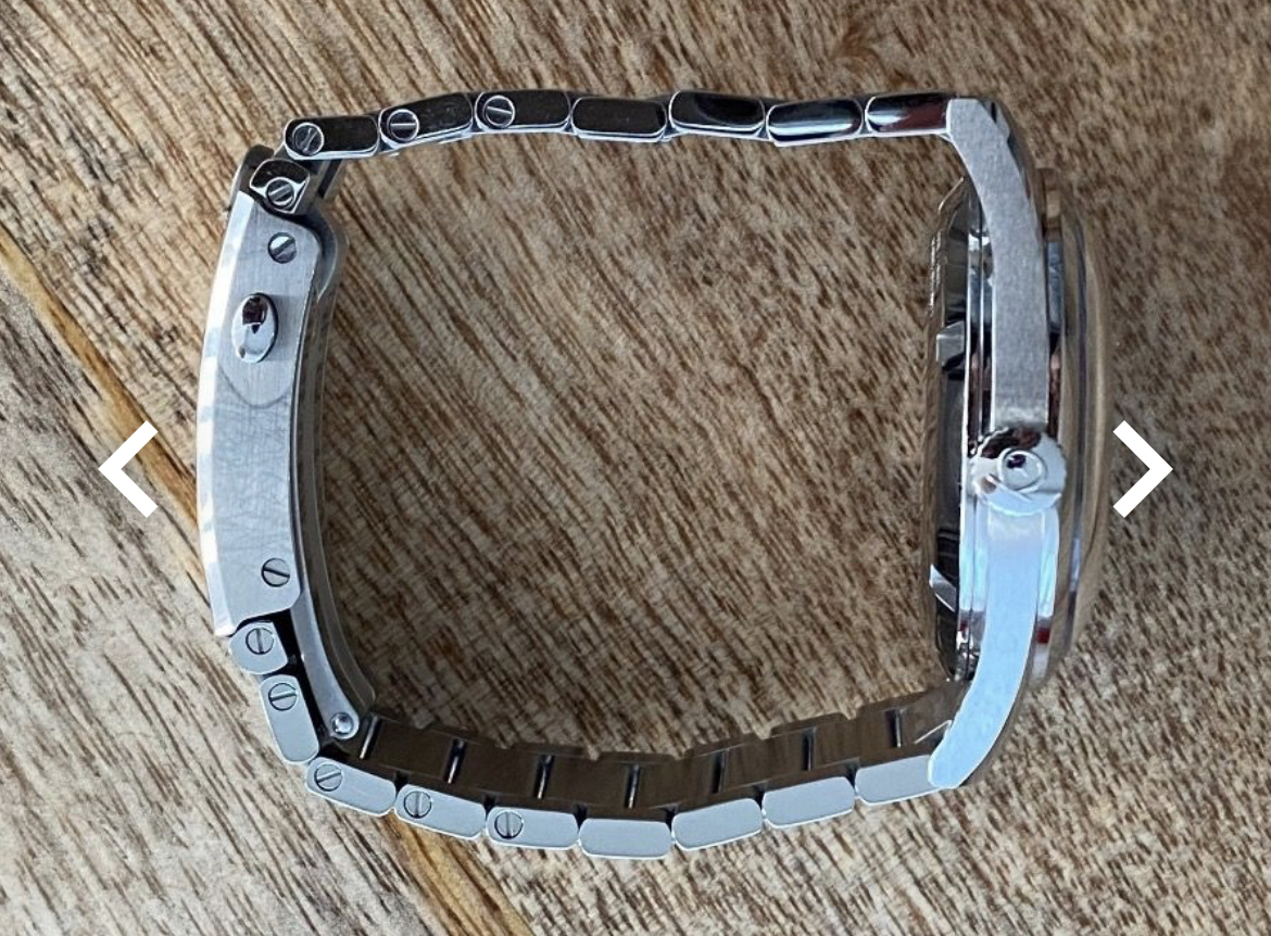

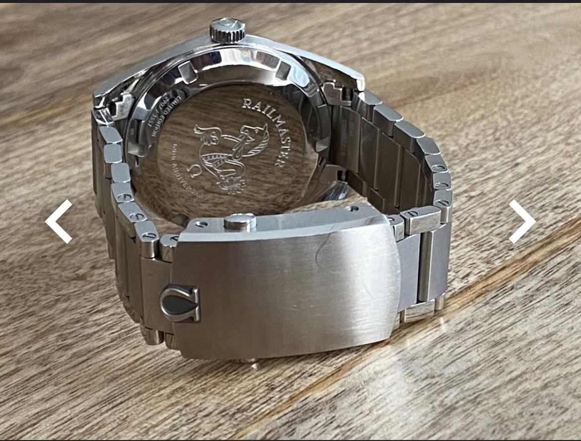

May I ask for your opinion on this 1957 trilogy Railmaster?
The price looks very attractive at 3900 CHF for “buy now” and auction starting price 3500 CHF (too good to be true?) The seller has 1 review on the platform and only as buyer.
Any alarm bells ringing? Or do you think this watch is all good?
1,981
3,873
This Railmaster does not come up on ebay, do you have a link ?
At 3900 it is way cheaper then average and with a no history seller, probably a scam.
1,981
3,873
Thanks ! If the watch is correct you have a super deal but dont bring cash !!
An immidiate bank transfer when you have checked the watch in person will work just fine, in a place with camera`s such as hotel lobby/jewelry shop.
1,981
3,873
Does the watch itself look good to you?
Yes, but it was a few years ago i handled one in person so i hope one of the current owners here will help.

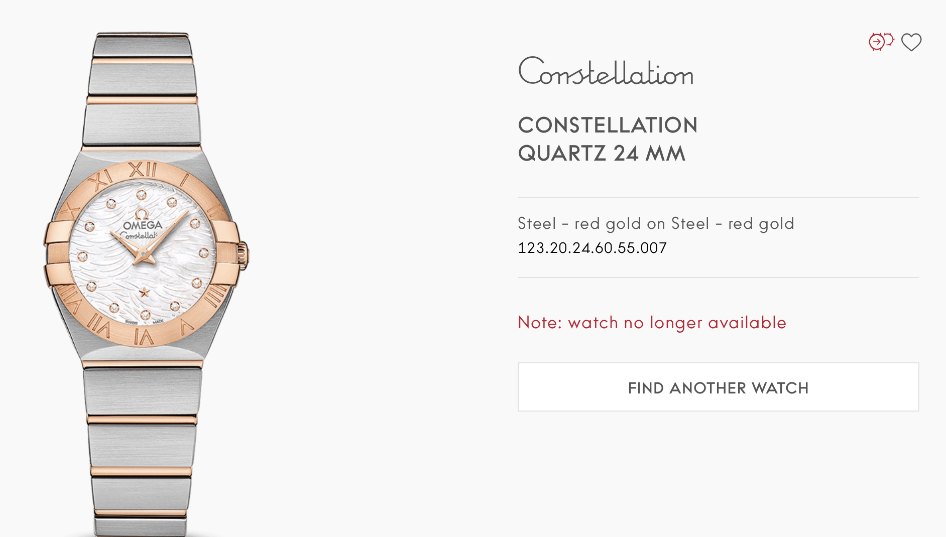

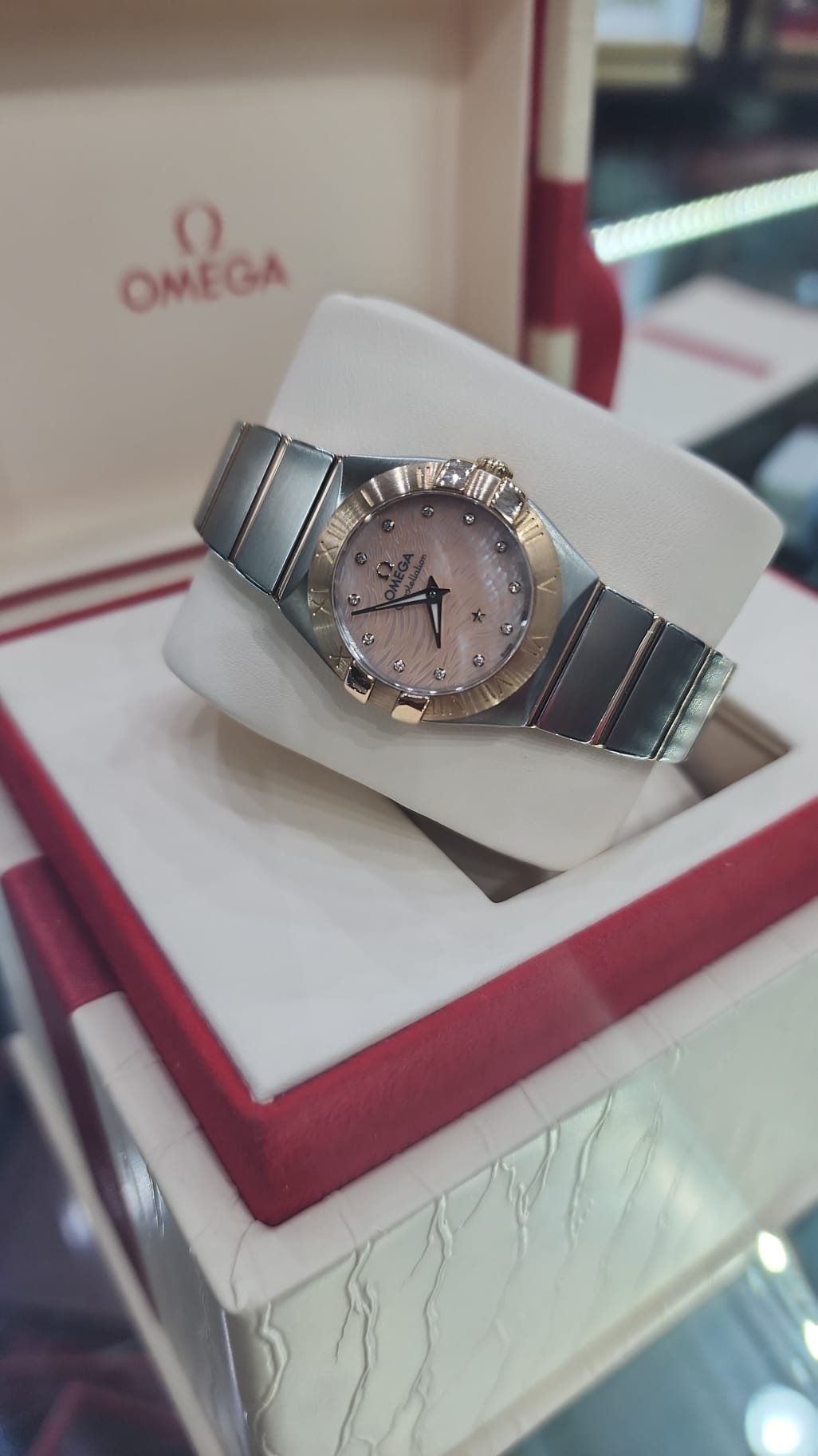

Please could somebody help me ID this watch? Buying from a private reseller and awaiting confirmation of paperwork.
I’m told it’s 24mm with a pink dial , however, I can’t find any similar models on Google. Might be an older model?

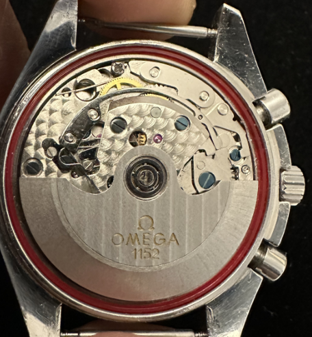

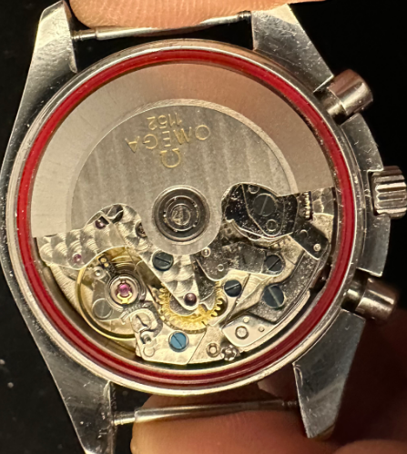

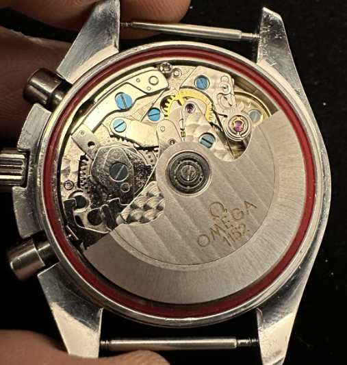

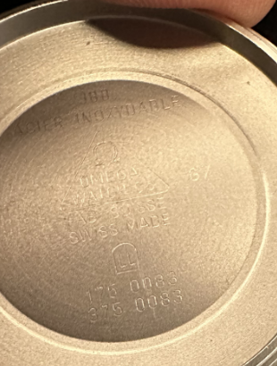

I recently bought this Omega (reference 3513.33). The gentleman who sold it to me said he believes the movement to be fake because of the finishing and the blue screws, but the case is genuine.
I popped the case-back off and when I compare the markings with examples I see on chrono/eBay it looks consistent (175 0083 and 375 0083).
I need help determining if the movement is authentic and the case as well so I know whether or not to spend any money restoring this watch. Please see pics below:
https://ibb.co/FqCsfJM
https://ibb.co/98hdFgg
https://ibb.co/WxjJCr0
https://ibb.co/2MJ3Xc5
https://ibb.co/7GxCY8c
https://ibb.co/bsxmHjH
