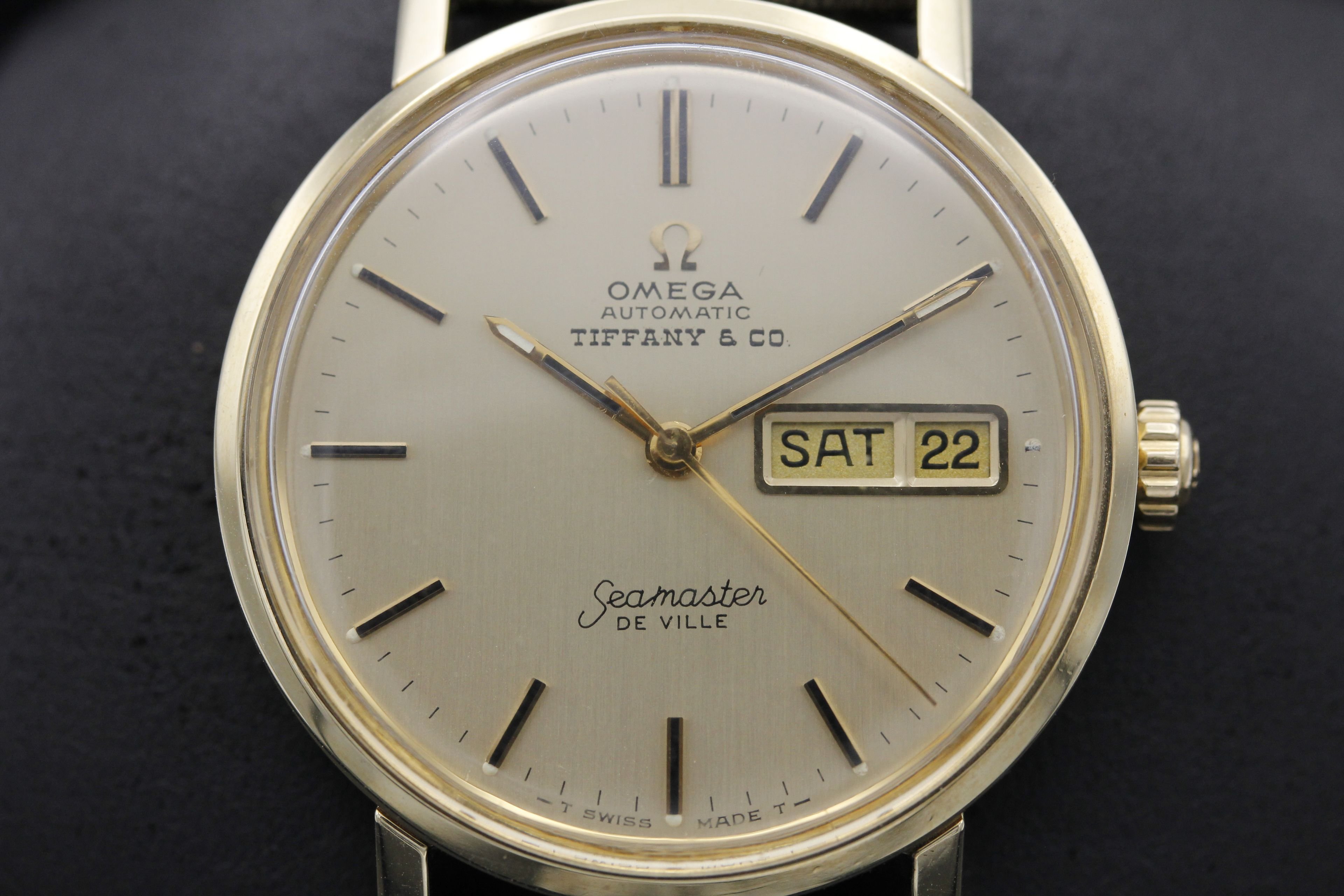

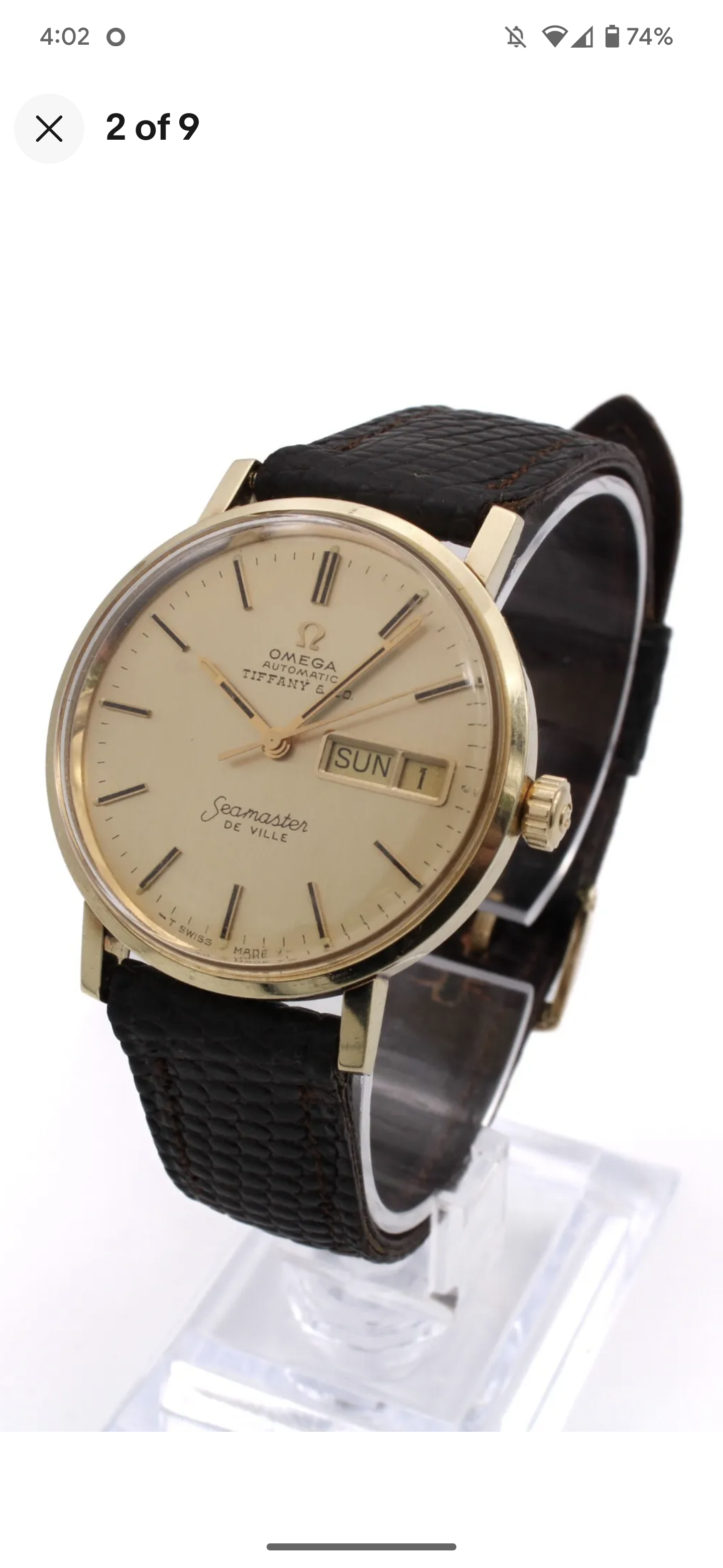

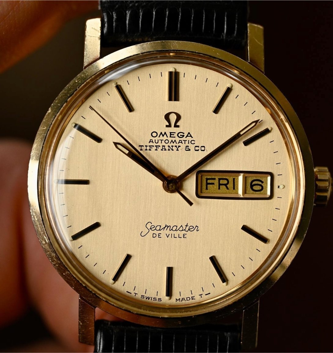

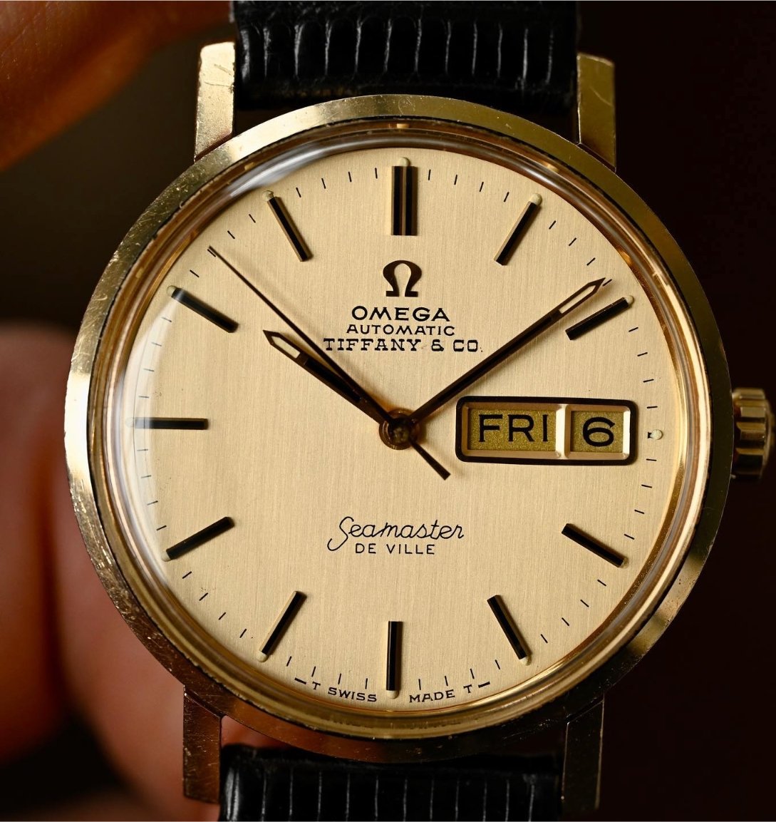

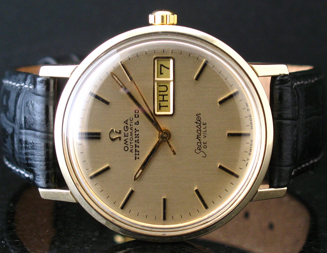

Hey folks,

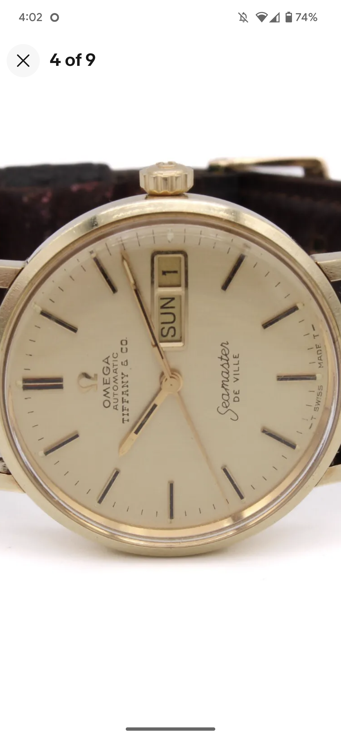

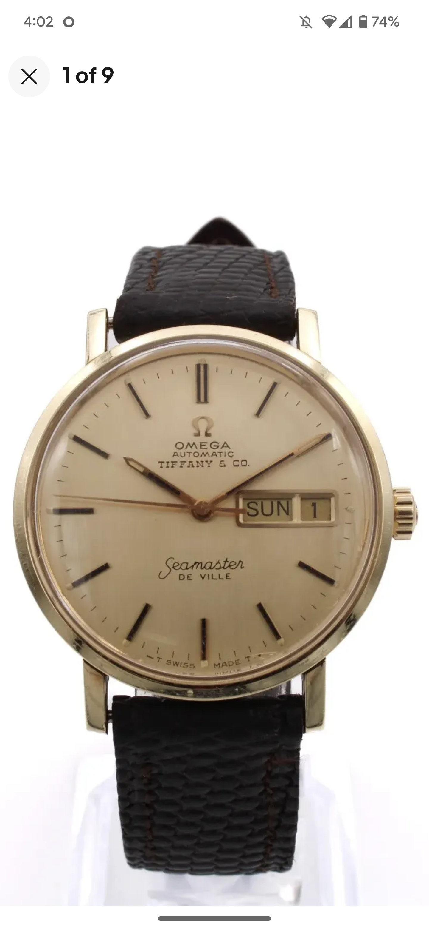

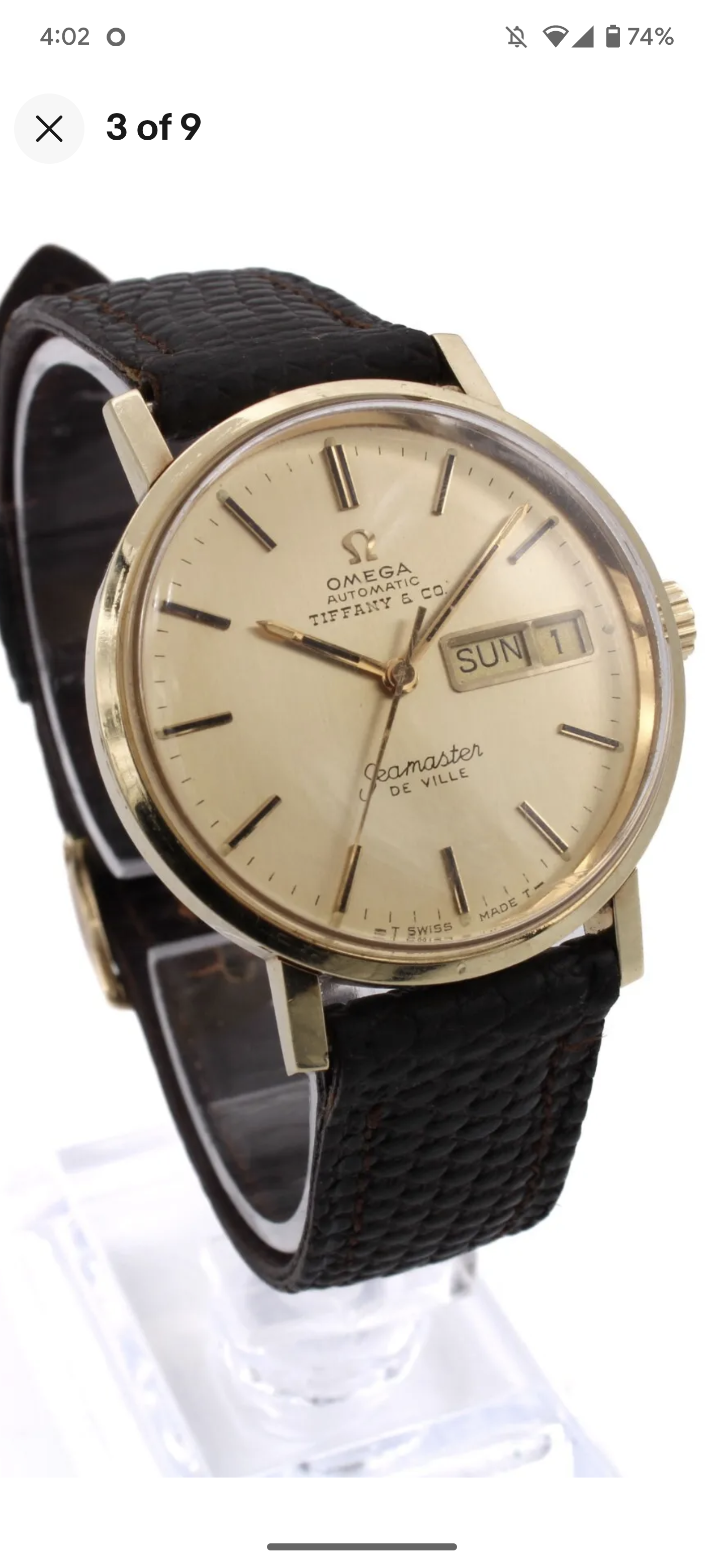

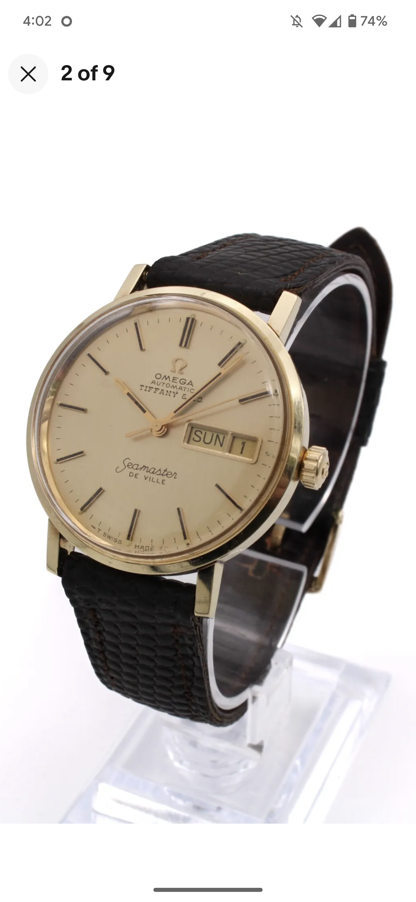

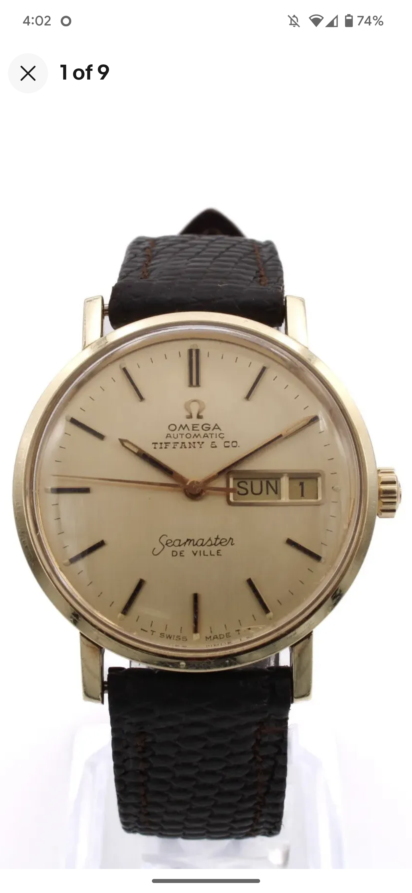

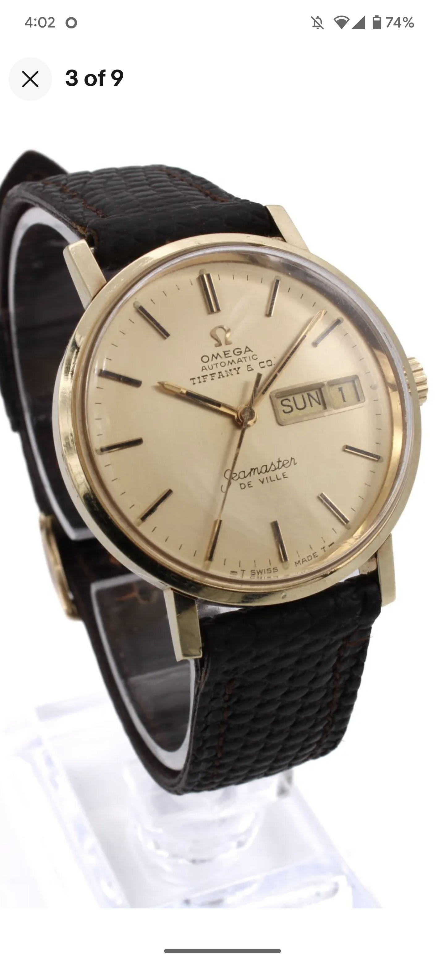

I bought a Tiffany dial seamaster Deville ref C6865 from ebay, it was posted and discussed on the recommended vintage watch thread. Ebay authenticity guarantee contacted me saying that the dial has been refinished. At first they mentioned that the watchmaker concluded that since the Tiffany stamp is present, the dial is aftermarket, to which I sent over a picture of the journey through time book which mentions this reference, they have now come back and said that the dial has been refinished by someone other than omega or Tiffany. Everything else they say is original on the watch though.
I'd like a second opinion if you kind folks would give me your two cents? Attaching all the dial images
Here is the original listing : https://www.ebay.com/itm/2562179654...p5vfbx-qeu&var=&widget_ver=artemis&media=COPY

I'm on redial here, The 'Seamaster' looks very sloppy, The coathanger 'S' was from 50s-60s but the watch was probably from 70s. The rest look Ok though.
Edit: Did some research, looks like the dial is legit, still think the Seamaster is funky 馃榿

If the Ebay authenticator says it's refinished, I tend to believe it. And I think it was done nicely if it was indeed refinished.

I know about the coat hanger S being from the 60s, and that this reference was probably the only exception from the 70s. Would defer to @dsio here since he found this originally!

Here is a suggestion. Go to google images and find 10 other coathanger "S" Seamasters from the same era and compare the "Seamaster" letter by letter. I think it will become very clear before you are halfway through the 10 examples, and you will learn something because this is an easy one.

3,285
23,747
I'm no pro but the gap between the "a" and "m" in Seamaster and the "m" itself look completely whack. And the Tiffany text is crooked. I vote redial.

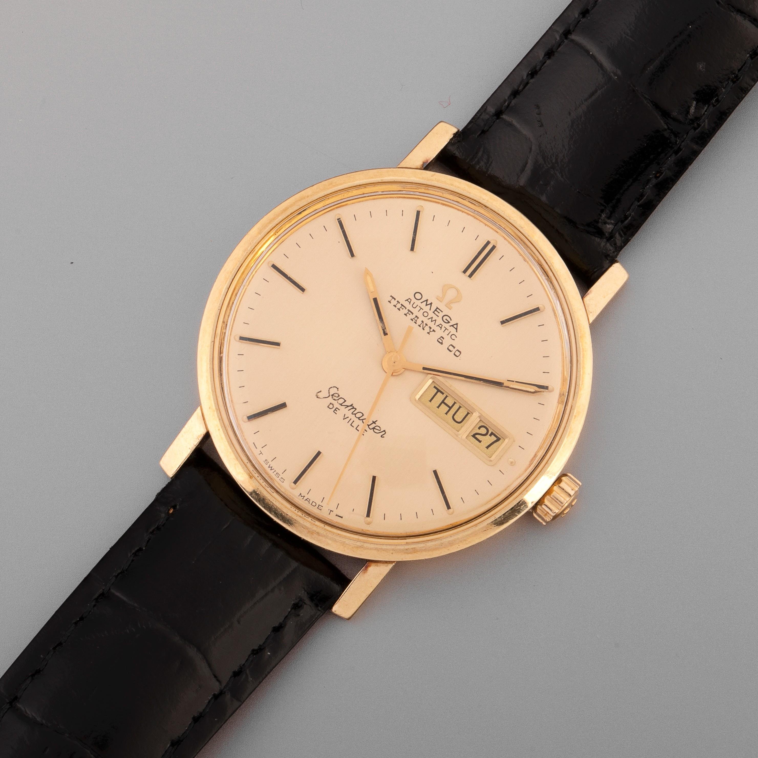

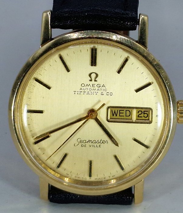

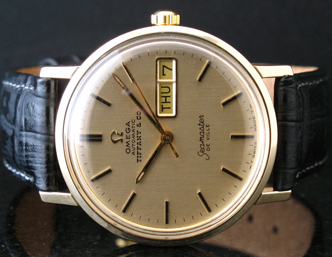

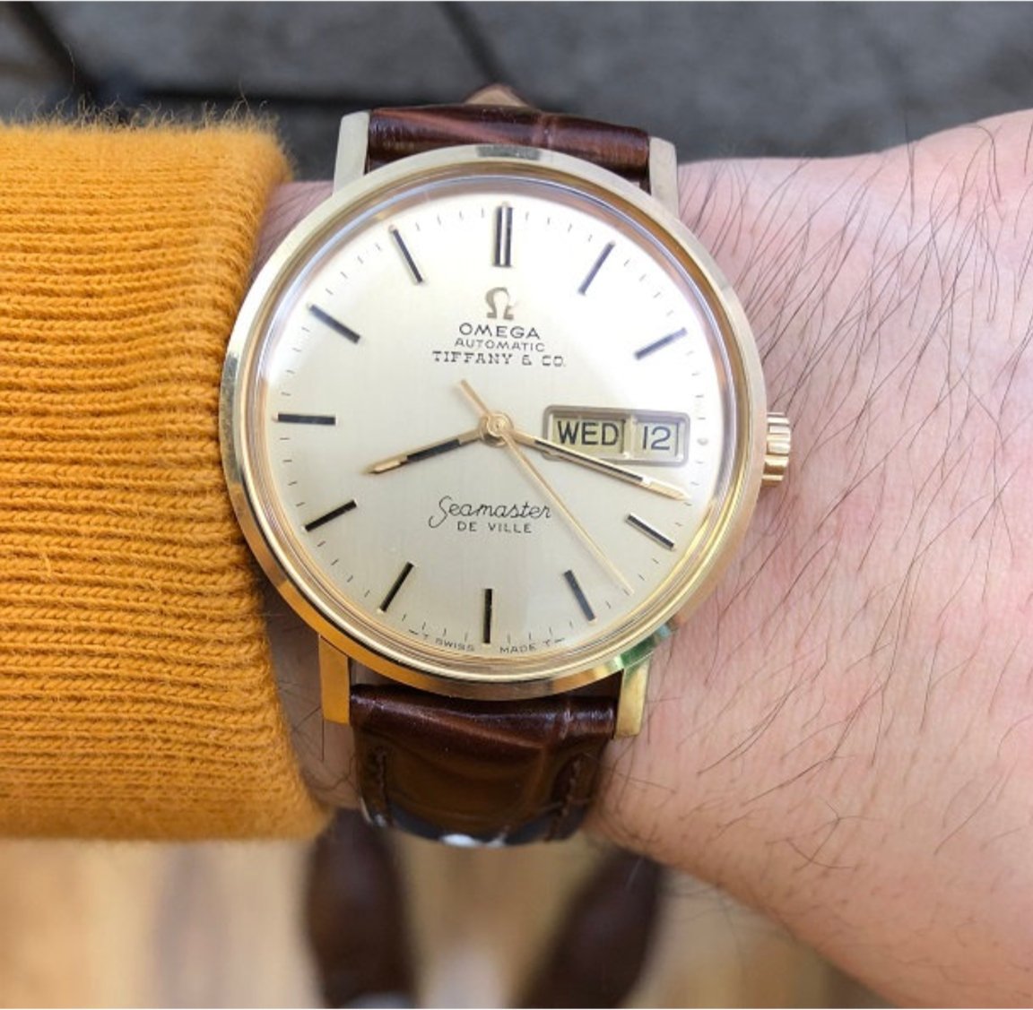

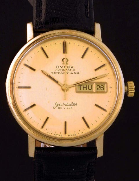

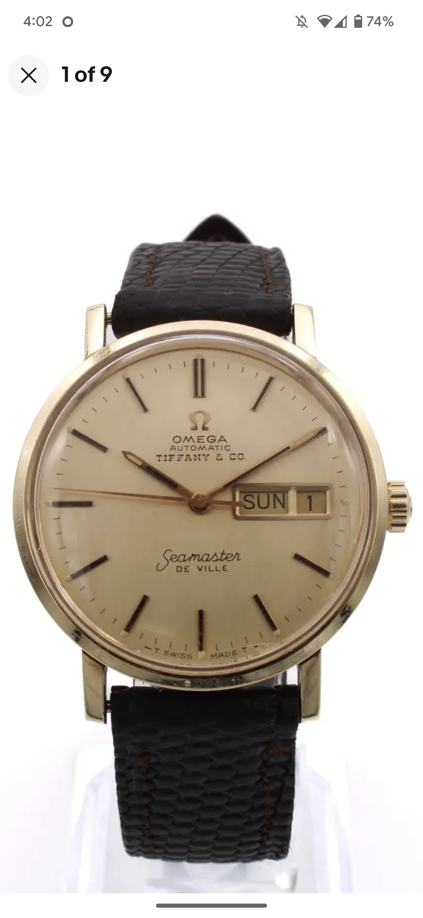

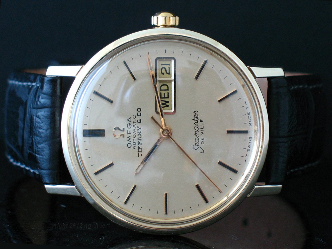

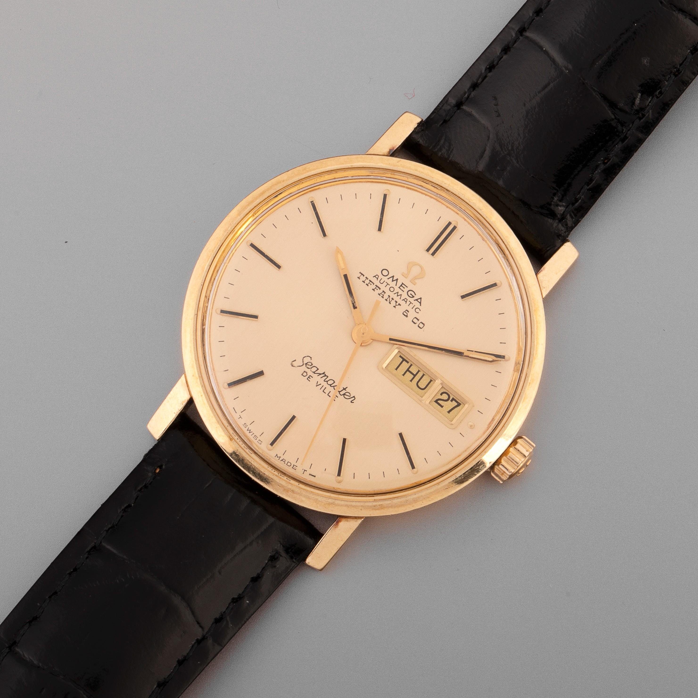

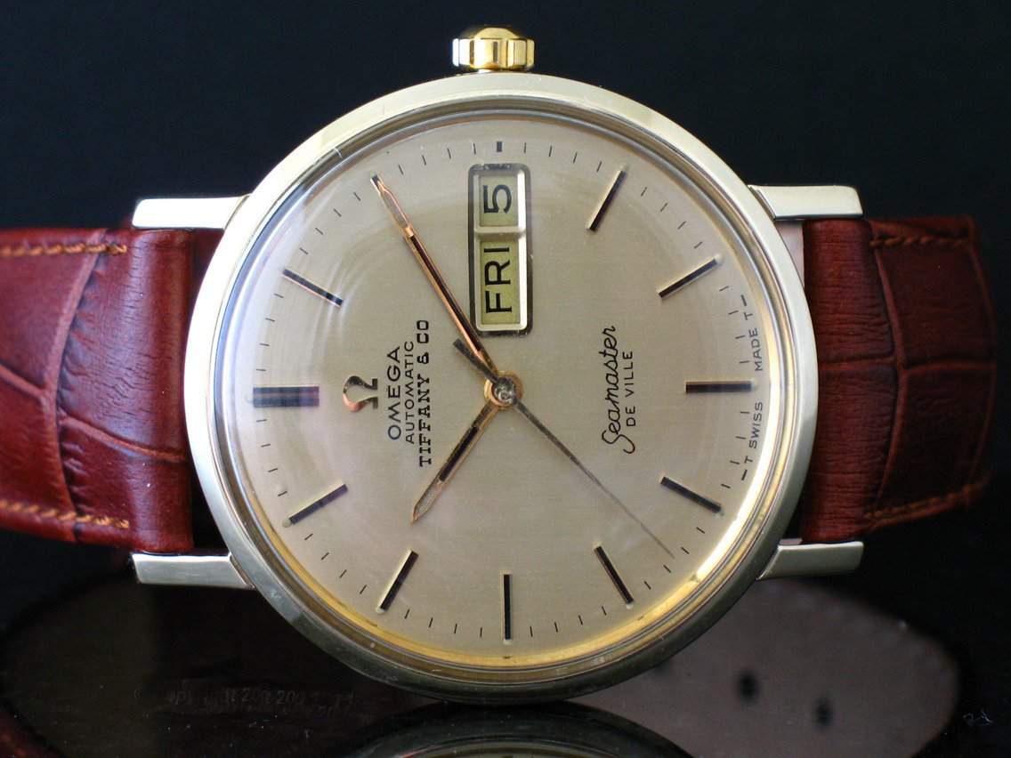

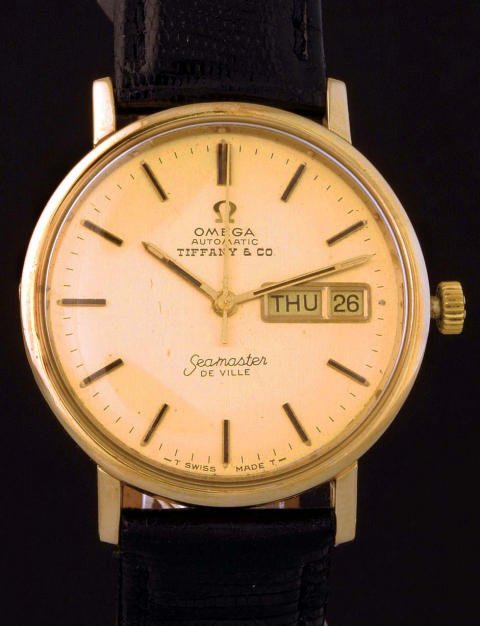

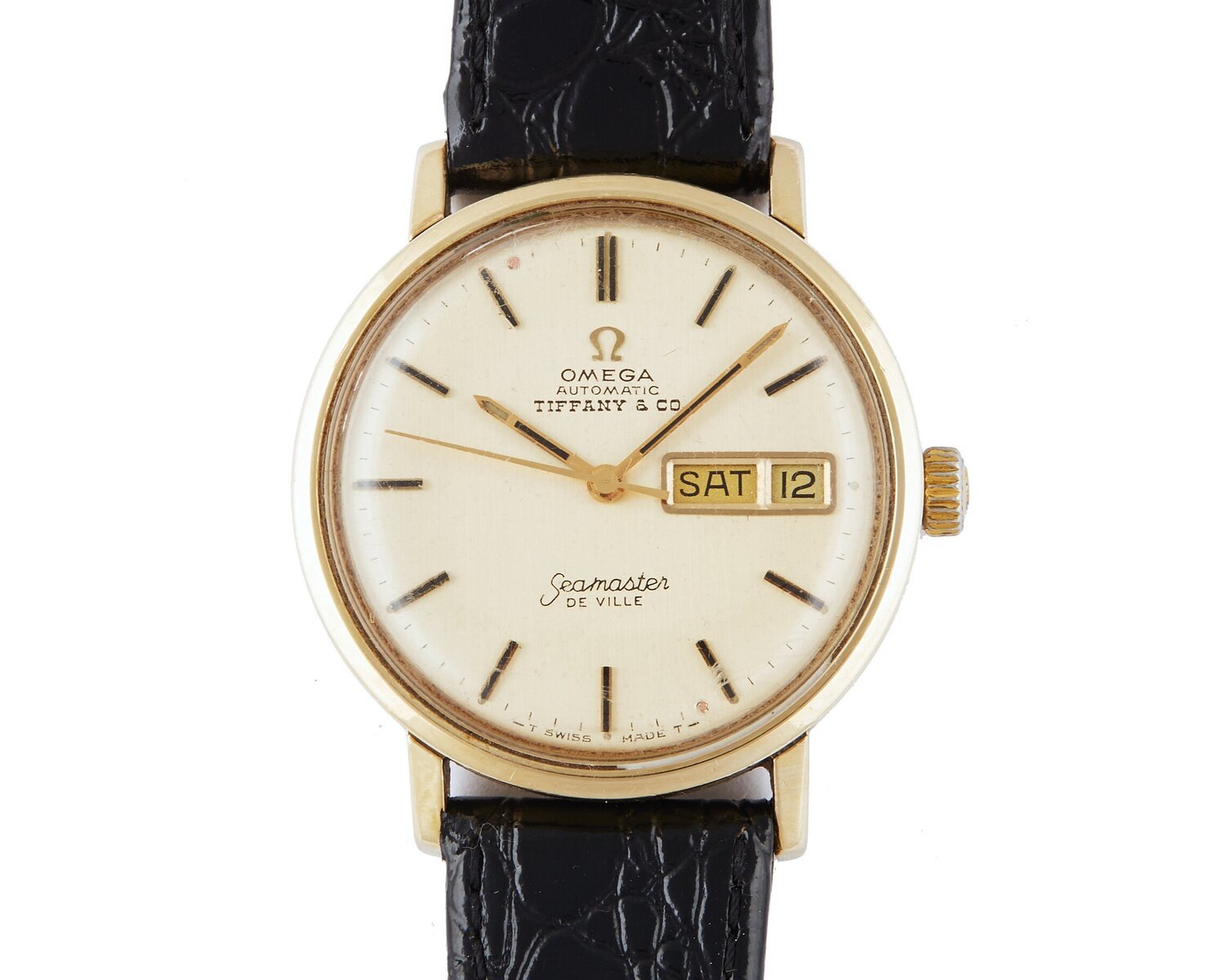

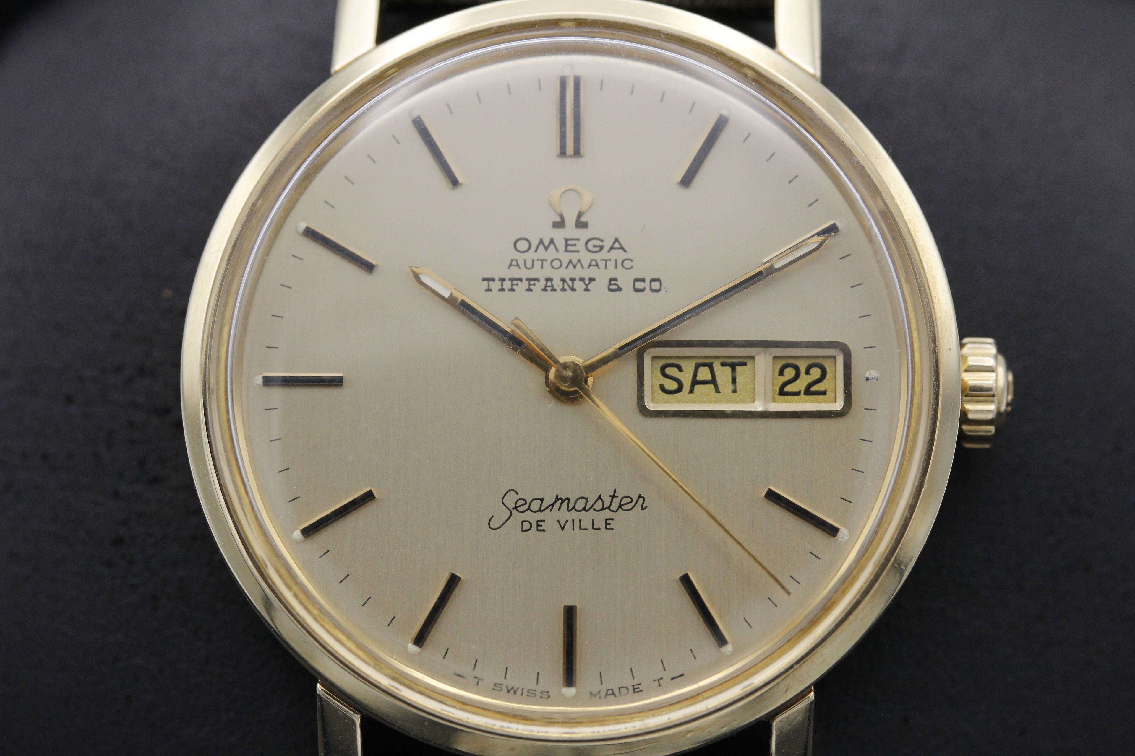

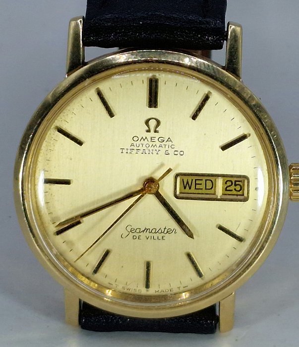

So these watches are infamous for looking weird in their printing as a reference. They鈥檙e a US made Norman Morris model, likely with a US made dial and the Tiffany was definitely added after the fact to all of them, but here is a selection of them. I鈥檓 seeing a weird gap between the A & M in all of them, and a wacky looking M in all of them. The resolution on the OP鈥檚 image is really not vey good but here鈥檚 a decent selection.
OP鈥檚 watch:
Other examples:
31
5
OP鈥檚 watch:
Other examples:
Thank you for your comment! As per @Dan S 's suggestion I went ahead looking at these dials, I also found some where the there's an ever so slight tilt in the Tiffany stamp. Probably there was an ever so slight variation in the stamps Tiffany added since there was no direct omega supervision?
That's research. 馃憤
13,489
31,804

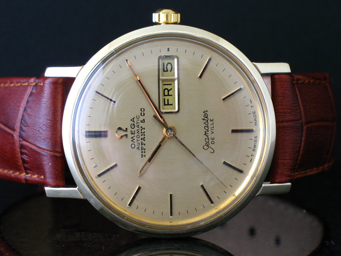

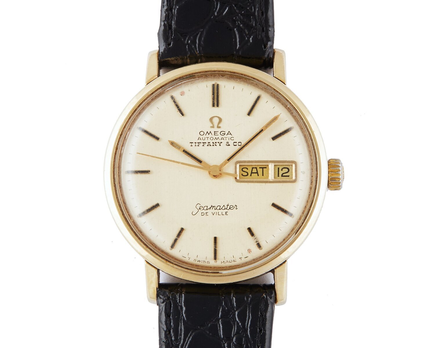

Here are three which have passed through my hands.
It鈥檚 hard to know exactly what the story is but these are definitely a 1970s watch and that is the wrong decade for a coat hanger S, but then Norman Morris鈥檚 US production was mostly in the 50s and 60s, so these were an oddity. They did make a lot of them, all with the one dial pattern and all Tiffany signed, and if I had to guess I鈥檇 say NM went to one of their dial makers who had produced for them in earlier decades and asked for another set of De Ville dials, and given the last dials that maker produced may have been the coat hangers from the early 60s they went with that.
Regarding the Tiffany stamps, I鈥檓 guessing here too but they were probably both stamped and retailed as a Tiffany exclusive, with the already printed dial stamped a second time, and variation could be expected from that.
See I had a feeling you would have some great examples too I was just about to tag you!

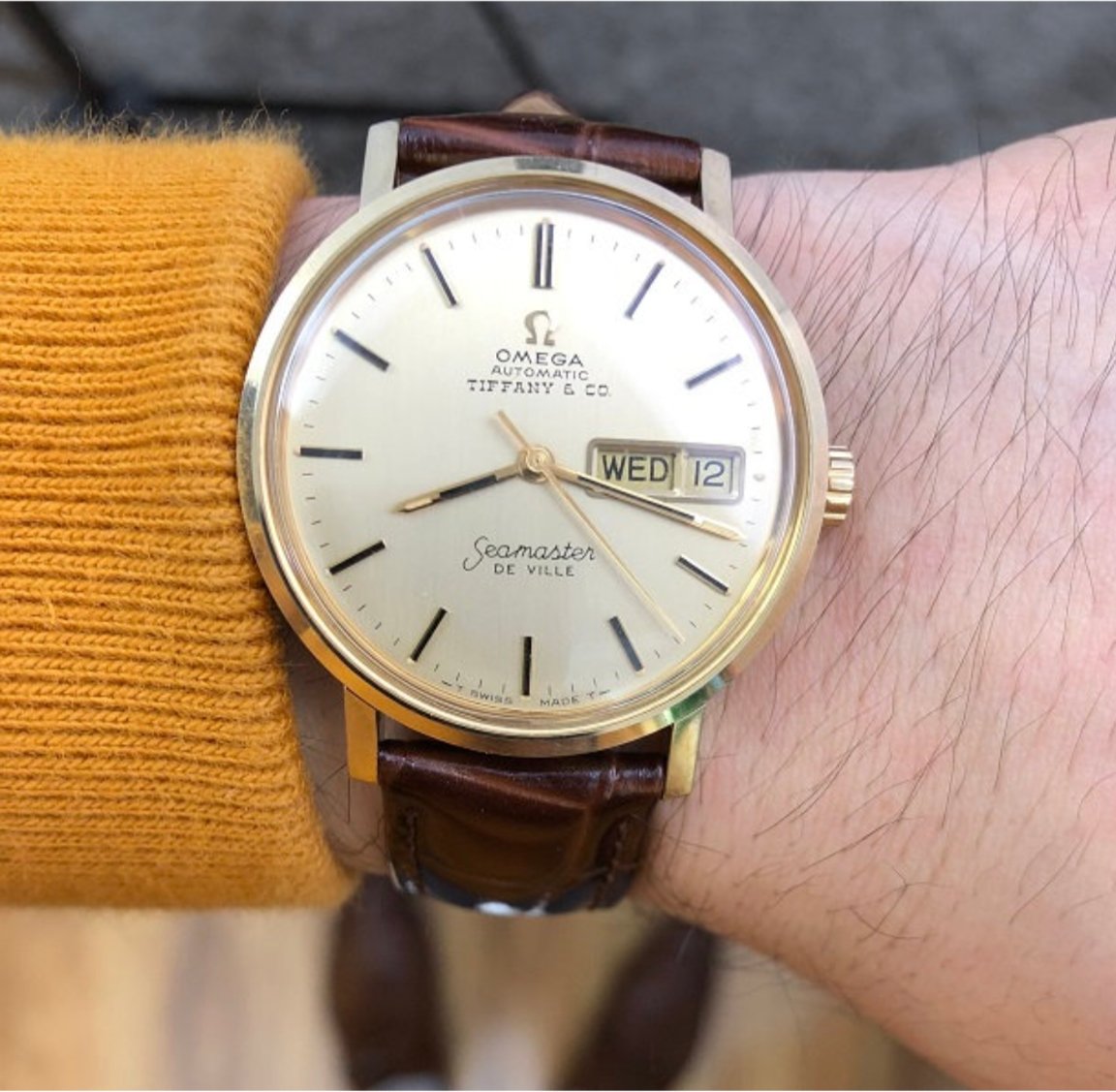

Thank you all for chipping in! 馃榾

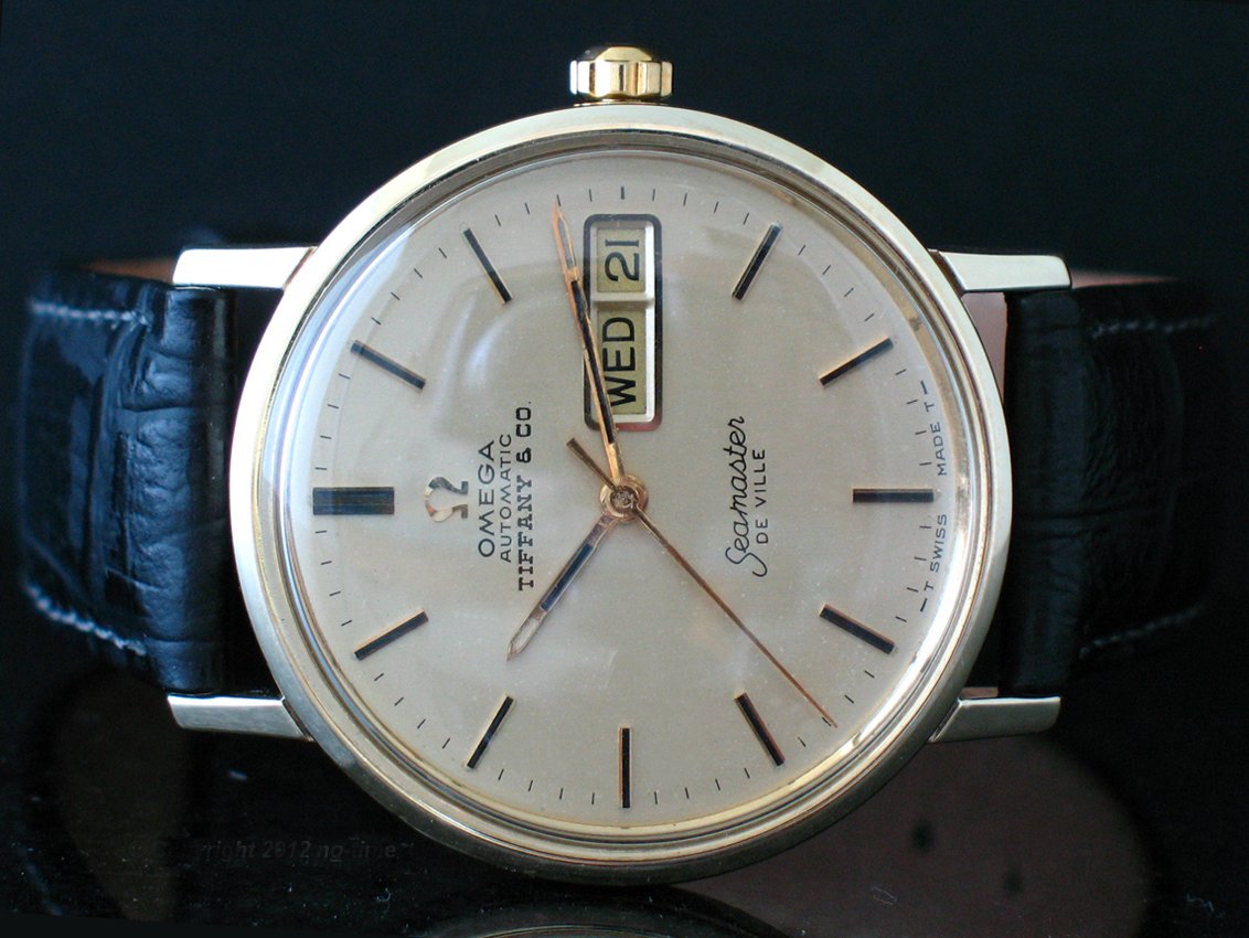

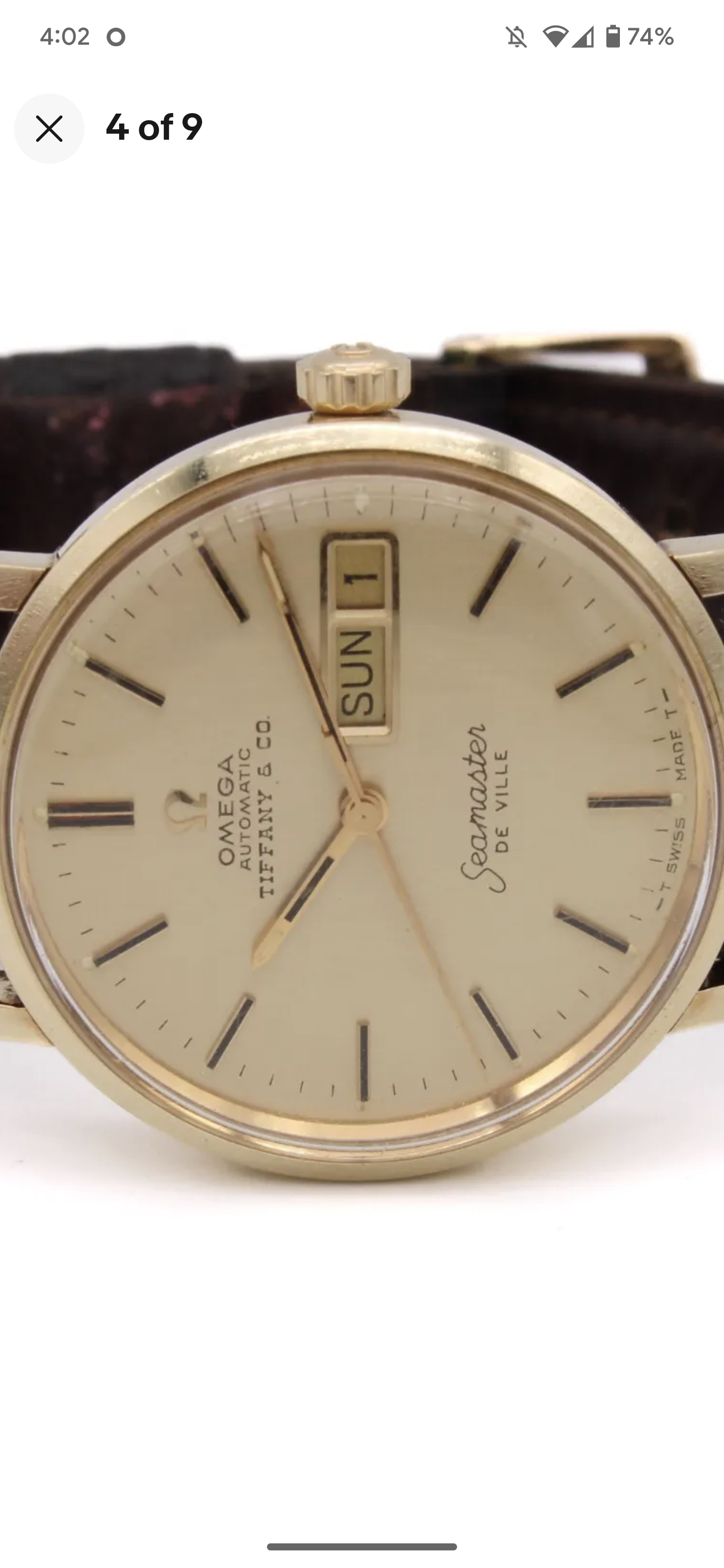

Here are a couple I found which also have the weird gap but also the *slight tilt* in the Tiffany stamp relative to the automatic that some have mentioned.
3,628
7,916
As an interested observer here I would say that the funky Seamaster script is very consistent across all these examples, and would accept the theory offered by @dsio and conclude they are ok.
