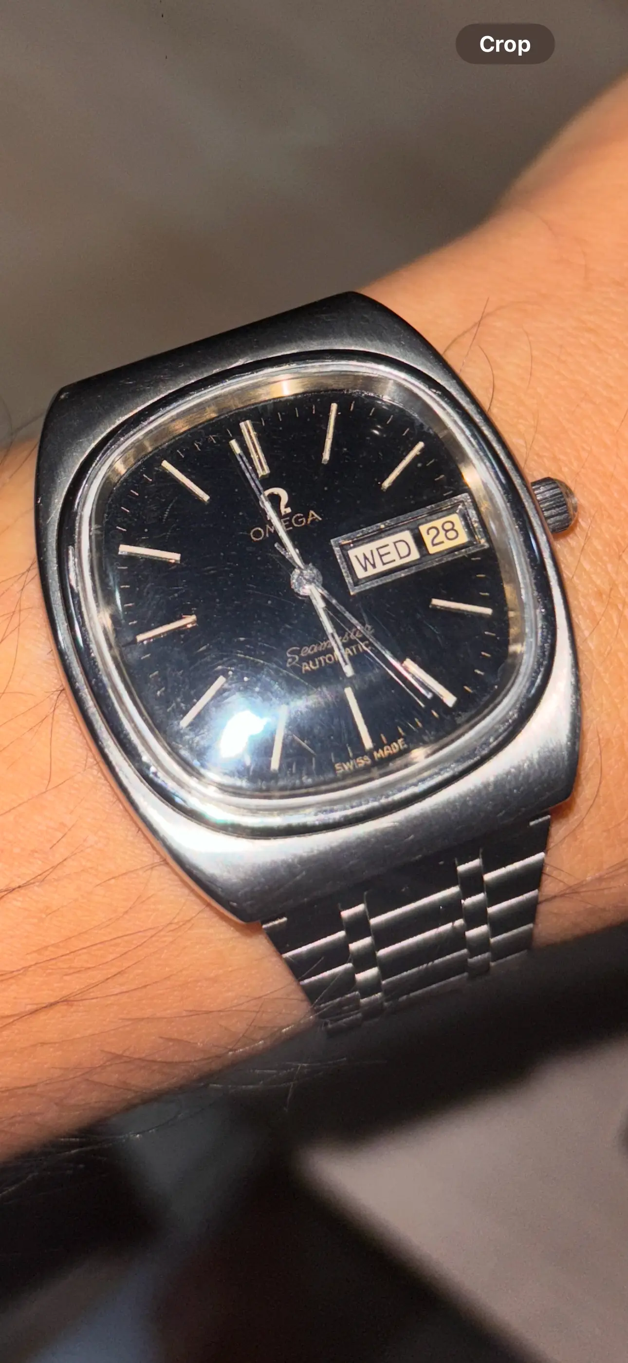

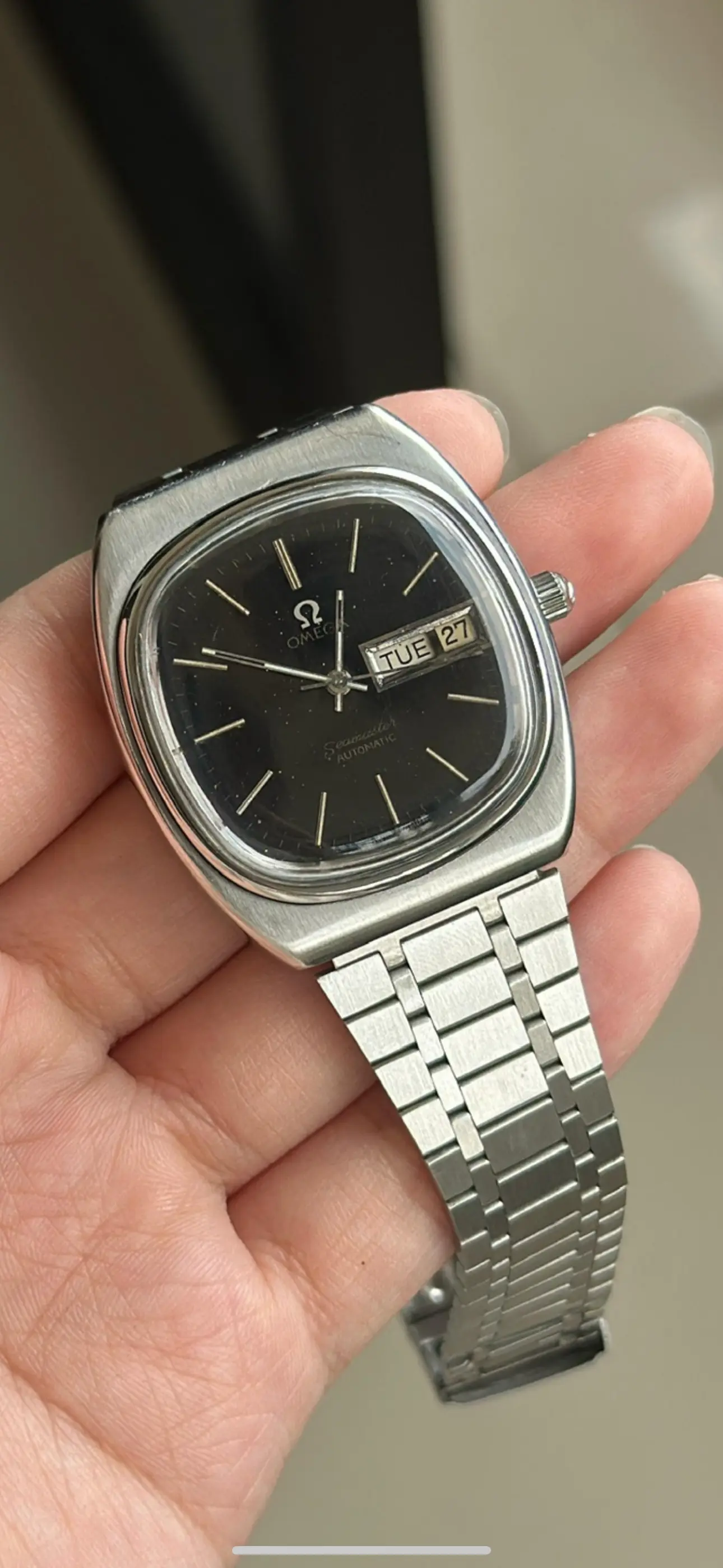

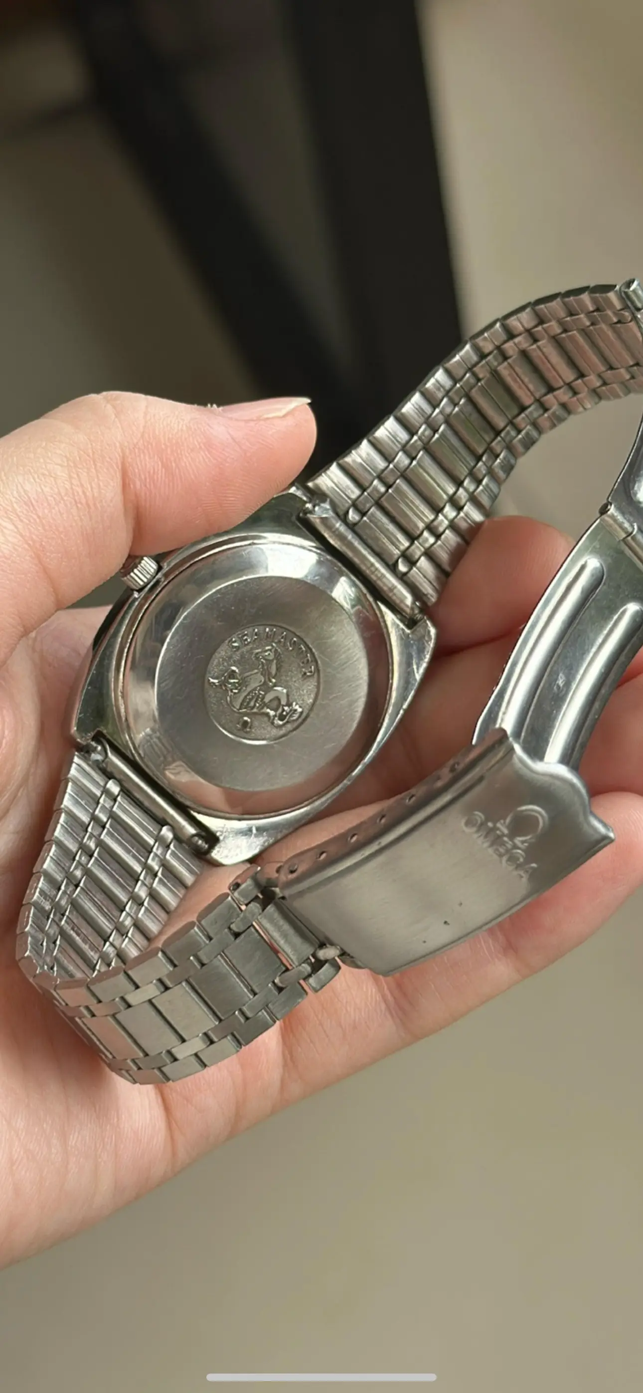

Need help :( is this seamaster auto 1020 real?
Just acquire this watch today, pls ignore the strap because it was changed. I just wonder if the body is real.. thank you so much

The case is real. It’s a (heavily polished) 166.0211.
As you mentioned yourself, the bracelet in non-Omega (except for the clasp, although I think it’s a fake clasp). And, I’m sorry to say, it’s a redial. I hope you didn’t pay too much.

I agree with ^^^.
If you aren't a fastidious collector obsessed with perfection, and you know what you've got, enjoy it for what it is.

clasp is weird. I have never seen one with Omega spelled out on it, usually it is just the Omega logo. I believe the clasp is a fake. Any pics of the movement?
