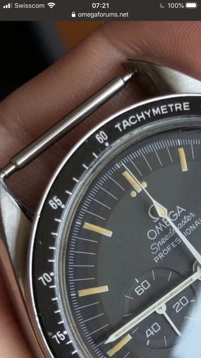

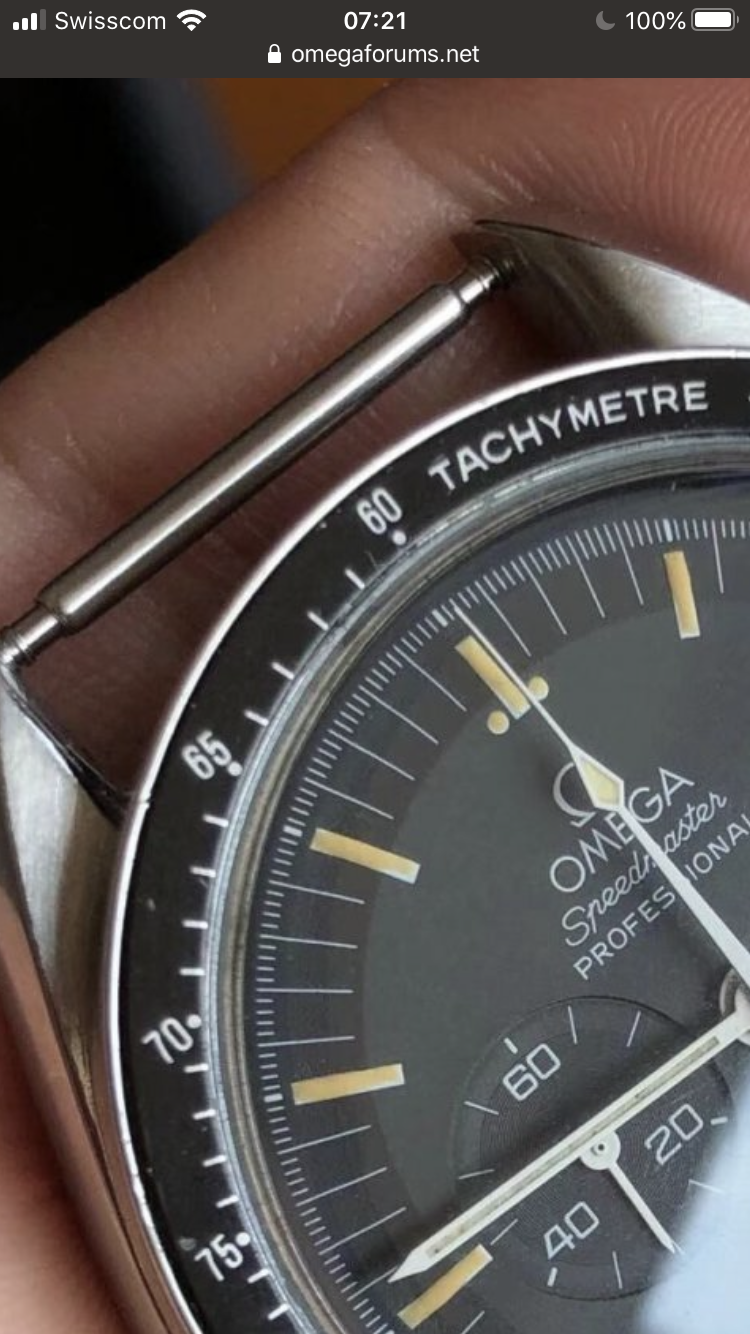

While the bezel is still a serviced one, though the inner case back can be correct.

I don't think your bezel is a service bezel.
I have owned and seen some of these watches. And also the so-called "Holy Grail" (different ref. 376.0822) falls into the range of these late 1980's, early 1990's watches. To my own observation, the DNN bezel (with the large "TACHYMETRE" font) can as well be seen as the bezel on your watch.
But, I wonder what happened to the under side of the lugs of your watch. There must have been a Dremel around...

I agree on the bezel and caseback but how can you be sure about the crown?
I saw the stepped dial and crown looked wrong for that era. Now I know it鈥檚 a 3590 and that changed things. Good thread to test knowledge

Looks we still have an open discussion about the bezel. Now we have two different opinions. Just wonderring any further data to be digged.
As of the under side of Lugs, I think it probably caused by conatacting w/ bracelet end link? Since the mark looks very symmetrical.
