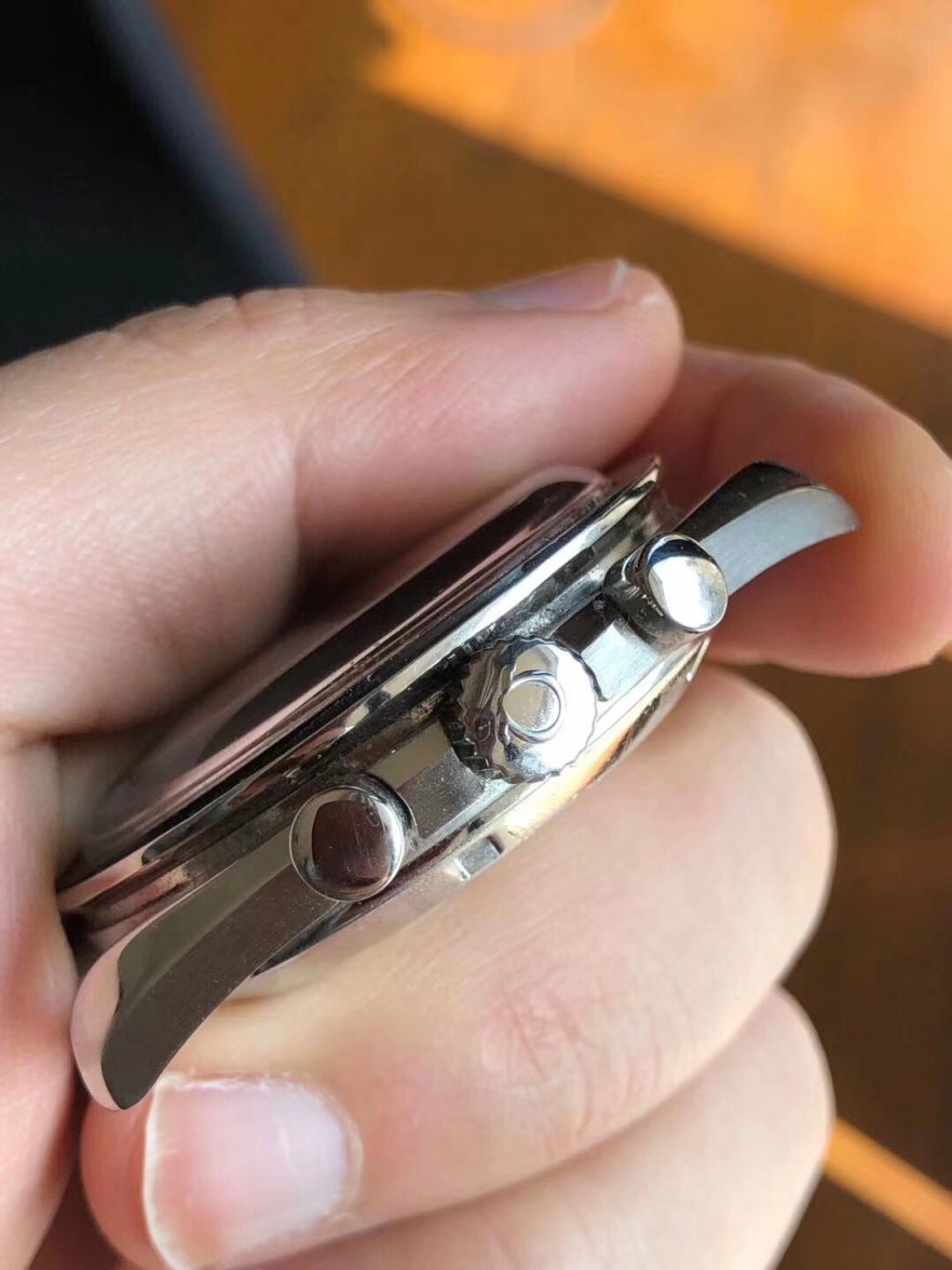

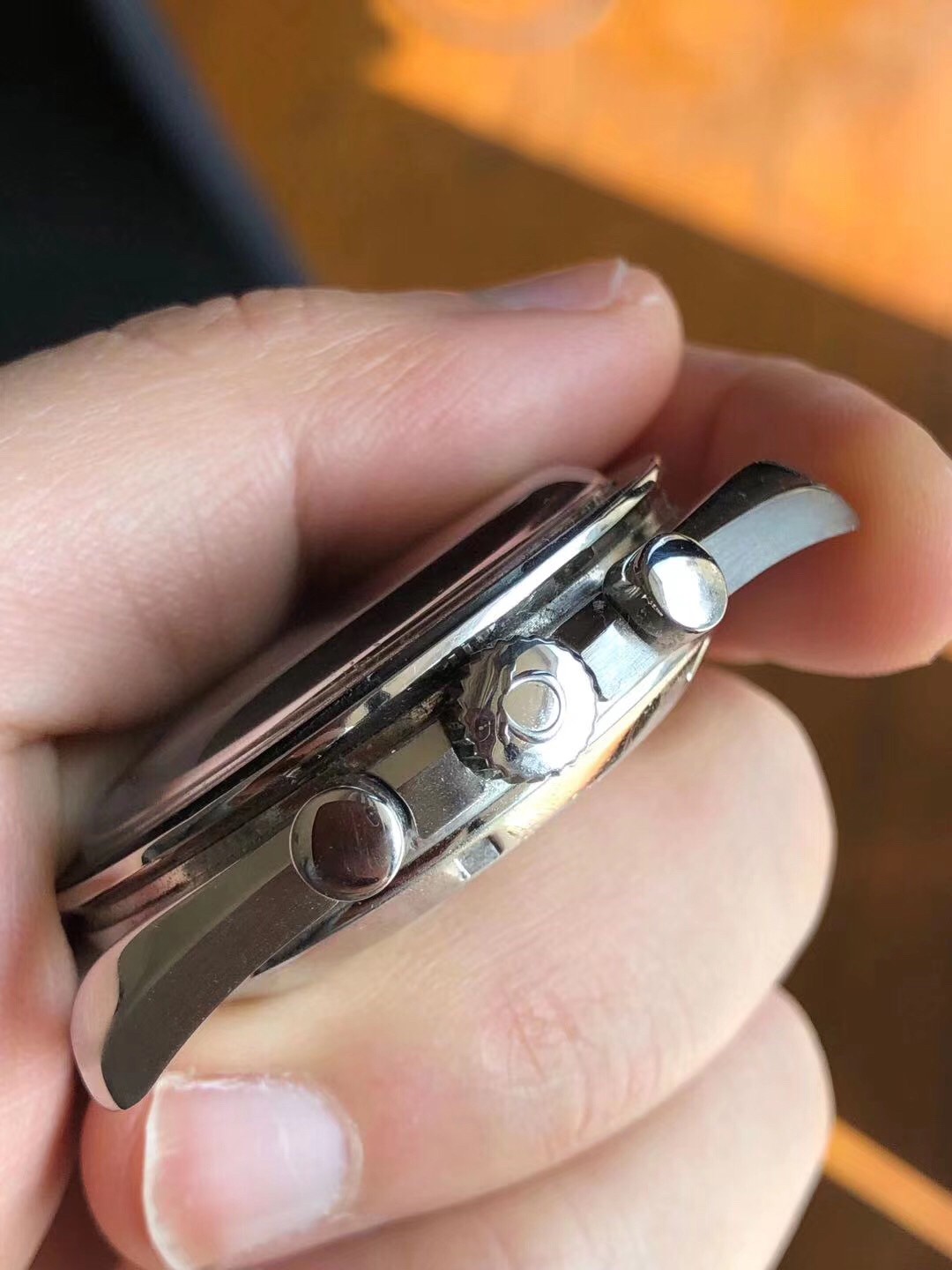

But, is that even the same watch? (first and second picture)😕
4,106
16,321
surely not 👍 first pic is most probably a premoon 145.022-69 and all the others a 145.022 from the eighties.

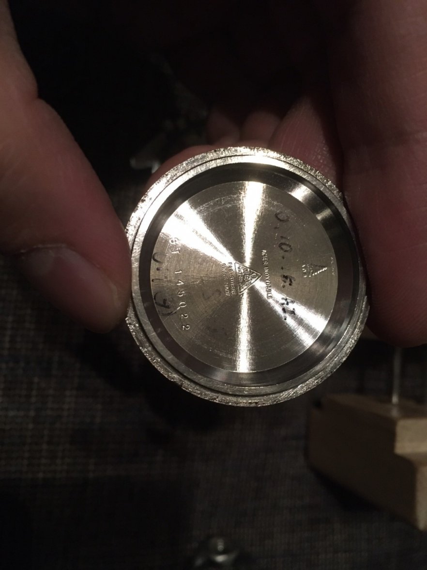

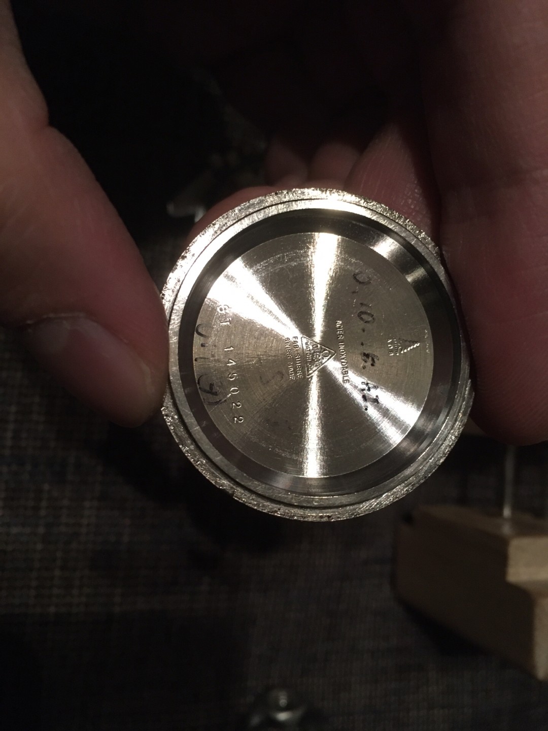

Besides that, the bezel and caseback are later service parts.
1,441
3,809

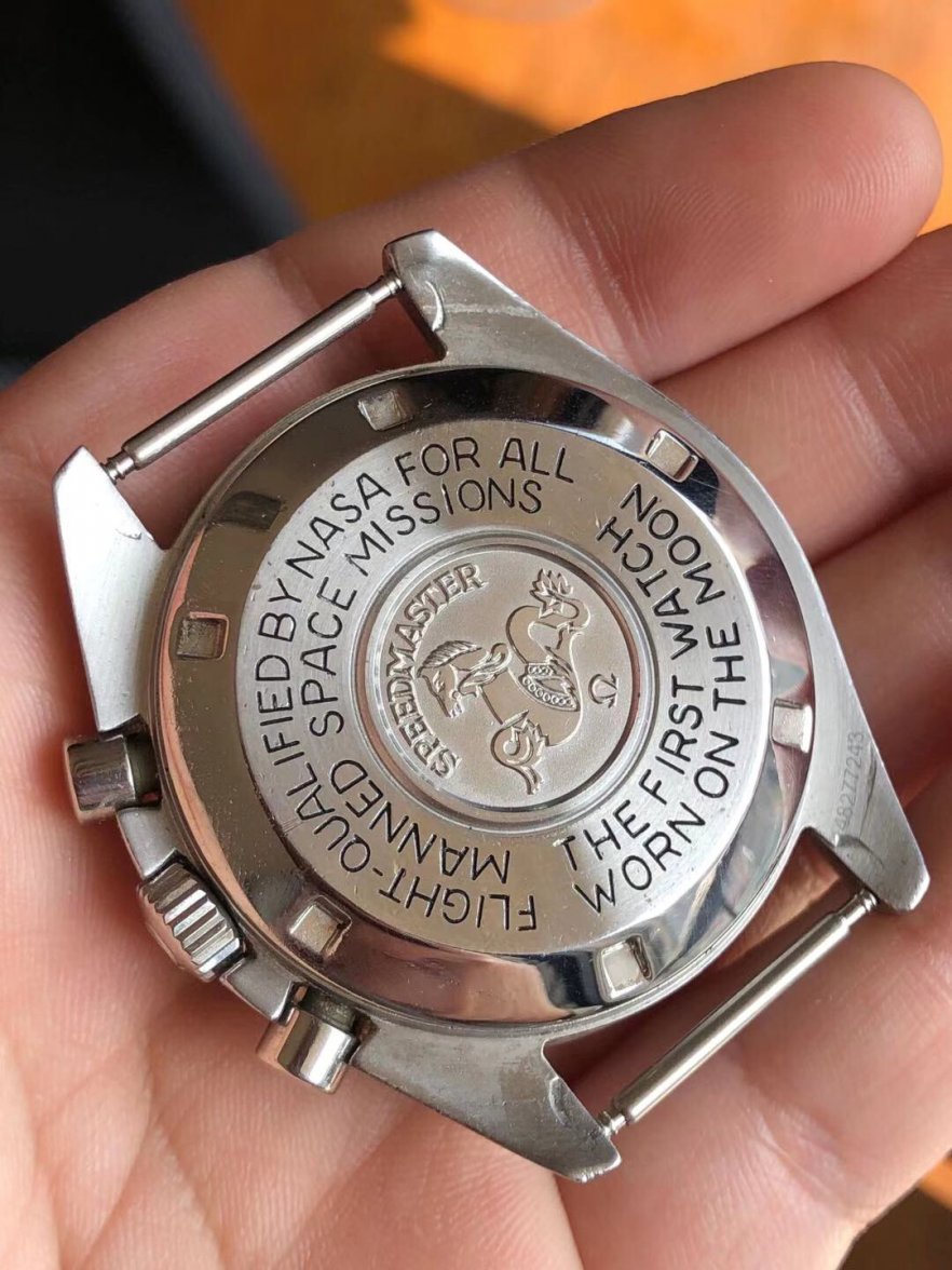

4,4M would make this an early 80s watch which would not have a step dial. So the dial is not correct for the serial (or any factory serial really). Bezel, crown, inner case back appear incorrect as well

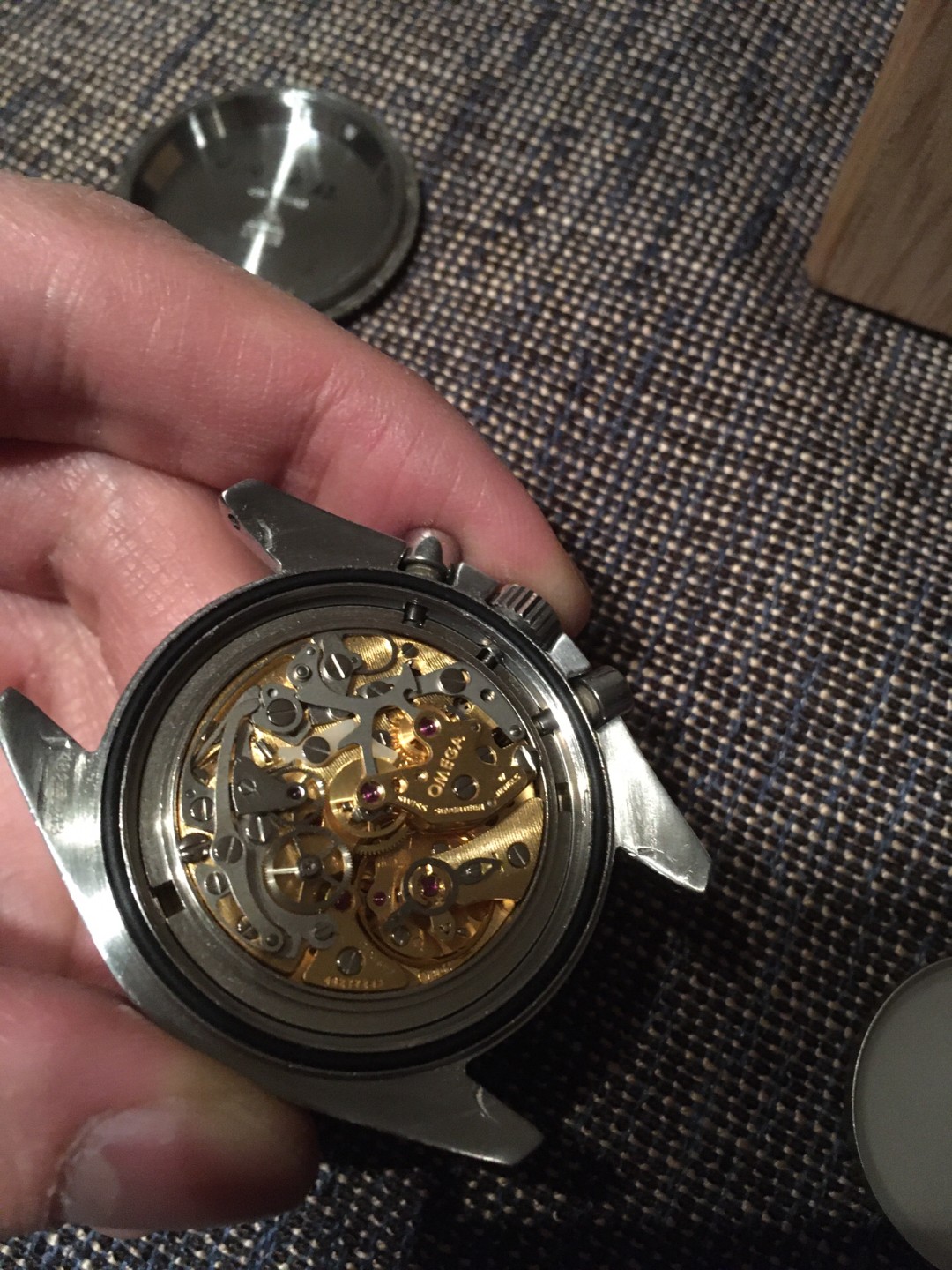

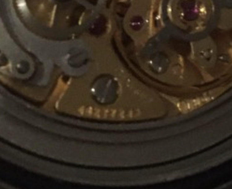

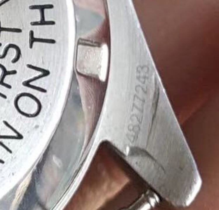

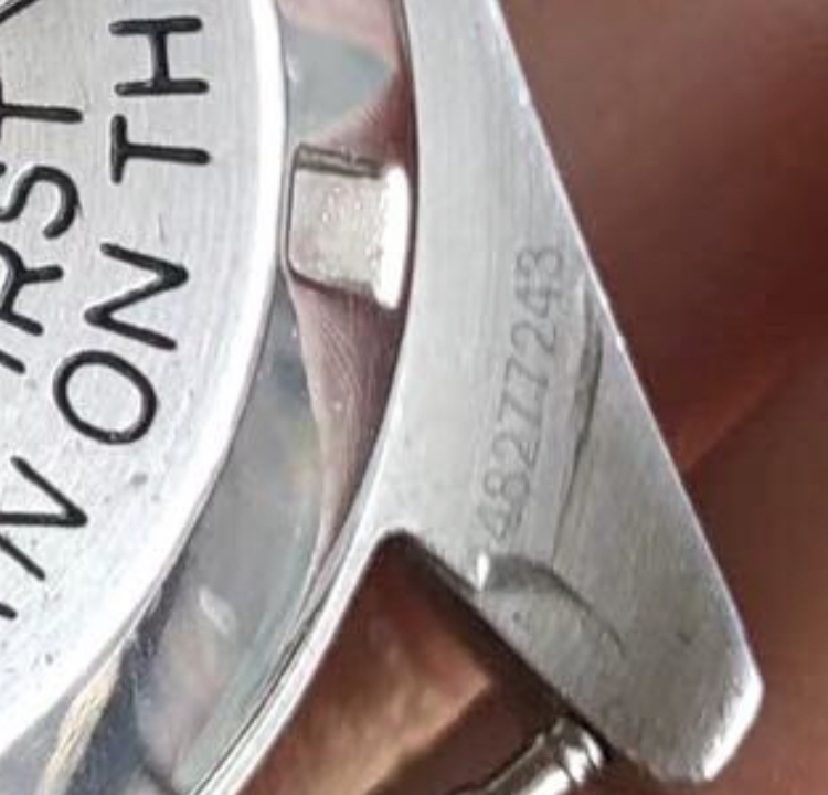

Thé serial of the movement is not the same on the case lug.

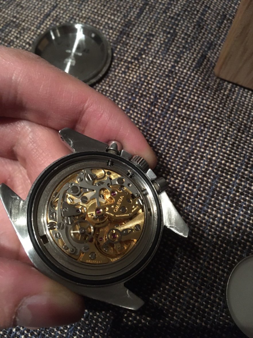

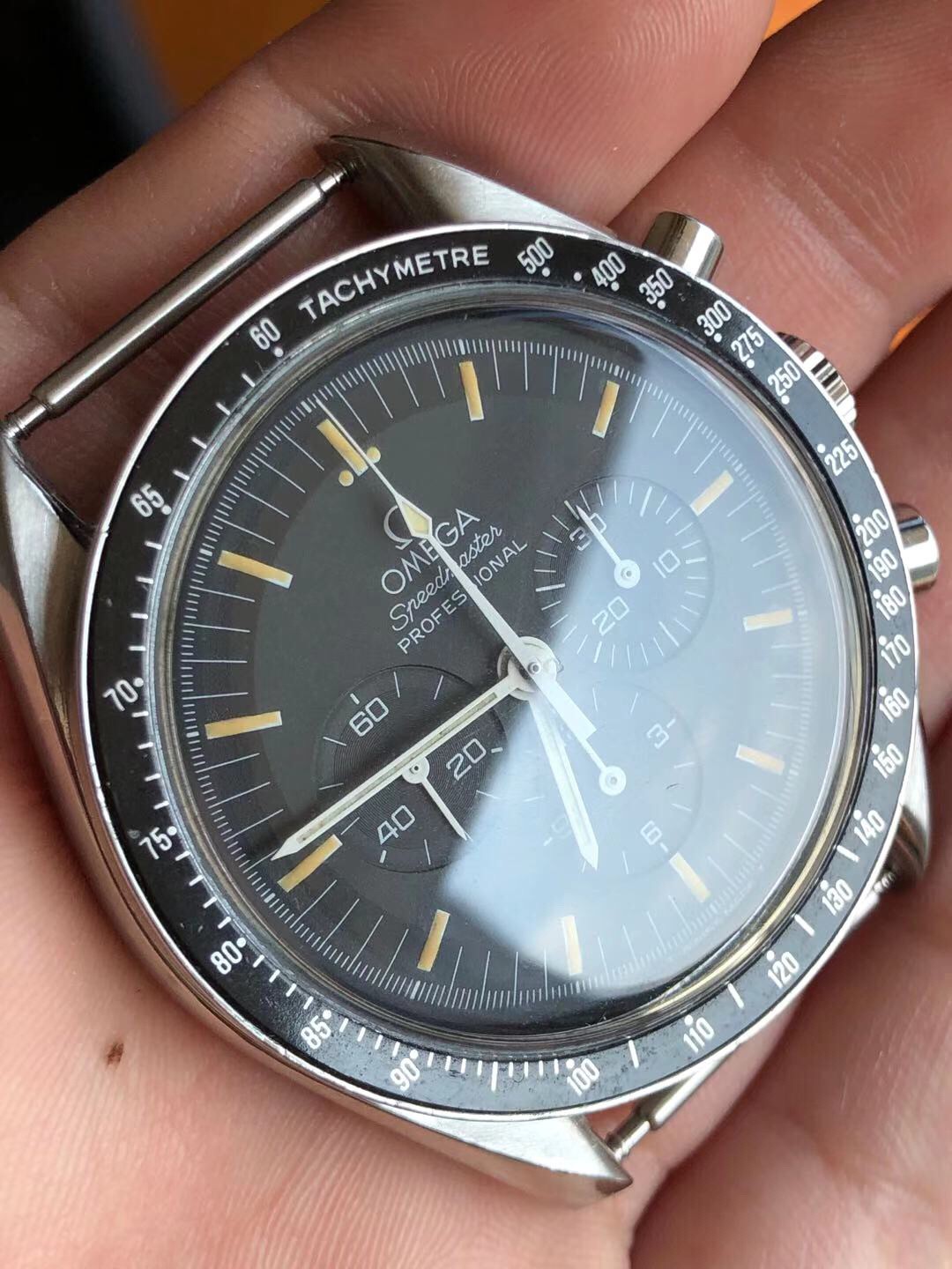

The Seller confirmed the 1st pic is from another watch. And I didn't attached all pics since too manh.

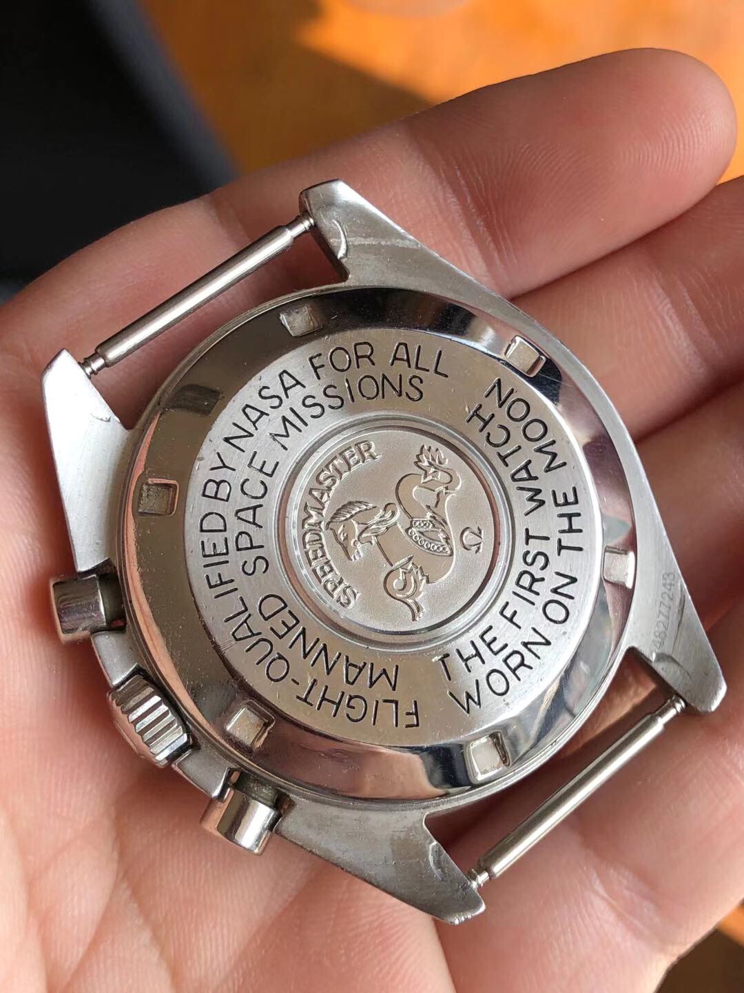

From the S/N this watch should be 90s, and how to justify the Bezel/crown/inner case back is incorrect?
I now attach the rest pictures here which claimed from same one:
Delete the wrong picture to avoid confusion.

Looking at the bezels at 110 and the 11 o'clock markers, it again doesn't seem to be the same watch.
Even image names and resolutions are different:
idlefish-msg-1585475576024-jpg (1200 x 900)
388198763159505-jpg (1080 x 1440)

Bezel: In the second pic there's clearly a polished dent near 110.
11 o'clock index: In the first pic some tritium is missing IMO.
Thanks, I have a vedio but don't know how to upload. Looks the polished dent and Tritium at 11 is about the angle of view. I'm still very curious how @killer67 and @kov noticed the incorrect Bezel, crown, inner case back.

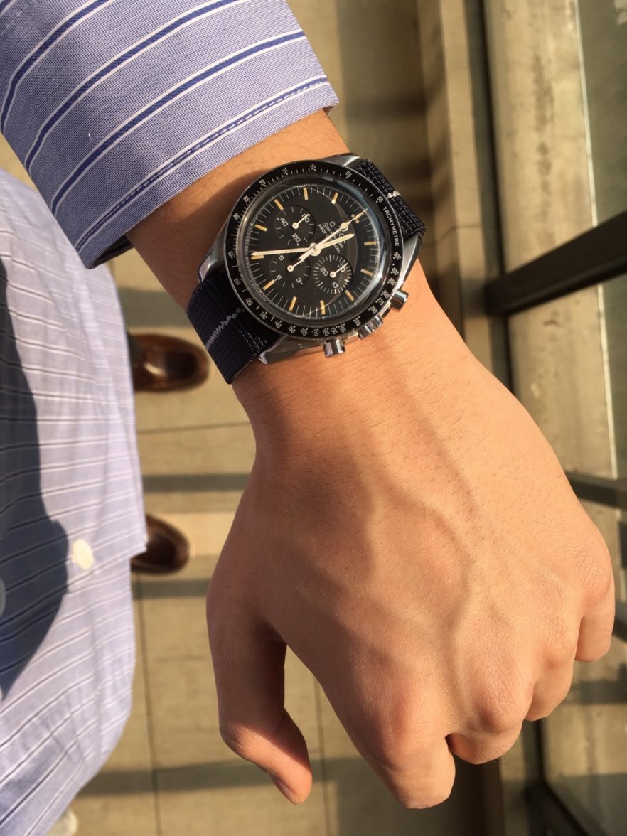

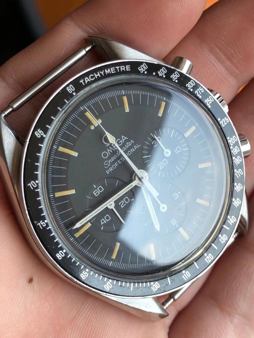

So the last picture is definitely from another watch again, just check the ‘ marker above Tachymetre on the last picture. First picture of the 80’ies Speedy is missing this. Why do we see pictures of different watches on every post so far... Either buyer beware, or there’s something 😕 going on here...
243
751
Thanks for pointing it out, I just got confirmation that the picture w/ leather strap is not the right one::facepalm1::. Forgive the unprofessional seller.
So I summary current status is:
1. The target item is a 80~90s 145.022, I'll get the clear pic of movement tomorrow to confirm the S/N
2. It does not have a step Dial
3. While Some experts mentioned the Bezel/Crown/inner case back may be incorrect, any further detail about the suspetion so I can request more details?

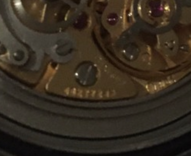

At the first glance, I would say you’re right but I think you aren’t.
It’s easy to mistake and think that this serial is not 48 millions here but chances are very low that we have only one different digit on these pictures.
4_277243 are quite clearly visible.
4,4M would make this an early 80s watch ... the dial is not correct for the serial (or any factory serial really).
But that serial is more likely to be correct so the dial is fine too, per consequence 😉
I agree on the bezel and caseback but how can you be sure about the crown?
This Speedmaster is a 3590.50 produced somewhen in 1991. For sure not in the eighties. And it is not supposed to have a step dial 😉
243
751
It does not have a step dial as I clarified the wrong pictures🤦.
How to tell the wrong bezel and caseback to justify it's a 3590.50? Due to the S/N range?
4,106
16,321
Delete that first picture and you won’t confuse people with it anymore
Based on that serial / period you can securely assume it’s a 3590.50. All the other comments are based on that assumption. I would expect to see a different bezel and a different caseback on this watch to say it’s all original. Now you have all the details to make your homework and find out 😀
