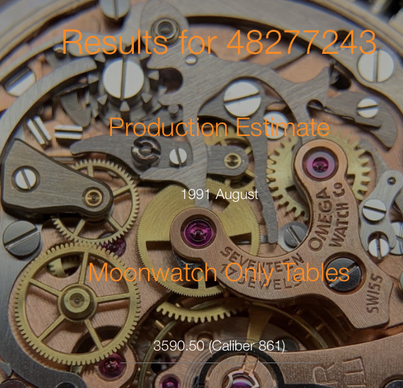

Based on that serial / period you can securely assume it’s a 3590.50. All the other comments are based on that assumption. I would expect to see a different bezel and a different caseback on this watch to say it’s all original. Now you have all the details to make your homework and find out 😀

This Speedmaster is a 3590.50 produced somewhen in 1991. For sure not in the eighties. And it is not supposed to have a step dial 😉

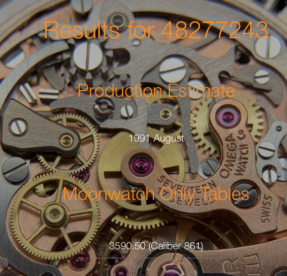

Just ran this one through ilovemyspeedmaster - came up as a Sept. 1996 watch, so 4 months out...
4,106
16,321
Yep, I told you it's a nightmare and I'm using my own reference points.
Which one? OP watch?

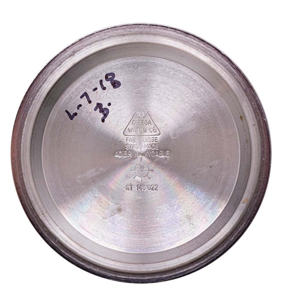

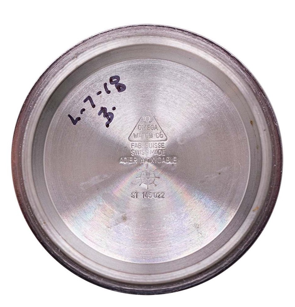

But the inner case back called out 145.022 sound still correct? And Bezel are also the same since 3590.50 are using non-DON bezel?
4,106
16,321
No, to me it's a service caseback. I would expect it to look like this :

Obviously I will not buy it giving the wrong inner caseback. And the inner caseback looks poor comparing w/ the overall status of the watch.
What do you think, the C.R.S. version wasn't used for 1990s examples?
And how would you date this one?
I can't say 100% no. But most of the Charles Rene Spielman cases I've seen were from the 1980s.
What I am sure about is that the caseback from OP is a typical service part 😀
What I can tell you is that there were more than 10 companies making Moonwatch cases for Omega since the Moonwatch exists. HF, CRS, KB and so on. Again, I am not saying that only the caseback I showed is correct. I am saying that the one from OP is not. That's different 😉

I'm not doubting what you say, but it confuses me a bit, because I think I have a believed to be NOS watch with the same caseback as on the OPs watch. I'll check this... 👍
4,106
16,321

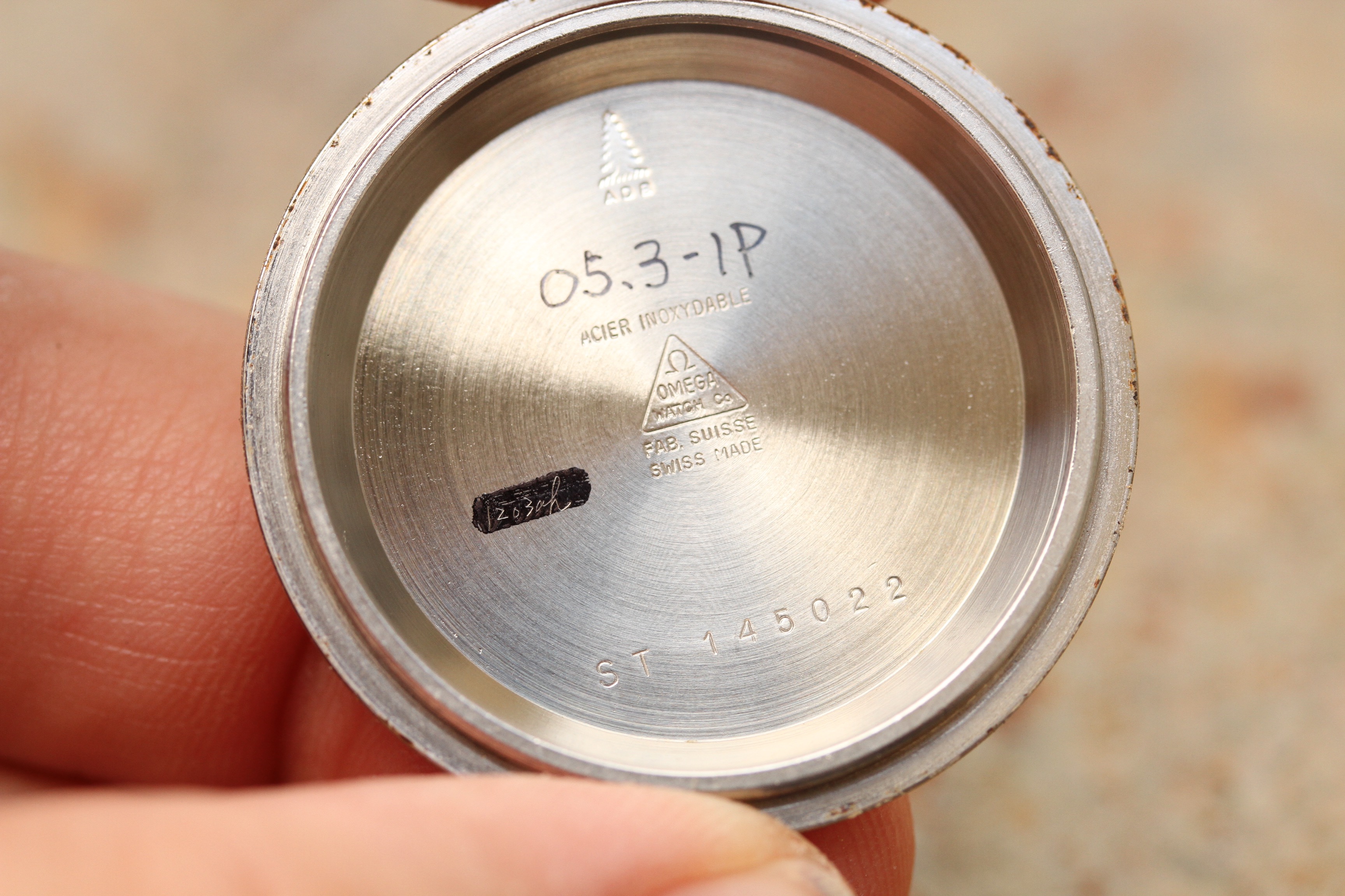

I have researched a bit and found several examples with this kind of caseback, like the OP.
img_8173-jpg.223059
The ST 145022 marking, so big and light engraved looks pretty much like the service caseback BUT what's different and what I didn't pay attention to is the fir tree at the top.
I am now thinking I've simply never had such a caseback so far and the fact that the big and light engraved ST 145022 ref looks so similar to the service parts, led me to a mistaken conclusion. This OP caseback can be correct.
2,086
2,899
