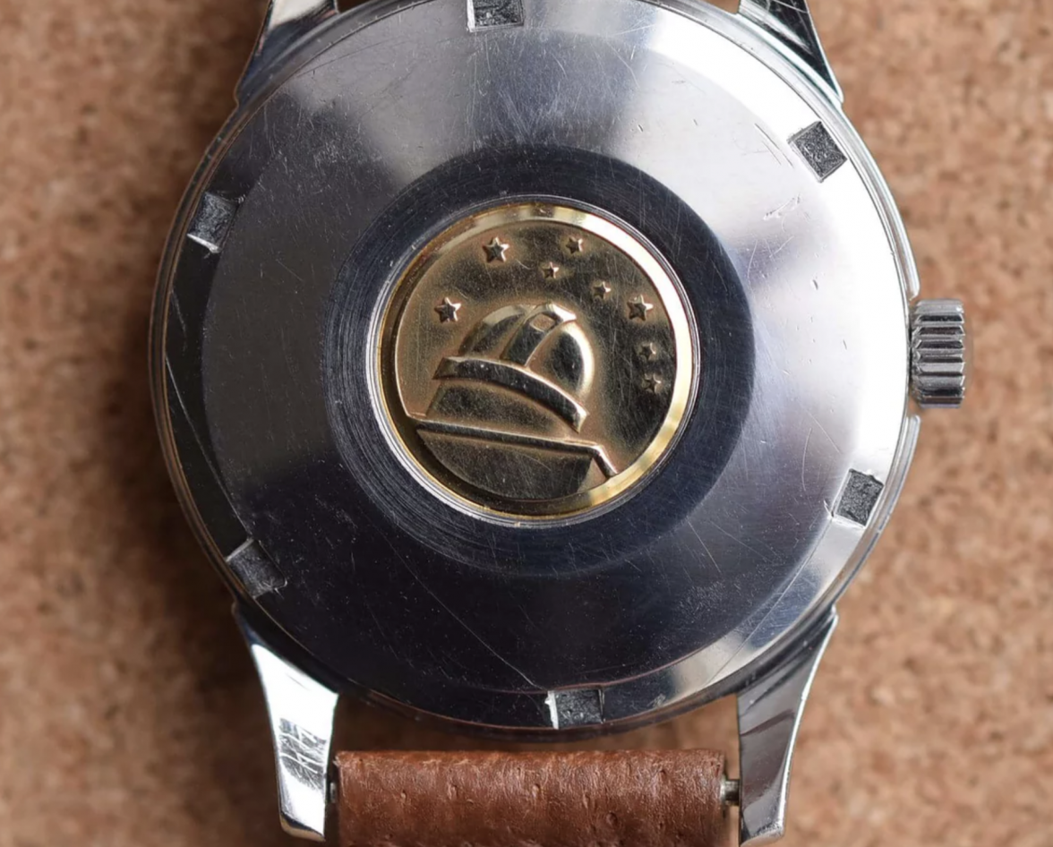

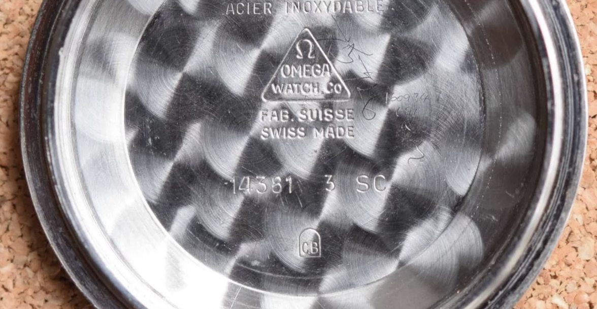

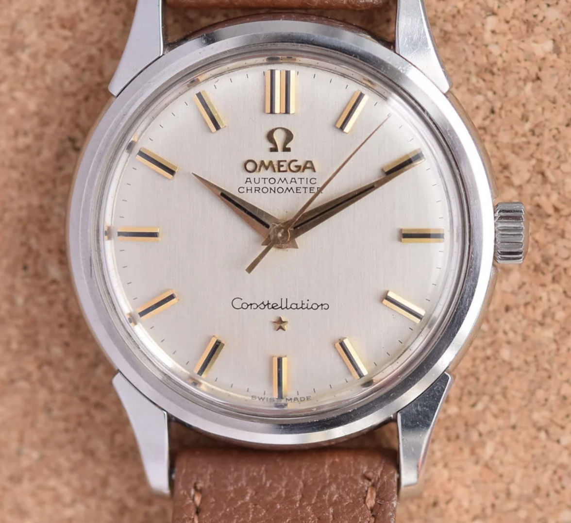

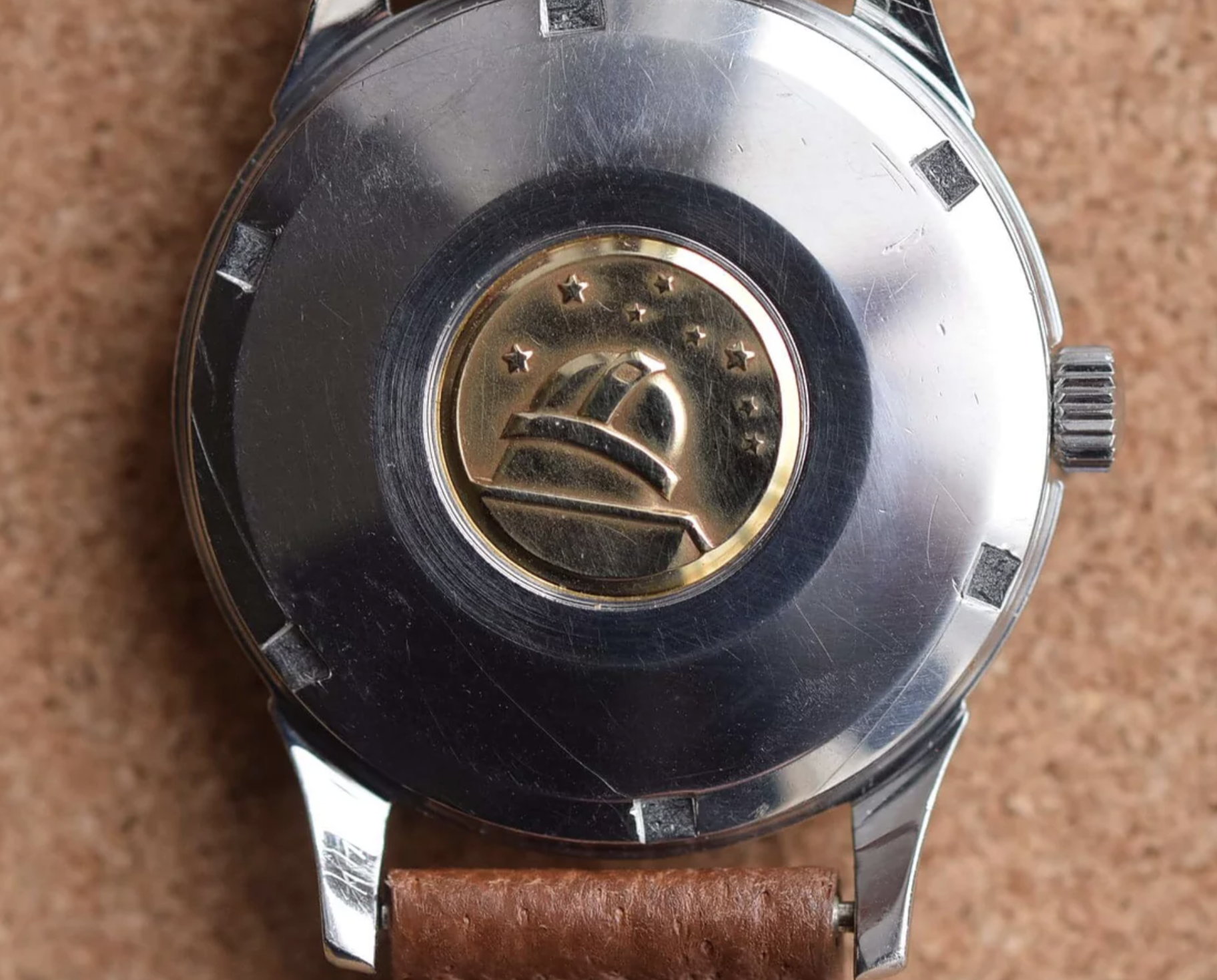

Hi all,
I am a newbie and am looking to buy a decent mint vintage Omega. I recently came across this Constellation and I am very tempted. Price-wise, I think it is definitely being quite marked up by the seller, but given my lack of experience I am willing to pay the mark up. However, I want to make sure this is a solid Constellation and not a fake or a Frankenstein watch.
According to the seller, the case is unpolished and the dial is also original. Do you think this is true to its description?

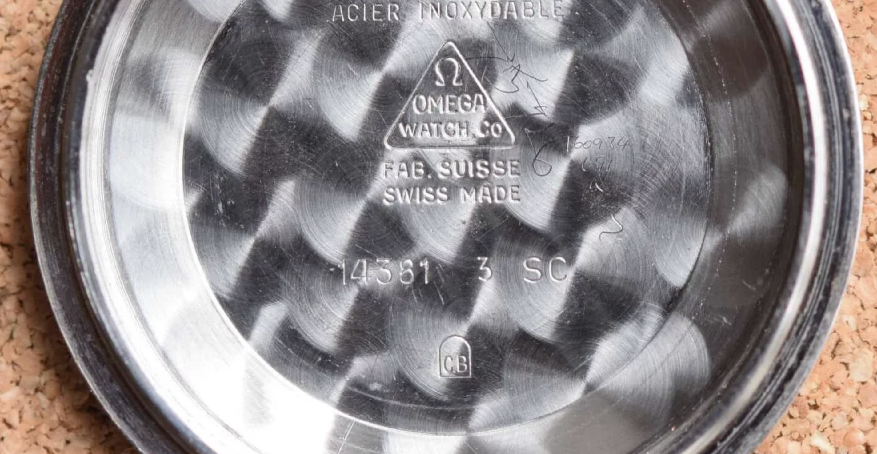

I believe this is the page from the Omega Achieve corresponding to the watch:
https://www.omegawatches.com/watch-omega-constellation-omega-ck-14381
Any input will be greatly appreciated!

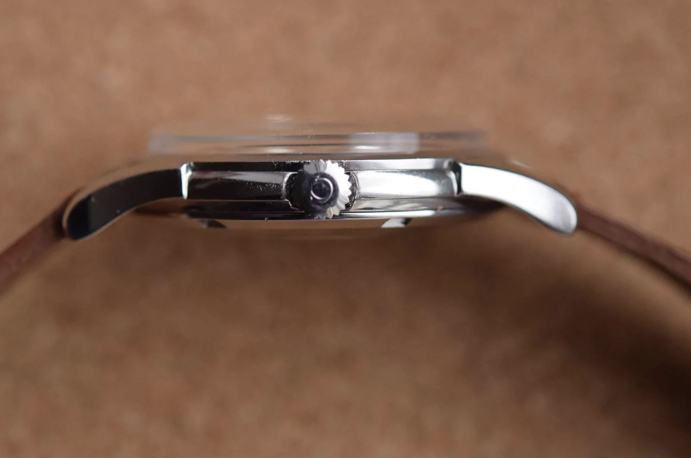

It looks good to me apart from the incorrect crown and scratches on the case back. I guess how good it is depends on the price?
1,120
1,792

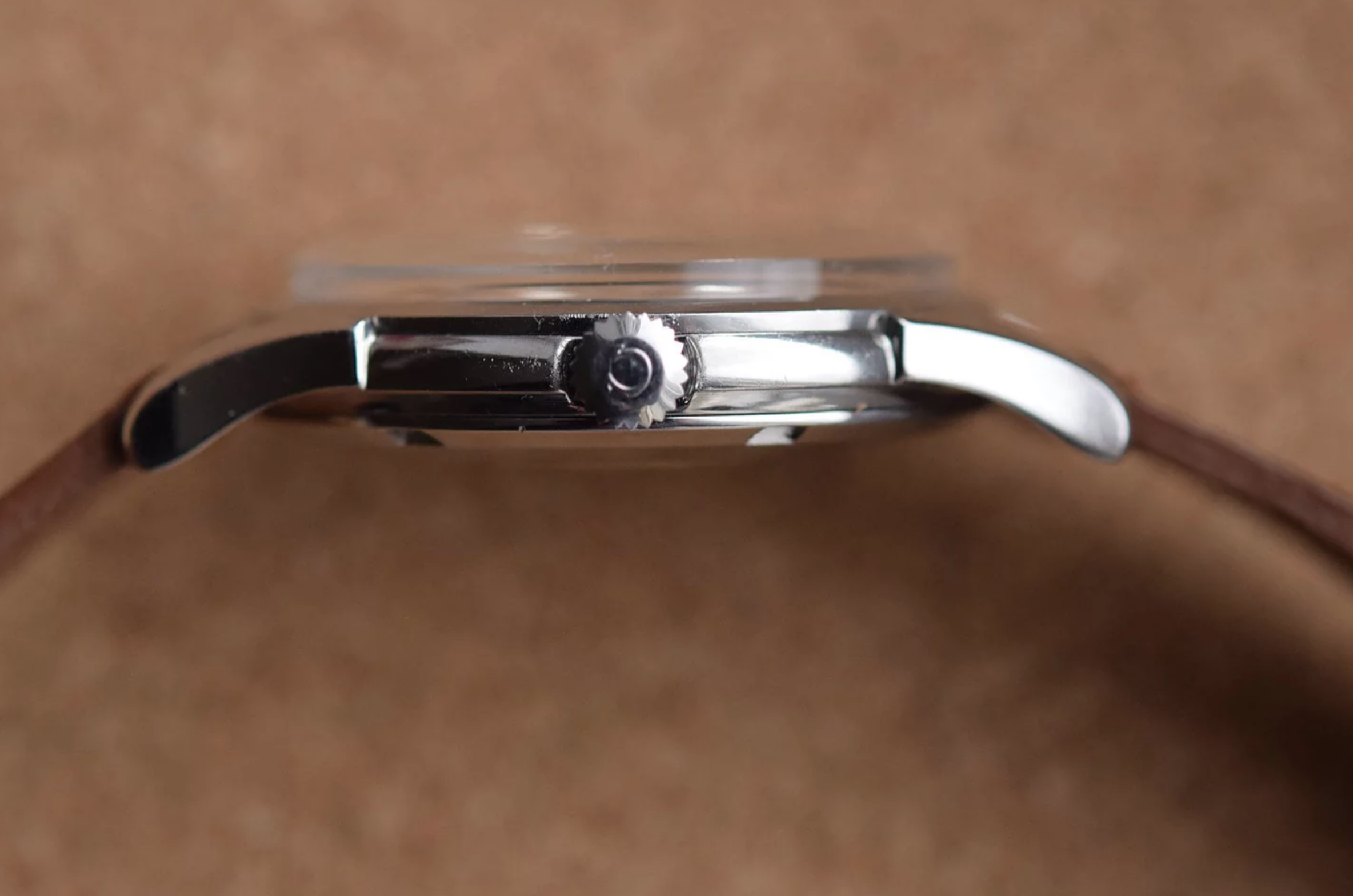

Sellers often claim their watches are unpolished (and serviced) so please take these statements with a pinch of salt. The crown is a later service replacement and would have originally been fitted with a scalloped or thin decagonal type. Apart from that everything else looks correct for this reference.
All comes down to price I suppose. For me it’s a £700 - £900 watch.

@Noddyman, Thanks for the input. Great to hear that all looks correct except for the crown. The price is definitely decently more than what you suggested. But I guess it's the newbie premium. I will try and see whether I could find some other good bargain. But if not, I will probably bite the bullet and go for it, since it speaks to me.
Speaking of the crown, do you know how I could try to find the original one for this reference? If I end up getting this, I might want to find the right crown to replacement the current crown.
I started read up Constellation crown, and I think one could write an essay on Constellation crown. It is hard to pin down which one it should be. And I haven't bee able to find any picture/achieve of this same watch online to figure out what the right crown should be.
@ConElPueblo it seems like you have a wealth of knowledge of Constellation. Maybe you have some ideas?
Looking at http://www.ofrei.com/page_147.html, it looks like the replaceable crown now for case 14381 is 8100/1080, which looks like the one that is on the watch at the moment. I would like to know which scalloped or decagonal crown I should look for.

The OPs watch is really quite nice however, it is not entirely unpolished as the facets on the lugs are soft.

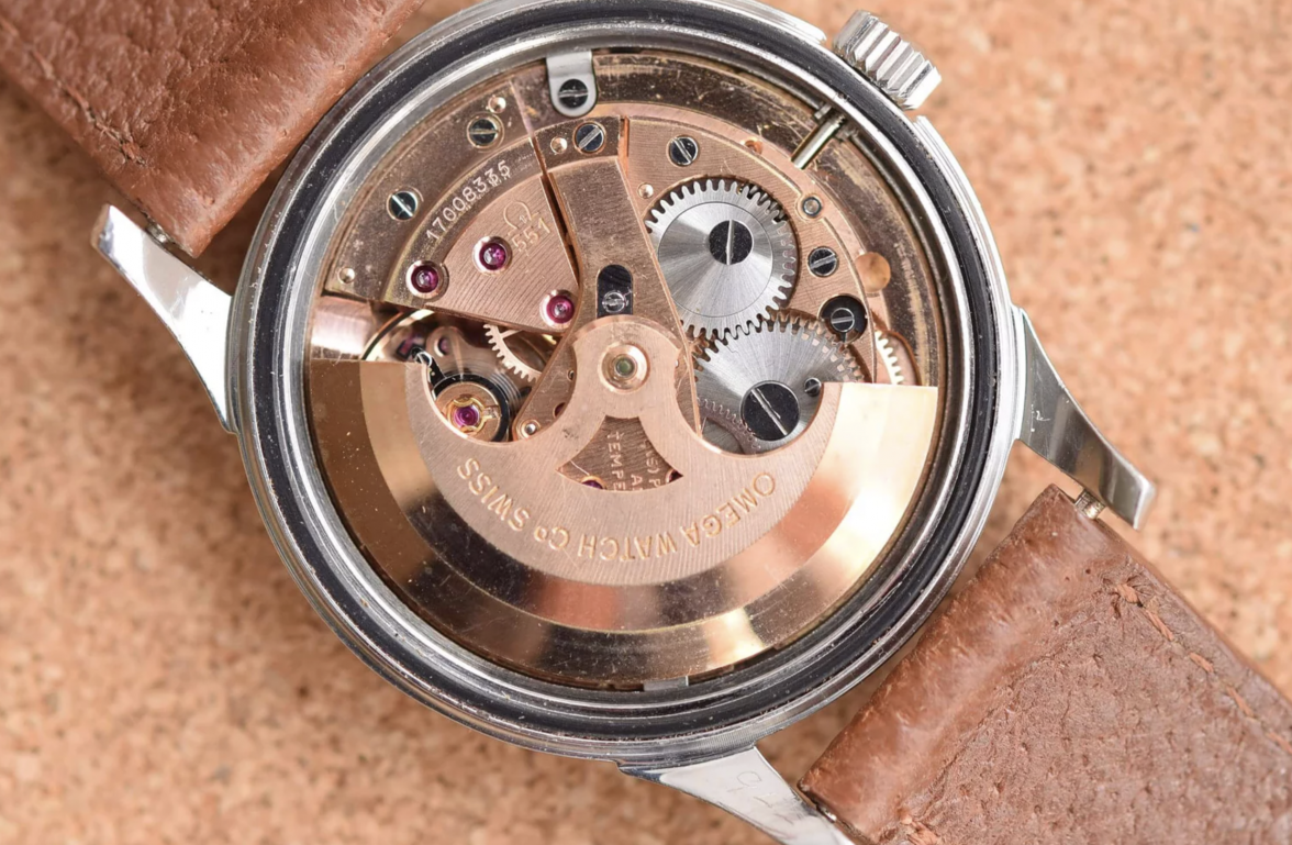

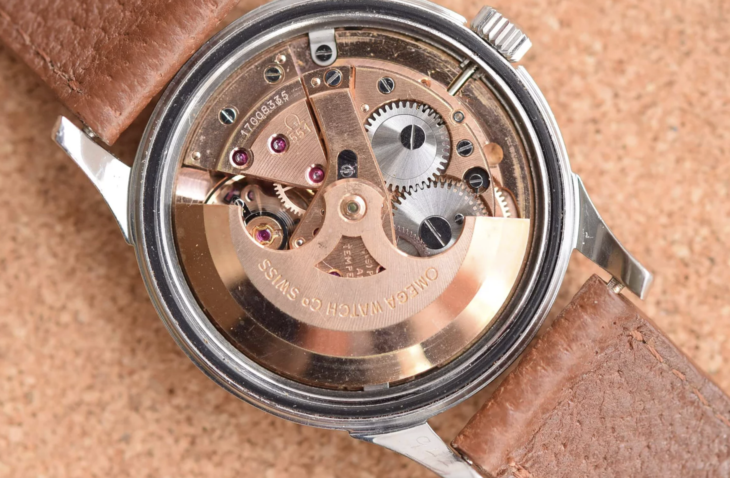

The movt has some rotor rub so if you are paying a premium be aware the watch requires a service.
(What exactly is the asking price?)
The correct crown is the classic slim decagonal but this reference is so frequently seen with a scalloped crown that it is also believed correct.
@ConElPueblo ’s thread on the subject.
https://omegaforums.net/threads/the-curious-case-of-controversial-constellation-crowns.54568/

The rotor rub may have been sorted if the watch has been properly serviced.
