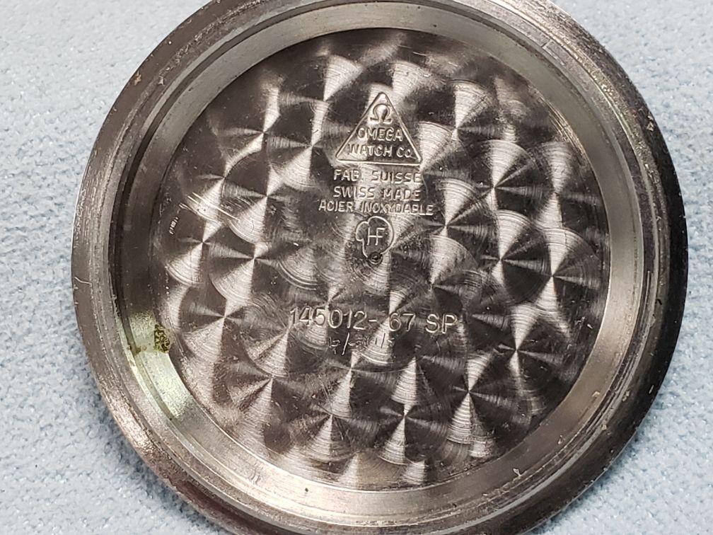

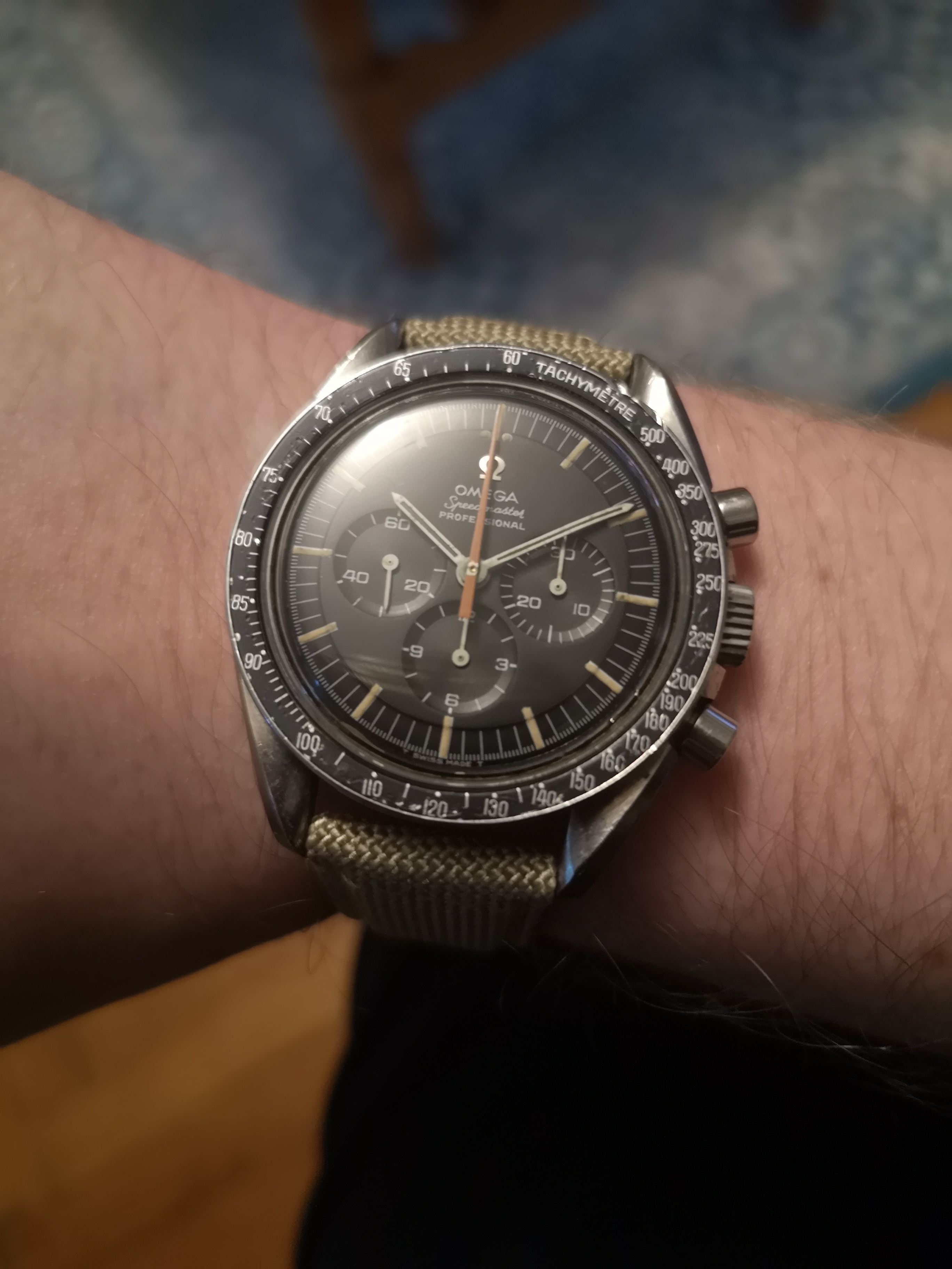

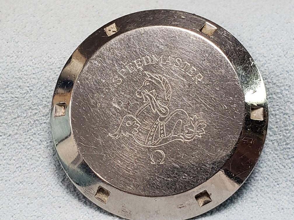

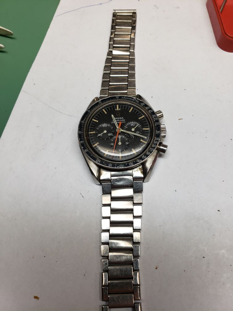

Hi guys. I live in a small community here in Canada and I was recently able to purchase what appears to be a 1967 ultraman from the original owner. It was his dad's watch and he had it in a drawer for 40 years. It was full of dirt and gunk when I got it. I cleaned up the bracelet and the dirt between the bezel and crystal and gave the crystal a very light polish. I ended up putting it on a strap.
I did some research and everything seems correct to me with regards to the serial range, case back, and bracelet stamp. I also fully believe the gentleman I purchased it from.
I was wondering if you guys think it is worth it to request an extract of the archives as I live in Canada and I think they are electronic. Do they even confirm it came with orange hand anymore? I heard they stopped doing it..
I will probably be posting this for sale here at some point. I just want to make sure it all looks good. It does to me but I am not an expert in this model.
Thanks,
Josh

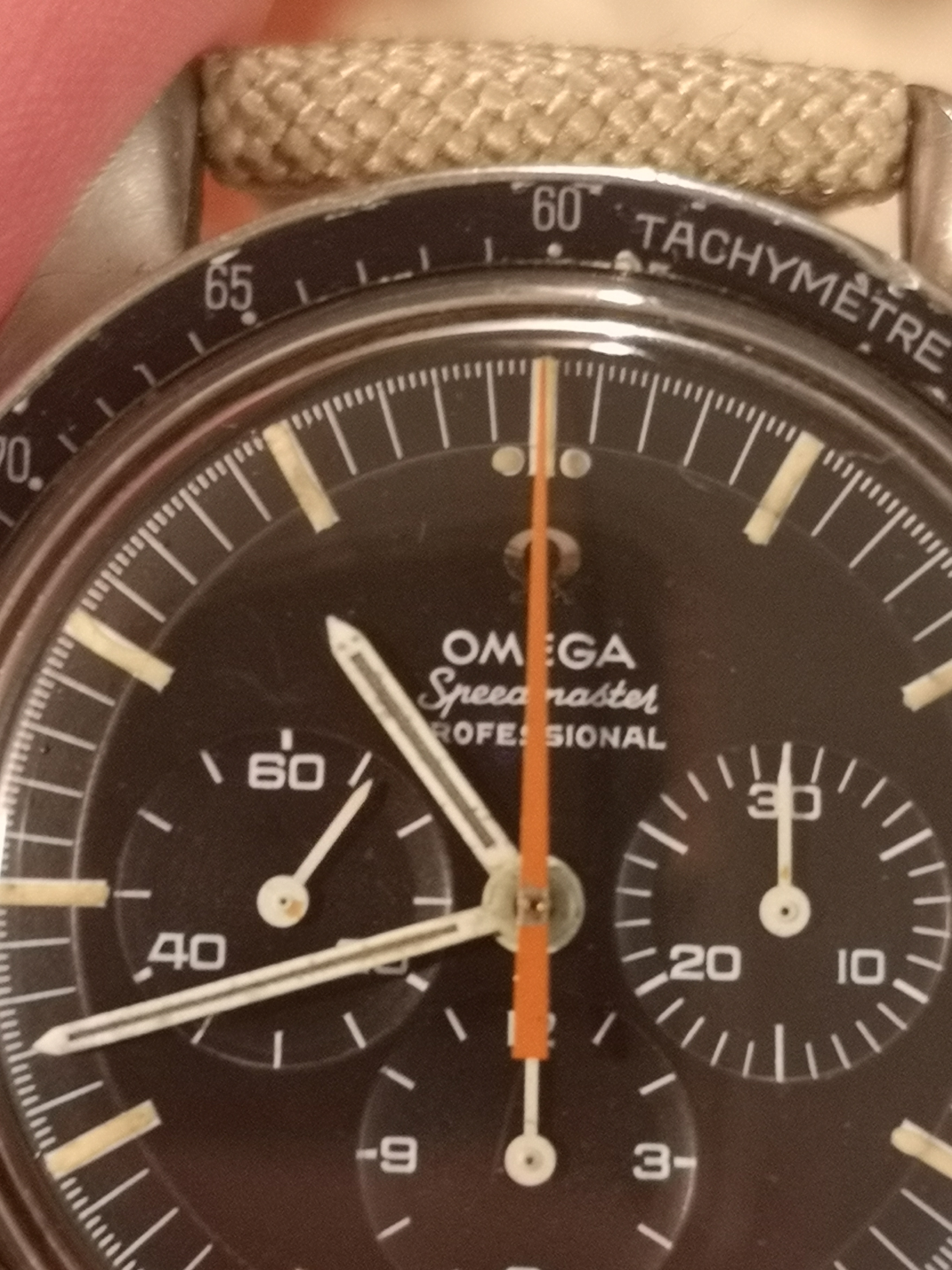

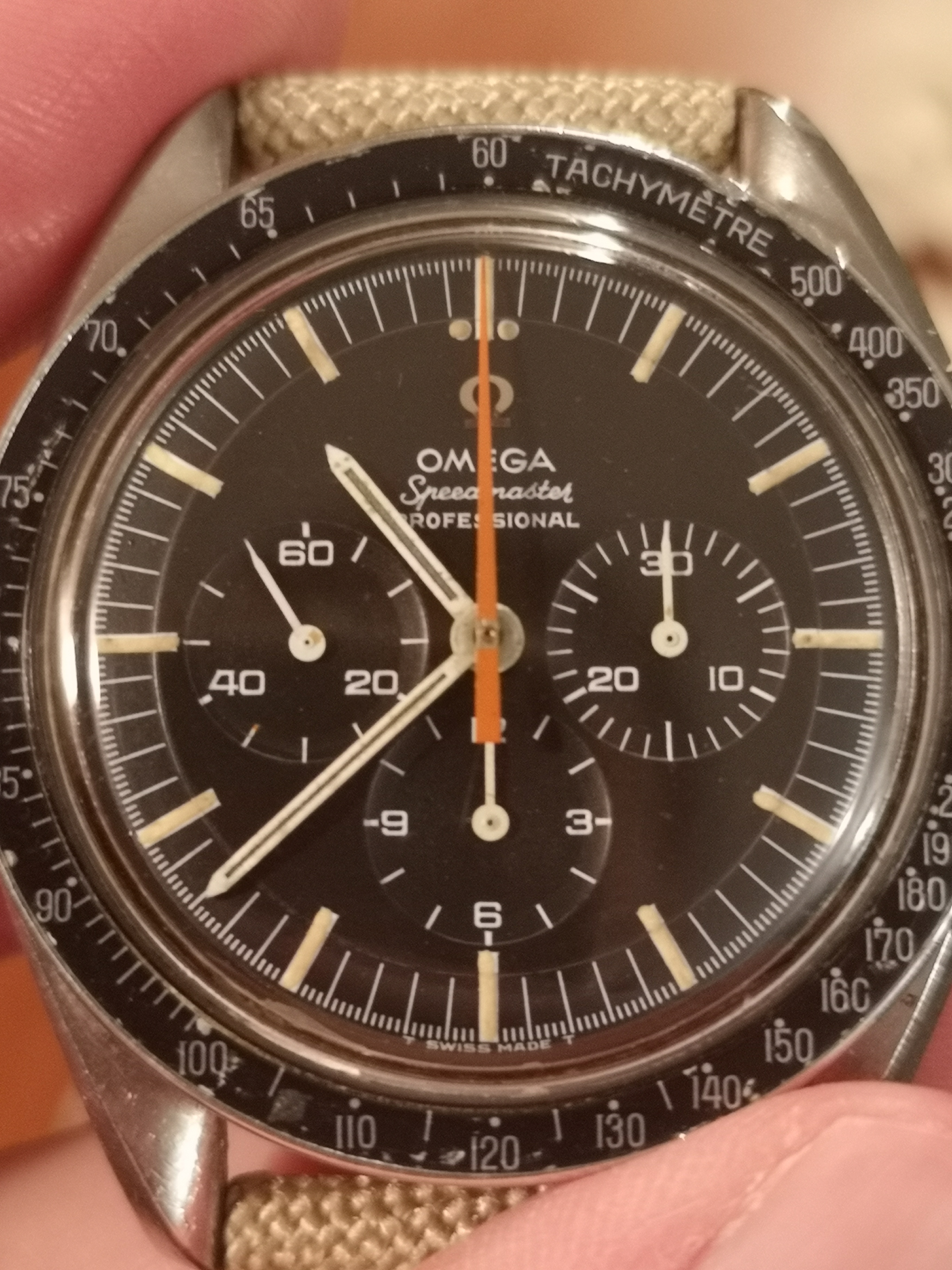

You will need better dial pictures to get any real help. Zoom on the tip of the chrono hand and dial as well.

This may have to wait until I have a better camera on hand. How is this ?

Looks like there been some damage/ paint loss where the hand has been previously removed which will make buyers wary. Apply for an extract, you will find it difficult to obtain UM price without one.

I don't even know if they put any remarks on the extracts any more when they are sent virtually.. So not sure if that will help but I did apply for one.
There is some paint loss.

The watch looks fine to me.
Get the exact for it
Omega now ask that you send photos too. I can’t see any reason why you won’t get an archive mentioning the orange hand.
The paint loss on the hand comforts me, it tells me that the watch hasn’t been tarted up.

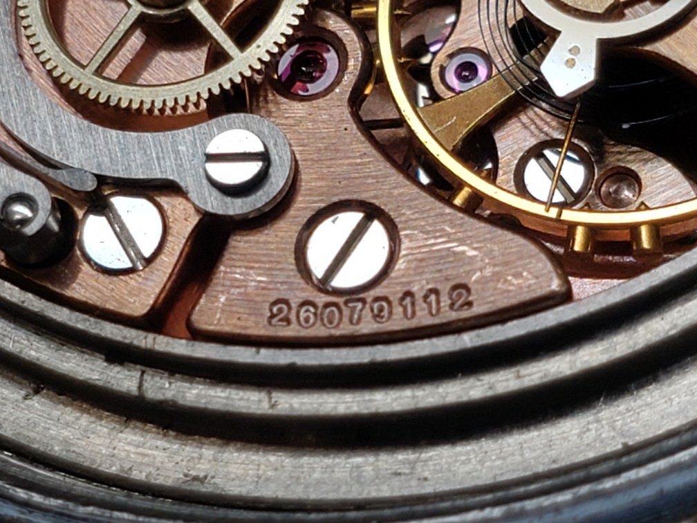

The serial number range seems correct as well.. 26.076.xxx and 26.079.xxx.

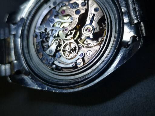

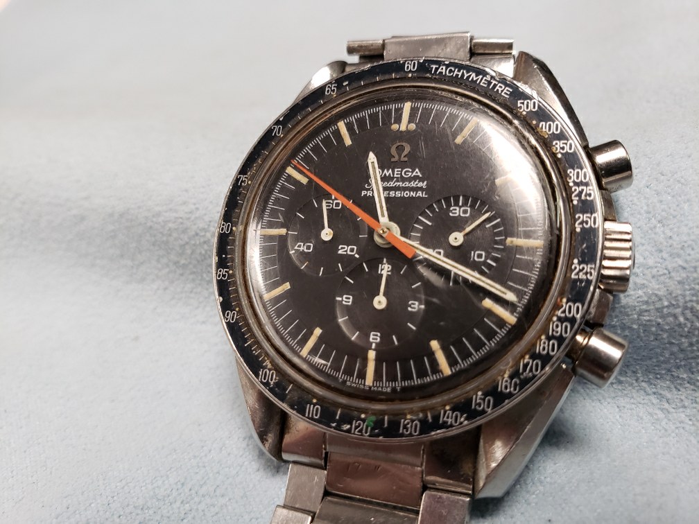

If you want to be comforted further. This is what it looked like when I pulled it out of the drawer the other day before I cleaned it up a bit. Note all the gunk between the bezel and crystal and on the bracelet. It took some serious tlc

Agree, all looks good. Really hope you’ve found an original UM. Please update the forum on what comes back from the archives. Good luck!
