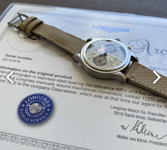

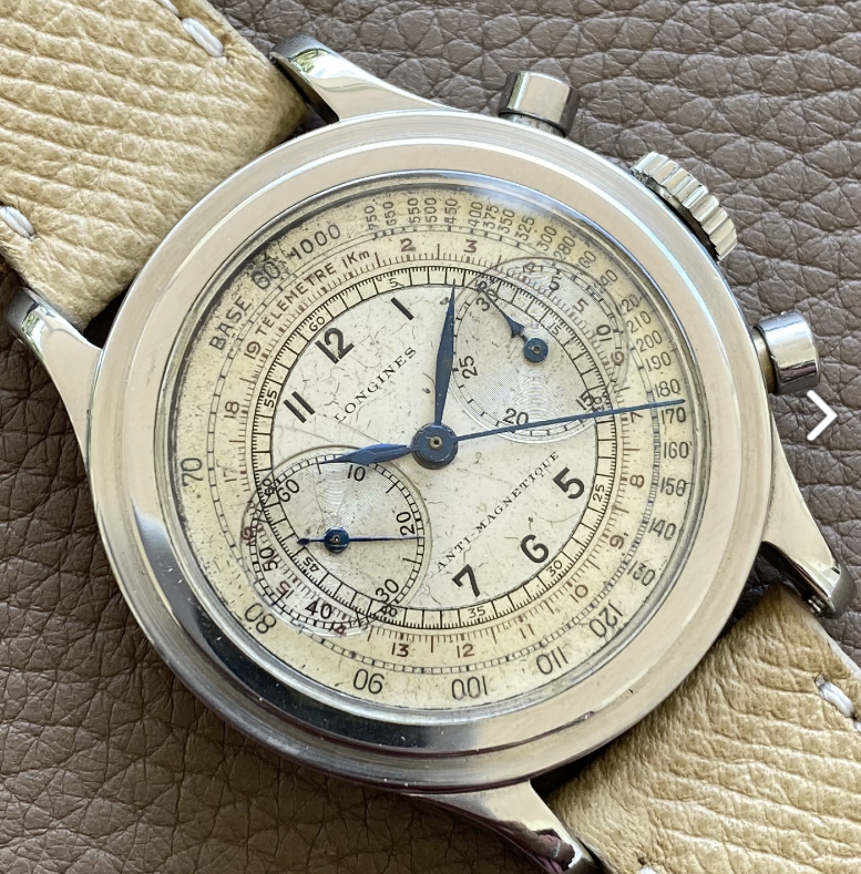

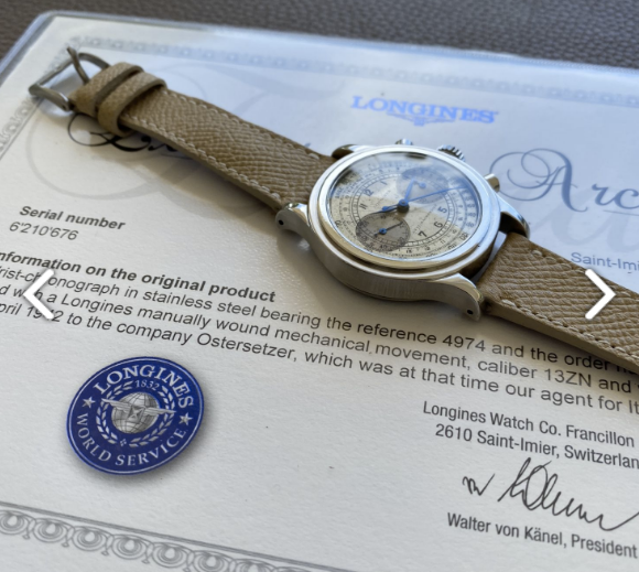

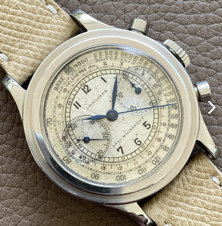

Right off the bat, it must be stated that ref. 4974 is one of the most sought-after Longines references. The design of the case, with its round pushers and screw-in back, make it a relatively early attempt at a waterproof chronograph. The stepped bezel and large size are also desirable. Assuming that the dial is worn but original, a correct set of hands, crown, and movement restoration would make this watch worth north of $30K USD, and maybe a lot more. Below is an example with an original (not refinished) dial, correct hands (barring the chronograph second hand), and a correct crown.
At this point, it is probably worth speaking with Longines' restoration department to see if they have the correct parts (crown, hands, movement parts) to service the watch. Sending the watch to Longines will be expensive but probably your best bet to acquire the correct parts. Also worth emphasizing is that the originality and condition of the dial is of the utmost importance to collectors/for value. So, it would be imperative to instruct Longines to not touch the dial, which they should comply with.
