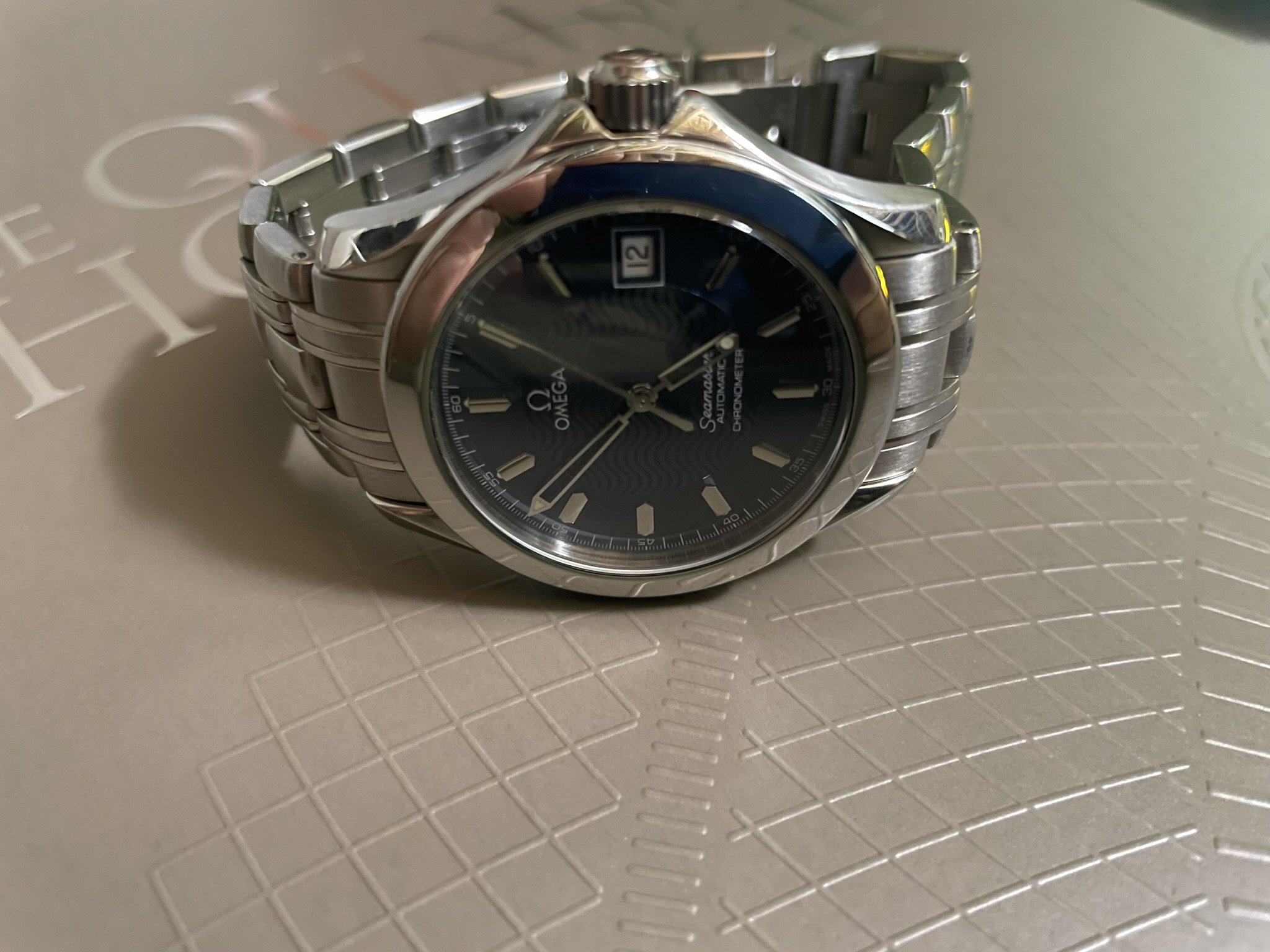

So I get the watch in, using Crono24 because this is JDM. Of course, the first thing I did was say, 'wow this thing is gross and smells weird' so I took it to my 'watchmaker' who is really just a buddy of mine with a basement, but he is more than capable of checking it out, time graphing it, and giving the bracelet an ultrasonic bath. In other words, 'hey man could you check this out for me before I send it off for a $700 service?'

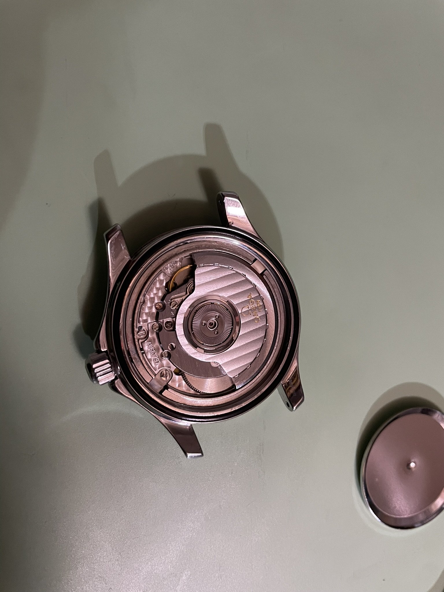

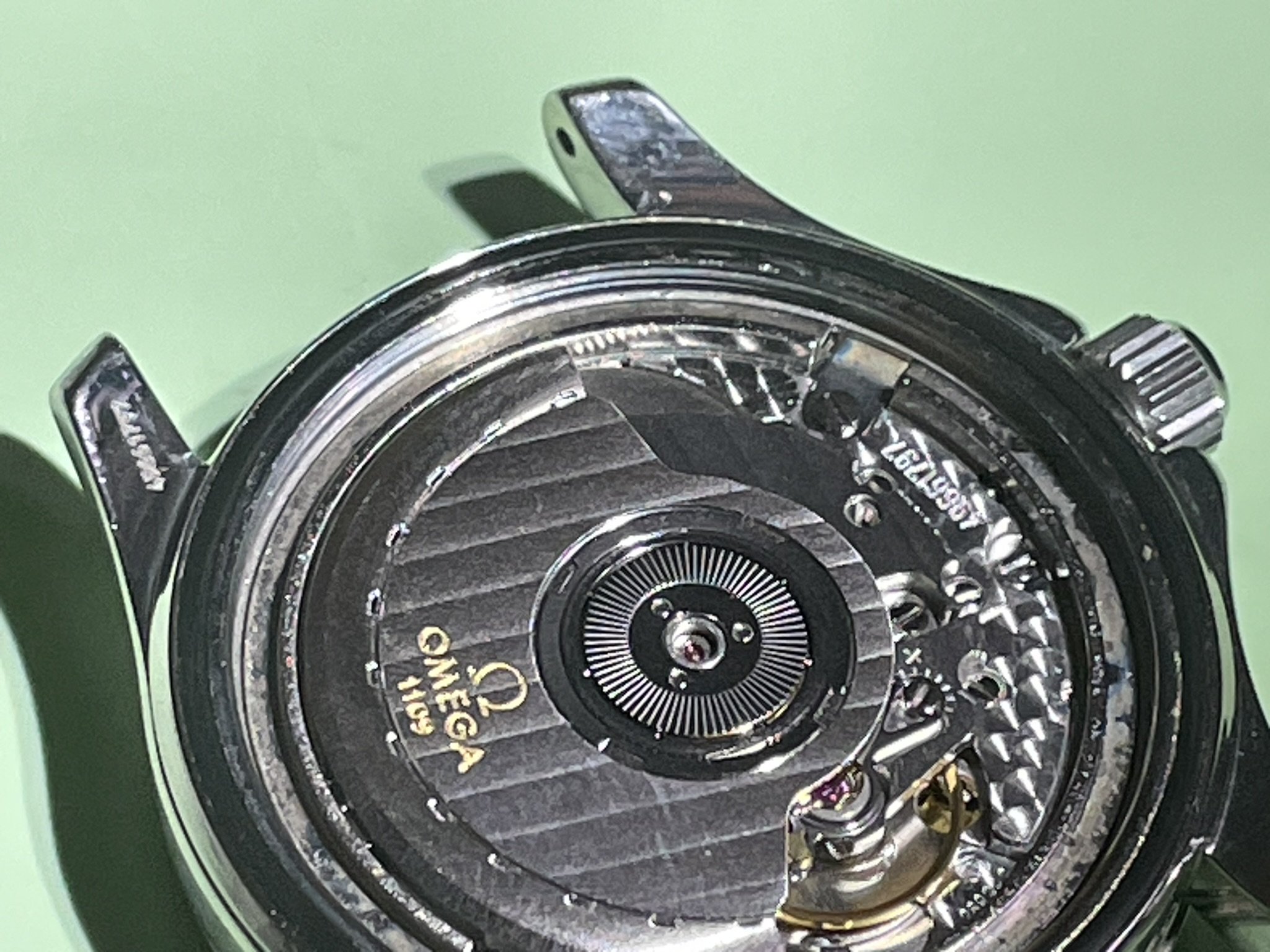

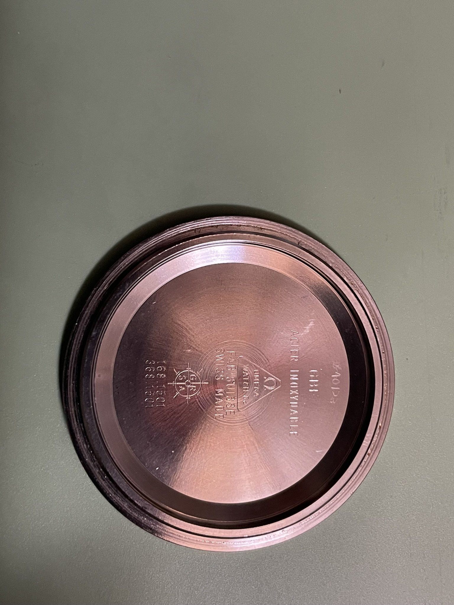

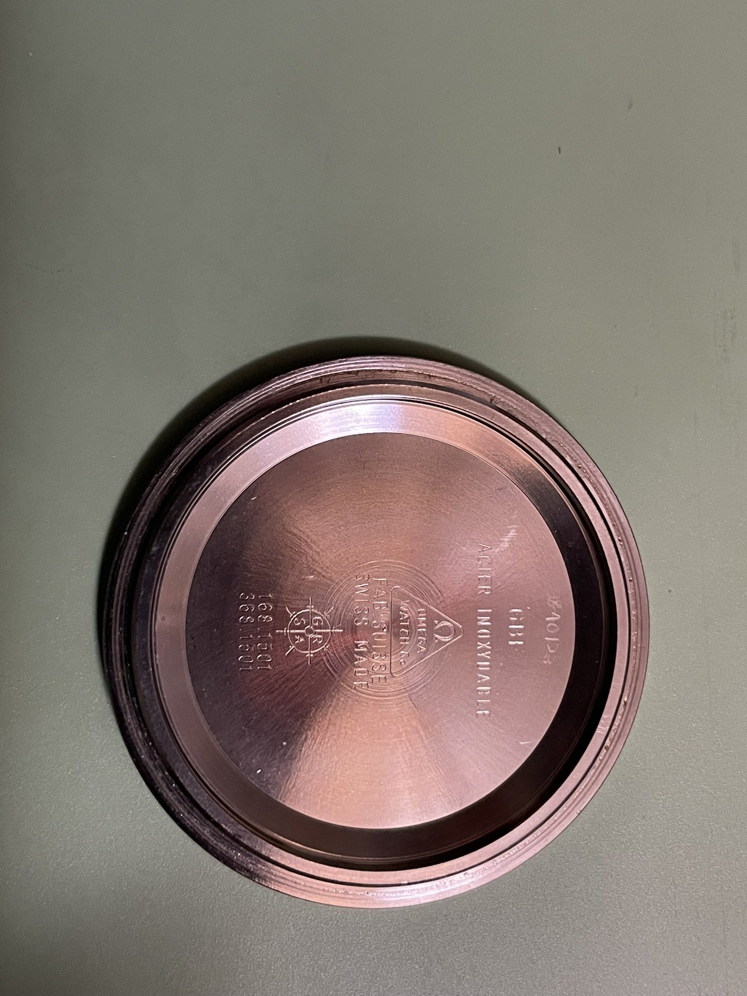

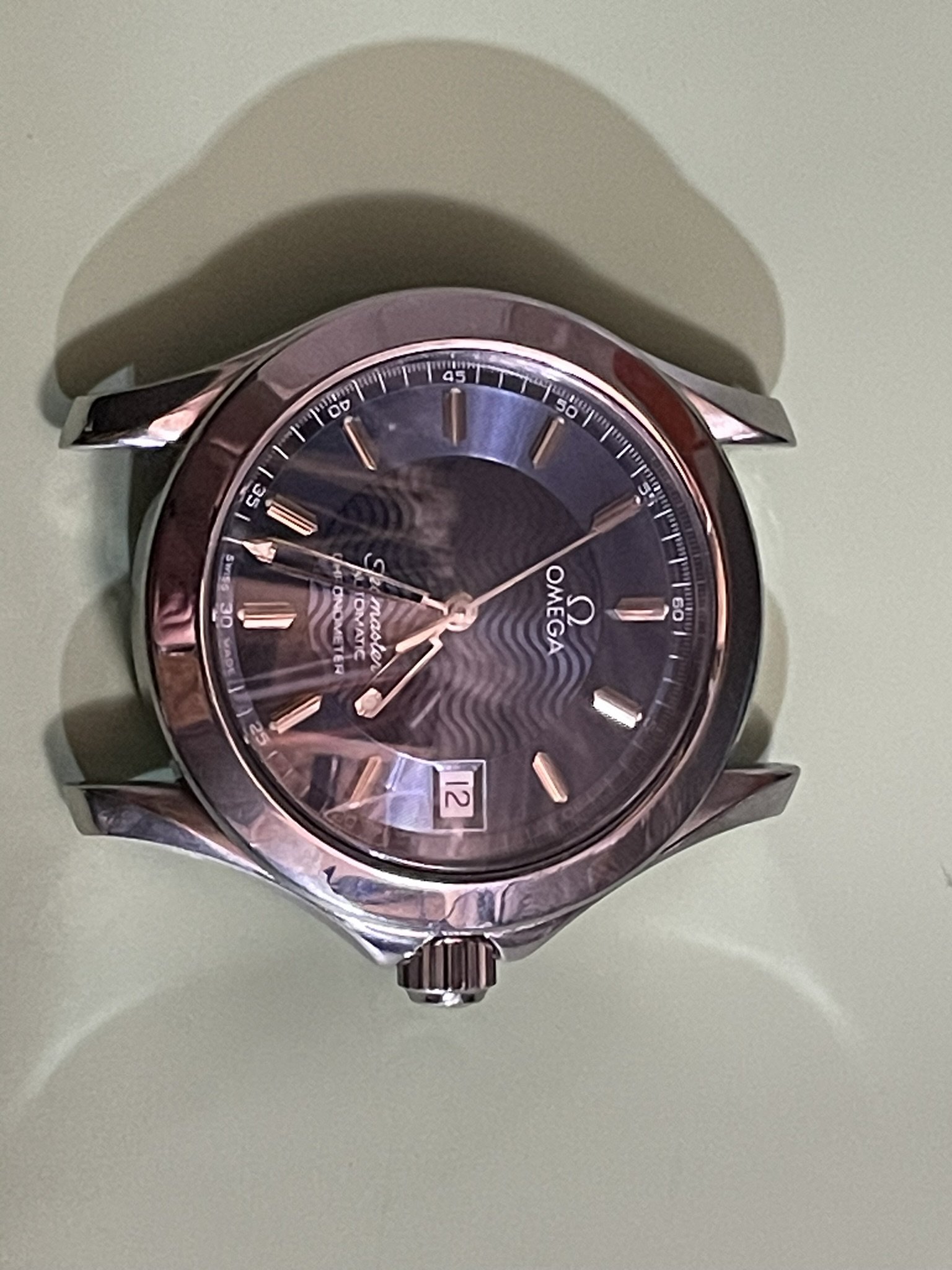

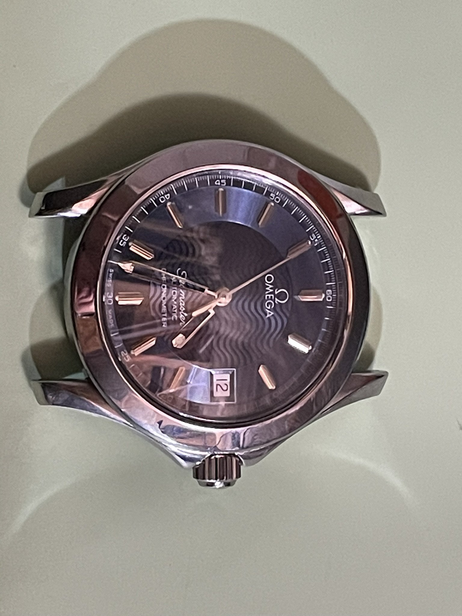

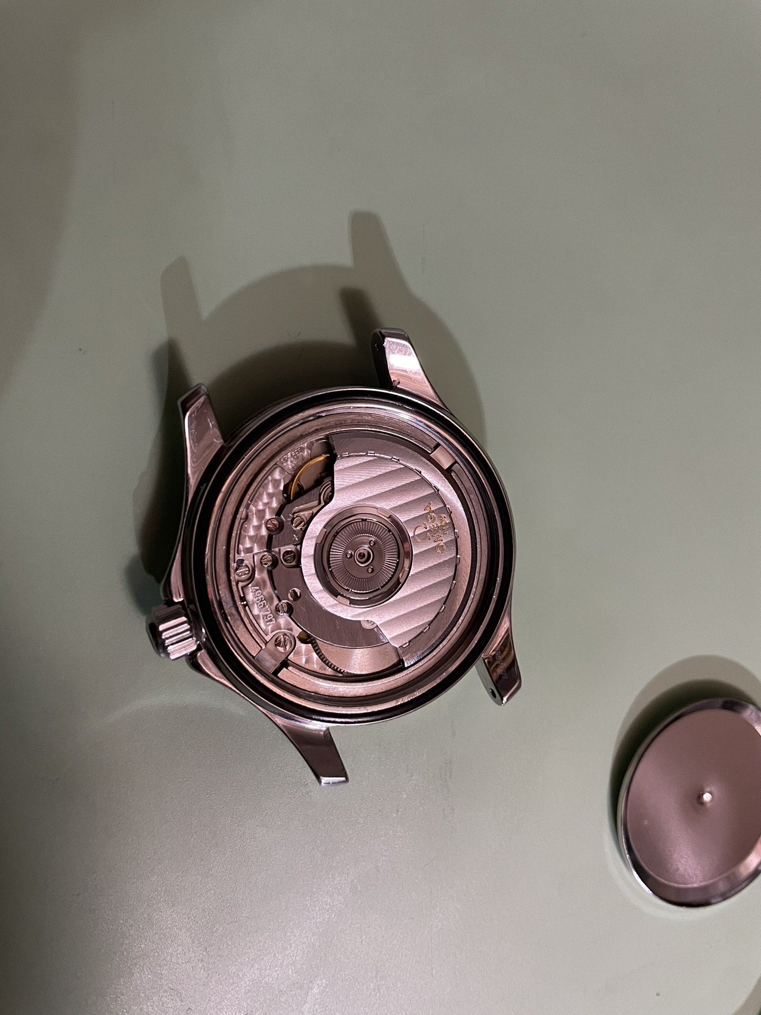

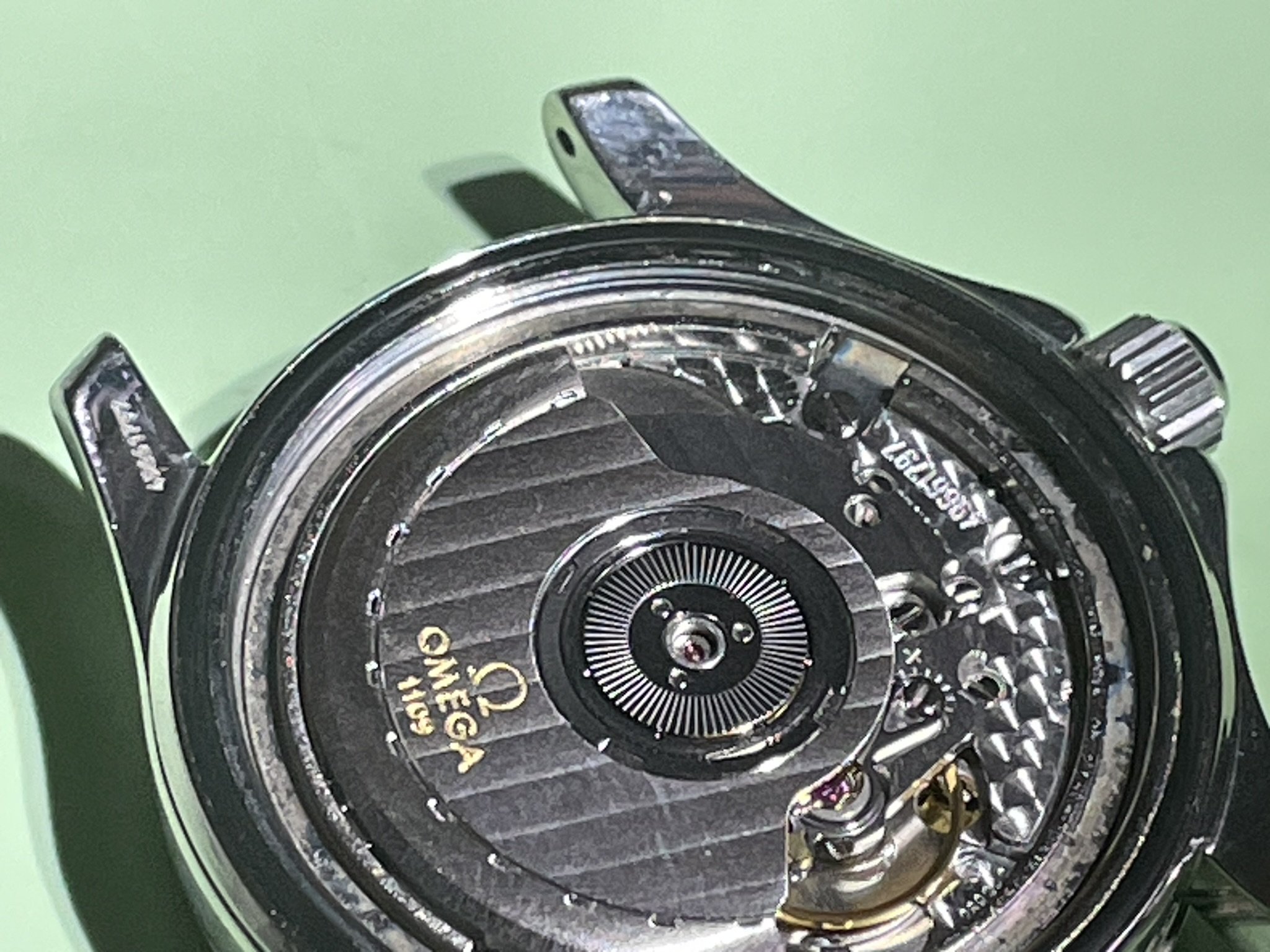

This is where it gets interesting. So when he took the caseback off to check the serial numbers, what he found was that the watch looked like an 2501.81.00, but did not have a 1120 movement. The rotor was clearly engraved 1109. My first response was, look, maybe that isn't a big deal. Maybe Omega changed the movement later on, etc. But upon looking further, the case serial and movement serial matched as expected, but the case back indicated something different. It said it was a 168.1501. I understand that the caseback number and the reference for the customer are not the same thing. But something didn't smell right to me. Sure enough, my serial number, movement, case, and caseback all are for a reference https://www.omegawatches.com/en-us/watch-omega-seamaster-120-st-168-1501, (ST 168.1501).

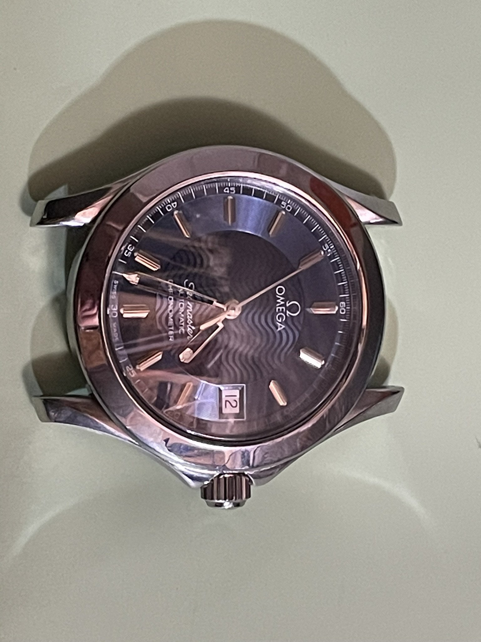

At this point, I start googling for all the dial color varieties and quickly realize that I have watch with a dial and hands swapped. That dial and that reference don't overlap at all, and I also have gotten a 1109, which is inferior in many ways to the 1120. So I don't have the watch I've ordered, and worse yet, it's got a dial from a completely different watch.

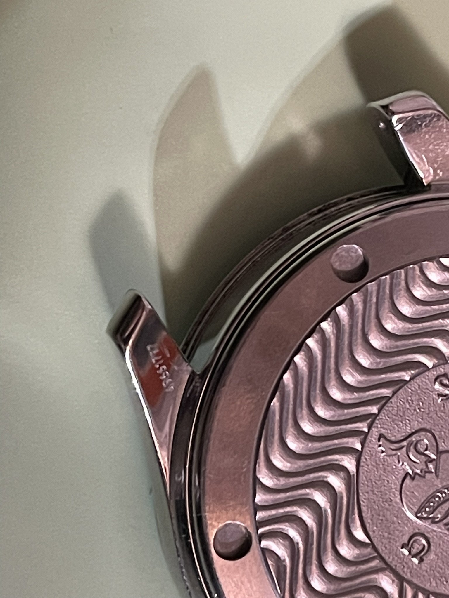

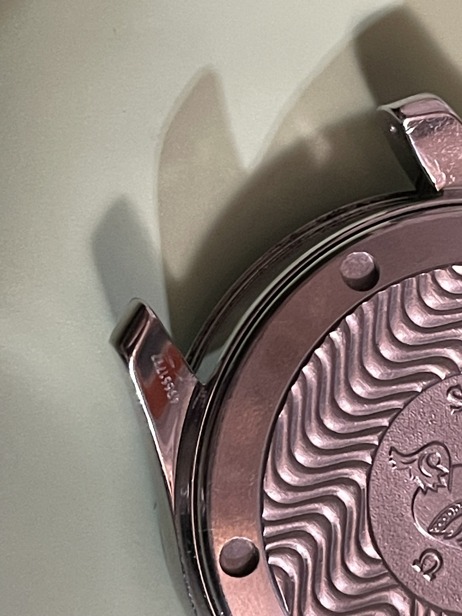

Do you have a serial number on the lug? their could be one on the wheel train bridge too. See if they match.

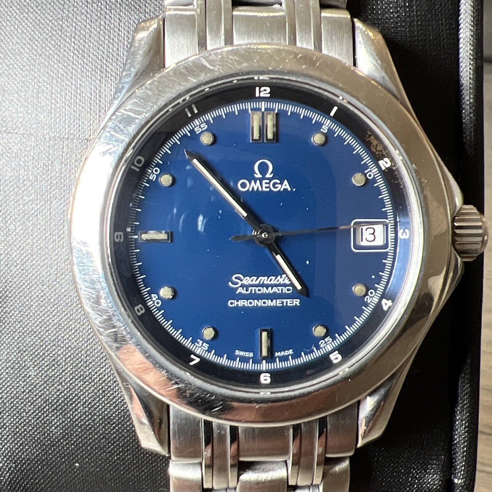

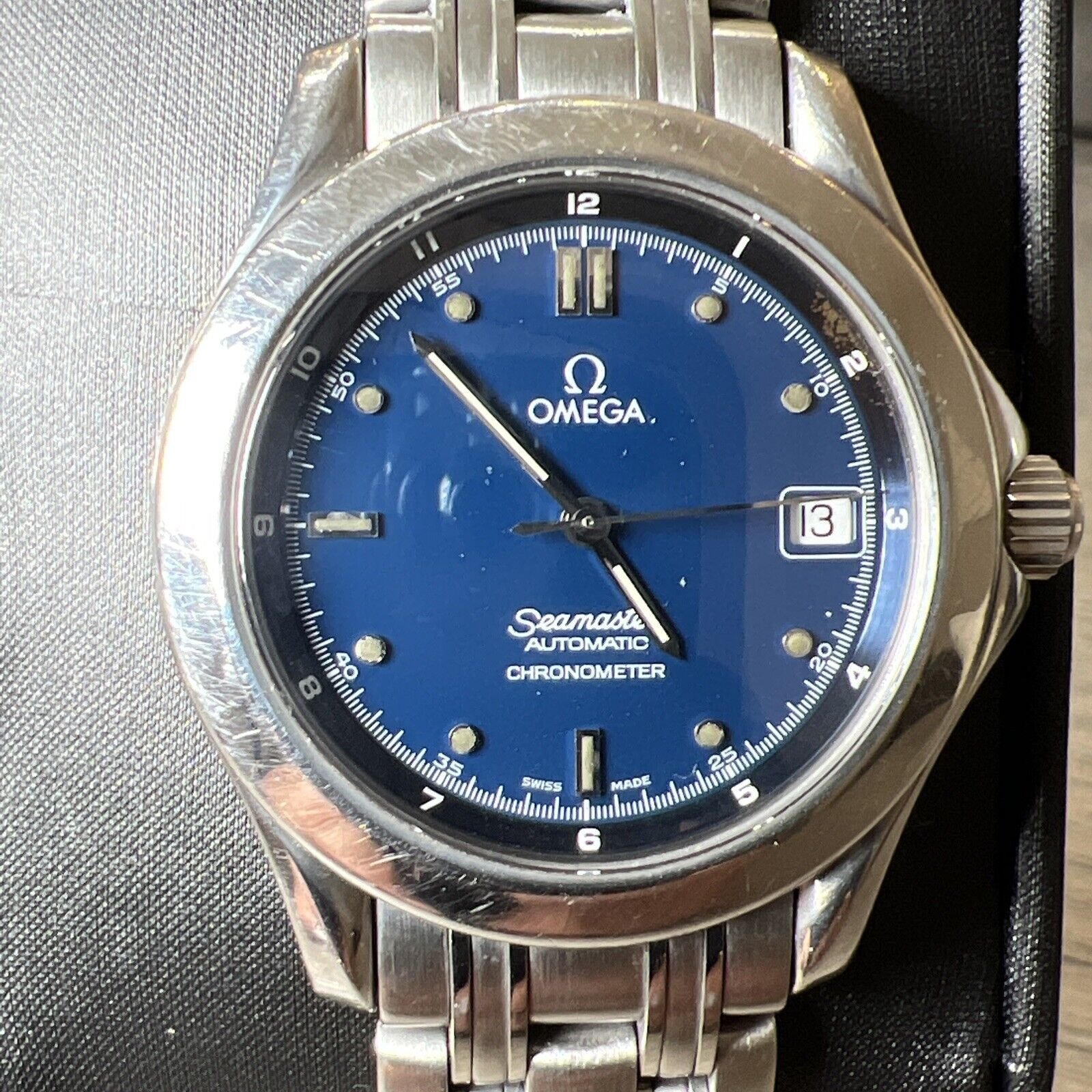

Also, if anyone cares to know, this is an image of the correct dial and hands. (Found on an ebay listing.)

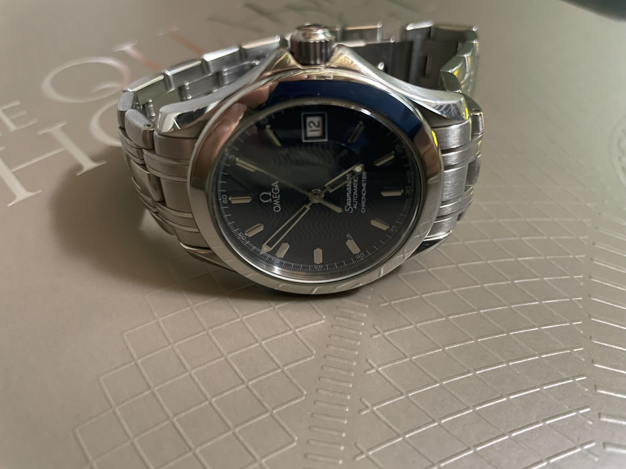

Hi ! Not withstanding the story behind, the watch as you got it is nice !! and I like the wrong dial better than the original .. but just my taste !! Good luck with the refund process ..

So the two SN match.Honnestly, if you like the watch, I would keep it if you paid a decent price for it.
It'as basically an ETA 2892 which is a workhorse + parts are not expensive.

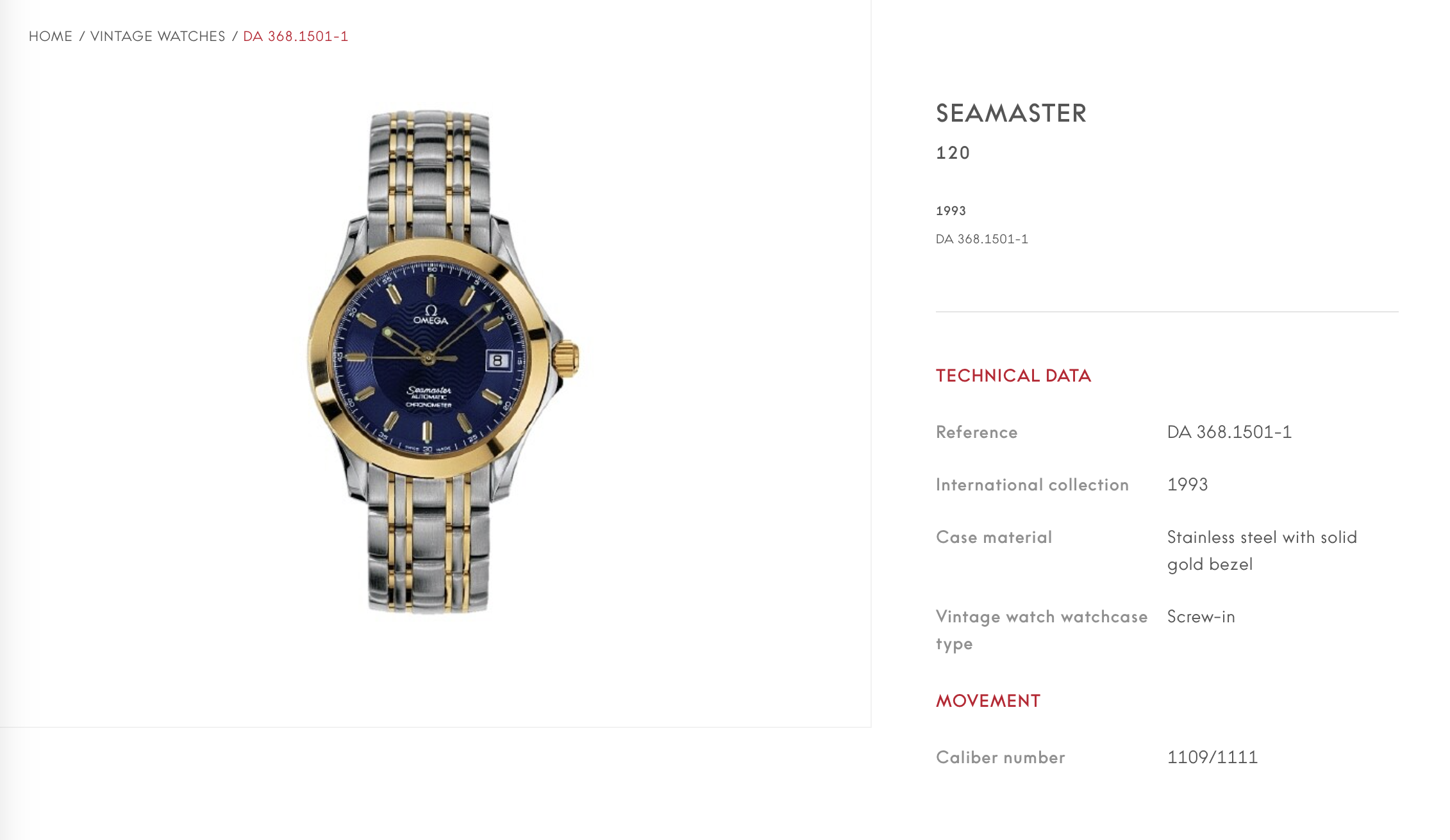

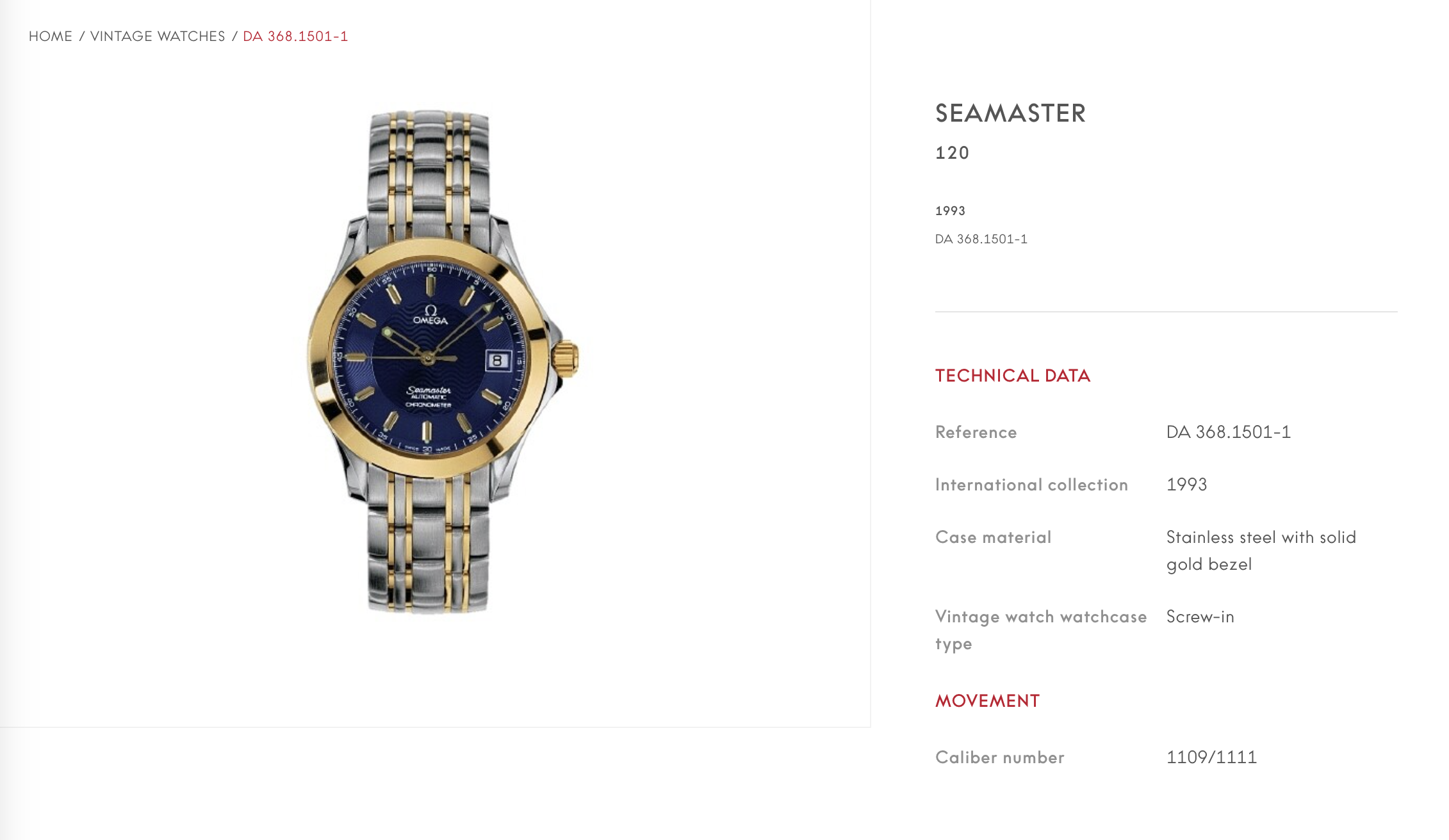

I can't say whether the OP's watch is authentic or not, but if you search for the second of the two reference numbers visible in the caseback (368.1501), you find watches that resemble the OP's. Most are cal. 1120, but there is evidence of a similar watch with cal. 1109/1111:
(https://www.omegawatches.com/en-gb/watch-omega-seamaster-120-da-368-1501-1)
Omega's vintage pages don't show exactly the watch the OP has (all-steel case, blue dial), but I don't know how comprehensive their listings are.

Strange thread - the watch you received is actually a ref. 25018100. The case number 168.1501 is correct for the early versions, and they did use a Cal. 1109. So everything matches up perfectly, and there's nothing wrong with what you received.
The dial and hand combination that you say is correct, is actually for a ref. 28018003.
This is the peril of using the Omega vintage database - it doesn't list all the possible combinations, so people are easily mislead if they don;t understand all this. You are sending the watch back for no reason.

I concur. The watch that the OP received looks completely legitimate.

Agree with Archer and Sathomasga. Even if the 2892 is not the most interesting Omega movement it works well.

I don't quite agree - the 1109 was quickly replaced with the 1120 for a reason.

To clarify further, I always did allow for the possibility that it was correct. But even if it is right, it's still not the reference marketed to me. While I would own a 1109, they are certainly less desirable, looking at eBay, they take longer to sell, and is therefore worth a somewhat less than what I paid for it. At the end of the day, the dealer is responsible for accurate listings and not the buyer.
