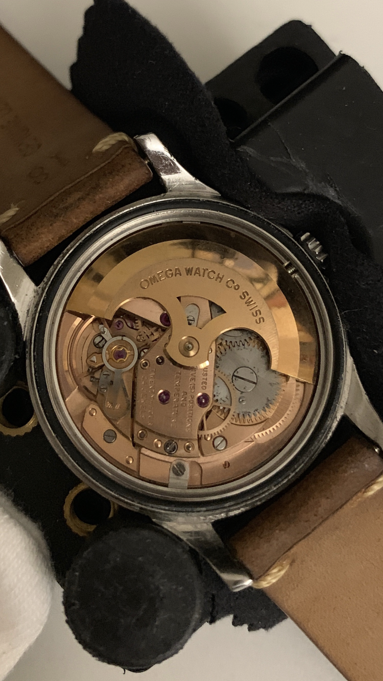

How does this constellation look?

Bump. I just wanted to confirm that there aren’t any red flags in this movement photo.

The movement looks okay to me. It looks like there might be a bit of rotor rub directly above the Omega, but that could just be the picture. You might ask for a picture of the inside of the case back. If it has just been serviced the rotor bearing should have been replaced if it was rubbing. Also remember that the 561 doesn't have a quick set feature for the date.
