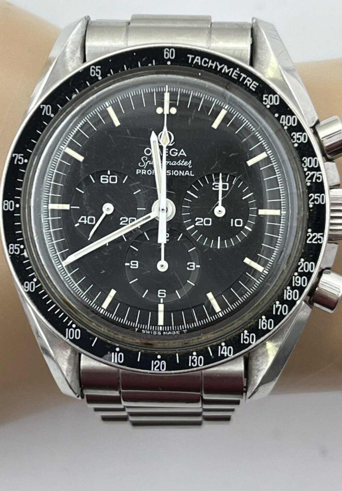

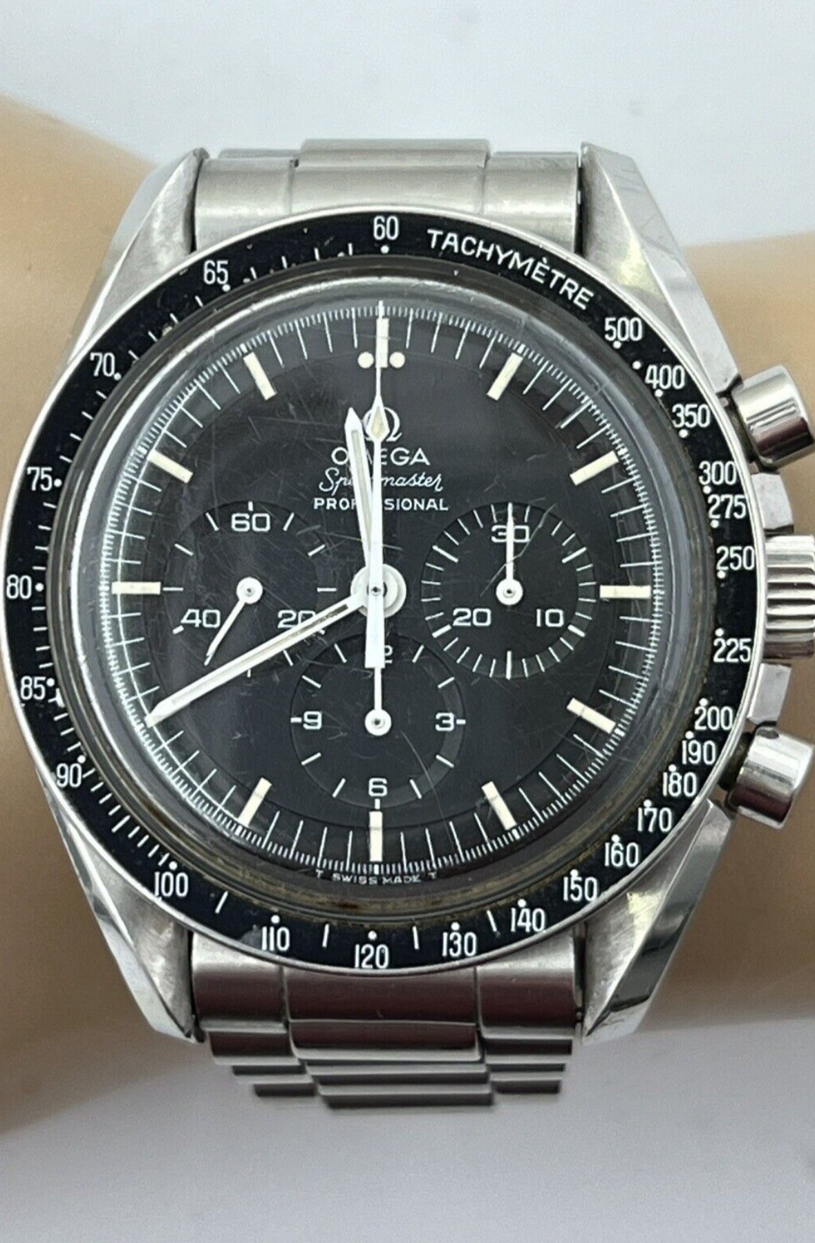

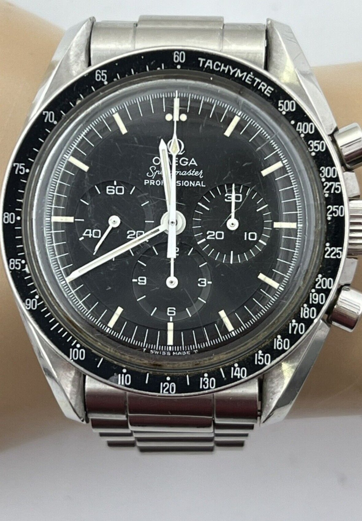

How does this 145.022-69 look to you?
23
8
I’m new, and I’m trying to learn as much as I can. OF is such a great resource! I’ve also been reading Speedmaster101 and watching some of his videos on YouTube, as well as a few reads through the “Learning to Fish” thread. I’m starting to learn what to look for, but I still have a way to go. Hoping the people here can help me continue to hone.

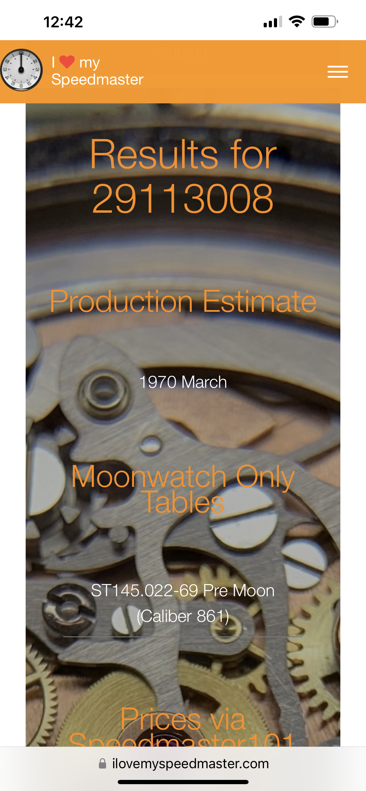

I found this 145.022-69 on eBay, and from my untrained eye looks pretty good. Case isn’t overly polished, but it does have some scratches (especially near the lugs). Dial and lume appear original, in reasonable shape, and a nice yellowed color. The hesalite obviously needs some polywatch, but I imagine that’s not a large consideration for most people?
This listing is from a guy who, although he has nearly entirely positive reviews, is just flipping jewelry he finds at estate sales. The watch will obviously need to be serviced right away.
What am I missing? My personal goal is to hunt for something (specifically this model) that I can wear in a rotation of daily drivers, so not a museum-quality piece by any means, but still presentable and something to be proud to wear at the office or out with family.

Well, let's cut the OP some slack. He's made a bit of an effort to assess the piece himself, seems to have done his homework and is pleasant enough to write a nice post including the pictures of the watch concerned...

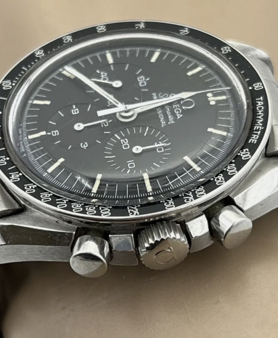

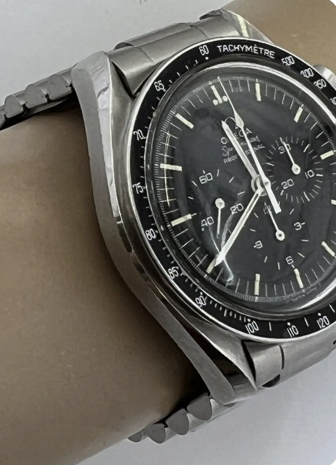

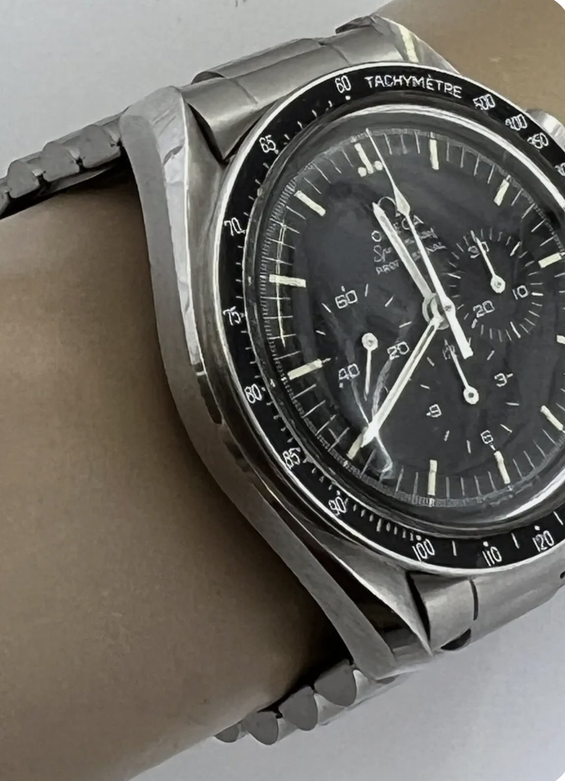

So, here goes. Hard to judge the exact attractiveness of the dial as the picture quality is quite poor, at best. As you might have read by now, certain 145.022-69's turn brown, this one is within the serial range that more commonly does so. Whether this one is turning brown and if so, whether it is attractive, remains to be seen. Can't say based on the pictures. The hands, especially the hour hand, appear very white and might be replacements.
Other than this, the bezel and case appear nice. A lot will come down to price. Is this an auction, or a buy it now?
Good luck making up your mind! 😉

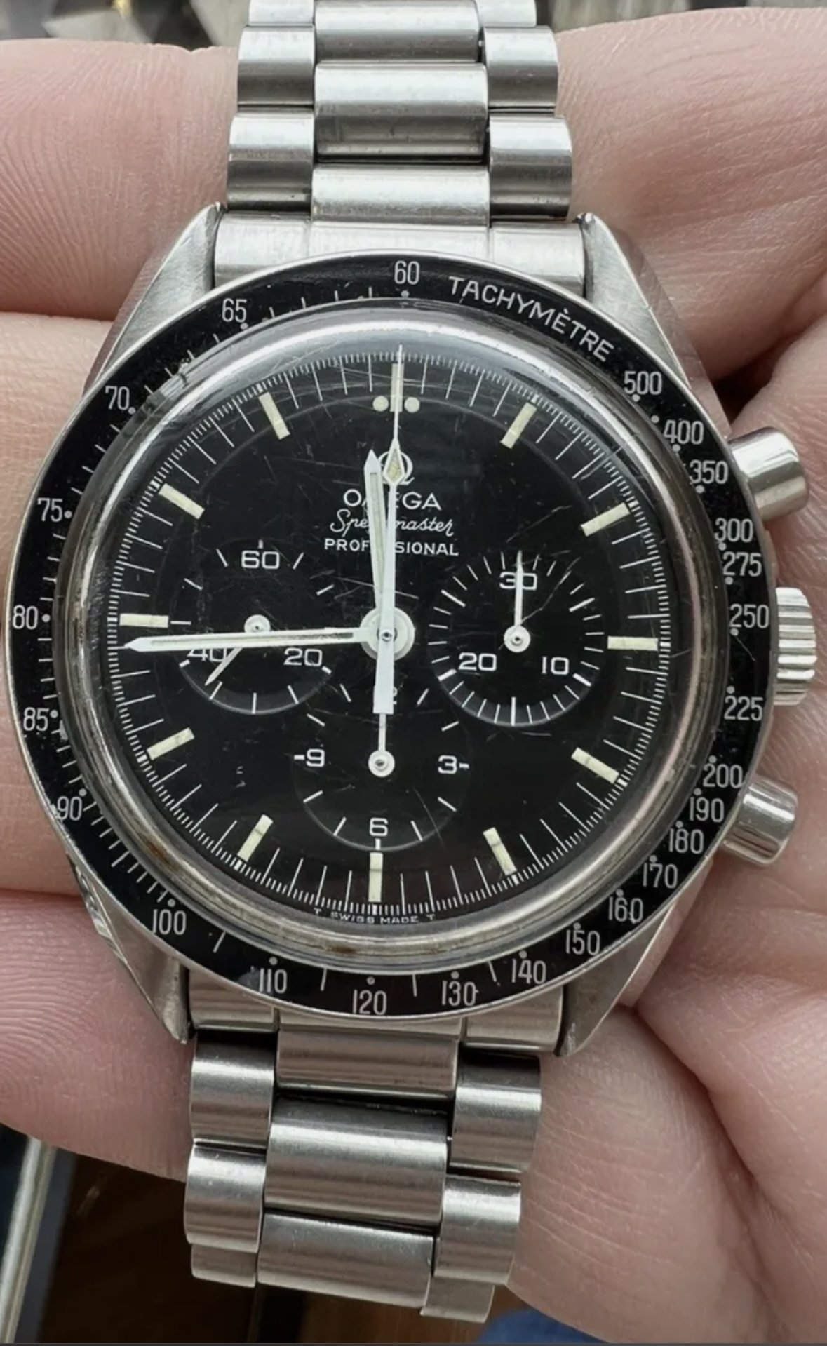

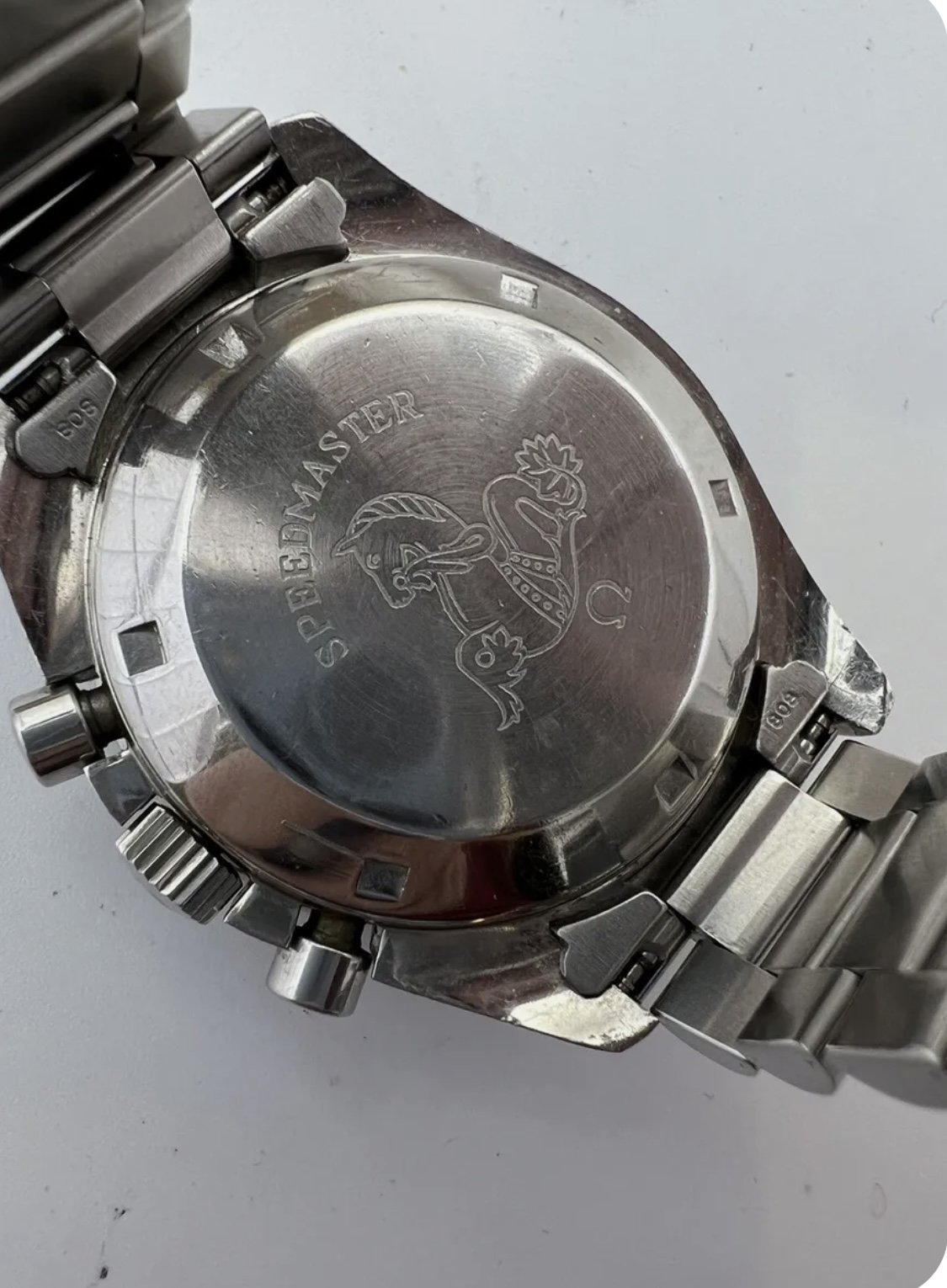

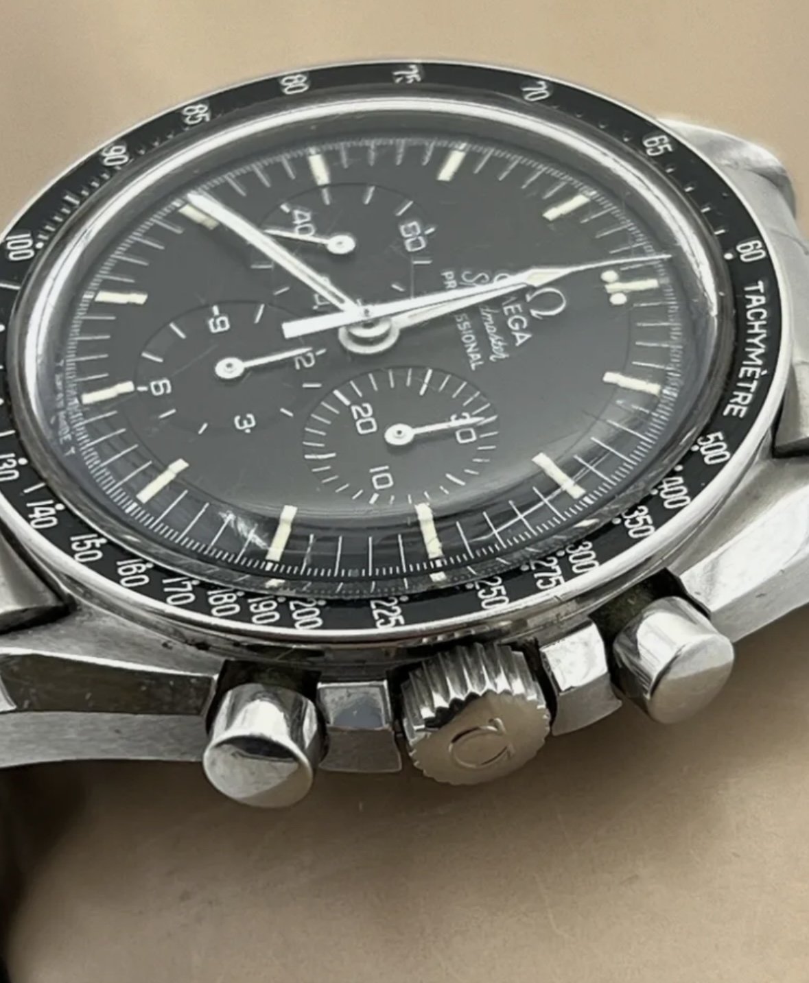

Try and get more close ups on the dial, from many angles?
So you can look at the condition, and possible marks, scratches etc…

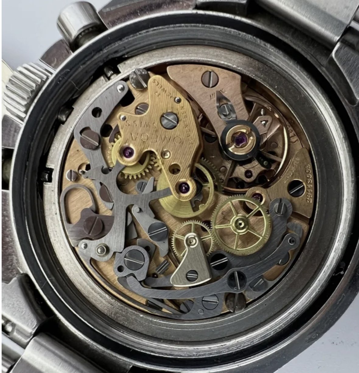

Do you have a picture of inside of the caseback?
And the serial nr, a bit hard to read…
It could be a nice watch, depending of the prize…😀

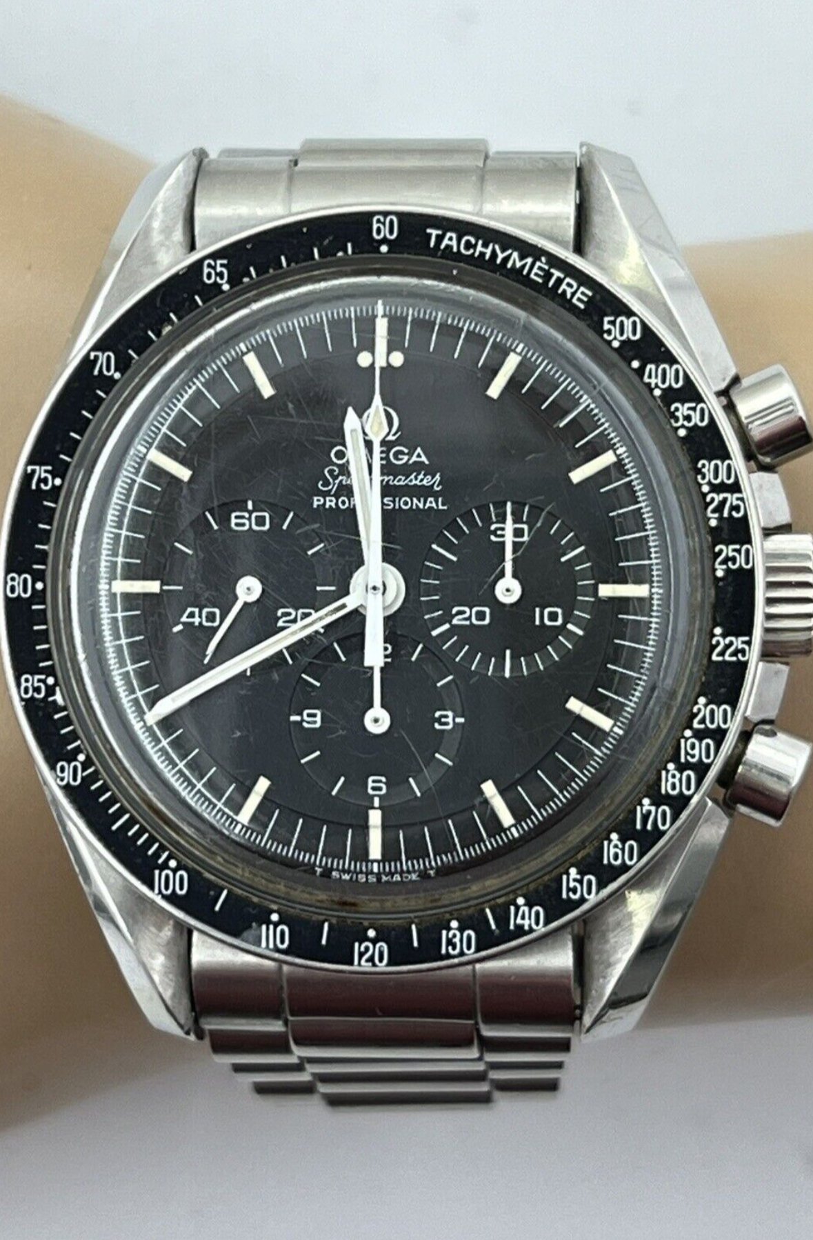

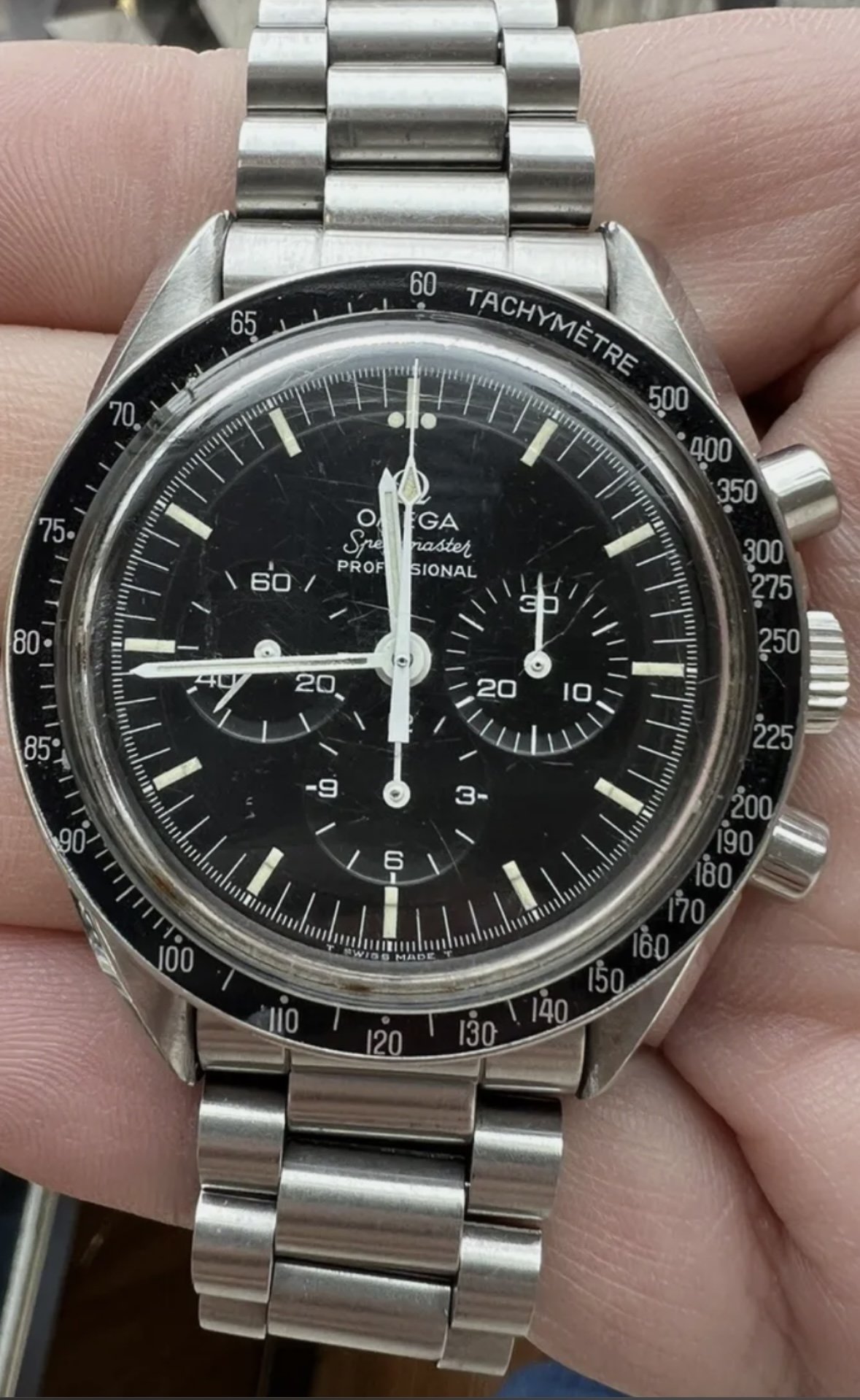

Thank you! This is the kind of feedback I was hoping for. Some of the feedback on a watch I shared last week was that the lume color was bad, and this one appears to be a bit better.
I also had a hunch about the hands possibly being replacements, so I’m not surprised to hear you say the same.
Here are a few more photos of the dial and link to the listing, which is a buy-it-now type.
Are these watches suitable for wearing a couple times a week? Not just sitting in display cases? I’m not looking for a perfect watch since I want to wear it and will undoubtedly add a few nicks and scratches myself. I don’t want a clunker either, though. 😀

It doesn’t appear to be a stunner but it’s not a dog.
A lot will come down to price. A beautiful watch can be a pass if the price is too high, an average watch can be a buy if it’s a good price and allows you to own it, feel it, get to know what a vintage Speedmaster is like, then trade up in the future if you like.
A couple of points on this one;
What is the price. It’s a big part of the info in deciding whether to buy. Don’t be shy about posting it.
The bracelet is wrong but has its own value.
Speedmasters from the 60’s can absolutely be daily wears.

Ok since you asked

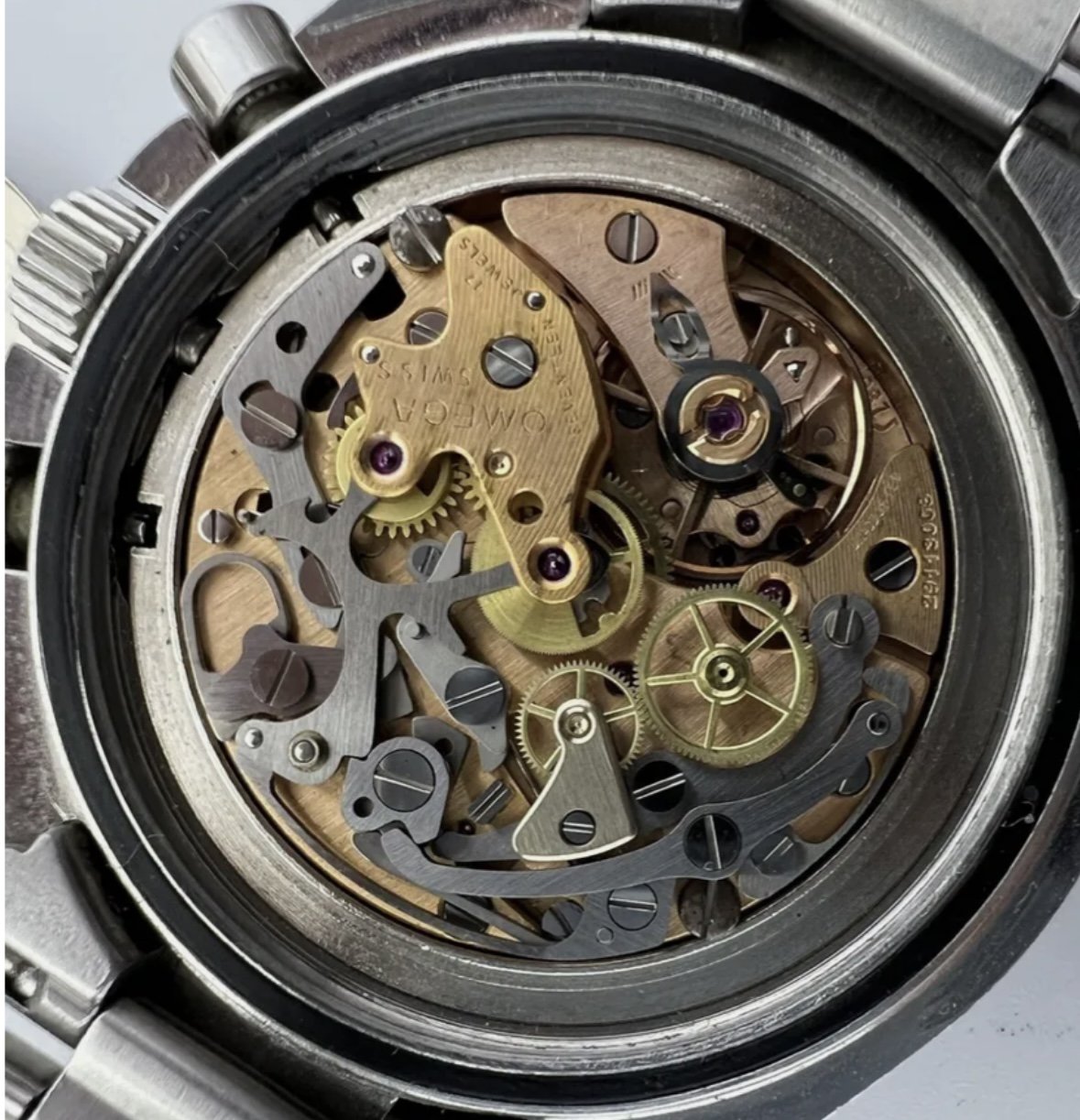

2911 movement, usually has a nice dial, but this one is not typical - the markers are white, and I cant see the body colour properly. Has a step and no obvious damage. I dont think there is any brown at all. (Shame). So not a markedly valuable dial but correct.
Movement has mismatched coloured bridges, but it may be the photography - but it would put me off. I dont trust that sort of thing.
The bezel while correct, and DO90, is not attractive as the font is blurry and there is damage. I prefer sharper font. I dont like the bezel
You dont say how much it is. Every Speedmaster has a price. For a price I would buy it
If someone paid $6500, Its not crazy but I would not do it. If its $7,500 its a lot more than you would recover on Ebay if you tried to re sell it.
EDIT:
My guess is if from a dealer asking $6500/$7,500
My no brainier price for me to buy is $4,000

Well OP, no one can spend your money for you, but I don’t think it’s a bad buy at that price. You’ll get a few hundred back by selling the bracelet which is a nice 80’s version and has no place on a -69
