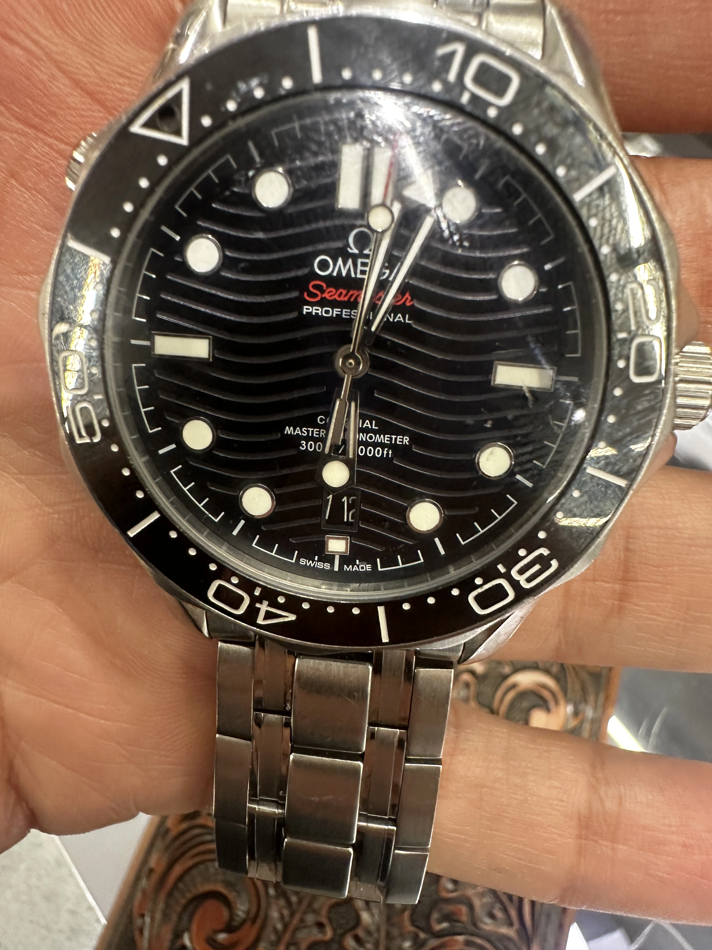

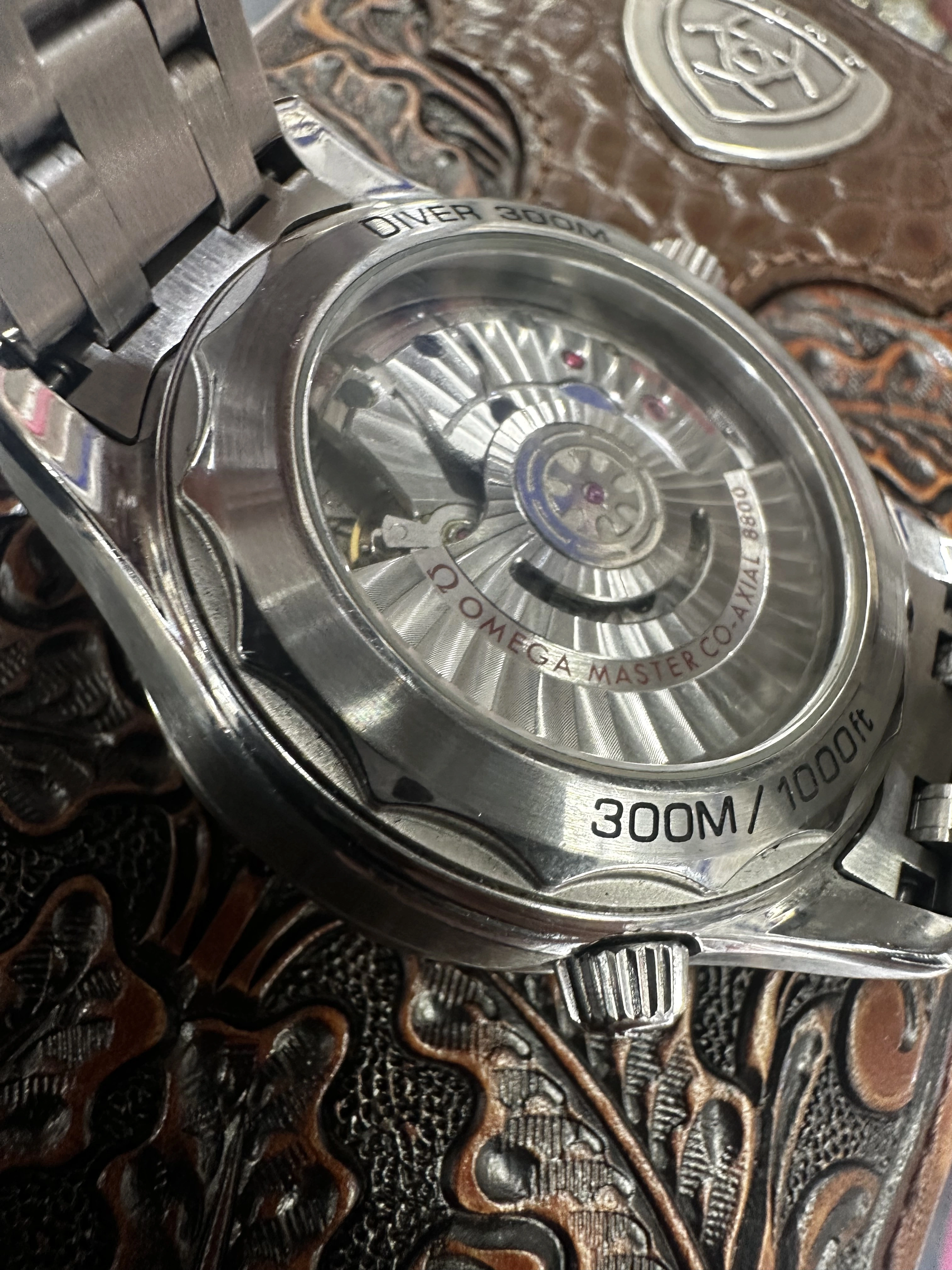

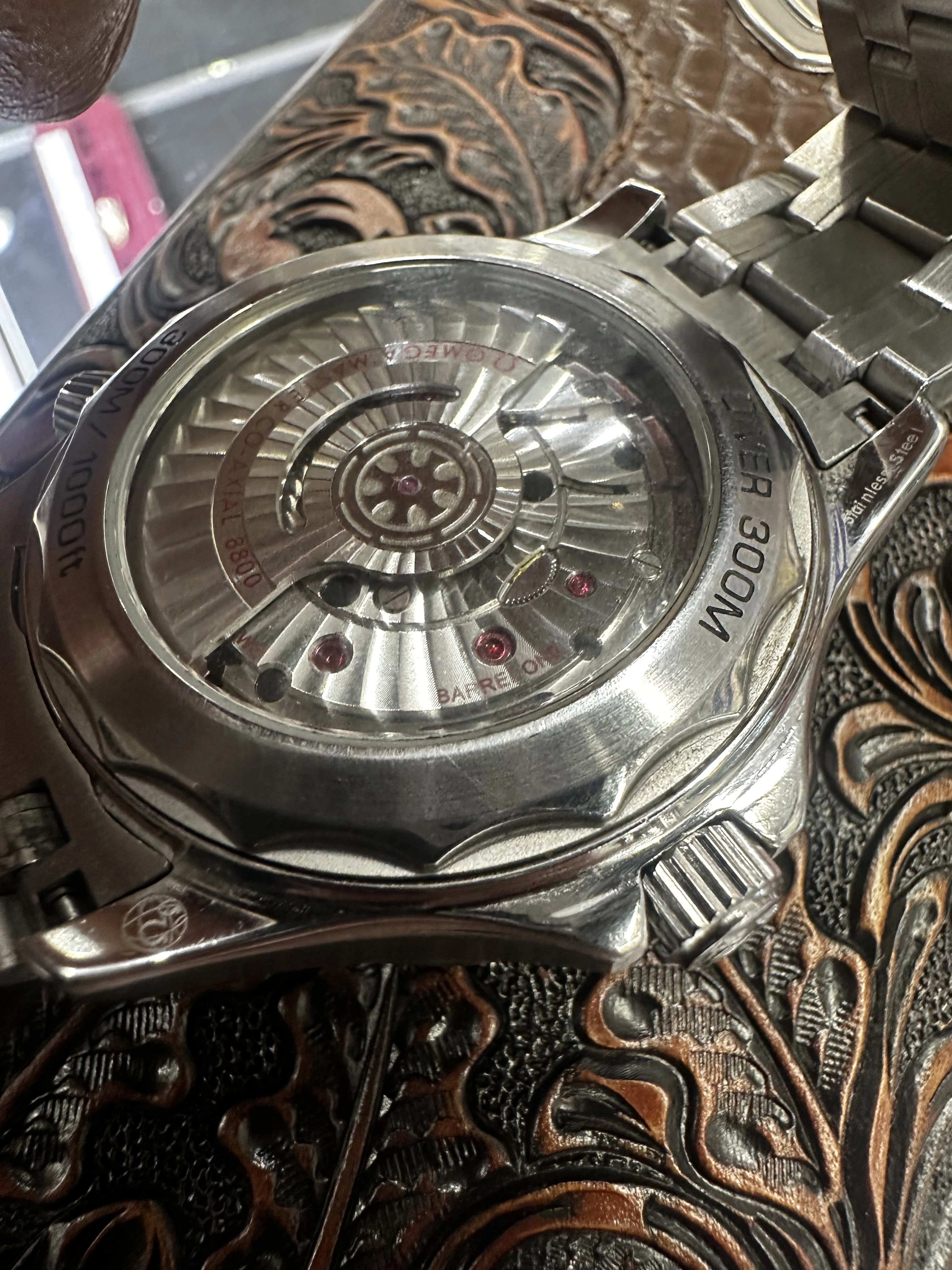

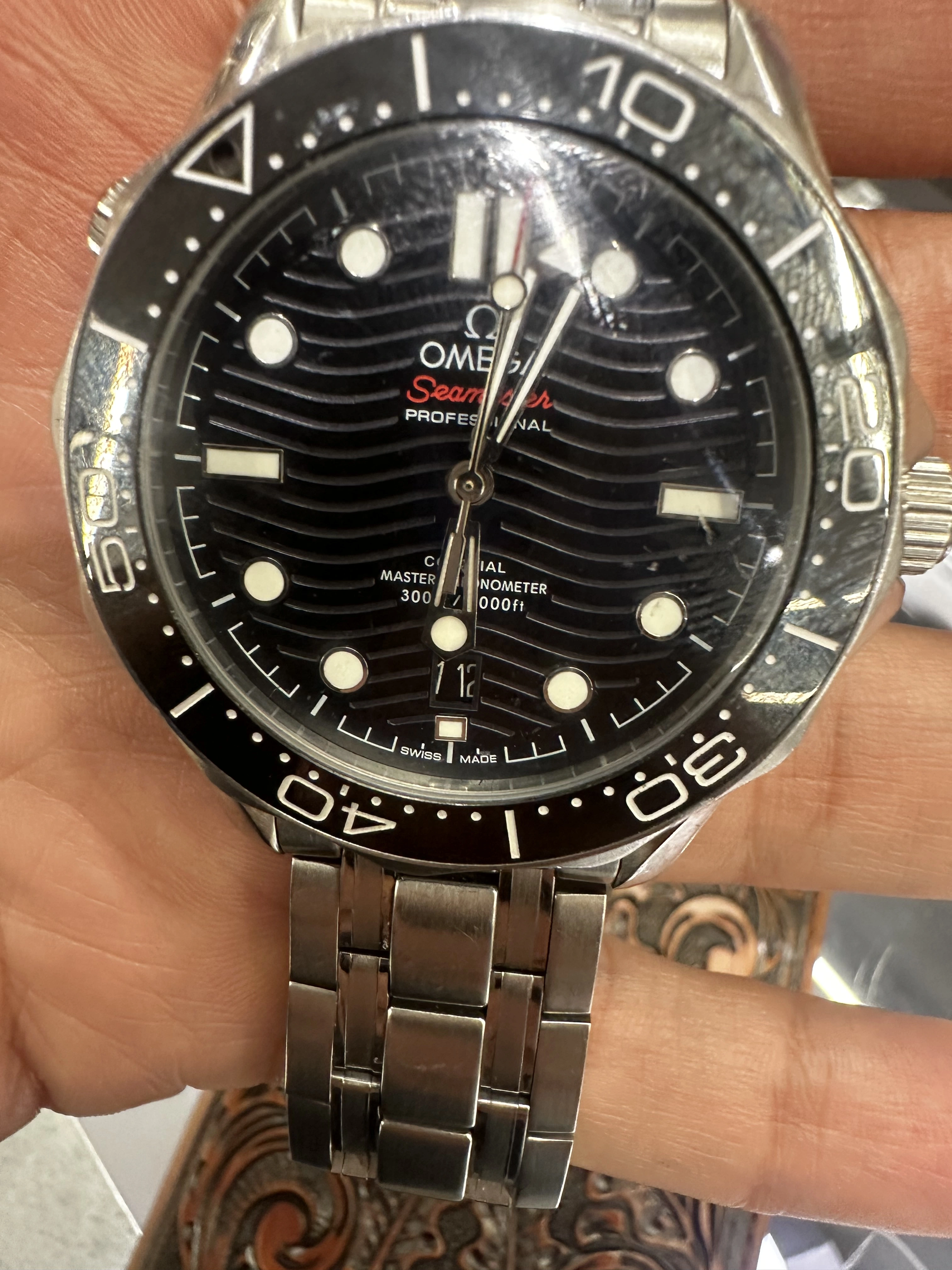

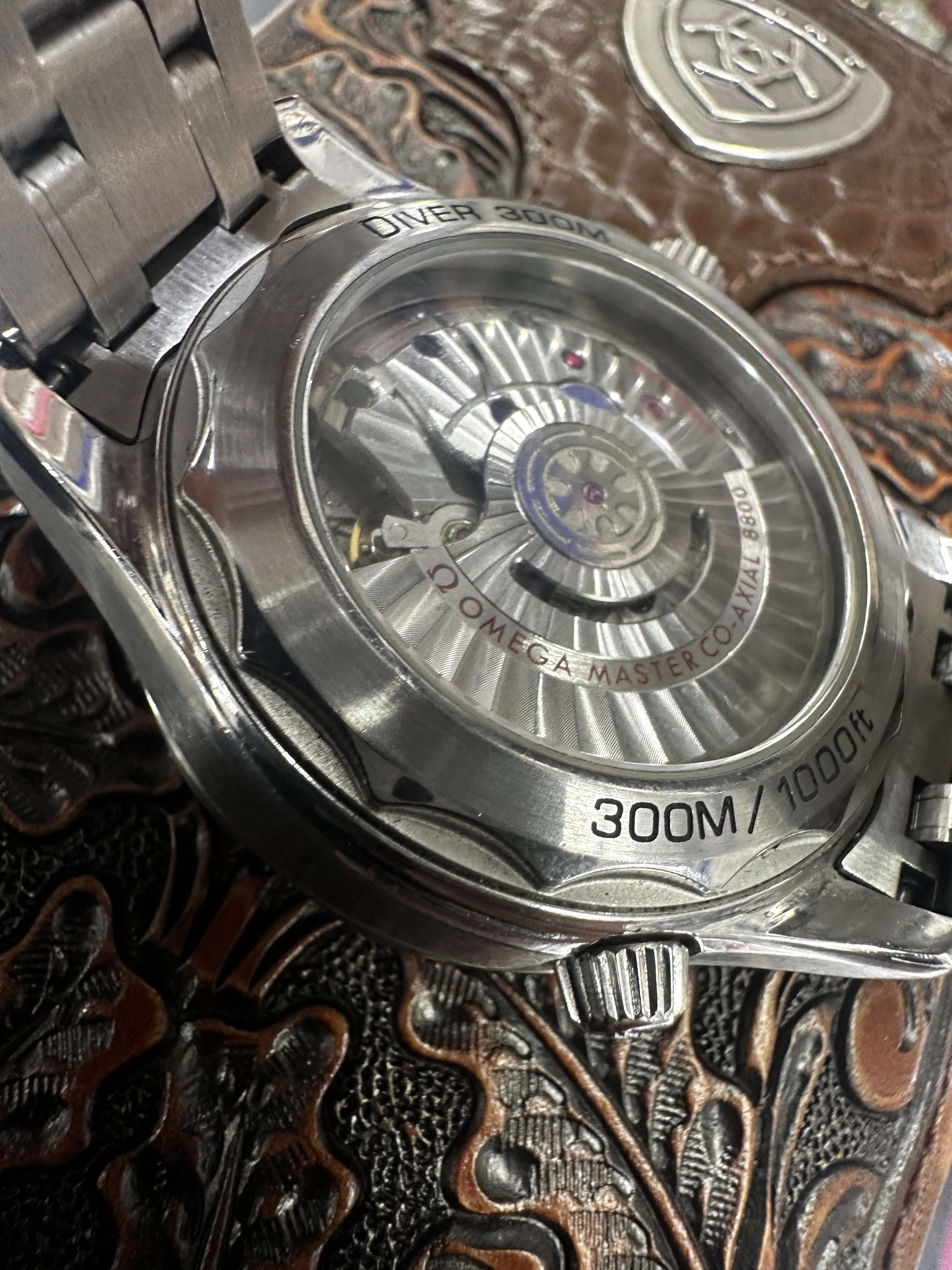

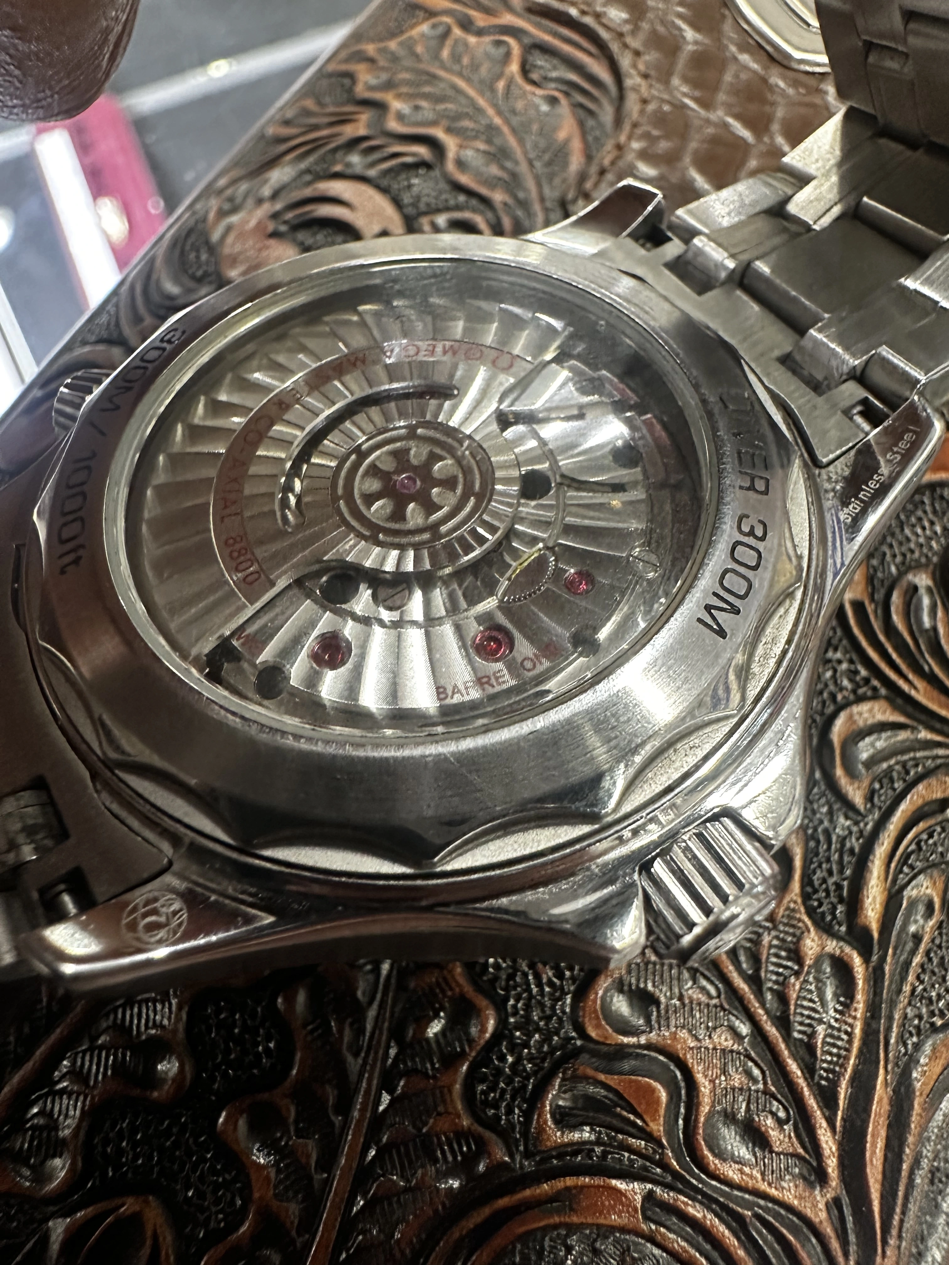

S Posts 122 Likes 31 spread5150 ·Sep 29, 2025 Normally I’m quick to jump on these deals. Even a beat up one but this one seemed off. No serial number on the case (corner). No divers extension. Am I wrong ?
Posts 2,184 Likes 2,397 ErichKeane ·Sep 29, 2025 Movement is very clearly fake. Look at the balance spring attachment😀
S Posts 122 Likes 31 spread5150 ·Sep 29, 2025 My eye is not the most trained but it just seemed wrong. Glad I walked away.
Posts 148 Likes 119 darkguyver ·Oct 2, 2025 ErichKeane Movement is very clearly fake. Look at the balance spring attachment😀 Yeah, the details on the plates are way too sharp. The details on the wheel should be much softer
Posts 29,820 Likes 77,175 Archer ·Oct 2, 2025·Omega Qualified Watchmaker 1 - balance is wrong 2 - too many barrels 3 - no pivots in the jewels This is an assembly slapped on top of a cheap movement.
