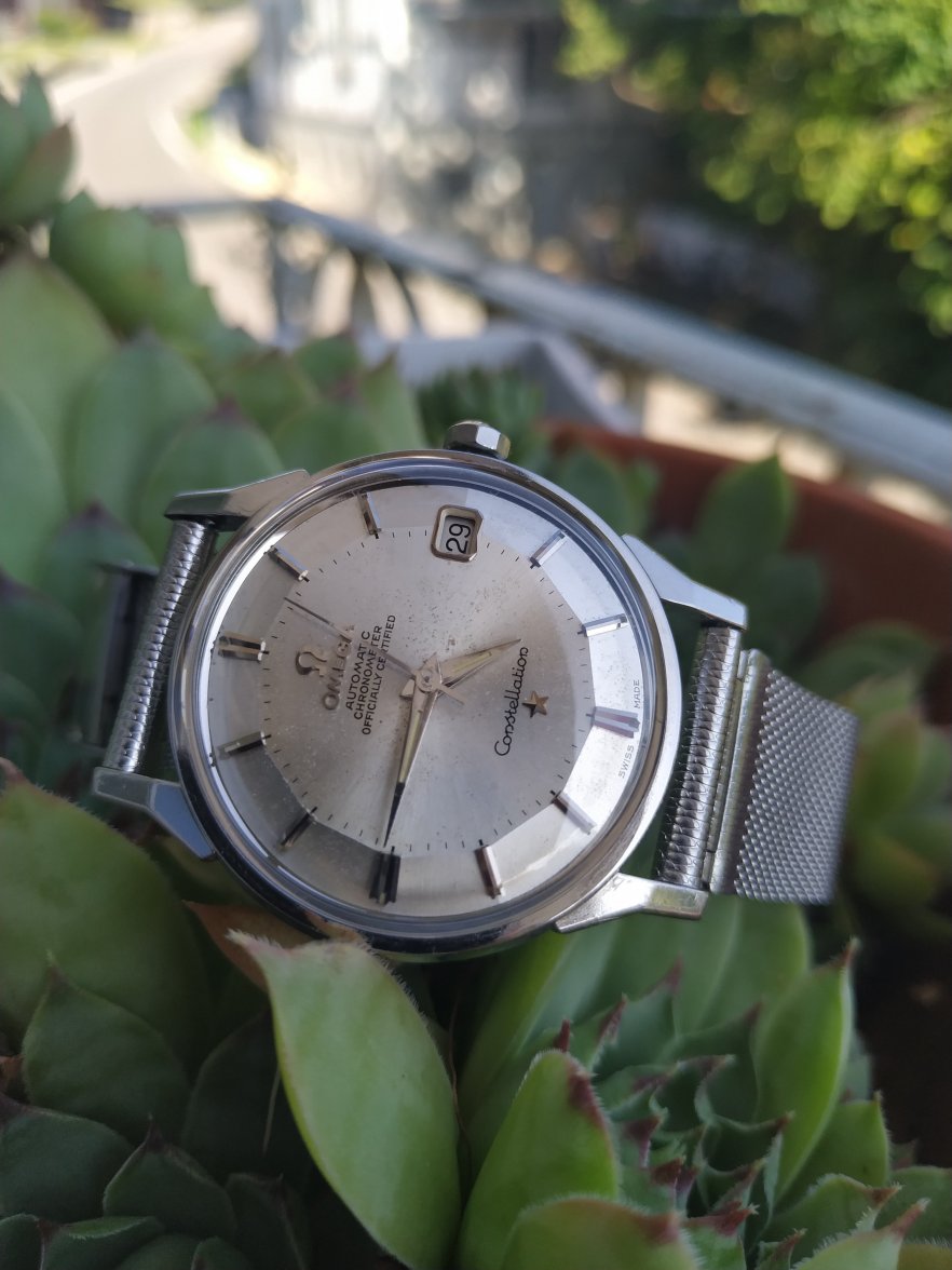

Hoping to get a bit of feedback on this Omega Constellation
45
19
I have this watch and am not an expert on these. Not the original owner. I'd like to know what is correct or incorrect about it and any other comments. Thank you in advance!

Watch seems to be in complete original, unmolested condition

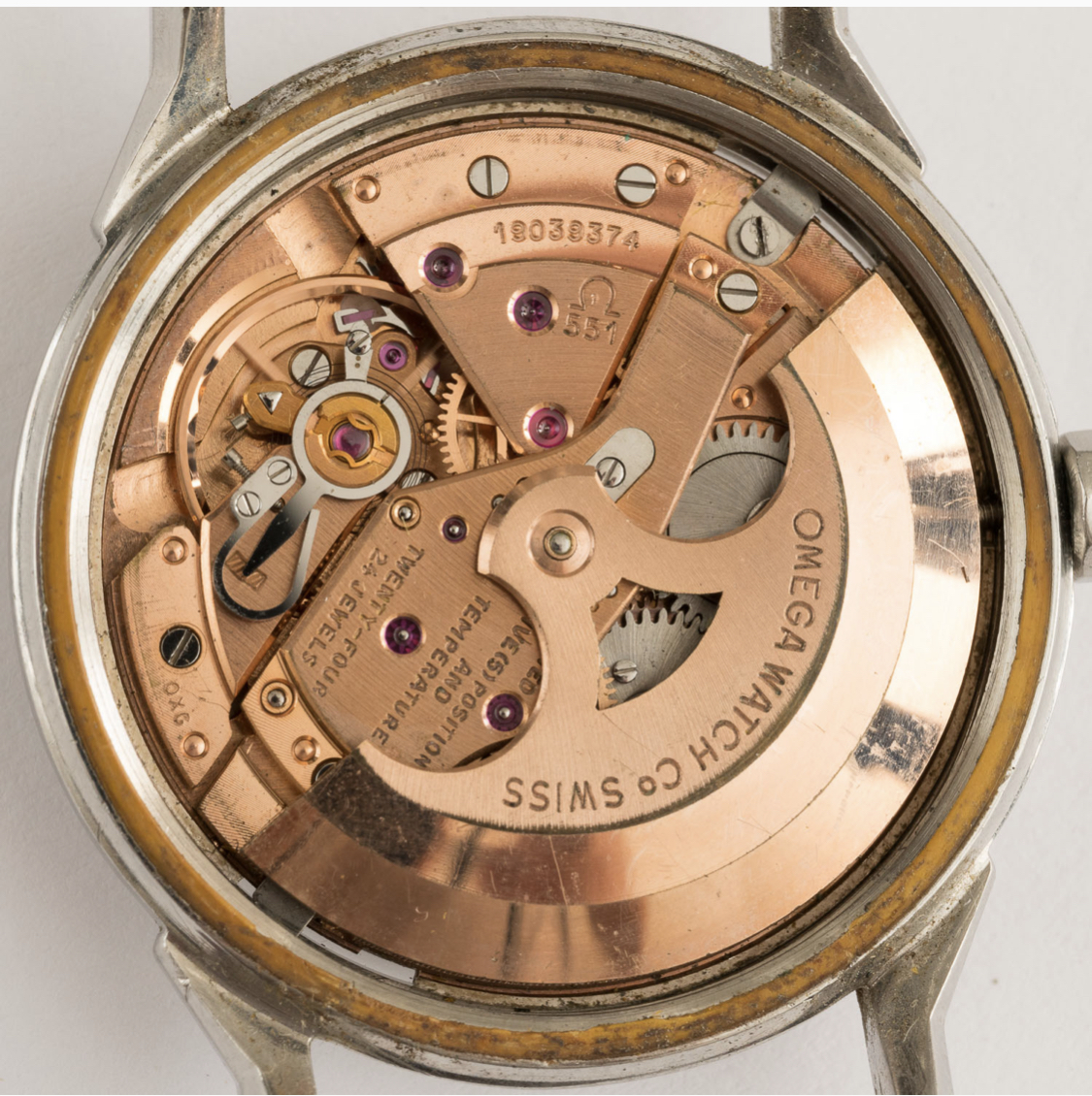

Definately needs a service (serious rotor rubbing), hope the dial can be carefully cleaned.
Sad that the outer caseback has been damaged by inappropiate opening attempts 🙁
US market watch
EDIT: Sorry, the hands are not original to the watch, a bit too short I think and former were lumed

Ref 14902 should have a caliber 561 movement (date).
1,501
5,694
Weird with the Movement, my Ref.14902 has a Cal.561. Here you can spot the difference between a dial with lume and the one without on yours.

Looks like the case back got switched on the OP’s Connie.
I think the hands are okay except they’re missing their inlays.

Original yellow gasket could explain the rotor wear.
No, not that much wear...needs a new rotor pinion.

Hands are correct, but are missing lume. No lume on dial. Incorrect caseback.
This is a frankenwatch of some sort.
Watch has had water intrusion at some point.
Dial is quite desirable, has a cross hair and onyx in markers.
Price needs to be low, as there is work to do to make this a collector's watch.

The black on the gasket is mold. I’m not saying it was underwater, but this watch looks like it was worn for a long time in a humid environment where condensation could have occurred.
Most watchmakers would replace this gasket during a normal service.

The damaged gasket shows that water resistance was compromised. This pattern on the dial looks consistent with condensation.
Condensation = water intrusion.
Remember that we are not sure whether the movement goes with the case or not. There could also be replacement plates in the movement that would have replaced damaged parts.
With a 55+ year old watch, anything is possible.
There is no way to know for sure.
Luckily, I did not quantify the wear that I see.
You didn’t need to...the wear is severe, with the worn section reaching nearly across the entire arc of the rotor. Far more that would be seen due to a flattened seal.
Well it still seems to rotate just fine and without wobble.
