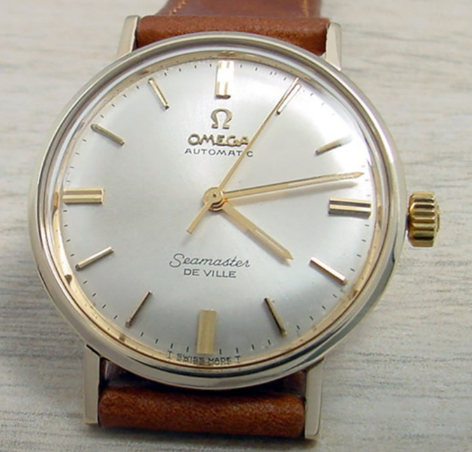

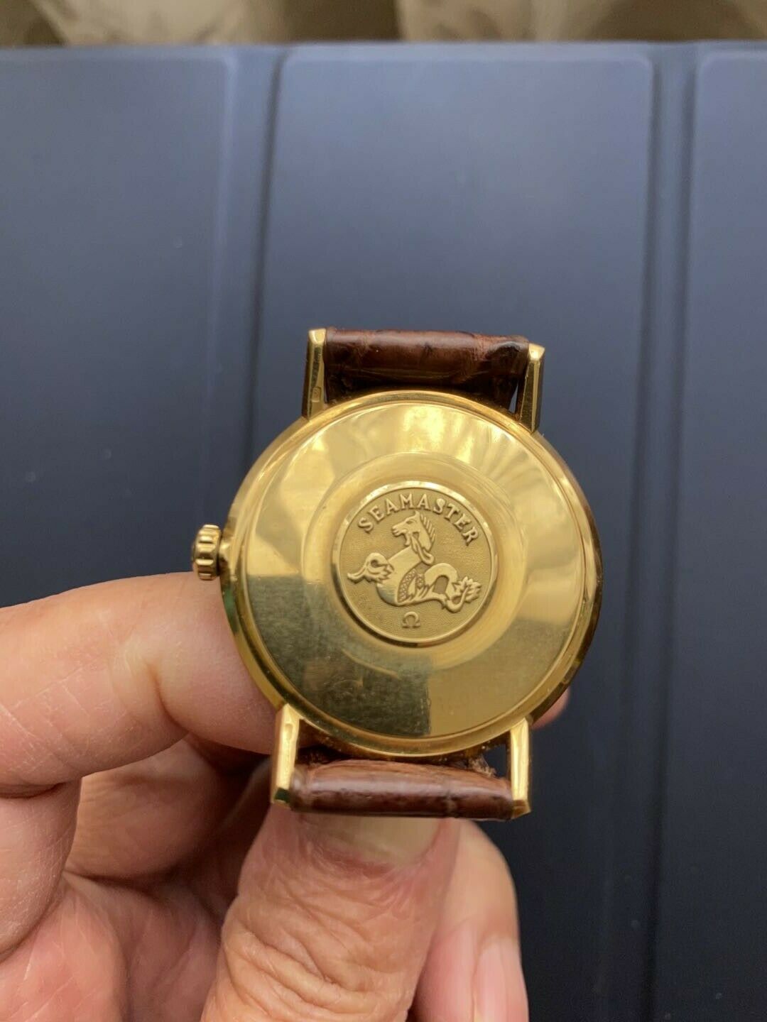

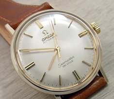

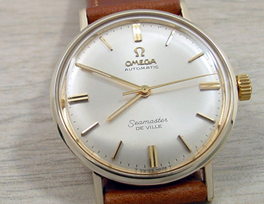

Can members offer me any opinions on this? It says 14k gold and the serial number is 23462778. The price is $1,400. I don't necessarily care about the price, but I don't want to get saddled with a bad dial, Frankenstein, or other abnormalities that I don't know about. TIA, Ken

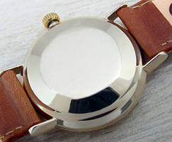

Now I feel really dumb...it only says 14k on the written description in the advertisement. Where should the 14k engraving be on the watch? Should I enlarge any other pictures for you to see?

Gold content would be marked between the lower lugs.

I can't see it on any of the pictures. Is it possible that the 14k is concealed by the watchband? The descriptions says: "Beautiful solid gold Omega Seamaster De Ville Automatic men's watch. Stunning 34 mm 14k gold case #LL 6590-1. Nicely aged original silver dial has original applied gold baton hour markers and original gold baton hands."

The color of the crown vs the case plus the interior pictures of the case suggest it's stainless not gold. Maybe the seller made a mistake between other watches he is selling?

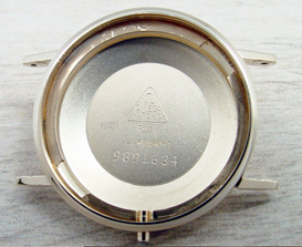

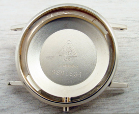

This shot usually tells you something, I just can't read it clearly.

Wow! I really appreciate your expertise and feedback! I can't believe how complicated these things are. I've purchased quite a few used cars, but I think buying a pre-owned Omega is much more difficult.
I appreciate you taking your time to comment. Can you tell me what I should be seeing in the picture? I am a novice and don't know what to look for. I'm learning as I go along. BTW, can you tell me the significance of one "T" to the right of Swiss Made on some of these Omega watches?

Reference LL6590 is a 14K gold case.
It is a US reference and will not have hallmarks.

I guess it also won't look gold compared to the crown and reflector ring? That watch looks like stainless to me not white or yellow gold.
