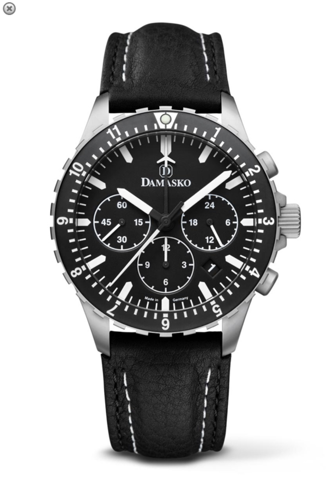

Damasko is not alone trying to emulate the chrono central minute display. Both Sinn and Tutima do it as well for some of their models. But the existence of such ersatz is not what is being discussed in this thread. The question is wether the real deal may one day do a final victory lap, hopefully in an Omega.

I think it鈥檚 very unlikely that Omega would make a 5100 based movement. There is simply no incentive for them to do this. The 5100 can be described as industrial if we are being very kind, and Omega is not currently trending in that sort of direction with their movements. They are heading in the complete opposite direction, so putting out a movement that is full of plastic, even if you add a co-axial escapement and tart it up a bit, just doesn鈥檛 fit with what they are doing currently.
