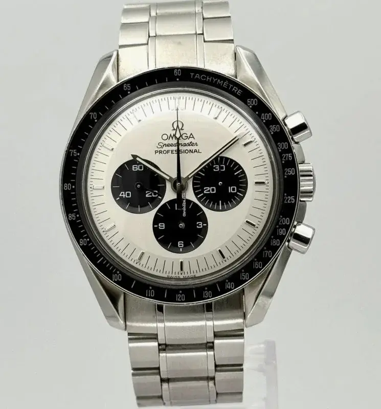

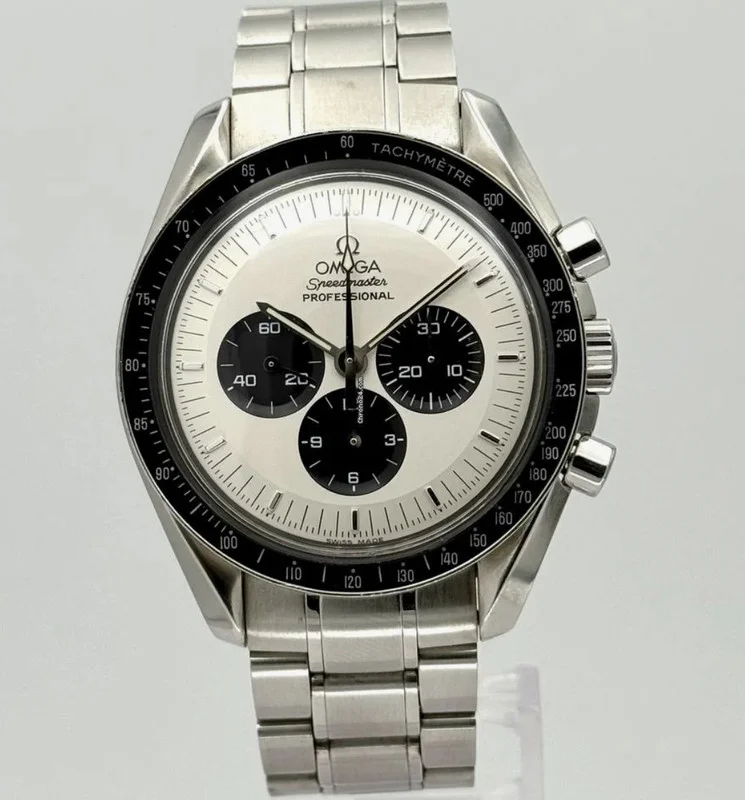

And while the newer versions promise improved aquatic performance, they are incompatible with my second itch: a panda dial (preferably a Mitsukoshi, or Apollo 11 35th anniversary) and I actually prefer the 1861 case shape over the 3861.

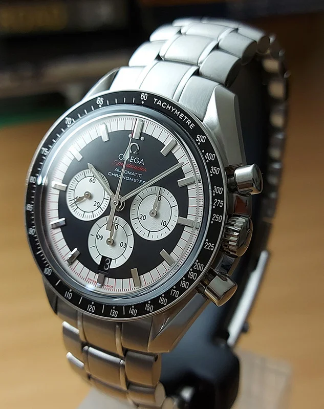

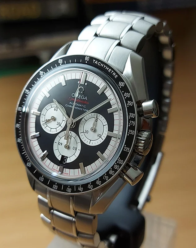

So while researching the subject I find out about the Michael Schuhmacher Legend series (specifically the 3507.51.00) and it's 100m water resistance.
While a beautiful watch in itself I would still prefer a less busy panda dial instead.
But it felt like the best of both worlds: classic 42mm Speedmaster case and improved qualities as a daily watch

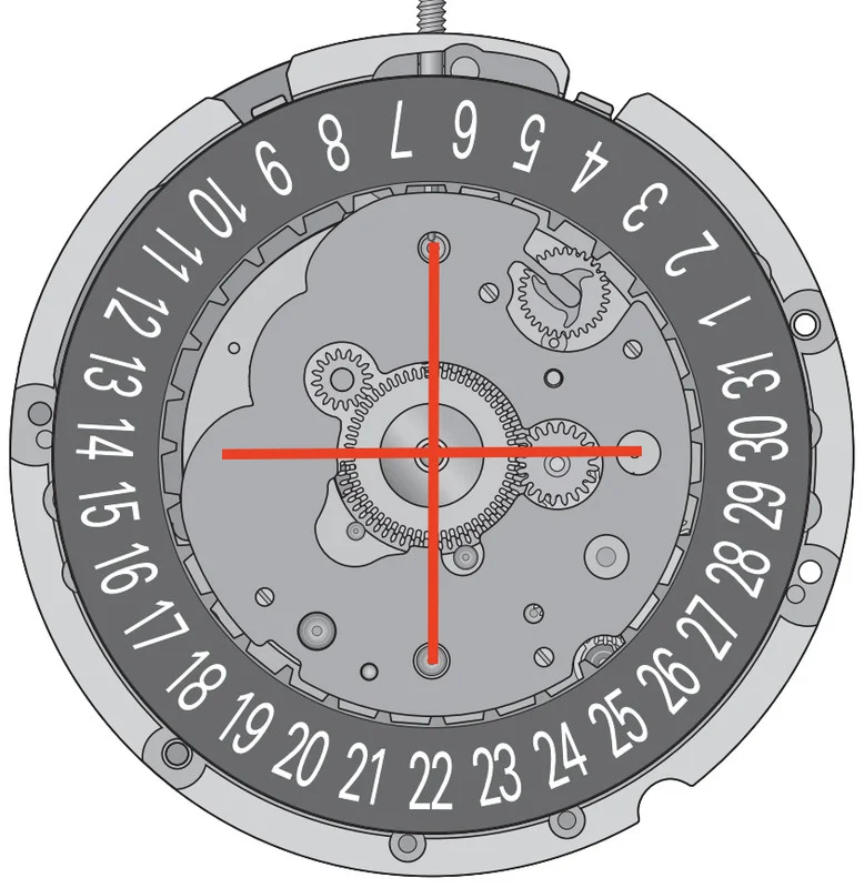

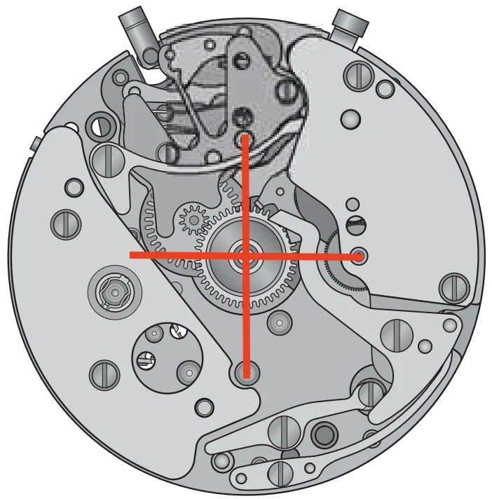

So I looked into the respective movements and they seem very similar in proportions:
Both are 27mm in diameter and 6.85mm or 6.87mm in height.
And my improvised measuring attempts on the computer screen seem to put the subdial centers also in the same locations on both movements.
So I feel a 1861 panda dial should fit the 3301 movement as long as the date wheel is not interfering with the dial.
And with the 3507.51.00 I could even reuse the same hand set (the red seconds hand tip would even make the Apollo11 35th anniversary dial work)

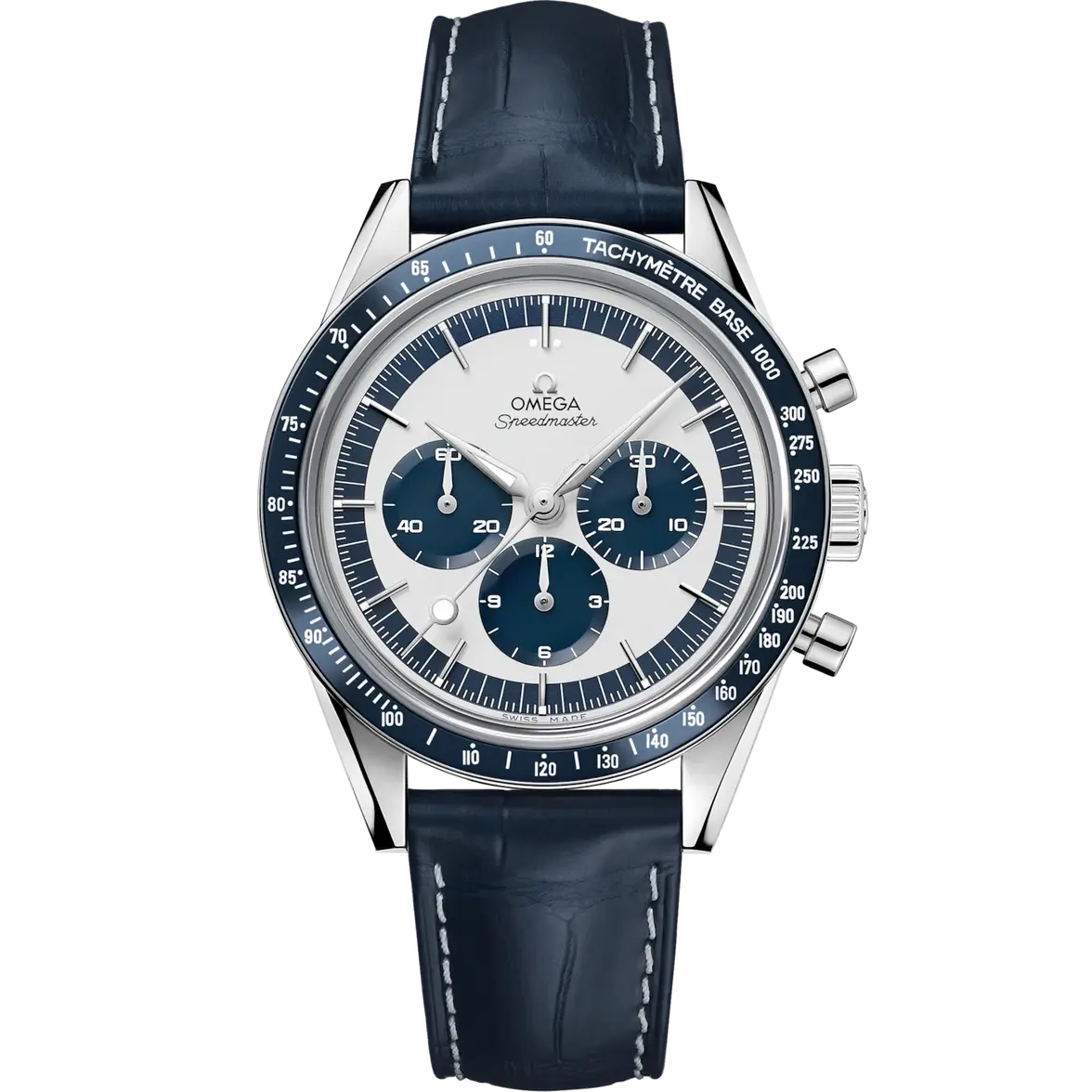

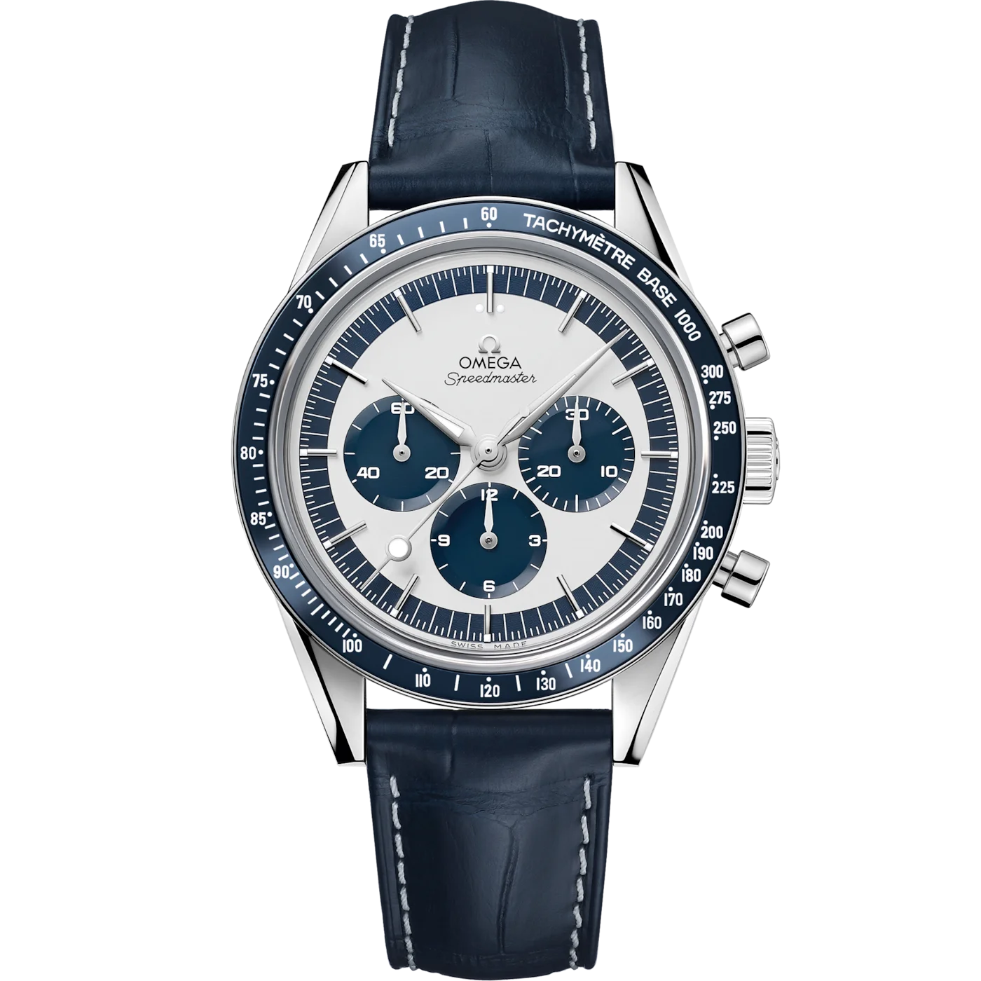

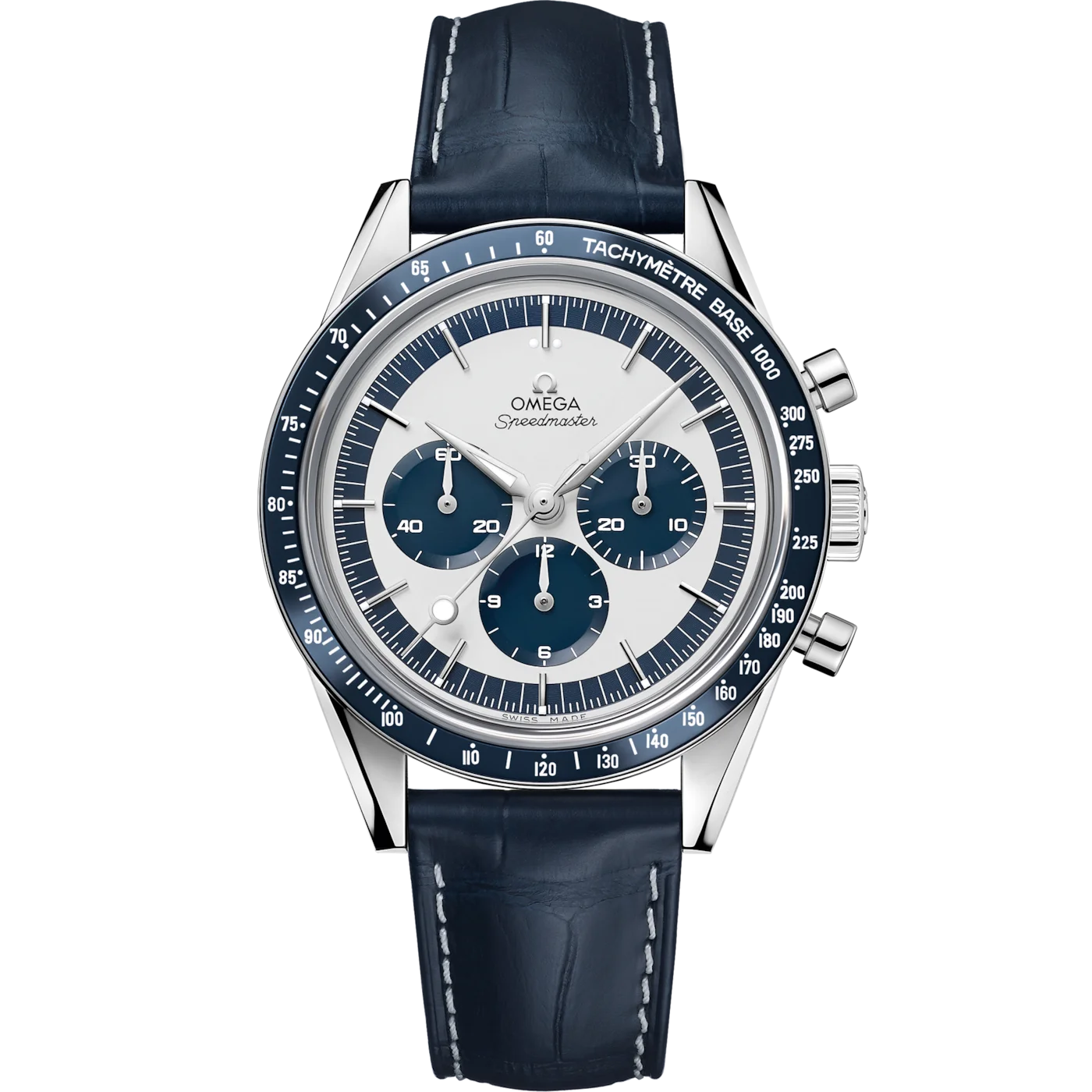

Another alternative in the Panda dial with more water resistance might be the FOIS models:
225
1,831
Both are about 27mm diameter movements but they're going to be different in thickness and the relative placement of the crown and pushers relatively to the case is likely to be significantly different even if it could fit.
Thank you for the suggestion. I did try on the FOIS and unfortunately it doesn't wear as well for me as the Professional case.
As for the crown and pusher placement: I was under the understanding that the case of the Schumacher Legend is basically the same as the Professional case but I might be wrong there.

FWIW, the one in those links (The CK2998) are both the professional case, 1861. I have the blue one, its fabulous.

Has anyone ever tried to fit a 1816 dial to a 3301 movement?

I don鈥檛 think the subdial post placement measurements are the same.
These are totally different watches and totally different movements. The reduced/ automatic also has a narrower dial vs a pro. One is 40mm the other 42mm wide.

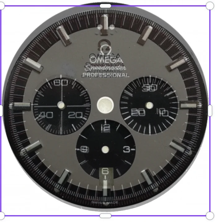

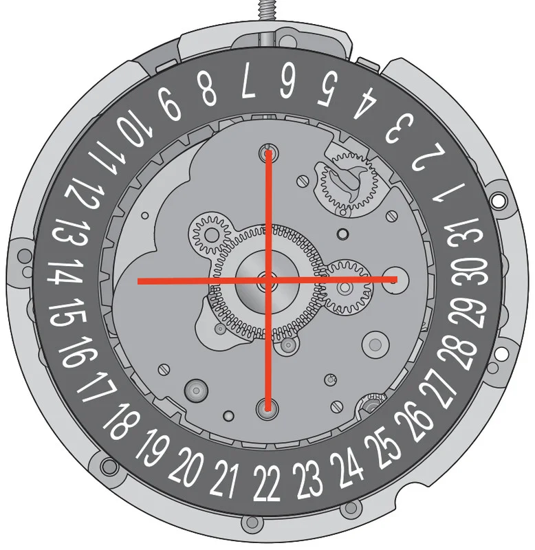

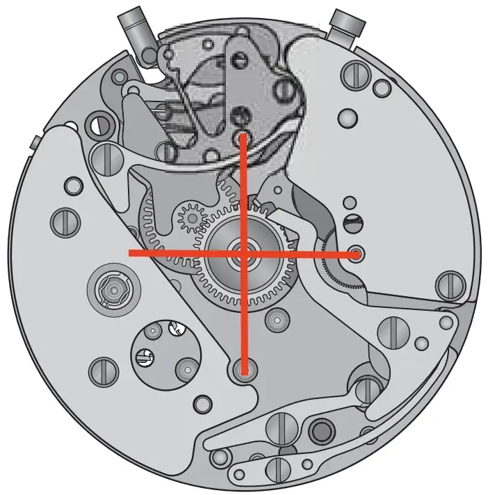

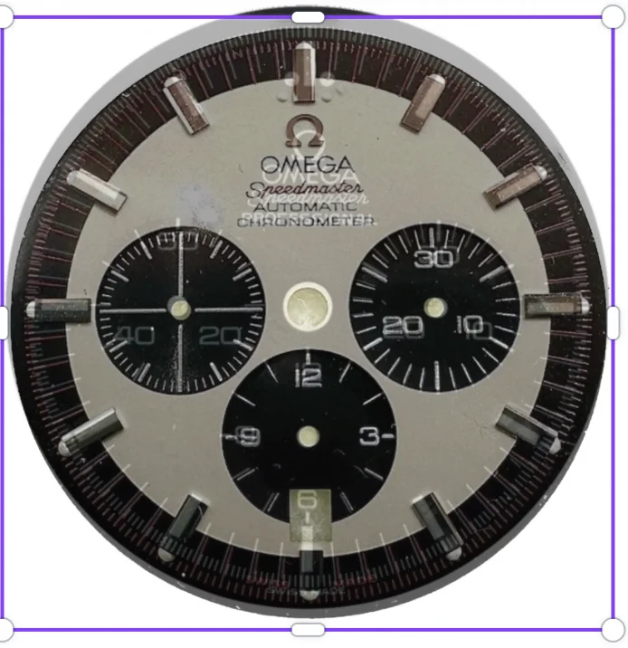

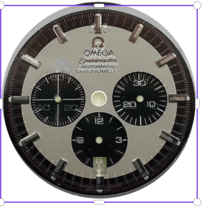

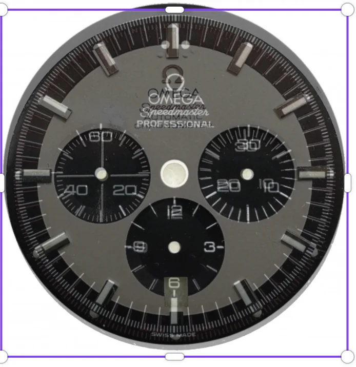

I took a picture of a 1861 dial and overlaid a picture of the Schumacher Legend and then showed different levels of transparency:
Looks pretty close to me in regards to subdial positions.
What do you think

Do what I did and ask google if the sub dial post positions are the same for the 1861 and 3301 movement. The answer was an unequivocal no. Though AI isn鈥檛 always to be trusted it鈥檚 true. Close isn鈥檛 good enough unless you want to butcher the holes on your new dial to make it fit.

I got a similar reply but it also said that the subdials should be farther spaced and I just don't see it.
I made a little video of the overlay sliding back and forth and to me it really looks like the holes are lining up:

The overlays look close, but not the same. That small difference will make all of the difference. Close isn't close enough where tenths of a millimeter matter greatly.
I guess only one way to find out 馃榾 Gonna have to bite the bullet

I don鈥檛 think this will work. The tolerances are so tight on these watches. Given the rarity/value of the mitsukoshi dials, I recommend you test this out first with a standard dial. You can sometimes pick them up for a few hundred鈥nd sometimes less for a damaged one.

Yes I will have a regular 1861 dial to try it out first.
Worst case I end up a with a very nice Schumacher and a Mitsukoshi with a 1861 case 馃榾

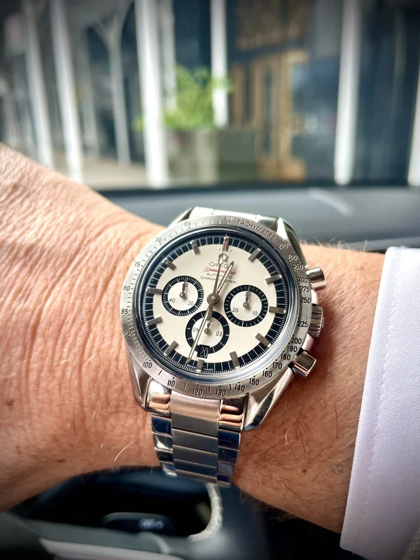

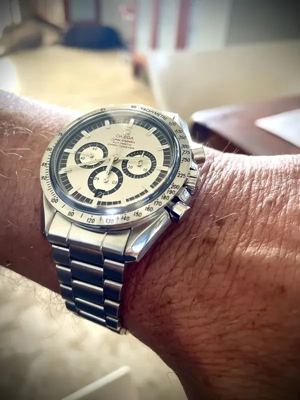

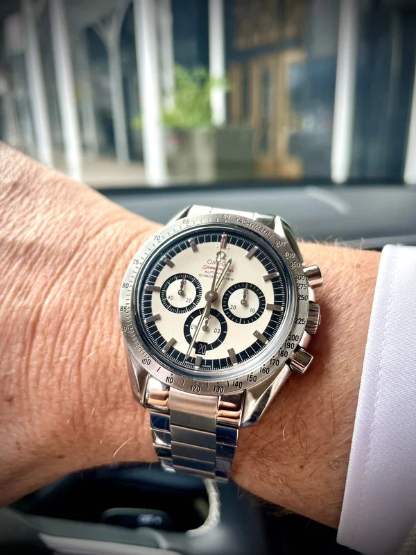

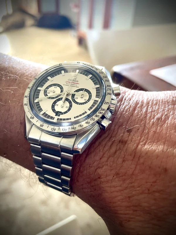

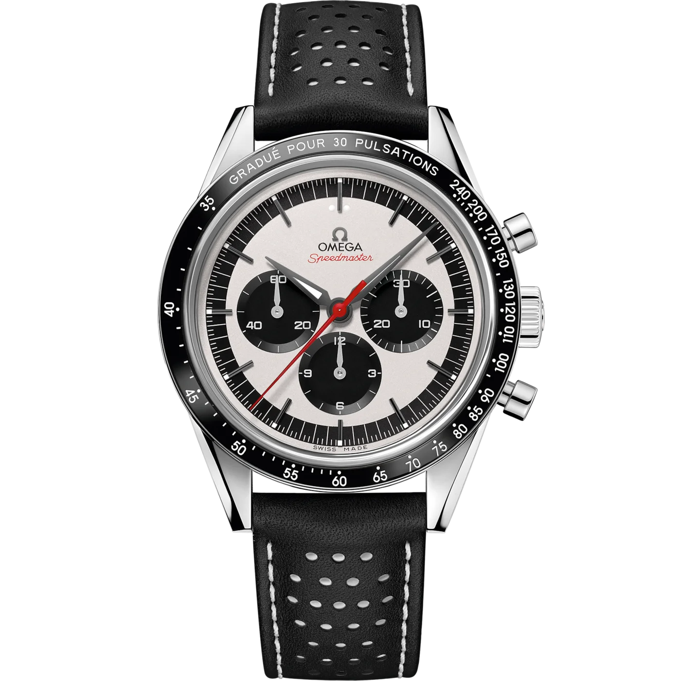

FInally was able to hunt down the Schumacher Legend series watch, but honestly it's too nice to fiddle with it:
Will have to look for one of the white dialed version where I don't mind tinkering 馃榾
But I might just be happy with this. I think these are highly underrated.
Also dresses up nicely with a more shiny bracelet:
