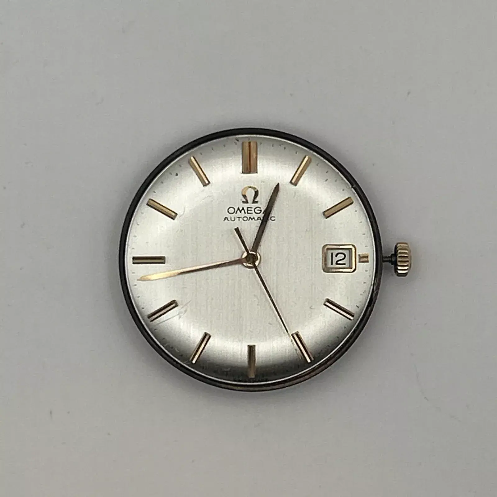

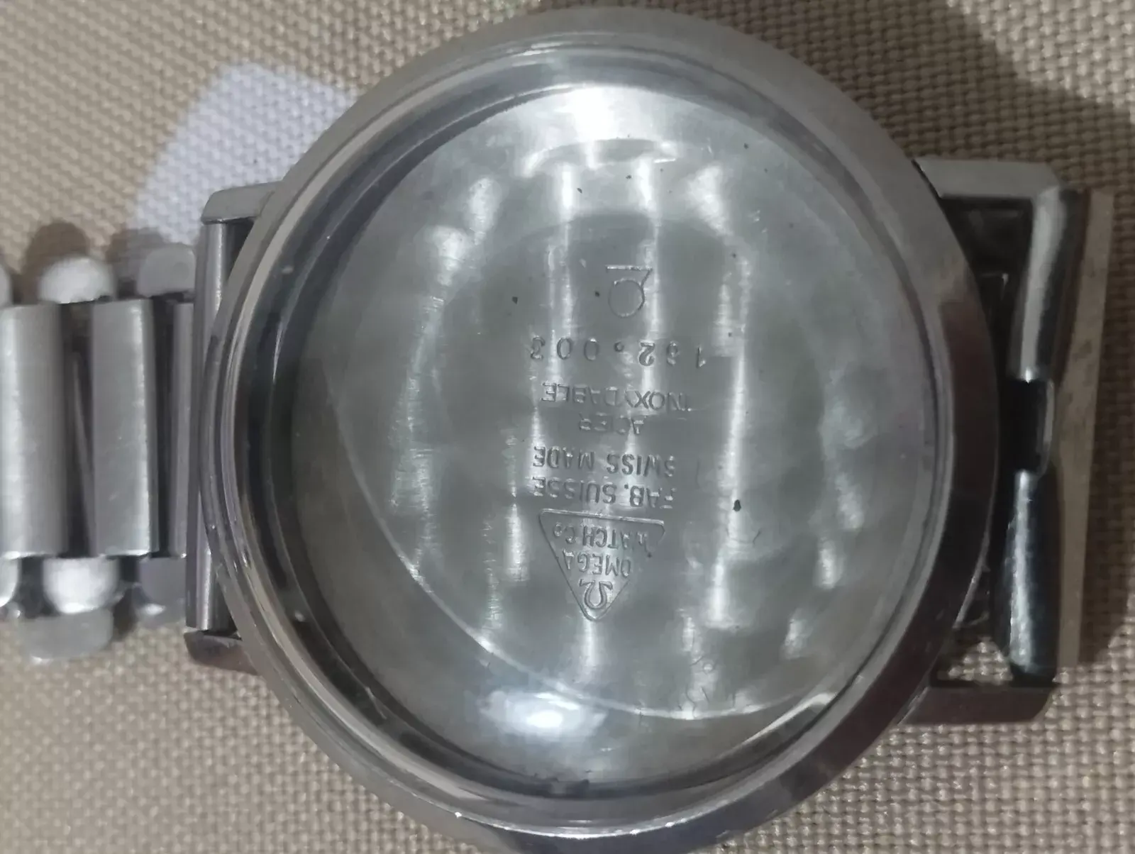

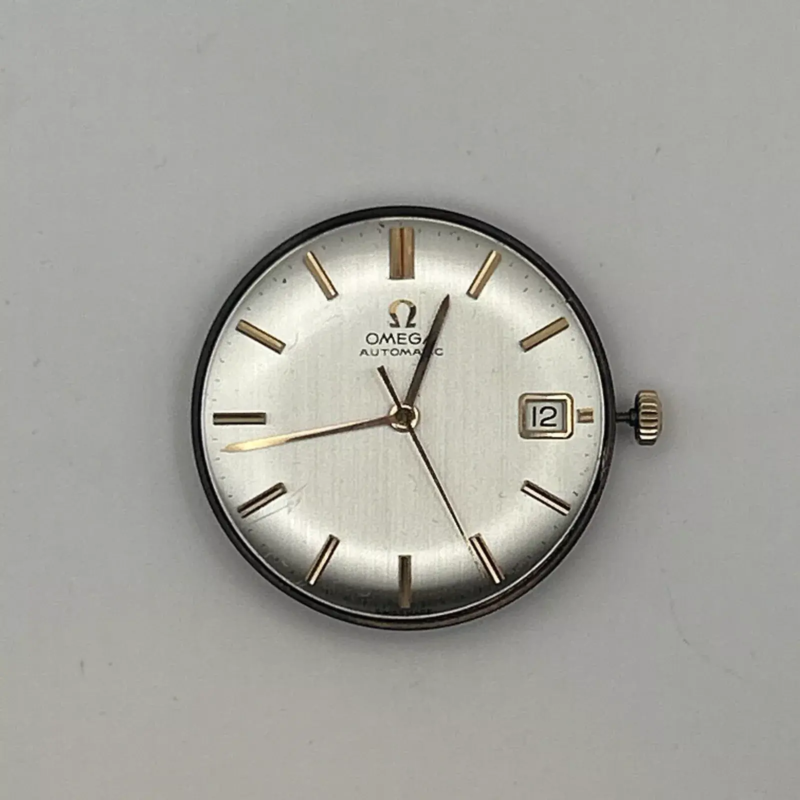

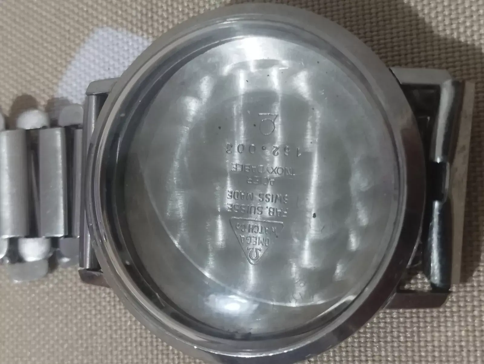

I won an auction for a nice dial and working 562 movement in good condition. I also have a 162.003 case that I assumed was the right fit for it but I'm not sure its the right case for this dial. I've got a few questions:
1) is it the right case? if not, whats the right reference for this 1962?
2) if it is the right case, how do I open the back? I cant seem to get that off with any of my tools, and I also cant seem to remove the bezel. I dont want to keep at If theres some trick to it.
Thanks for any help!

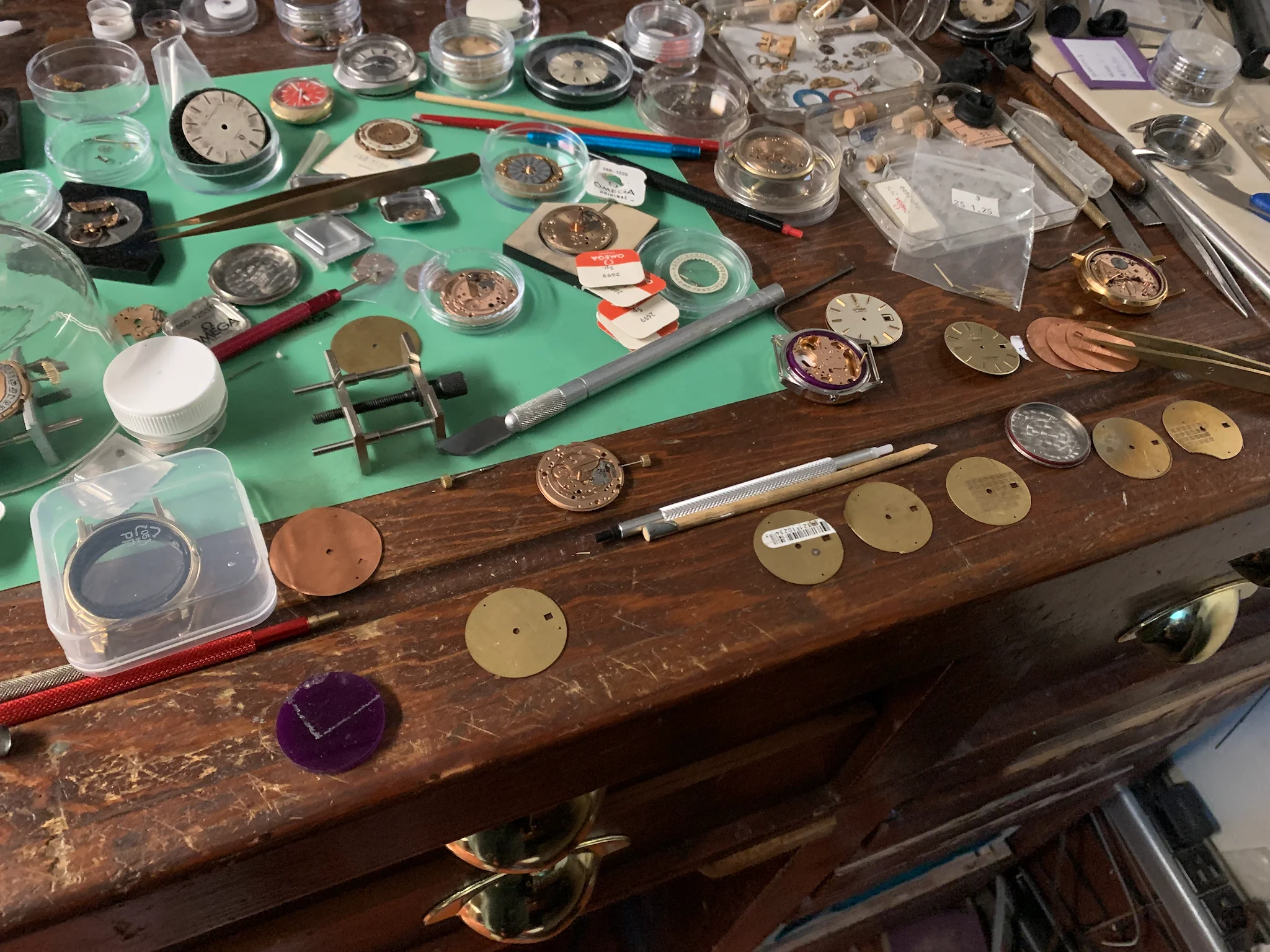

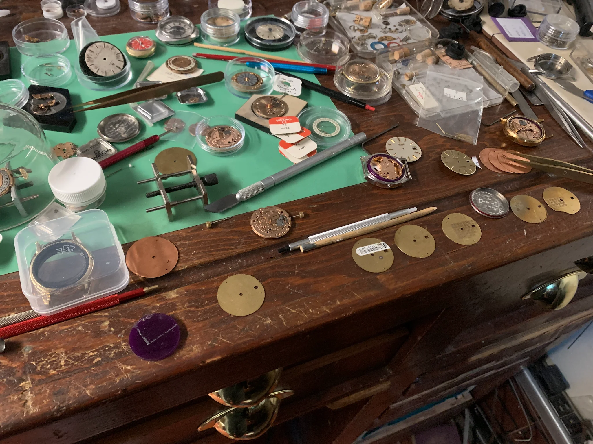

I have been experimenting with a fiber laser to make some dial blanks. Most of the stuff I get is pretty trashed. Finding cheap 562 cases is difficult. Best is to get a case/dial set and go from there. Movements are plentiful.
Some of this is an ongoing project from 30 years ago, when repainting dials was a standard procedure. Probably should be testing more with the old generic Landeron chronos, But I got parts for half a dozen or so 5xx movements. I also have access to a fiber laser so can make movement rings. The lasers are also useful for making movement holders.
I have also playing about with the 134x quartz movements. It is not uncommon to find 2 or 3 similar watches, where the only difference is the dial. The reason for posting the picture is to show how much waste there is in dial making. My guess is the dial makers had a lot of unusable product. Yield rates are not that great. One factory I visited had a huge boneyard of enameled dials.
There may also be a difference for watches made before the quartz crisis in the 1970s and 1980s. Quartz watches were made on automated assembly lines, so the dials tend to be more standard. By the 1990s dials seem to be pretty consistent.
My experience has also shown, that no money is saved trying to restore partial watches. One winds up with a lot of examples which often seem to need unobtainum parts. Hind site says that one is better off getting a complete movement, with a plated or SS case. Which there are quite a few lesser examples of. Even if this is more boring, chances of success are much higher.
this pry back had a little gunk holding everything up, a little brute force with a case knife got it - so thats one thing down.
7

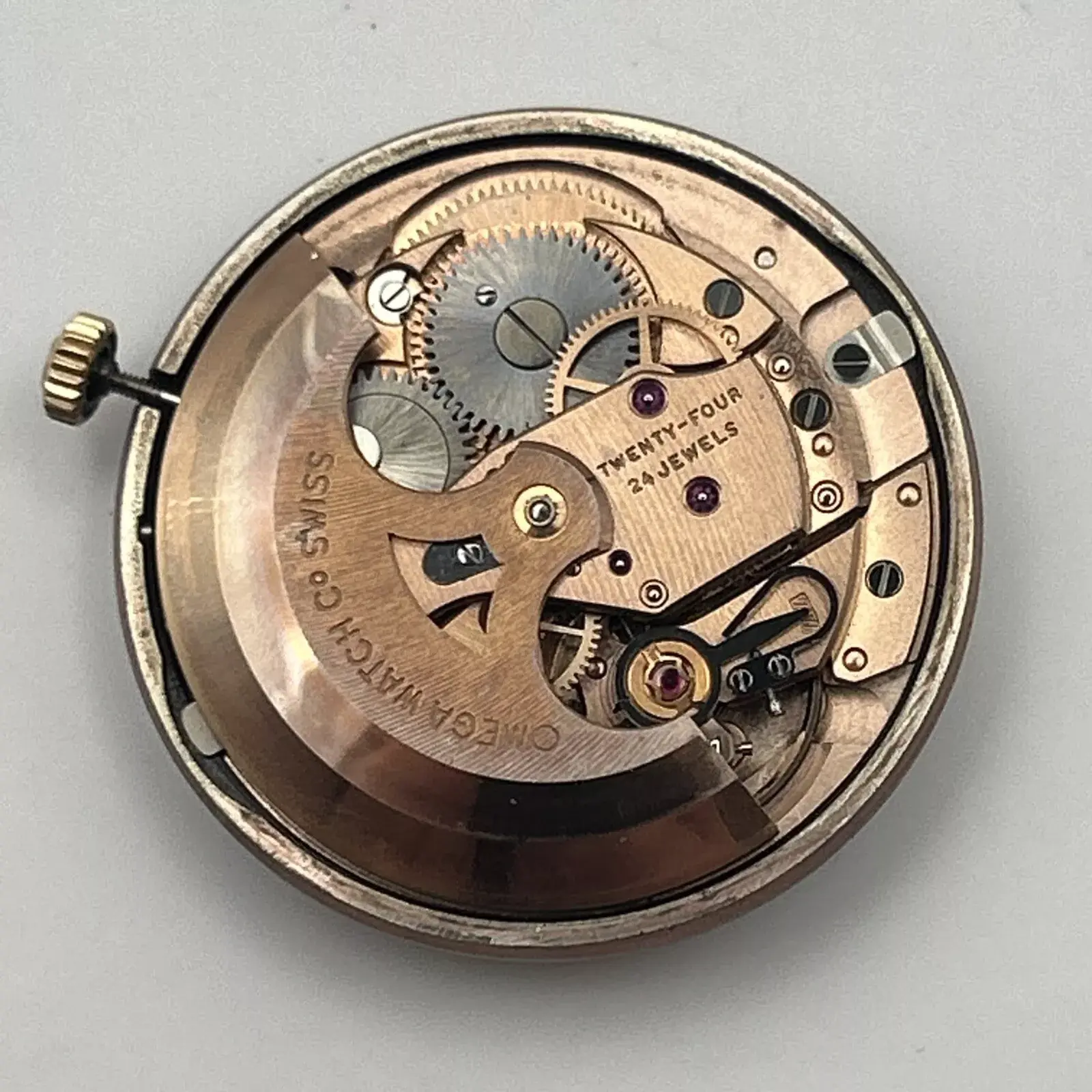

ok so that is definitely not the right case for this. The movement is ~31mm and the case opening is 28 on this 162.003.
Dial size is 30mm, movement 31. still from 1962.
With that additional information, would anyone know what the right case is?

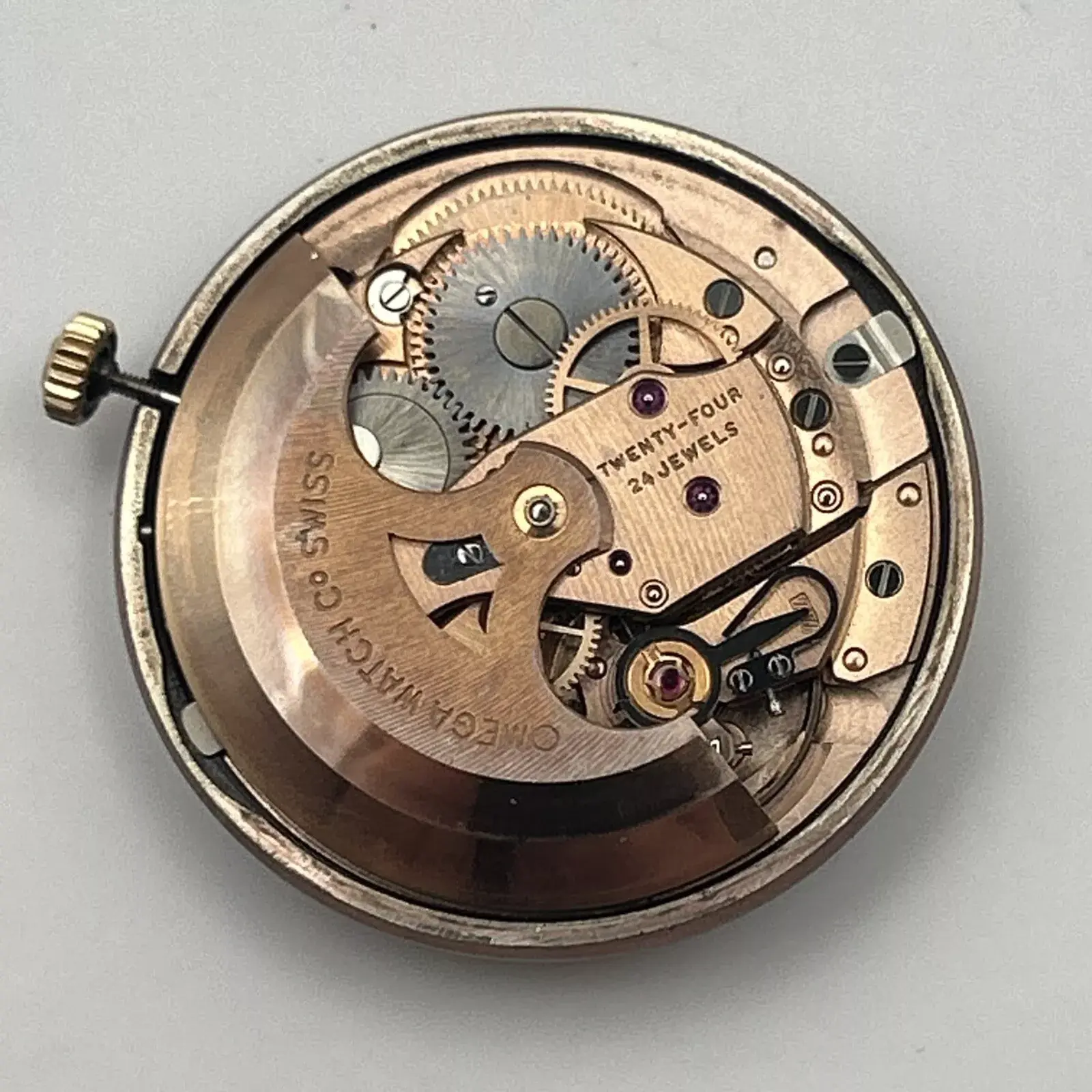

A 562 should be 27.9mm. Is there a spacer ring on the movement?
It is not uncommon for the larger (jumbo?) dials to be installed on a smaller movement with a spacer ring.
I am finding matching cases and dials to be difficult, Seems like I may not be alone here.
7
yeah it looks like a spacer on the movement to acommodate the larger dial
