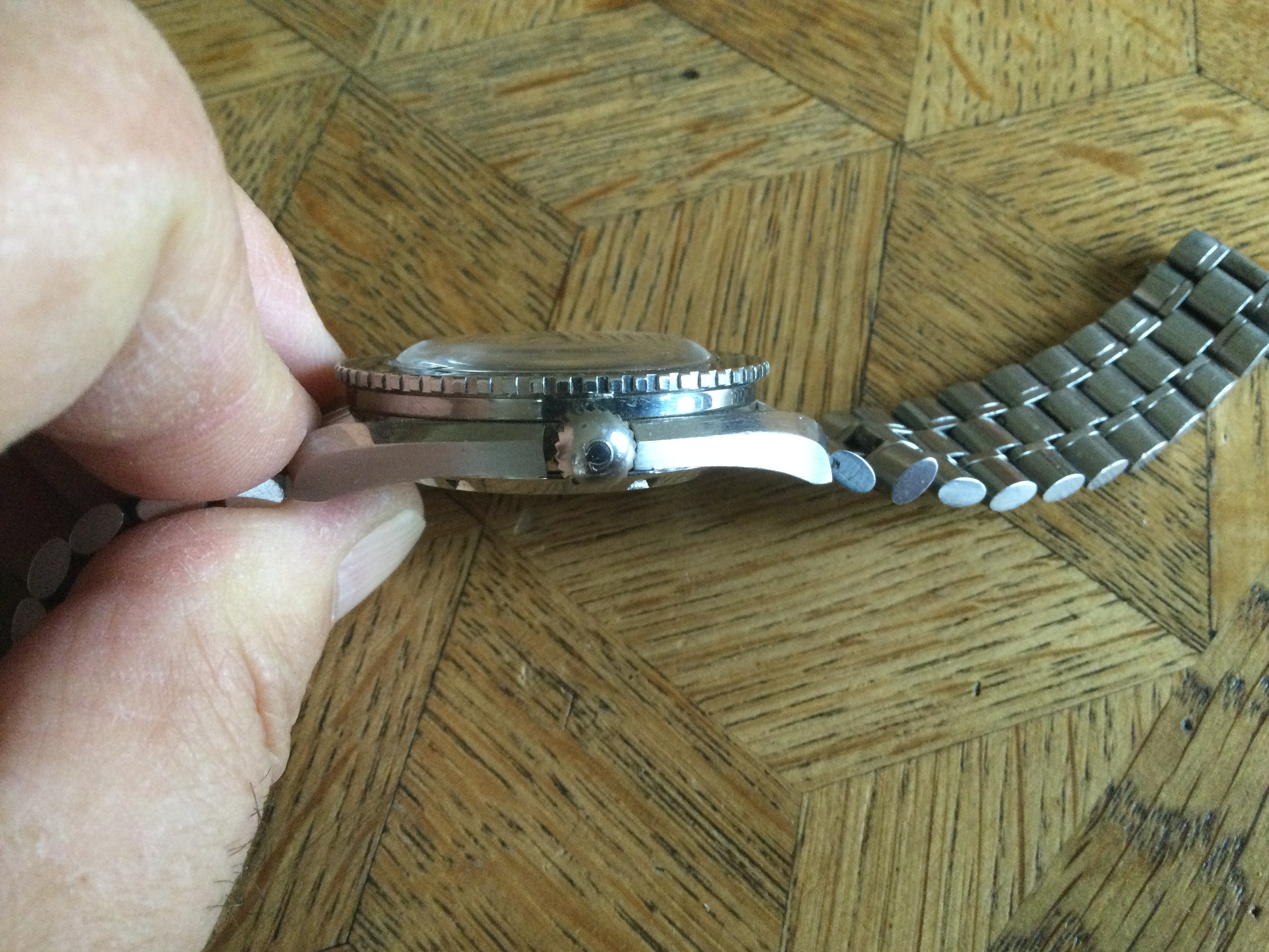

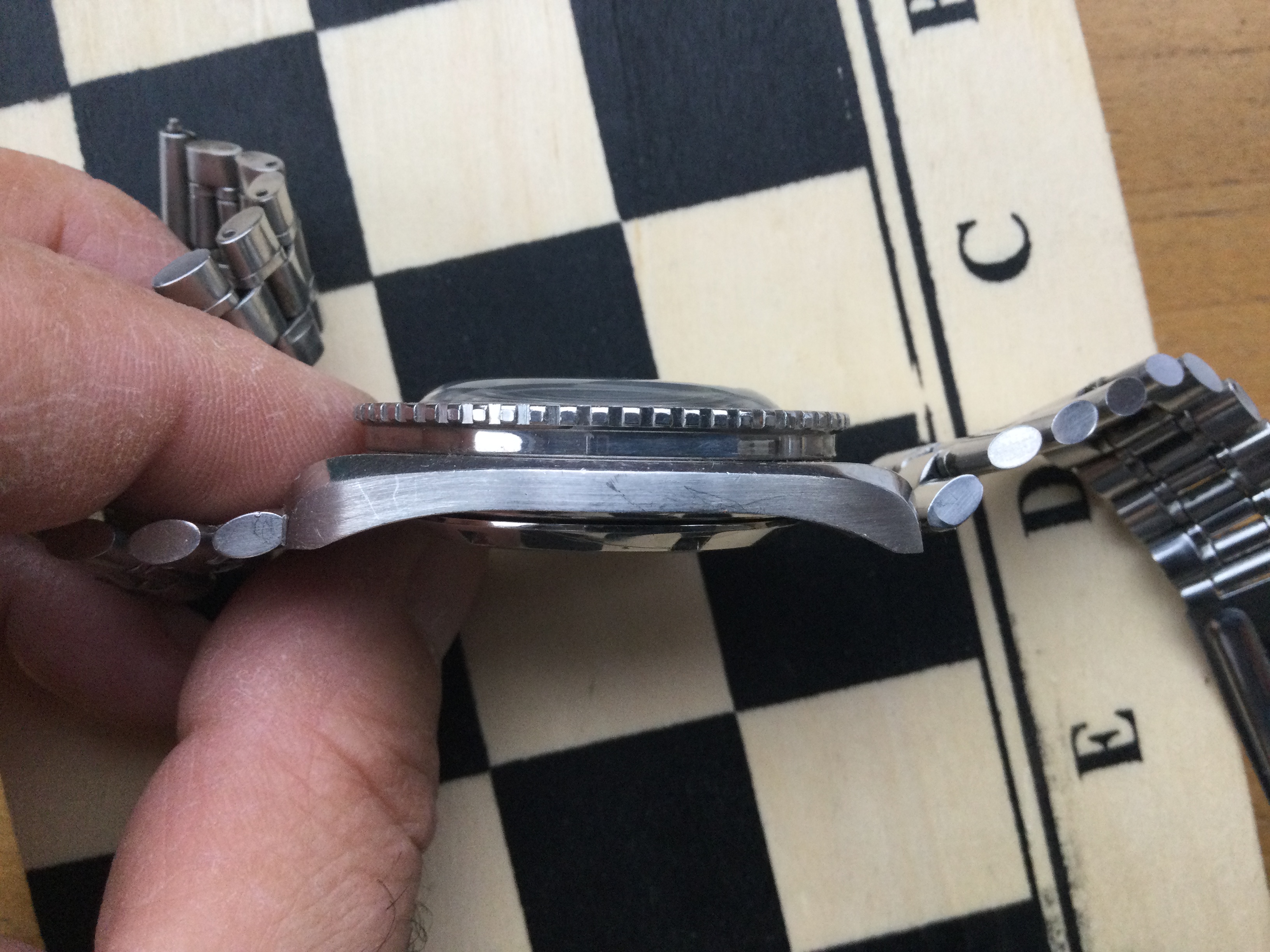

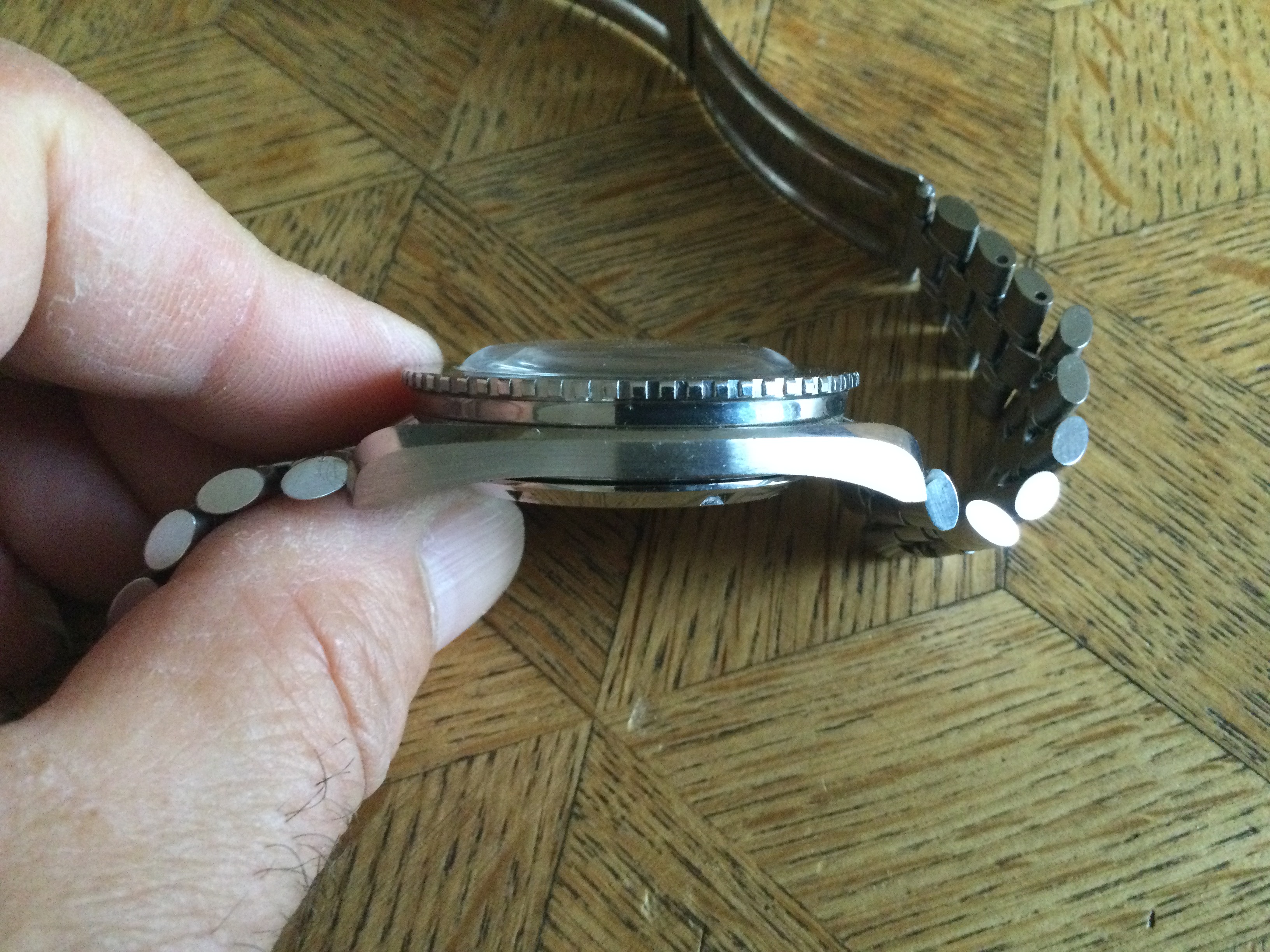

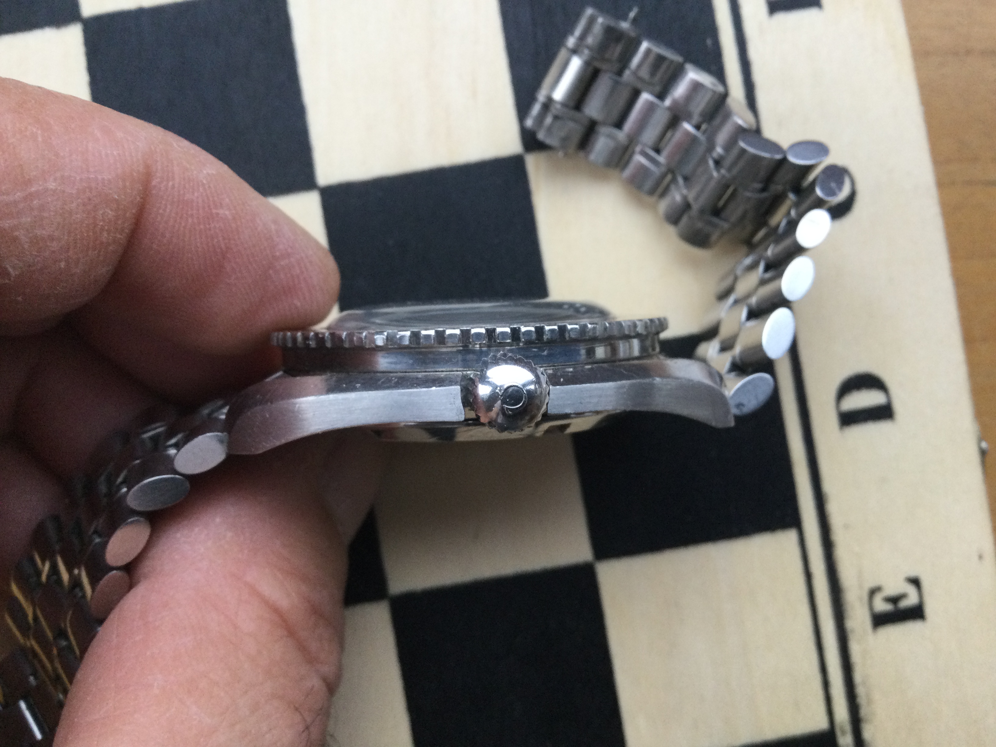

That said, based on @ndgal comparisons pics above I’m feeling way better about it. Really appreciate him correcting and educating and sharing his knowledge, exactly why I posted here!

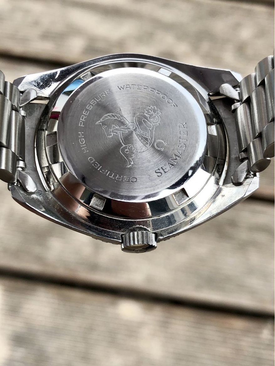

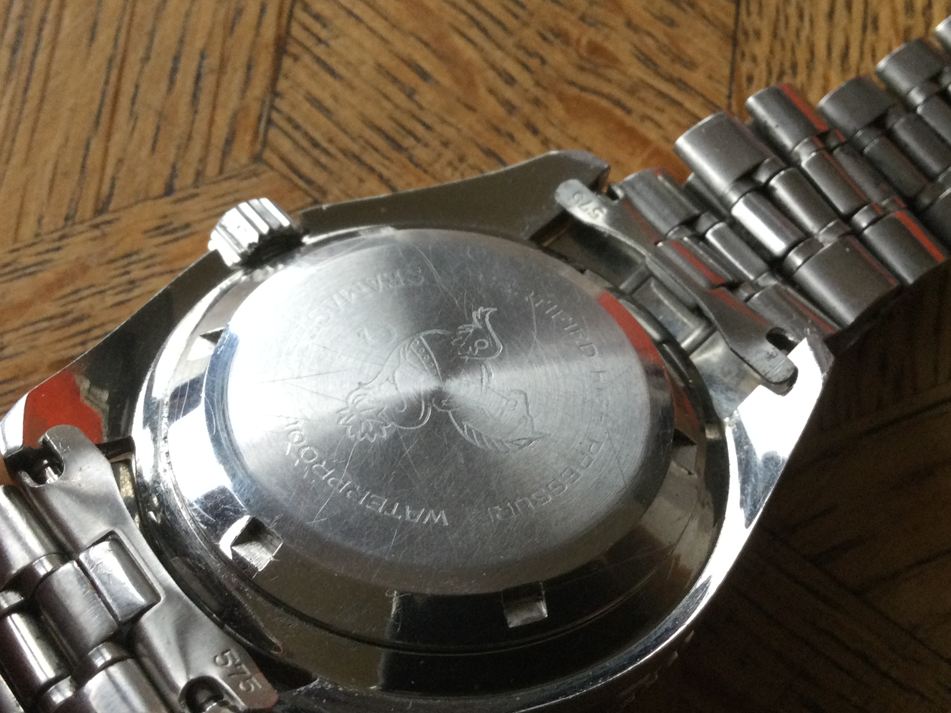

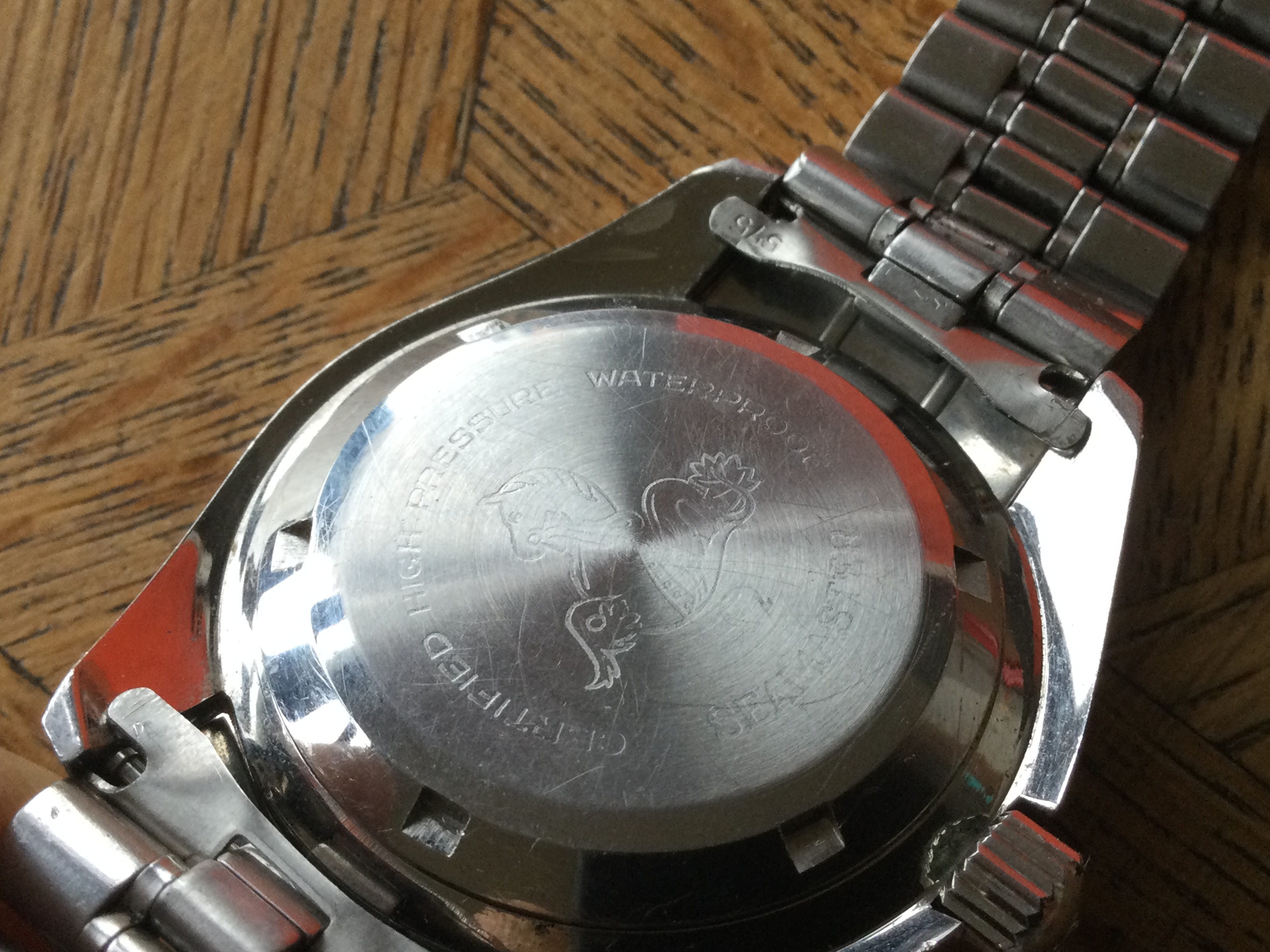

Again, the case back (and case) are fine. They’re not fake.
30,289
78,178
The type of the caseback is different from the OPs. Were there variations in the service caseback engraving?
Yes.

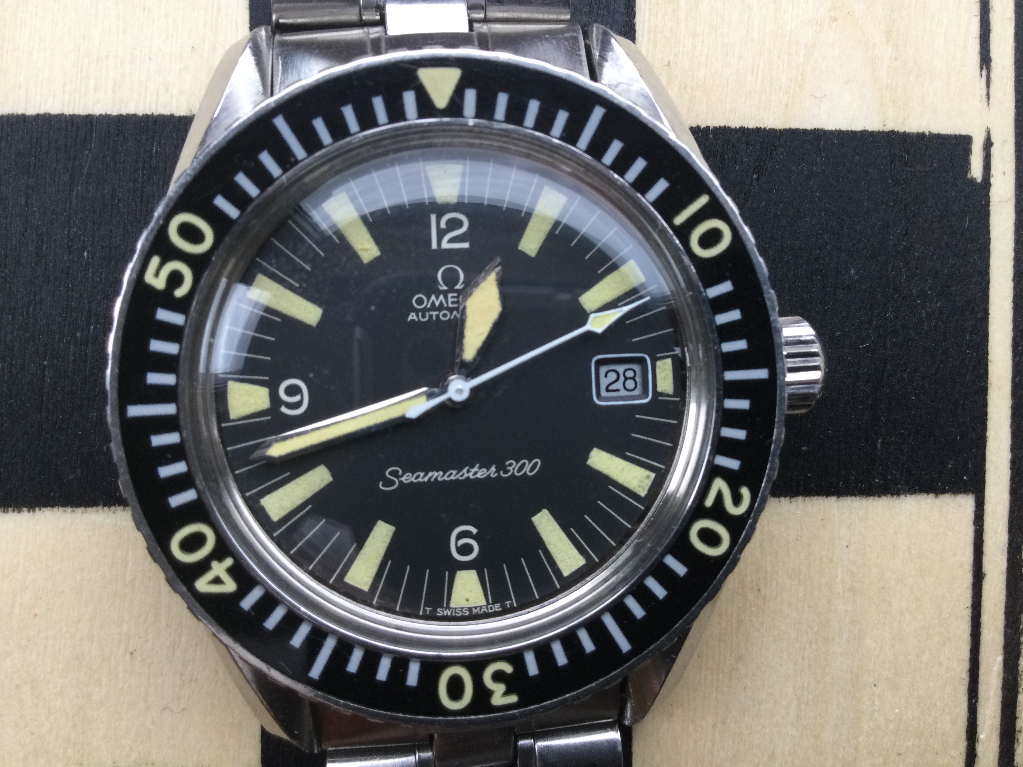

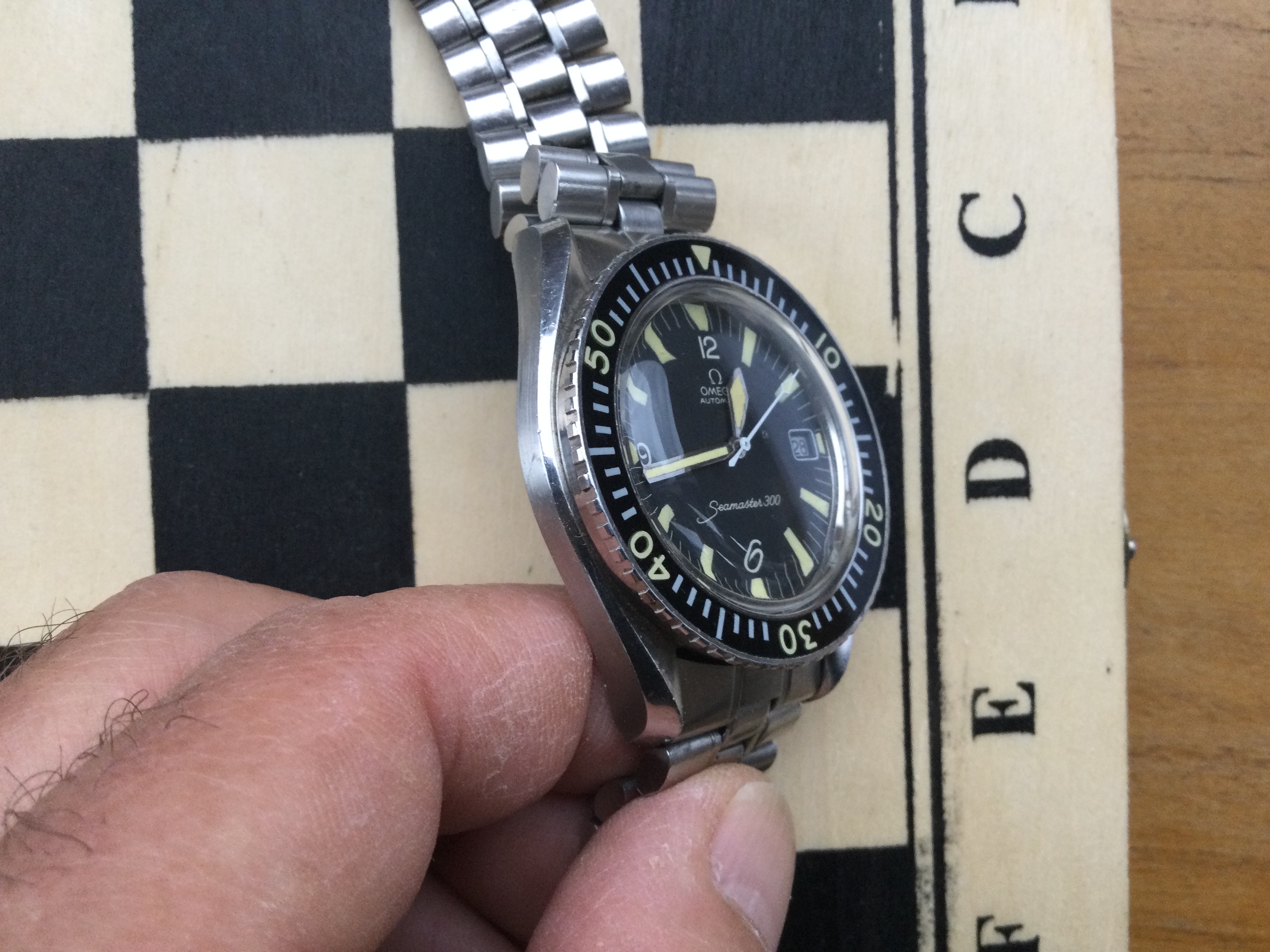

So, good news and bad news.
It does look to be the original case, bracelet, movement, and caseback -- the caseback is just in almost-NOS condition.
The bad news -- I'm pretty sure it's a very good relume job. Under blacklight, you can see multiple colors of lume in the big triangle, the lack of a pin dot, and that the various index markers are have very, very uneven edges. Grateful I spent the $8 on a UV blacklight flashlight on Amazon, because it isn't nearly as noticeable in regular lighting conditions.
Leaning towards returning this to the vendor -- thanks all.

I’m not seeing what you’re seeing on the video. Why is it a relume? It looks original to me.
2,318
5,713
Because it is all original.
