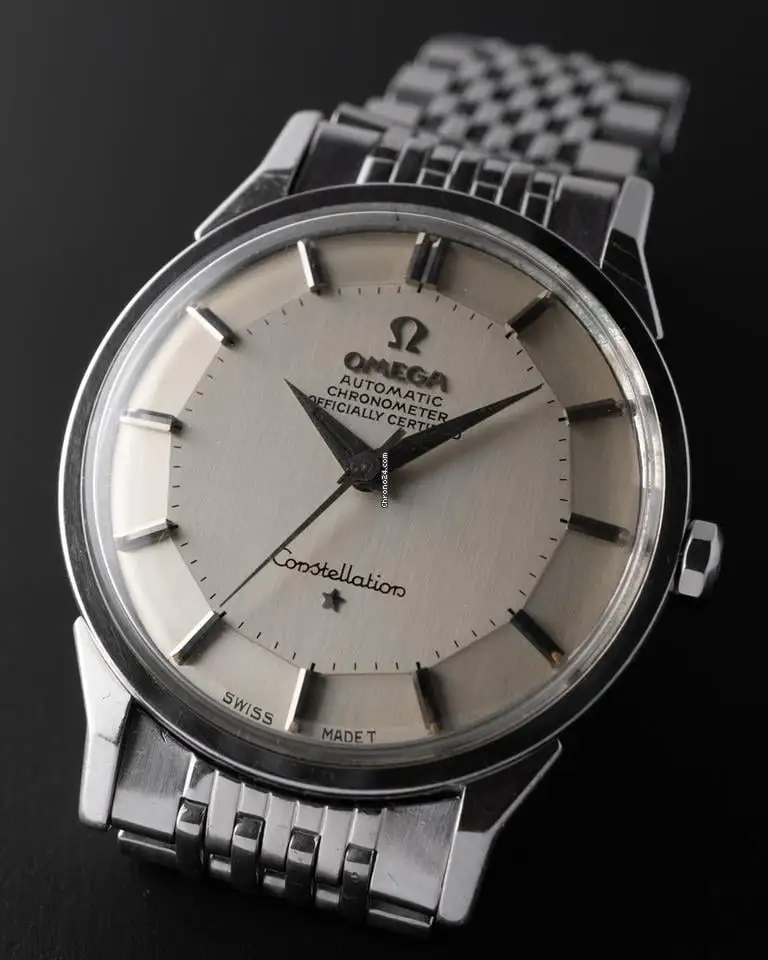

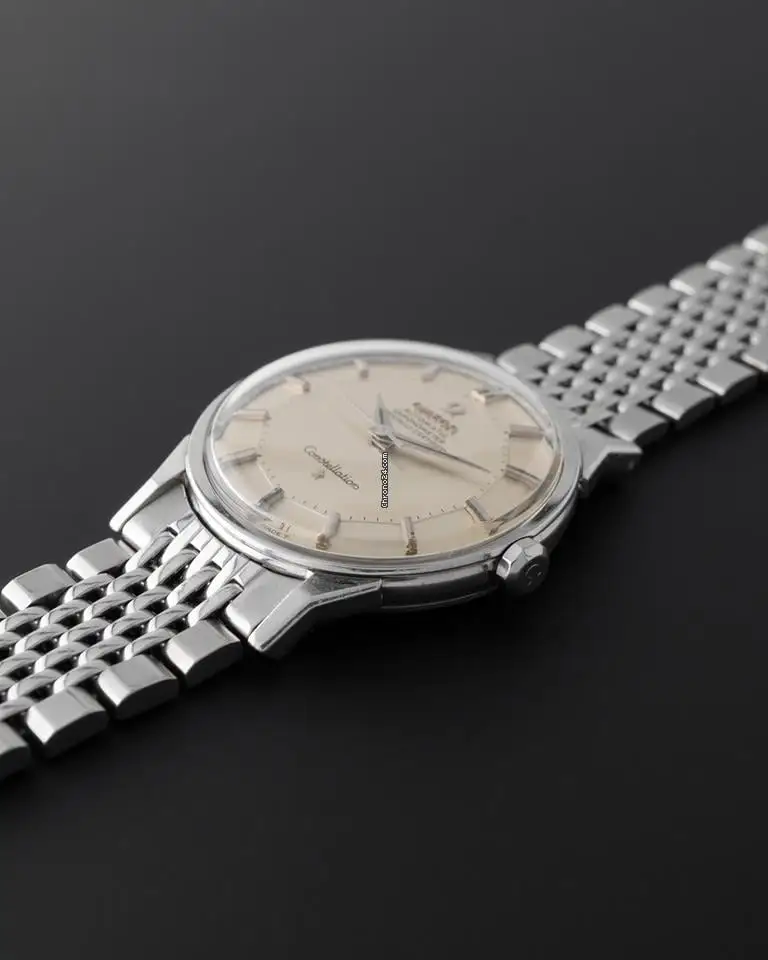

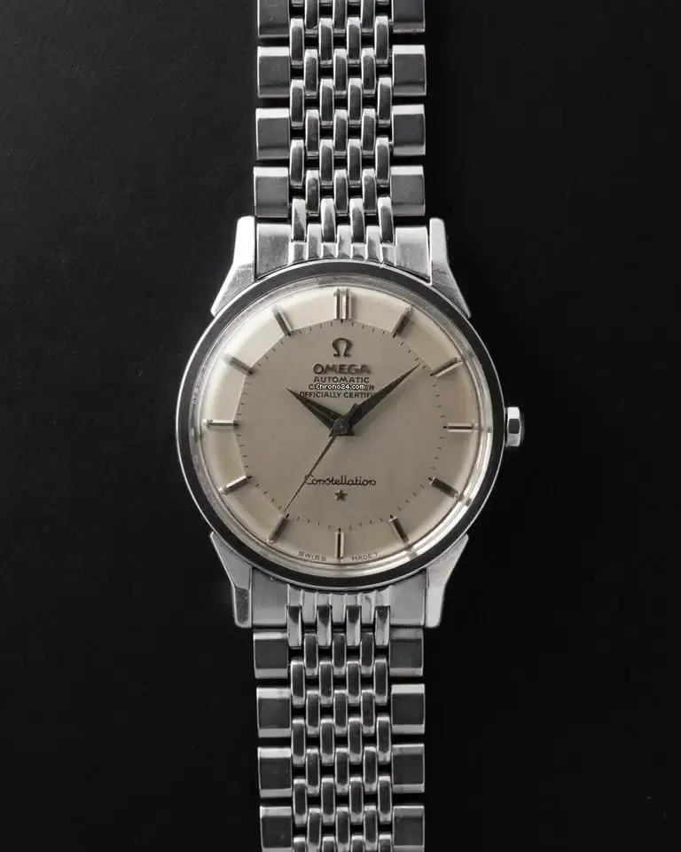

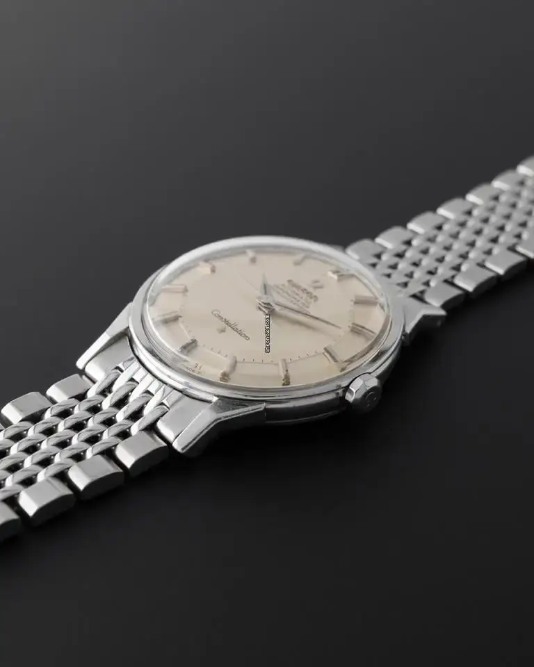

I have recently become very interested in vintage Omega watches, especially Pie Pan Constellations in steel. I found this 167.005 with BOR bracelet from a private seller in Japan and would really appreciate your opinions before I make a decision.
From my limited experience, the watch looks attractive and fairly honest, but I am unsure about:
  • whether the dial looks original/unrestored
  • how polished the case may be
  • and whether the asking price (~1850 CHF) seems reasonable
Thank you very much in advance - I would really appreciate any thoughts or advice from more experienced collectors.

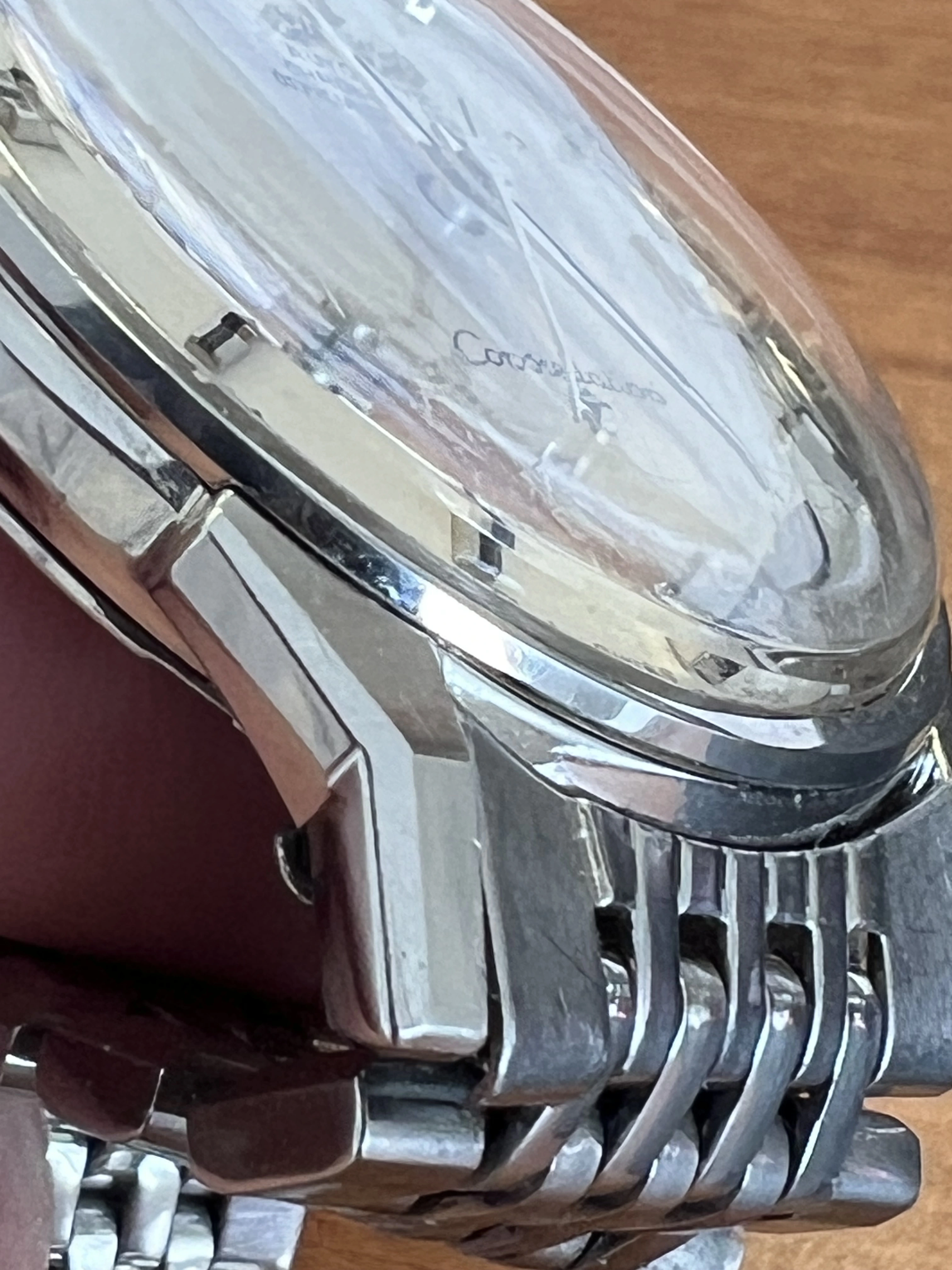

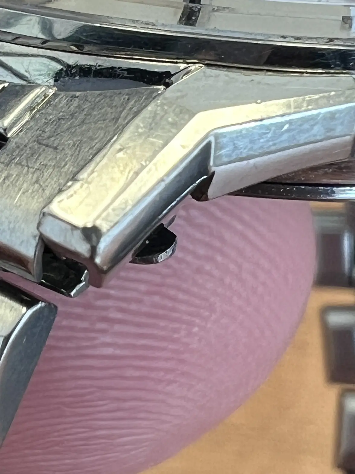

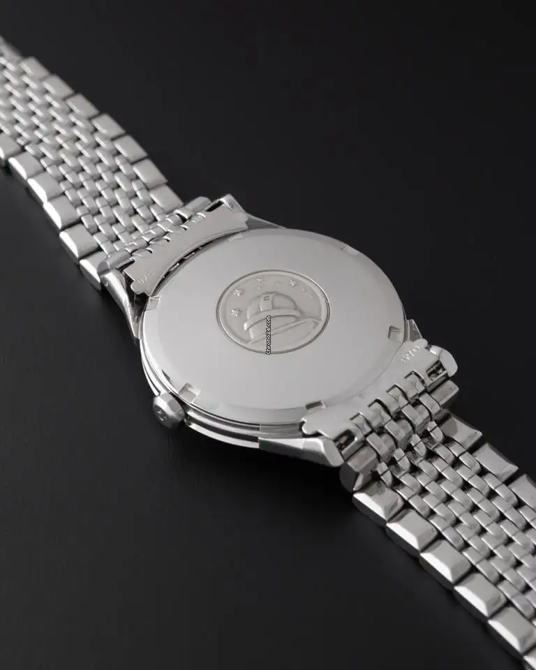

Dial looks good other than the minute markers (which I can't tell, teh photos aren't good enough to see if they are compression artifacts or inconsistencies/re-paints), case has quite a bit of polish on it, it is missing the facets to the dog legs.
Price seems quite high to me, probably at least 300 CHF high(though original bracelet is a nice to have!), though I probably wouldn't go for a pie-pan without sharp dogleg lugs, thats sort of a deal breaker for me.
So yeah: Without better photos of the minute markers, I'm not positive about the dial, and the lugs are quite polished, so I wouldn't pay that premium of a price for it.

Don’t know about the whole watch, but the dial doesn’t match the age of the hands, so think the dial is refinished.

Gosh, the photos are just so terrible. It's really hard to judge the condition of the dial, but you can definitely see that the case isn't great. I think that sharp edges on the lugs are a really important feature for the dog-leg cases.
Your budget is good enough to get something nicer, IMO. It really depends on whether you are patient enough to wait for a better example.

As above, the photos simply aren’t good enough to assess the watch in any meaningful way.
If these are the sellers pics, then pass on this seller.
If they are screen grabs and you can post better images then do so, so that we can assess the watch properly for you.

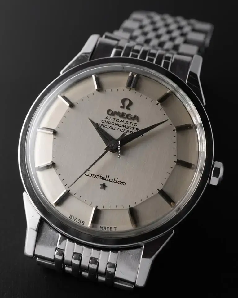

I find it ok for that price to be honest. Dial looks fine to me. Movement good. Lugs not sharp anymore but ok in my eyes. And even the original crown.
Its not in perfect condition but i think its fine

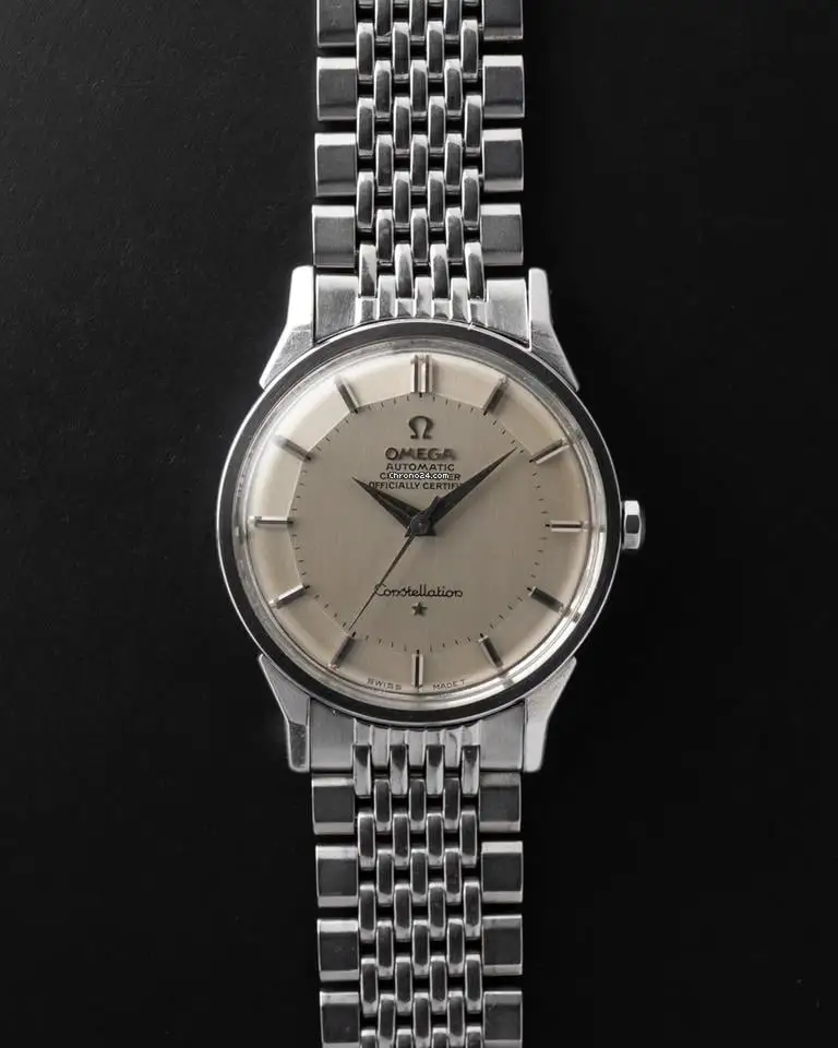

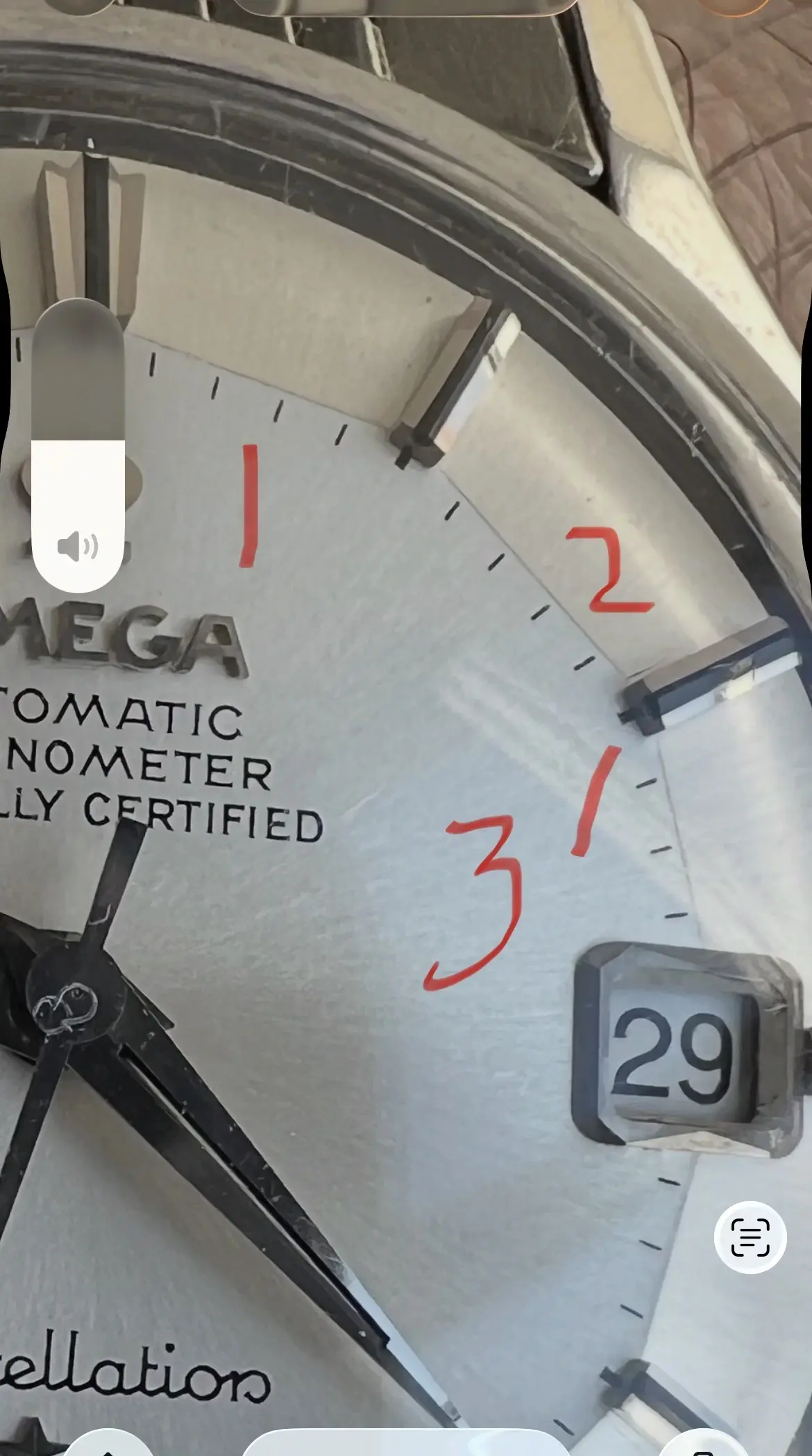

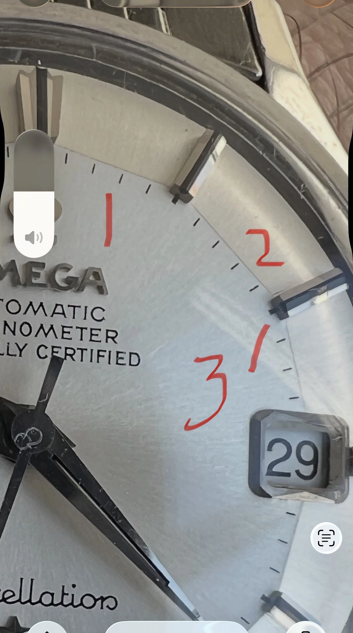

One more question regarding the minute markers: what are the main things you usually look for there when trying to identify a possible redial?
Thanks again!
3,333
7,345
1. Minute tics should be evenly spaced
2. They should be very close to the pie pan line not far away
3. Mark at each index should be very close- touching the marker , and be rectangular with serif visible on magnification.
3,333
7,345
You can also see the onyx inserts embedded in the steel marker, with the roofline easily seen on the 2 and 3 markers. That is how to distinguish from painted markers which are less desirable.
