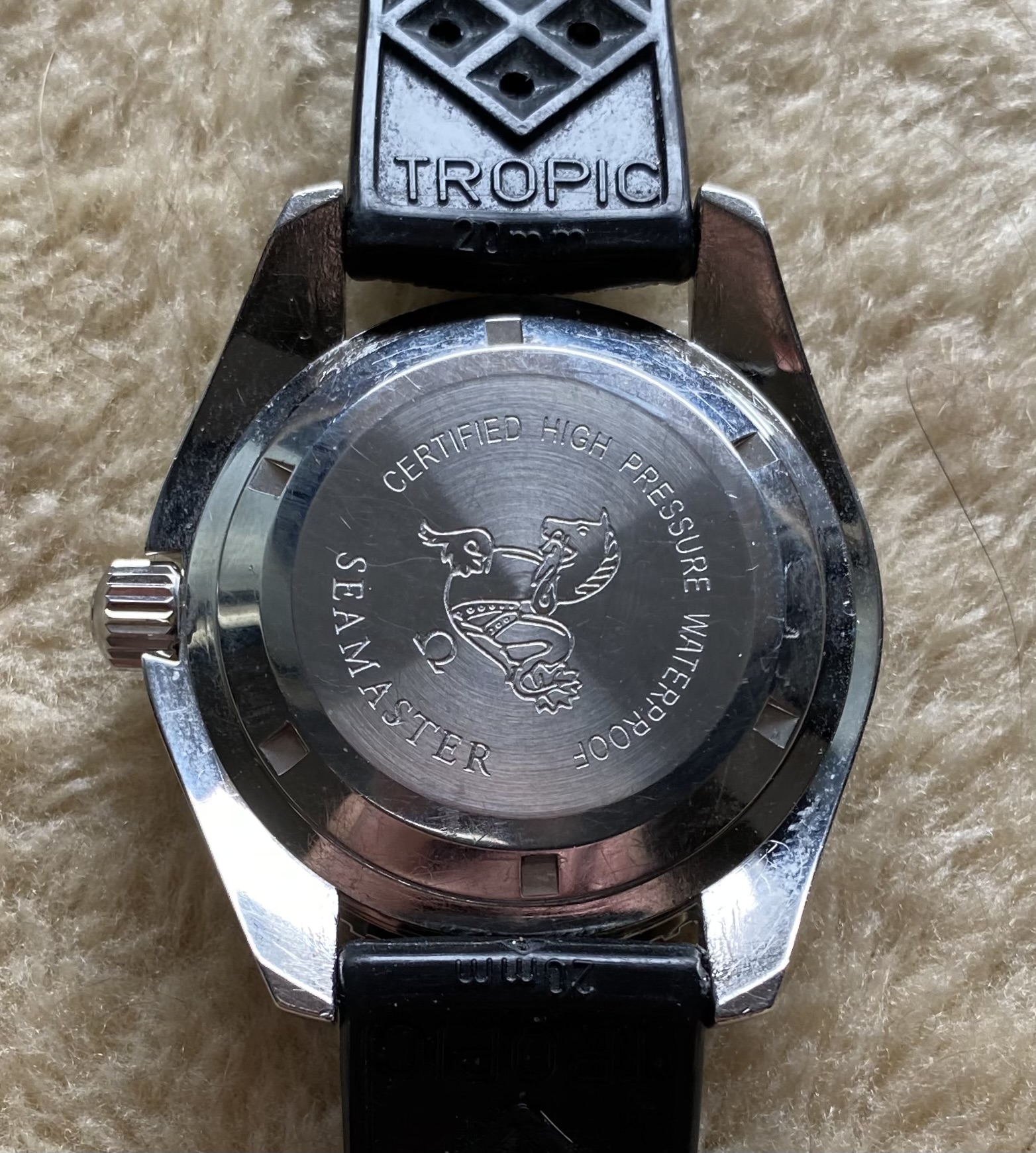

So what's the deal with it then? It won't arrive for a couple weeks because of eBay's authentication service (and after that, there's still a 2 week return window).
I agree that it looks lasered or at least not-stamped. Looking online, it actually does look like a variant of a 166.0324 service caseback.
And if it's a 166.0324 service caseback, I don't particularly mind, but -- should I worry about the case itself potentially being service and not original, as well?
This is what a 166.0324 caseback on a 166.0324 service case looks like:
And, yes, you should be concerned that it is a service case, but that isn't a bad thing... you might have an entirely fake case.
My Seamaster 300 is a genuine "WatchCo", one of the last they produced. For your education, they assembled watches with all service parts and a movement they got from "somewhere". Mine was allegedly a new/old stock service movement.
1,610
2,722
The type of the caseback is different from the OPs. Were there variations in the service caseback engraving?
5,631
5,815
Not that I know of. I believe OP's caseback is fake, if not the whole case.

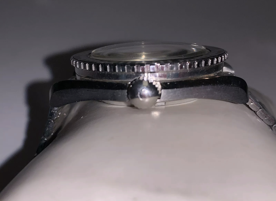

Yep. The case on that watch is El Fako. Sorry. 🙁
Why do you say that? Service cases have noticeably different lugs/profiles than OG cases, so I'm not gonna call it a fake because the case doesn't match the service pic, that's to be expected. This also clearly has polished lugs. But that said, It looks pretty close to an OG HF case to me (note the comparison pics have some overpolished lugs).
This auction:
Comparison HF (look at lug on right, not left which is overpolished):
This watch: s-l1600.jpg
HF comp:
Front view:
HF:
5,631
5,815
Because experience. You believe what you want, not like I care. Shared my opinion, and I am not going to argue with you or anyone else because I am not getting paid to argue. 😀

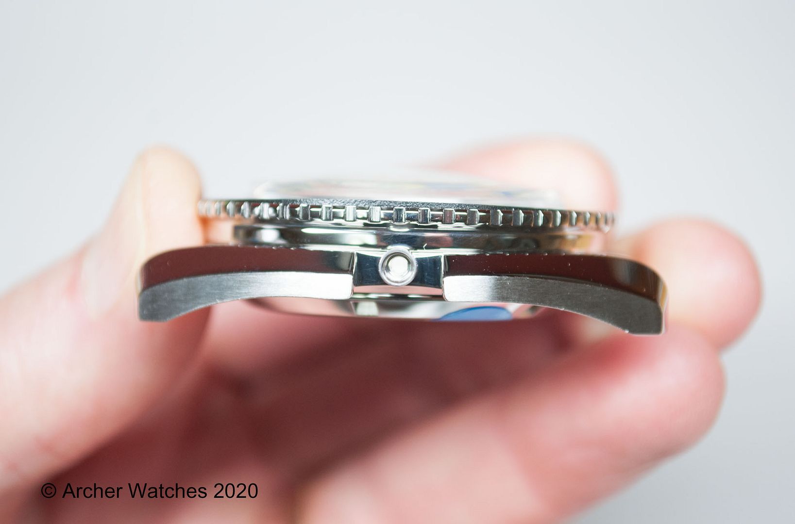

@whats_shakin
Your comparison here is inaccurate.
You are comparing the case shapes of two 165.024 from 1967. to a 166024 from late 1969.
(Both of them mine by the way. These are images from my original post. And both watches are 100% unpolished).
Two different references, two different case shapes.
You should be comparing the watch to this 166024
