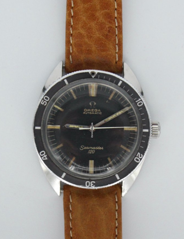

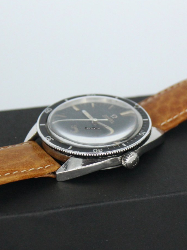

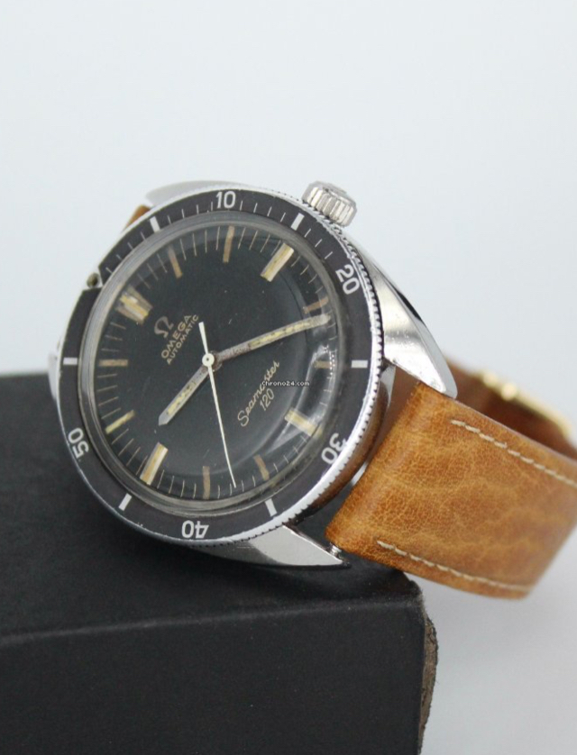

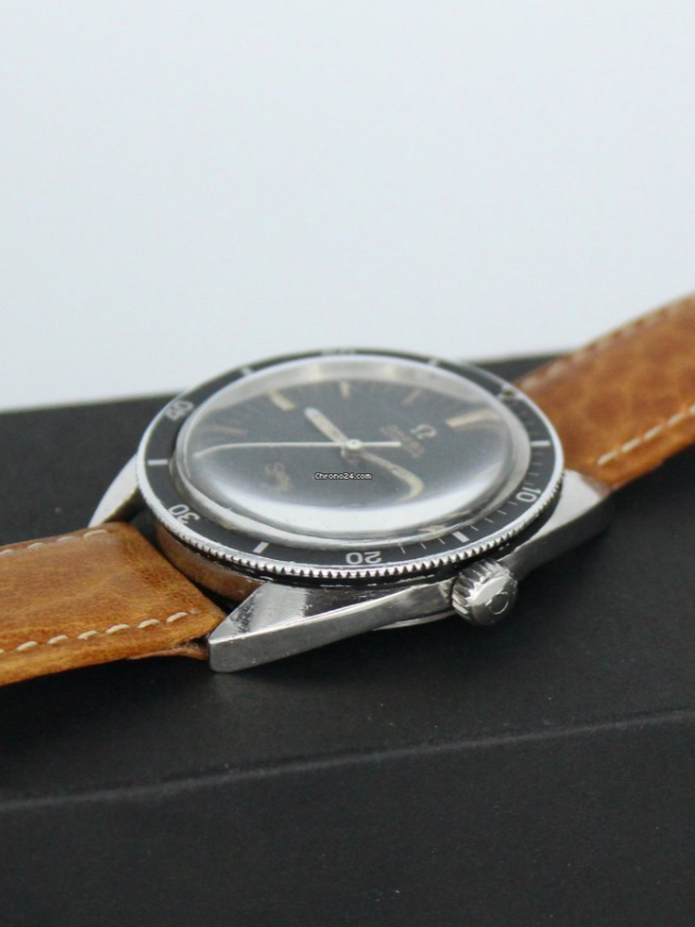

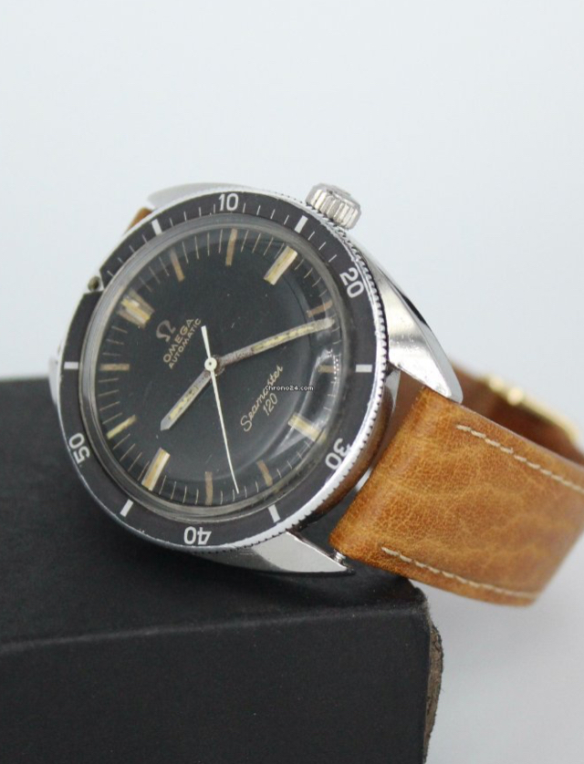

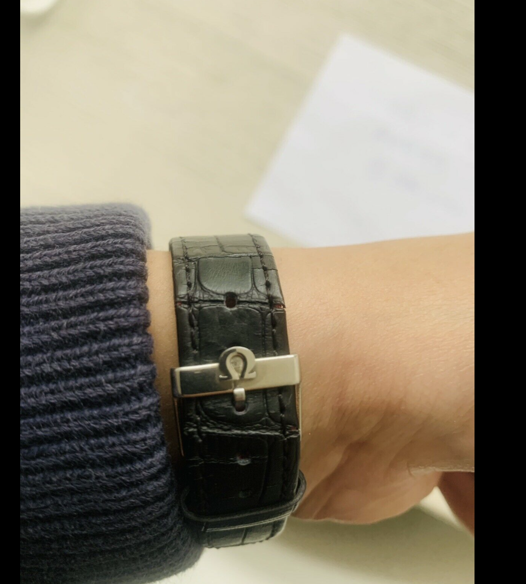

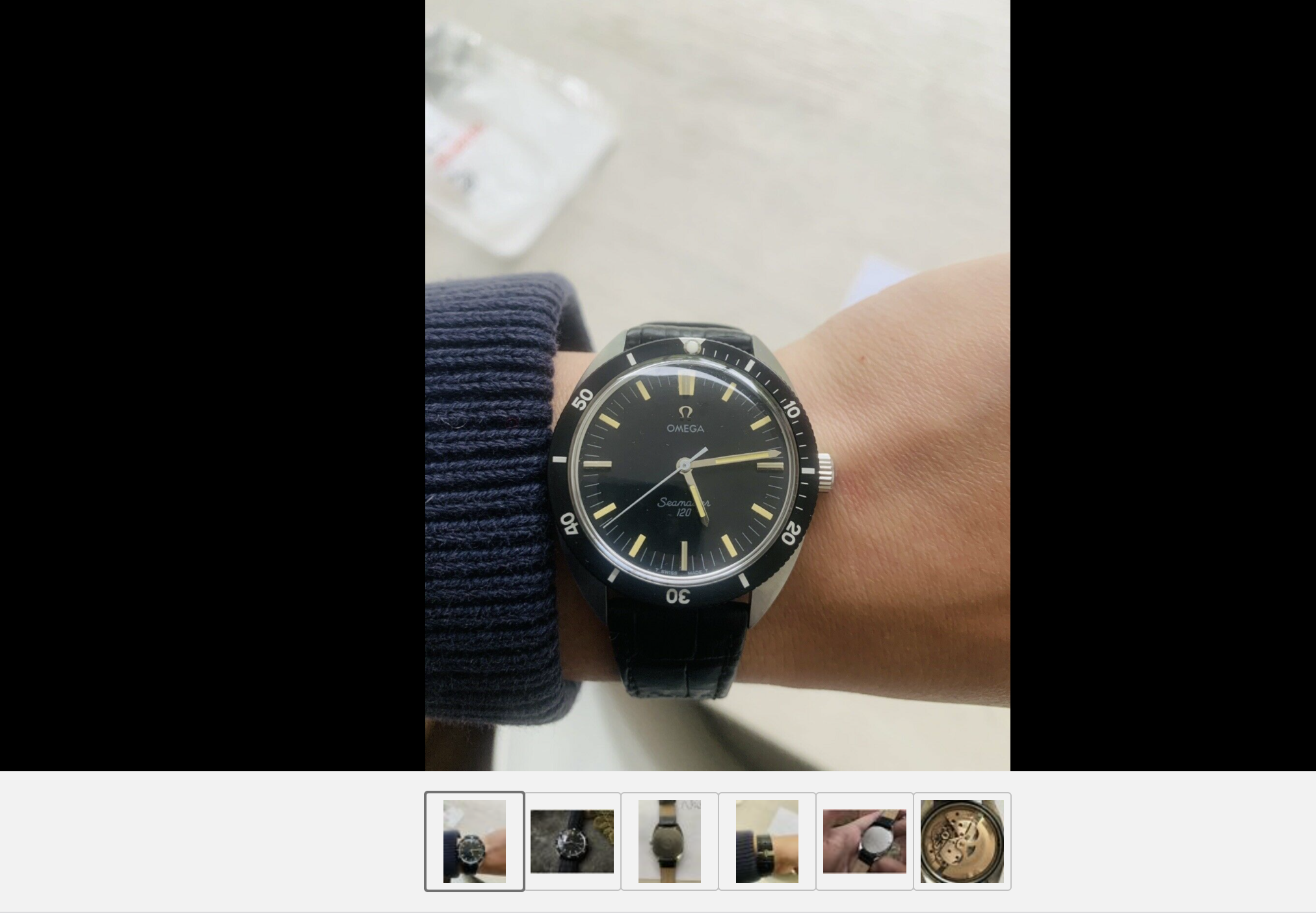

Hello everyone, new to the forum. I posted a reply to the other thread re early seamaster divers and what to look for, but j didn’t get any feedback. I figured I’d give this thread a shot. I have one for y’all. From what I’ve can see it all looks right, dial print is not quite white but also not grey… case bezel, dial and hands look right to me… thoughts?

To me this looks correct.
Feels like an honest, well-used, example.
But these really are a jungle.
I quite like the model, but with so many iffy examples around, I've just tried to stay clear over the years.
3
thanks for your take on this… I agree, it certainly is a minefield with these….but they do have a certain charm….

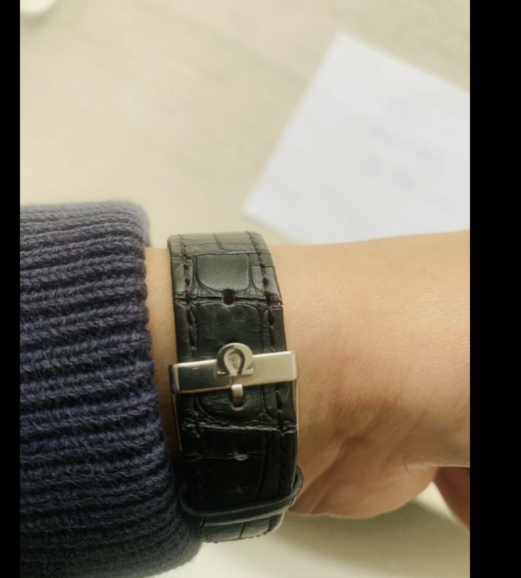

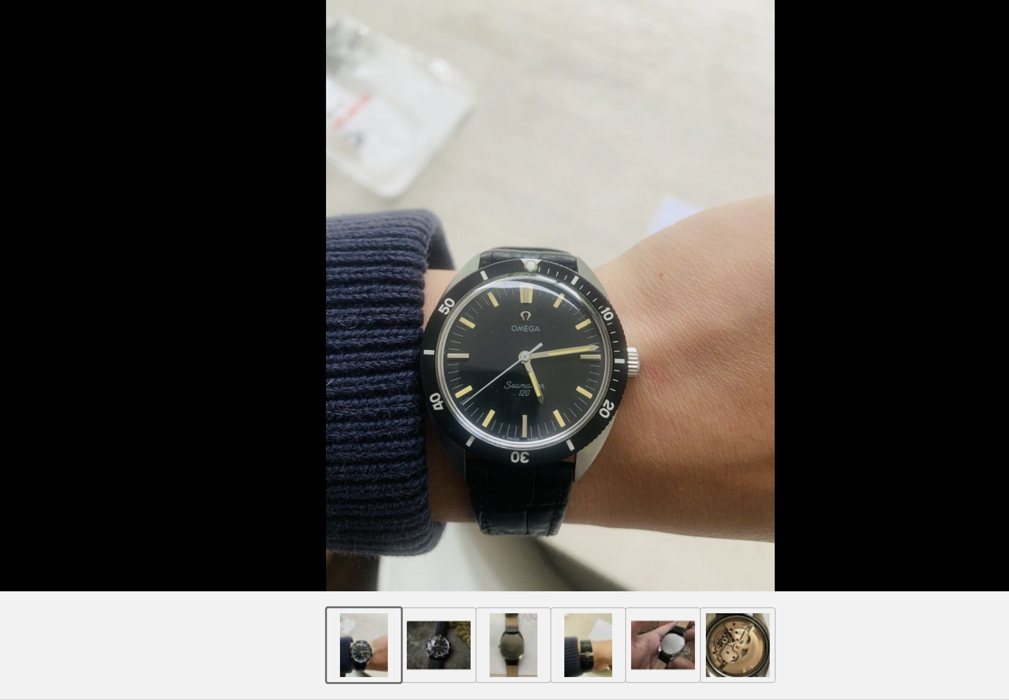

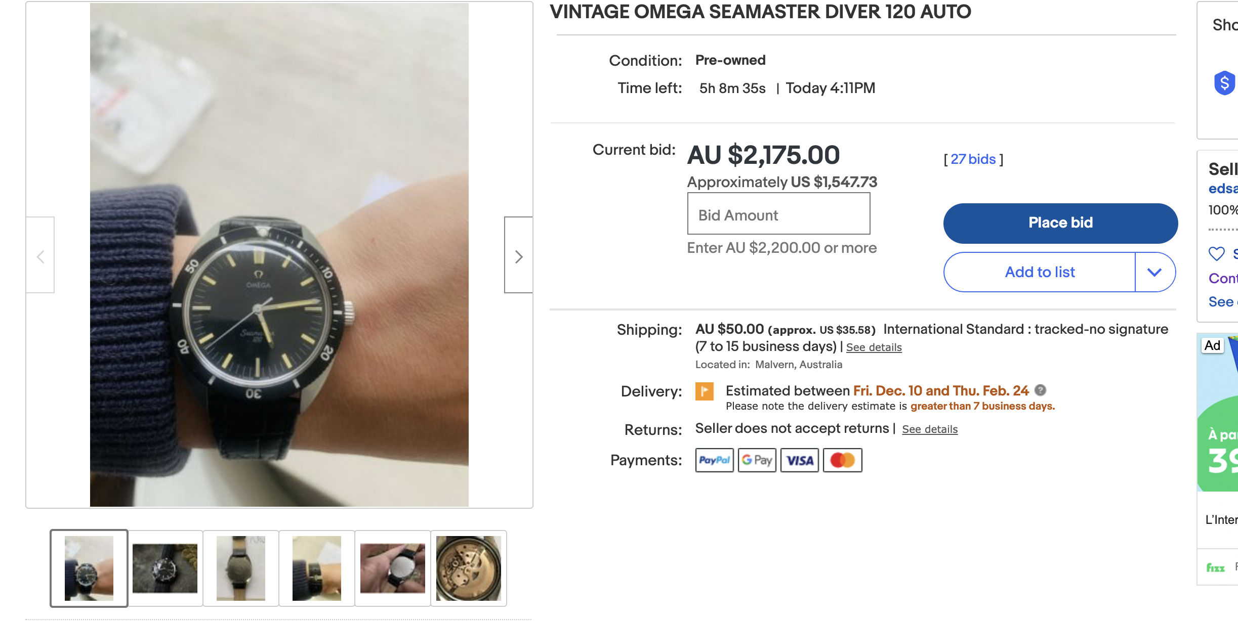

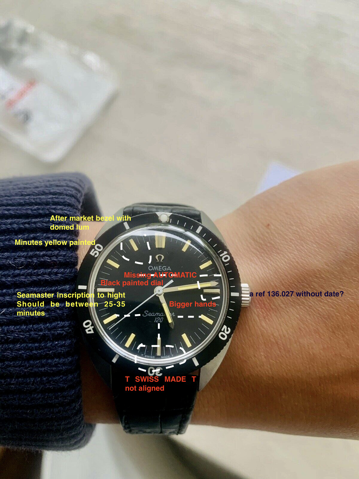

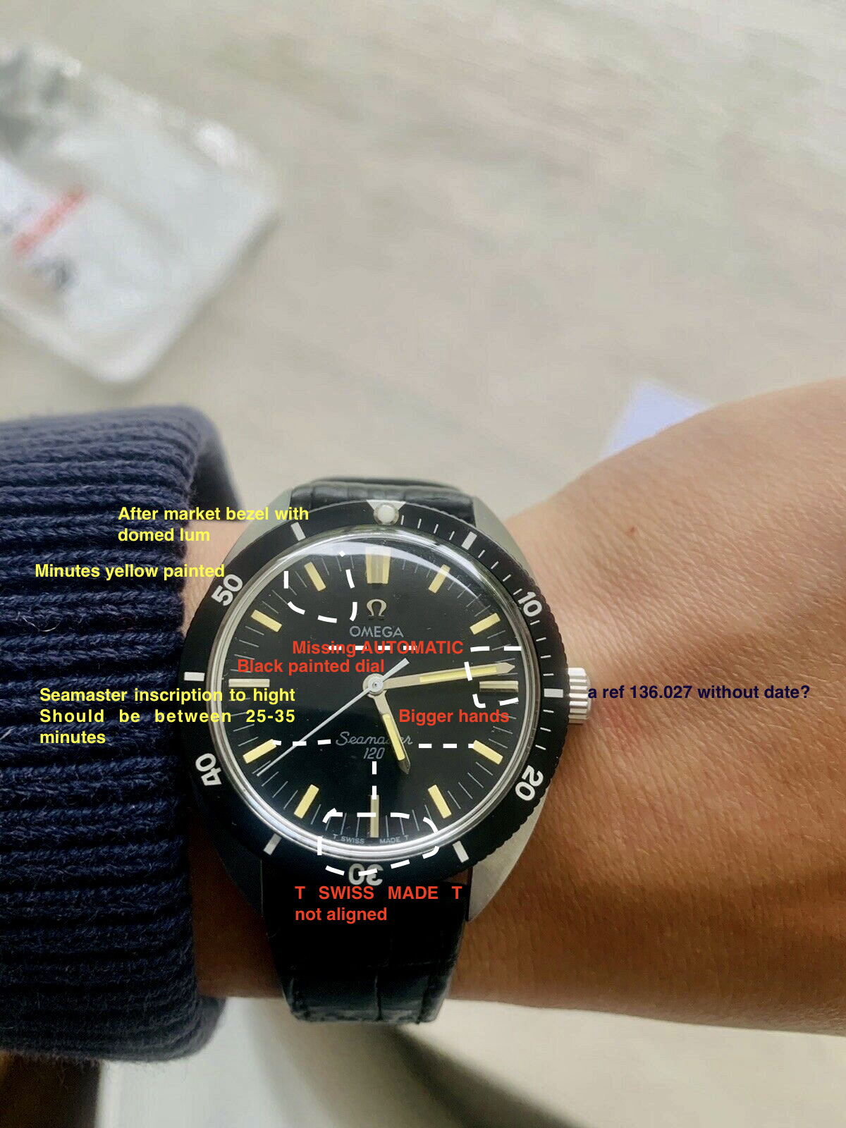

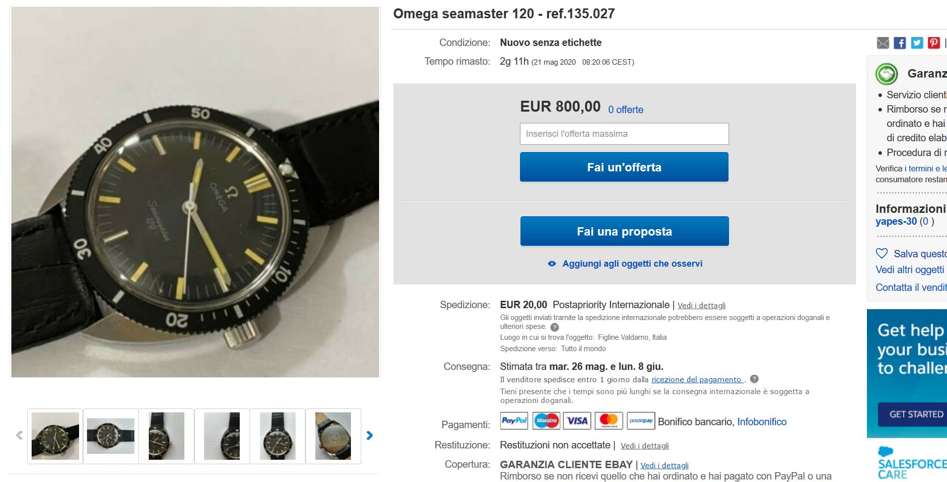

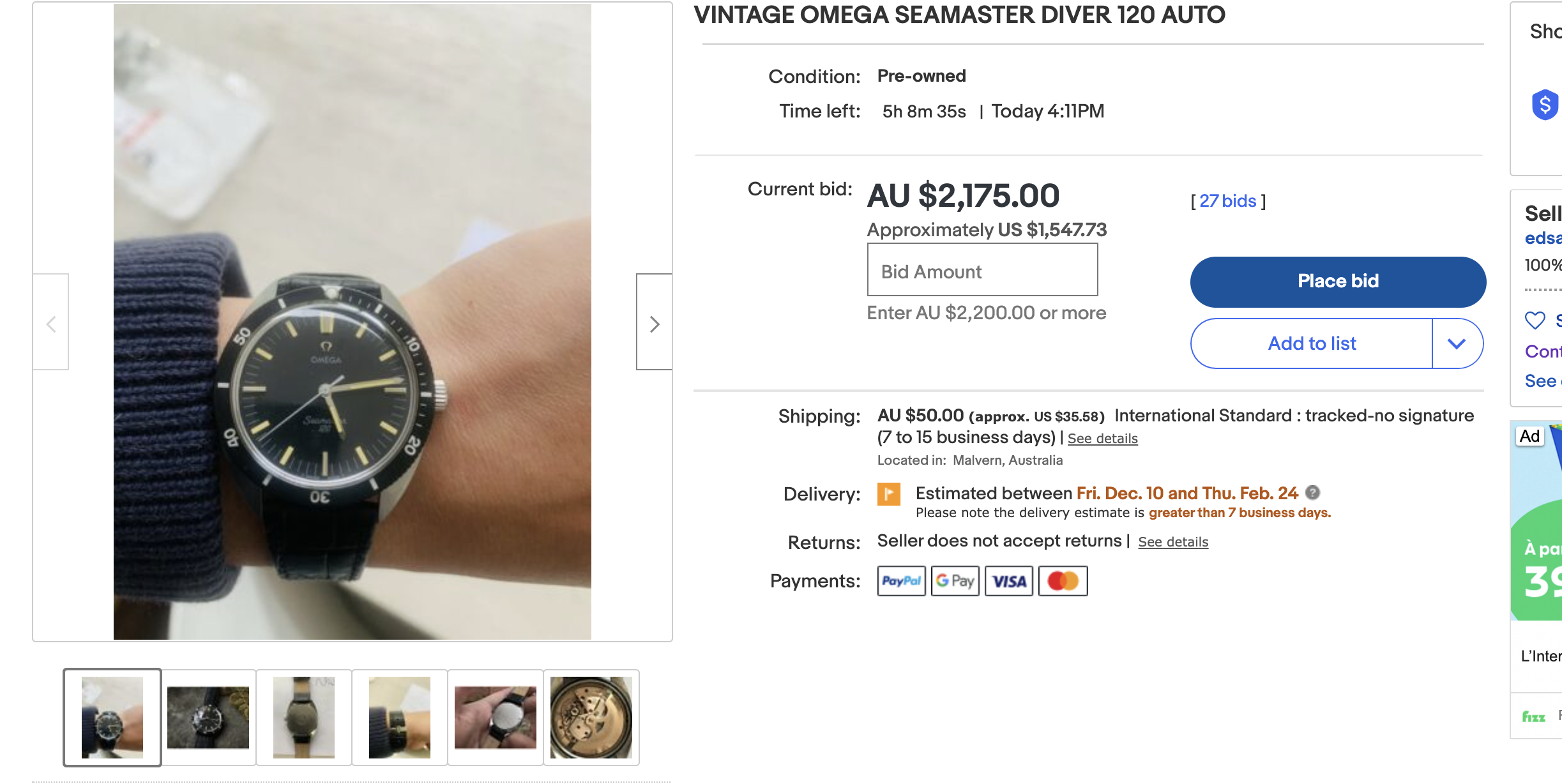

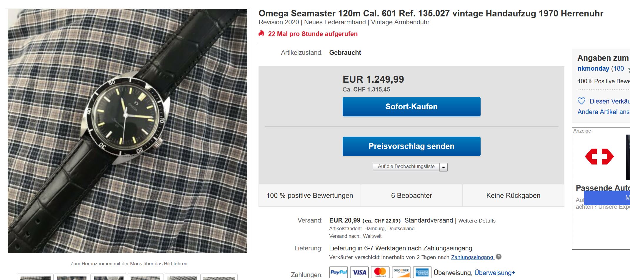

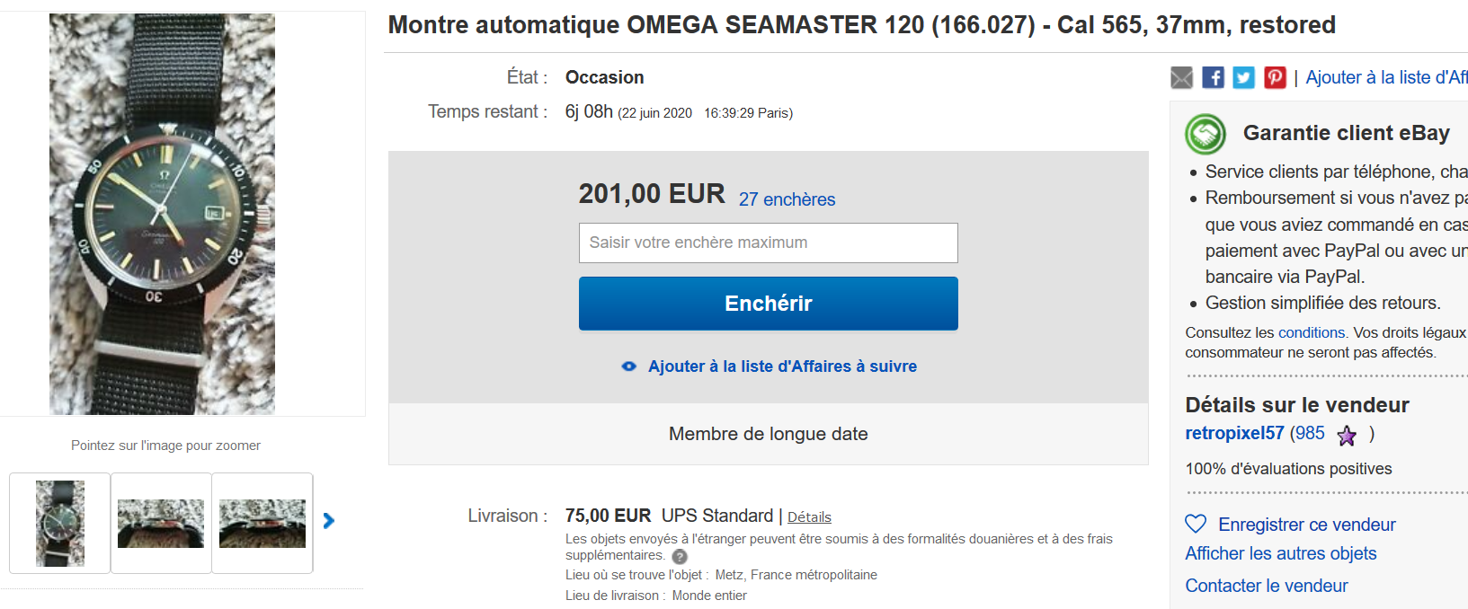

Here is one on EBAY for sale....top buyer will pay a good price for this fake. Automatic 565 mov but a dial without AUTOMATIC inscription, Bezel, Hands, painted minutes...all fake.
https://www.ebay.com/itm/194538004147
23
4

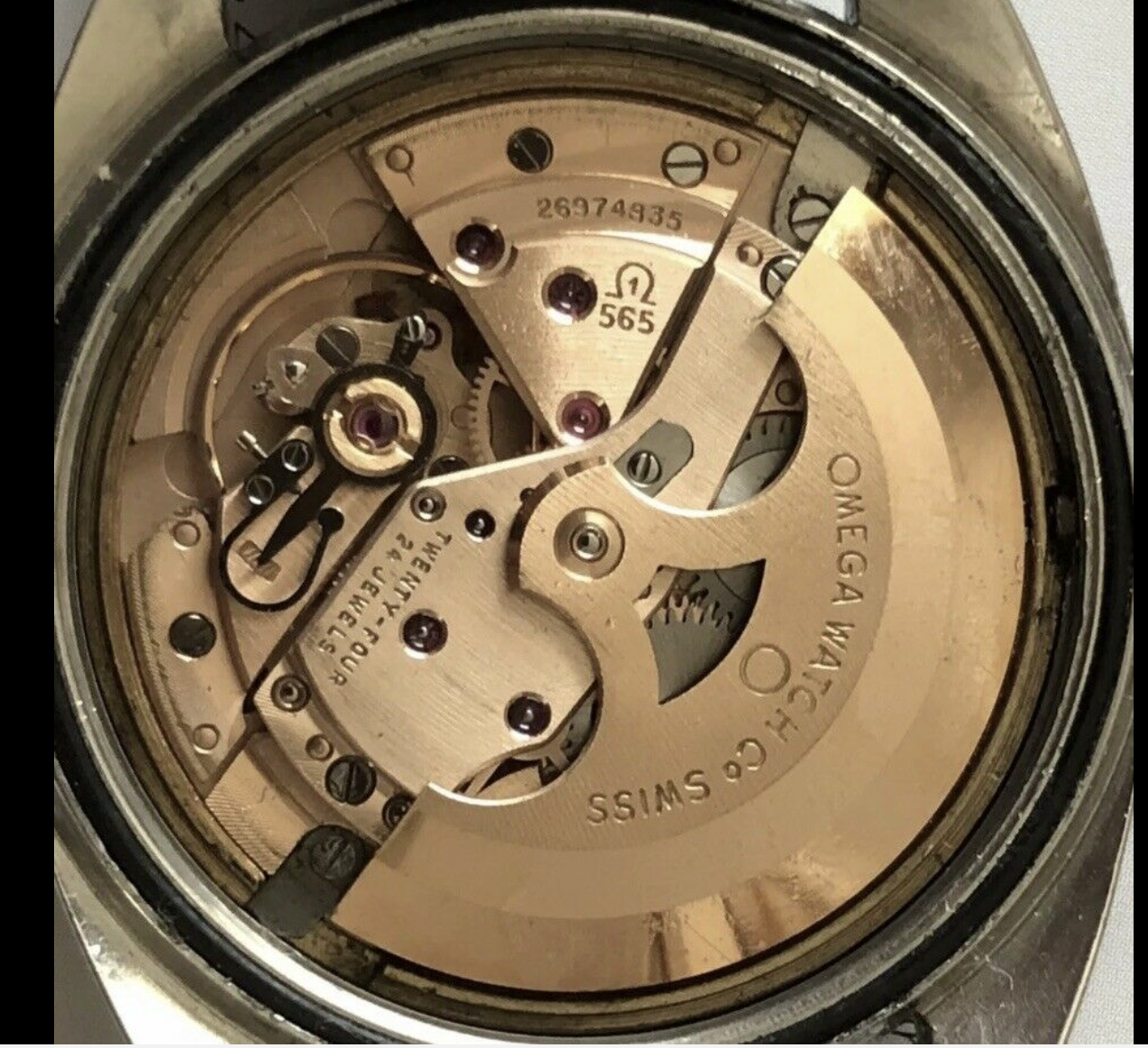

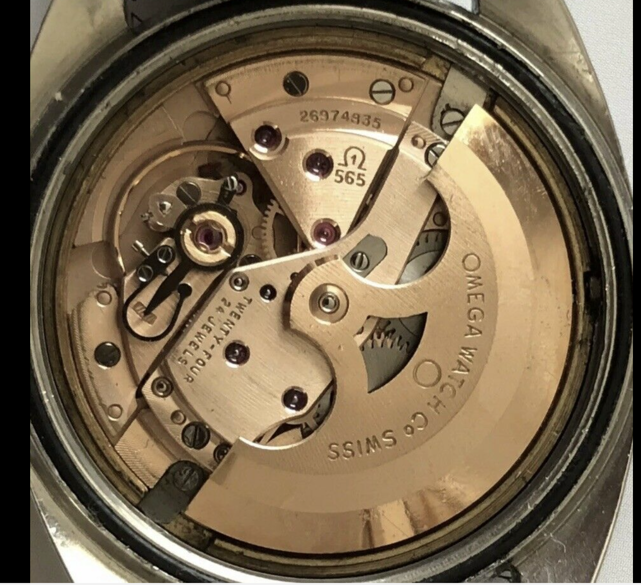

The 15 mistakes dial....this watch has under the dial a Cal. 565 automatic movement with a Ref.136.027.

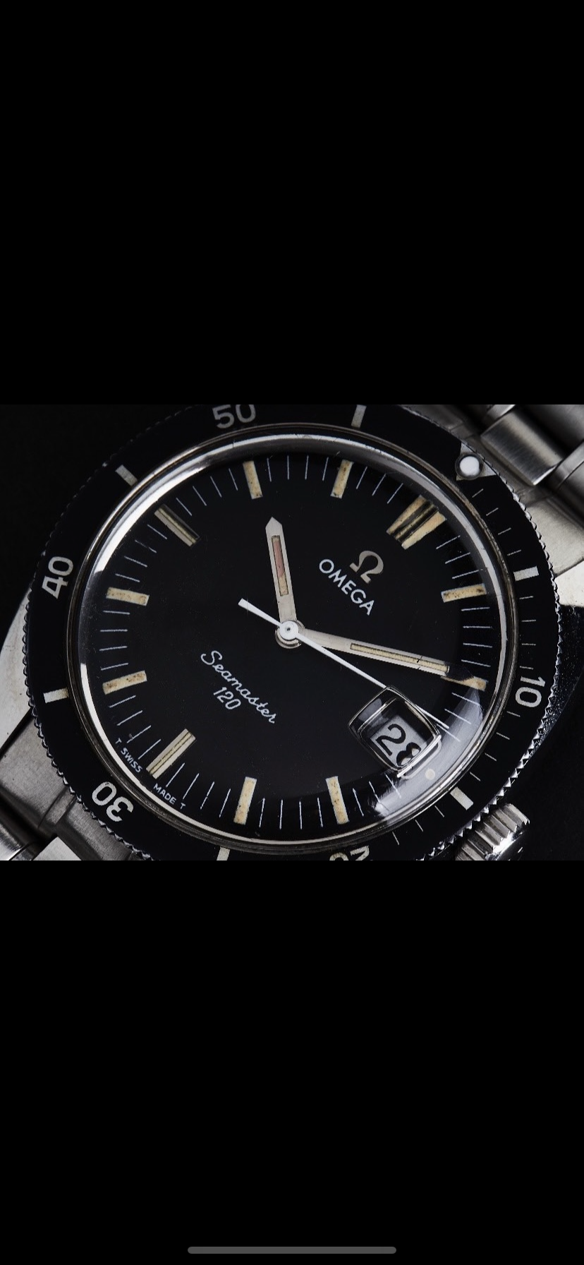

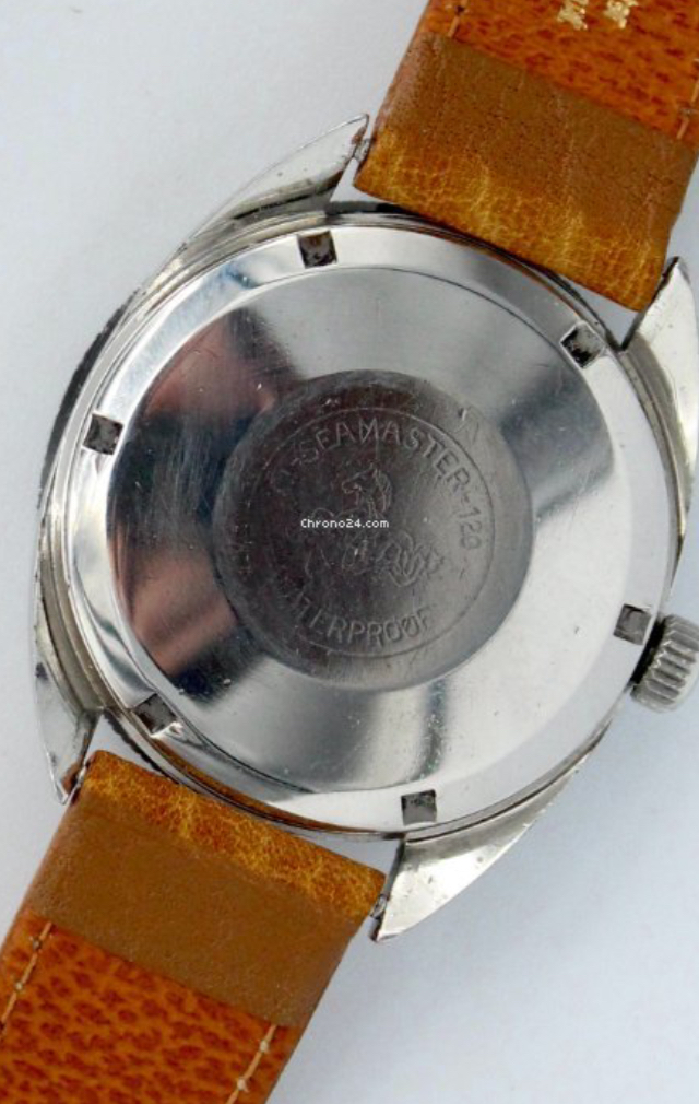

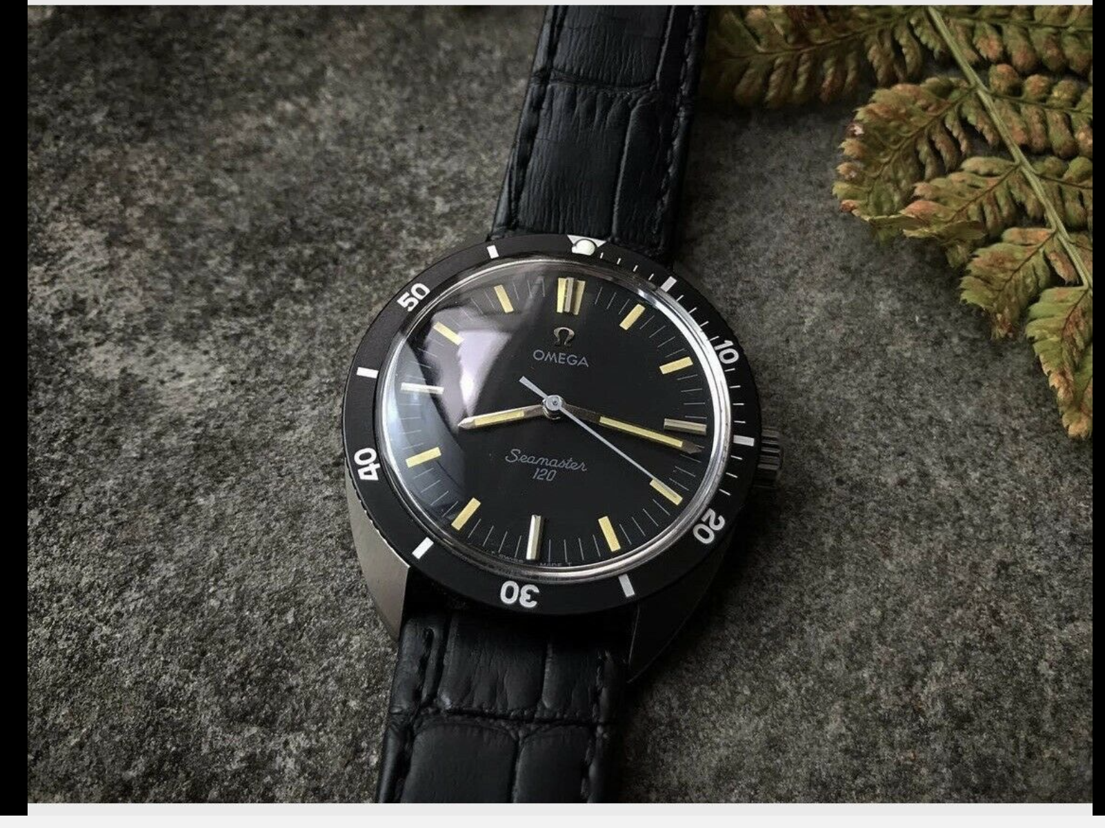

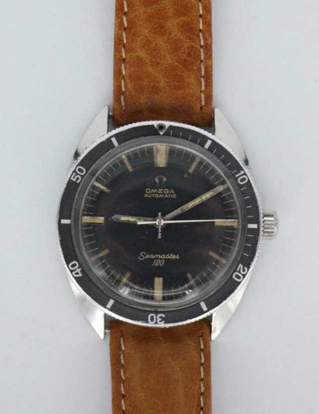

7

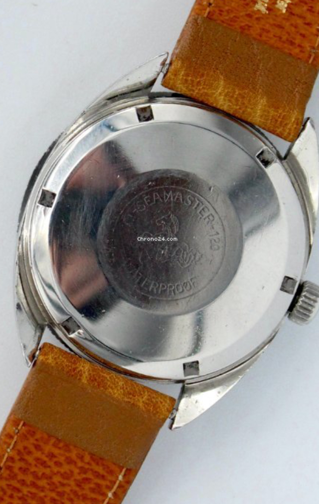

Dial, hand and bezel ok
Glas with magnifier ok
Polished case
Service caseback
Later 1125/560 bracelet
Not a bad one

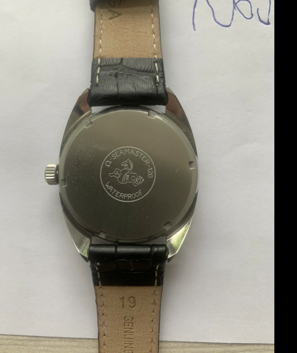

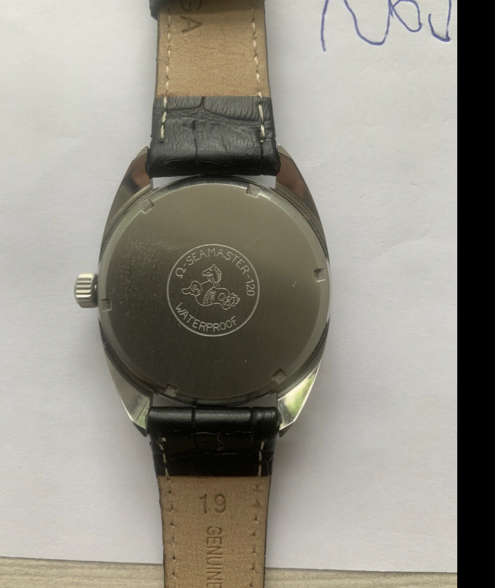

I’m confused I’ve always stayed away from ones with ‘pointed A’s on the case back? Yet now people are saying they are ‘service casebacks’ what is the correct case back? Does any of the ‘experts’ know #misinformation

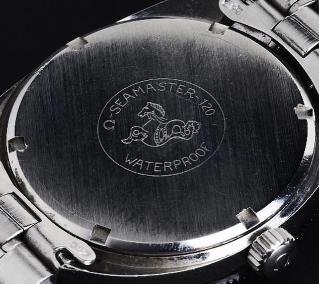

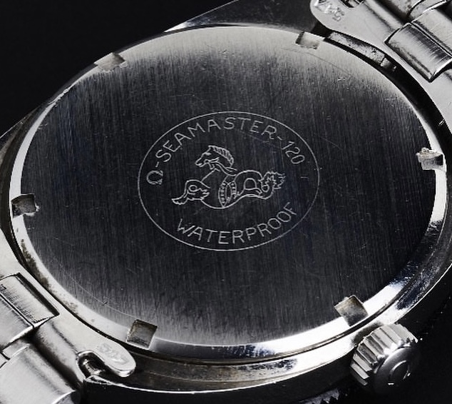

The new service cases had pointy A's on them...this case is 2019 production:
The shape of the cut out around the crown changed also:
Case back:
