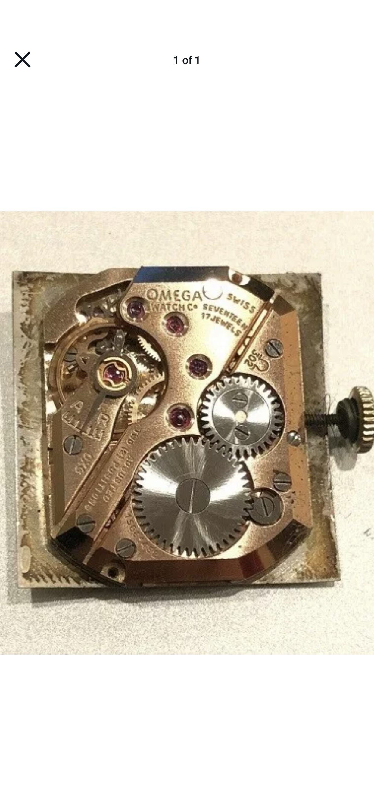

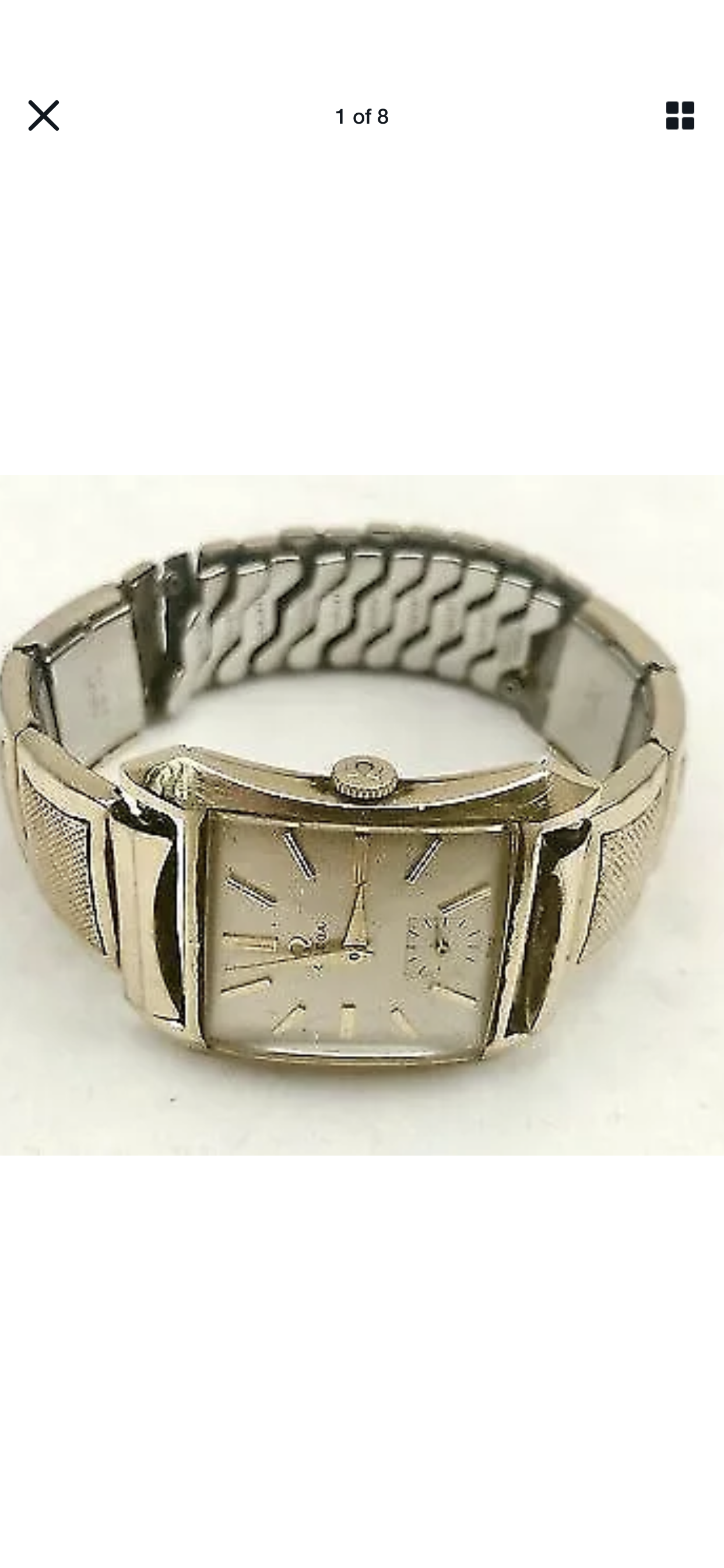

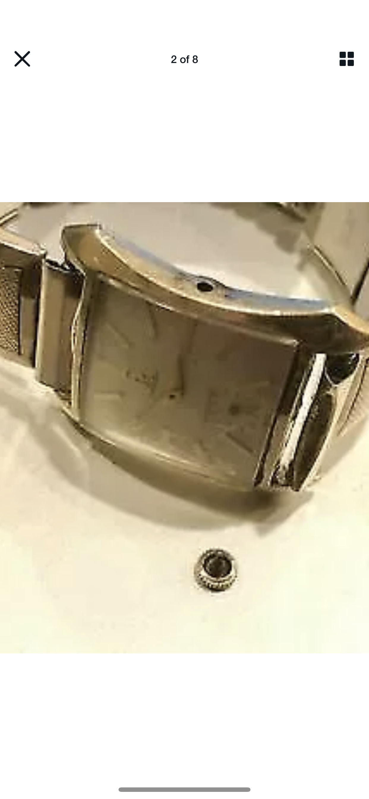

First question: I just purchased a vintage omega watch( I don’t know exactly which one it is so I will post pictures). The crown “broke off” according to the seller and the movement is reference 302. Is there somewhere I can look to find a stem and new crown or would I just have to send it into omega?
second question: looking at the pictures could anyone tell me anything about this watch? The seller had little info on it and I would like to know as much as possible about this watch? Pictures will be attached.

Nice looking watch Tom. Usually it’s the stem that breaks, although the stem is in the crown so if the bit in the crown can’t be extracted, then the whole thing needs to be replaced.
Give it a day or so for the resident experts on this era of Omega chime in- it’s Sunday and many don’t check their email or the web in the weekends. Plus many are on the other side of the globe.

Your watch is an American market watch dating to ca 1956/7.
Why not just let a watchmaker source the stem/crown, no doubt the movement needs servicing anyway. Any competent watchmaker familiar with vintages watches can do this, absolutely no need to send it to Omega.

It is a reference N-6258, 14K gold-filled, case made by Jonell.

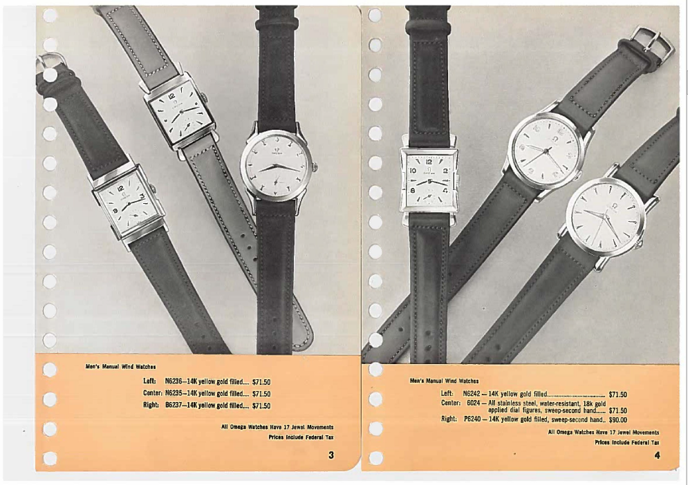

Below is an excerpt from a 1955 Omega catalog as published by Norman Morris Corp, their US importer in the mid-1950s. The model N6242 on the right is similar to your watch (though not exact) so you can see how it compares to a few other models from that time:
