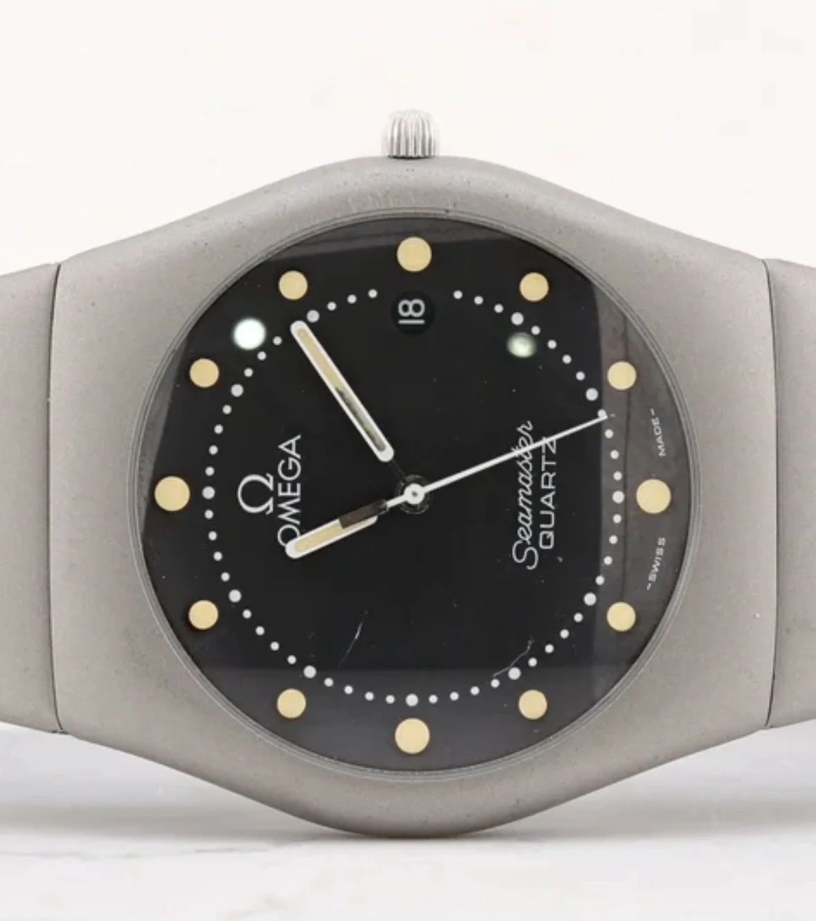

I've recently purchased an old Omega Seamaster 'Recife'.
The minute hand have lost some of its lumen, and I was wondering if it was possible to re-apply new lumen, while still keeping the correct "vintage" color like on the hour hand and indexes?
See attached picture of exact watch.

There is definitely an 'art' to the color matching. It is possible, but not easy. I've got a kit to do so, but find the 'lume' grains to be too big so it is not nearly as 'clean' of a lume as the factory stuff (it is obviously grainy?). And I bought one of the nicer 'kits'.
Bergeon has a kit for ~$100, but it doesn't have the dyes? But getting a 'right' color match is quite a bit trial/error, so expect to go through quite a lot if it 😁 I'd also suggest doing both of the hands at once, as the hands being different is OBVIOUS, and some level of hand vs dial difference is less noticable.

If you sent the watch to Omega for a restoration they would replace the hands, so re-luming your originals isn't blasphemy.
You can do it yourself if capable. Just use quality fine grain lume powder and colourants. Use an old set of hands to test colour as you mix each batch and note your quantities.

Perhaps consider doing both hands, not just the one that needs it. That way you don't end up with two hands with (slightly) different colours or one hand that glows in the dark and one that doesn't.
