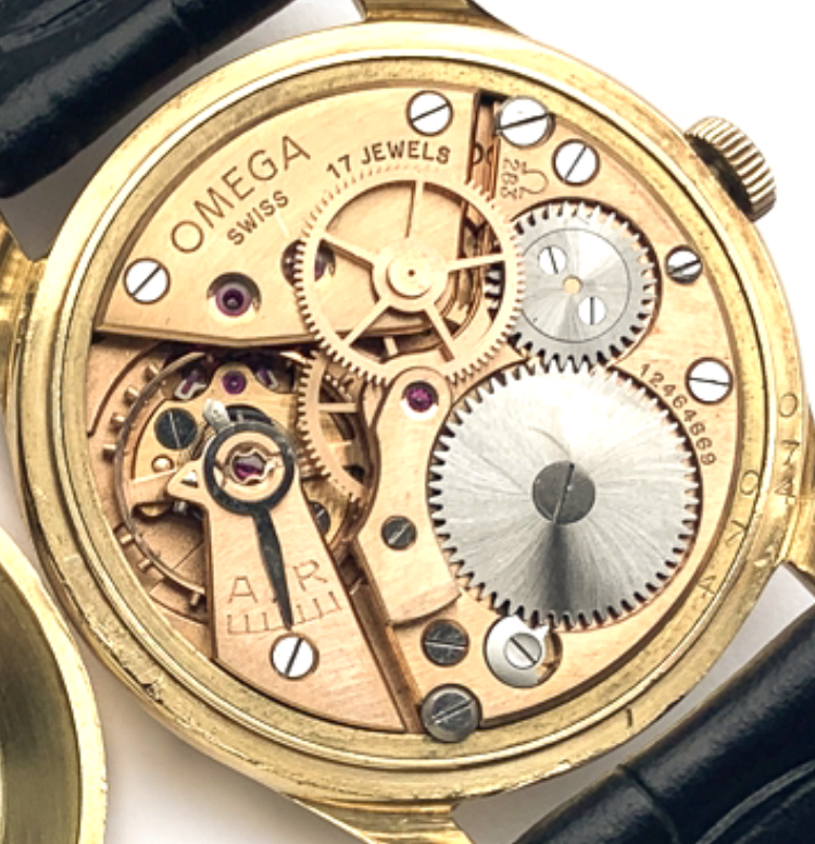

I don't think I've seen a cal 283 chronometer that I can recall. And obviously we can't believe anything written on the dial. Can you show a photo of the movement?

This is the shot from the dealer's marketing.
The dealer guarantees that the watch is all original on pain of a full refund for an unlimited period, if it turns out not to be.
Something is a little odd, though. Despite posting awful numbers on the timegrapher, the watch seems to be keeping quite good time OTW.

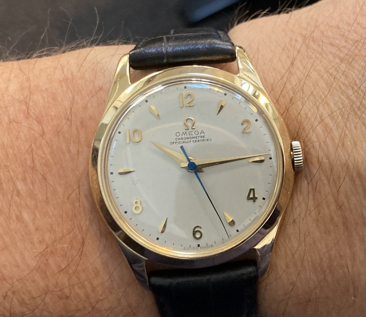

It was never a chronometer until the day the dial was repainted.

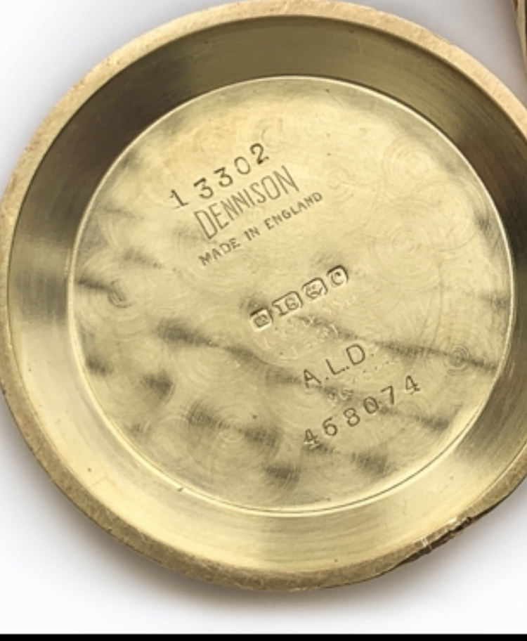

I would prefer to keep the dealer site out of the dialogue. But here is the case back. FWIW I didn’t pay a premium for it being a chronometer.

A repainted dial no longer qualifies this as “all original.” Especially since it was repainted to something it never was to begin with.

An English cased watch by Dennison, so trying to reference against anything is difficult.
The bottom number is Dennison's internal serial number which ties the case parts together as they were pretty well hand fitted.
Dennison may have used the Omega numbering system for the top number which would indicate.
(1) Gents Watch
(3) Manual Winding Centre Second
(3) Non Water Resistant Chronometer
(02) Possibly ALD numbering.

So, contrary to the previous comment it IS a chronometer?
18,840
39,182
It houses a caliber 283, which is not chronometer rated.
My suggestion that Dennison may have used an Omega style for the top number is simply my suggestion, nothing more. Due to records for Dennison watches being hard to find, we shall probably never know.
If they did in fact use that system and they originally produced the watch as a chronometer, then the watch would not have had a caliber 283.

So are you saying that the movement and case don't match?
