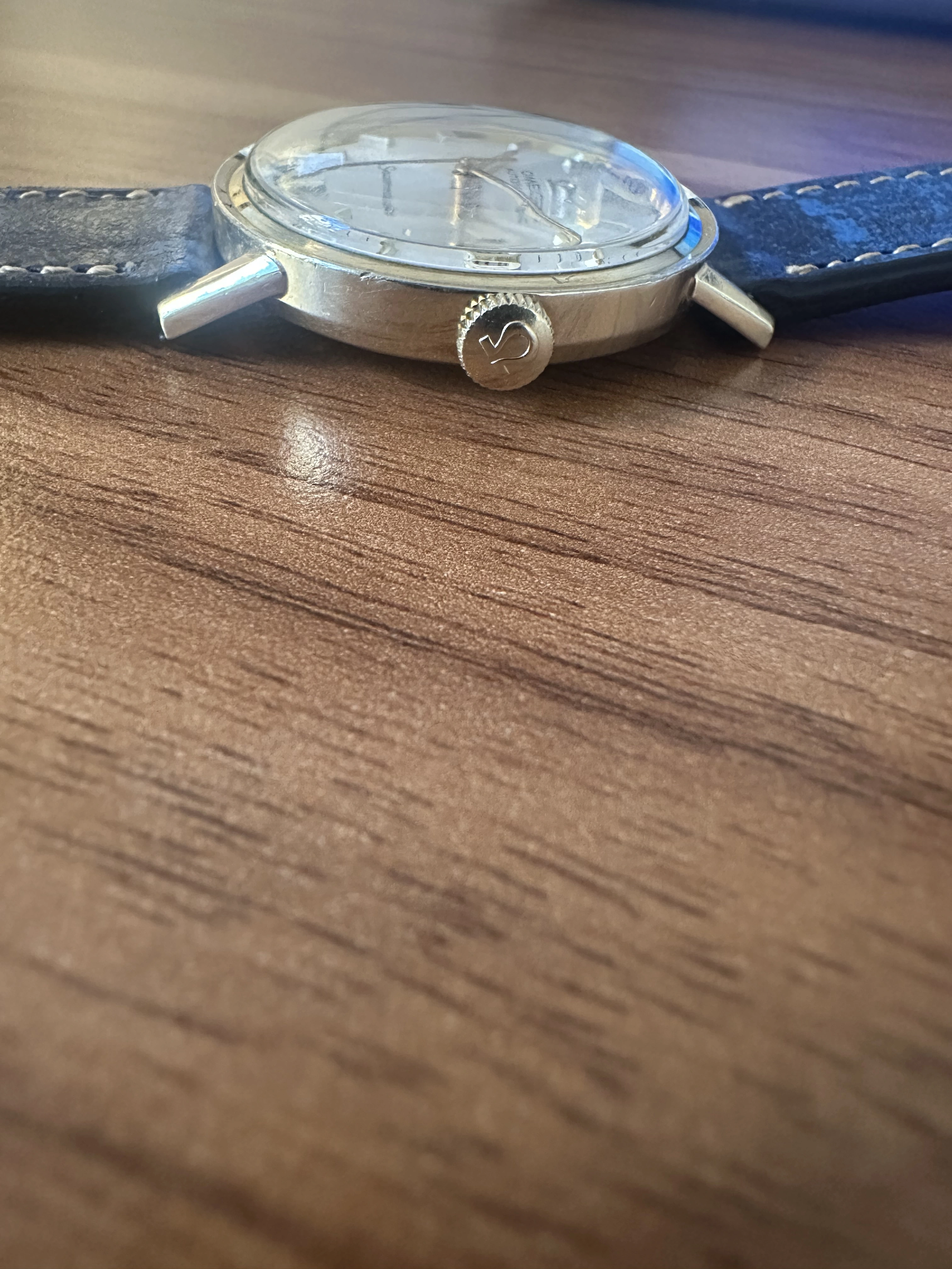

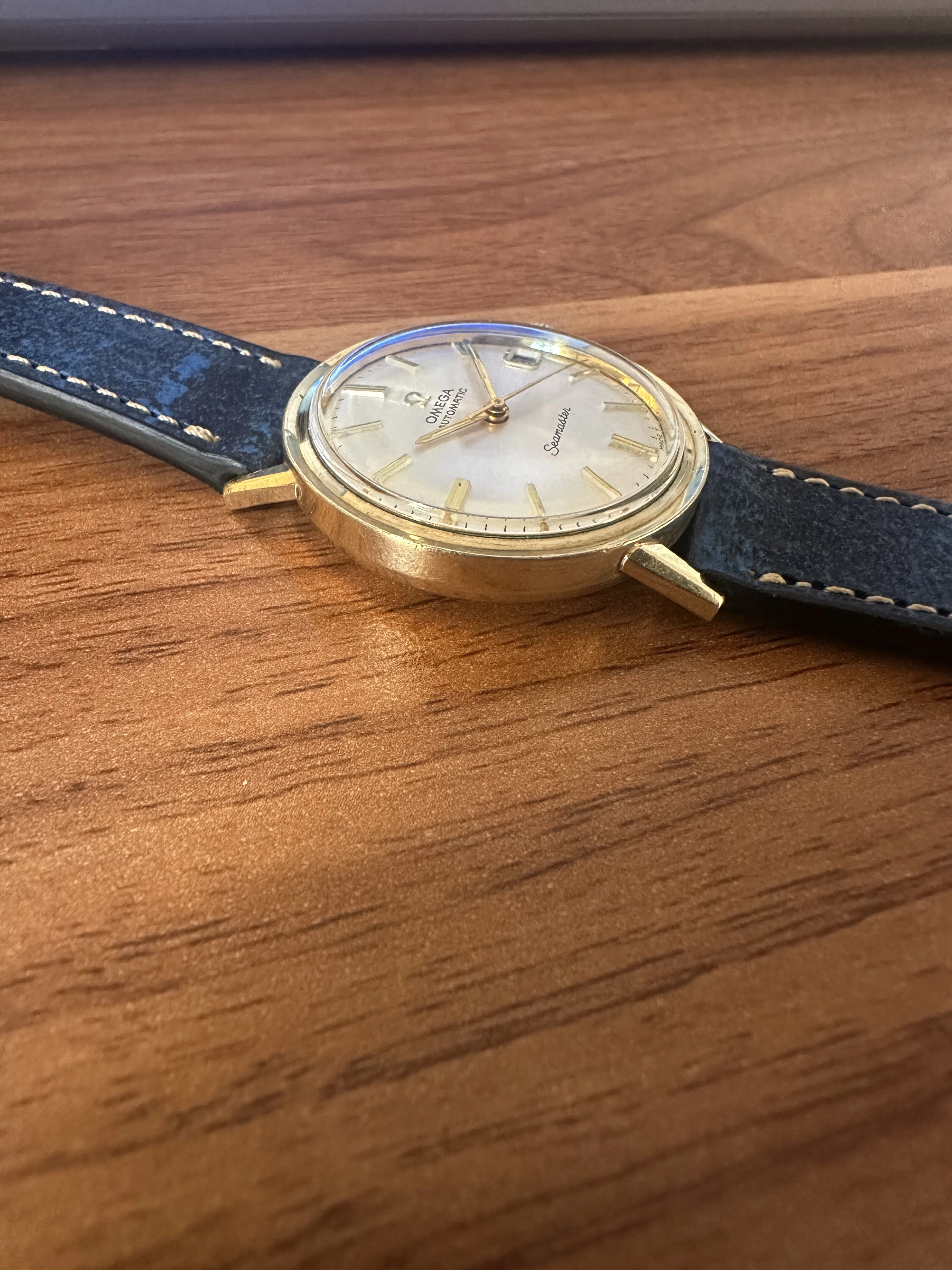

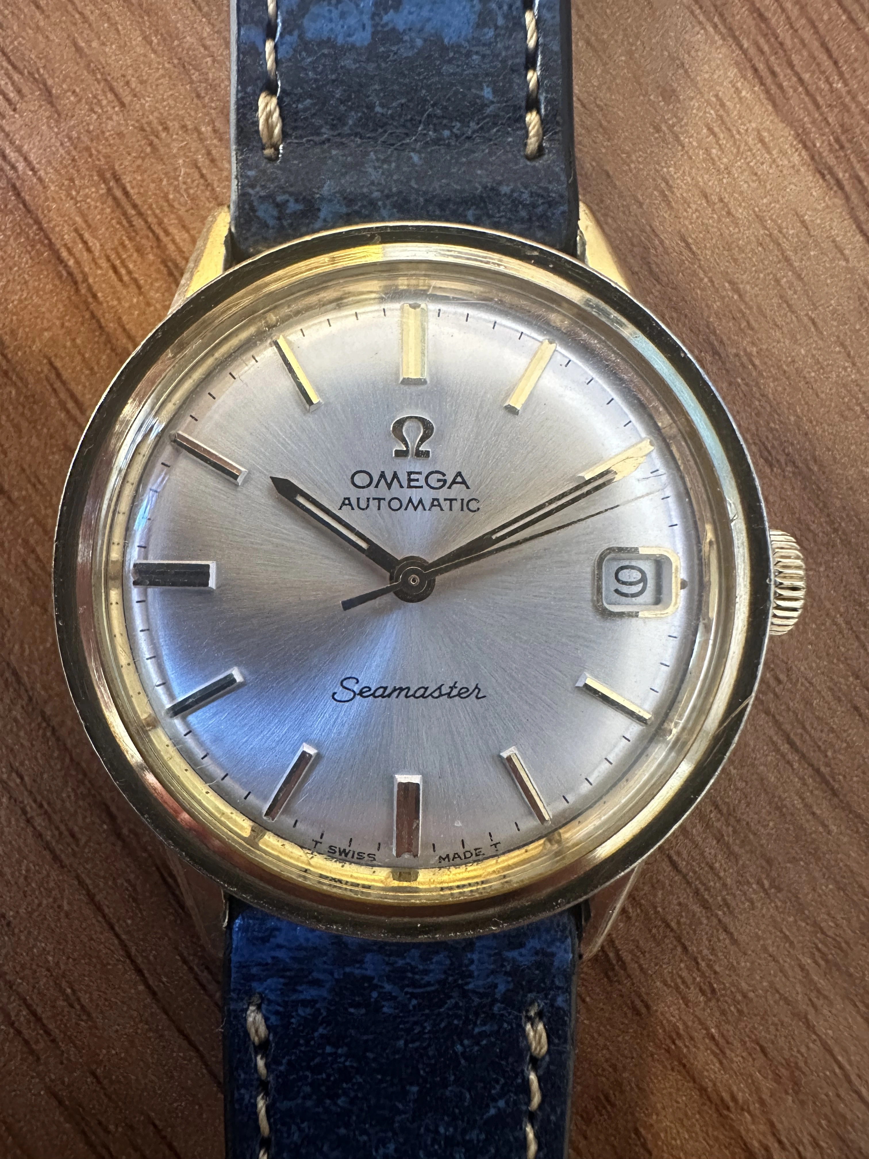

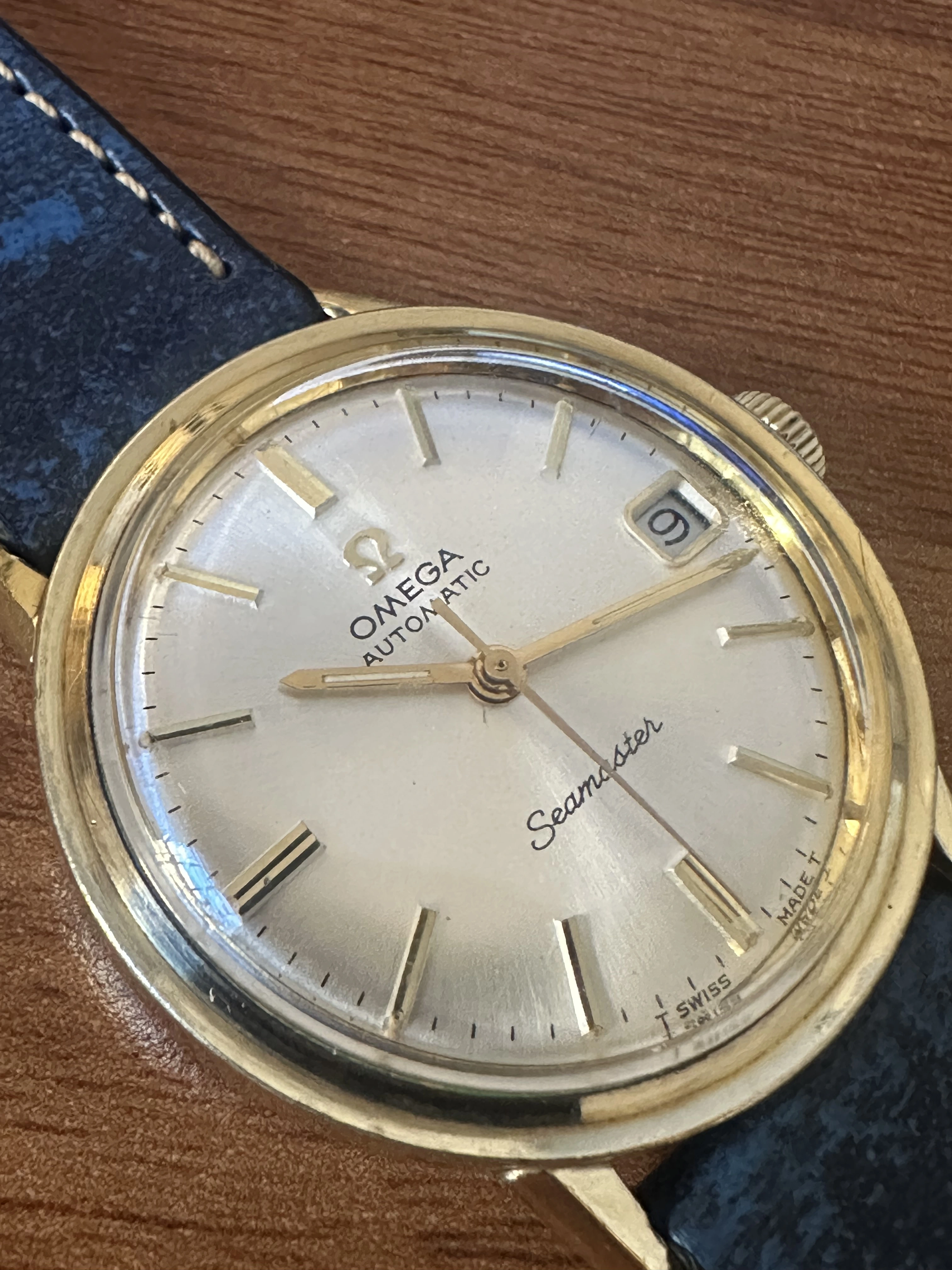

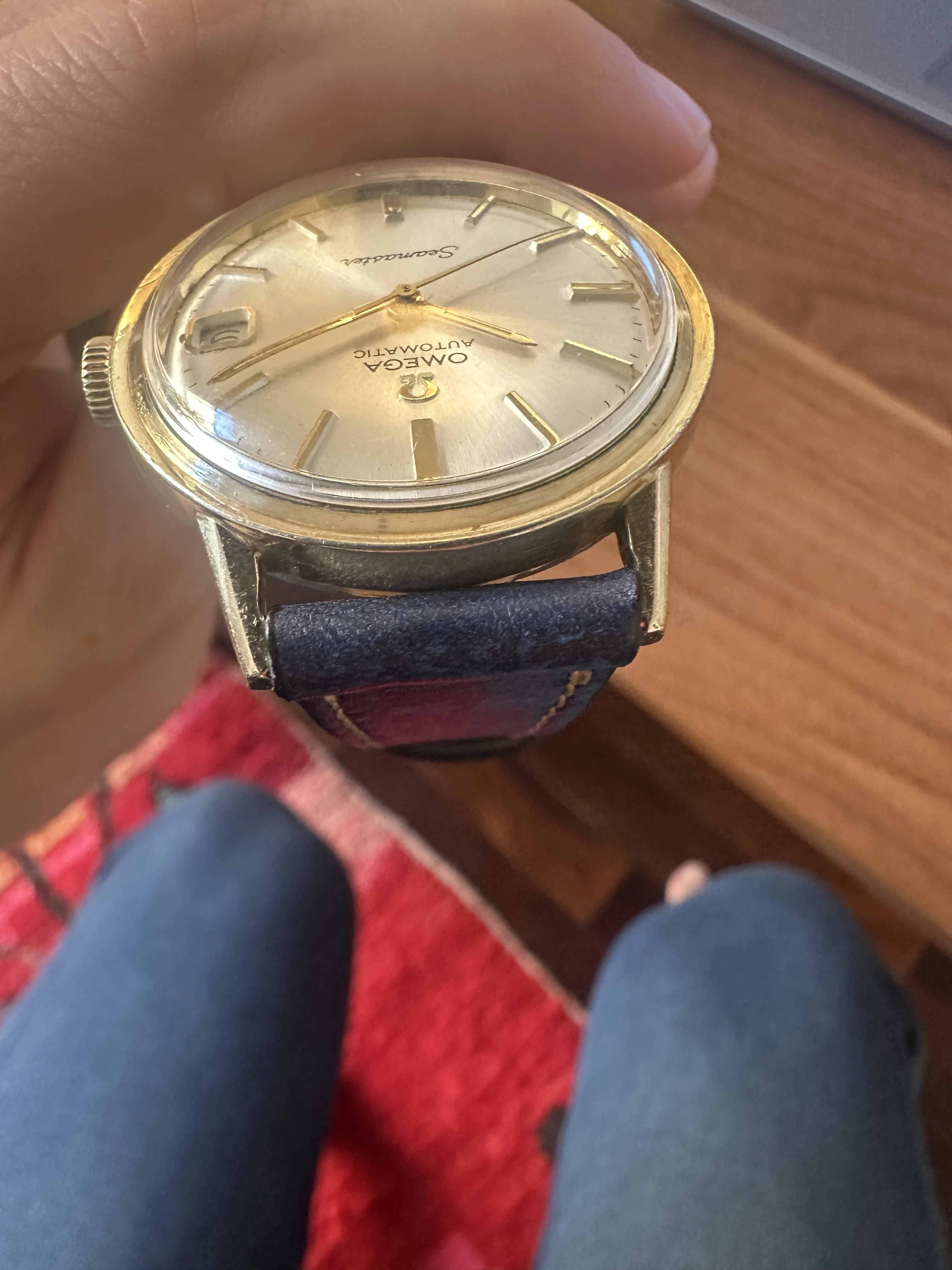

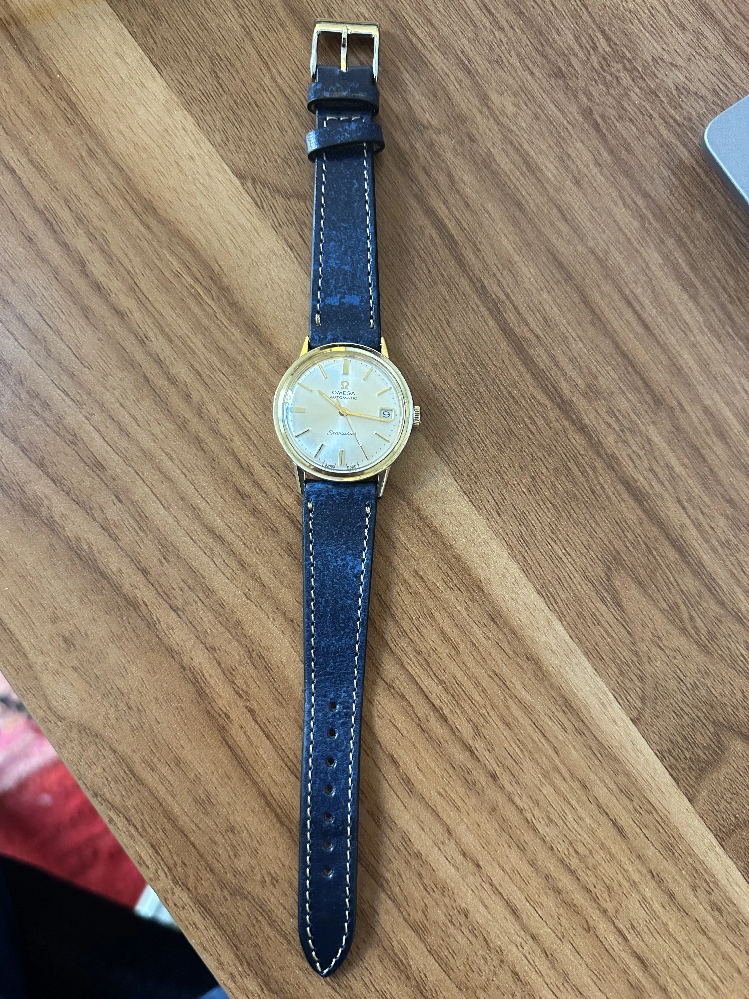

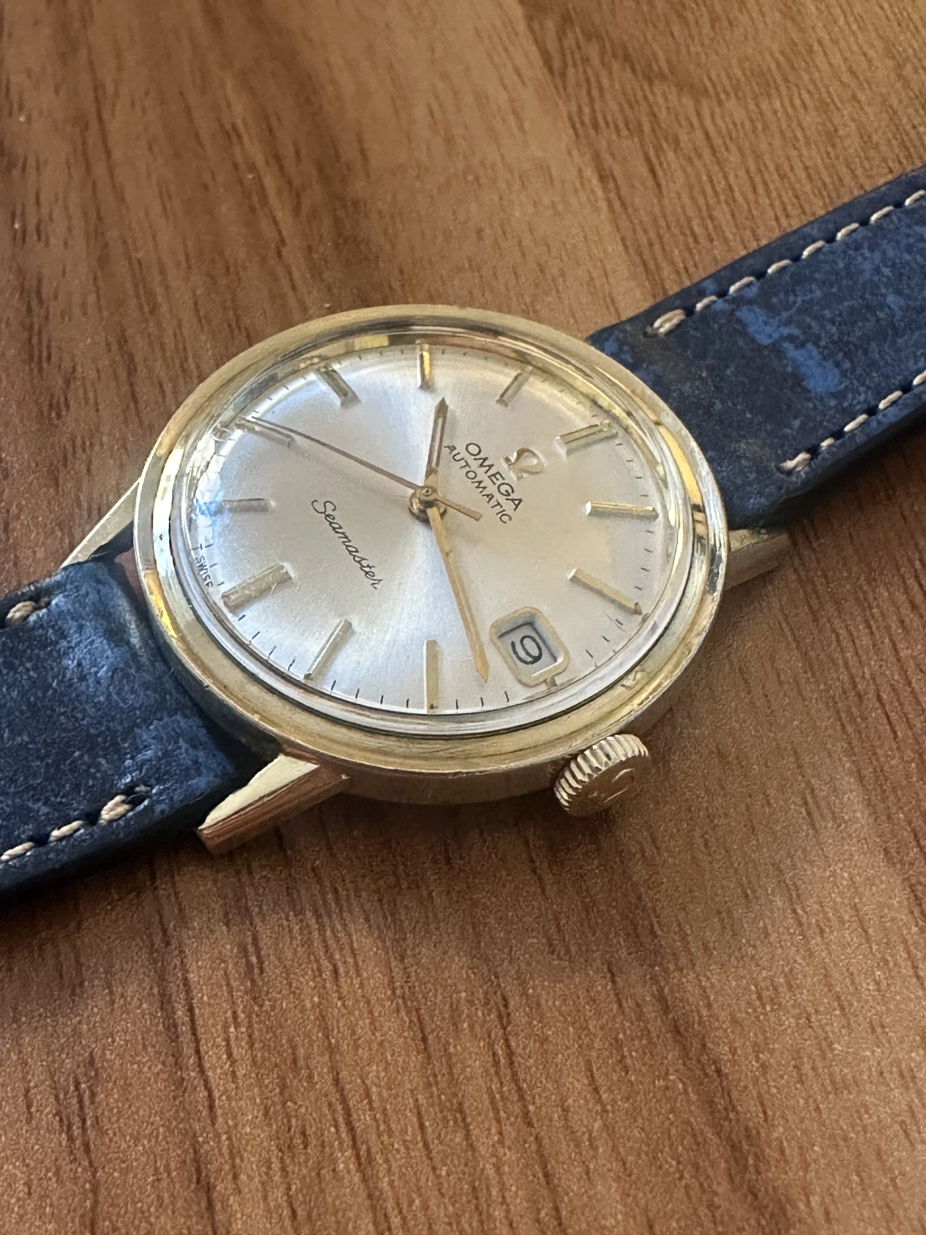

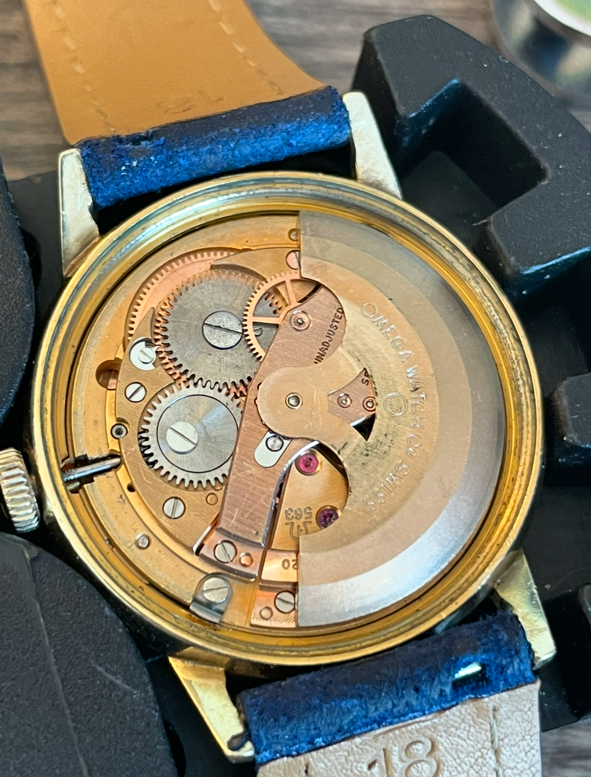

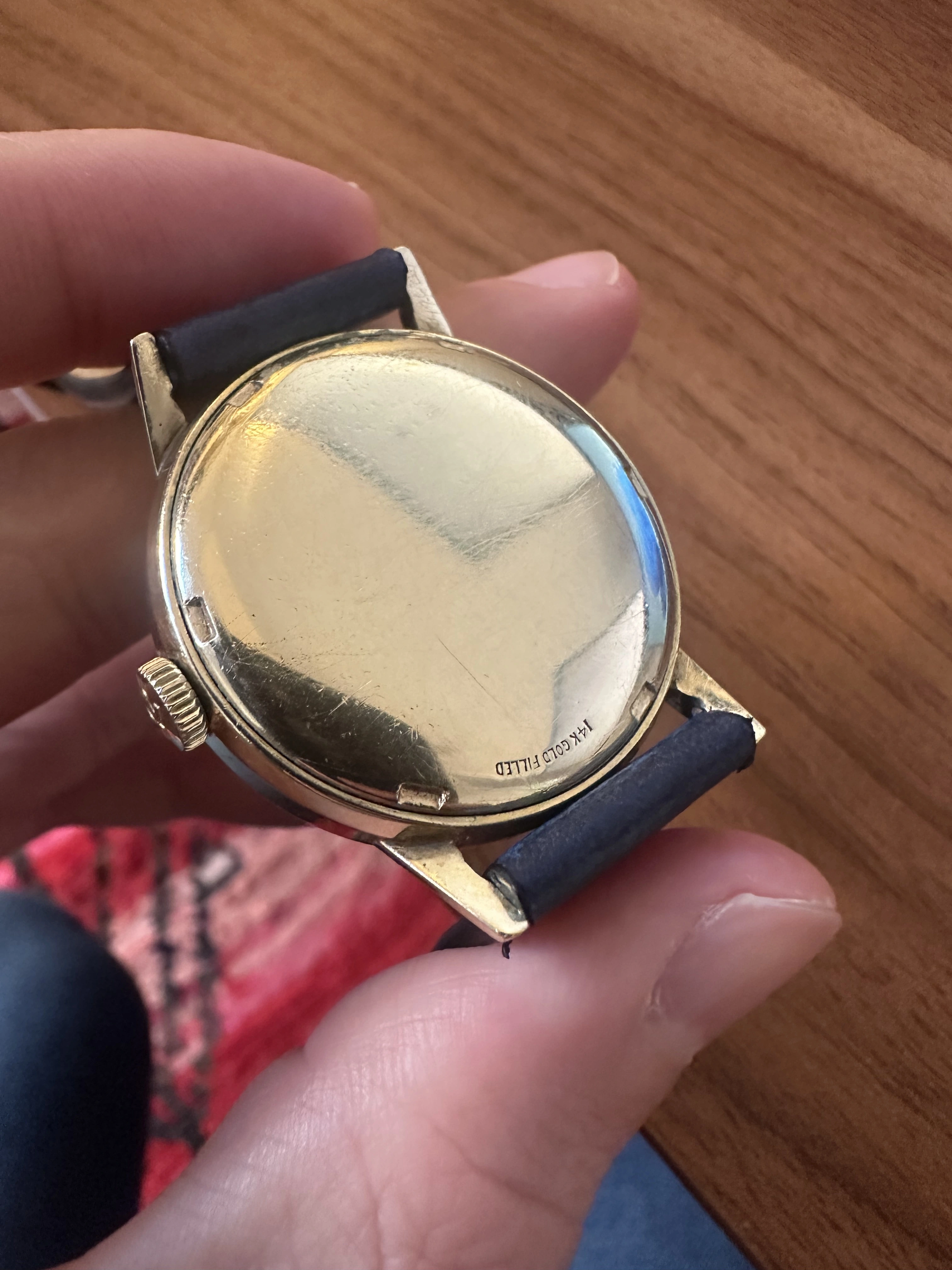

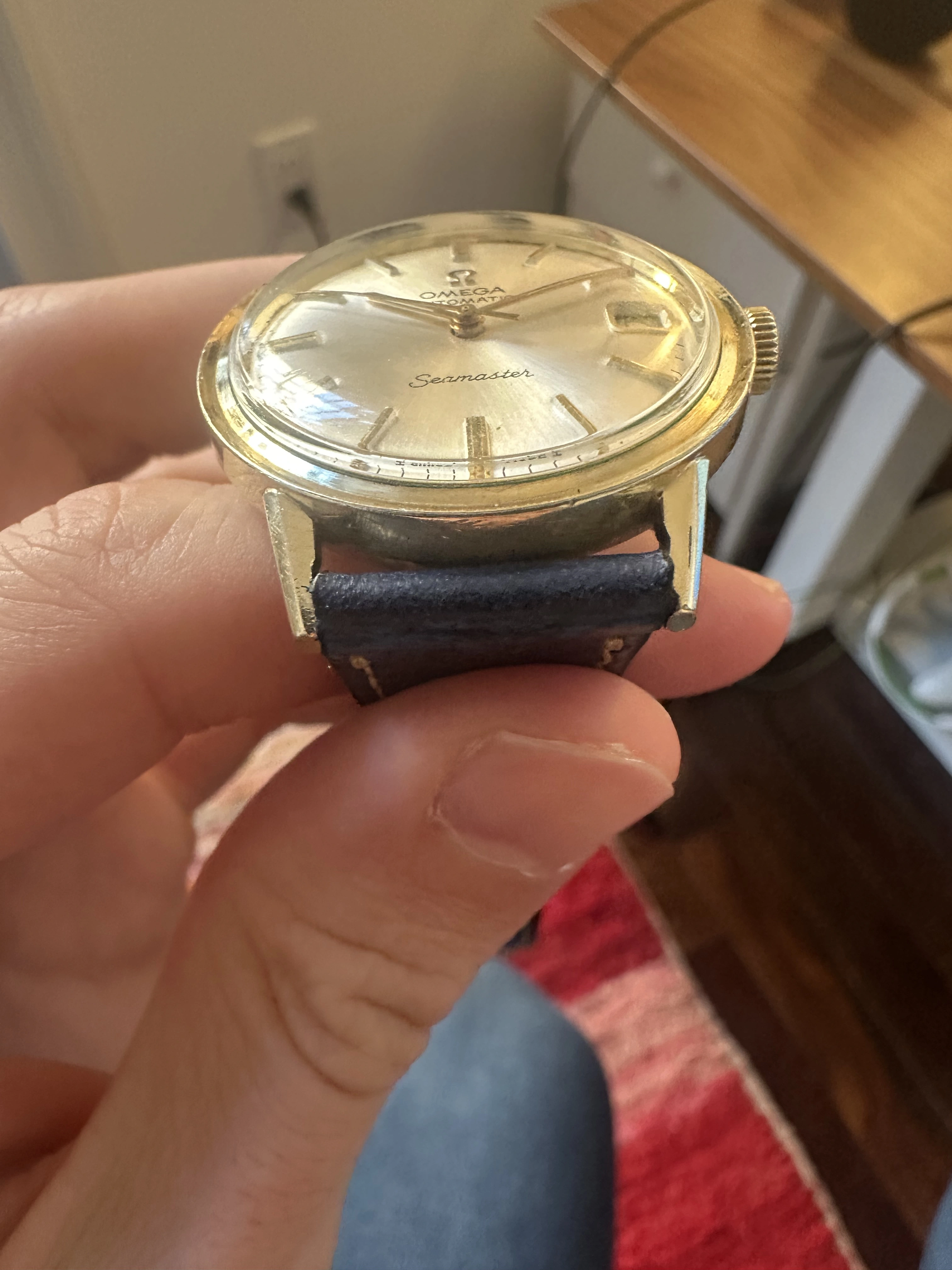

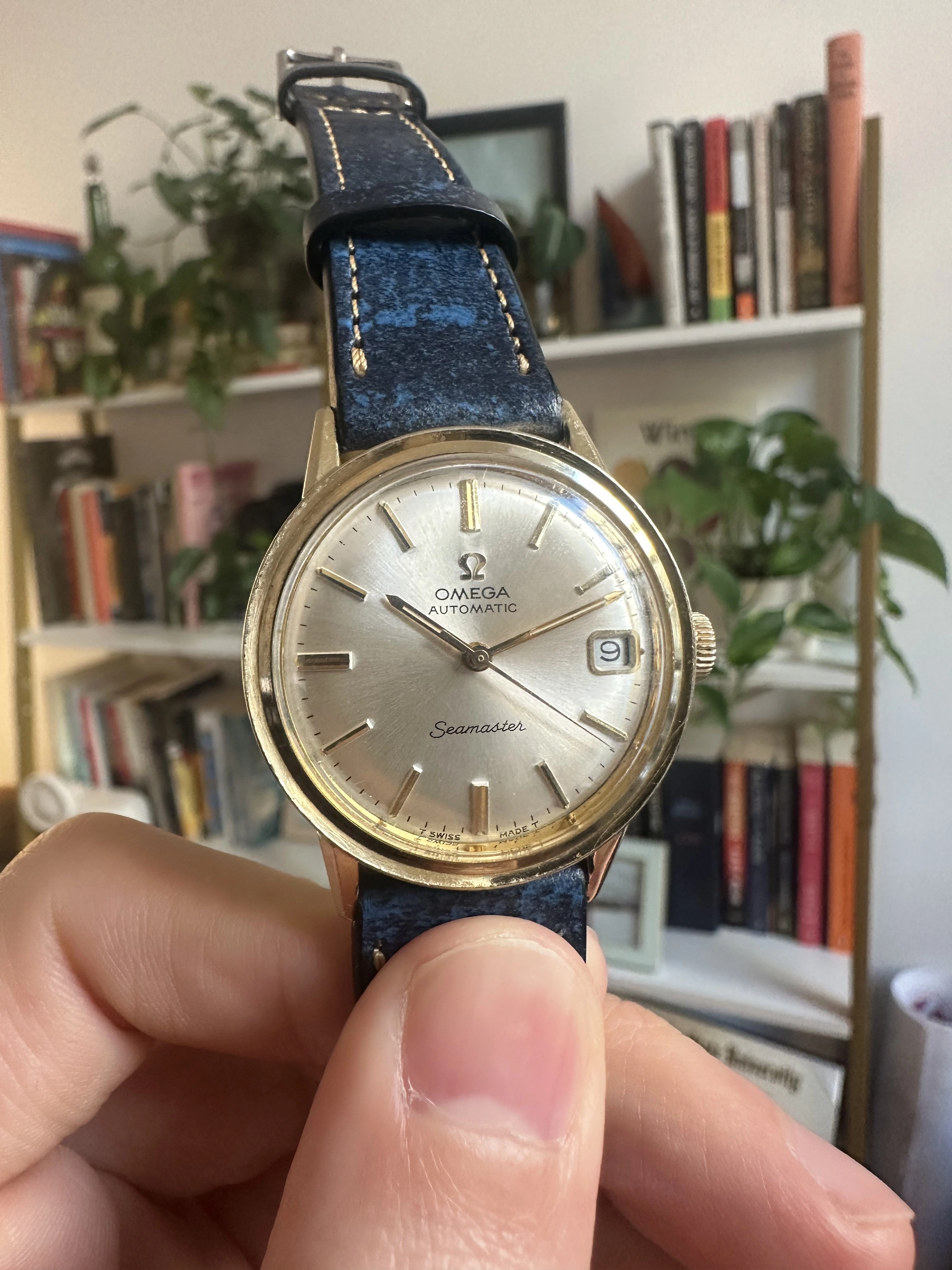

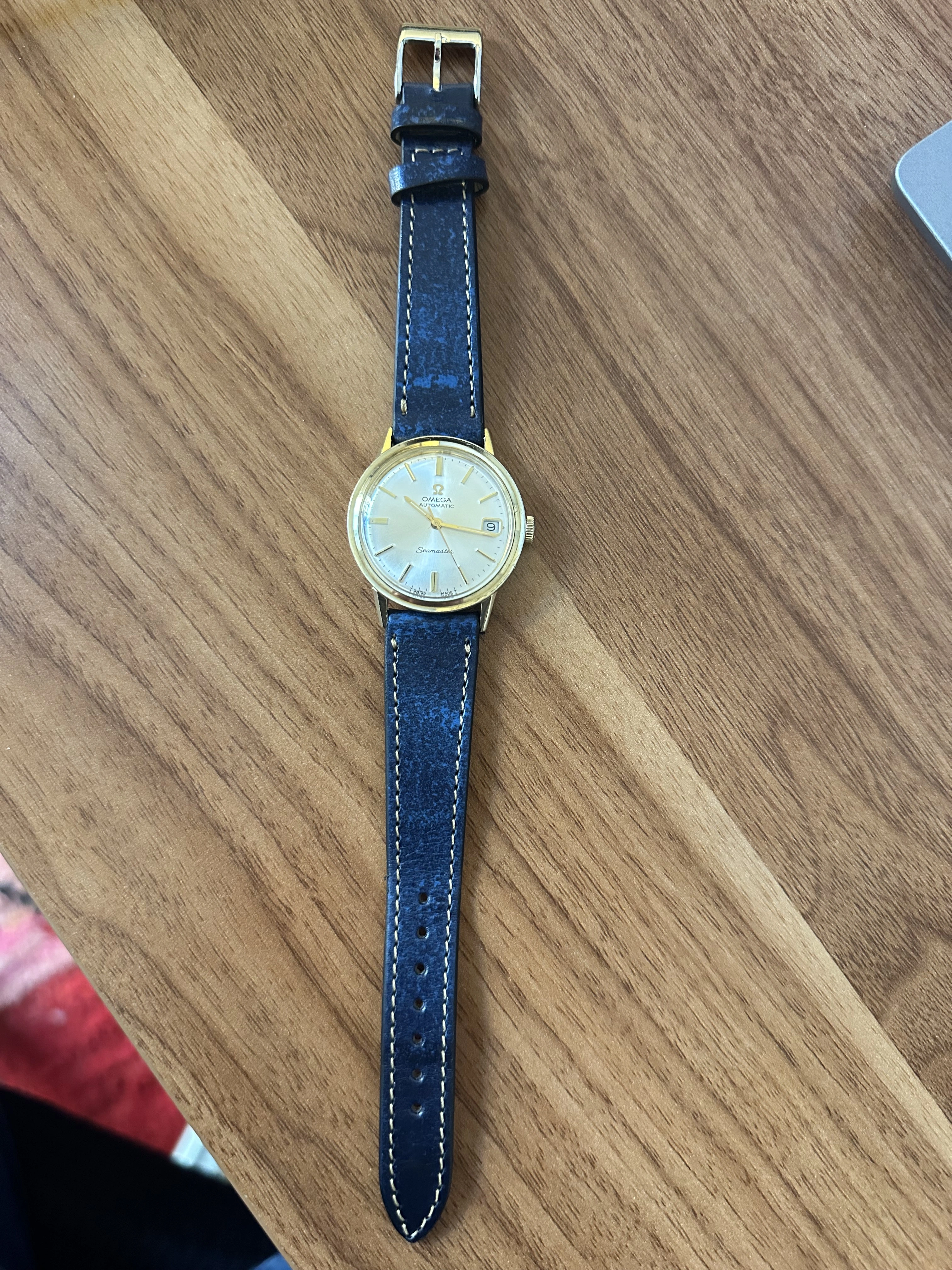

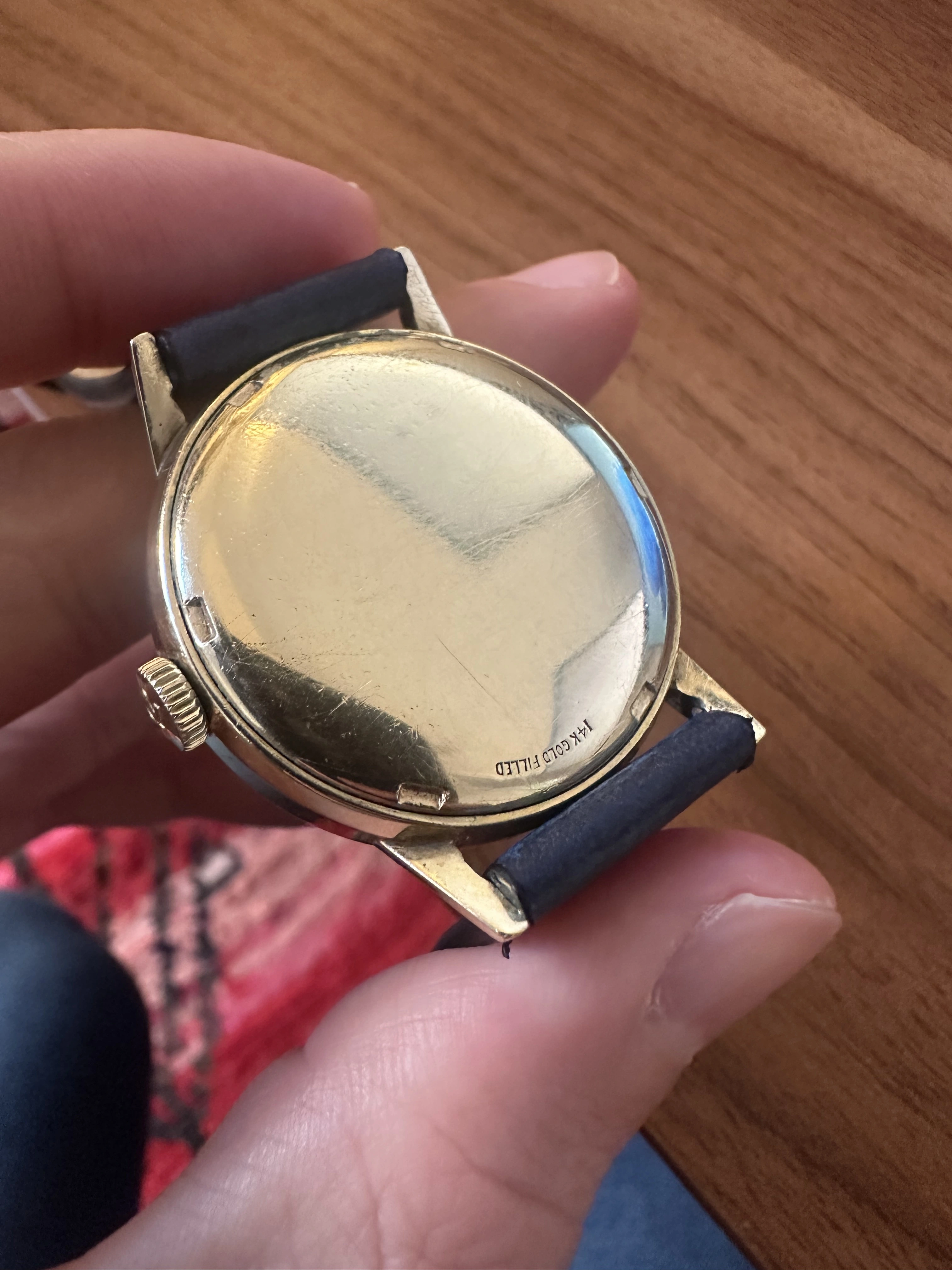

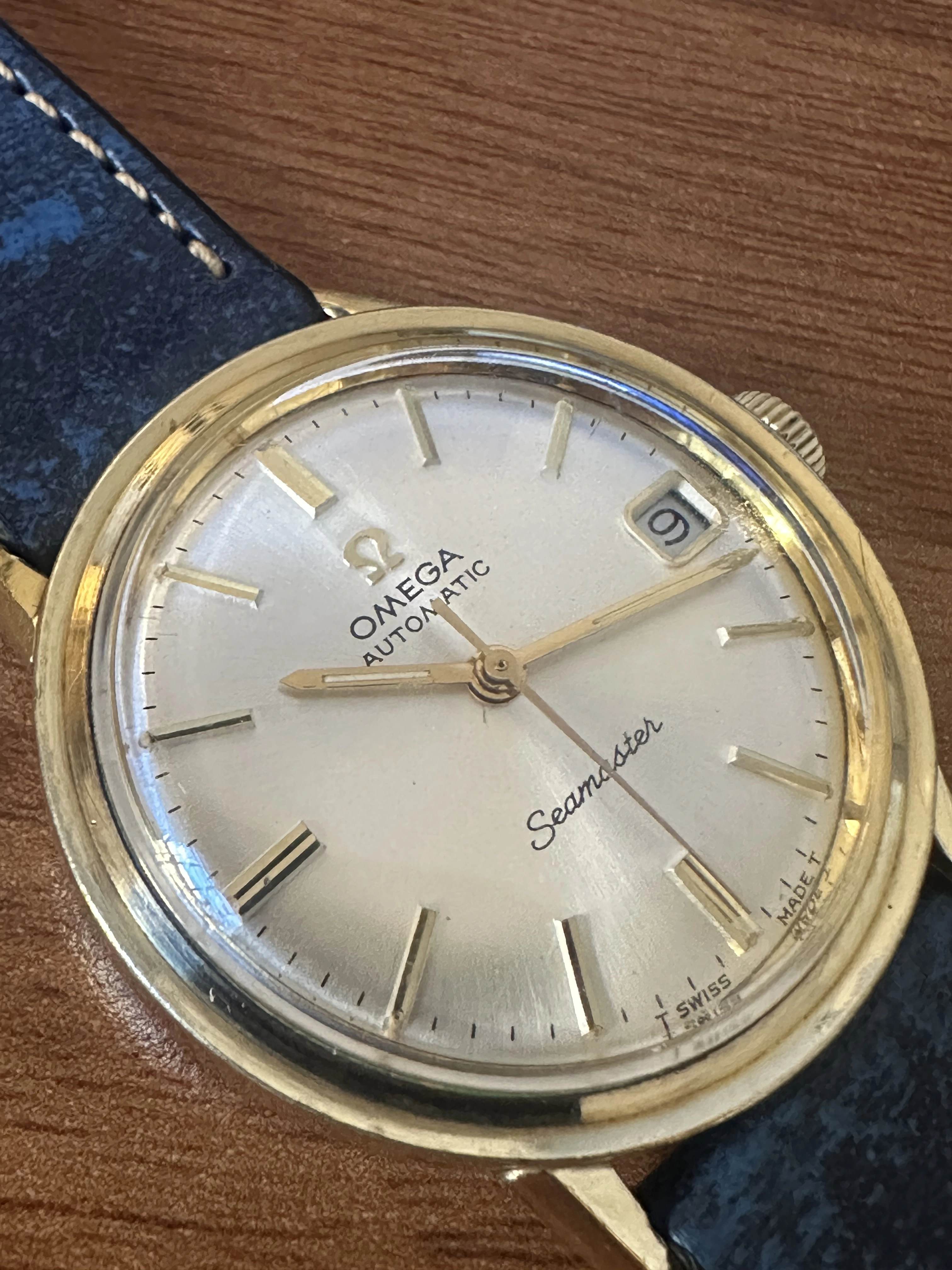

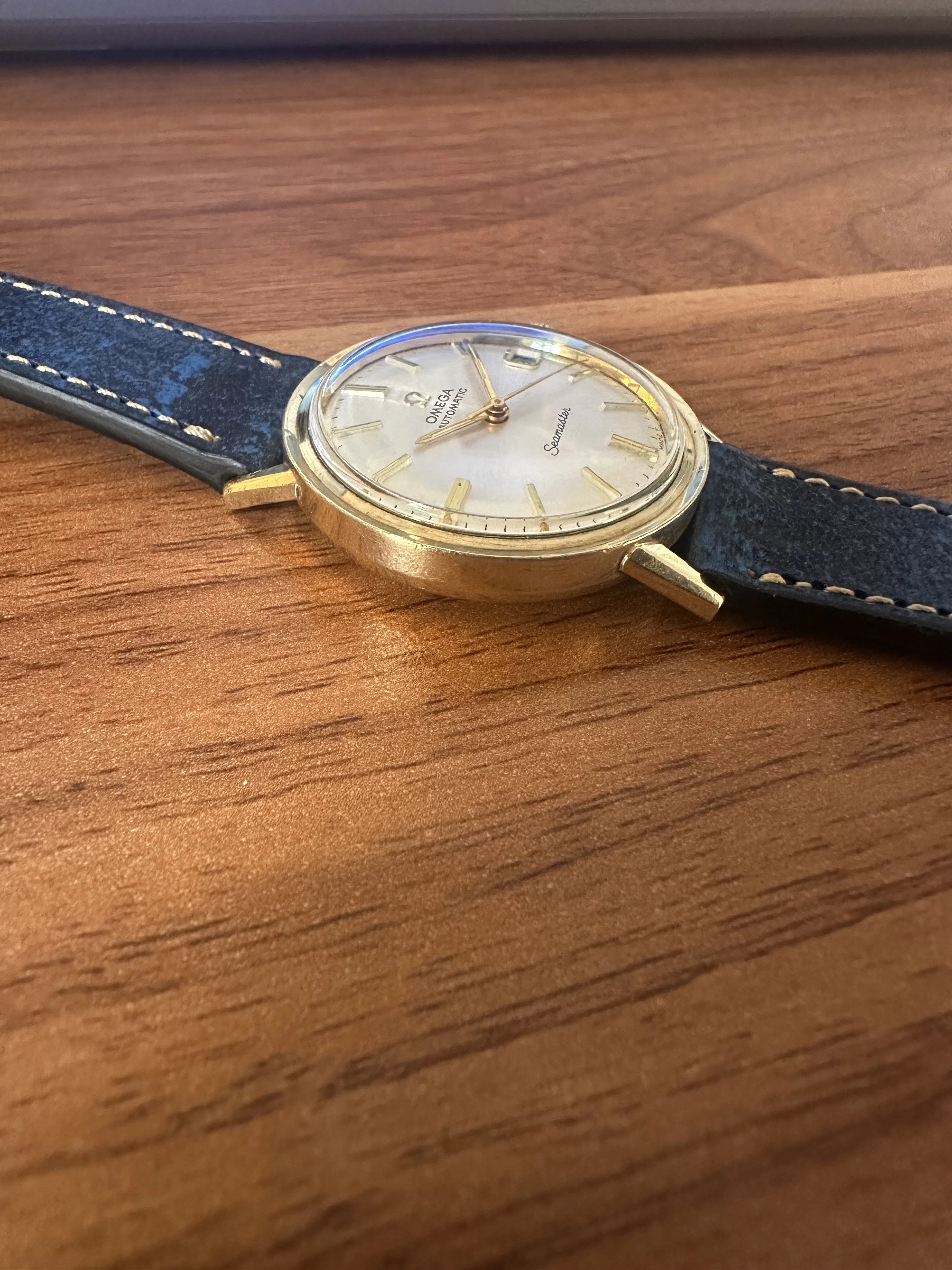

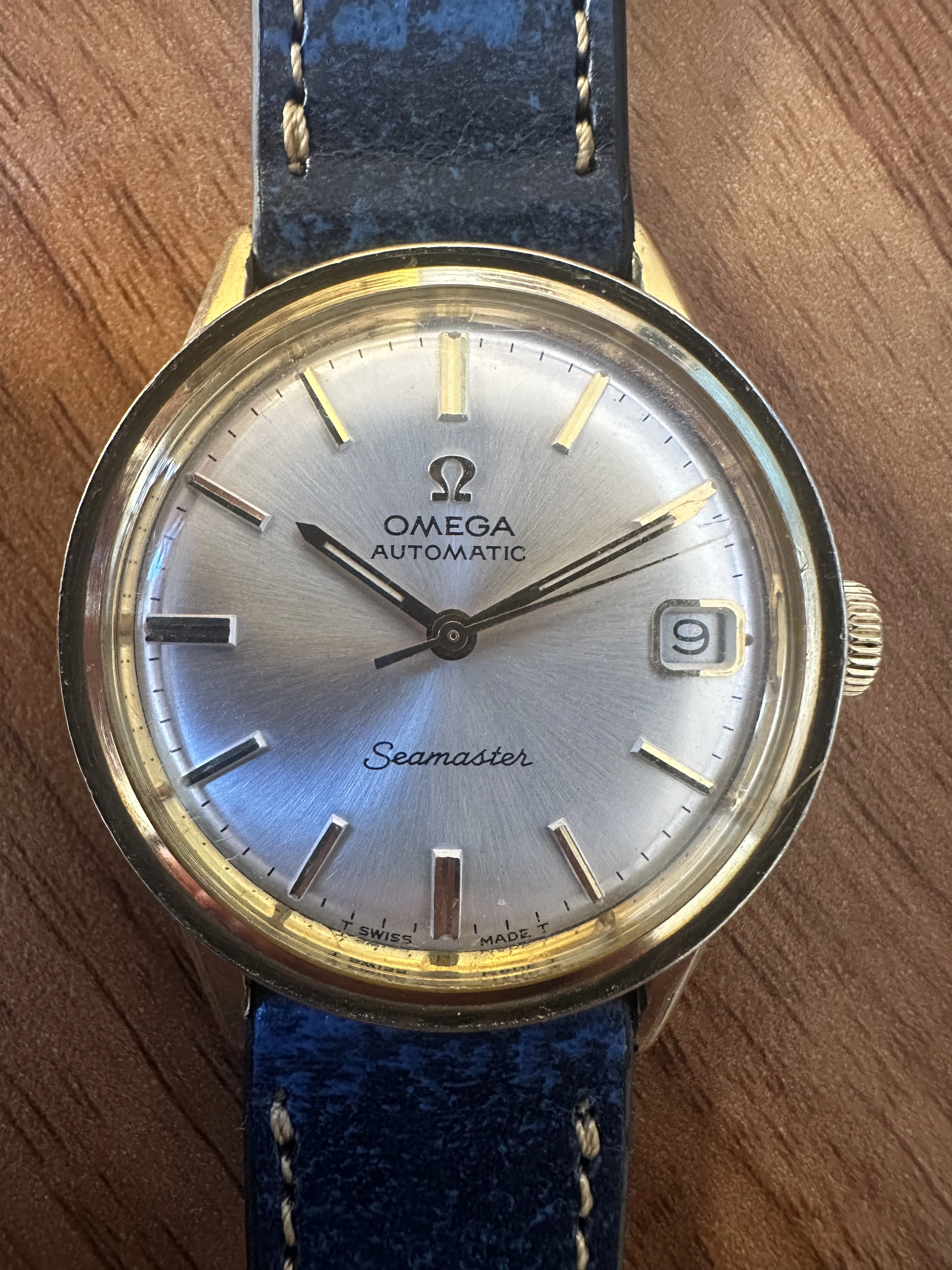

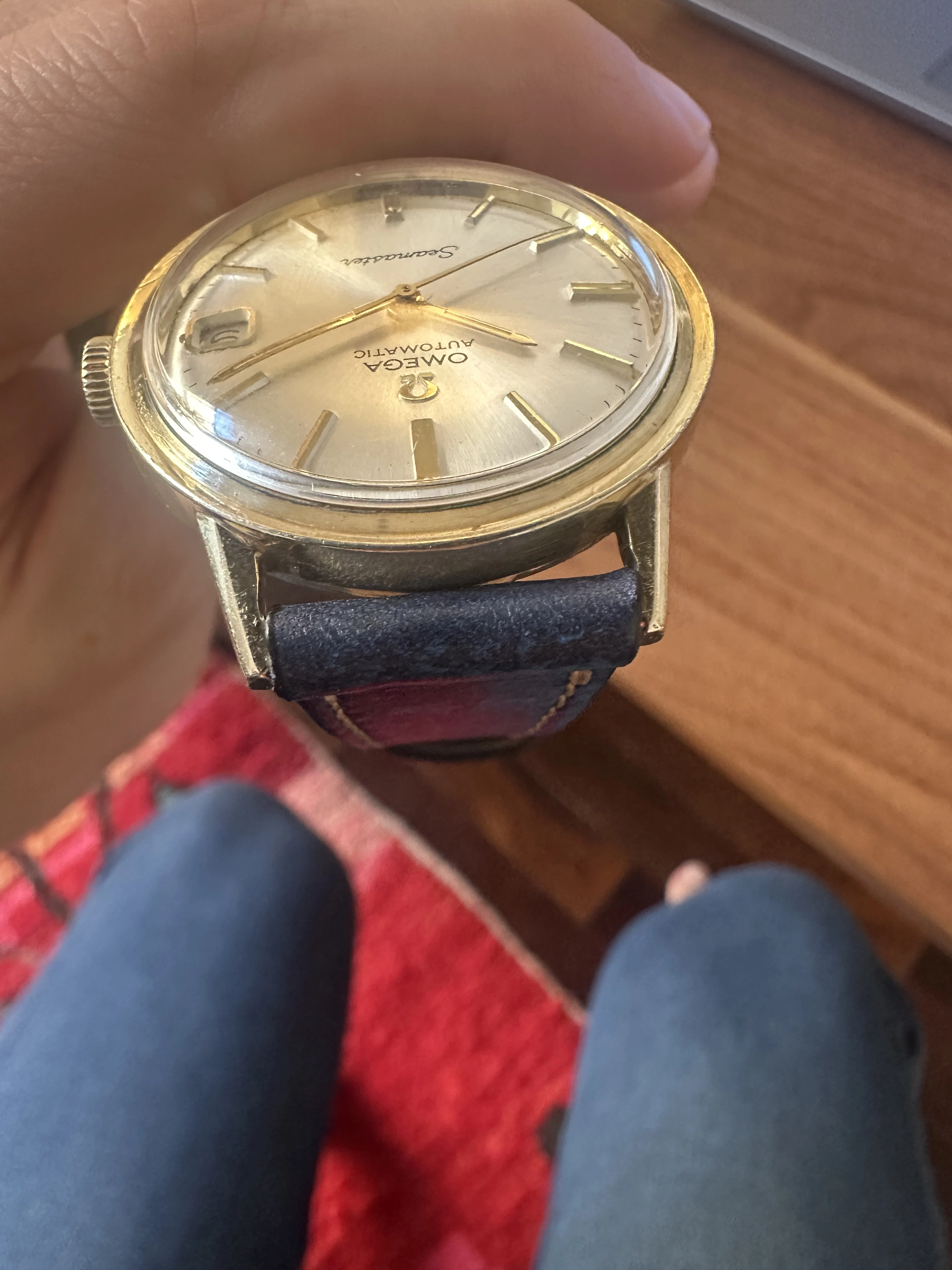

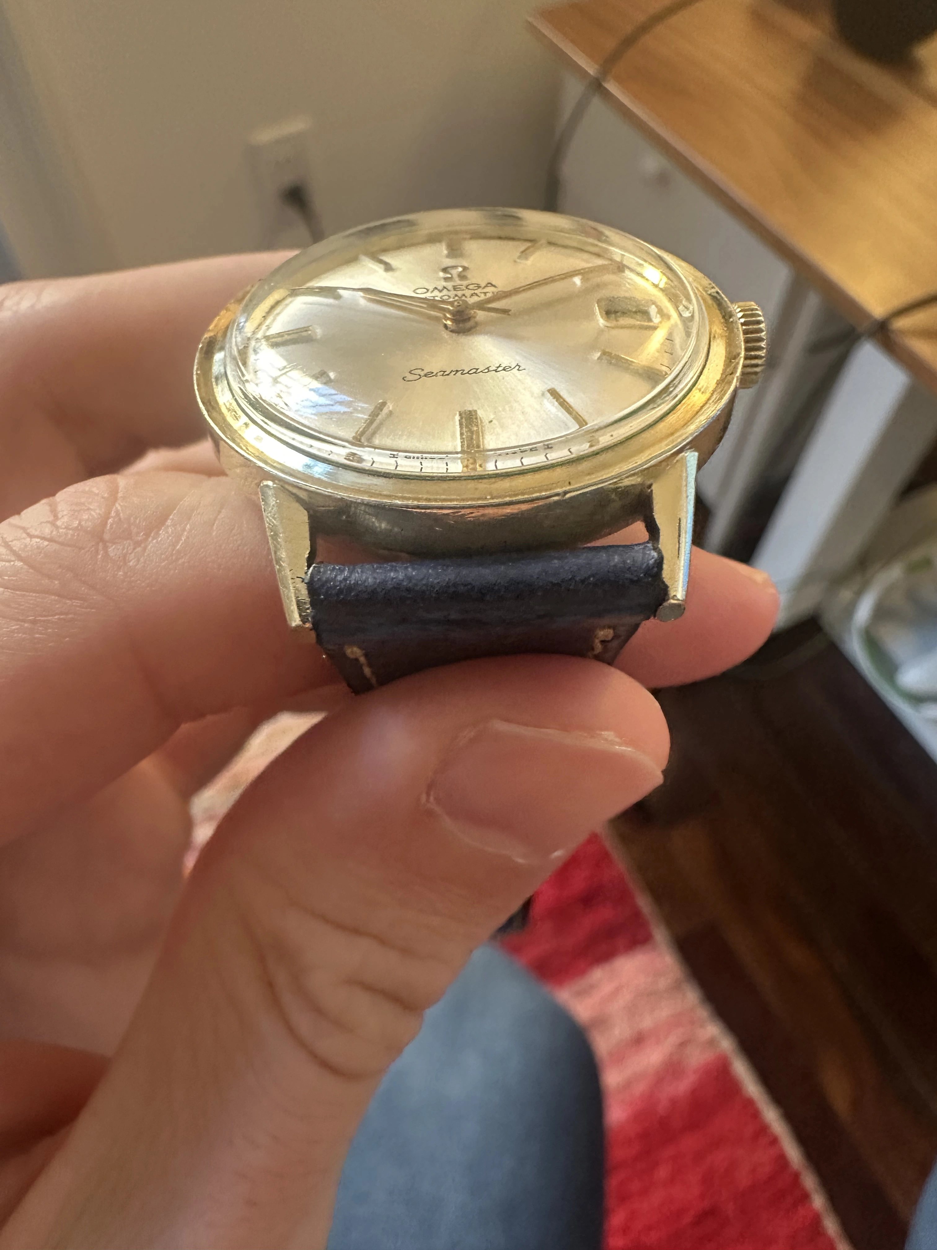

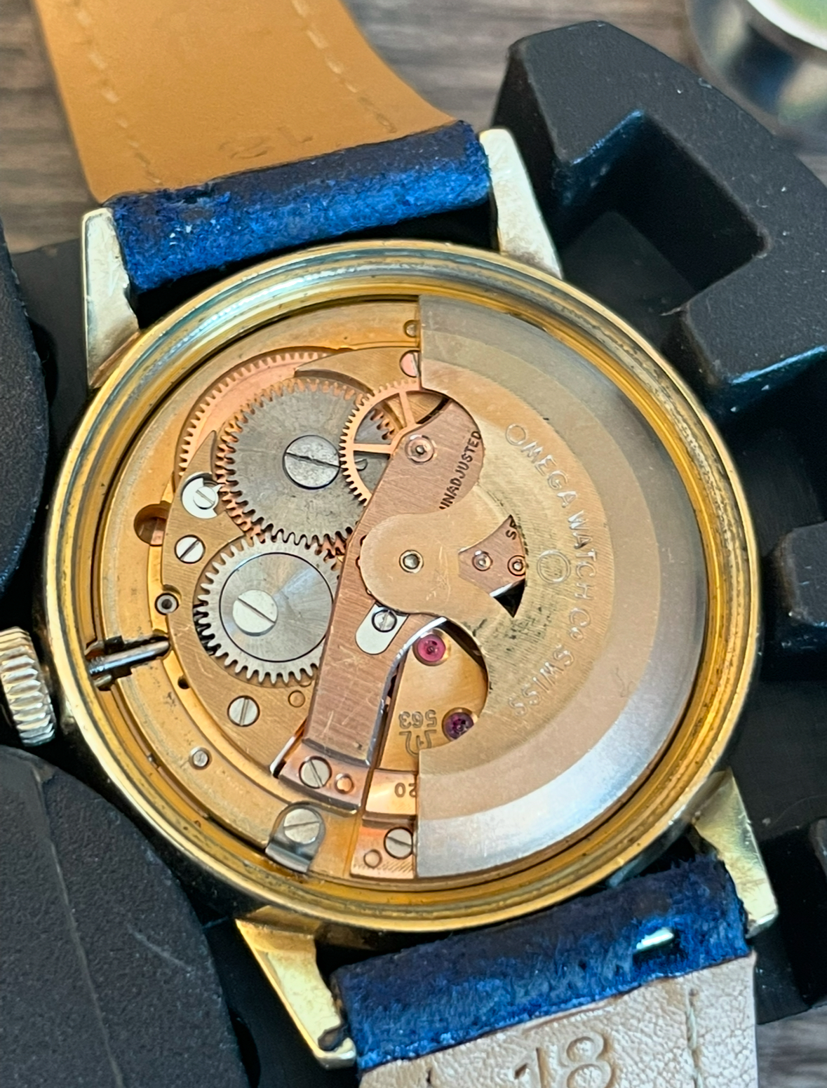

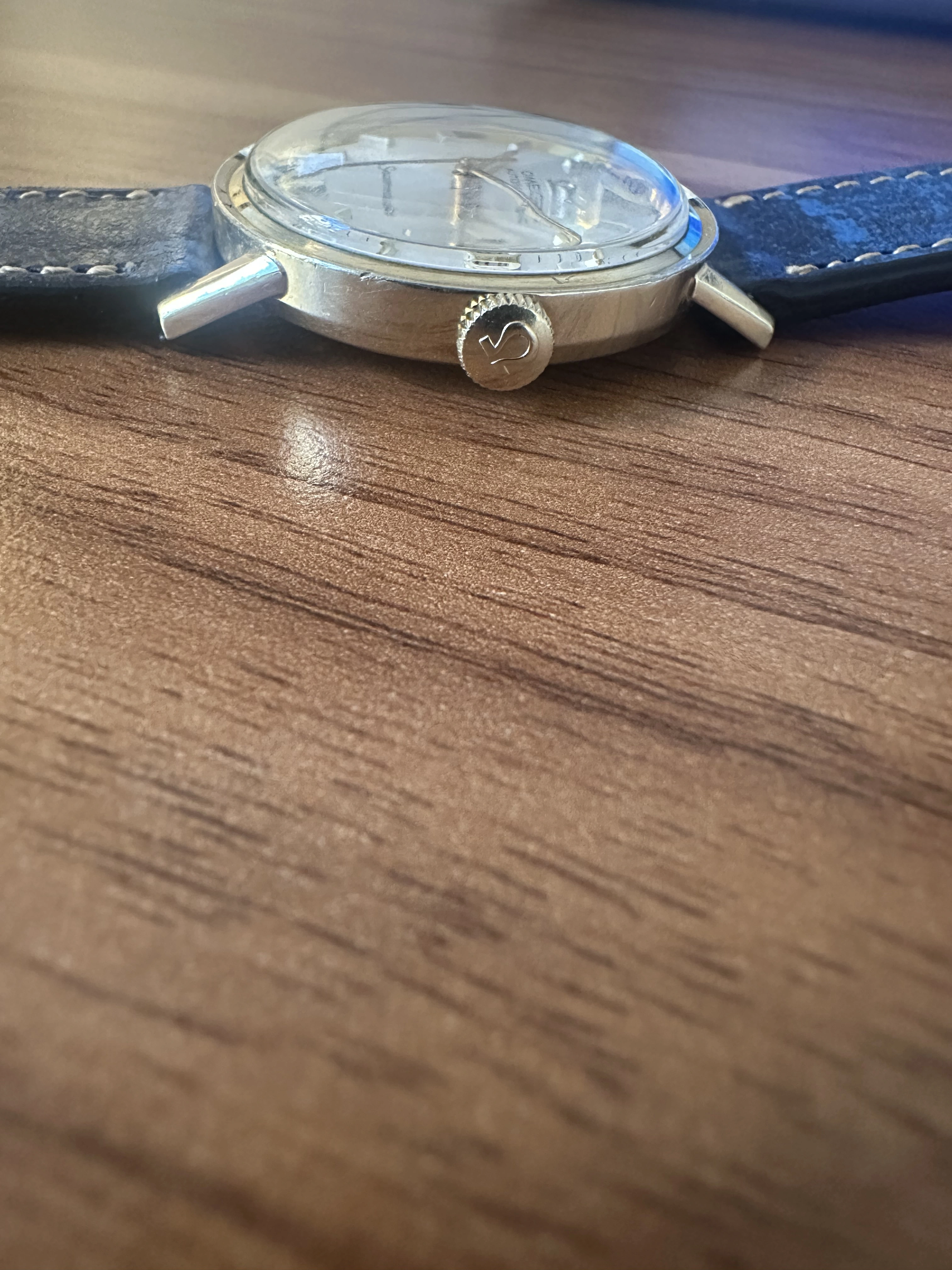

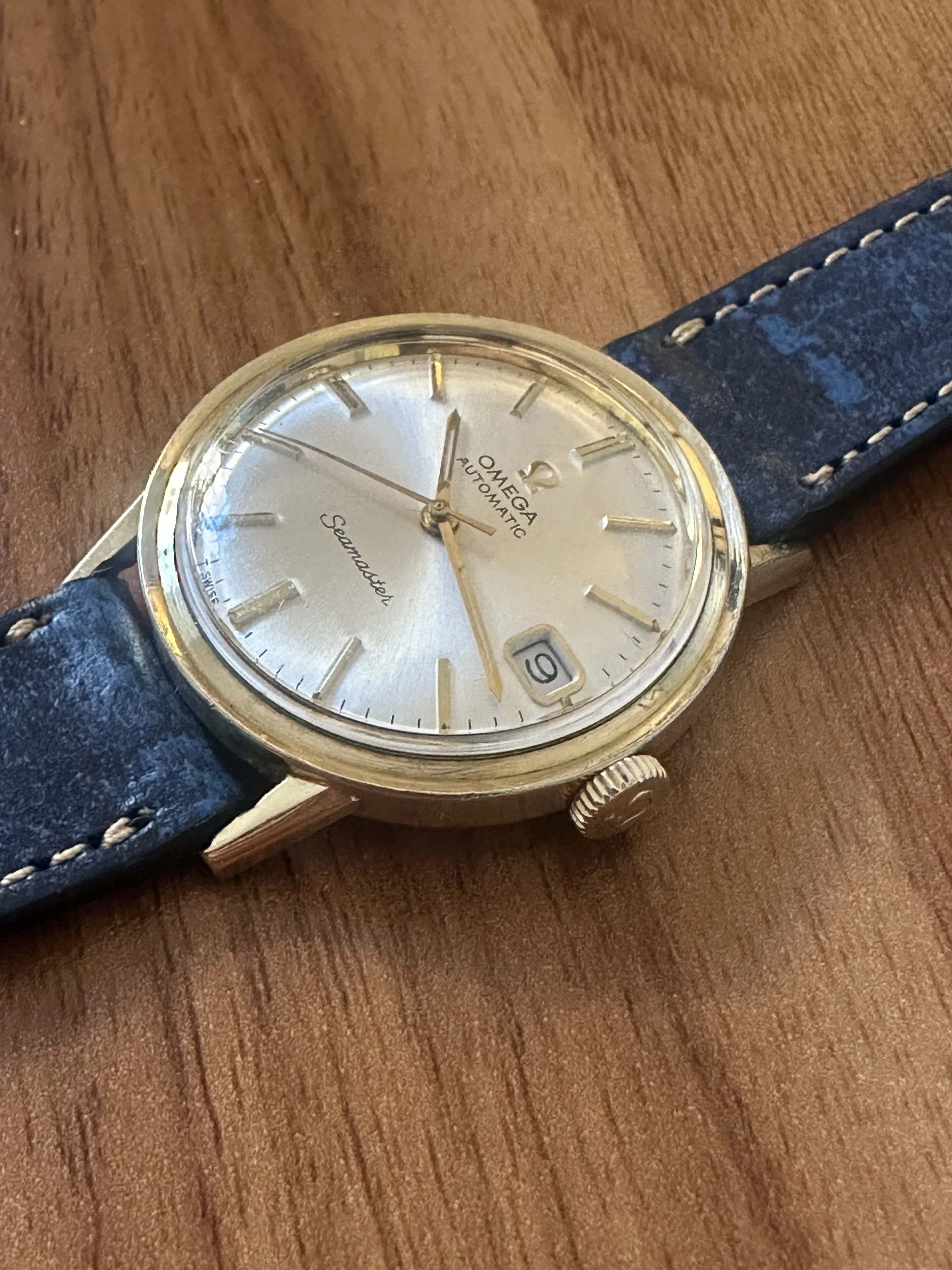

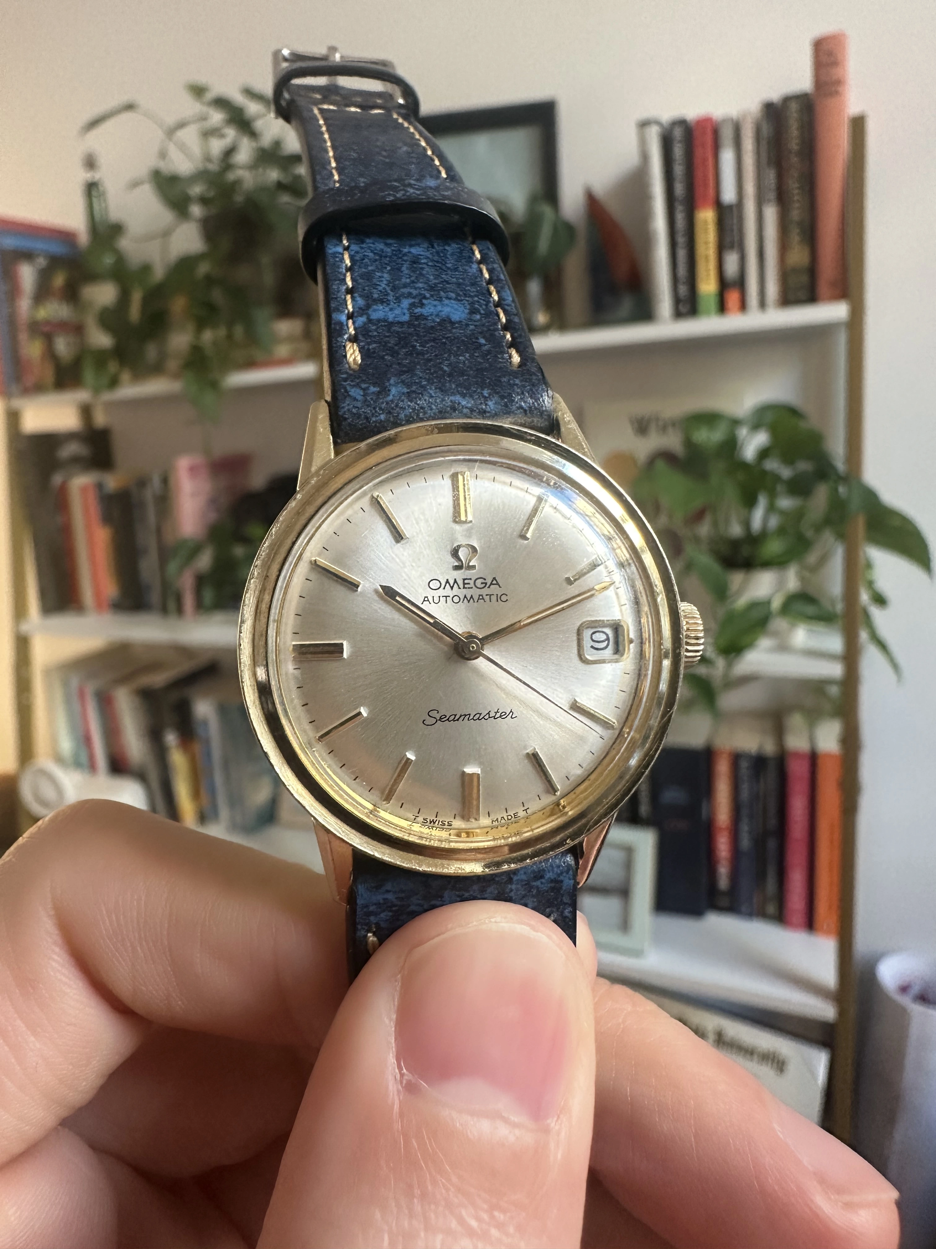

Omega Seamaster Cal. 563. Getting servicing quote of ~$1,000…not too sure what what to do (full description below)
Hi there! I could use some advice from the community. I have this nice little Seamaster from the late 60s and it needs a service; it’s running but the movement seems loose within the case and the dial quivers a little when I pull the crown out. I like the watch but $1,000 dollars is quite a bit for a service considering I paid $500 for it in 2019. The watch condition is okay I think. The dial has a small scratch by where the hands are mounted and the lugs are a little mangled from years of strap changes prior to my ownership, but not sure how this compares to others from this era.
For context it’s the Caliber 563 movement. I don’t believe the crystal is original, but not sure about the rest of the watch. I live in New York also if that’s helpful and tried grand central watch, Manhattan time services, and Time innovations
What would you do in my situation?

Does the $1k quote include providing a bezel and fixing the hole chewed through the one lug? Seems like those items could add a bit.

Indeed what exactly is the scope of work? Seems very high.

Mvmt. wobbly ? In your pics. the case clamps do not reach the case to fasten the mvmt .....

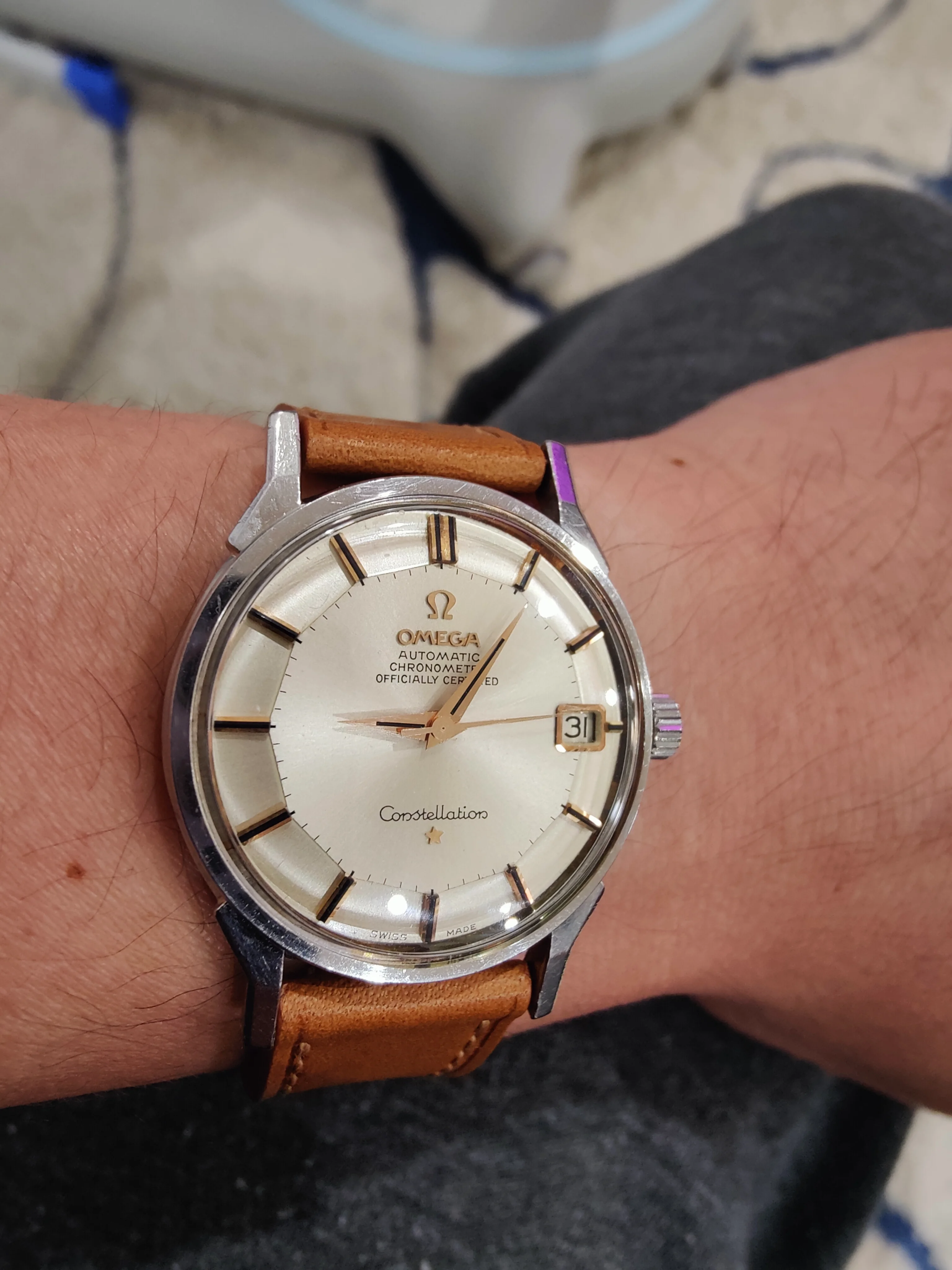

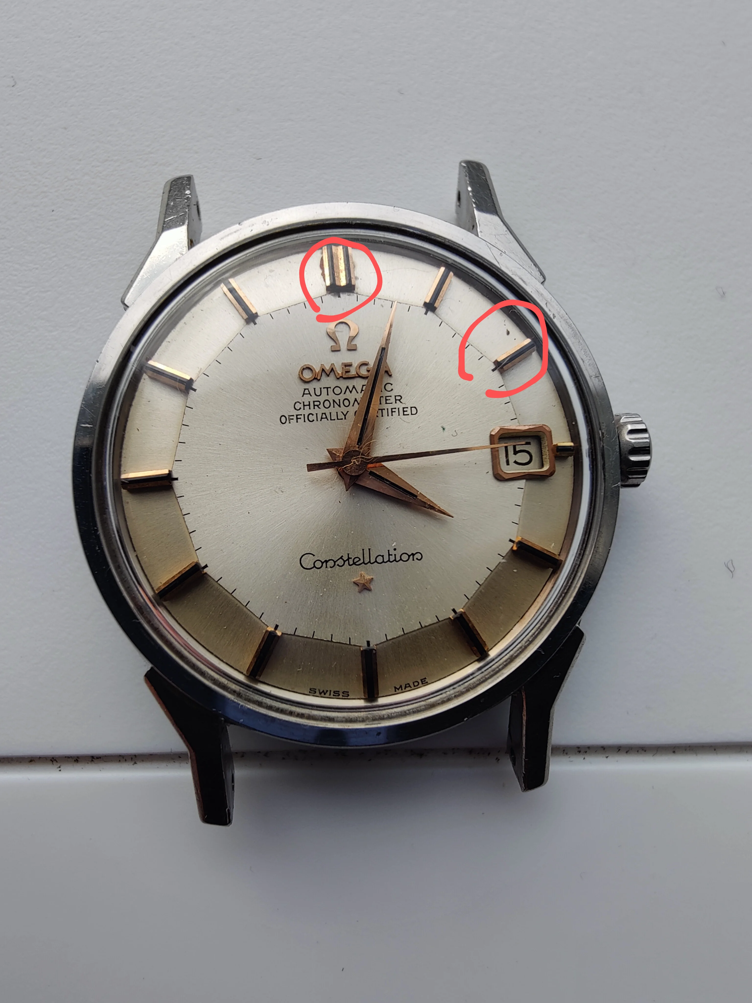

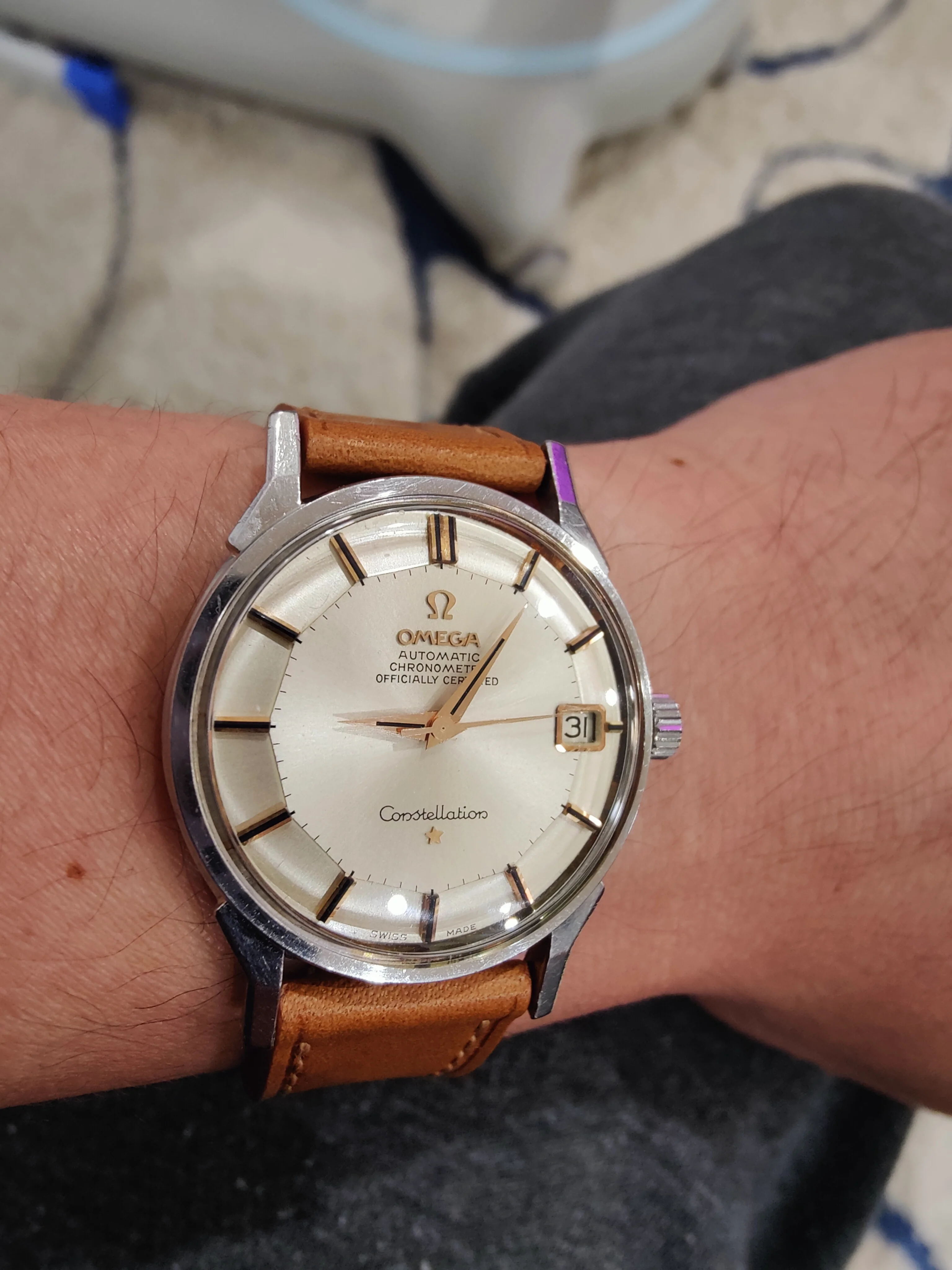

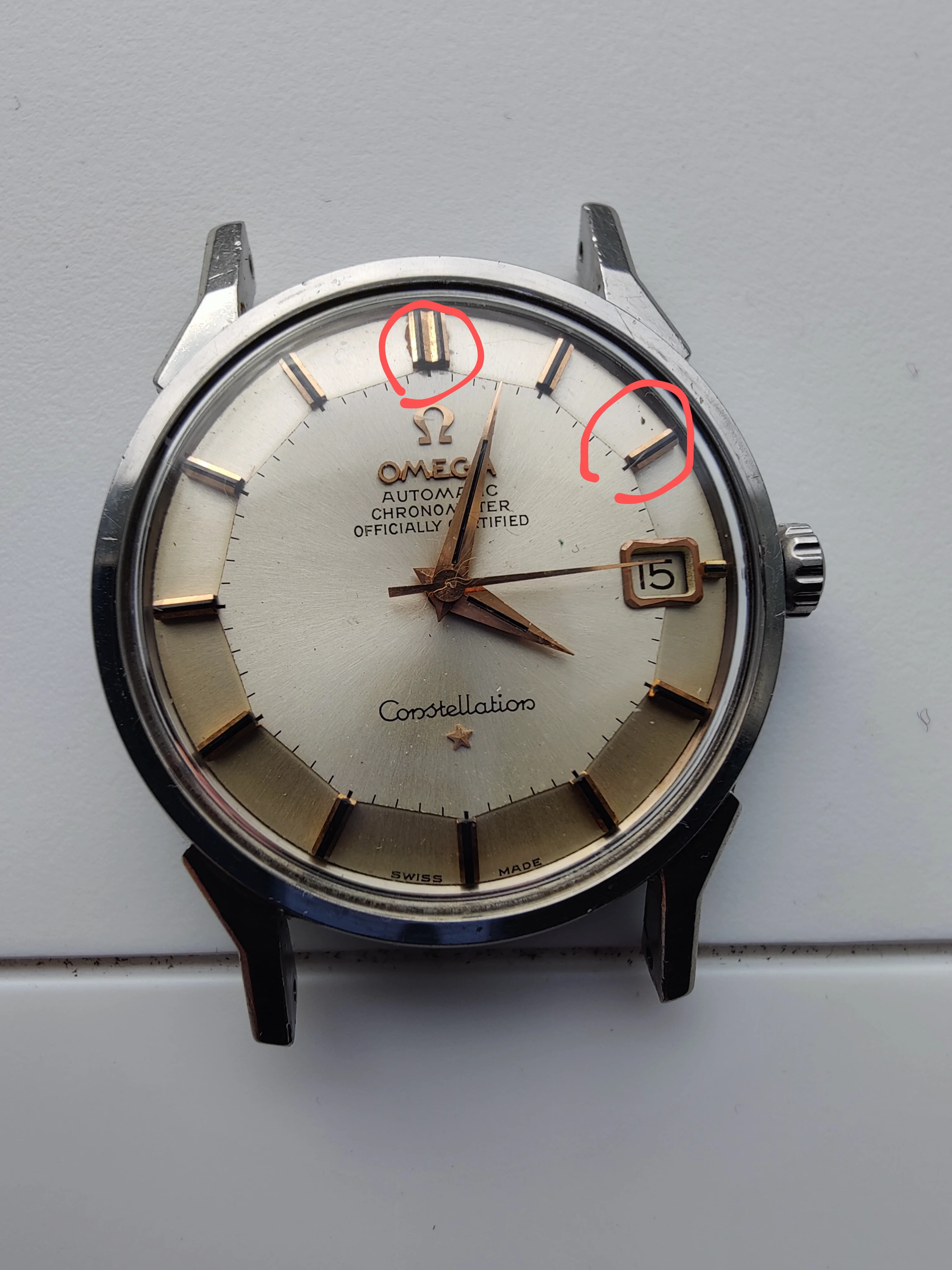

I'm also in NYC. I send my watches out of state to get serviced because it's cheaper. I sent the last three vintage watches to Andy Lewis at Ultra Vintage in Ohio and they all came back great. Servicing ranges from $350-$400 depending on the watch so it's much more reasonable. There is a wait but that's for everyone. Just ask him how long it'll take.
https://www.ultra-vintage.com/
Before
After

Thats what I saw immediately. If this is the only complaint you have/thing that needs fixing, it might just be as easy as figuring out how to get a replacement case clamp. That one we can see looks like it was broken off at one point, at which point, replacing it yourself seems like it would be easy enough. THOUGH, a service might be a good idea just to figure out where the rest of it is.
