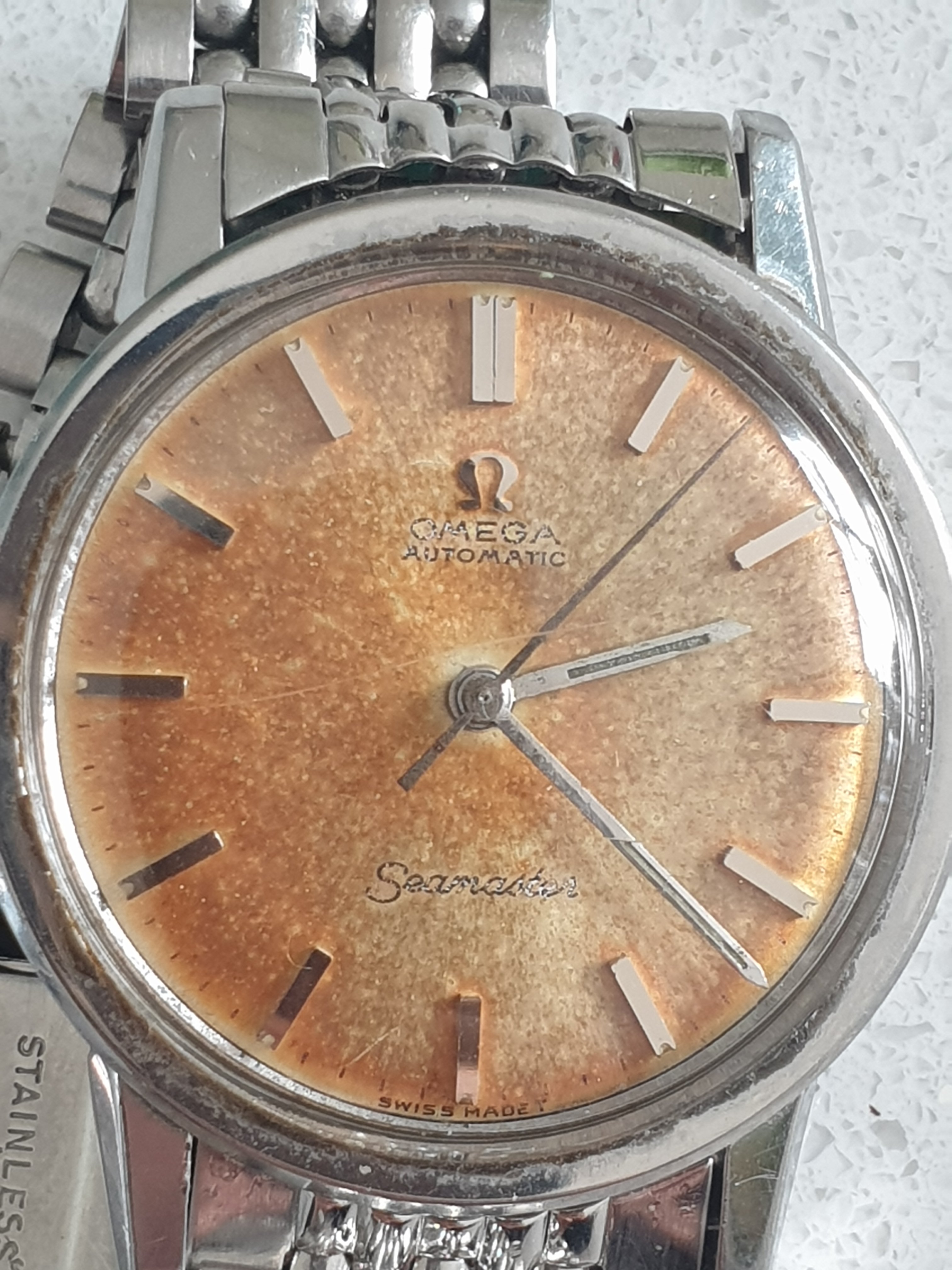

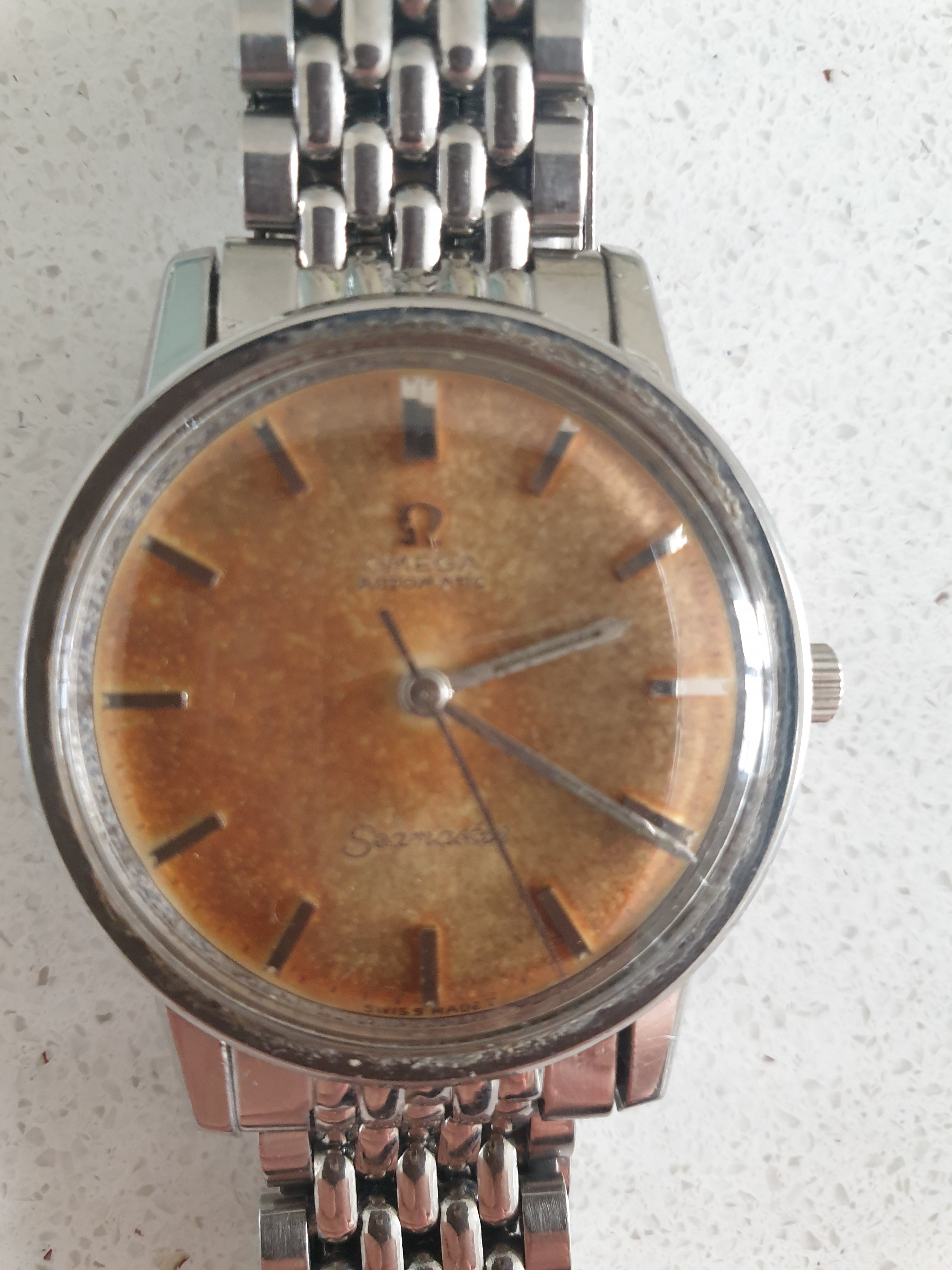

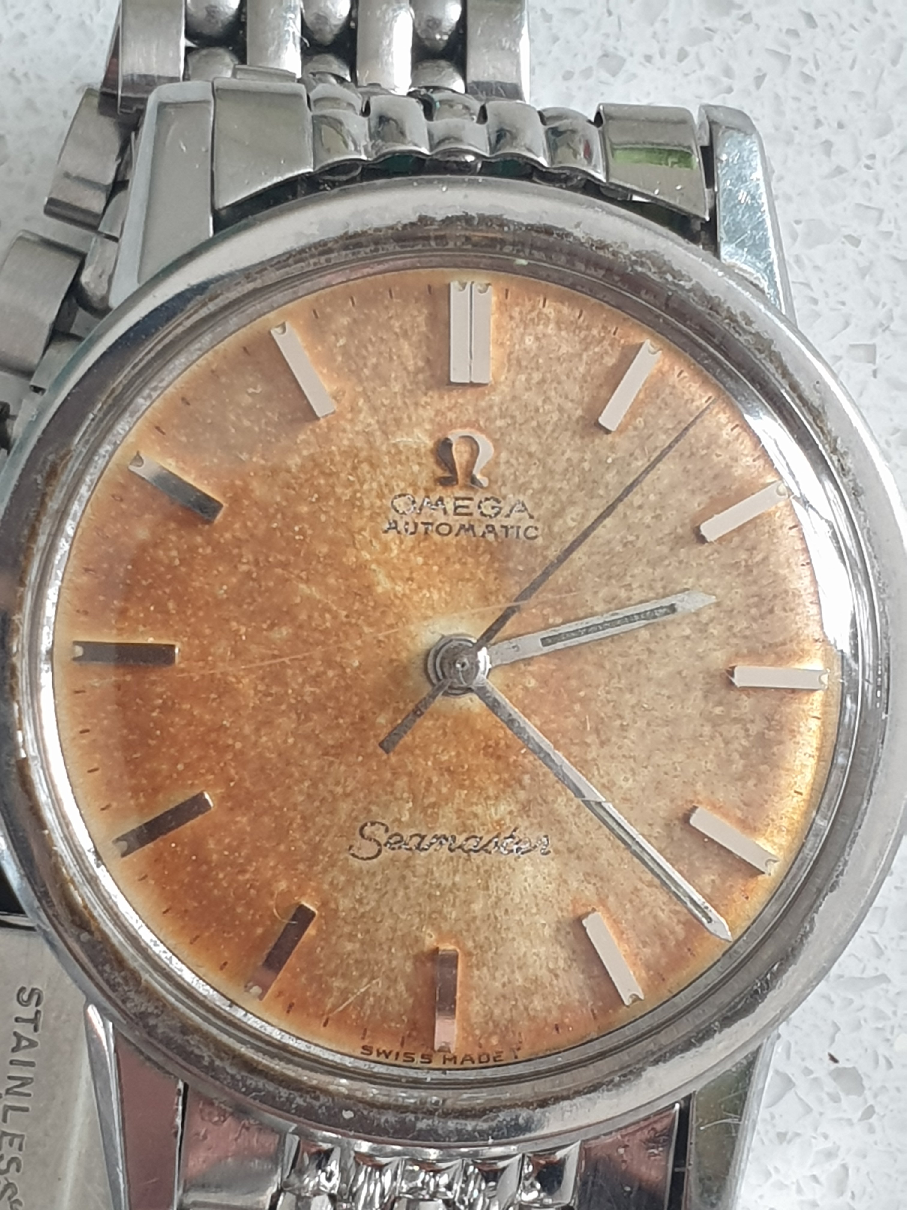

Hi! Totally new to this forum and in all honesty never thought I'd be fortunate enough to own a Seamaster but here we go!
My nan recently gave me what she said was my Great Uncles Seamaster. I have spoken with Omega (the wonderful Brenda) and have been given some information, however I am really looking to get a little more before I embark on what could be a relatively pricey refurbishment!
The information I have is that this was a late 50s early 60s model. There is corrosion caused by water damage which fits as my Great Uncle was the captain of an oil rig fire fighting vessel for years.
It has no date window, and also no 300 marking which made me think that it could possibly have been fake, however Brenda has advised that by all accounts its genuine.

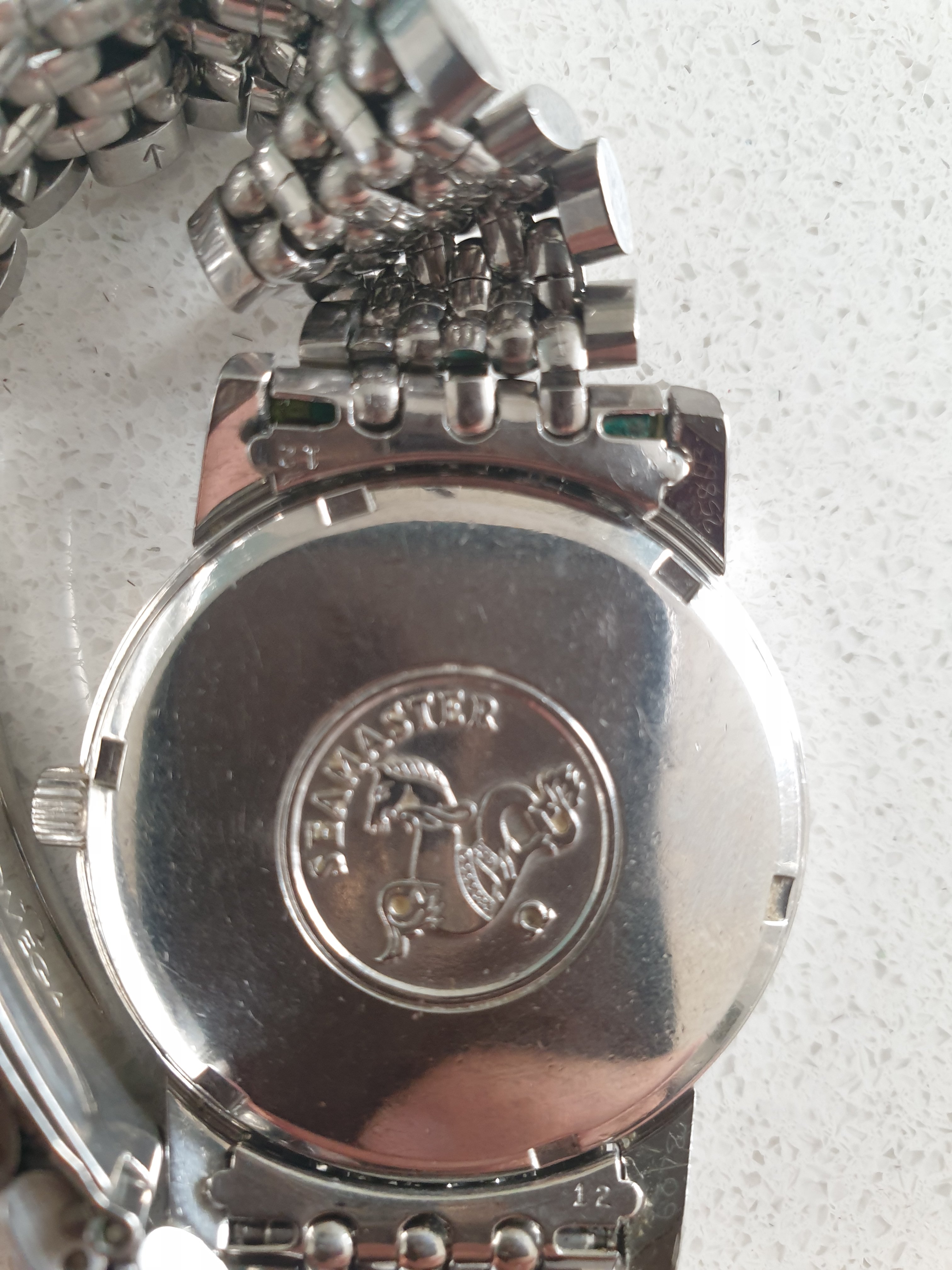

As you can see by the back, it has no markings other than the Seamaster. I haven't had it opened up yet, however the automatic function kicked in as soon as I started handling it and it hadn't been moved for about 8 years apparently. Its working fine and keeping the time so I'm hoping the damage is limited.
Has anyone seen a model like this before? I'd be so interested in whittling down a year of manufacture. I have contacted an official omega partner who does servicing and restoration and am just waiting for them to contact me.
I look forward to any response!
Toby

It’s not a seamaster 300 (dive watch) but a Seamaster (dress/semi sports watch).
Appears to be a ref 165.003 perhaps.
Probably dates around 1966/7.

Nice watch! All genuine apart from the crown which isn’t original I don’t think (likely changed at service, this is common). I can’t think of the ref off the top of my head, but I can tell you that due to the ‘T’ by Swiss made on the dial its an early 60s model; at least after 1962 (might need correcting on this). The reason for this is that omega used Radium lume up to the early 60s before switching to Tritium; and there was a certain point when they started showing this on the dial with the letter T.
Once a watchmaker opens the caseback the serial number of the movement will allow you to get a better idea of the date and if you want a very specific one you can buy an extract from the archives which will tell you the manufacturing date (it left the factory) and where it was delivered.

I would agree with David about the reference.
Get it serviced, then wear and enjoy as is, I would NOT have it "restored".
Have a watchmaker open the watch, take photos of the movement and inside the case back and post the photos here, be sure the serial number on the movement is visible when you take the photo(s).

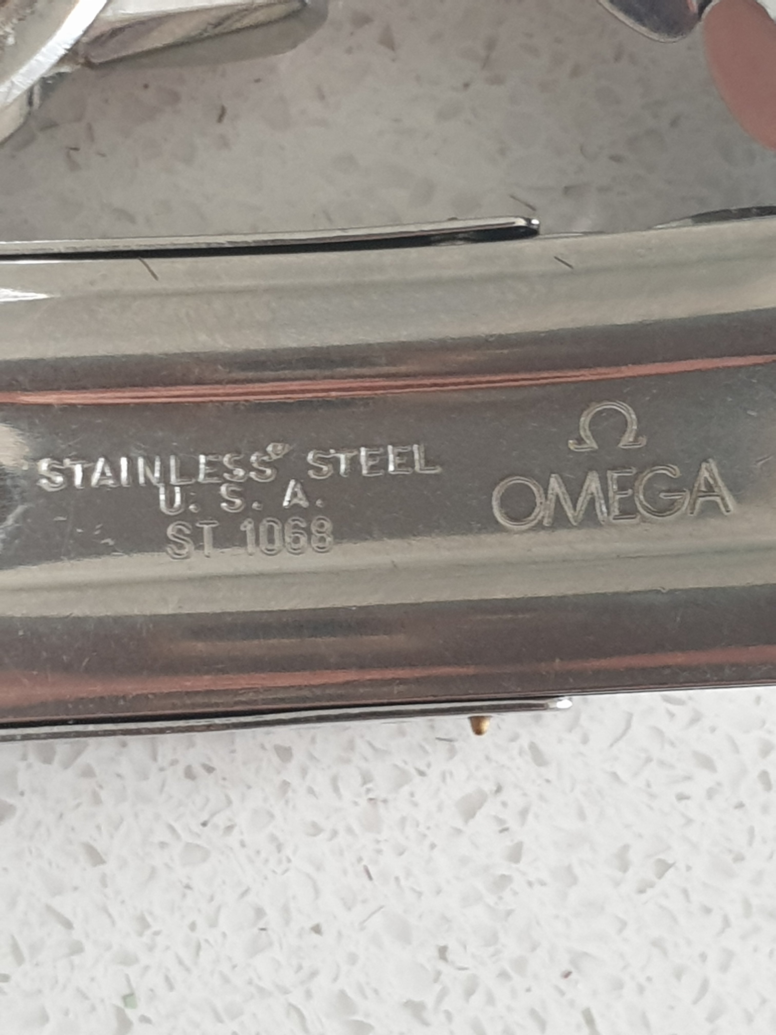

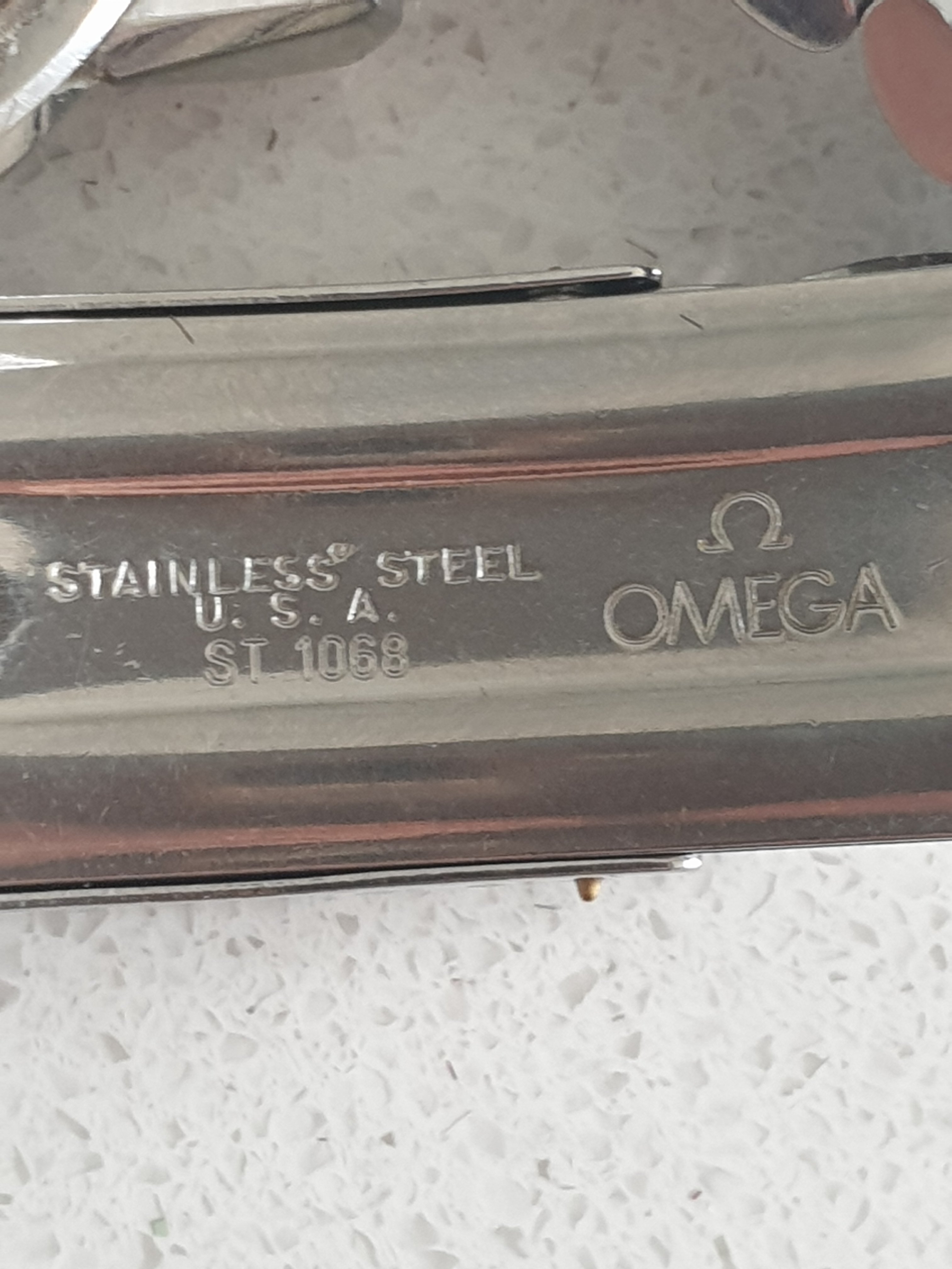

And the bracelet is probably worth at least a third/half of the value of the watch.

I can't see any "water damage corrosion", and none will be visible until the case is opened.
While the dial does look "rusty", the effect is called patina and is produced by the degradation of the varnish used on the dial.
The most likely cause on your watch would be continual ultraviolet exposure (sunlight).
As others have noted, avoid an "Omega restoration".
Any competent watchmaker can have this cleaned and running for a reasonable cost and the original dial, even with its patina, is more preferable to collectors than a shiny re-dial or service dial.

I love sun burnt tropical watches and yours is gorgeous. you got some real solid advice so far so please go with what has been suggested. A watch is only original once.
24,801
55,084
Some people pay extra for a dial like that, and that's your great uncle's patina. I would certainly not do any restoration on it, especially since it's a family piece.

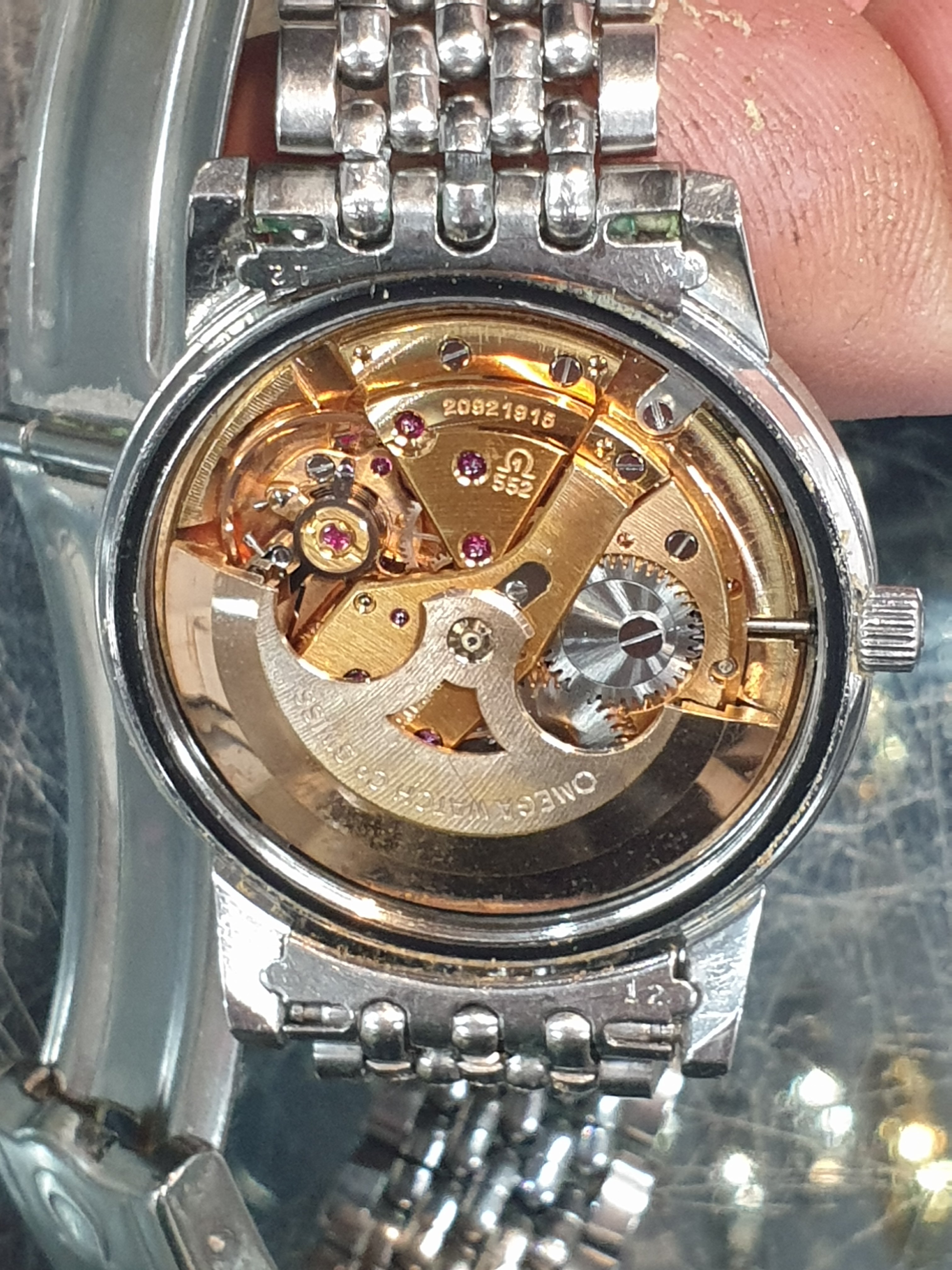

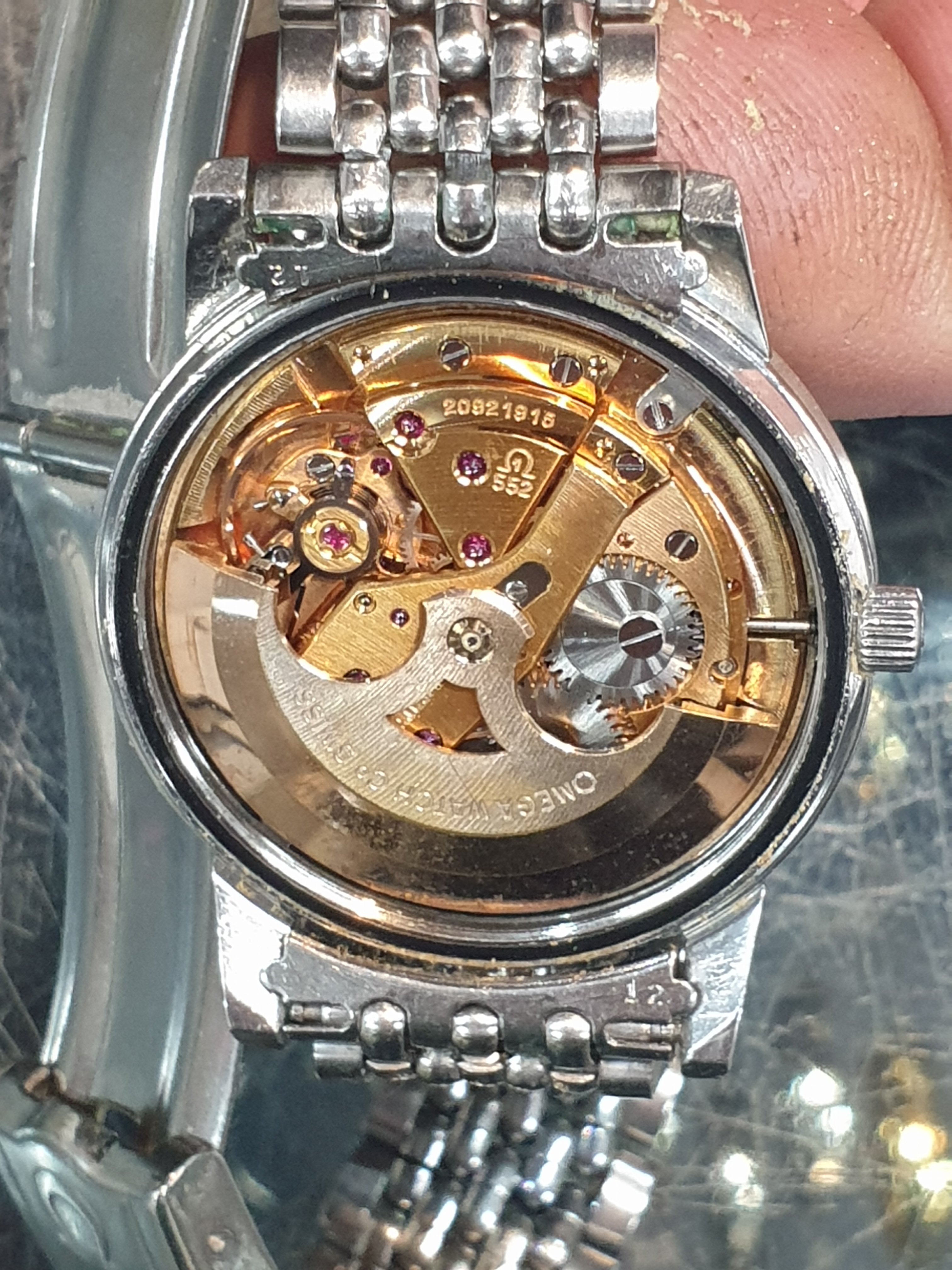

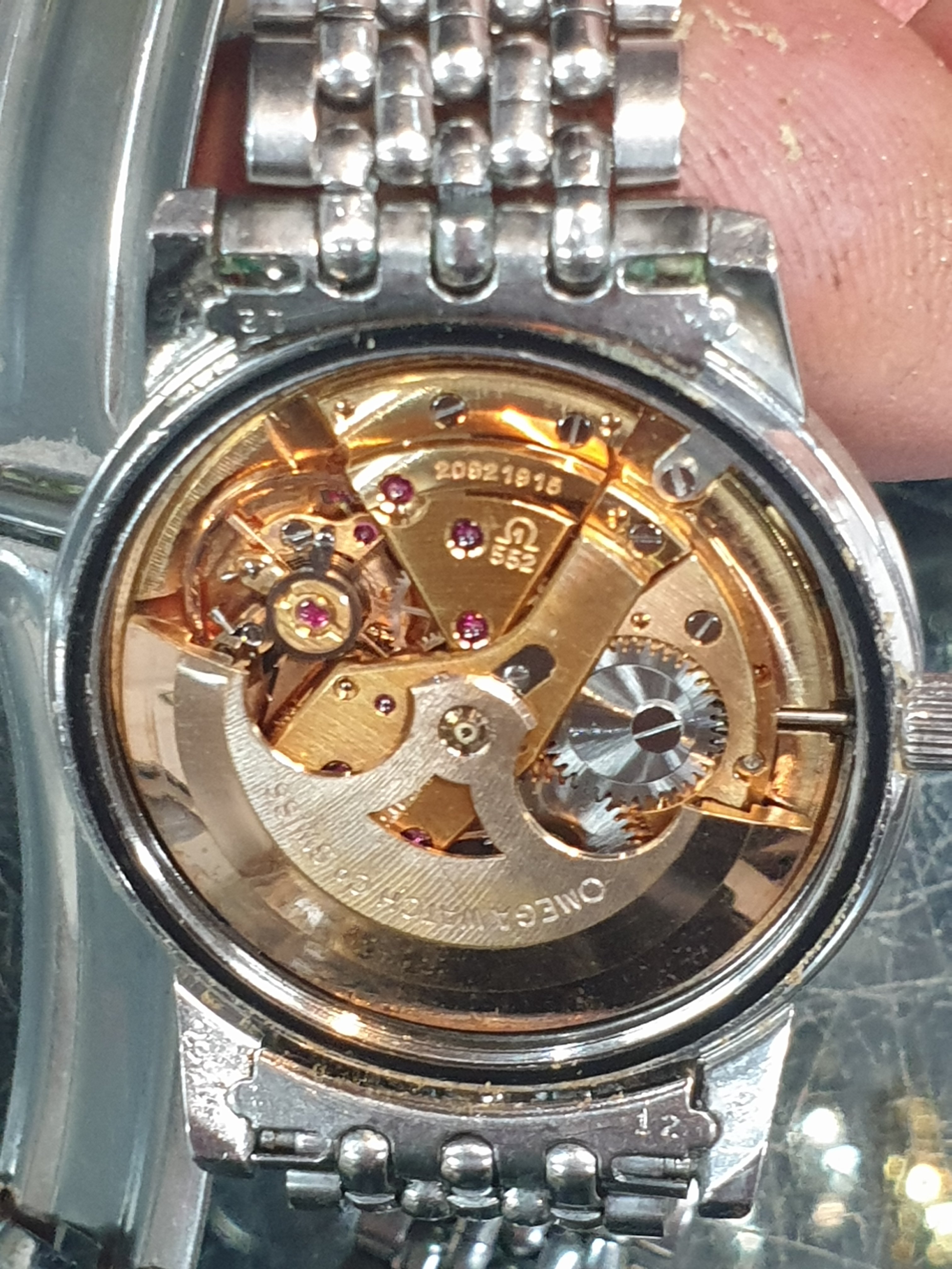

Hi again,
So I got the watch strap adjusted and am now proudly wearing it!
I also got the jeweller to open up the back and took some pictures of the movement. Its a 552. I guess the longer number is the serial number?
I've posted the pictures below
1,611
6,050
Yes, it is, and 20.9 millions serial dates the watch back to circa the end of 1963.
Nice watch, wear in good health!
