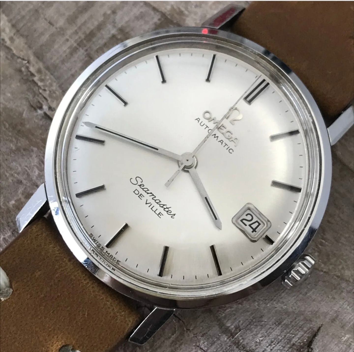

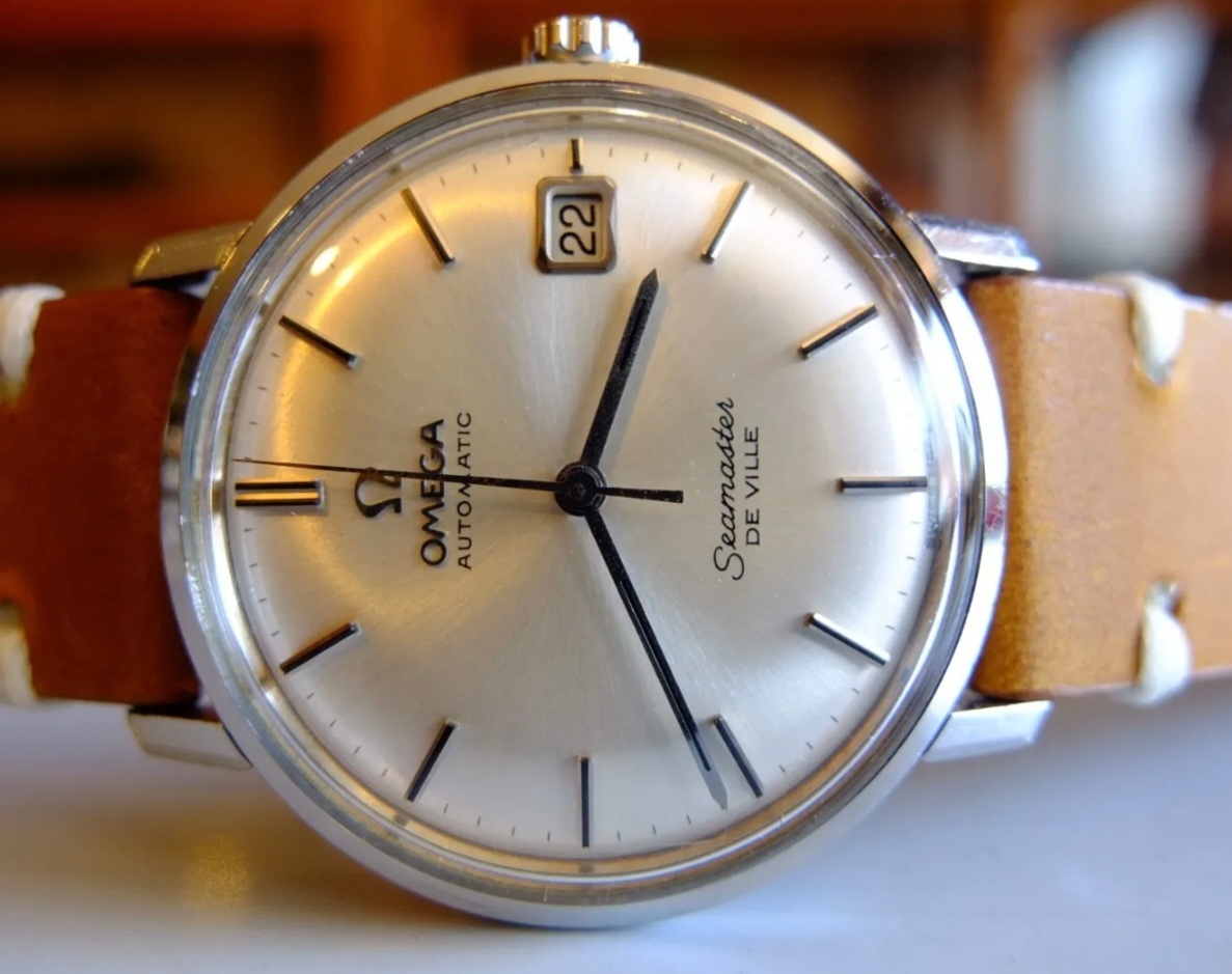

Lately I came across one eBay item that attracts me 60s Omega Seamaster De Ville, I would like to share few photos from eBay , I am rookie to this watch and need your advise if this watch has been modded, especially the dials, it looks too perfect to me for 60 years old watch.

No the dial is original. Generally a nice watch there, even the crown looks correct.
Due to the unishell case these Seamaster Devilles tend to see less water ingress and have less amateur tampering.

Yea I recommend this specific reference, the 166.020 frequently because so many of them look excellent still. They’re great watches with great movements and this one is a nice example. Just keep in mind they typically go on eBay under, or around a grand even in this condition

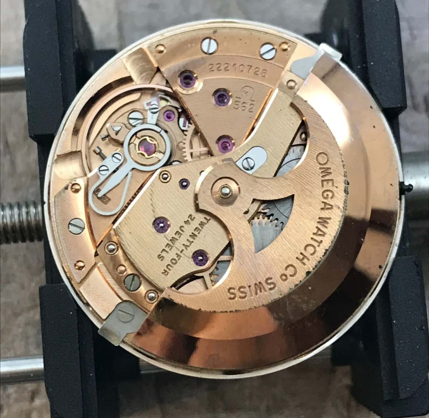

There appears to be some pretty serious rotor rub damage. Hard to know if this was addressed in the past or not, but it may be badly needing a service.

Just to say one thing - don’t think that watches are fake/dubious just because they’re in very good condition. If you look in the right places you can easily find examples of this age and older which are in remarkable condition.

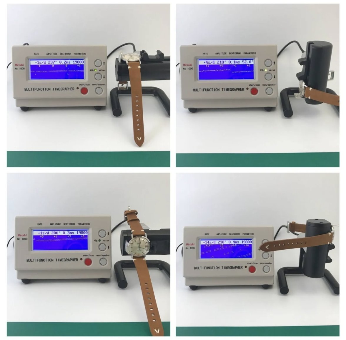

I think the time accuracy is not that bad from the photo posted by seller

Apparently you don't understand the rotor and the auto-winding mechanism. They won't affect timekeeping, but based on the damage to the rotor and the plate under the rotor, I would assume that the auto-winding mechanism needs not only service, but repairs with replacement parts. This happens when the movement is not maintained regularly.
Regarding the timegrapher readings, the amplitude doesn't look very good, but the lift angle is set incorrectly, so that reading is not accurate anyway.
