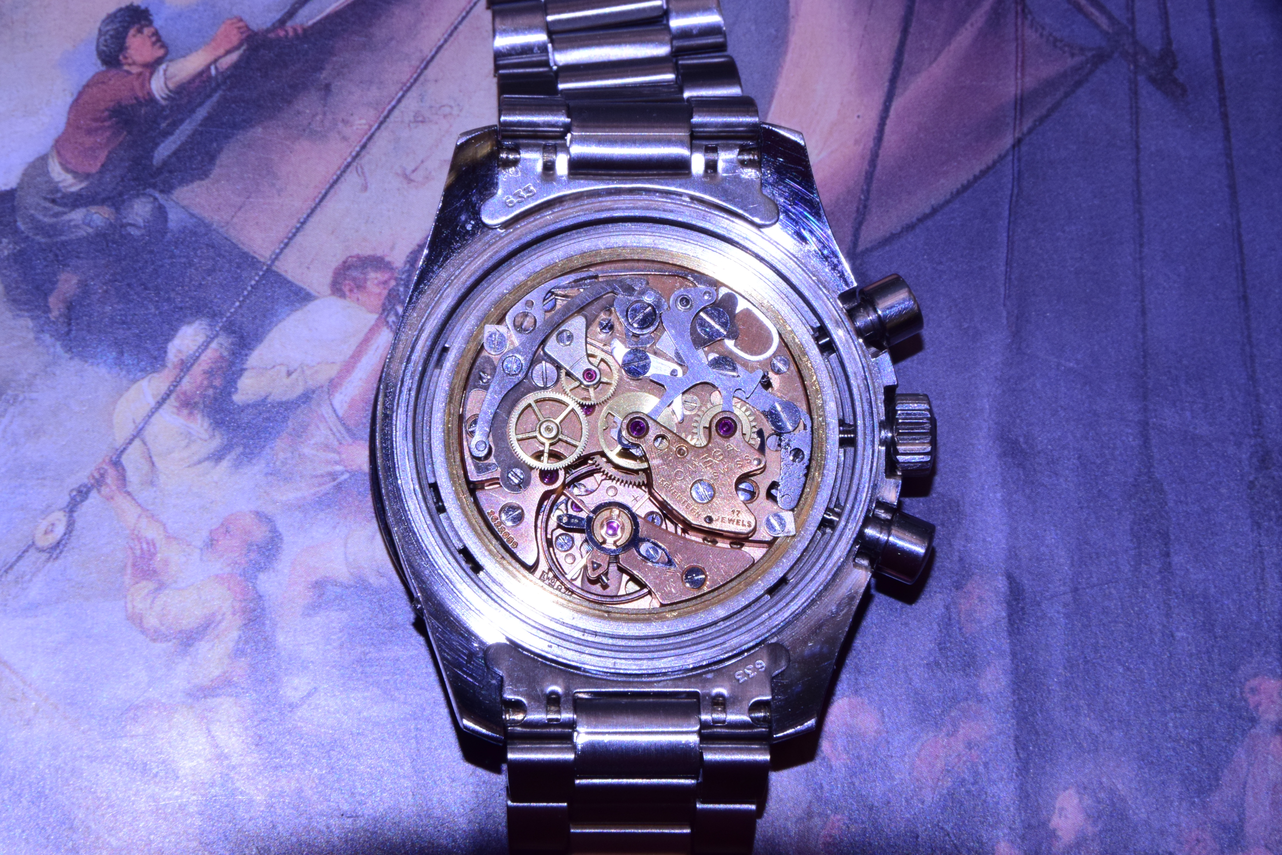

I think I might be able to shed some light on that movement... Its a Lemania 873 movement that appears to be dressed up. You can see the 873 and Lemania hallmark in this picture https://omegaforums.net/attachments/dsc_0599-jpg.228046/
Now that is the movement base for the 321 and identical to the 861? The reason I am calling it dressed up is that I cannot find any omega with the Lemania hallmark on it. The only examples I can find with markings there are the Omega Logo and 861. Like this example https://omegaforums.net/threads/1969-omega-speedmaster-pre-moon-transitional-145-022-cal-861.15356/
I might be wrong, but google search and seeing 68-71 examples with the Omega logo and lower serial numbers perhaps someone with more knowledge can clear up the movement..
It's a Lemania movement clearly...or at least a Lemania main plate...
Omega did not use Lemania main plates, so this is clearly a put together watch. Not sure what term you want to use for it - franken...fake...bitsa....I think an argument could be made for any of these, but it's certainly not an Omega in my opinion.
@moonphaselover you are correct the moonphase is a small module placed over this movement to make the Moon work.
The moon phase added to either the 861 or 1861 (making them the 866 and 1866 respectively) does not involve the use of any module - here is a typical Speedmaster dial side for reference:
And this is an 1866 with the Moon Phase added:
The term "module" implies that there is a self contained sub-assembly of parts that can be removed just by taking out a couple of screws, but the moon phase is made of up several individual parts that are added to the dial side. In contrast this is a complications module on a watch I serviced, and the top plate of the module has been removed to repair something, but this whole unit can come off the watch, so it is a true module:
Cheers, Al
78
36

I now have an appointment with my
watchmaker(s) for this coming Tuesday,
and maybe we can yank the hood open,
and have a look at the motor in this thing......
BTW, Just for fun, I have wound
the watch, and it runs quite well.
The date and moonphase properly
advance at midnight.
If this is NOT a moonphase watch,
how can this be so ?
Any bets on how this is happening,
or what we will find inside ?
The moonphase indicator on a genuine 866 movement doesn't advance at midnight, it advances 12 hours after the date advances.
78
36
Good advise !
I checked and:
1) The date and moon advance 12 hours apart
(and that's hard to see with my eyes !)
2) The functions advance with the pushers.
It makes me wonder if this is an 866 movement with Lemania parts....
78
36
I read on the internet
(So it must be true, right ?)
that Lemania movements were
used in the Speedmasters.
The years that happened are a little unclear........
Could be that, in the early times, Lemania movements
were used, and NOT marked as OMEGA, and gradually
Lemania movements marked Omega were used, and then
finally, the movements were either Lemania marked as Omega,
of made by and marked by Lemania.
I could see this in the 60's............

I've never seen that, but it's unlikely that this left the factory this way, as the Speedmaster Moonphase didn't appear until the 1980s

@Archer I think answered the movement question conclusively. The movement was a Lemania out of something or at least the plate was and then Omega parts where put on it. Straight swap as the parts are identical.
Keep in mind back then and still today watch companies would license movements or buy movements from other watch makers or movement makers. Even Rolex purchased movements from other manufacturers while selling movements to other watch companies. The famous Daytona had a zenith movement up until recently.
Sometimes the movements where straight dropped in with no changes. Sometimes they are dressed up, sometimes modified heavily. @Archer though said no omega movement would carry the Lemania hallmark.
Hopefully @moonphaselover this helps put things into perspective.
I think that is exactly the point !
78
36
Well yes, I am trying to get a "perspective adjustment" on this !

"perhaps someone with more knowledge can clear up the movement."
I was just doing as you wished. I service these for a living, and having serviced hundreds of Speedmasters, I'm pretty confident in saying this is a franken.
