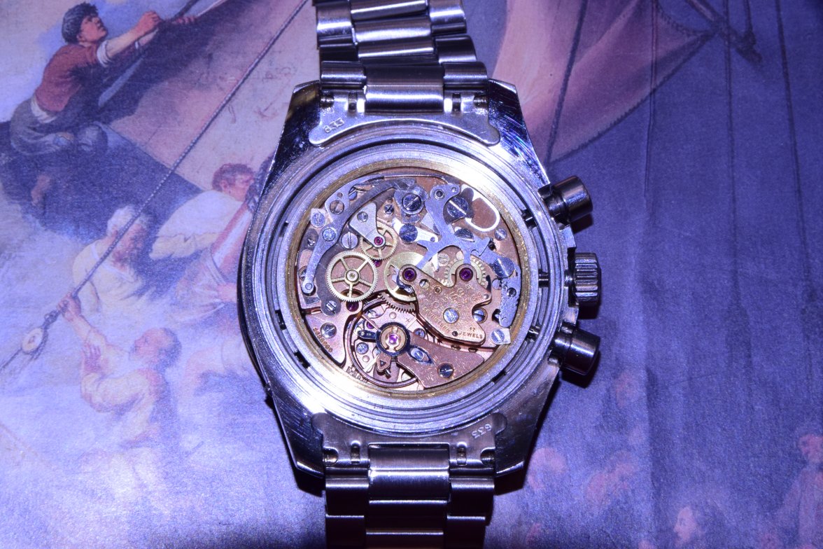

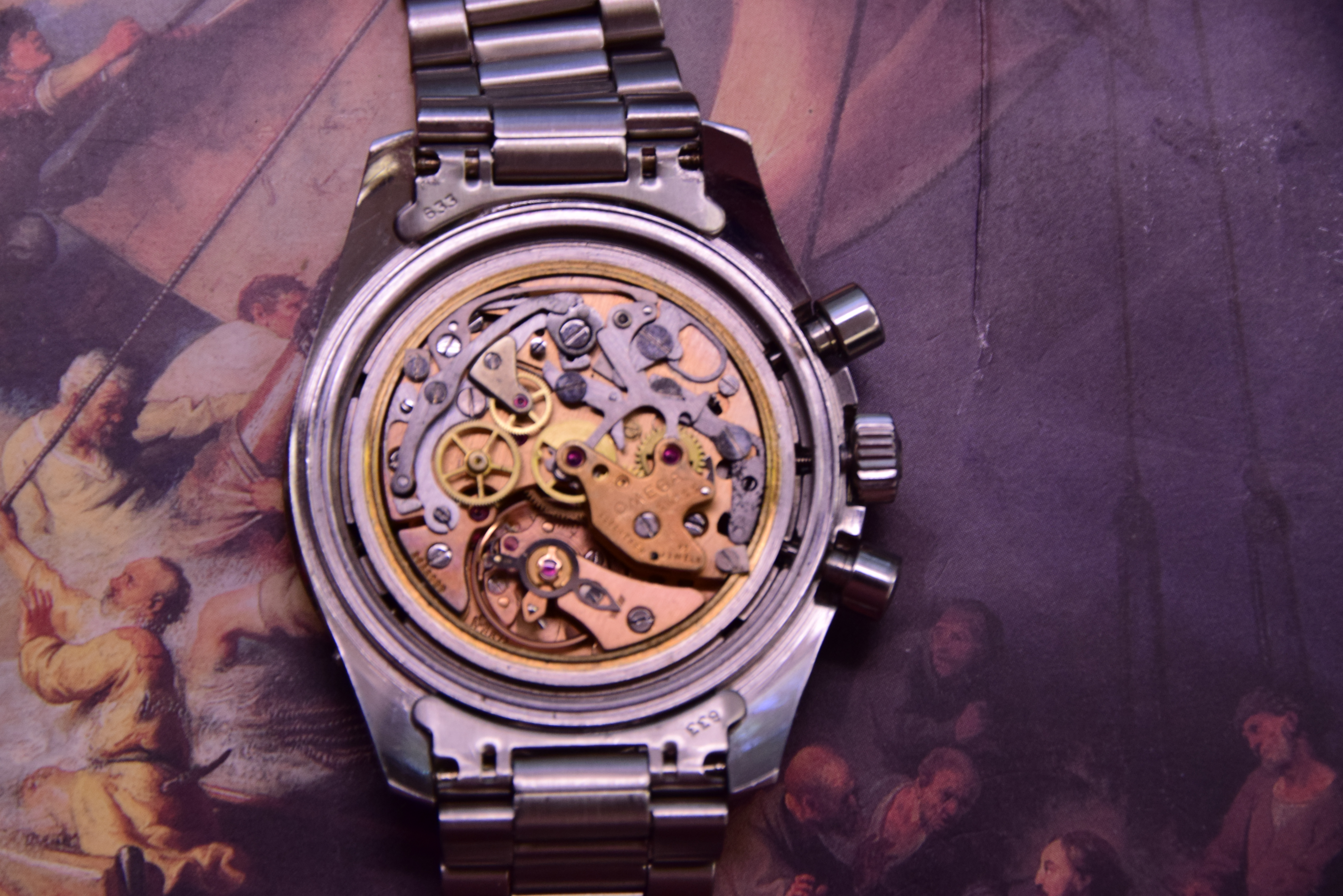

OK: Went to the watchmaker this morning,
who was quite helpful, fairly knowledgeable
about Omega watches, and took some time,
and got all of the functions working.
A) The Chronograph functions reliably when
it does start, but won't start every time.
My guy thinks this is probably a service
question, since it DOES work.
B) The moonphase indicator advances.
C) The date indicator advances.
D) He put the watch on the "clicker,"
and the watch runs about
10 sec's per day fast.

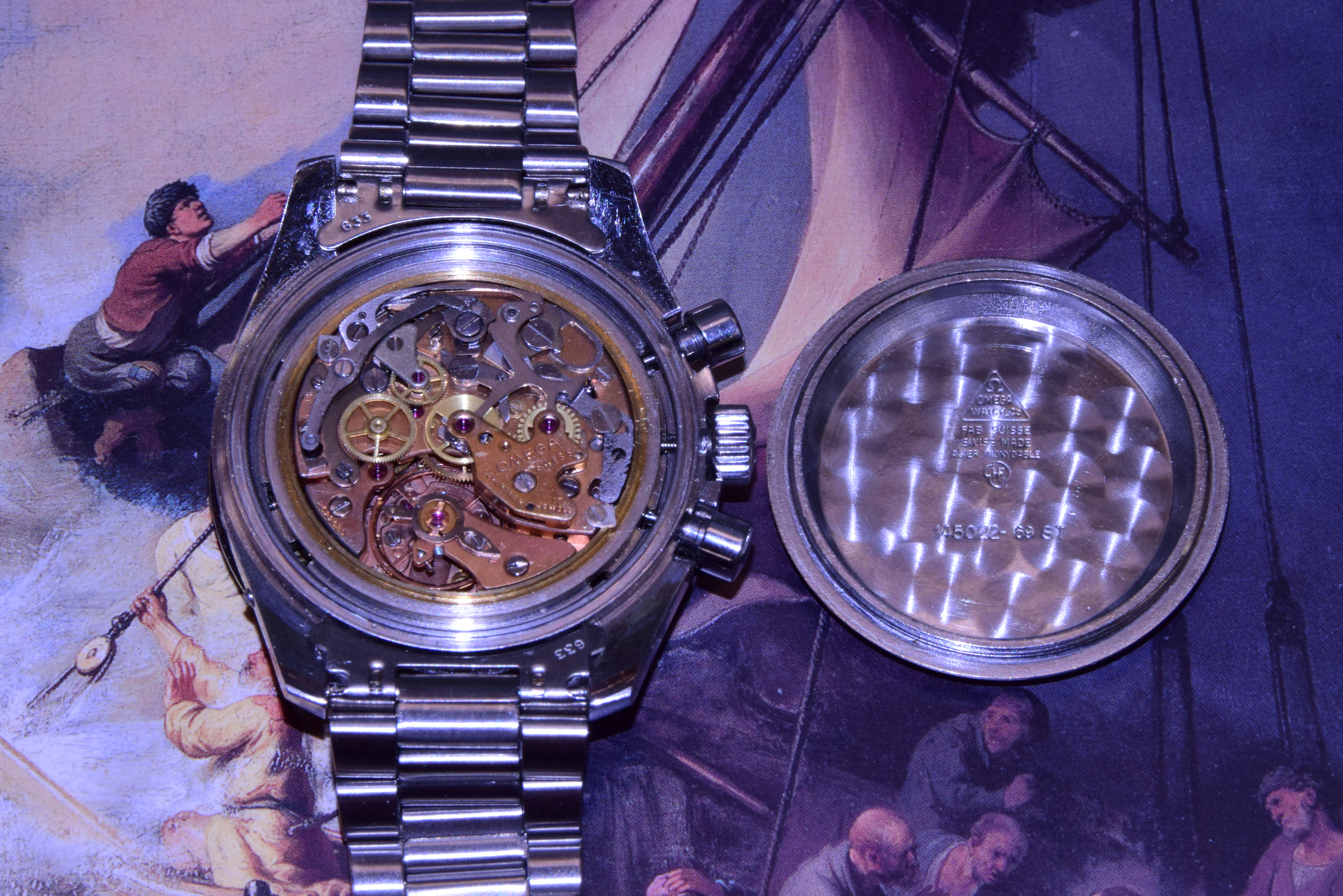

We took the back off:
Here's a first blush, while I am
trying to post pictures to this site:
Pictures are included in the
re-posted eBay ad, at:
1) The main 17J movement is marked as
an OMEGA 17J movement .
2) This movement is has serial 2622089
3) The FUNCTION of the watch has,
and working, chronograph, seconds,
minutes, hours, date of the month
and moonphase.
This begs several questions:
I) Did Omega ever use a "Non Omega"
movement in their Speedmasters ?
II) Did Omega use a "second" movement
"on top" of the "watch functions"
to provide the date and moonphase ?
Looking forward to your gentle responses....
Scott

Pianoist: Do me a favor and look over your post(s)
and see if the more critical comments are still appropriate.
My attempts to get to the bottom of this are interesting, but lengthy and time - consuming.
At this point, I would be willing to concede that this watch LOOKS VERY
different from others from about the same period.
Is it a FAKE ?
Or is it a "BITSA ?" (see my later posts)
Is it an Omega case ?
(probably so, but modified,
and from what ?)
Omega dials ?
(Probably so, but re-painted ?)
Omega movements (?)
(Probably, but original to
this TYPE of watch ?)
Original Crystal ?
(Maybe not, but almost
certainly Omega)
Back ?
(Sure looks right to me
on the INSIDE. If from
another watch, than which one ?)
Back stencil ?
(Did the very early #321 "pre-moon"
have a different back ?)
Bezel ?
(Maybe it is not Omega,
but what then ?)
I am willing to accept "incorrect,"
which is a lot less crushing than "FAKE !"
How about a "Tribute to a Speedmaster Moonphase ?

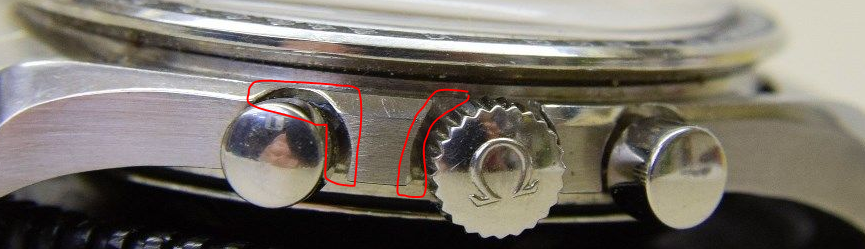

Taddy: I would welcome some additional constructive criticism......
The cut-outs for the stem and pushers on the right side
of the case do look a lot different that the ones you illustrate with.
IF my case is "bogus," than what is the origin of this case ?
Omega, aftermarket ? Could an original case be "counter bored
larger to give the cut-outs for the crown and stem to look like this ?
The moonphase and date "pushers" on the left side look wrong too.
Can it be that there is a correct movement in there, and somebody
just bored additional holes in an ordinary Speedmaster to
accommodate the "top" movement ?

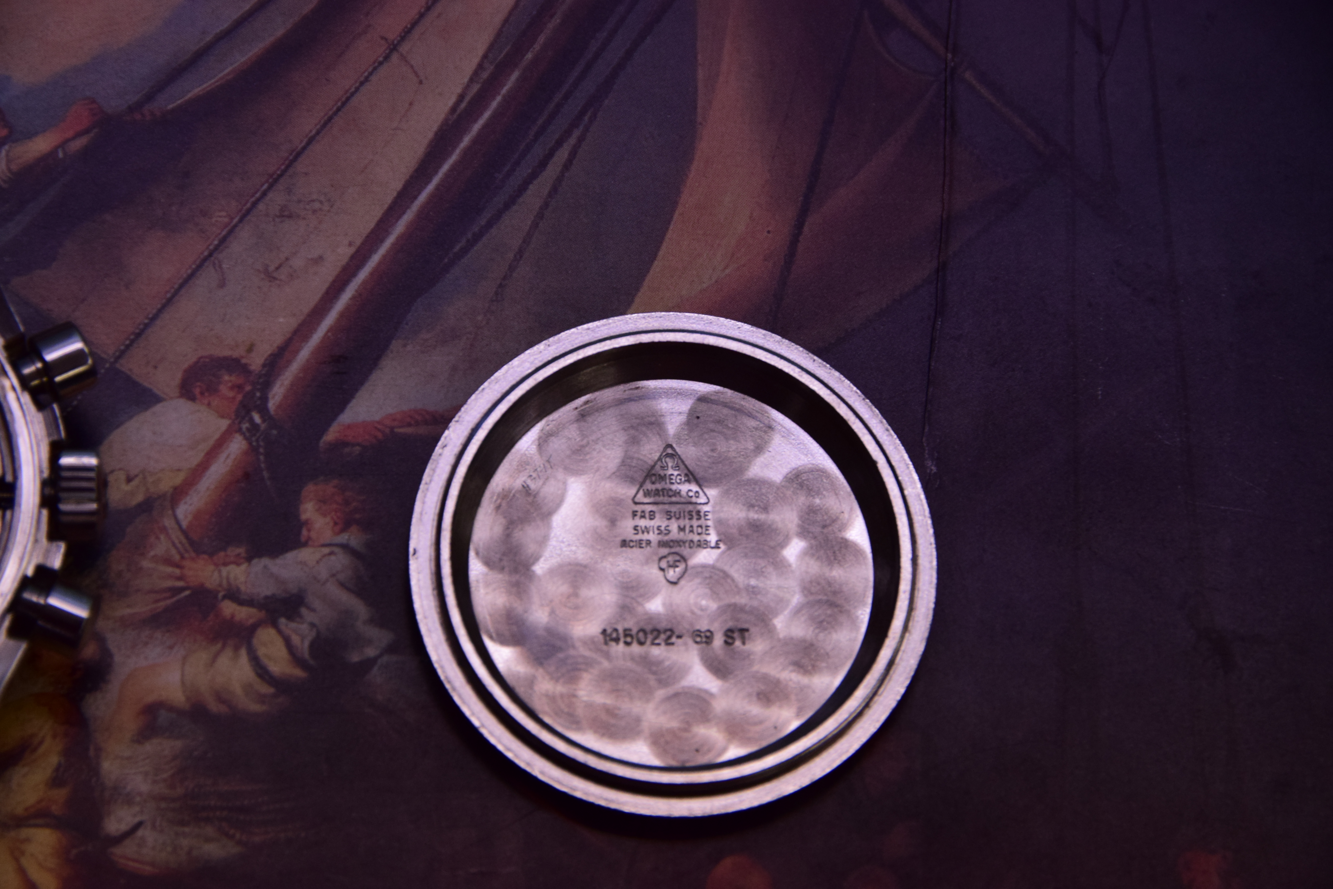

The back looks OMEGA to me, but if it is
not from a moonphase, than what ?
The movement is marked OMEGA,
and the "chronograph" bits seem to work.
If not the correct movement,
that what was the "donor ?"
Could this be put together from authentic Omega parts? Certainly I think we would agree the dial and bezel are not, as well as the monthly date hand.
In addition to the movement pic, it would be good to see a picture of inside the case back. Case back is not correct for this model as well. The watch you have was first sold in 1985. The case back on the watch would belong on a late 1960s watch. I think others with more experience can comment on the outside of the case back, given all the other issues, I would have reservations if this too is authentic.
Earlier I had not even looked at the case, basically I stopped after looking at the bezel and dial. But the workmanship below is nothing like any of the Speedmasters I own.
As far as the bracelet, the 633 end links look suspect as well. The stamping of the "633" looks wrong.
4,878
31,865
Scott,
You got a lot going on here.
Not sure how to describe this, it looks like you have authentic parts from various speedmasters, along with parts that are not authentic.
As far as the movement, there are too many different parts to lead me to think this was a moon phase originally. Possible, but I don't think likely. Serial number is from a 321, and there are a few other parts that are not moonphase. Seems like an odd mix.
Id like to hear an opinion on the case back, I have no idea if it is authentic or not.
I think consensus would be bezel and case not authentic. The dial is so badly done, I mean really bad, and that along with the case and bezel the red flags immediately go up.
