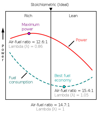

That graph is fairly misleading. A high performance engine will run very rich on that graph to keep it cool. Leaning the engine off will increase power but increase temperature and wear. Increasing performance would mean leaning off the mix not enriching it.

The graph is not misleading. It is a fact that a slightly rich mixture gives more power.
Then your interpretation of it is. High performance engines run richer than ideal. So to increase power you must lean off the mix and not enrich it.
Leaning an engine (essentially starving it) will not increase performance.
Just for an additional perspective- F1 2020 the video game utilizes Lean and Rich exactly how @Vercingetorix and I are describing. Since they boast the most realistic experience with game engineers spending thousands of hours to build it off of real data, I imagine you can trust the details.
As a pilot I 100% do not get more power off a lean engine. Engine to Engine lean and rich function the same way. There are performance gains from balancing out Rich and Lean and that’s generally where the driver spends all of their time (in that sweet spot). Enriching an engine will give more power whereas more lean restricts it.
No offence intended, but more your interpretation than his.
The graph shows the exact definition of what lean and rich means. HP engine runs way richer than ideal, as you state. If you run then a bit leaner, you increase performance, but the mix is still very rich.
A lean mix give less power than a rich one. A leaner mix... it depends on your reference mix.
Also, despite current F1 engines being high performance ones, they are running lean. The reason is the fuel limit they have to deal with. Remove the 100kg/race limitation and bring back refueling: teams will run them rich again, richer than the max performance mix for the reasons you already wrote

I don’t thinks so. I imagine with modern electronics and injection they are close to ideal, whilst still running rich to lower temperatures and protect the engine.
Fuel flow rates would be more important for power and economy, not the mix. Running a 1.6 turbo engine producing 800hp with a lean mix would not work. Detonation of pistons would be swift

They are running lean for sure: from several trustable sources (racecar engineering, SAE, etc), AFR is around 21:1 at max perfomance.
The main focus of Shell, Petronas and others is on anti-knock additives. It is also why they are all using pre-combustion chamber. They ignite a rich mix that then ignites a lean mix in the main chamber.
Interesting, well I have to admit to my knowledge being limited and lacking and wrong. Pre ignition chambers, additives, and massively lean engines, quite different to performance road car. A bit of a sidetrack from what I meant that a big knob saying rich/lean mix is unlikely and simplistic, but it is an interesting one. I think I understand more about the difficulties and limitations and innovations for engineers than I did.
