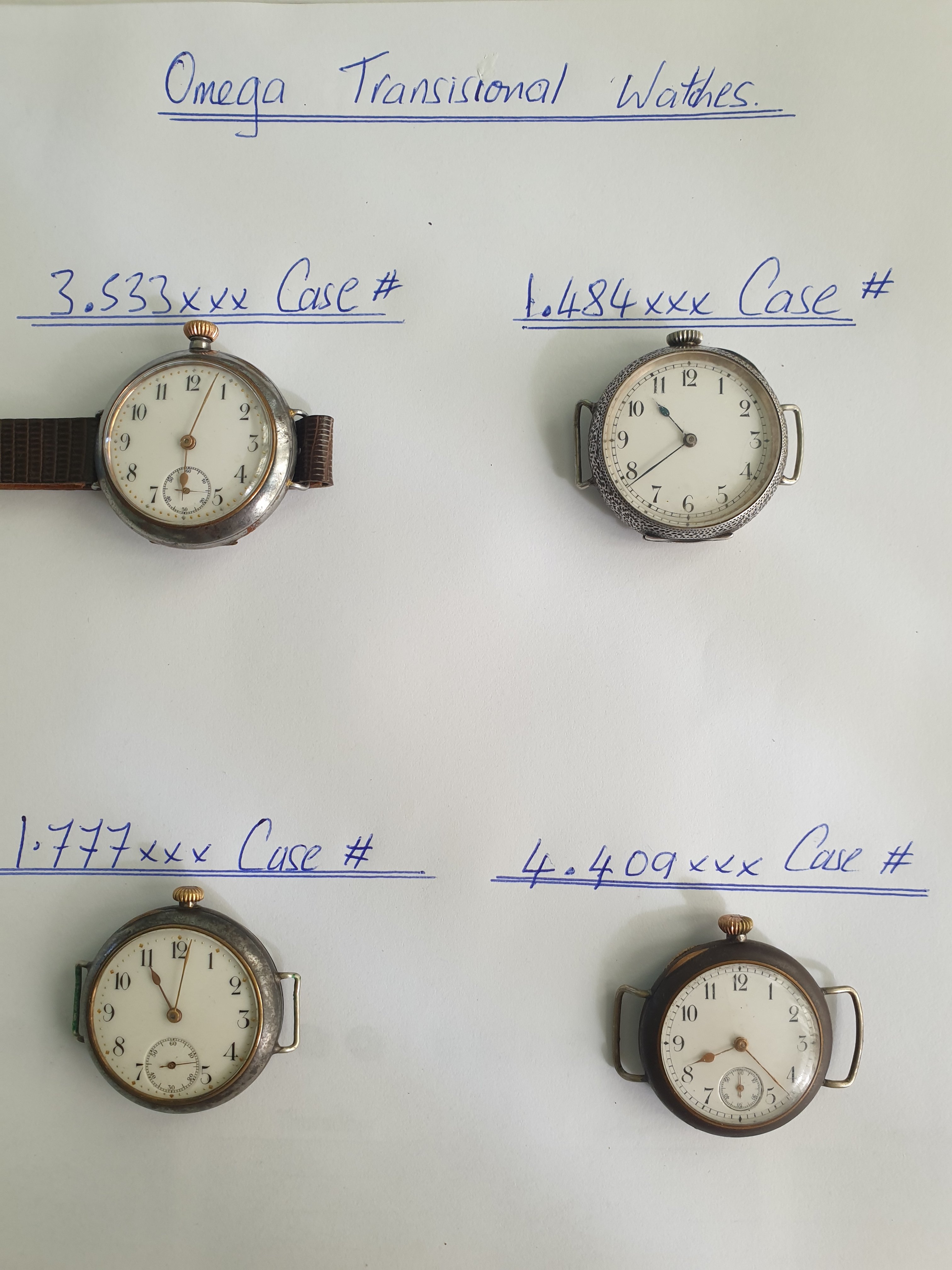

I would love to see some examples of any genuine 1900-1906 wristwatches
Have a look in AJTT, Chapter 3
572
1,461

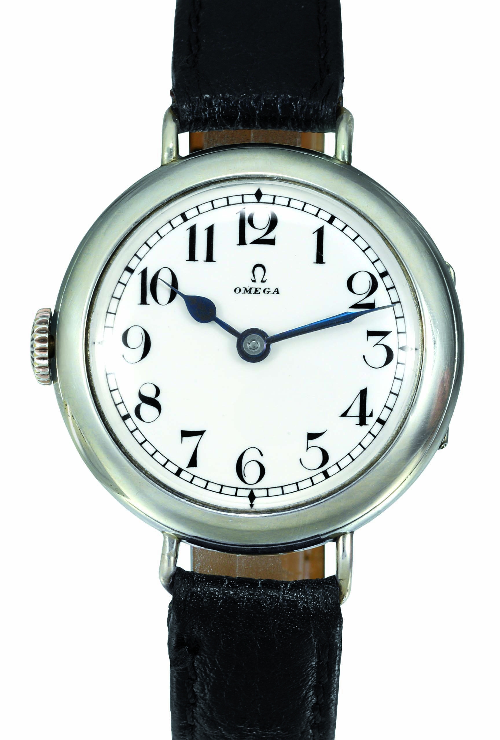

saw this Omega from 1905
And here we see the style of the early wristwatches - quite different from the 'cushion-shape' in the video posted above, which surely dates much later that the video claims.
And it also confirms the point from @JimInOz about the watch in that video - that "the size of the wire lugs is out of place with a watch from the first decade of the 1900s".

a cushion case style with wide lugs and strap was available as early as 1916.
Agreed. But 1916/1917 is a very different story from 1900. I'm afraid the claims in the video would need some explaining (unlikely!).

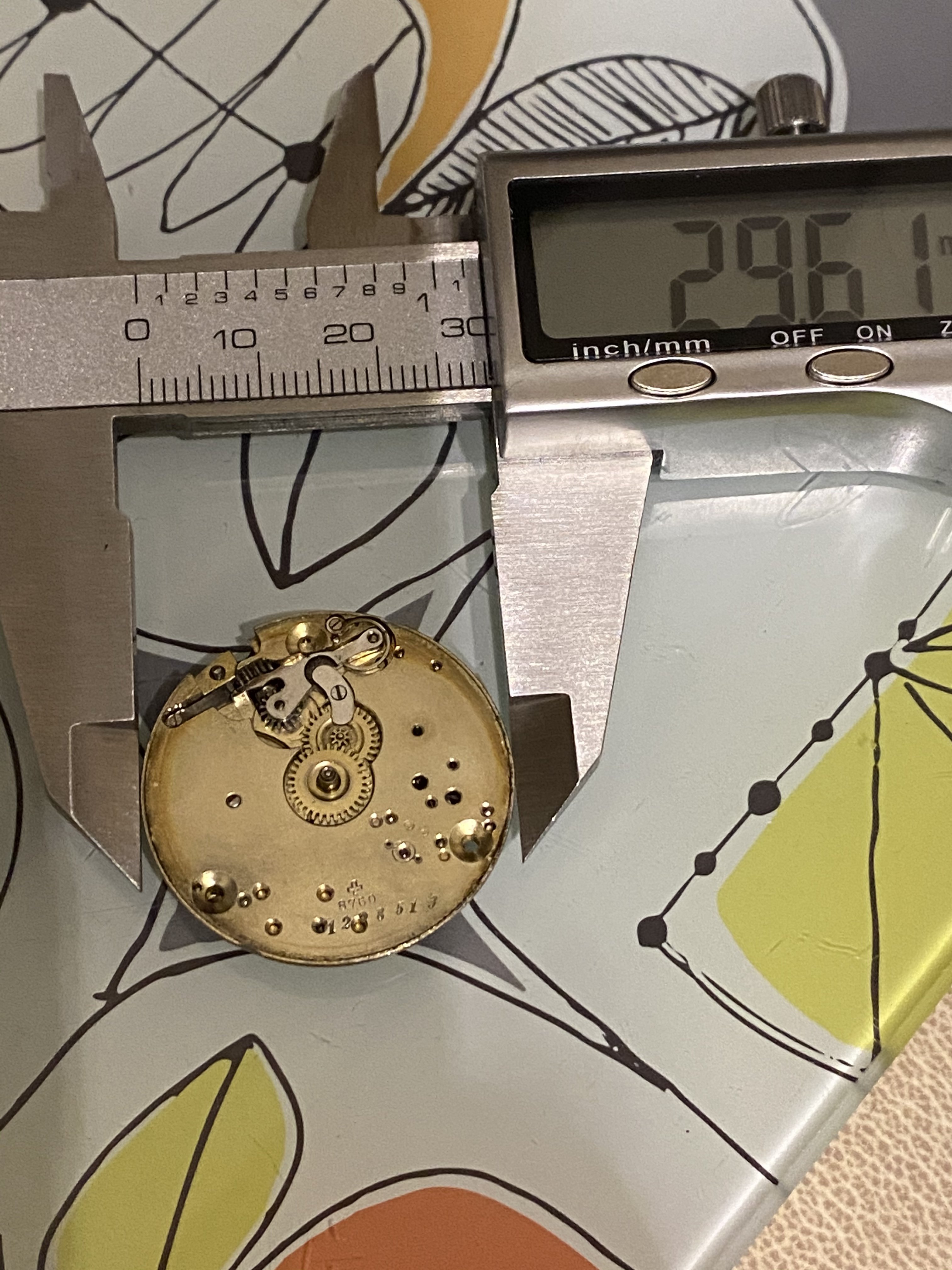

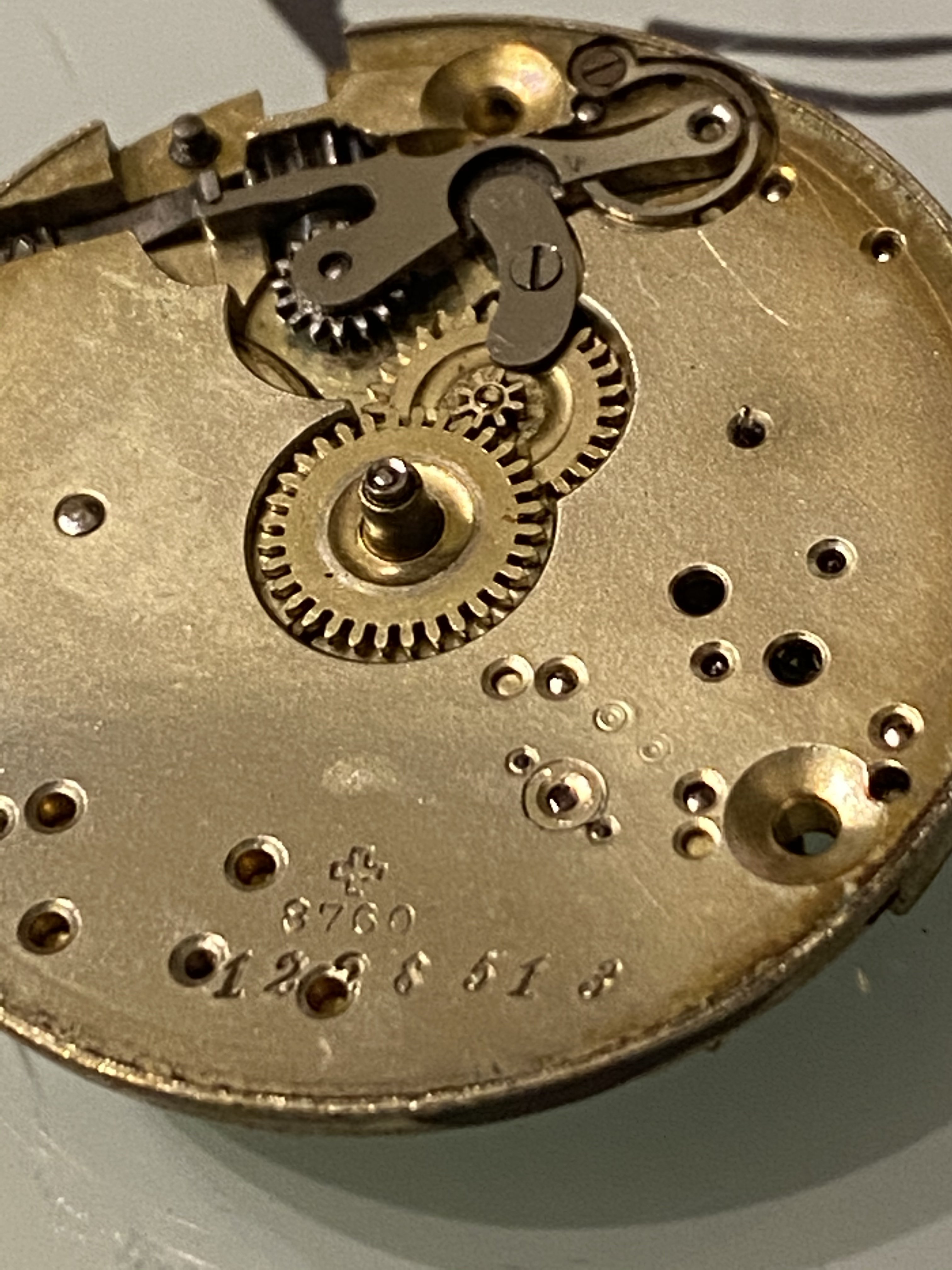

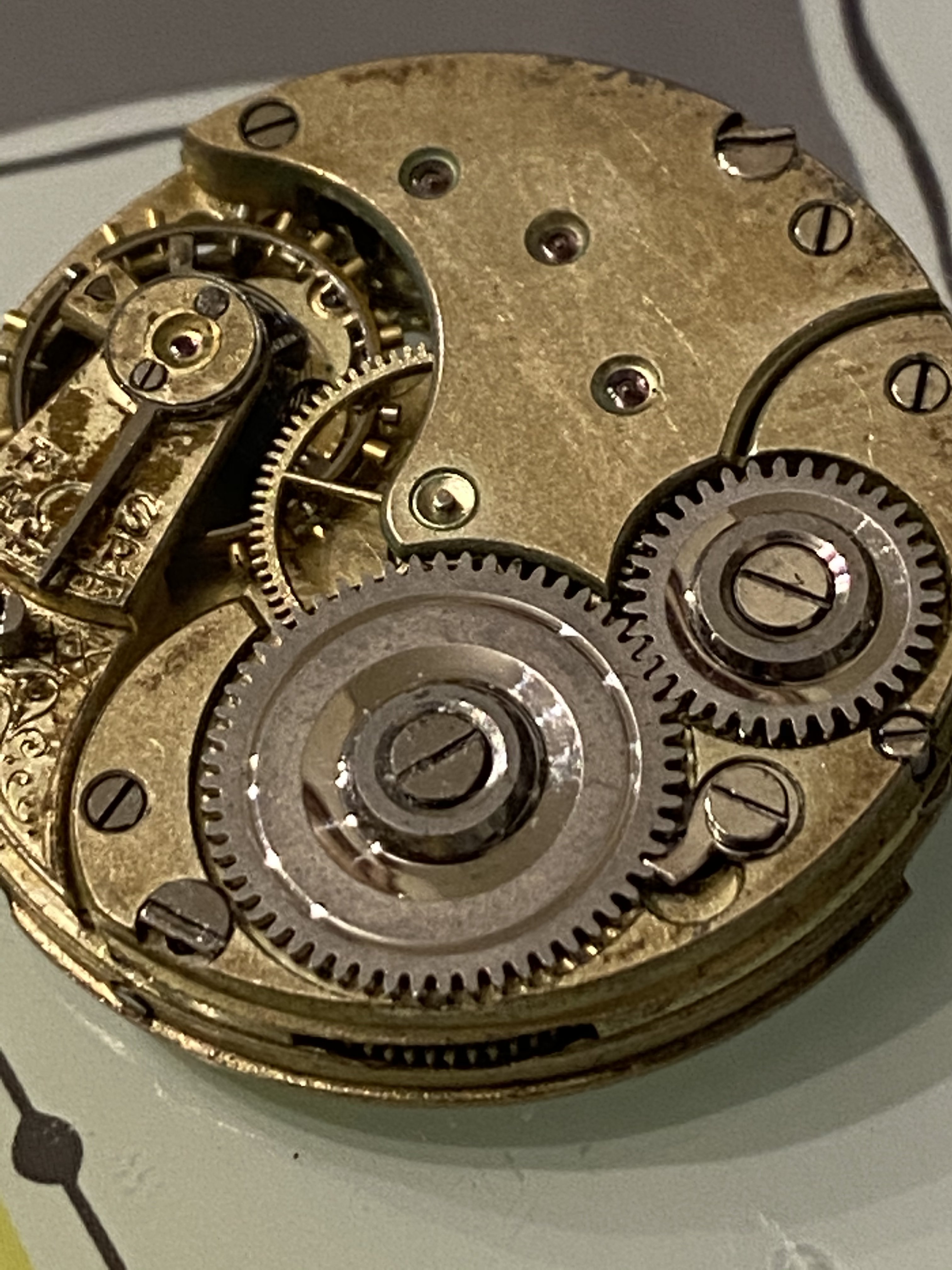

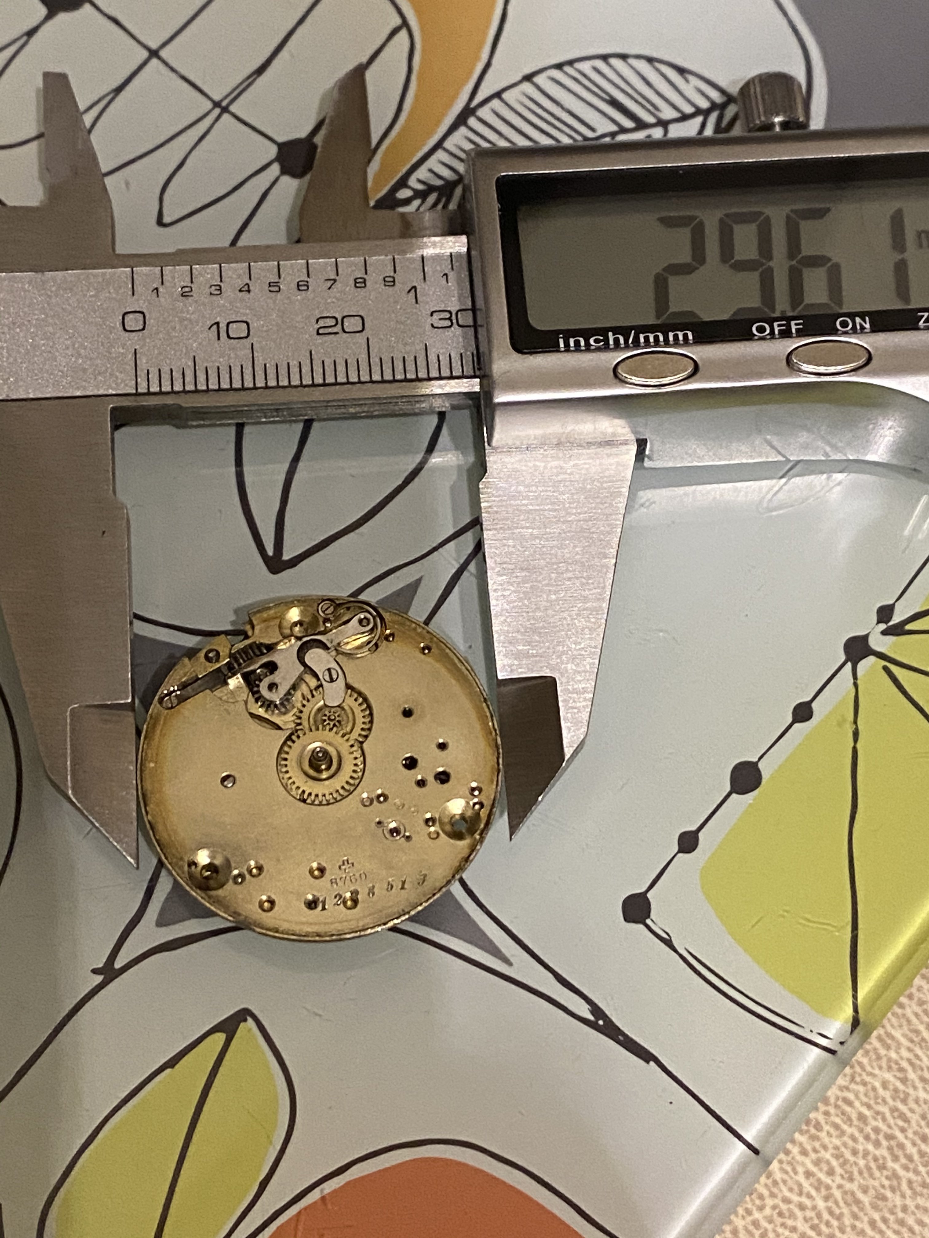

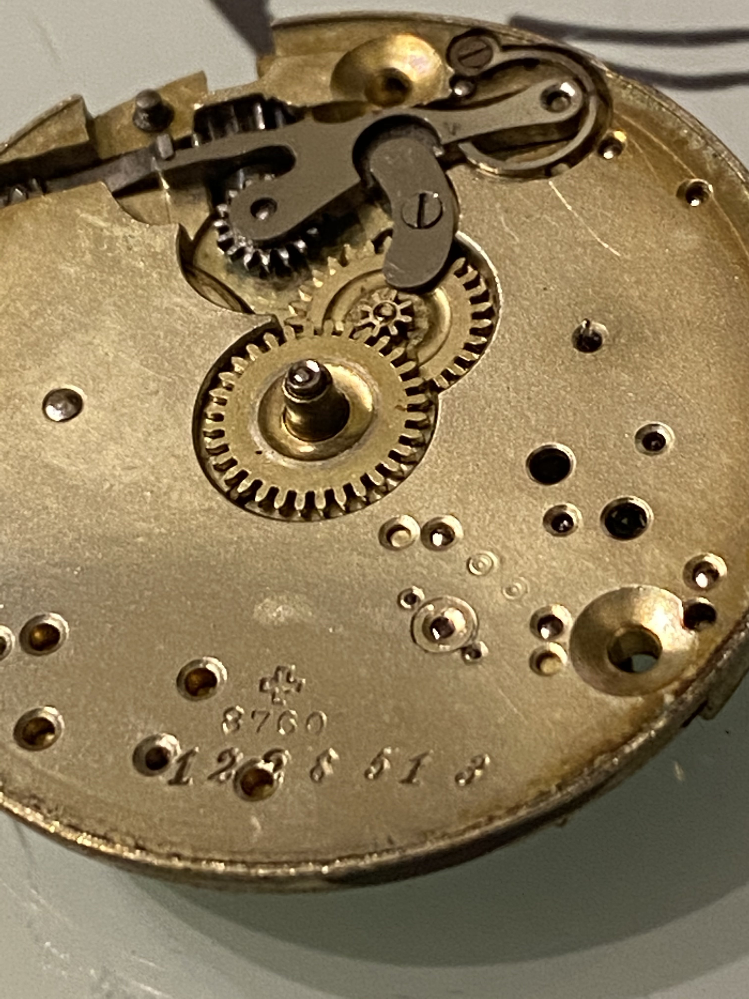

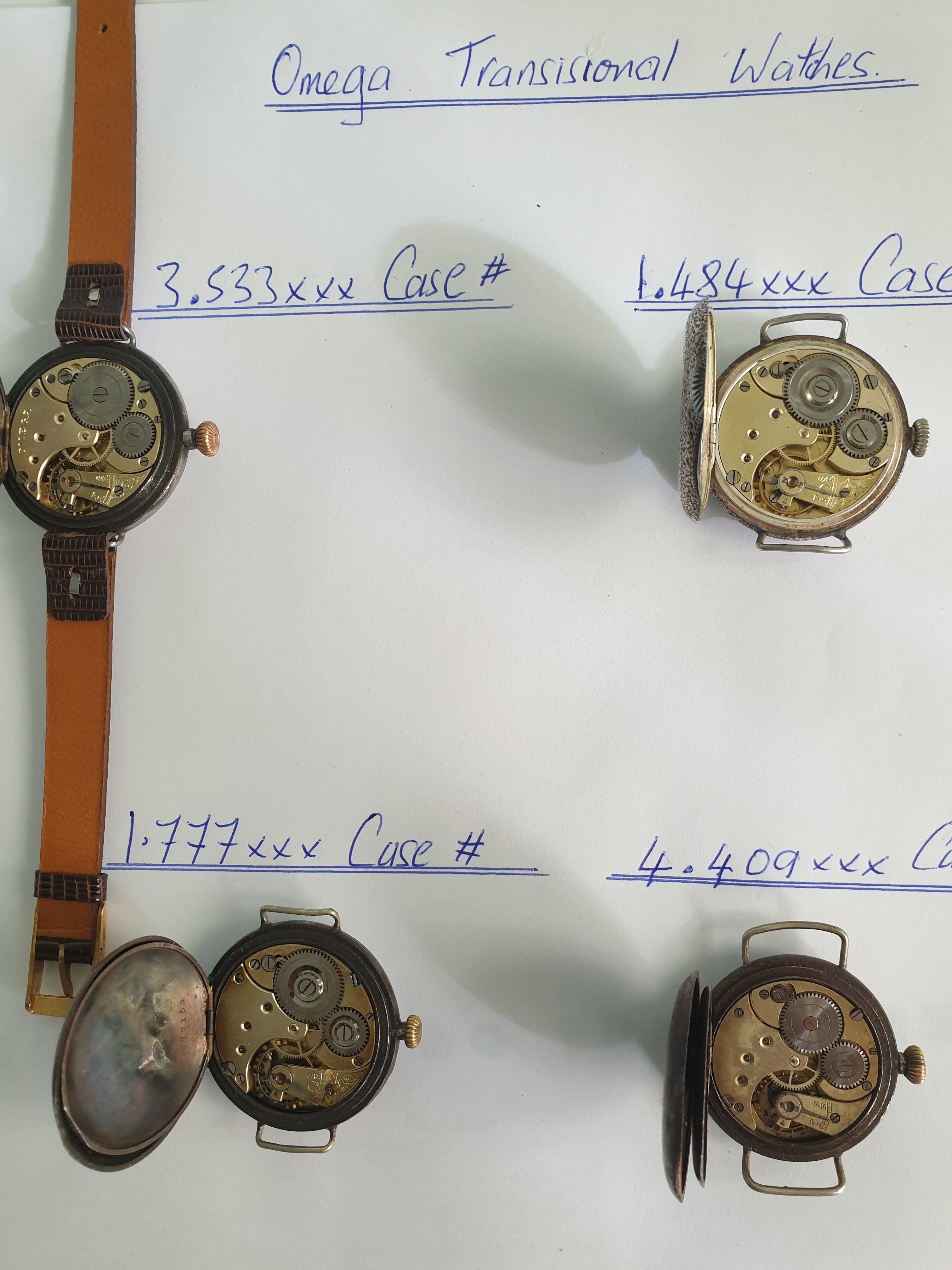

Sorry to resurrect this old thread but it got me thinking about this old movement I had kicking around. Would it have come from an early Omega wrist watch or is it just a small Omega pocket watch movement? Did they make them this small? The omega symbol is on the regulator index but hard to see in my pics due to the oxidation. Thanks for any insights you guys may have.
13,685
19,062
Looks like a 13 ligne movement. Based on the serial number, it’s a very early Omega, probably pre-1900, so it is definitely a ladies pocket watch movement.
gatorcpa
Given the orientation of the stem (at 3 o clock) i’m assuming it must have been a hunter watch then?
18,851
39,205
Possibly, but it could have been a movement from stock and used in a wrist watch which would align with the crown at 3.
The caliber 13''' would have been suitable for a wrist watch which was appearing in the very early 1900s (1902 onward).
The 1 million series serials ran roughly 1994 to 1902 but were used up until 1916 in low production runs.
Only an extract (if available) will answer the question.
You will not get an extract based on the movement# for one reason: early watches have to be looked up in the archives by case serial numbers unlike the watches from around 1939 onwards which are searched for by movement serial##
18,851
39,205
So without the case, we have no case.

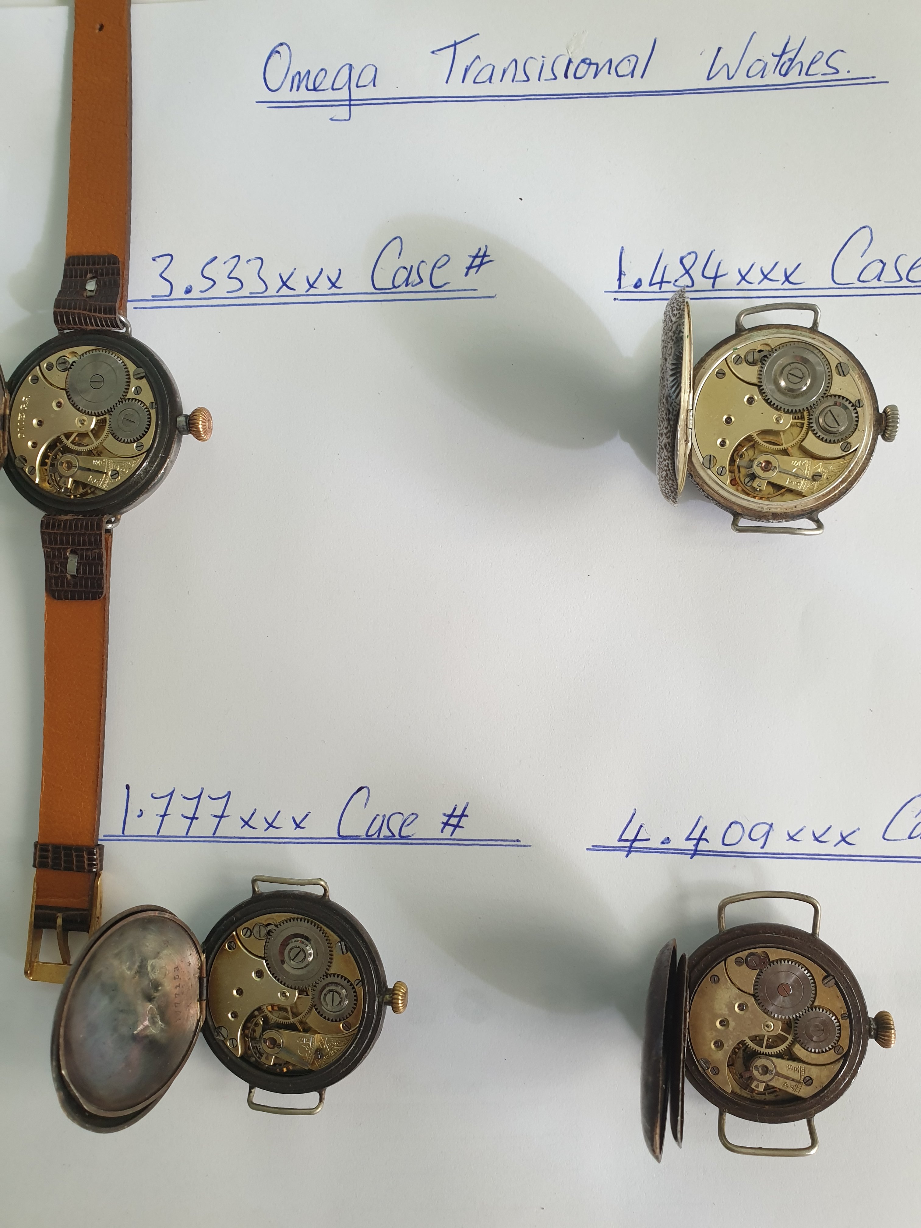

So were early omega case numbers unique identifiers rather than just a reference to the model/style?
18,851
39,205
Thanks for your help.
Correct. The cases were serial numbered, as were the movements (although not the same group of numbers) so it is completely normal to find a case number with a different movement number.
As @mac_omega explained, archives were registered by case number until 1939.
I don't know exactly when the company started to include model numbers instead of serials in casebacks, but somebody here is sure to know.
