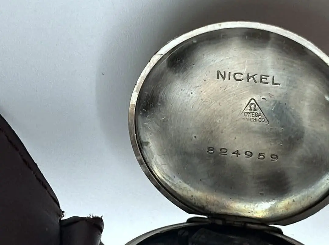

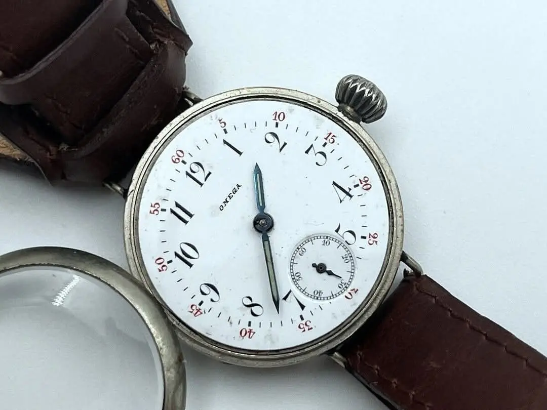

So my watchmaker has this, and the serial number appears to be from the 1900s, maybe 1903, 1905, somewhere around there. I thought wristwatches weren't a thing then. Can anyone confirm the originality of this piece?

Sorry, have to disagree. Who are the ‘others’ above with whom you agree? Not many agree with you!

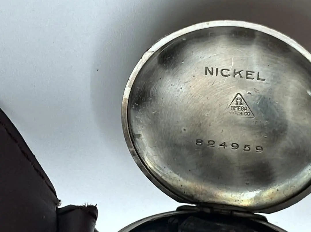

To start with, the case on the OP’s watch is not Omega (the movement is). The case number therefore does not help to date the watch from Omega numbers - which anyway for this period would have 7 digits (this has 6).
As already written, it is impossible to date this watch from the movement alone (it could have been produced 10 years later), nor from the case.
The link to Bob’s watches is interesting (and collects information which has been available for years) but does not help much with this watch - the link largely refer to modern watches (listed/dated according to movement numbers, unlike the early watches).

You will not get an extract based on the movement# for one reason: early watches have to be looked up in the archives by case serial numbers unlike the watches from around 1939 onwards which are searched for by movement serial##

1) The inscription on the back mentioning Eclipse Stove places the date of the CASE as definitively earlier than 1920, as that is the year that the company changed its name to Tappan (the folks who introduced the microwave commercially in ~1957). Thanks to @gatorcpa for early thread research.
2) As many have recounted here, though the movement and dial definitely do appear to be genuine Omega, there is no definitive means of establishing a specific date for the manufacture (per @mac_omega ), only loose comparisons to similar dials, similar size 'side-winder' movements (from smallish hunter pocket watches) and similarly constructed movements.
3) The suspicious protrusion of the stem seems to indicate that the movement began life as a pocket watch, as there is a stem length belying the removal of the bow and pendant as mentioned by @JimInOz earlier.
4) The likely date of presentation of the watch - bounded by, in part, the best estimate that can be made for the age of the actual recipient, Michael Loesch, whose grave marker link was posted by an intrepid thread participant some months ago.
I'm sufficiently pleased to have the watch in my collection due to the historical considerations, the charm of the inscription, and the likelihood of it possessing a genuine Omega dial and movement that certainly puts it at over 100 years old based on the collected discussion here.

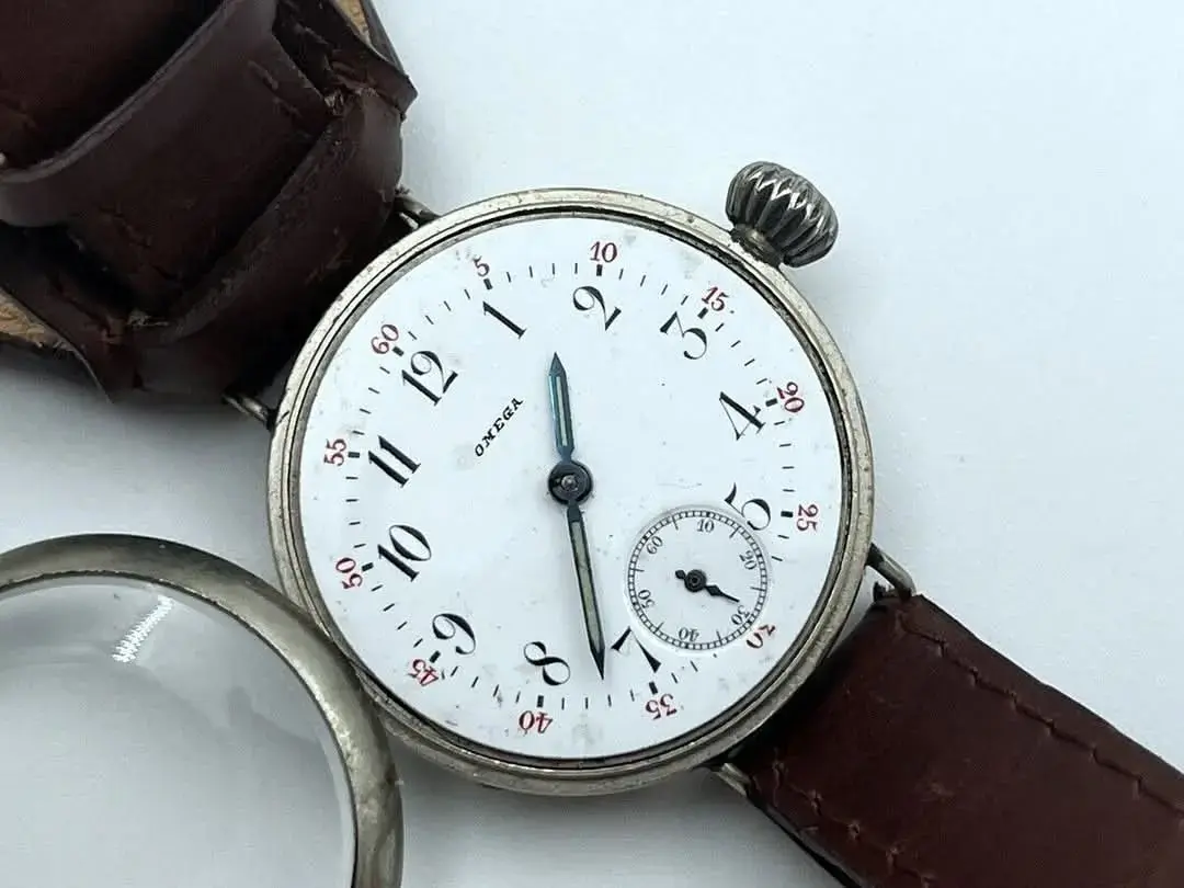

Sorry to bring up an old thread, but I wondered what the hive mind thinks of this one. Owner is adamant this is a 1900 wristwatch...
18,851
39,205
Nice hands for 1900 🙄.
I'd show the owner the previous posts to help with his research.

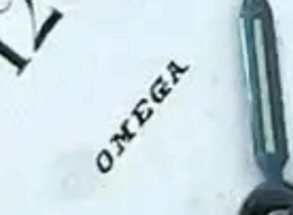

ONEGA ?
Sorry, just magnified, it's an M.

The owner actually directed me to this thread, as if it verified his belief.

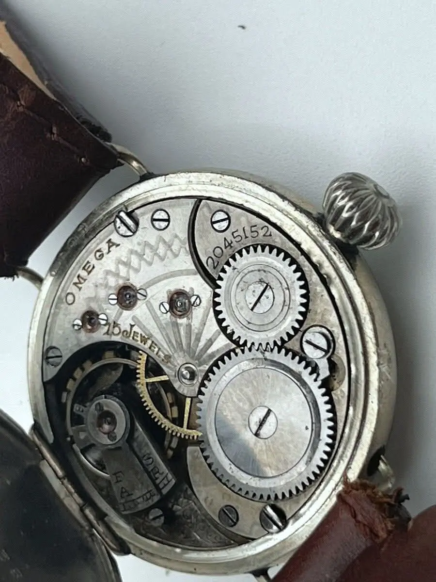

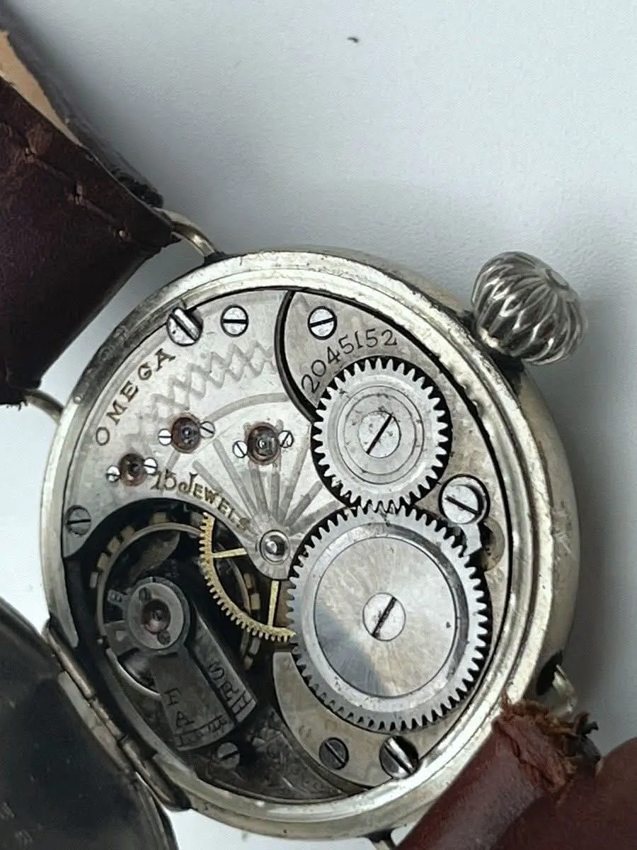

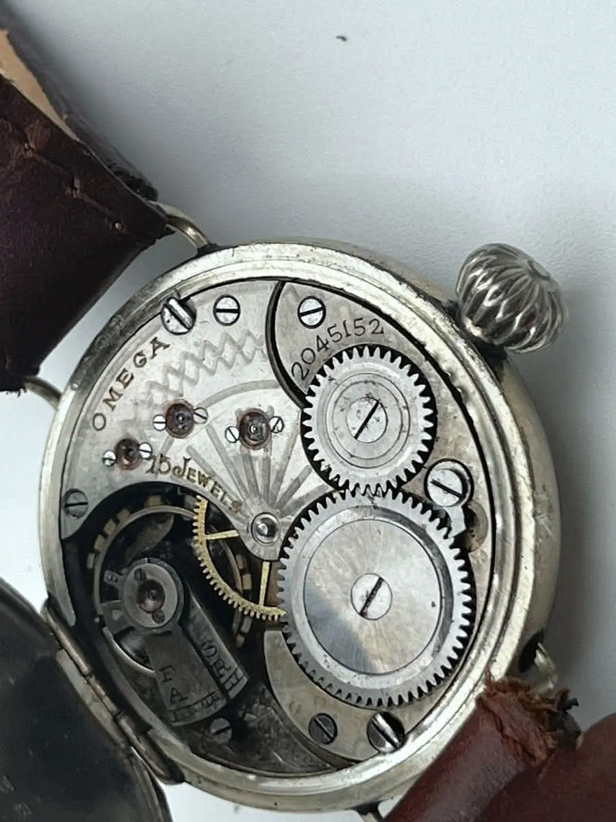

Here is the movement.
When did Omega start using the triangular stamp? I thought it was in the 1930's.

As others have said, the hands on that are obviously not correct.
The lugs look really suspicious to me, there seems to be obvious evidence of a pretty mid-tier soldering job of it, so I don't think that case originally had lugs.
The movement is pretty clearly this one:
https://pocketwatchdatabase.com/search/result/omega-watch-co/2045152
So 1903 movement production (though other Omega serial number searches put this in 1902).
See its sister here: https://pocketwatchdatabase.com/profile/abmimoso/collection/view/161346
You can see that one is a pocket watch with basically the same dial as that one. The movement is similar, though pressed in vs screw-in bearings, plus some additional movement finishing. THAT is a bit of an older watch based on serial number (201 vs 204).
A little later of a sibling is here: https://pocketwatchdatabase.com/profile/Jbeau56/collection/view/179042
(210 vs 204). This one has similar finishing, but still the same bearings as the previous one. Interestingly, STILL doesn't say Omega on the movement like yours does.
What does all this mean? VERY little it seems. These are 3 movements likely from the same 'run' of movements. So differences in the movement are probably expected.
That said, I'd put money on that one being a converted pocket watch.

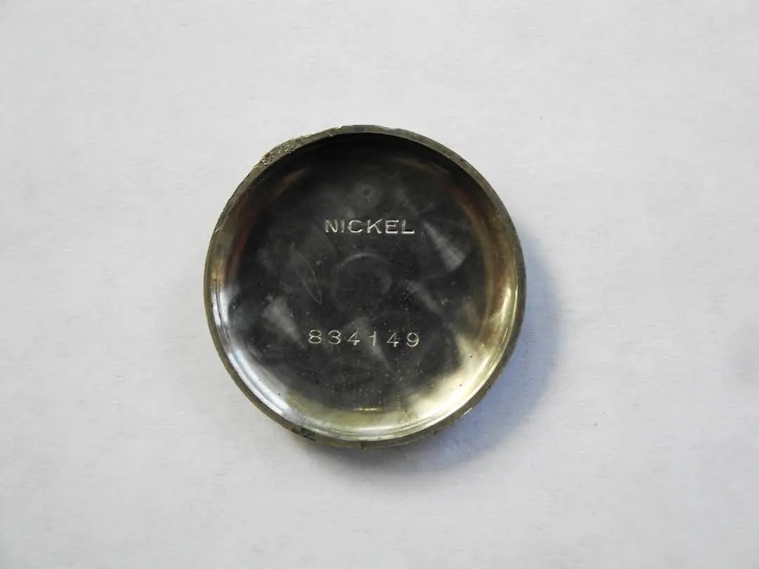

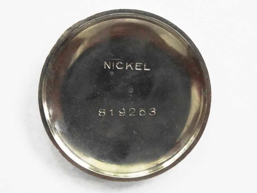

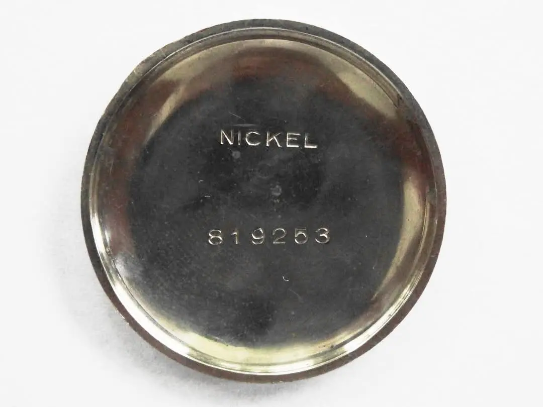

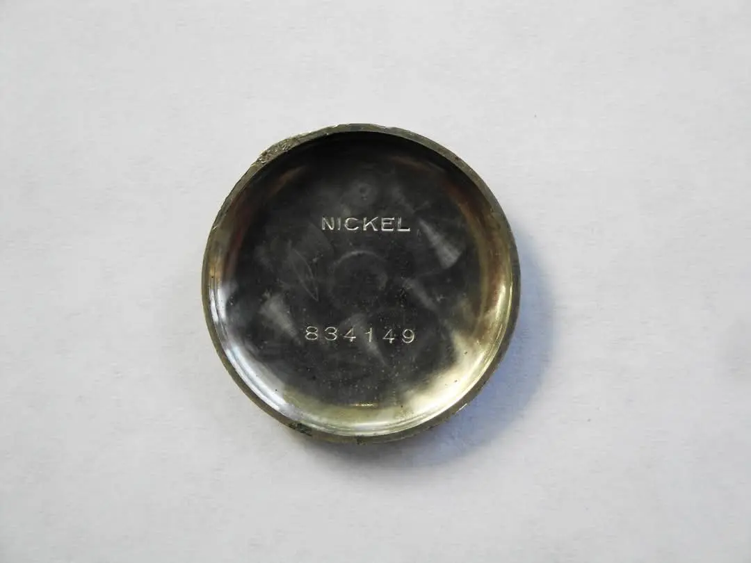

Further to my initial post, Stan Czubernat says these cases were made by Wadsworth between 1916 and 1918, he posted a couple that have a six digit serial number beginning with 8.
So along with the original poster's watch they all seem to be Wadsworth cased watches no earlier than 1916.
