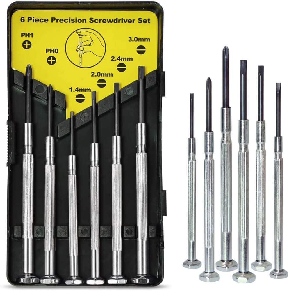

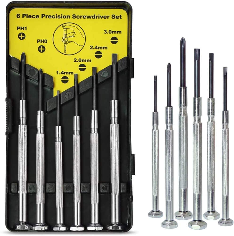

Yes for vintage 1171, 1162, and 1479. Normally, also yes for my wife's Ladies Dynamics, but once ran into difficulty getting a screw fully out or back in (I forget which) and had to take it to my local watchmaker because I didn't want to force it. I just use one of these and one of those plastic bracelet holders that come in the $5.00 kits from China:
The plastic bracelet holders work fine but I would recommend getting a decent set of jeweller/precision screwdrivers. You don't have to spend a lot but the difference between <£5 and around £20 (or more) for a set of a half dozen or so is notable. Found this out when changing the battery on my X-33 which has multiple, very fine, shallow head screws. The cheaper screwdrivers have a thicker, uneven tip which can easily destroy the screw heads since they don't bite into the screw head very well. Better quality ones will have a sharper, even tip. Huge difference when the screw head is very small and shallow.

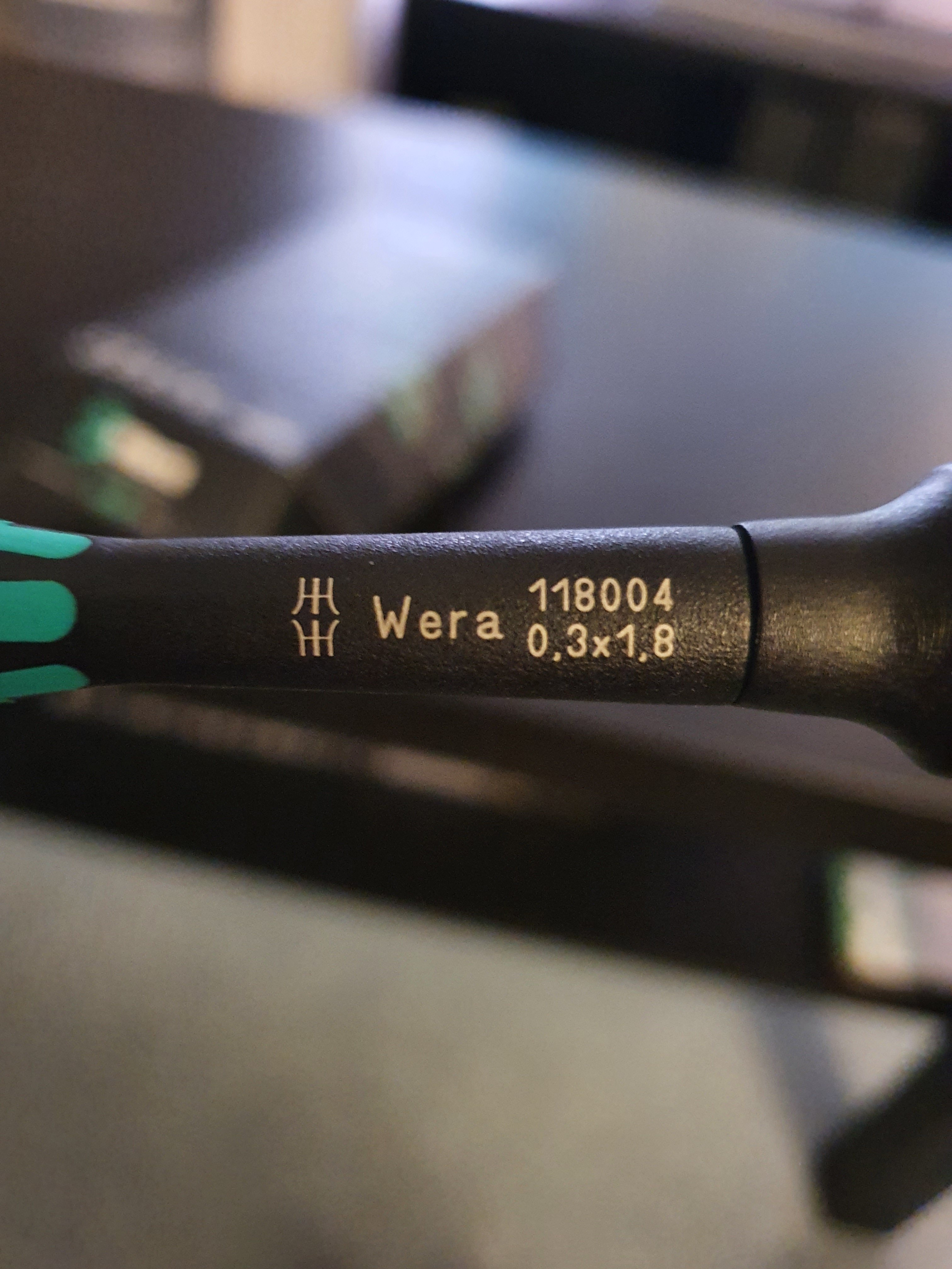

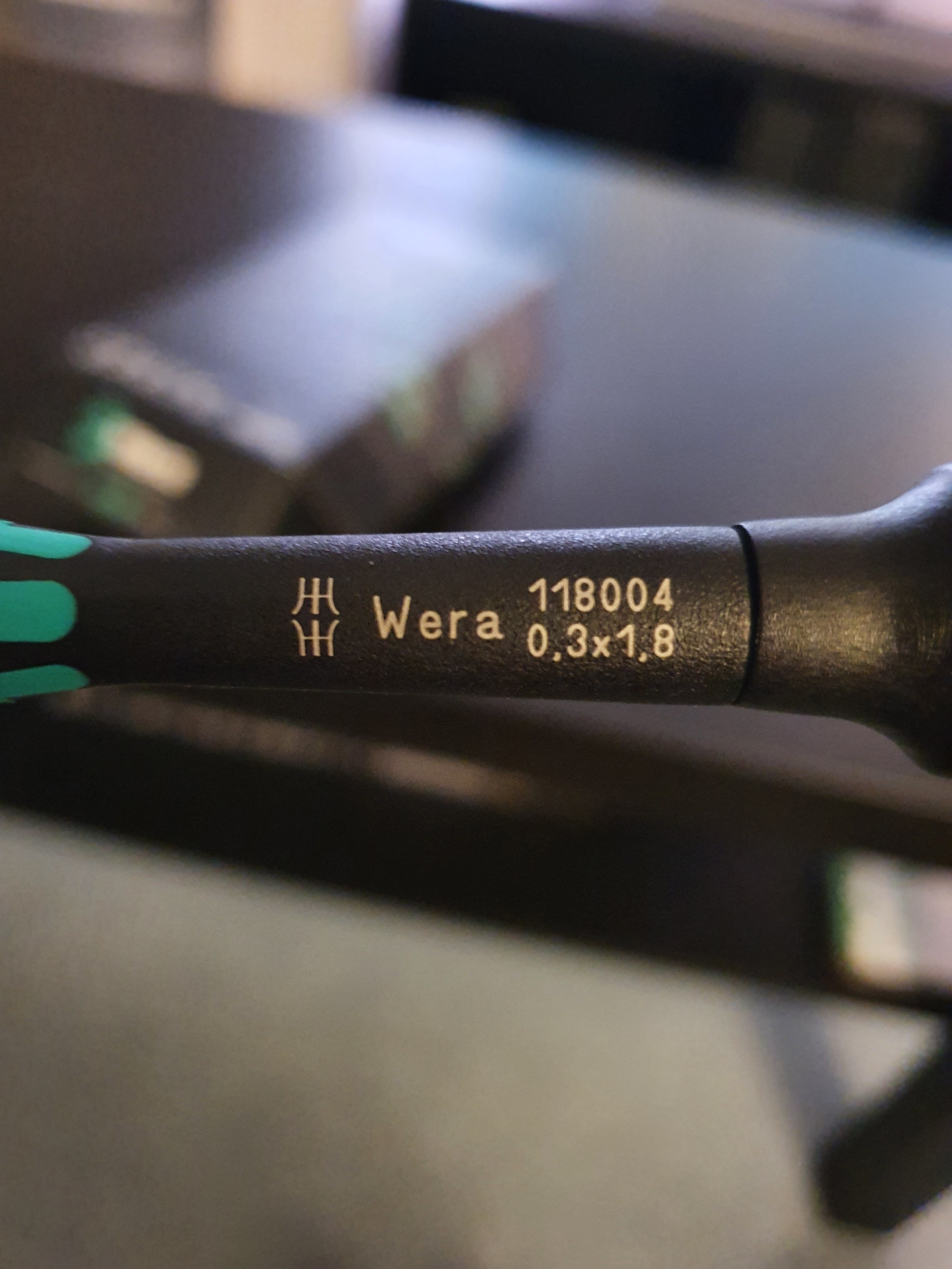

I did my Speedmaster bracelet using the 1.8mm screwdriver from this kit after doing a bit of research.
https://www.screwfix.com/p/wera-kra..._bvD_BwE#product_additional_details_container
The depth and fit was perfect, and got all the screws out without marring and jumping out of the slot.
I didn't need to use any heat, but worth noting those screws were not the easiest to remove without it.

I seem to think it was that one anyway, I handily already had the kit. Whichever I used it was a good positive fit.

It was this one, 0.3 X 1.8mm.
